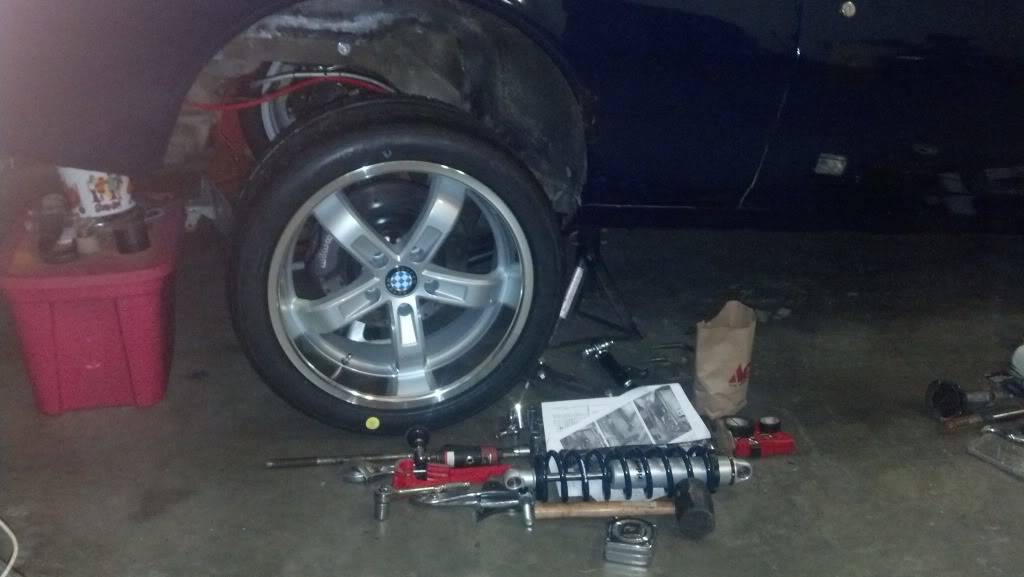

      Yah I've been lazy on the picture taking - I'll have to get some after church tonight. Right now the car looks like a Redneck mobile with the wheels and tires on it and the rear jacked up in the air 3-4 feet.

      Haha - it looked too funny not to share!
      I'm going to start working on fitting the tabs to the axle tomorrow night. Tonight's progress consisted of getting the fuel pump and filter "panel" mounted. I had to move it to clear the 4 link cradle. Unfortunately it's now in the way of installing a rear sway bar if I decide to buy one later. The car really needs a new fuel tank so maybe a fuel tank with an internal pump, sway bar, and a few odds/ends will be on next Winter's upgrade list. Next year's list definitely won't be as long as this year's was!
      So, back to the progress for tonight, I had to re-run some of the return lines because of the relocation and the pressure line isn't long enough to reach to the new location either. I've got a few feet of braided stainless Earls -6 line and some -6 fittings so I just cut out the portion of the line that was running over the axle and am going to mate it together with a -6 conversion fitting from the metal line to the Earls line. I hope it doesn't end up causing my garage to smell. If it does, I'll replace the hole metal pressure line from the tank to the engine Saturday. Hope it doesn't because I don't want to waste time going to Augusta to get a roll of line from Auto Zone.
      You can see where the line was run in the picture above where it's hanging down in case you're curious!
      That's it for now!
