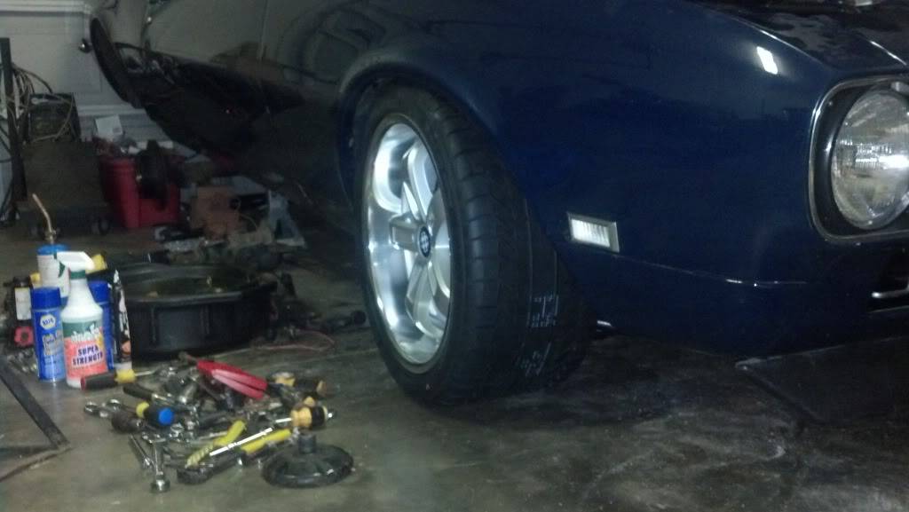

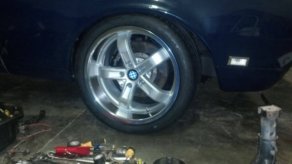

    5. #105
      1,747
      Pics - pretty self explanatory
      As you can see it's LOW...
      GeoffP
      68 Camaro - LS1/T-56
    6. #106
      Cincinnati, OH
      331
      That is a ton of dish for the front! I like it. Are the rears even deeper?
      Jim S.
      67 RS
      "driver "
    7. #107
      1,747
      Thanks! The wheel are the same front and rear. If I decide I really like them (They're growing on me), I'm going to have them widened to 11 or 12 whenever the money tree puts out enough to do the mini tub. I agree that a deep tub version of this wheel in an 11 or 12 would be cool looking.
      GeoffP
