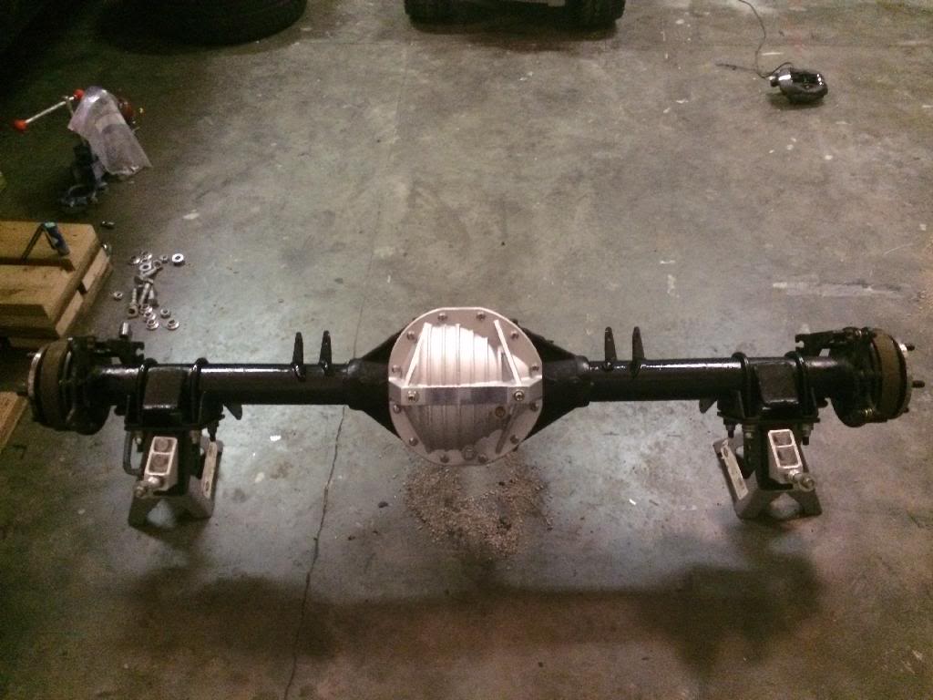

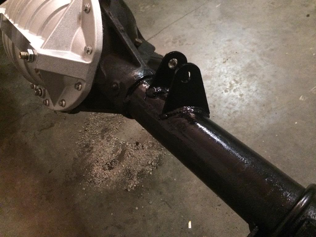

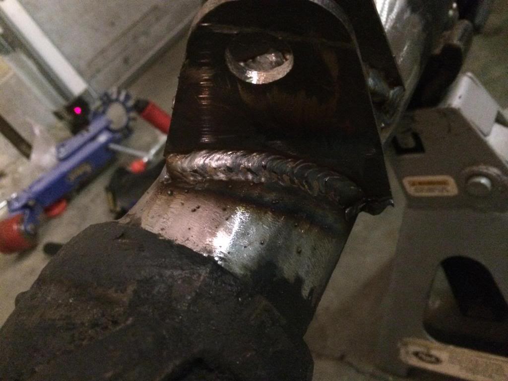

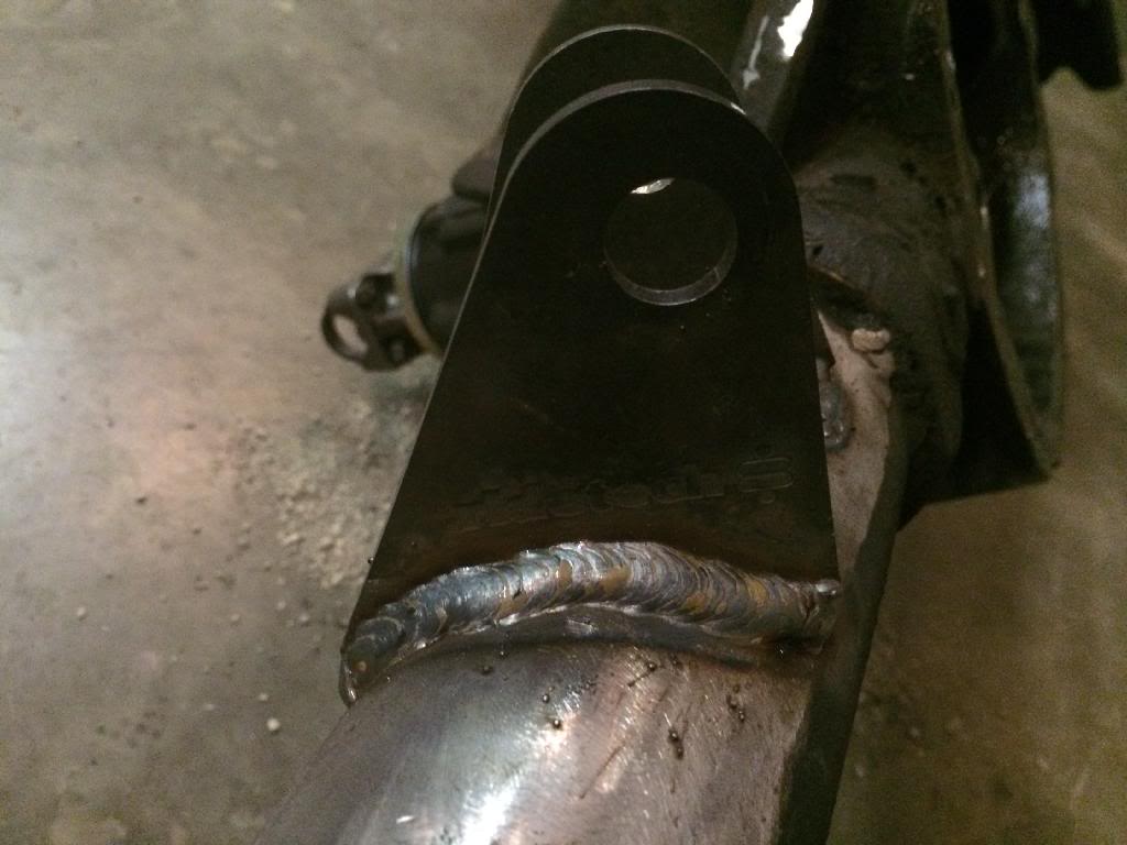

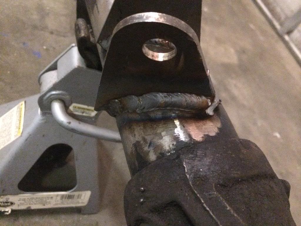

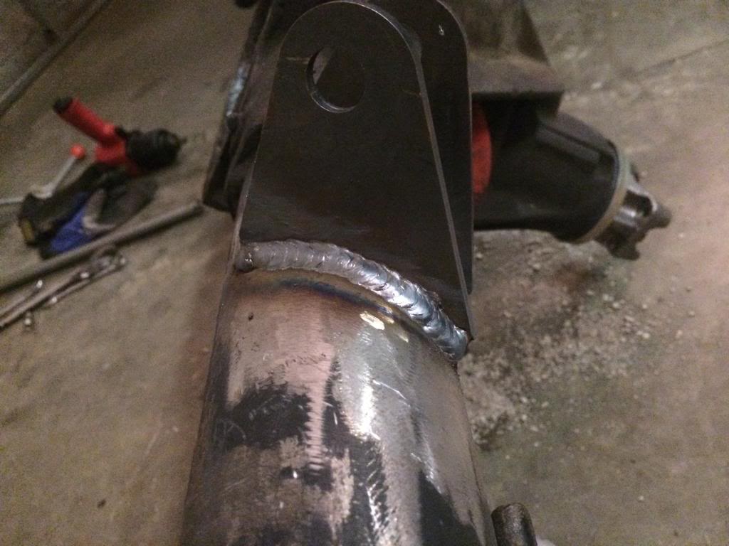

      Here are some updated pictures of my rear axle project. With some help from a few friends (Rodney Prouty, Brian and Tony Clark, Kevin Poe, and a couple local friends), I got the upper link tabs redone on my axle and replaced the very noisy 4.11:1 gear set with a set of used 3.55:1 gears. I want to give credit and extend thanks to these guys because without each of them helping, I would not have been able to do this project. Money for big boy toys has been very tight this year so I did this on a shoestring budget. The pictures below show the various stages of progress over the last few weeks of working as I had time and was able to get help with certain things like welding and setting up the gears. The first few pictures show the excellent welds.

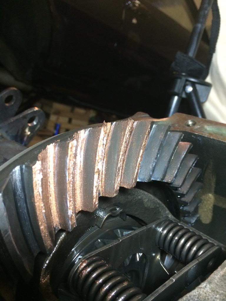

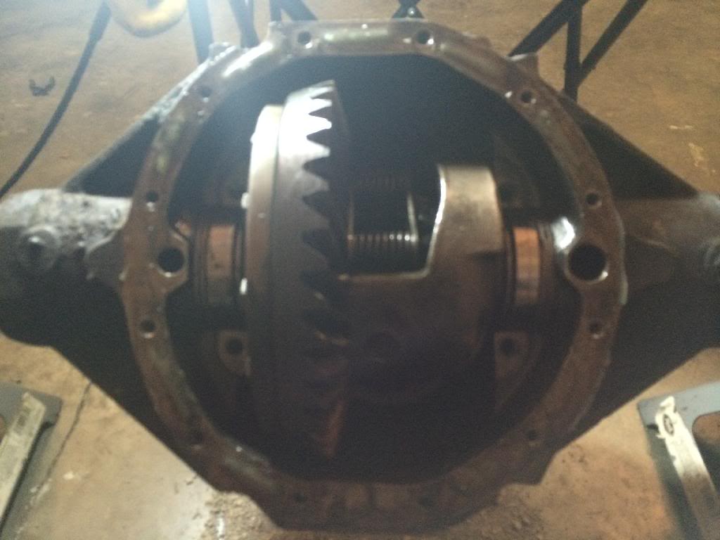

      These next two show the gear set and pattern. The copper color is anti seize compound. I forgot to buy marking compound so this is what I found worked the best for showing the contact pattern and ended up working quite well.

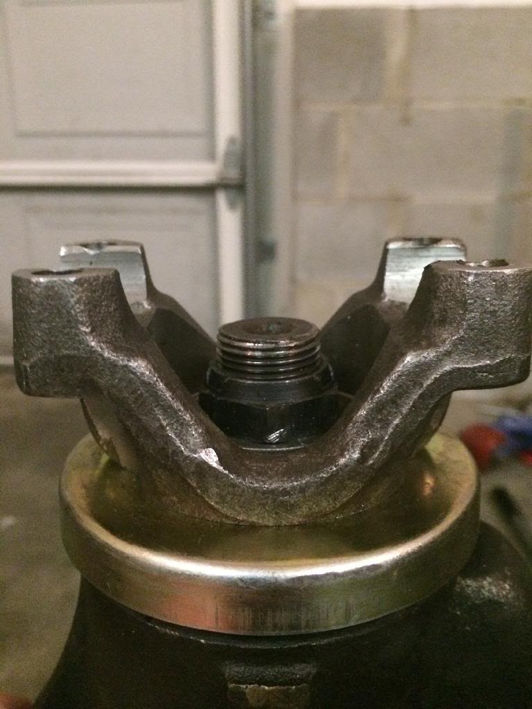

      The next one is the new Moser pinion yoke I bought hoping to solve a driveline vibration. It did thankfully eliminate that problem.

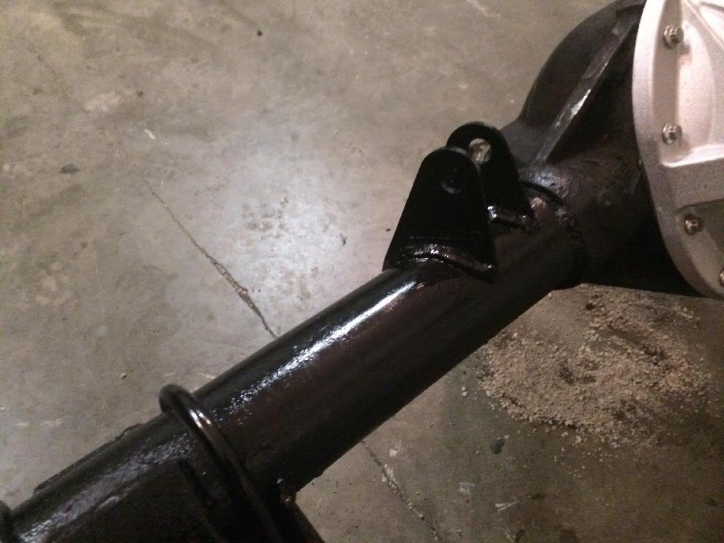

      The next three are the finished axle before I started mounting it back in the car.

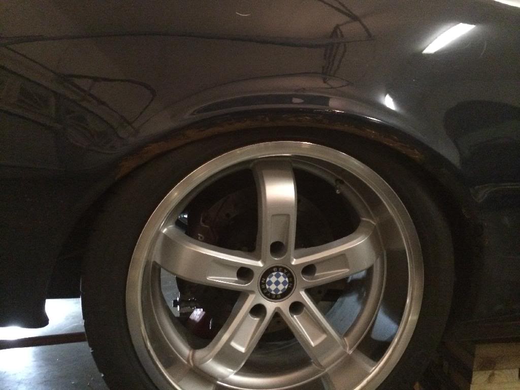

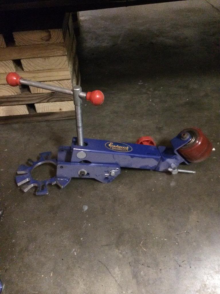

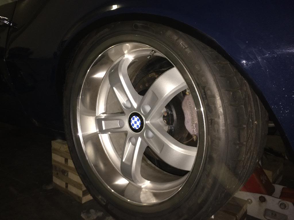

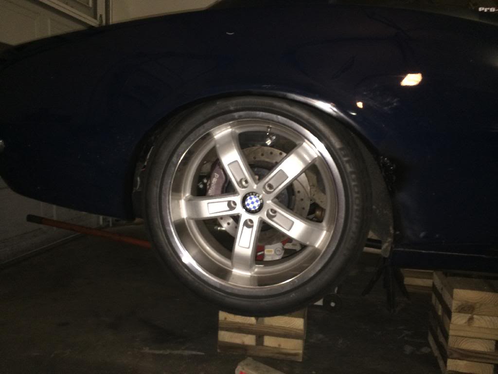

      Then I borrowed a local friend's Eastwood fender lip rolling tool. If you haven't used one, it works great. I was able to completely eliminate the tire rubbing problem I'd had previously which was preventing me from lowering the car anywhere near the quarter wheel opening without tearing up the sidewall of the tires.
      This is where I lowered the car down on the tires as far as it would go before rolling the lips so I could figure out exactly what needed to be rolled. The copper color is anti seize again. I used it to mark the quarter panel because it is easy to see and easy to wipe off.
      These last two pictures are the ride height as it's sitting right now. At this height, it does not rub at all.
      The project was a complete success. The gear noise is completely gone and the driveshaft vibration is completely gone. It's odd being able to hear road noise and wind noise inside the car now because it's never been so quiet. It's had an almost unbearable gear whine and a minor vibration the entire time I've owned the car. I had never even noticed the car had a wind noise problem before!

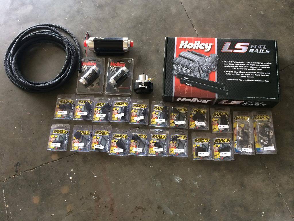

      Last but not least, here's the pre-requisite unboxed photo of all the Holley parts I chose from winning the gift certificate at the SEMA dinner:
      I chose an assortment of Earl's -6 fittings, a Holley Terminator EFI fuel system kit, and a Holley EFI LSx fuel rail kit. The only thing I have left to get is a fuel pressure gauge so I can adjust the fuel pressure so it matches the OEM Corvette fuel filter/regulator currently installed on the car.

      Nice update! welds look great!
