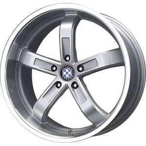

      Update time - I finally decided on wheels and tires and got them ordered today. I'm going the BMW route with Beyern's "5" wheel in 18x9.5 et15 (about 5.8" backspacing), hoping I don't have to run a small spacer but won't complain if I do. I also ordered some PCD corrective lug nuts so I wouldn't have to worry about the bolt circle difference (5x120 vs 5x120.65 or 5x4.75"). I may also have to order some hub centric rings but I won't get those on the way until I'm sure I need them.
      I have to give props to Discount Tire Direct. They called my cell to verify the order and the guy who called (RJ) was very nice and professional, double checked the order and sent me info on applying for a $100 rebate for buying a full set of wheels and tires. A nice bonus is that they're going to mount and balance them for free so I'll be able to check fitment as soon as they arrive.
      and I'm going to wrap them in BFG Sport Comp 2's 275/35-18.

      When do your Beyerns come in? Are those a cast wheel I guess? Nice looking. I like the Rapps, similar to the fives but 9.5 is not wide enough...
      Jim S.
      67 RS
      "driver "
    12. #92
      1,747
      They should be here tomorrow. Yes they are a cast wheel. I couldn't afford anything nicer right now. Hopefully Forgeline's or Rushforth's are in my future but it'll probably be a couple years at a minimum.

      Another update - I installed the front sway bar tonight. I was just slightly disappointed with ridetech's instruction sheet because it said to drill a 5/16 hole for the front frame mount but it doesn't say to tap it or anything. I guess they just assume you're supposed to know to use the nylock nuts provided though you have to be a contortionist to get the nut inside the frame. I haven't drilled that front hole yet but the bar is in otherwise. Also the wheels and tires came in today. The picture I posted doesn't do them justice. They are MUCH nicer looking than that picture. I stuck one on the right front to make sure the offset looked ok - so far so good but I am concerned about not being able to use a hub centric adapter to center the wheel. I'll know more on this when the PCD correction lug nuts arrive in about 10-12 days. I need to compare the Comp 2's to the Nitto's I have but just at a glance, the Comp 2's look wider. They fit the 9.5 width of the wheel very well. It should be a good looking setup when it's on the ground.
