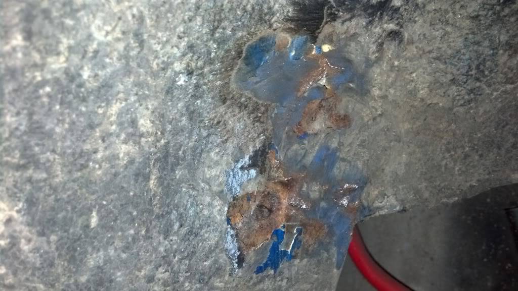

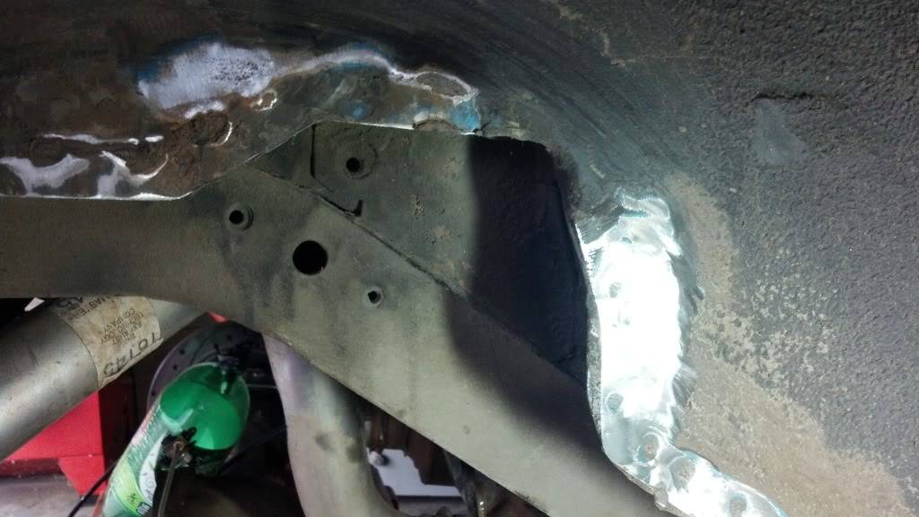

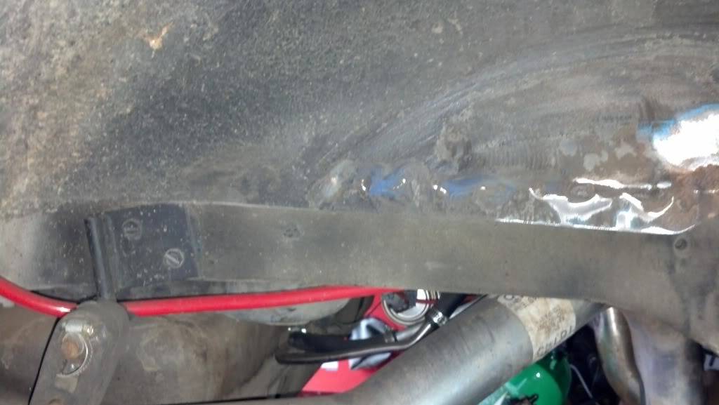

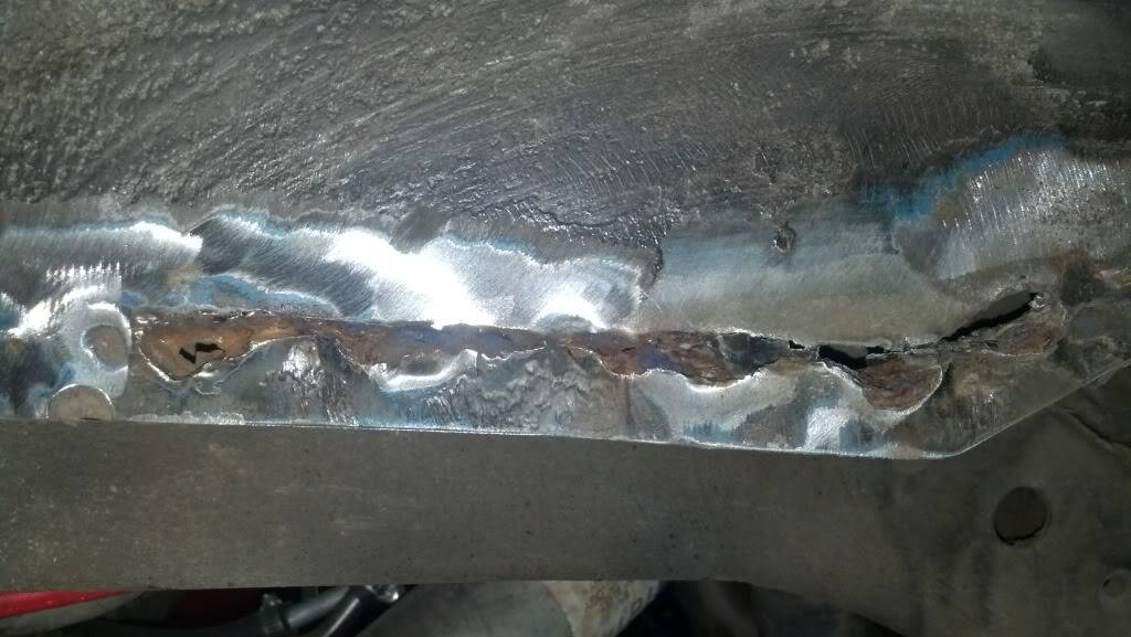

      In my case I found some additional body work I didn't know I'd need to do tonight. I might have to replace the outer wheel well sooner than I anticipated. I'm going to try to get away without so I can make it through this years event season. I don't want to start major rust repair until next year (AFTER all the new parts are paid for). Pictures follow:

      I know the second picture makes it look like the fuel line is right near the exhaust pipe but it really isn't. I'm also going to have to re-route the positive battery cable (yay). It shouldn't be that big of a deal. Thankfully most of the rust other than the last picture will be completely cut out to install the DSE mini-tubs. I knew I had some rust but didn't know it was as bad as it is. A good bit of it was covered up with blue silicone and then covered over with undercoating to hide it. (yay again) I think the rust in the last picture is in the outer portion of the tub so I'm going to have to fix that or patch it (better than silicone over rust!).

      I wouldn't replace that outer house now if you aren't willing to replace or repair that quarter as well. It's been my experience the quarter rusts right along with the outer house. I would wait till next off season before I began that surgery. Get those minitubs done and get her ready for the upcoming fun season
