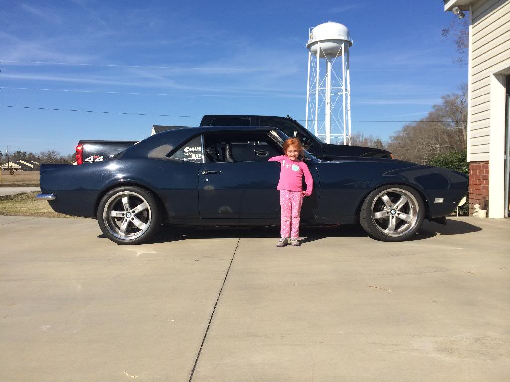

      Are you running the ridetech Truturn system, Geoff? Car is looking good and you are making some serious progress. I wanna see a wide shot of the car showing off her new stance
    2. #362
      1,747
      Yes sir - I am running the whole ridetech setup including the TruTurn. Thanks for the input! Here's the profile pic as requested:
      That's my little helper posing in the picture. She loves "Daddy's race car" I still need to clearance the front fender wells. I'll drive it to work tomorrow so I'll find out if I need to make any height changes. I found out Saturday that it rubs going into the local Amoco with the whole family in the car but there's another entrance I can use and not rub in the future.
