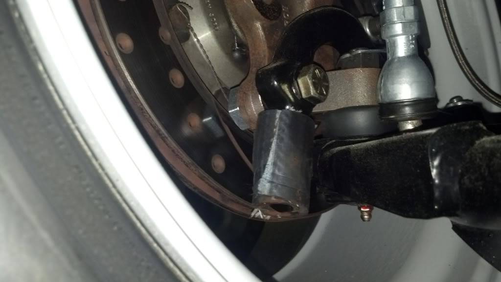

      I have a question for you guys with ridetech's setup - why isn't the adjustable bump stop on the front side of the a-arm??? I had to use some 3/4" heater hose to make some bump stops to keep the tires/wheels from hitting the front sway bar. Thankfully I caught it before it did more than rub some paint off the sway bar bracket.

      Love the thread Geoff. Im very intrested to see some pictures of this------> I have a question for you guys with ridetech's setup - why isn't the adjustable bump stop on the front side of the a-arm??? I had to use some 3/4" heater hose to make some bump stops to keep the tires/wheels from hitting the front sway bar. Thankfully I caught it before it did more than rub some paint off the sway bar bracket.
      The A arm are you referring to the control arms? Upper or lower? I know with my set up I had to drill and tap the lower control arms to stop the wheels from turning into the muscle bar. I have stock lower control arms atm but have the ridetechs waiting. When I get the ridetechs on they are tubular so drilling and taping may not work. Im curious so see what your talking about and your set-up.

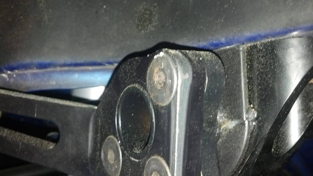

      I just checked to see if there were any pictures of the 48 Hour Camaro's suspension that shows the bump stop. The only thing I noticed in their pics is that they didn't use the threaded hole for the bump stop on their arms. I suspect their 18x10 wheels are nearly the exact same offset as my 18x9.5's and the difference is in the hub/rotor combination. My brake setup uses a rotor that bolts to the back side of the hub (Wilwood 12.19) vs. Baer's hat over hub design. The hat over hub adds anywhere from about a 1/4" to 3/8" if I remember correctly. This difference is probably why they did not have to use anything to limit steering travel more than the TruTurn already does with the built in limits. I'll try to get some pictures in a few minutes - definitely not working sick with it so cool and wet outside!

    20. #240
      1,747
      Here're the pictures as promised. Pay no attention to the little specs everywhere...that's just pine tree pollen. We're having the worst pollen season ever this year...everything's covered in green powder.
