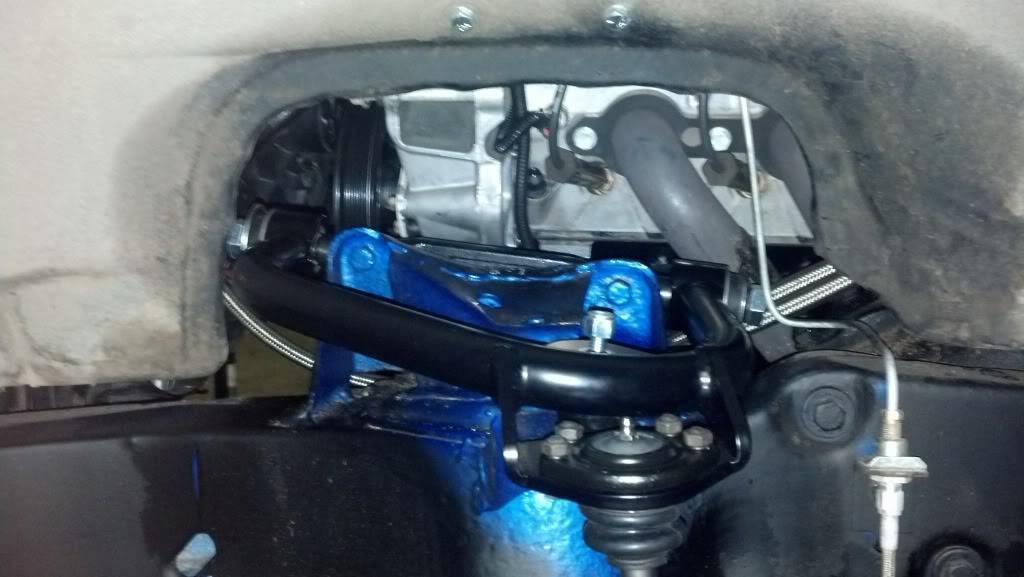

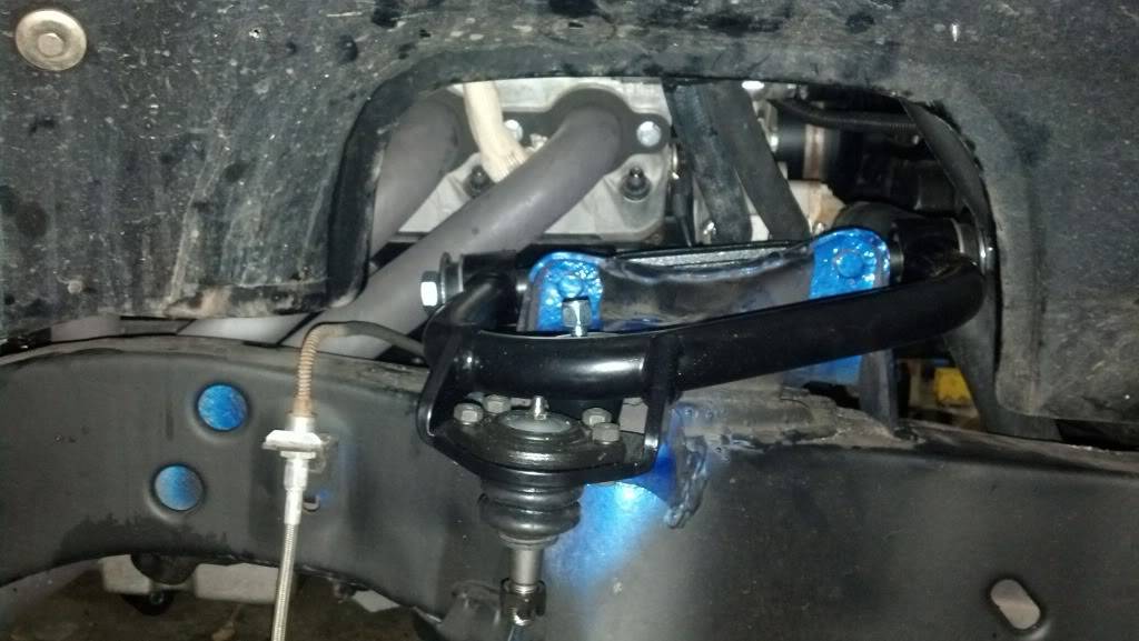

      Time for an update. I finally had some time to work on the car tonight. I got the passenger a-arm on finally. I had to pull the header and wrestle the old arm off and the wrestle the new one on...it was a pain but it's done. Here's a couple pics:
      Seeing the pictures I should've painted the frame but I can always tape the arms off to shoot some paint up in there. It doesn't have to be perfect cause it's where no one will ever see anyway other than these pics.

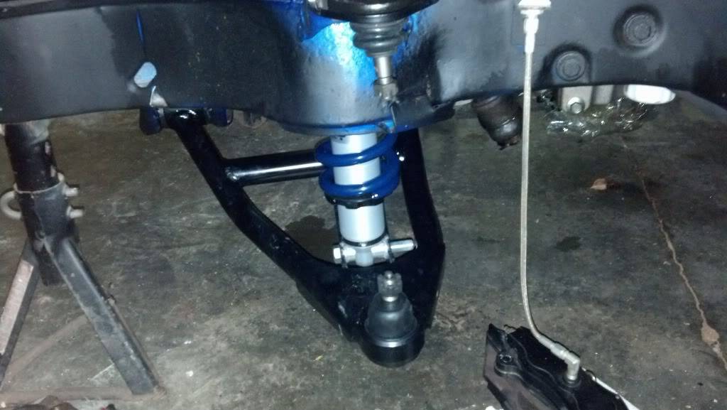

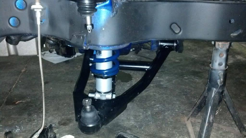

      More progress today - not as much as I'd like but I'm fighting an oil leak on my truck that's driving me crazy. I think I've just about decided to go ahead and put in the lower mile 6.0 I bought several months ago. Anyway on to the pics! Lower control arms installed along with the coil overs.
      I had TONS of fun fitting the aluminum bushings into the lower a-arms. I think they're sized for an arm prior to powder coating. I knocked a few thousandths off with some 320 grit paper and they slid right in. I would've gotten the whole front suspension installed on both sides but had a honey do to go take care of. Plus I made a deal with a friend to borrow the wheels and tires off of his S-10 Extreme (no motor or trans - might buy the whole truck for a future daily driver project) so I'll be able to drive the car once the suspension is done until I can afford to buy the new wheels and tires.

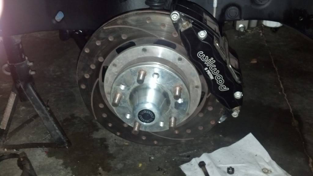

      I finally made some progress on the install tonight. The driver's side is almost complete. The a-arms are fully bolted in and tightened down. The spindle is mounted and the ball joints are tight as well. I got the whole steering linkage for the TruTurn pre-assembled and the castle nuts tight and cotter pinned. Installed a new pitman arm and painted the idler since it came unpainted. I figured it was time to call it a night since I had to wait on the paint to dry anyway. Hopefully more to follow Thursday night!

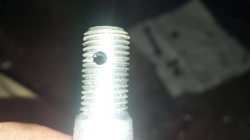

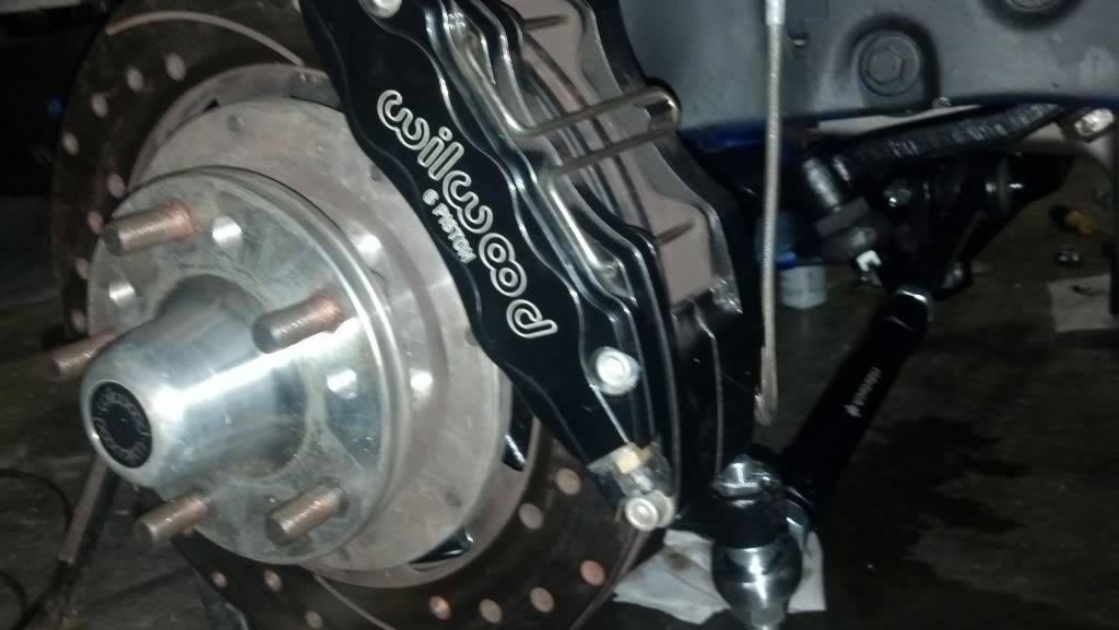

      More progress tonight - not a lot but it's a milestone so it's worth posting. The driver's side front suspension is all together, tightened and ready to go.
      Unfortunately no progress seems to be made without some kind of problem big or small - the cotter pin hole in one of the TruTurn steering arm Heim joint adapters was drilled off center. I'm gonna call ridetech tomorrow to see if they recommend trying to redrill it or if it'll be better for them to send me another one.
