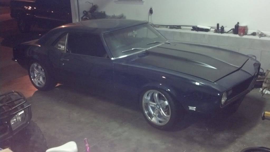

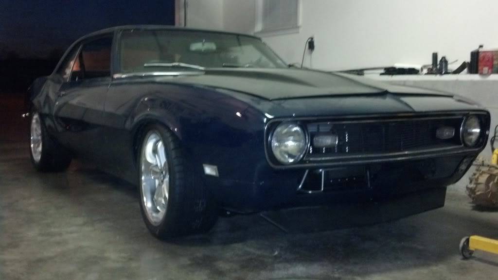

      How about a couple "Money" shots???
      It's actually a little lower than it needs to be. It looks awesome but the front tires are sitting on the fender wells and the rears have no room for travel. I need to raise both about an inch or maybe two for clearance. It would sit on down if I had those high clearance wheel wells like Anvil makes but I just can't afford them.
      It's not done. I still need to finish bleeding the brakes, get a couple muffler hangers since the cradle is in the way of reusing the Flowmaster kit hangers and then set the toe in so I can get it to the alignment shop along with getting the ride height right.

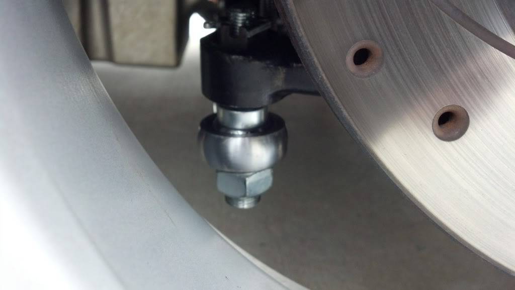

      It will be a shame if you have to raise it too much. It looks awesome slammed like that. The rear is usually an inch higher than the front anyway and it is easy to change. The front is a bit trickier and more complex. Are you using drop spindles or springs?

      I think with that Truturn up front you could have tucked more tire under the car and maybe gotten away with a lower stance.

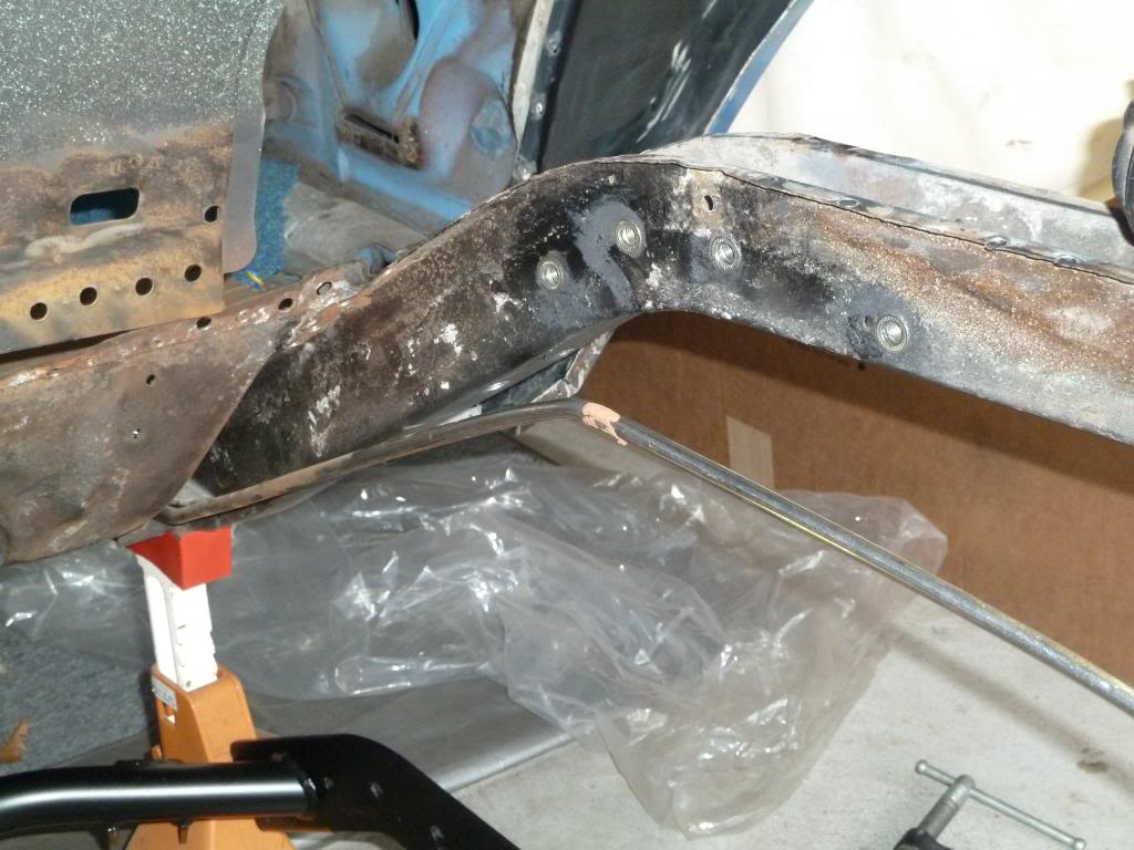

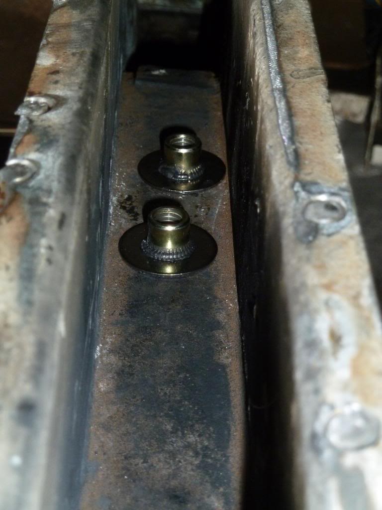

      I dont want to hyjack your thread Geoff but here are a couple of pics of the frame attachment method I used...I figured not welding them in left more options in the future.

      Thanks for posting the pictures of the nut serts. I don't plan to take mine that far down for several years or until rust progress necessitates it.

      Not sure if its just me but the front tires in the second pic look huge! I like it

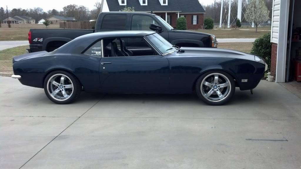

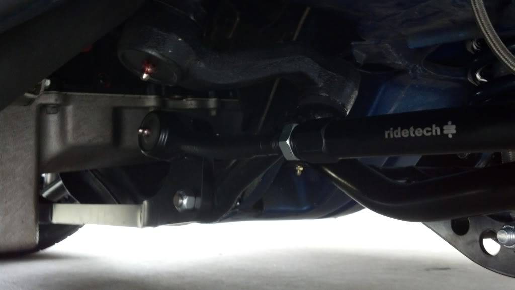

      I just got back from DRIVING IT FOR THE FIRST TIME!!! I had the shocks set all the way firm and it feels surprisingly like the Hotchkis setup like that. I played with the spring pre-loads some but am having a little trouble getting it to raise up. It's definitely rubbing in a few spots but nothing serious. I just need to lift it up a little. Here are a few pictures from today:
      EDIT - I wanted to mention with the TruTurn that I think it's probably necessary to use 18" wheels in order to get the width. The picture above shows where the tie rod end is actually inside the diameter of the wheel.

      Quote Originally Posted by GeoffP View Post

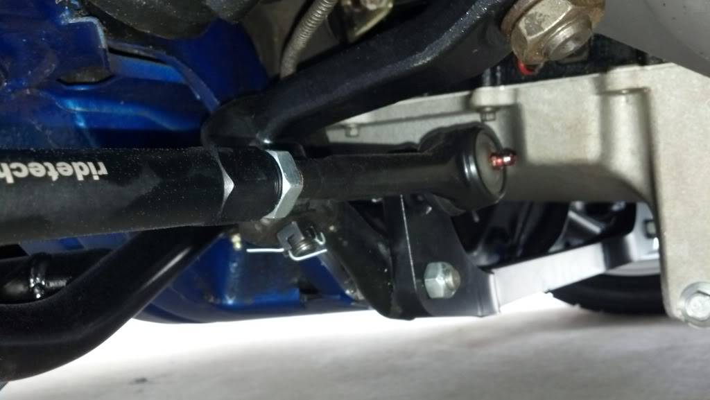

      Does that inner tie rod look bent in this picture or is it me?
      Jim S.

      Does that inner tie rod look bent in this picture or is it me?[/QUOTE]
      That is how it comes in the kit. I think that was something talked about in anoter thread

      Quote Originally Posted by brownz View Post
      So the passenger side has a bend in it?

      Yes, the tie rod is intentionally bent to clear the idler arm at full lock. I raised it up a little more but I'm having a hard time getting it level side to side. I don't have much of an impression yet other than the sweeping turn coming out of my neighborhood and then a couple miles down the highway and back. It's definitely smoother riding than the Hotchkis setup I had before. It seems to be more "grippy" but I'll know more after I get it properly aligned. It's a little darty but I'm sure that's because the toe is a little off. I'm going to try to get it to the shop one day this next week after I get the ride height finalized.
