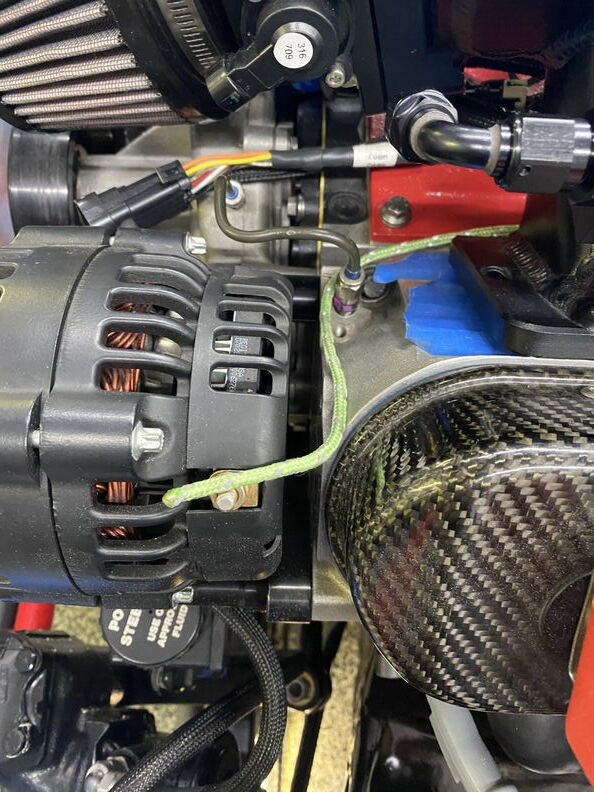

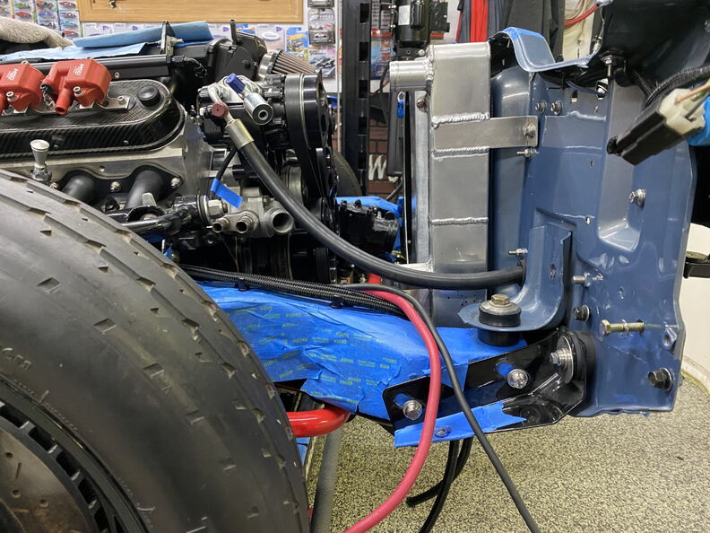

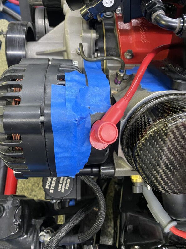

      Today's project is making a new wire to the Alternator (01-16-21)
      Well, It's time for another update and I am getting closer to catching up this thread to where I am today.

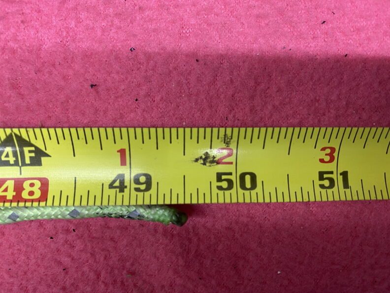

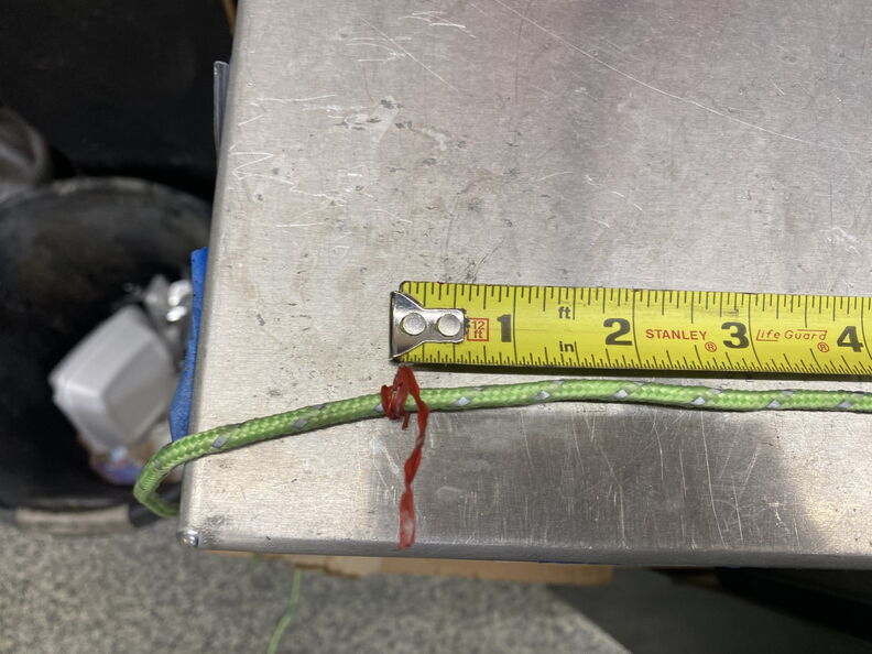

      Today's project is making a new wire to the Alternator.

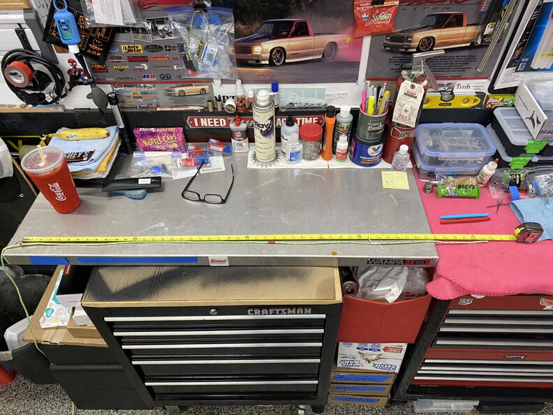

      I love the string method as you can lay out and get an almost exact length you will need when you cut your wire.

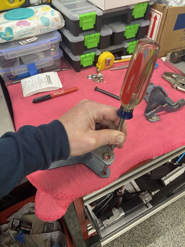

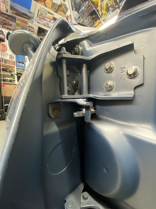

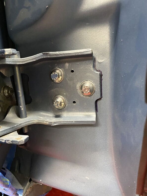

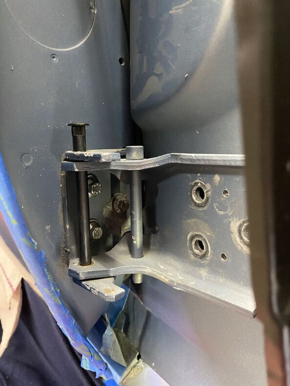

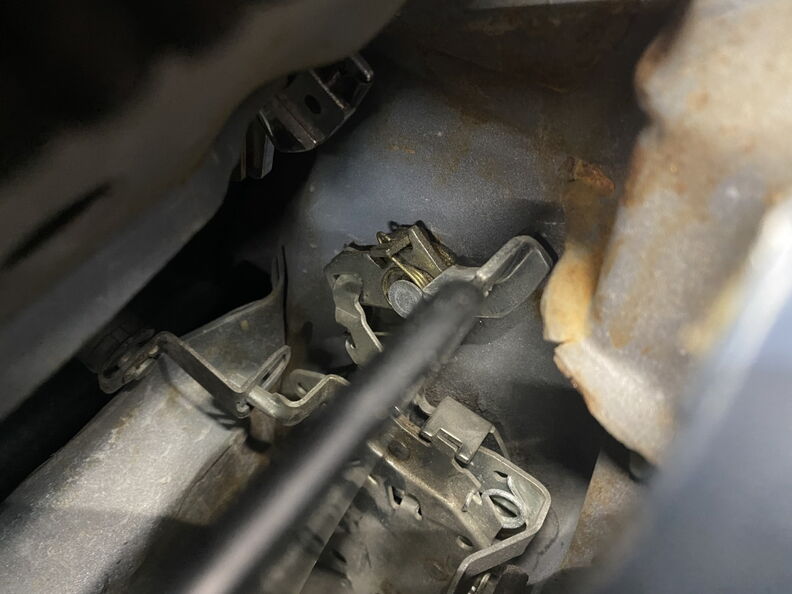

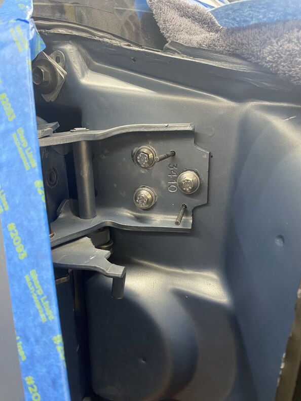

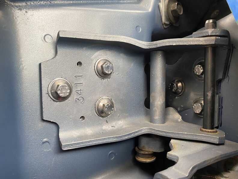

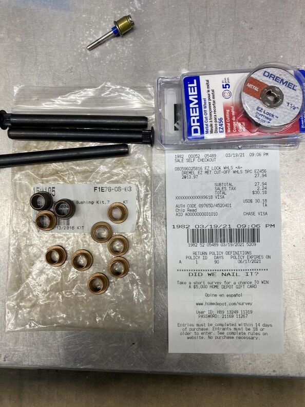

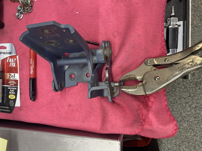

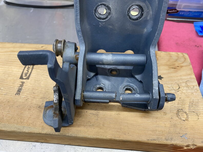

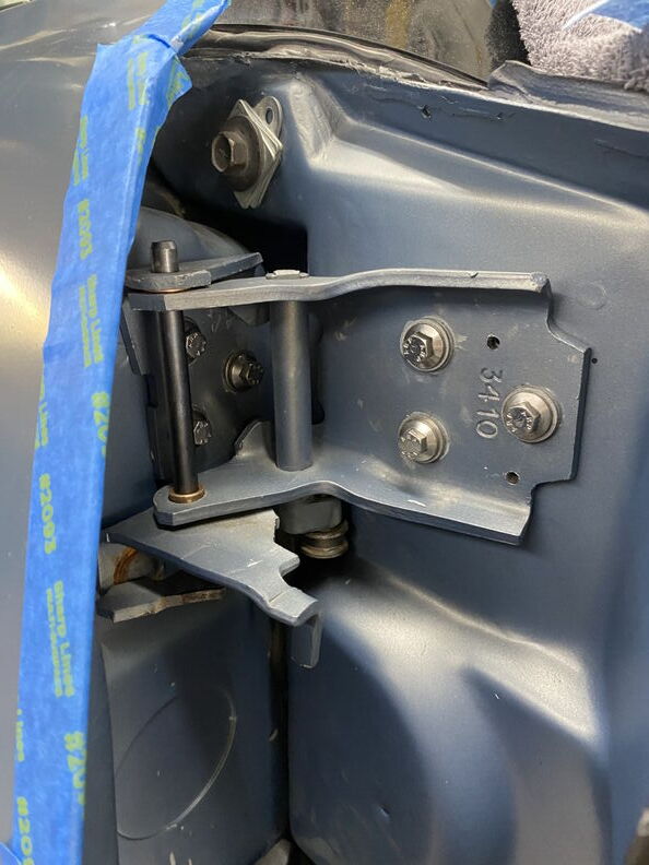

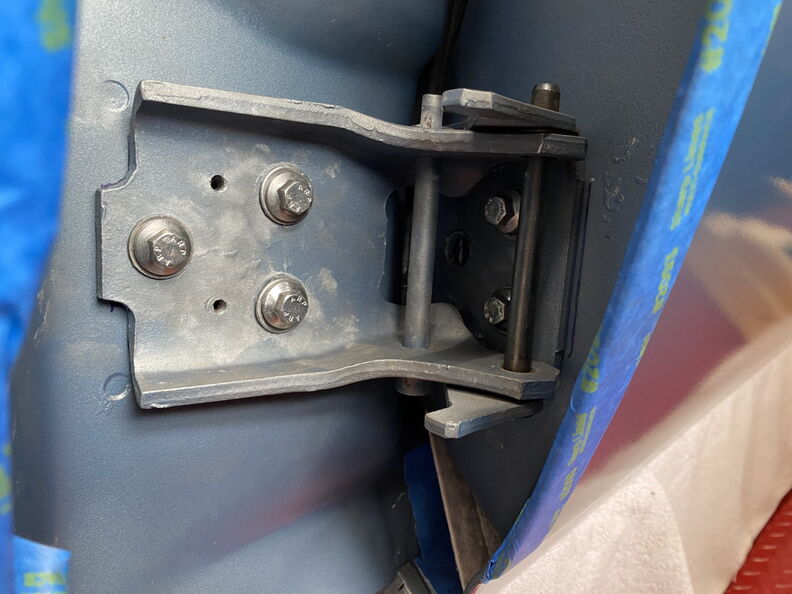

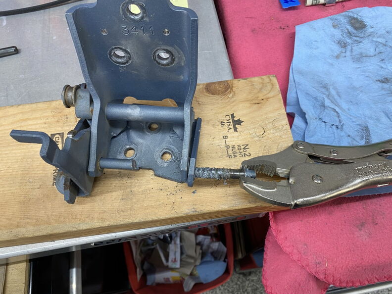

      So this is one of those "sure why not now" irritating moments. Yep, the rod fell off the door handle again. Ugh !!!
      This will make me feel better.

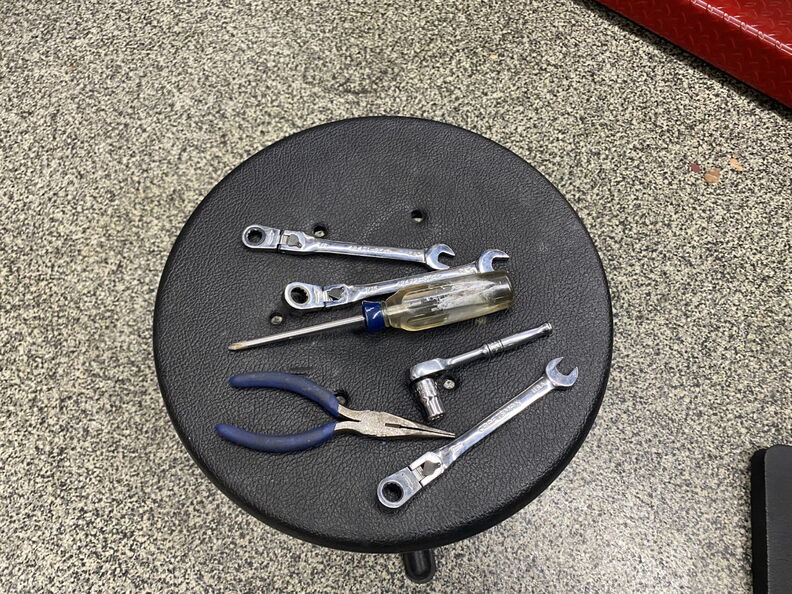

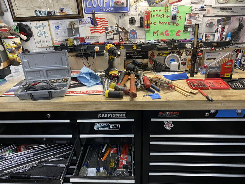

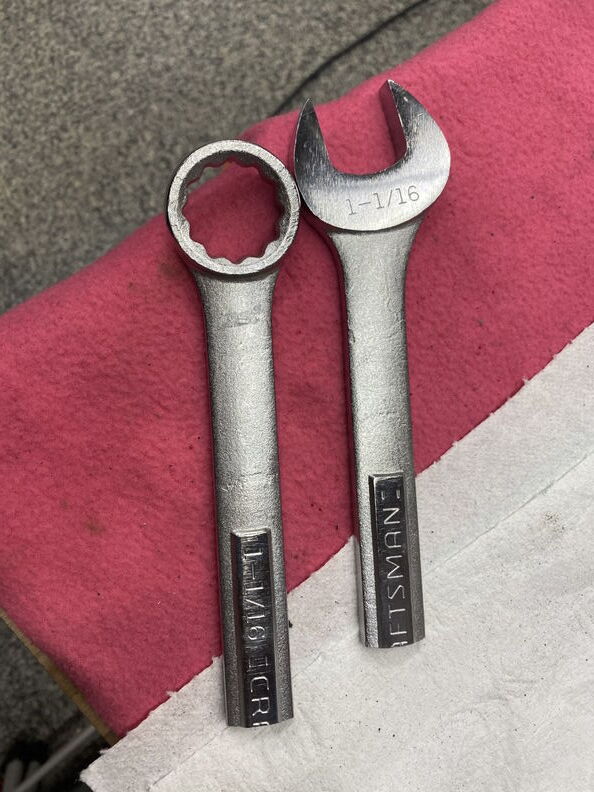

      How could I have used all of these tools ??

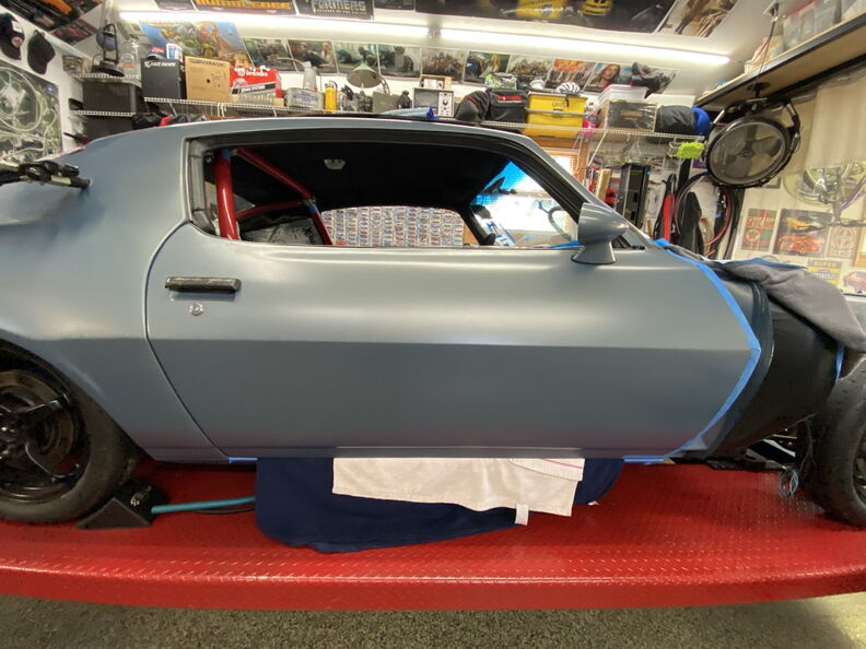

      All better now and door handle is back on.

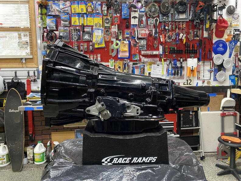

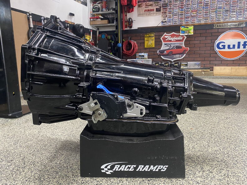

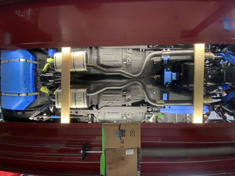

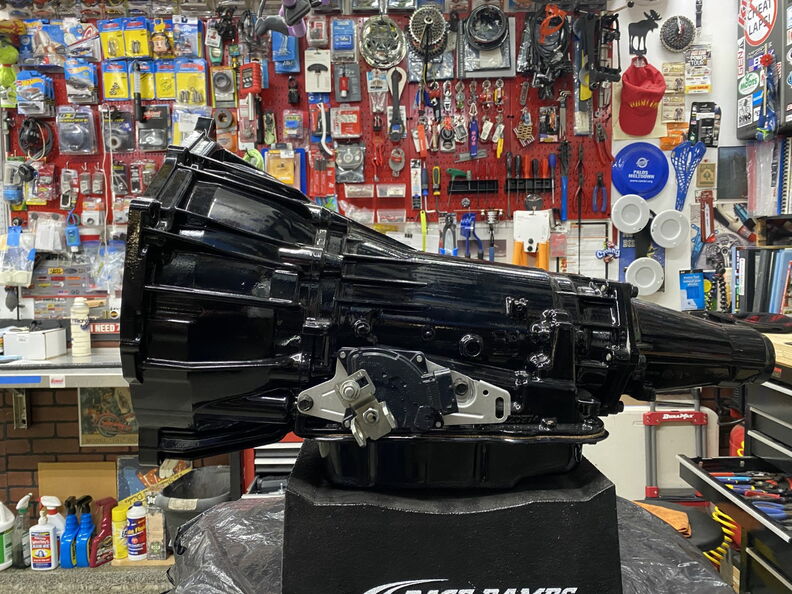

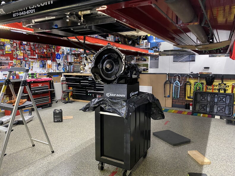

      Atomic 4L60e Transmission Final Install (02-28-21)
      Hopefully this will be the last time the Atomic Transmission gets installed.
      I used the lift on the jack to support the engine.

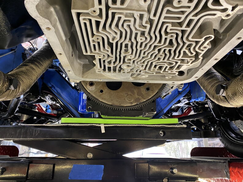

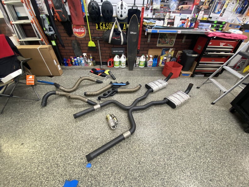

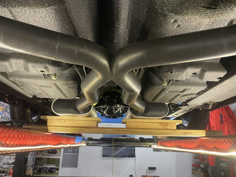

      Originally I was going to try to install the transmission with the headers and exhaust installed. However I quickly decided that the 30 minutes it takes me t remove the entire exhaust system would be the way to go.
      This is the only nut that is a pain in the ass to get to. Thankfully the motor has header studs.

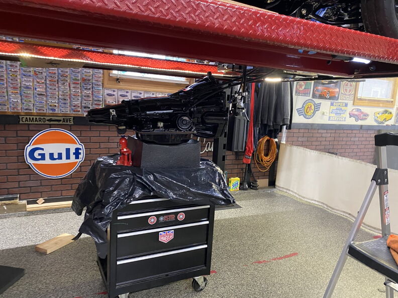

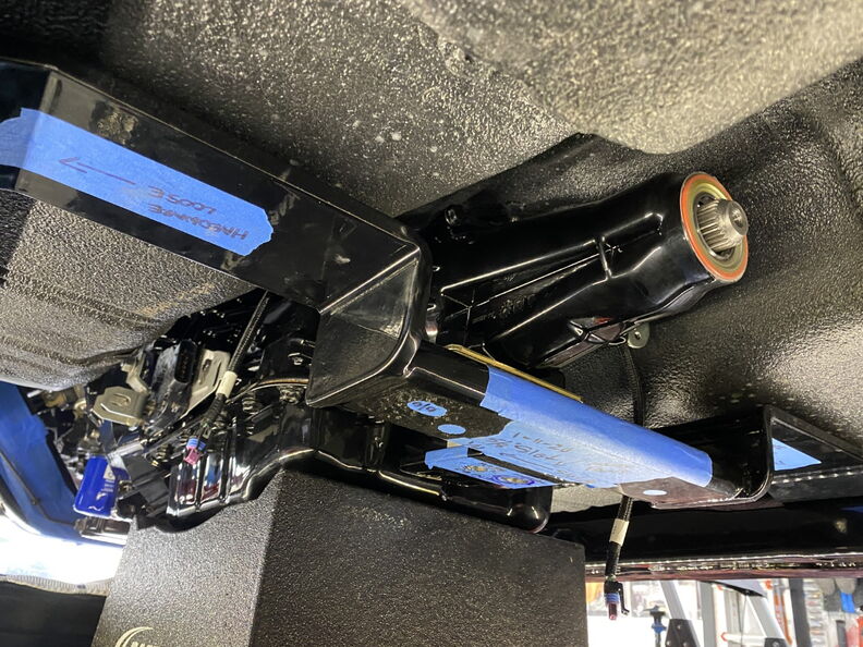

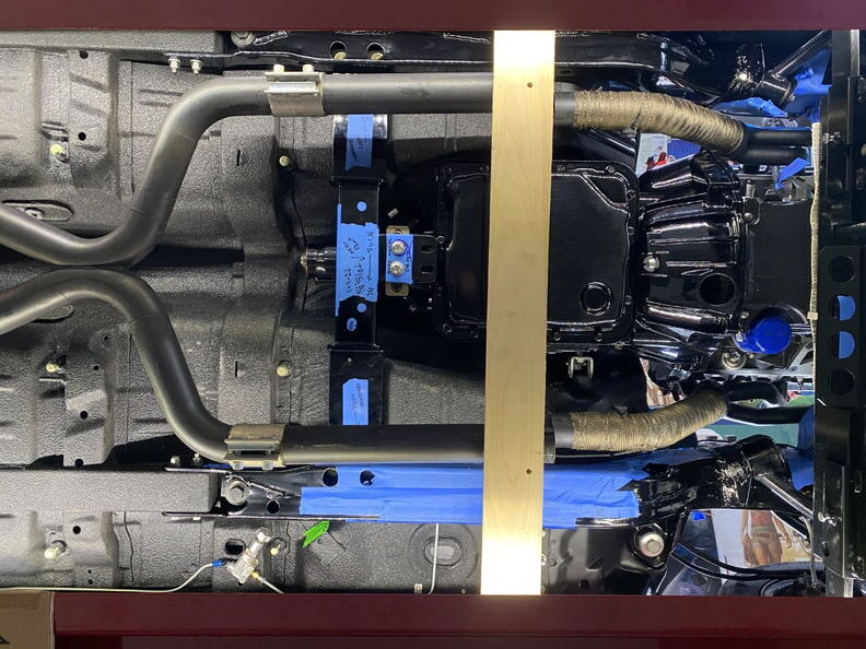

      Yes this is the exact height I need to get the trans in the car while it is on the lift.

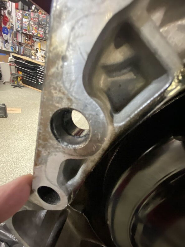

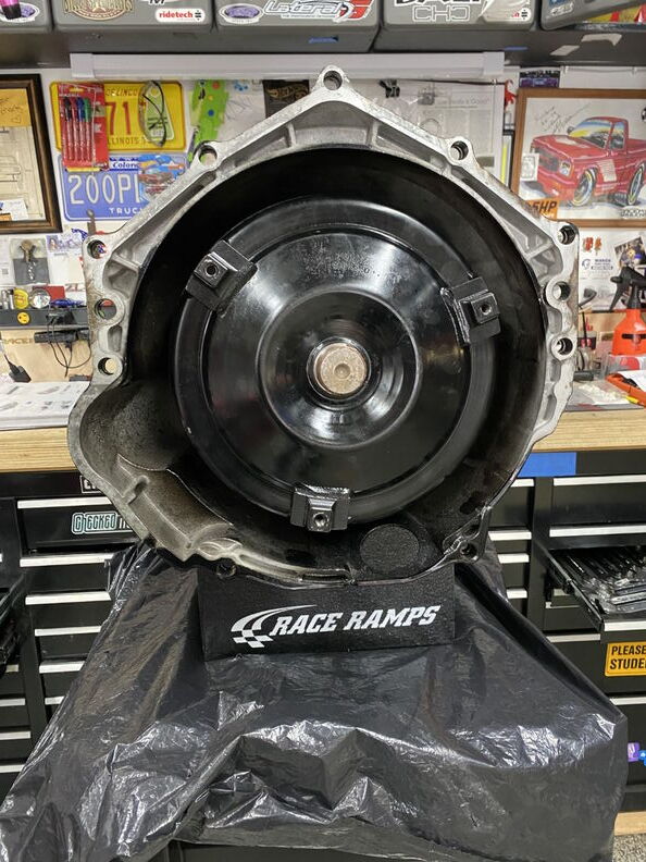

      So the first attempt didn't go as planned. Apparently I forgot to remove the powder coating that was in the alignment hole.
      Here we go again. (( Twice as it seems the torque converter moved out the 3rd time ))
      It's hard to see the soft lines I ran for the transmission.

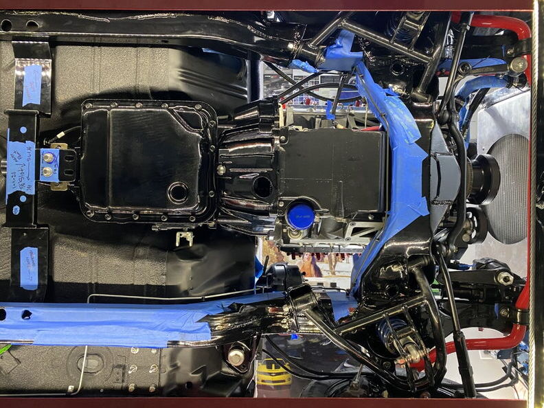

      Yet to do is replace the trans pan and pan hardware.
      Calling it a night.
      marty-mj

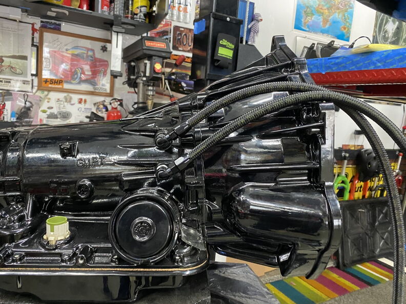

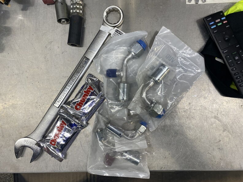

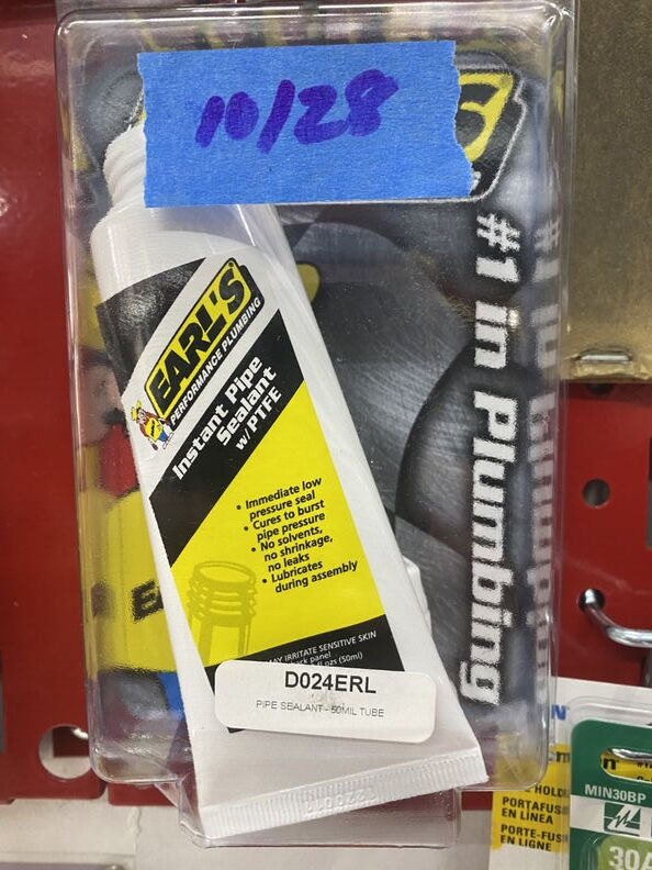

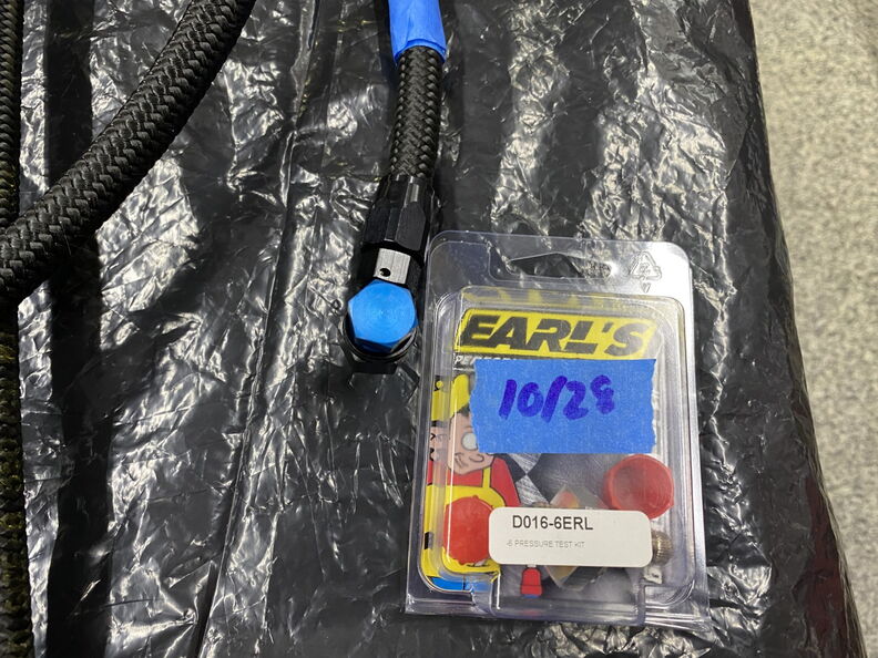

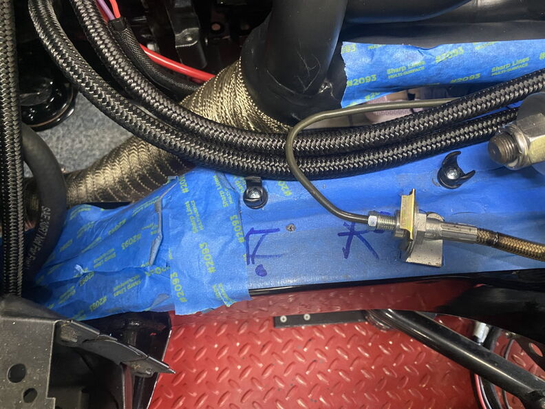

      Testing the Lines (( 02-28-21 ))

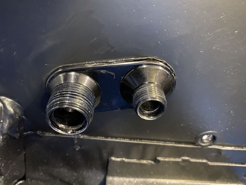

      Before the Transmission lines went in I tested to make sure the lines didn't leak.
      No Leaks

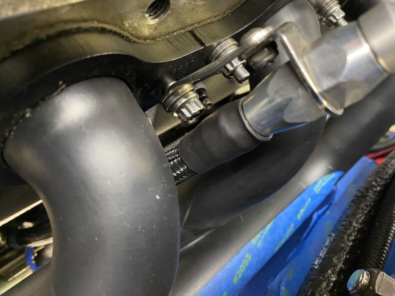

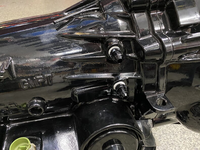

      I installed the Earls fitting in the transmission and then connected the lines.
      I also installed the knotchead -6 line clamps for the final time.

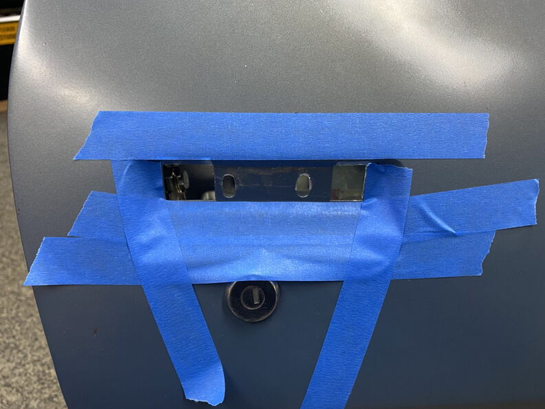

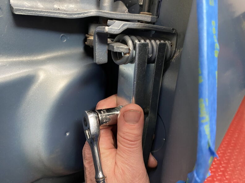

      Marty, are you missing a plastic clip that holds the rod on the door handle?
    5. #725
      Chicago
      2,788
      Quote Originally Posted by NOT A TA View Post
      Nope it's there but the dang thing keeps falling off and yes I am going to order a new one before I put the door panels on for the last time.
      Honestly I think it's the third time it has fallen off for me and Kenny had the same issue.
      marty-mj

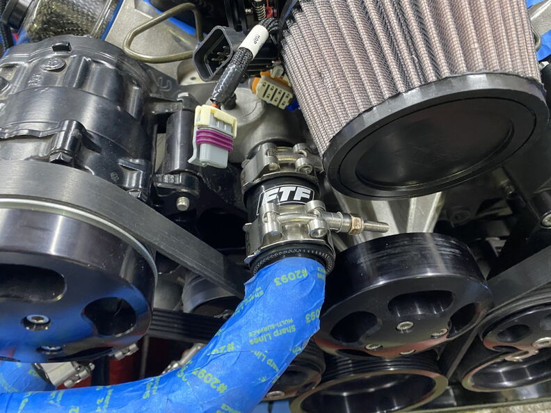

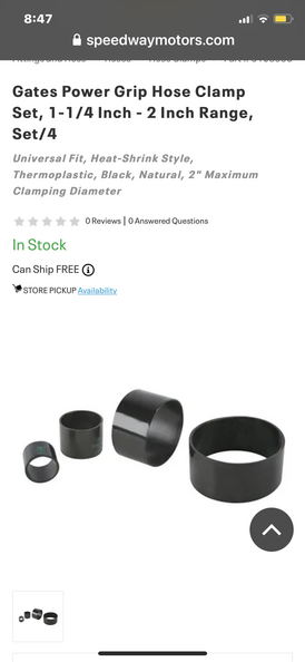

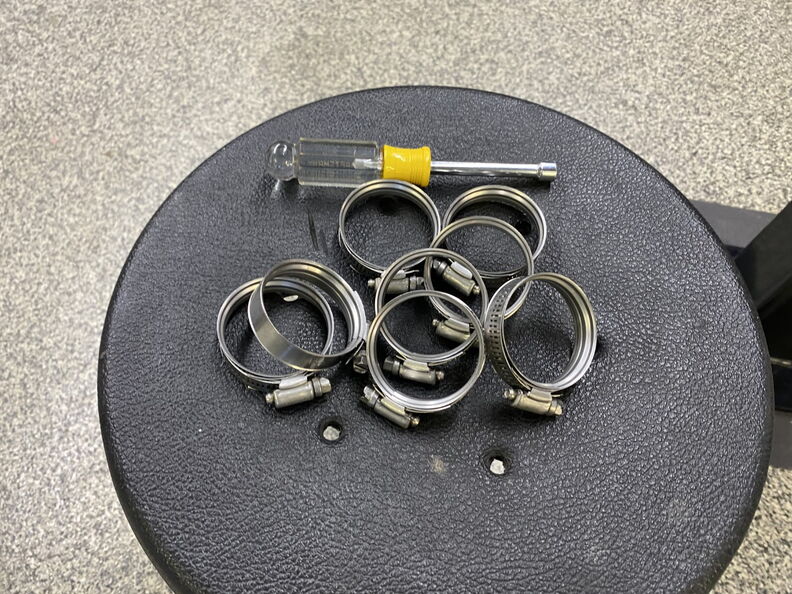

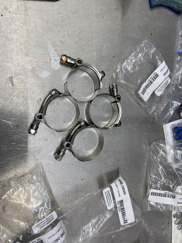

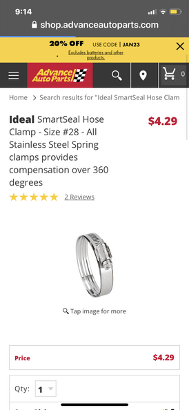

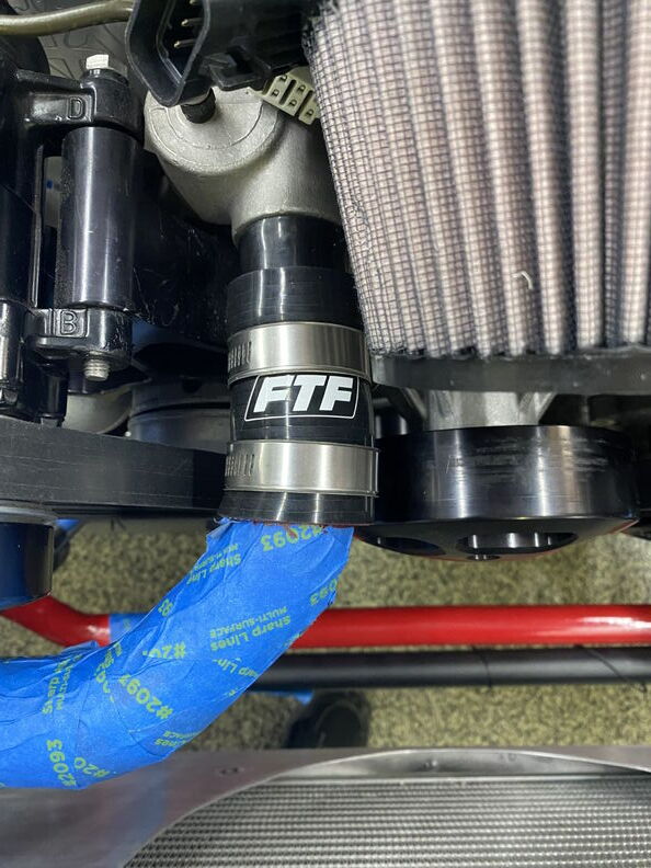

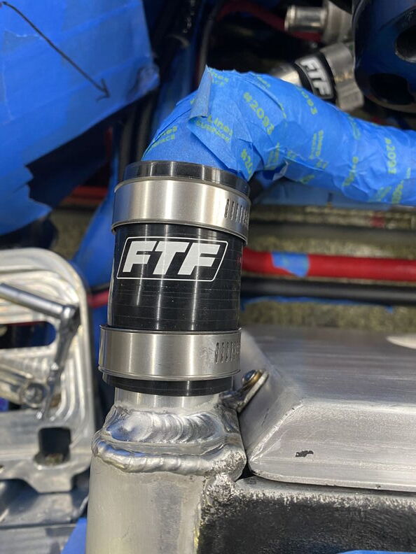

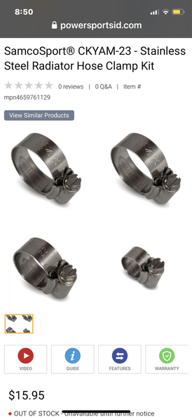

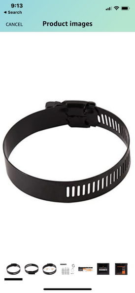

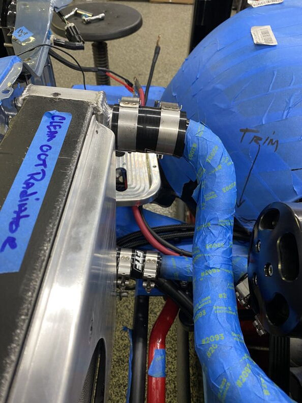

      All about Hose Clamps

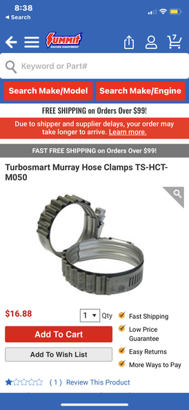

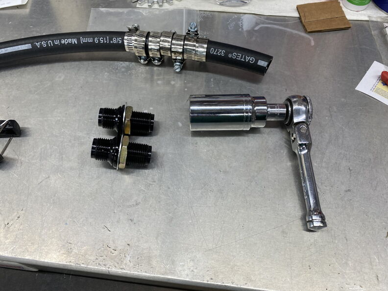

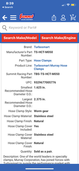

      So, I have had a few questions about the hose clamps that I had mocked up on the car. I figure I would share all of the different options that I found and if you have anything that you want to share please feel free to share it.

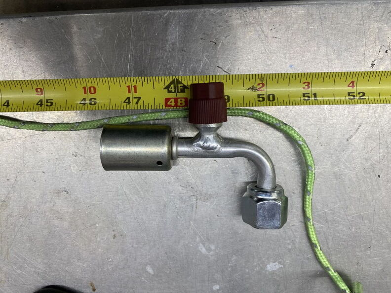

      Transmission Soft Lines (( 02-28-21 ))

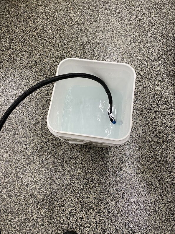

      Good News - No Leaks

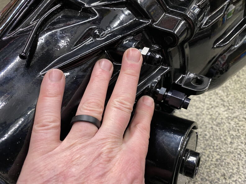

      Checked fitment of the fittings in the Transmission

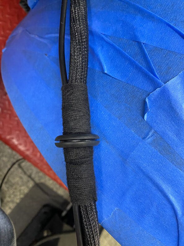

      I Attached the lines before I installed the transmission as it would be nearly impossible to tighten them when the transmission is installed.
      As the car was being lowered I passed the line up and into the engine bay so they would be out of the way.
      I also installed the knotchead line clamps for the final time.

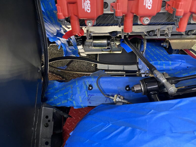

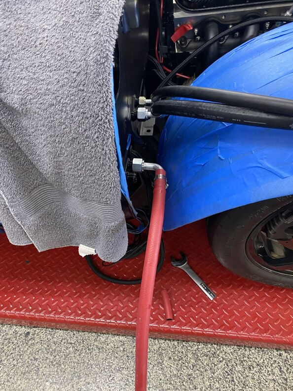

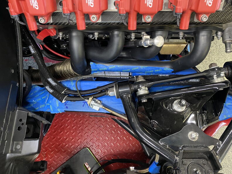

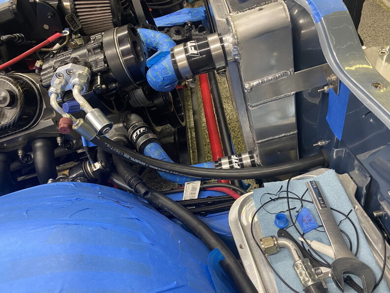

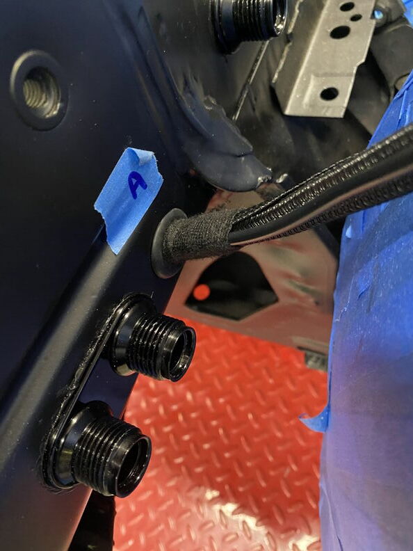

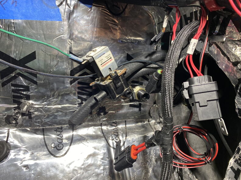

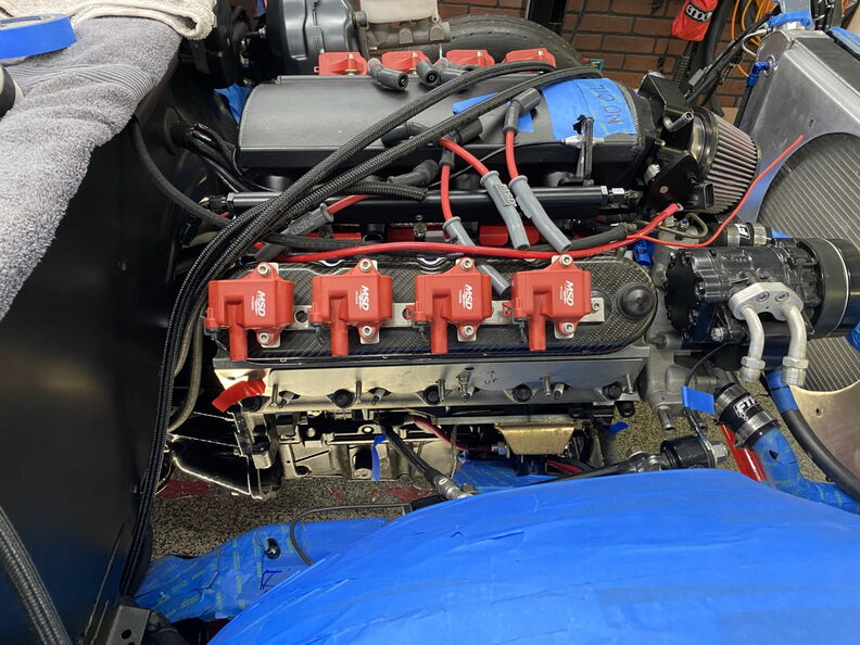

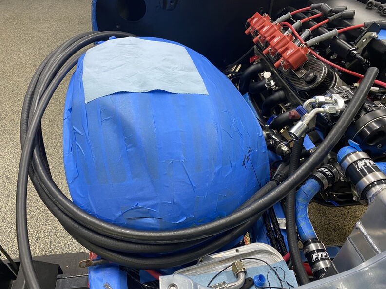

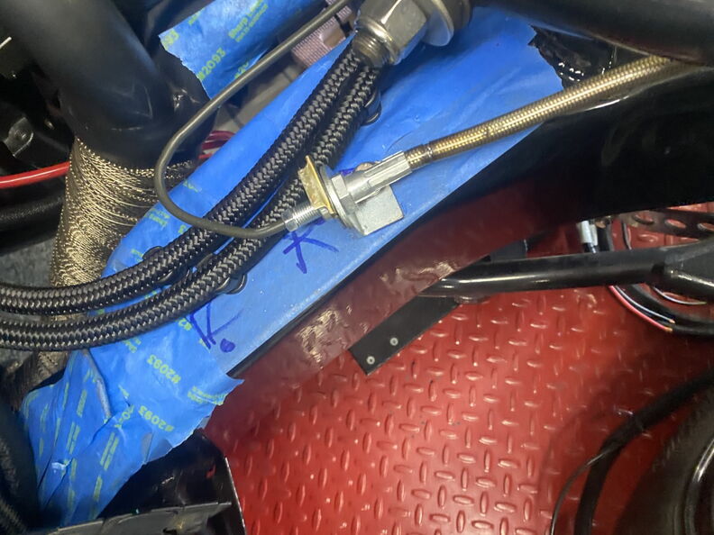

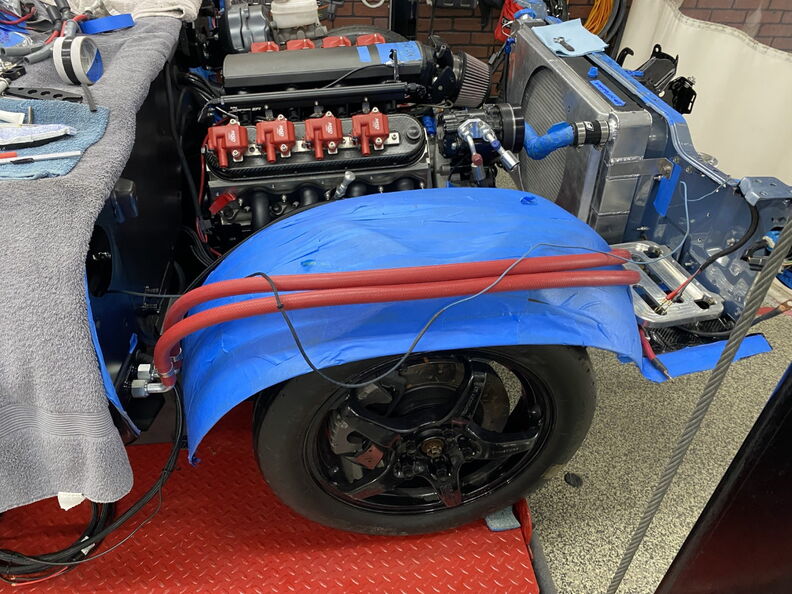

      Tranny Lines & Coolant Lines (( 03-07-21 ))
      Lines are run and eventually I will connect them to the Hard Lines Kenny ran.

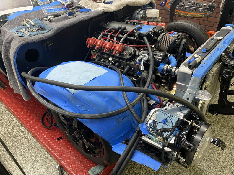

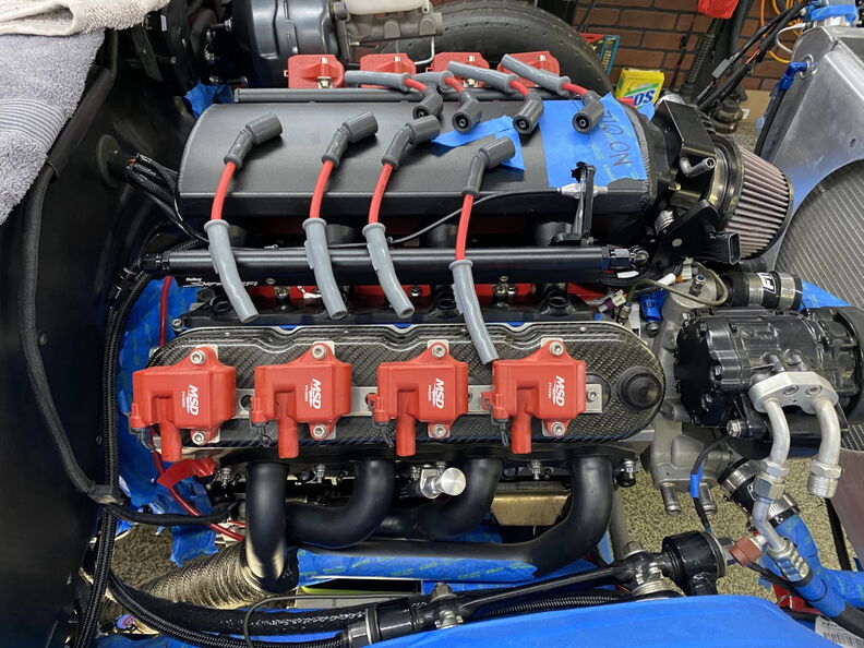

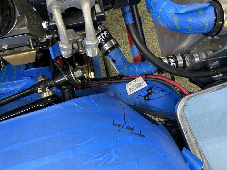

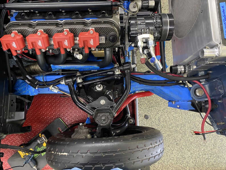

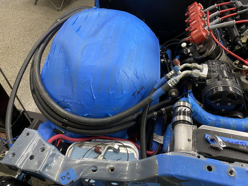

      I also started mocking up the AC & Coolant lines
      Instead of running them under the battery tray my plan is to neatly lay them on the Anvil Carbon Inner Fenders.

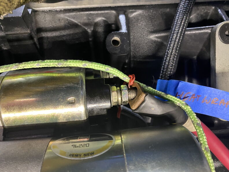

      Yes the Green String came out again.

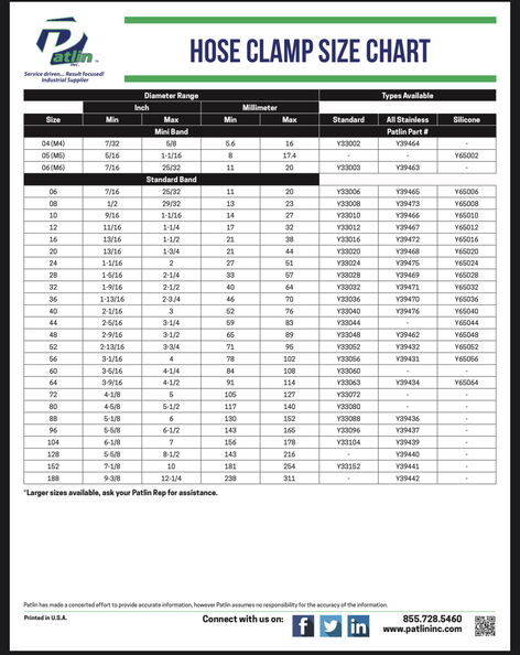

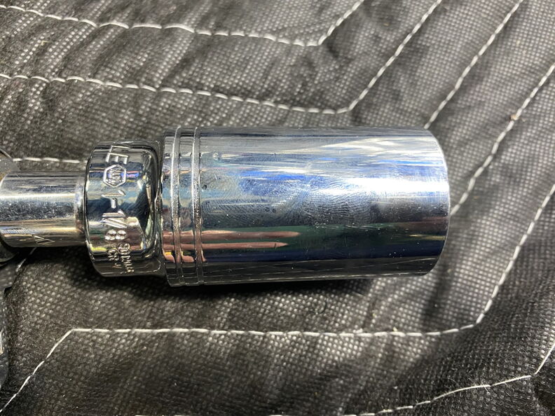

      So I needed a 1 1/16" wrench and I didn't have one so off to Ace Hardware
      Man I love Ace Hardware
      It's cutting time.

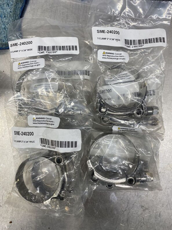

      Finding the correct fitting was fun and only two trips to Midwest Hot Rods.
      Time to make the new Lines

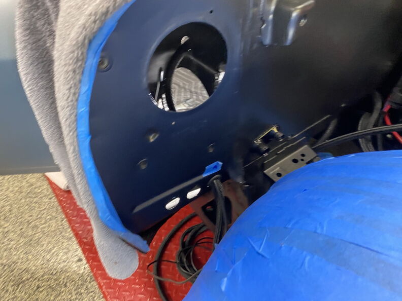

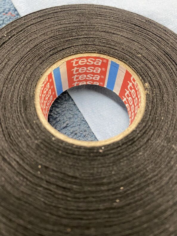

      At some point I know I will be nearing the end of all of this wiring fun. But for now it's been an awesome
      learning experience and the help along the way has been awesome.
      I wanted a way to tighten up the loom/grommet area to reduce the chances of water getting in. An wiring
      guru friend taught me this trick. It double as a way to seal up the hole and keep the harness from moving.
      Start your wrap on one side of the grommet and the make a couple passes on the area you want the grommet
      to sit and them side the grommet over the area. Once you install the grommet start taping the opposing
      side and it will secure the grommet in place and reduce your chances of a leak.

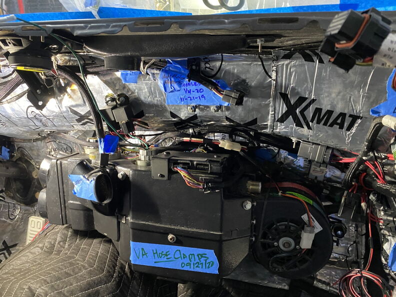

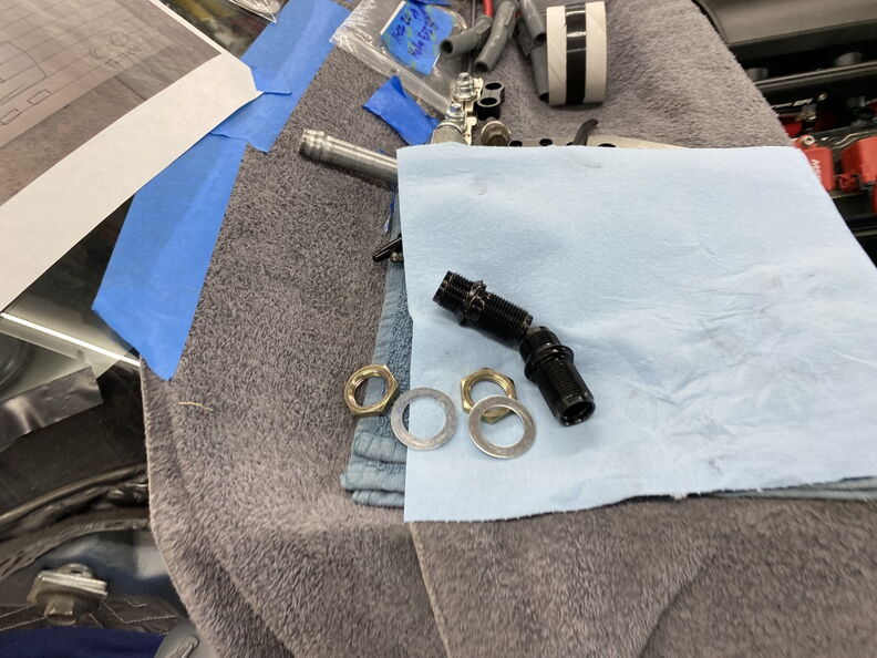

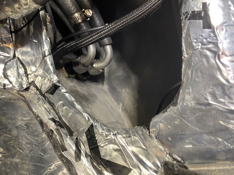

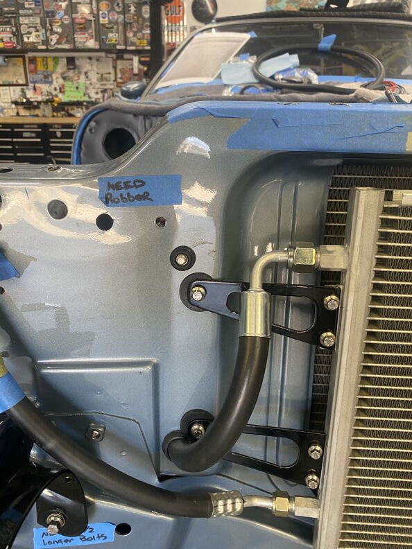

      Next up is the Vintage Air AC Lines and coolant hoses.
      I put a little silicone on the back of the fitting bracket to hold the trim plate in place and also seal up any gap that may allow water to sneak in.

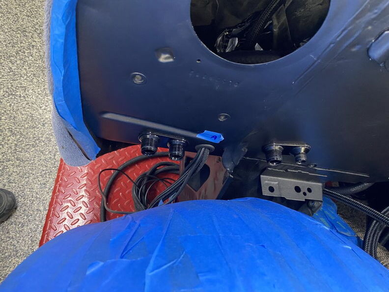

      Somewhere way back in this thread is the part number for the Machines Washers from Ace Hardware and also the part number for similar washers from McMaster Carr.
      Sorry the picture quality sucks.
      The fun part was me sticking my arm through the hole to get the nuts started. Once they were snug I was
      able to go inside the car and tighten them with a socket. I also used a smaller ratchet so I wouldn't over tighten the nuts.

      Installed Vintage air box one more time. Don't worry it will be coming back out again.
      I also wanted to make sure I would be able to get to the nuts on the hose clamps if I ever need to service
      them. So I adjusted the line clamp so the nuts would be clearly visible if I removed the kick panels.

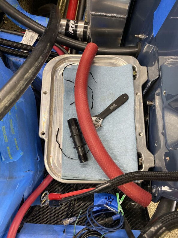

      Vintage Air Coolant Lines (( 03-14-21 ))
      Finally finishing up the Vintage Air heat lines.
      Yes something is really really wrong with me
      For mock up I am using this plastic reducer.
      I can't wait till I don't have to touch this valve again.
      marty-mj

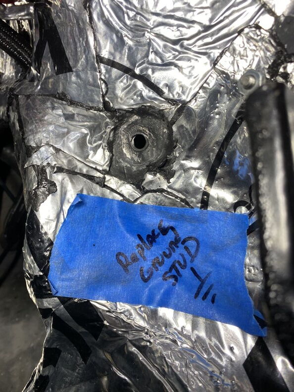

      Vintage Air Firewall Fitting (03-13-21)
      I missed this one so I am going back to it.
      Here is the ground stud that I will be using on the passenger side of the car. It goes directly to the battery and it will be also be a brass bolt.
      Firewall fitting test fitted it one last time before I permatex it to the firewall.
      Way back somewhere in this thread I put the part number for the machine washers that I am using on the inside of the firewall.
      All glued in and nice and tight.

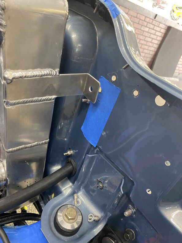

      Upper Radiator Mounting Hardware (03-15-21 )
      I Headed back to Ace Hardware for the tenth time this week.
      03-21-21
      Time to get out the big drill as I am way to lazy to run back to Ace and get the correct drill bit.

    16. #736
      Chicago
      2,788

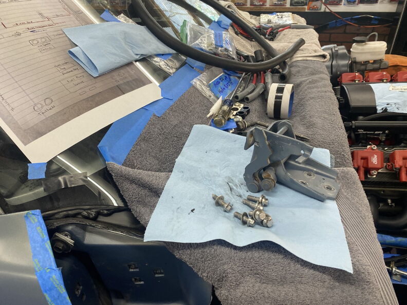

      Passenger Door Hinge Bushings, Yes I hate my life. (03-19-21)
      This is those while I am here moments.
      If you know what these are you now how much this project sucks.
      I made the right decision by buying the correct tool to remove the spring which made this a much easier task.
      I also made sure I drilled reference holes so I could the hinges back in the same place once I removed them.
      New bushings installed and on to the next hinge.
      Upper hinge should be much easier.
      I have said a bunch of cuss words at this point.
      Back to Ace hardware...good news I found some chunky bars.

      Are you worried that you won’t be able to get that masking tape off? Is that the tape with the orange back? Those I think are less sticky. I had a really bad experience with this masking tape. I left it on for several months and now can’t get it off
    18. #738
      Chicago
      2,788
      Quote Originally Posted by joeko23 View Post
      It’s actually painters tape and I am planning on removing some of it today. Let’s cross our fingers and hope it comes off.

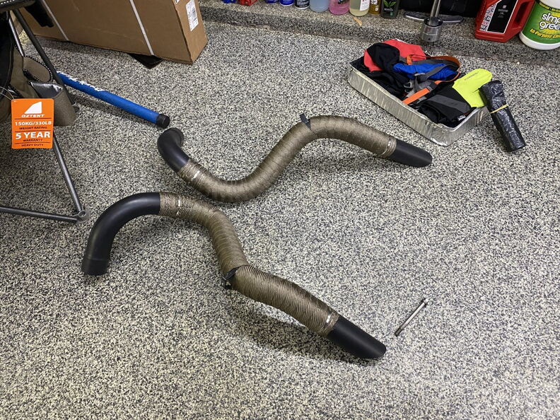

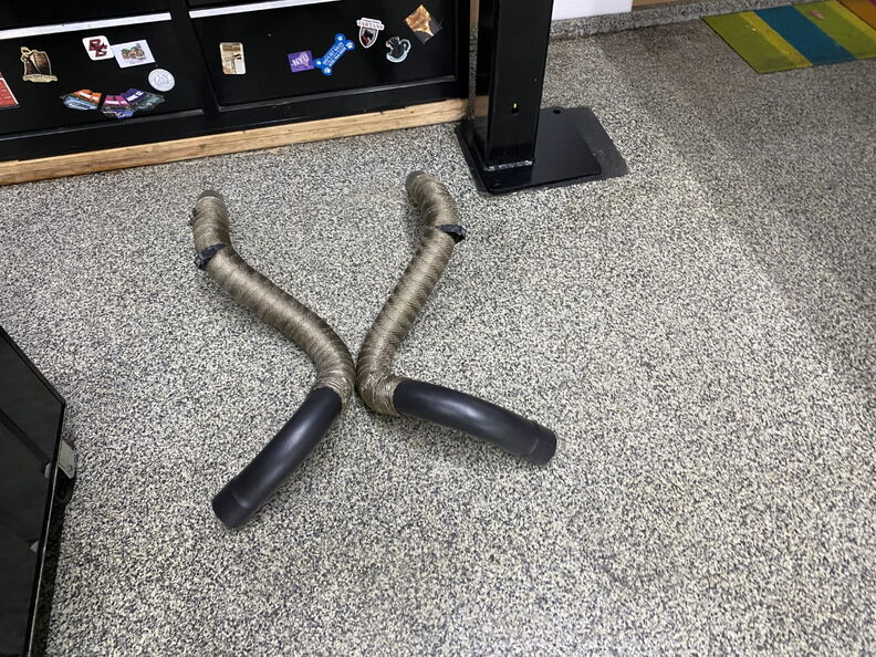

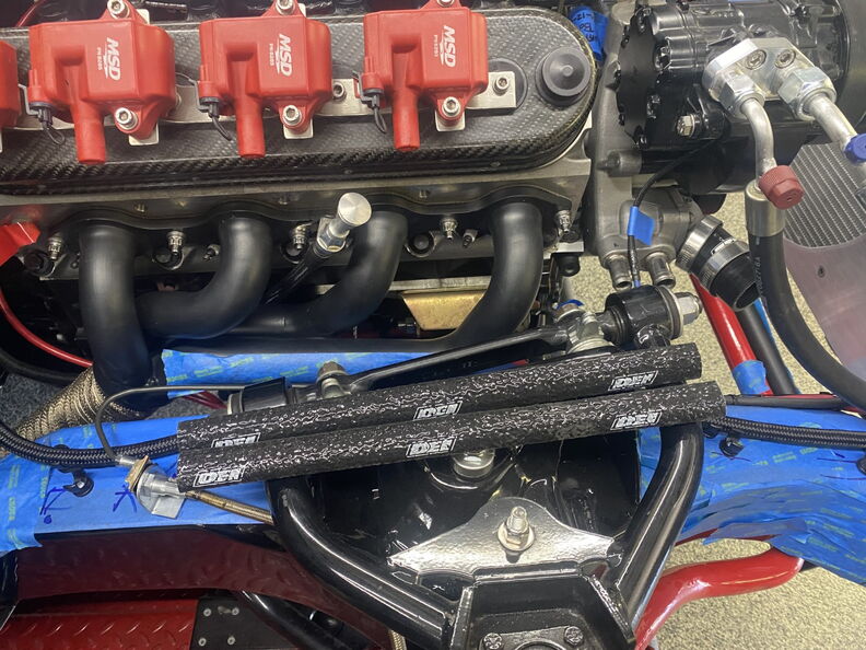

      Default DEI Heat Sleeve on Transmission Lines ( 03-20-21 )
      Since the transmission lines are close to the downpipe on the header I decided to wrap the lines in DEI Heat Sleeve
      Looking at these hard lines I now know that I am going to have to paint them.
      Just one more thing to add to the never ending to do list.

      Drivers Side Hinge - Ugh (03-21-21)
      So this side didn't go as smoothly as the passenger side.

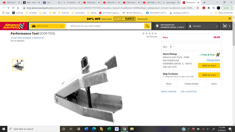

      This tool is a life saver.
      Hinge is off and reference marks are set.
      This side was not fun.
      Both hinges are installed and lets just say the door is way off and I needed a break.

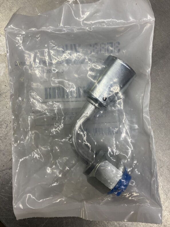

      Since yesterday didn't go so well I decided to make an AC Line.
      I plan to crimp the fitting in the engine bay once I have all of the lines in the car.
