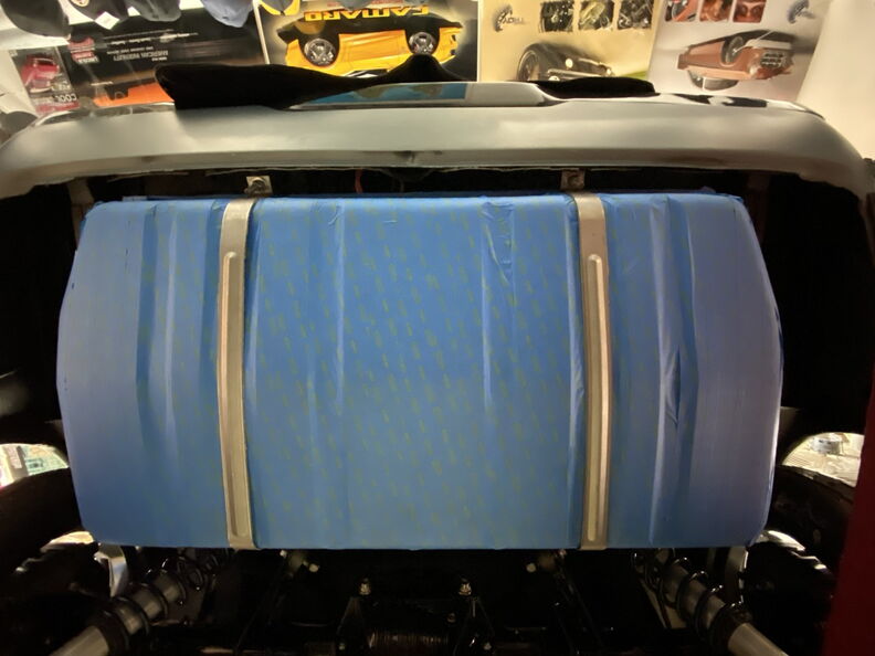

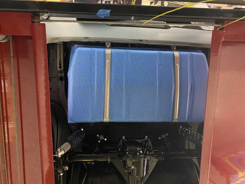

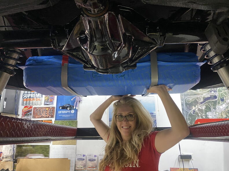

      Installing the Holley EFI Tank (( 09-23-20 ))

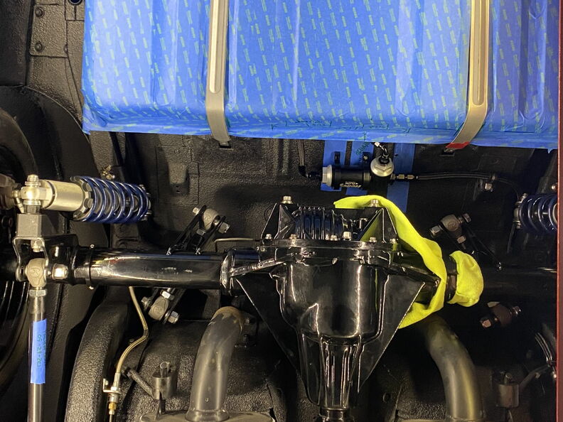

      Looking forward finally installing the Holley EFI tank.

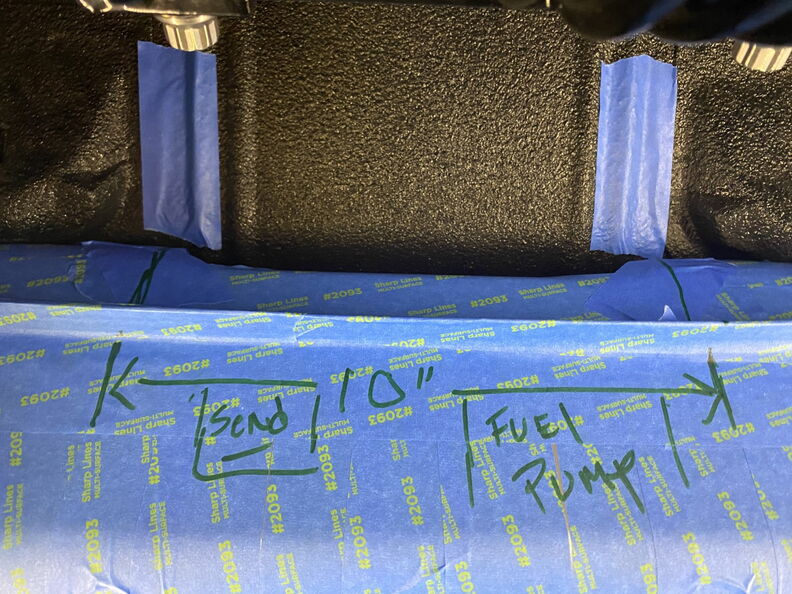

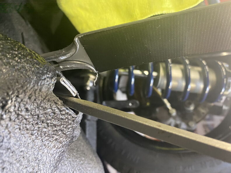

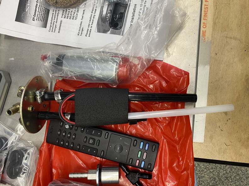

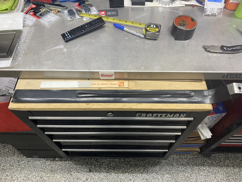

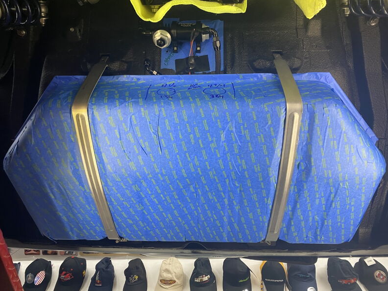

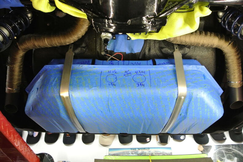

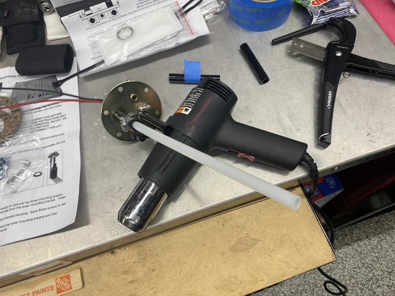

      Since the rubber isolator strips were in my garage attic and there was some duct tape nearby. I taped the straps so I wouldn't scratch up the tank.

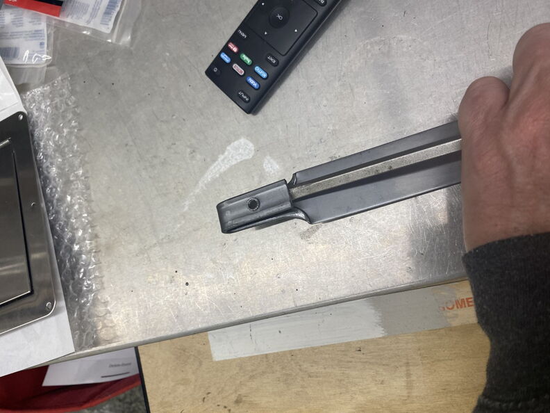

      I needed to open up the end so I could hang the straps.

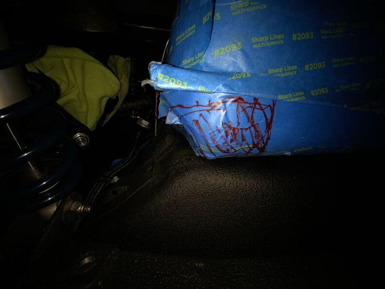

      All Taped up and ready to install.

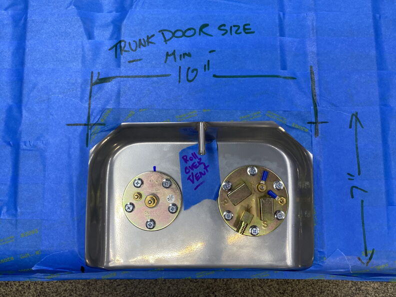

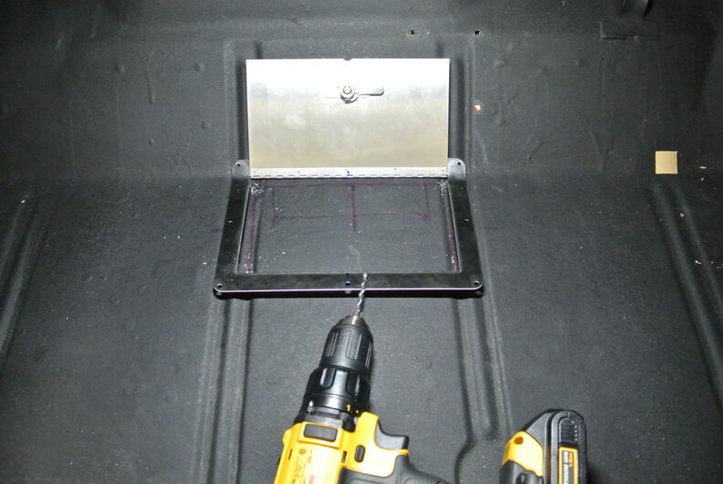

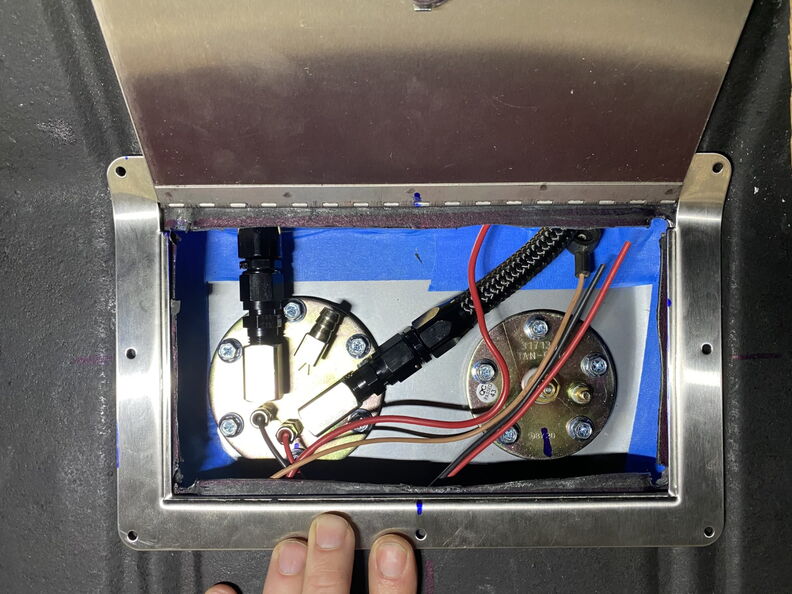

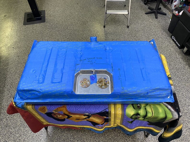

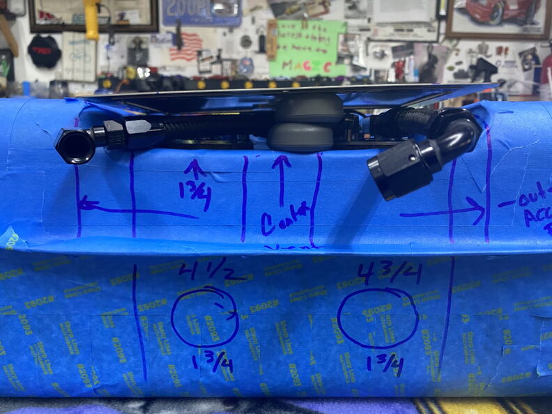

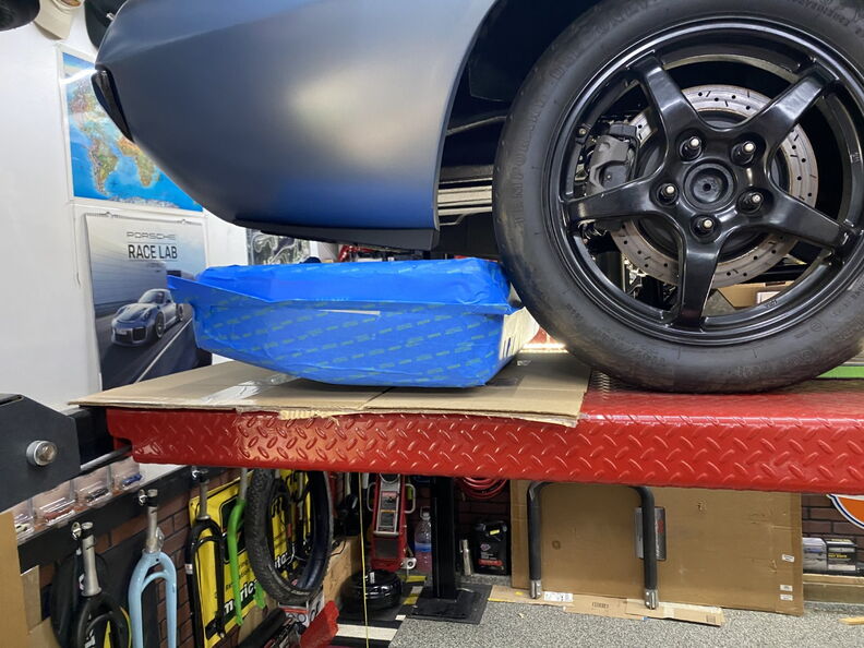

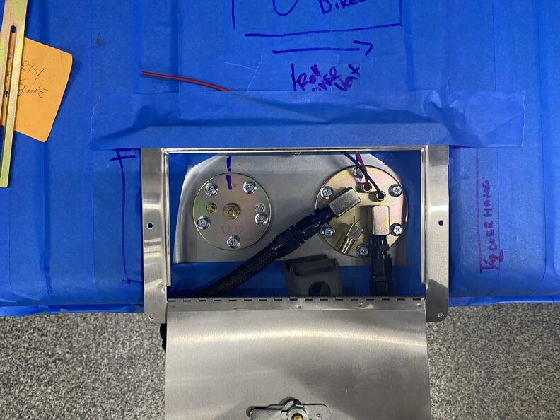

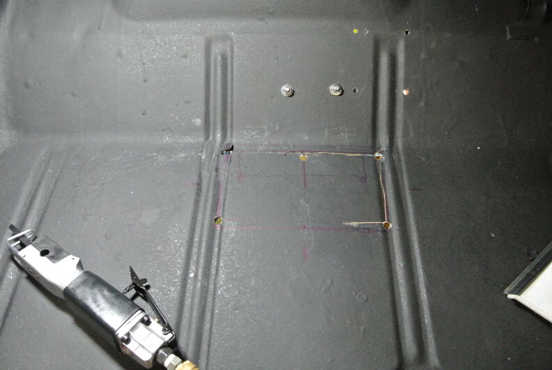

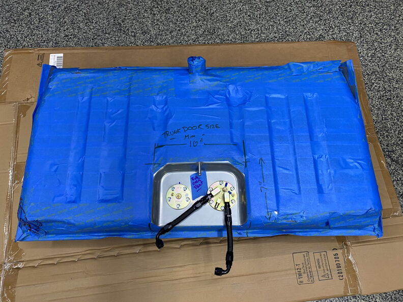

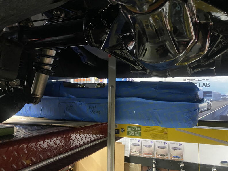

      Since I plan to install an access door I took a few measurements so I could figure out where to cut the hole in the trunk floor.
      This does not look like it is going to be fun to do by myself.
      Time call for back up.
      marty-mj

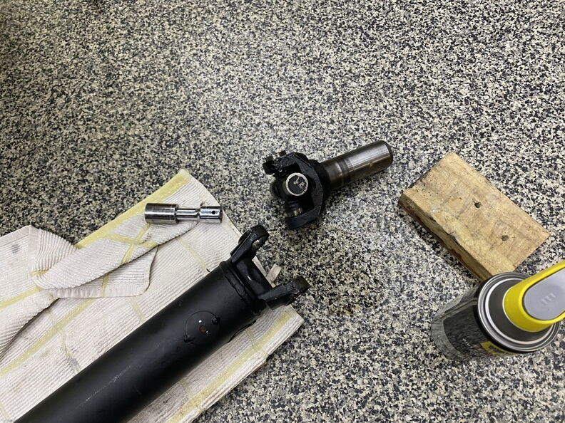

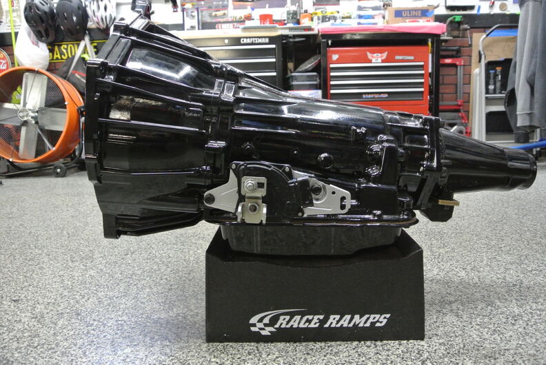

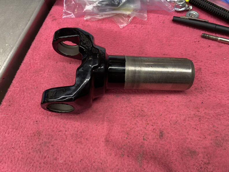

      Driveshaft - Village Auto (( 09-27-20 ))

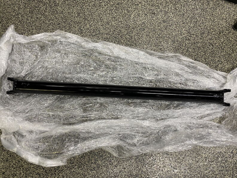

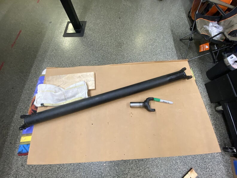

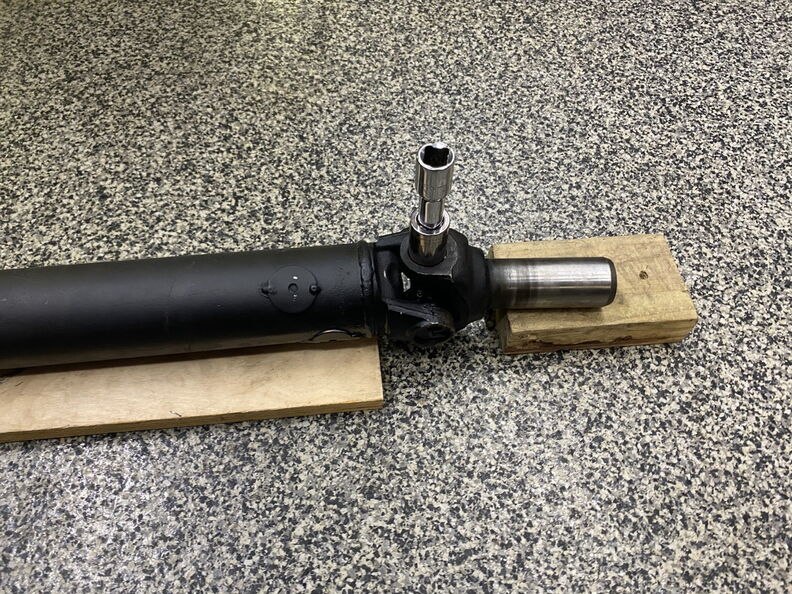

      Don from Village Auto stopped by and measured up my driveshaft for me.

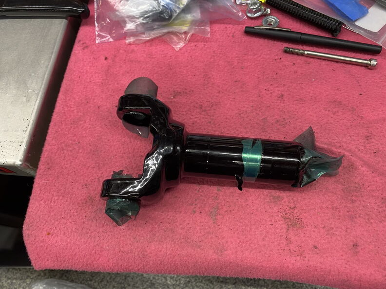

      It was shortened and balance and now it's off to the Powder Coater.
      Just need to take it apart first.

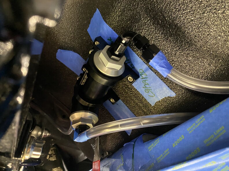

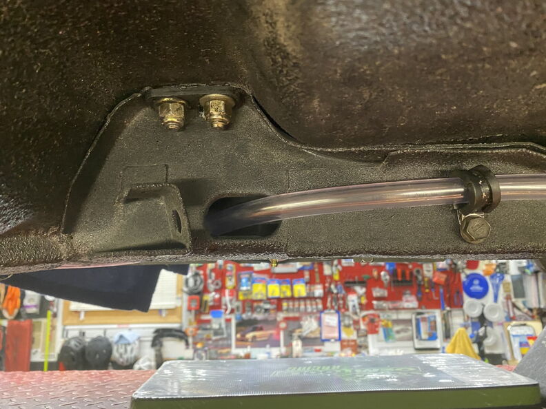

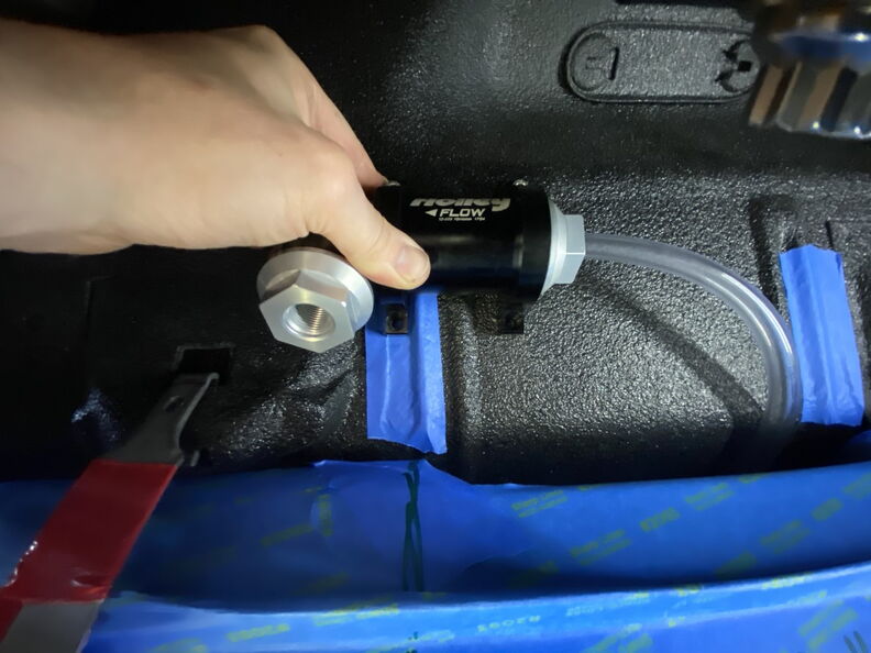

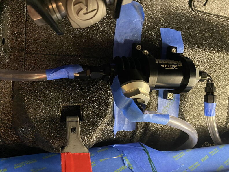

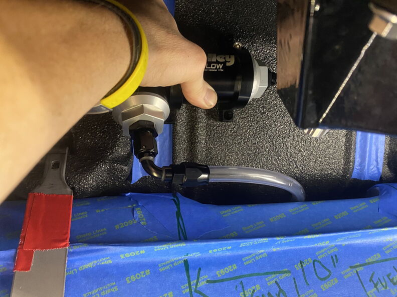

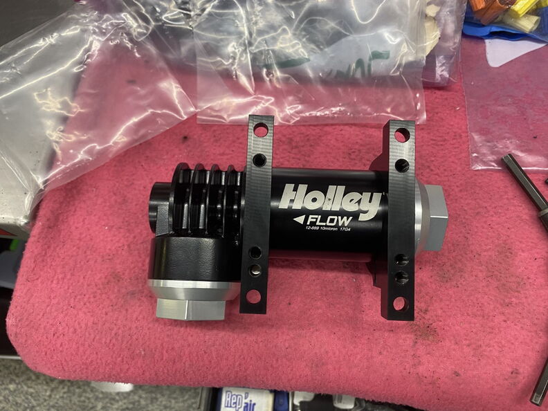

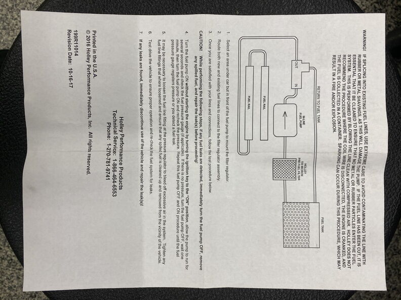

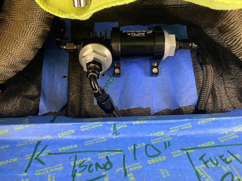

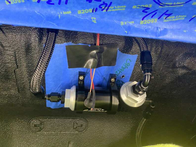

      The plan here is to find a suitable location for the Holley Fuel Filter Regulator.

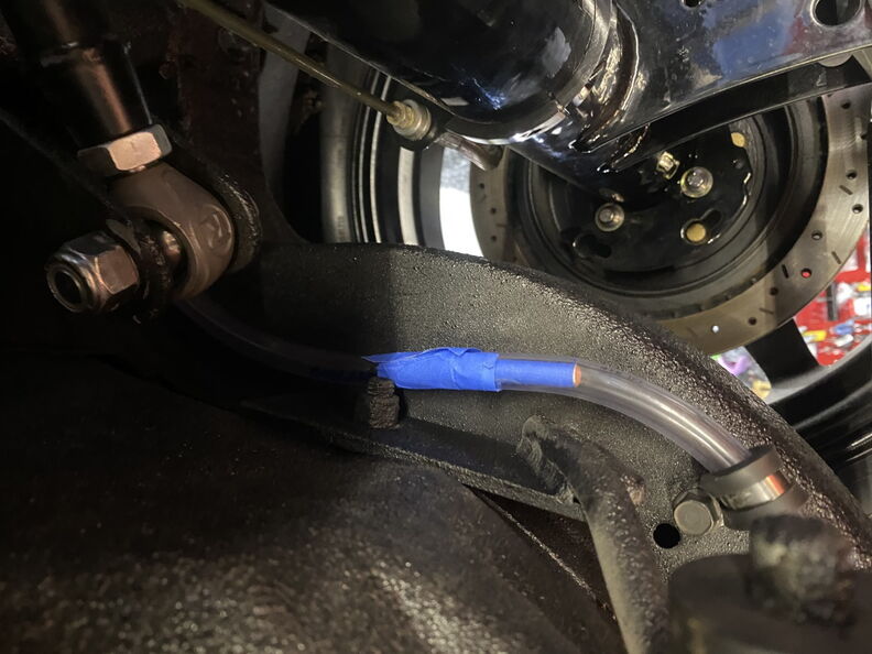

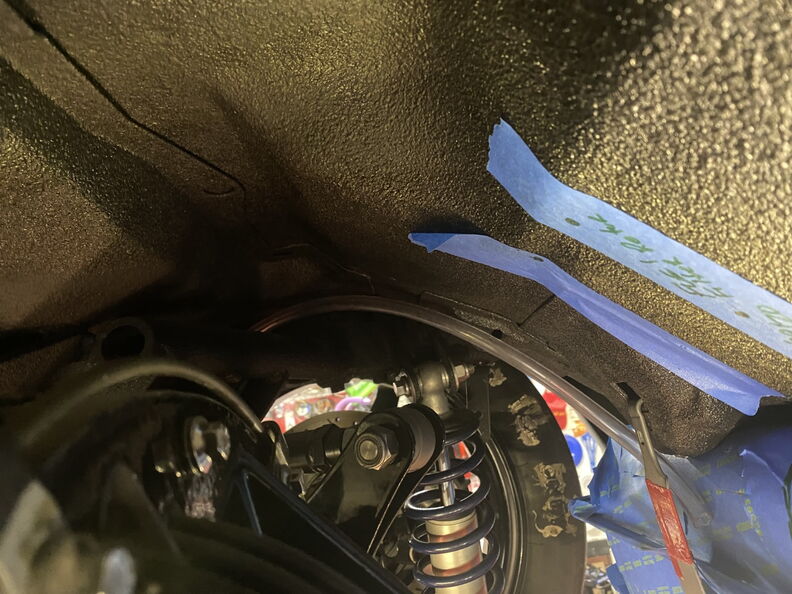

      I plan to use this clear hose for mock up as it is roughly the same size as the -6 PFT line.

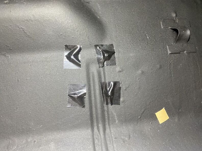

      This looks like a possible location.

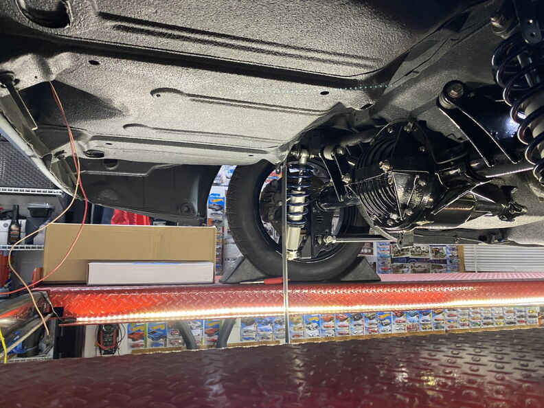

      Time to drill a few holes.

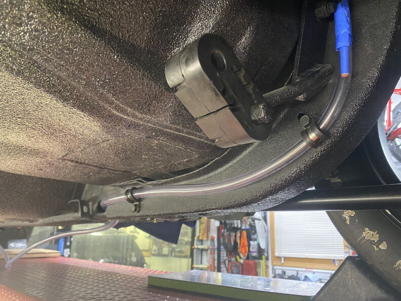

      Mocking up the fuel line.
      marty-mj

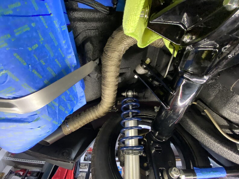

      25
      I know you love the tape, but that’s a lot of tape! You don’t mess around. LOL.
      Awesome build!
    5. #665
      Jul 2008
      512
      I was gonna say, he needs to ask 3M about sponsorship!
      Marty, might stop by a paint shop / supplier and ask about the different wraps they're using to protect body panels. Might could save you time/money instead of using individual rolls of tape.
      I'm happy with my Tanks Inc tank (Holley) but just pay attention to the vents. At some point I'm going to have to put a burp tank or something on mine, always seems to get gas in the lines any time I'm over 3/4 full. Might run oversize hose to allow air to get by the fuel when it sloshes in? I did have the rollover valve inline but gas kept on getting up to it, closing it, and pressure would build in the tank until it was overpowering the seals. I removed it and just live w/ smelling fuel every once in a while. (1964 stock vent technology has it loop through the trunk for rollover leak prevention, then exits into the pass rear wheelwell)
      While you have the driveline apart, grab a Sonnax hardened yoke. Couldn't hurt with your power level/traction. Had to put one in my chevelle to keep from twisting it.
      https://www.sonnax.com/slip_yokes

      Thank you for the tips on the tank vent I really appreciate it.
      As for the Yoke - Dam You my son. I will ordering one next week even if I don't need it and calling it my Christmas Present.

    7. #667
      Chicago
      2,788
      Quote Originally Posted by Toccoa View Post
      Awesome build!
      Thank you very much and the good news is I am trying to build a giant tape ball with all of the tape I have removed so the tape will not go to waste.

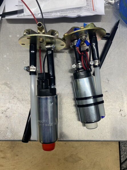

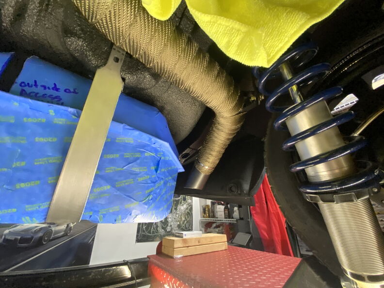

      I wonder if those round cork looking gaskets can handle ethanol. Cork gaskets generally can't.
    9. #669
      Chicago
      2,788
      Quote Originally Posted by Vimes View Post
      Actually I am hoping Andrew will chime in on this one.
      I know that I am supposed to you a sealer with these as they tent to leak from what I read.
      Also, Rob Ida posted a picture of a Holley EFI tank pump assemble that was killed by Ethanol.
      marty-mj
    10. #670
      Chicago
      2,788

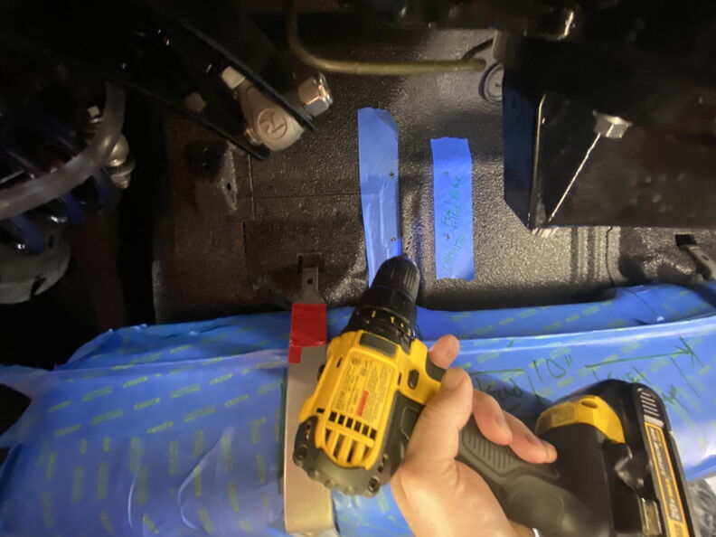

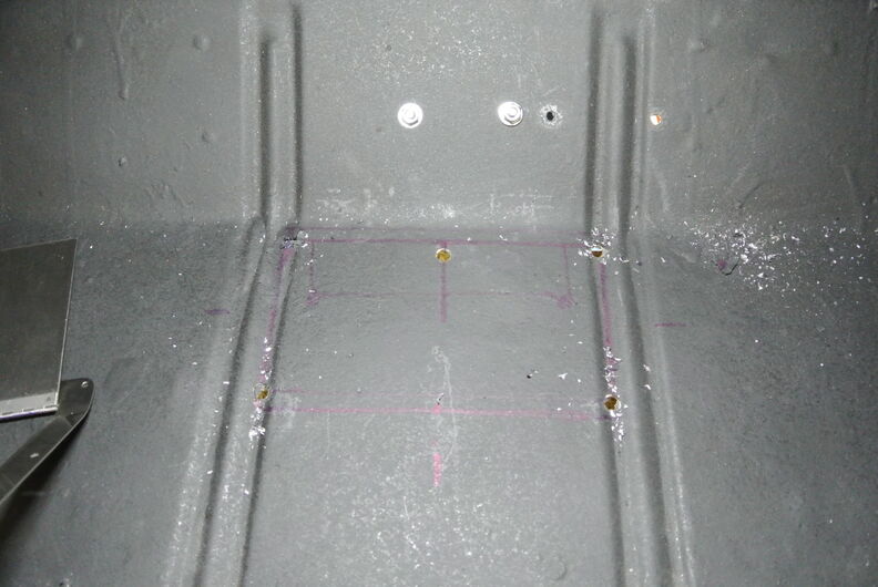

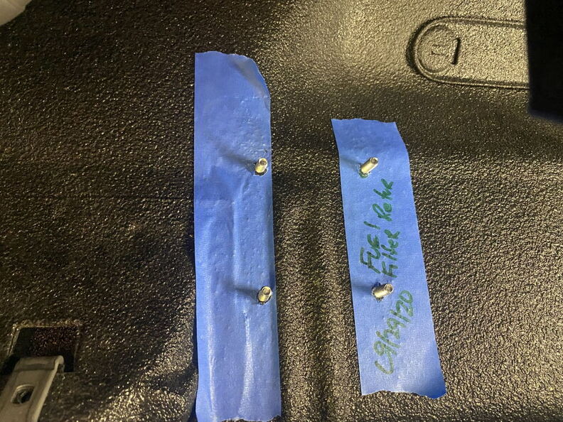

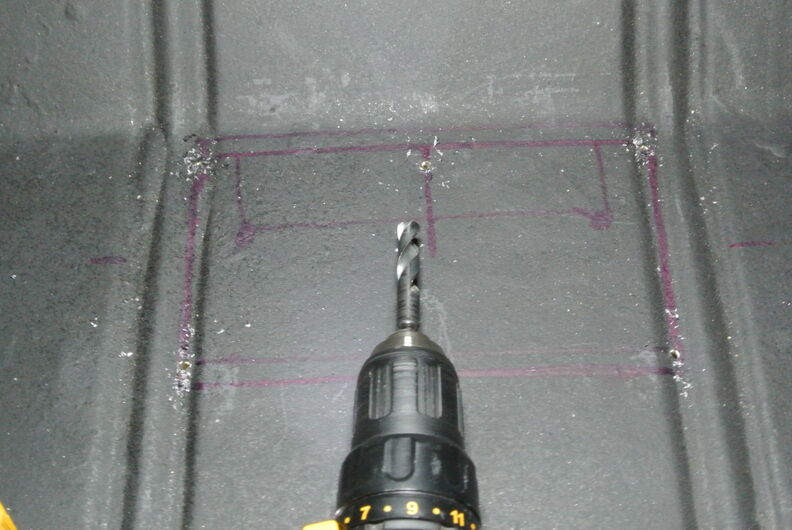

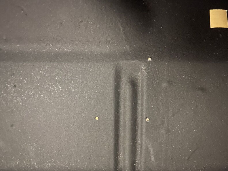

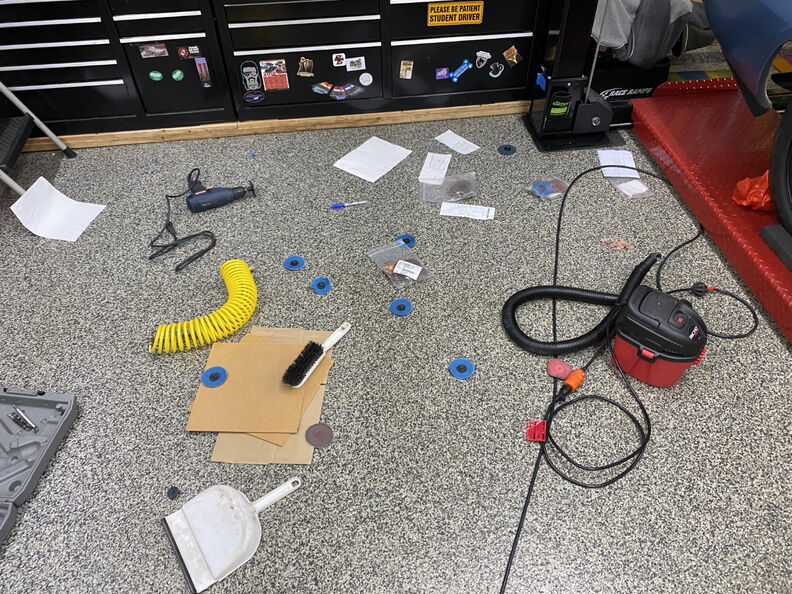

      Drilling Holes in my Floor (( 09-30-20 ))

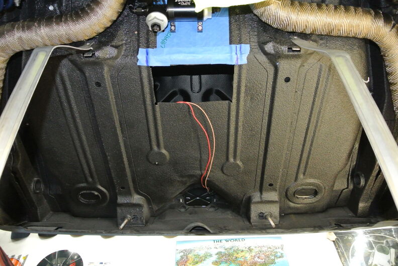

      I am sure I am not the only one that doesn't like drilling a hole in the floor.
      But since it has to be done in order to mount the filter/regulator so here we go.
      I was able to drill 3 out of 4 from the underside of the car. However, one of them I had to drill from inside the trunk.
      This is simple the best punch on the market (( Thank You Jimmy ))
      I wish someone was at home to help me hold the bolts
      Found a substitute for my Chunky Bars.
      Mounted !!
      marty-mj
    11. #671
      Chicago
      2,788

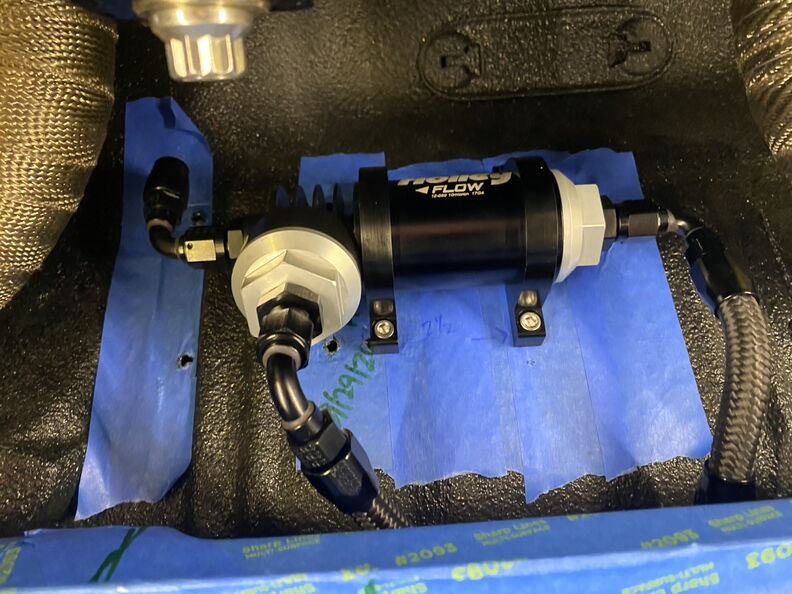

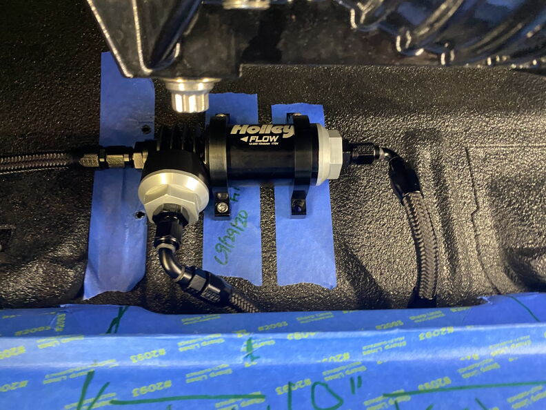

      Fast Forward Two Weeks Later and I am not really happy (( 10-11-20 ))
      I took a couple days off the car and finally was able to get a few rides in on the one of my Fat Bikes. I upgraded the fork & tires and man what a difference it has made.
      Looking back I should have installed the exhaust and the fuel tank before I mounted the Filter/Regulator. I am not really happy with how close the line is to the tailpipe. Either way I plan to install the DEI heat shield over the line and the fitting but I am still going to see if I can figure out a better way to run the fuel line.
      I slid the Filter/Regulator over about 2" and it looks much better. Not sure if this is going to be the final location but I may move it over a little be more.

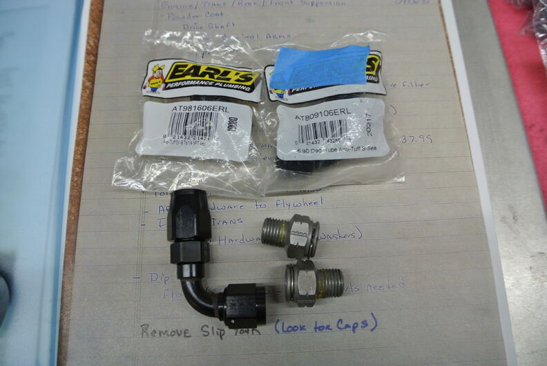

      I also added a 90 Degree fitting and according to Holley tech's this is perfectly fine.
      and then this happened !!!
      This is the area of the tank that the tailpipe would be within an inch of.
      Ugh !!
      So I have a couple choices in front of me and they both involve spending more money.
      Choice #1 - Have High Speed Welding make me two new Tailpipes.
      Choice # 2 - Order the Holley DSE Clipped Corner Fuel Tank
      Calling it a night and going into the house and to watch Kindig It Design on Motor-Trend TV
      marty-mj

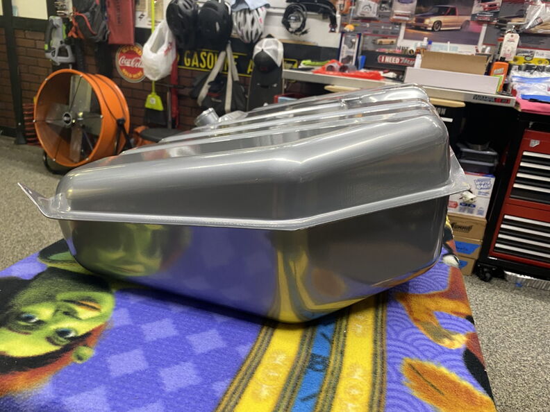

      Hi Marty this is what we did on my original new factory tank before I got the new tank.
      All Welded up ready for powder coating.
      here's the finished tank
      Finished tank.
      Maybe check how much to do this.

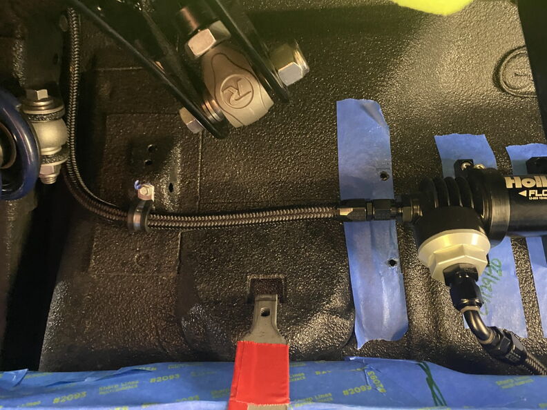

      Holley EFI Plumbing Final Location (( 10-18-20 ))
      I am enjoying my time off of work and spending time with my girls. My goal is to finally get this thread all caught up.

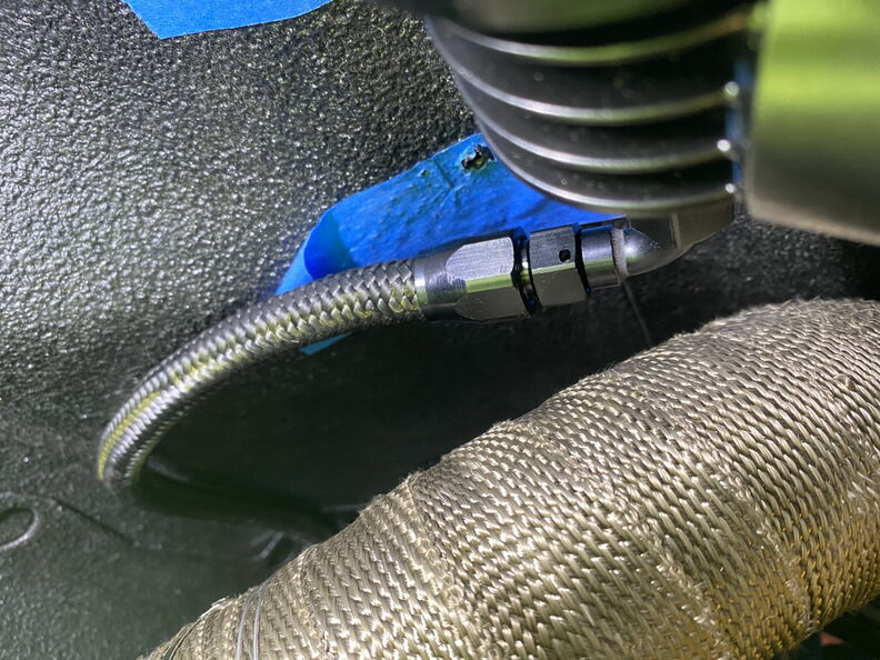

      The final location of the Filter/Regulator has been decided so I will have four holes to fill in the floor. Insert sad face

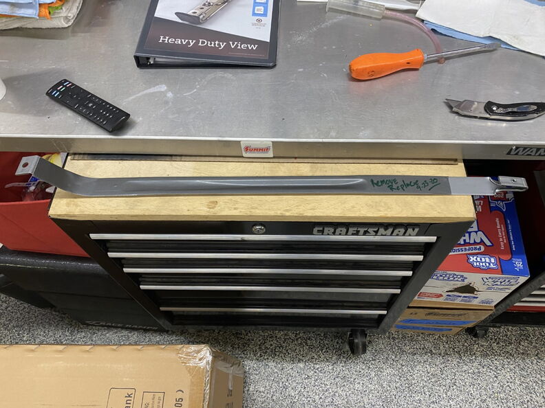

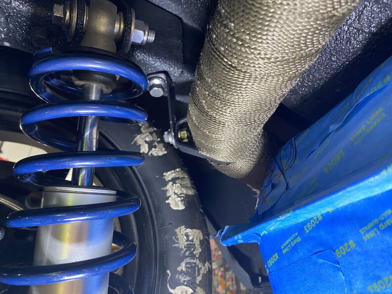

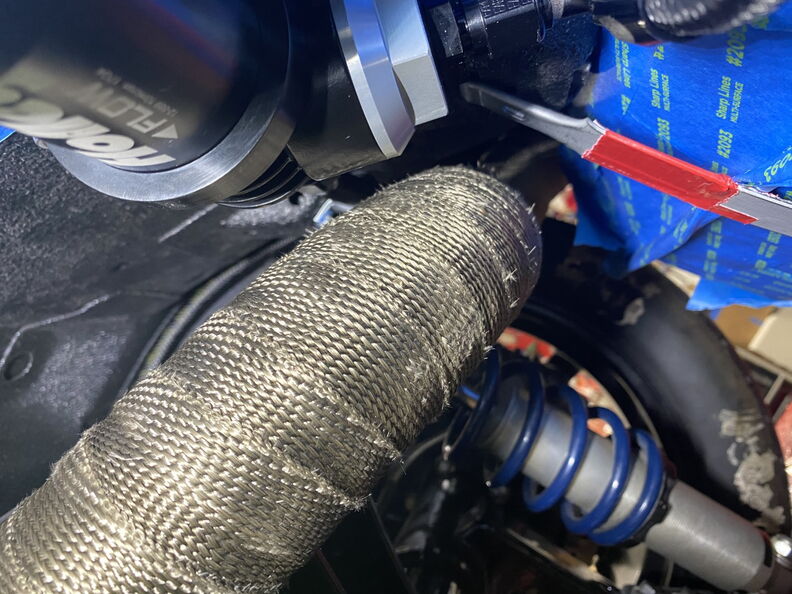

      While I am here I am going to fix a couple things. The exhaust was rubbing on the passenger side tailpipe and th good news is it a simple fix and all I need to do is flip the bracket and change the angle of the bracket.

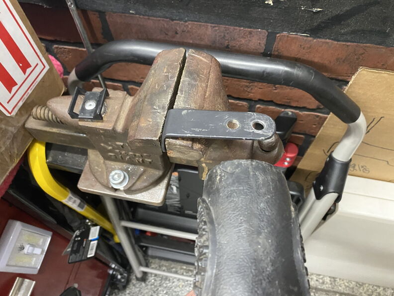

      My Grandfather gave me his fathers vice when I was a youngster and I am happy to say it still works great and I love having it in my garage on my rolling cart.
      I clamped the bracket in the vise and gently tapped till it was aiming the other direction. I like using the dead blow hammer as it doesn't damage the bracket and you don't have to hit it as hard as a regular hammer.
      Worked out perfect and now all I have to do is have it powder coated.
      I am also happy with the new location as it moves the fuel line a good distance away from the tailpipes.
      marty-mj

      I also headed to the Powder Coater to pick up the driveshaft. I am very happy with how it turned out.
      I probably should have put the universal joints in while it was taped up.

    17. #677
      Chicago
      2,788
      2020 10-19 Holley Clipped Corner Tank
      So I pulled the trigger and ordered the Holley Clipped Corner tanks and it was the right decision. It has solved my clearance issue with the tailpipe which will also allow me to have extra room if I ever decided to install wider tires on the rear and if I do will at least have the room to make new tailpipes.
      Here we go again.
      You can see how much deeper the new tank is by looking at the pump assembly.
      marty-mj
    18. #678
      Chicago
      2,788
      Preparing for the Power Tour - Fuel Pump Access Door (( 10-21-20 ))
      I know this is overkill but I really don't want to ever have to drop the tank when it has fuel in it.
      One of the benefits of the blue tape is I can write notes right on the tank.
      Talk about a tight fit.
      I needed to open these up just a little bit so I could slide them in place.

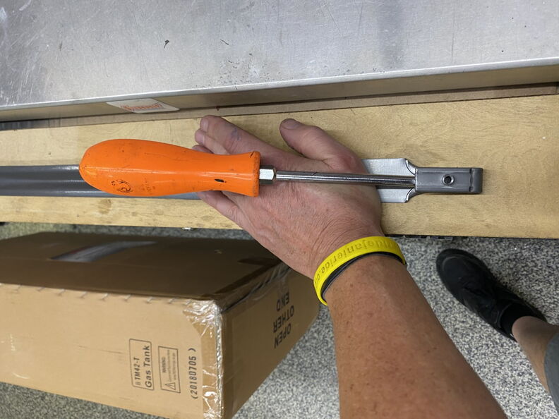

      So this is how I tightened them back up. Anyone do this a different way as I would love to know if there is a better way.
      I put tape on the straps temporarily and once the tank is in for the final time I will install the rubber strips.
      Had to call the wife out to help me put the tank in for the first time. Once the straps are bent I can easily remove and install the tank by myself.
      Tank is in and it looks so much better.

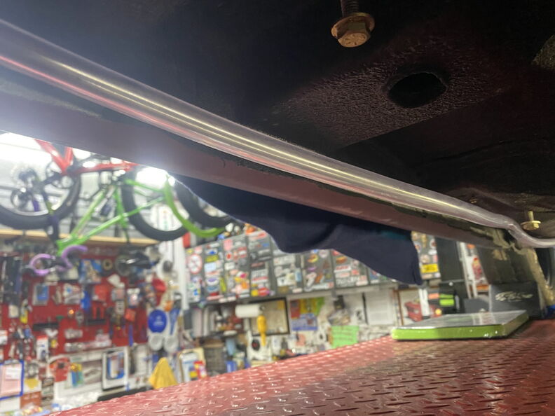

      I had to shorten the lines just a little bit and I was even smart enough to lay the wiring on the top of the tank. This will allow me to terminate the wire at the sending unit and the fuel pump. I will also need to run ground wire which I forgot to install.
      I quickly installed the tailpipes just to see how much of a difference the new tank would make.
      marty-mj

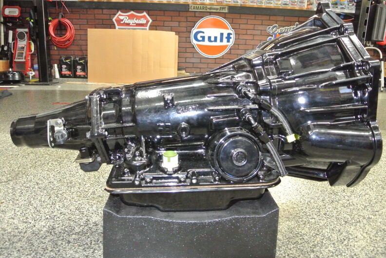

      Planning the Atomic 4L60E Transmission Coolant Lines (( 10-24-20 ))
      Time to start planning the soft lines for the transmission.

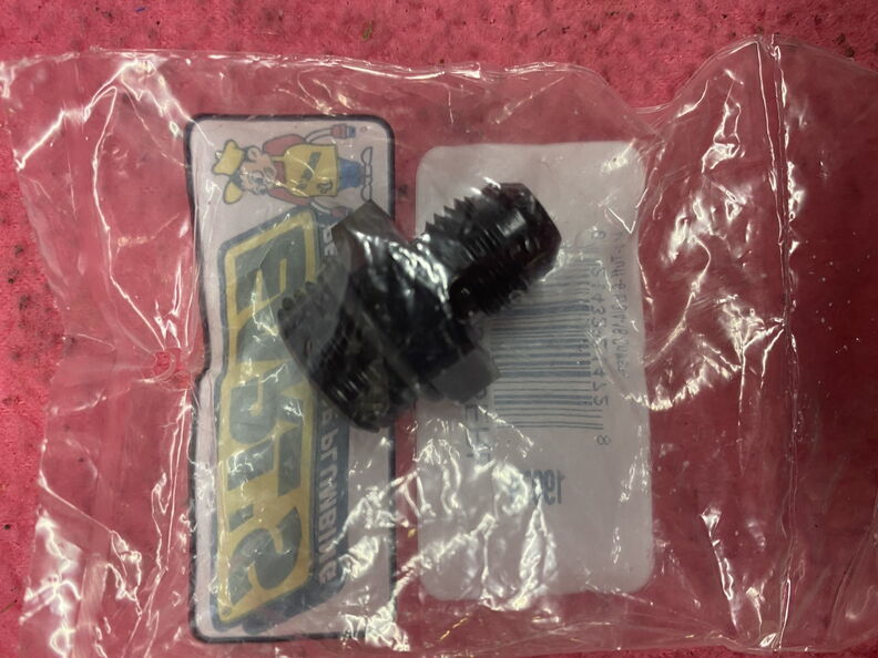

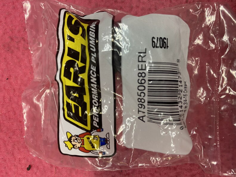

      I will need to order a few more fitting from Summit so I run soft lines from the transmission to the hard lines under the core support.
      Having soft lines at the transmission will make it easier to remove the trans and i won't have to worry about trying to figure out how I would get a wrench on the fittings if i did a hard line.
      Did I mention I have some of the best kids a father could ask for. Not only did my daughter go pick up lunch she stayed out in the garage and had lunch with me and we talked about her day.
      marty-mj
    20. #680
      Chicago
      2,788

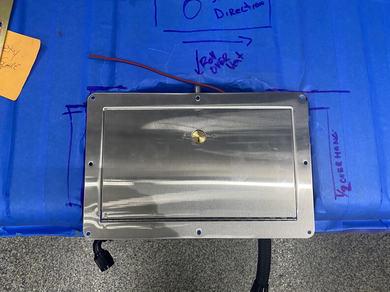

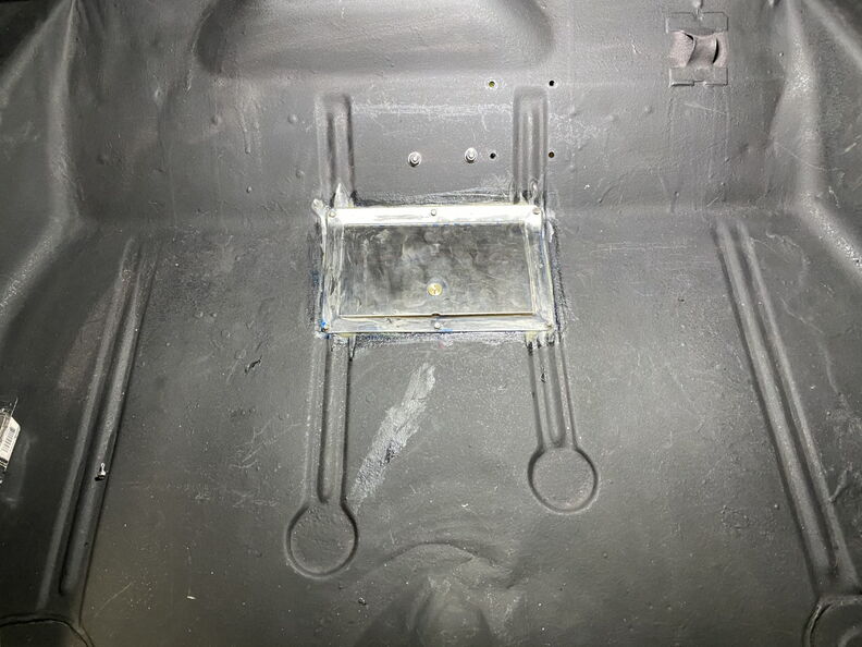

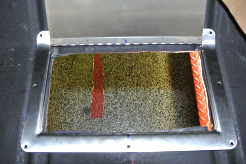

      Tanks Ink Fuel Pump Access Door Install (( 10-24-20 ))
      In order for me to be able to install the access door I am going to have to remove all of the parts in the trunk. The good news is most of the parts have already left the trunk and have been installed on the car. So I am feeling like the car is getting closer to getting back together.
      Don't hate me as I went to Harbor Freight and bout a disposable panels saw.

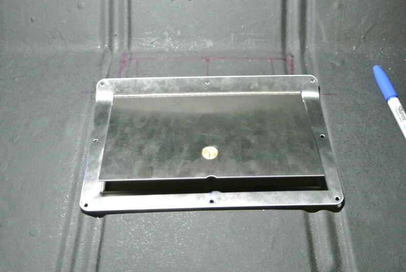

      and here is why I love the blue tape as all of my measurements are right there.
      In order for the panel to follow the shape of the floor I slid the panel up into the curve and slowly pushed it into shape.
      Tanks is back out.
      You know if it wasn't my car I am sure it wouldn't bother me to cut a giant hole in the trunk floor.
      Houston we have a hole.

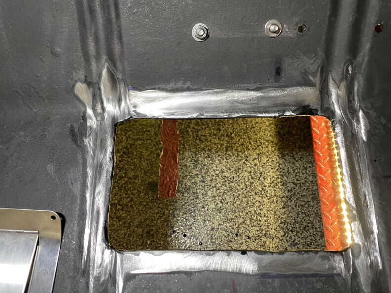

      Next step it to make the floor opening match the access door.
      I installed the tank back in to make sure I actually cut the hole in the correct place.
      Tanks is back in and I made sure I installed the lines. I wanted to make sure I could get to all of the fittings.
      Once I trim up all of the excess I will be able to service the pump, float & fittings.
      Holy crud am I making a mess.
      marty-mj
