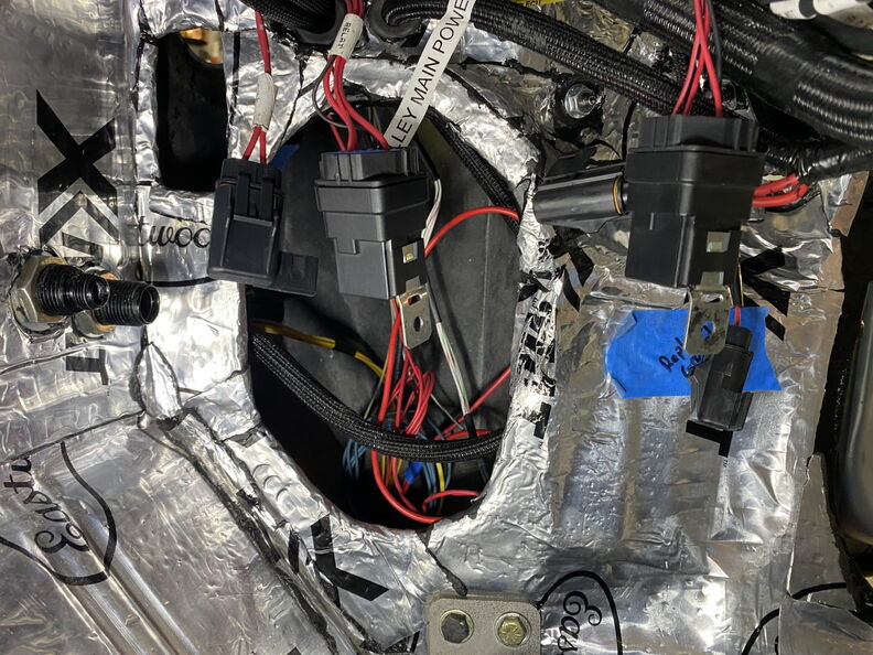

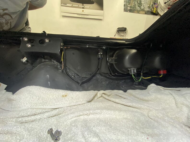

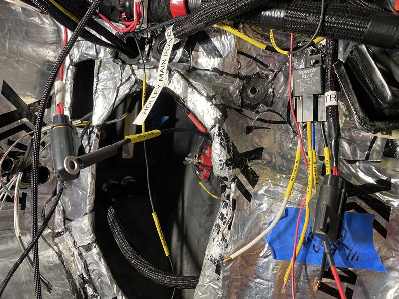

      Power & Ground into the Passenger Cowl ( 07-05-21 )

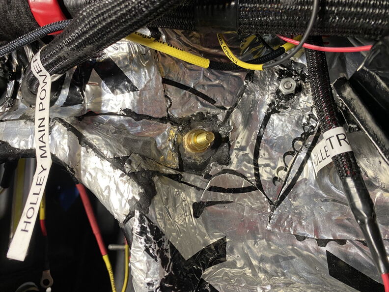

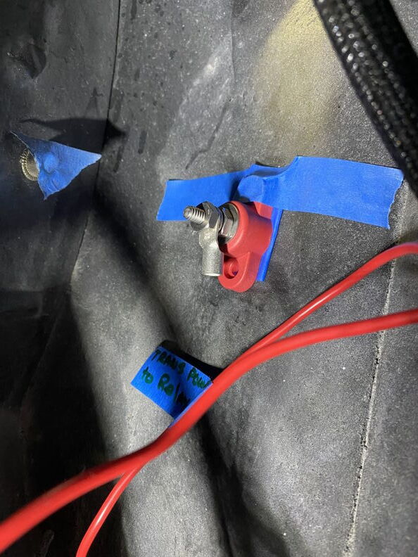

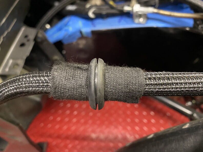

      I am running an additional power & ground on the passenger side of the car. In order to keep everything neat and tidy I am running the wires inside the Holley Power/Ground wire loom.

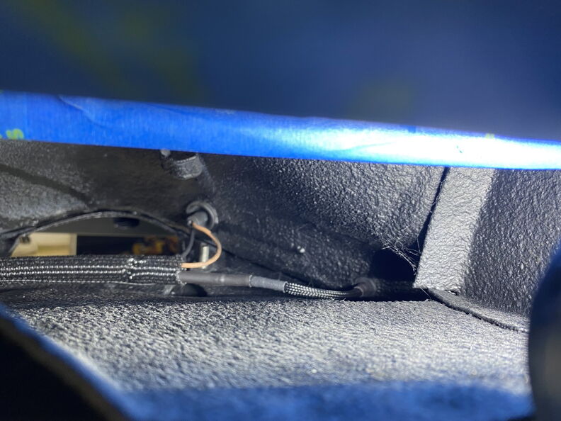

      In order to stabilize the wire loom I ran it through the grommet which I wrapped with Tessa Tape which was then covered with 3m Electrical tape to give it a finished look.

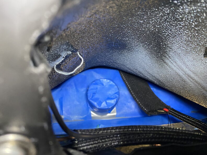

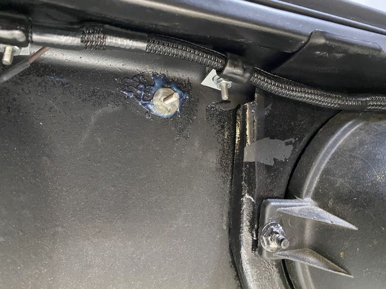

      I didn't want a power source in the cabin so I choose to move it into the cowl panel.
      Which should keep it out of harms way and still be easy to access.

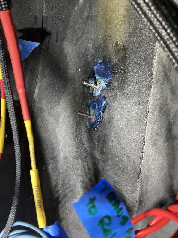

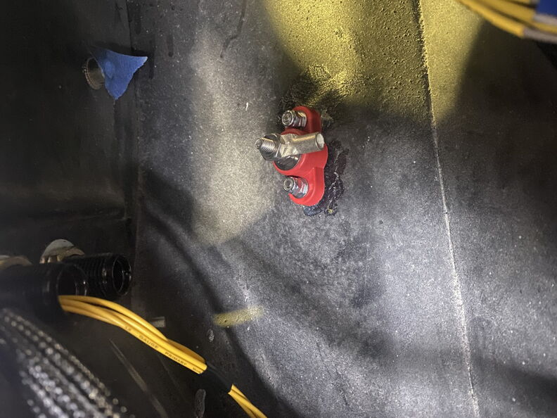

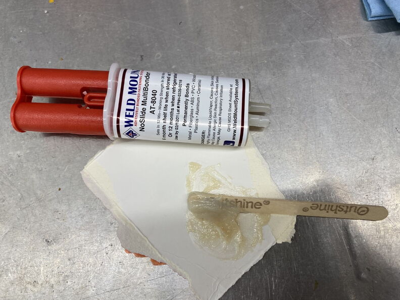

      I used a couple more Weld Studs to mount the power stud.

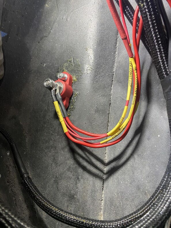

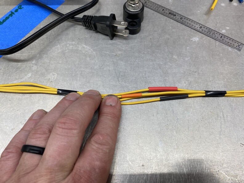

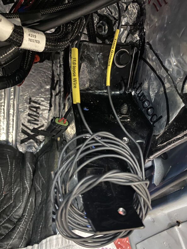

      While the epoxy was curing I started working on the four optional wires that the Terminator X can trigger.
      My thought is it is much better to run it now then figure out how to do it later.
      I cut all four wire to an equal length and then installed a different color heat shrink on each wire end so I would know which one is which at a glance.

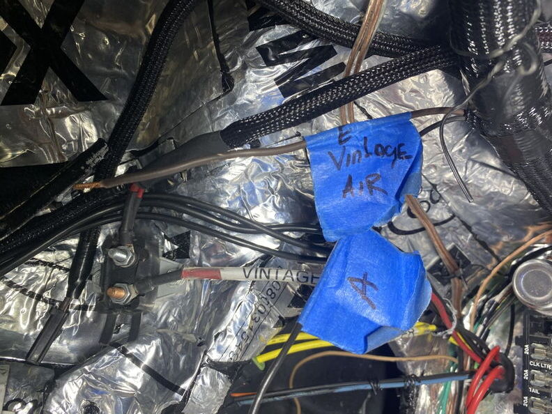

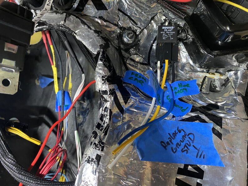

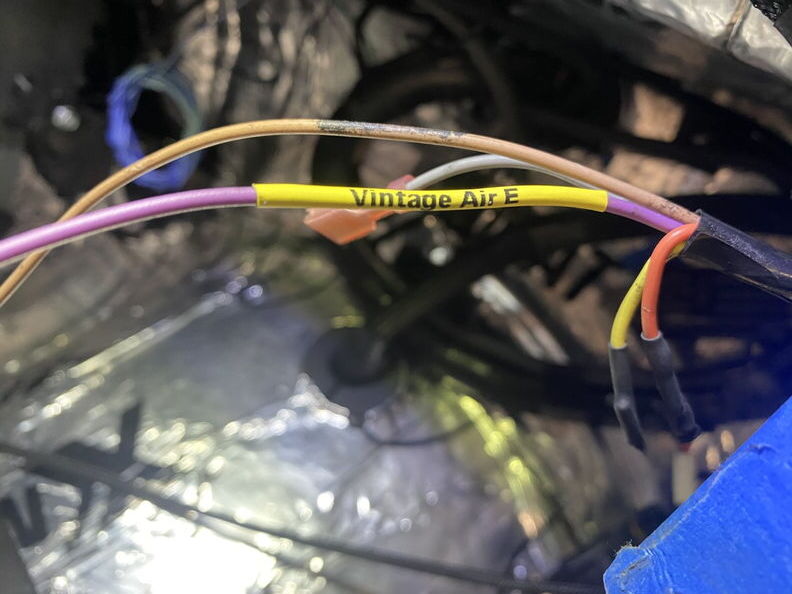

      I also labeled a couple more wires while I was there.
      There is a lot going on in this area and when it is finished will be easy to service. I hope !!!

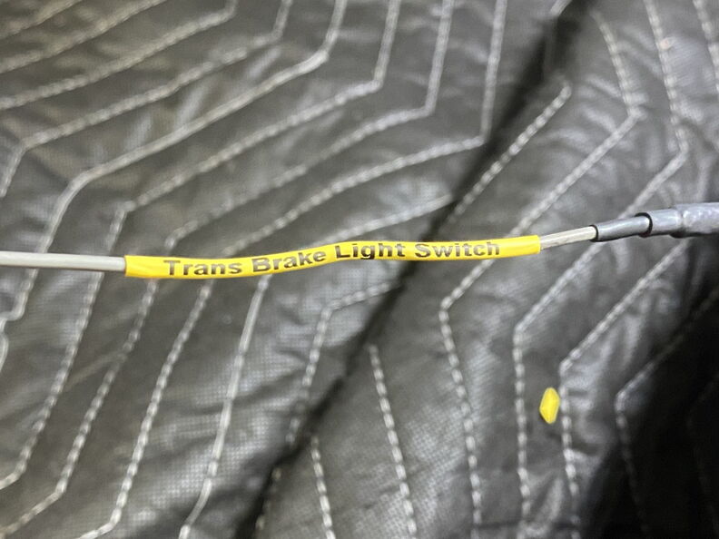

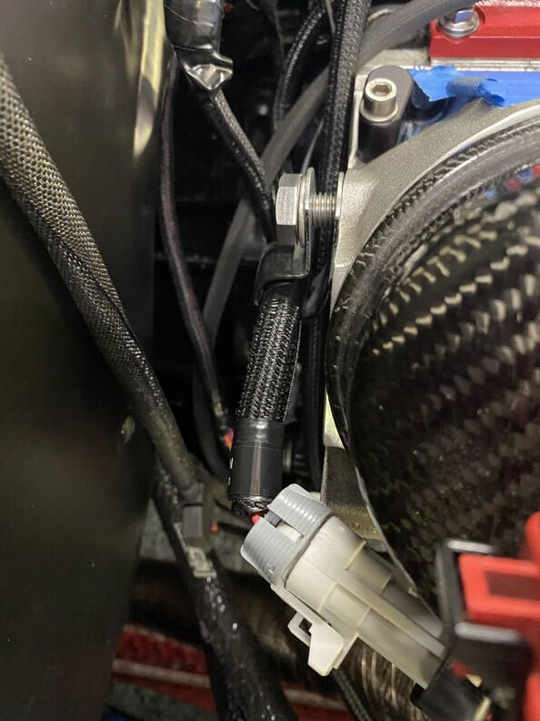

      Since I have an early version of Holley Terminator X I have to trigger the transmission signal with a relay.

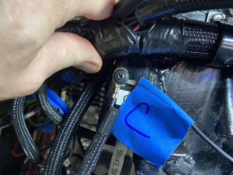

      More notes. This one is reminding me to replace the ground stud with a brass bolt.

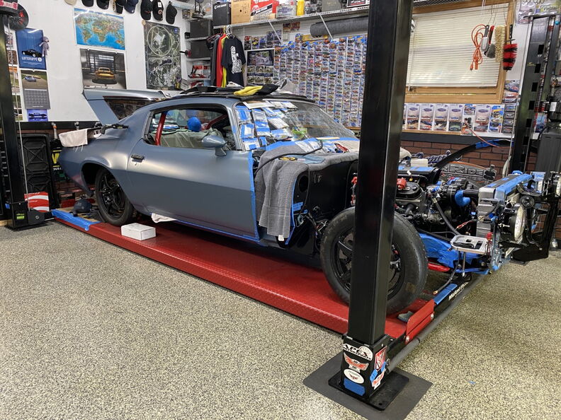

      Being honest the weather was so perfect that I spend the last 10 days riding.

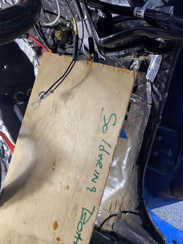

      I finally started working on the ground stud.

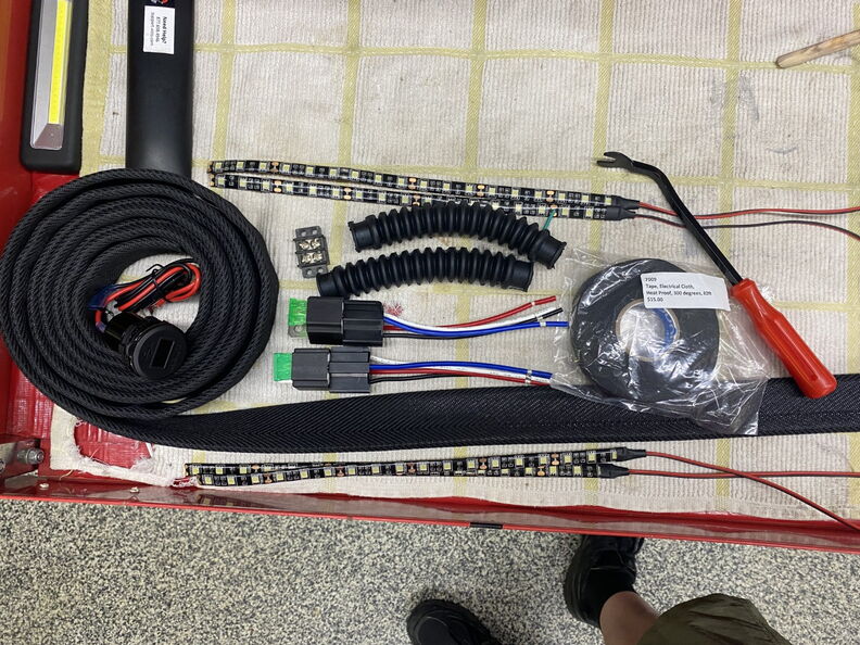

      Picked up a couple more parts.

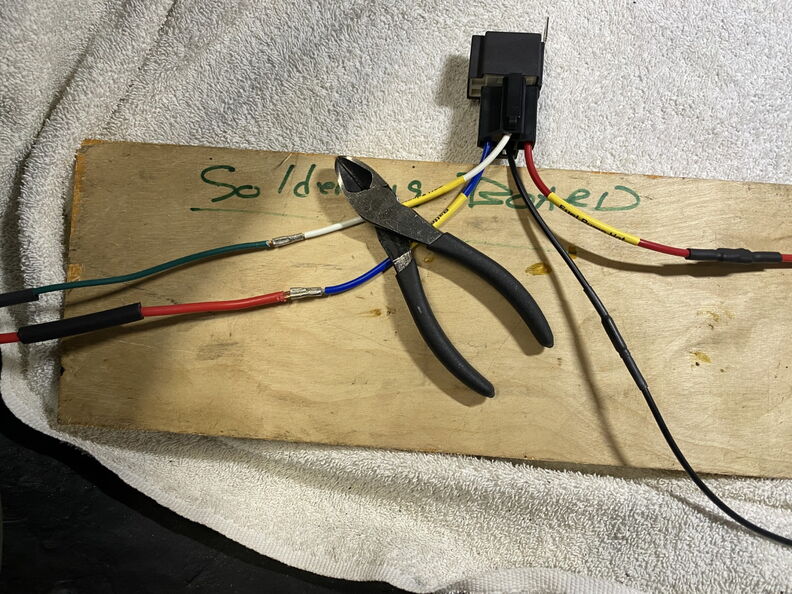

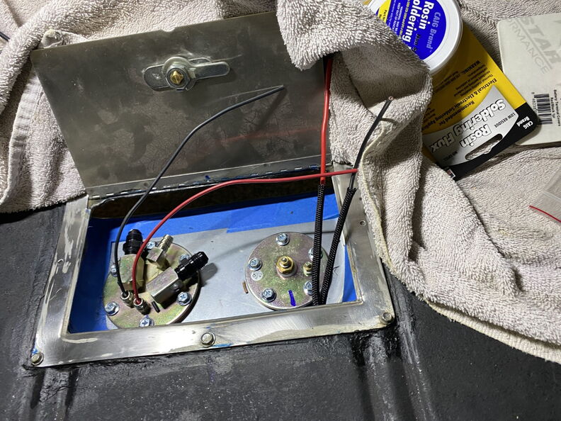

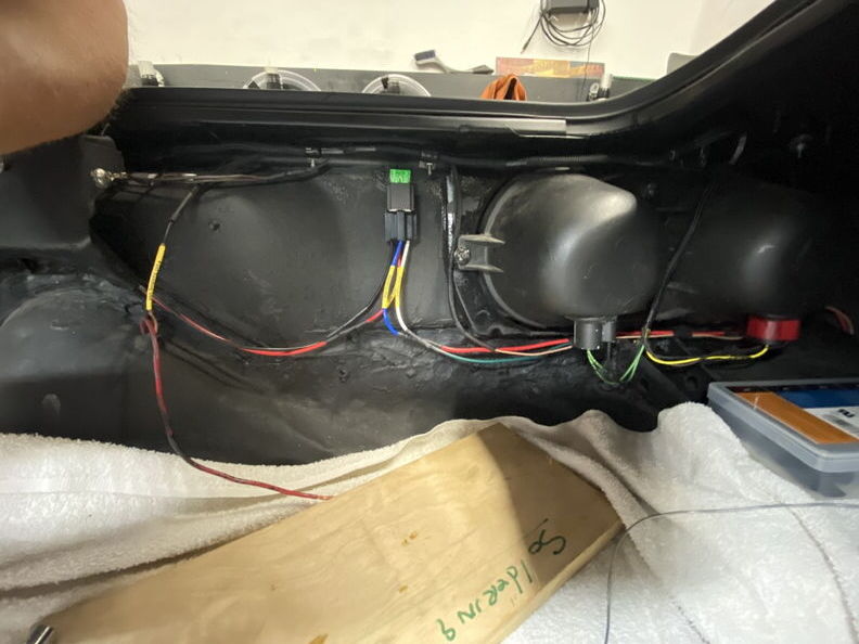

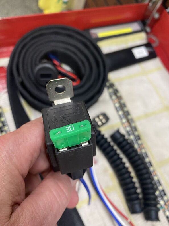

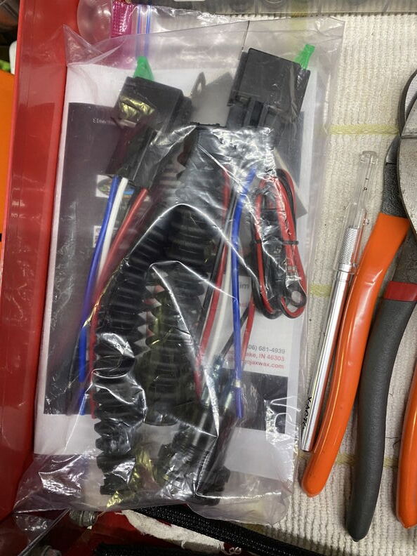

      I will be using this relay to trigger the fuel pump.

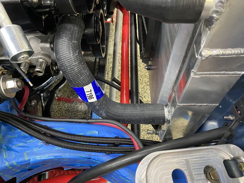

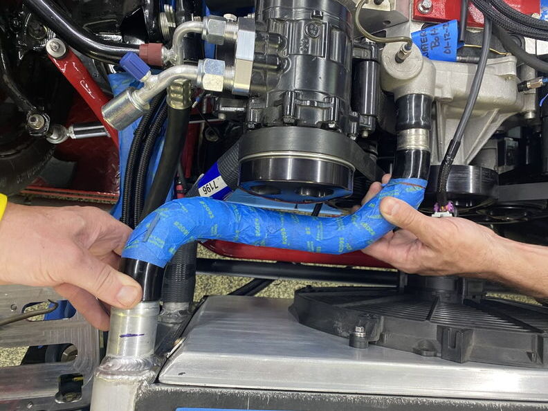

      While I was at Good-Guys Columbus I ran into a gentleman that found an over the counter radiator hoses solution that may work in my car. I ordered them up to see how close they would be on my car and they look pretty good.
      The lower looks good but it will need a swivel neck for it to work correctly.

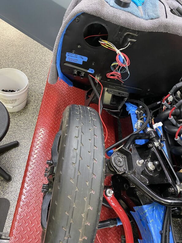

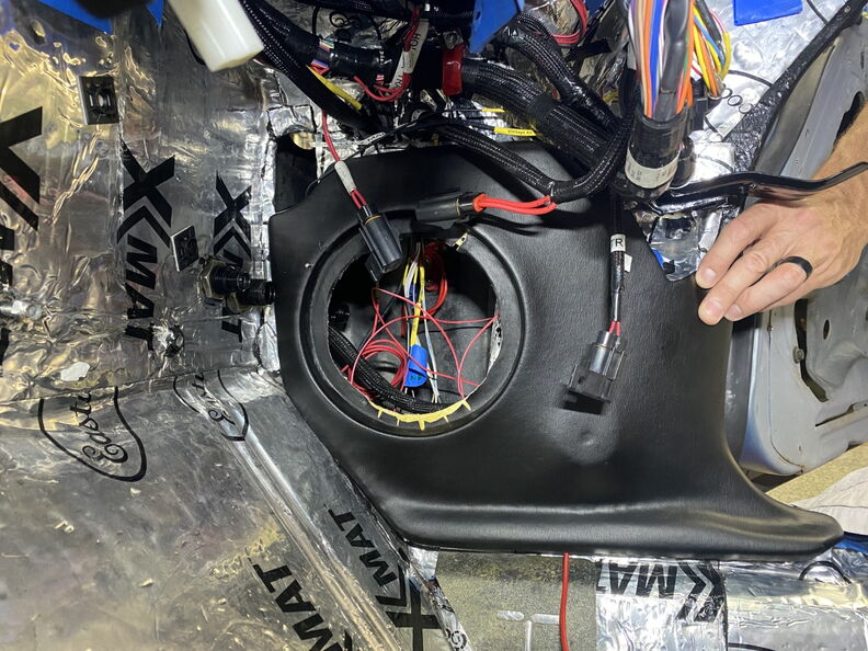

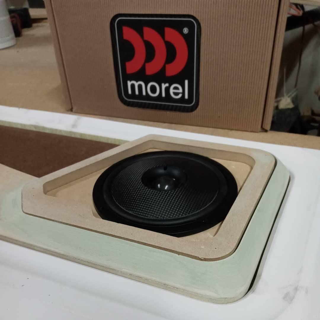

      Playing with the Kick Panels ( 07-31-21 )

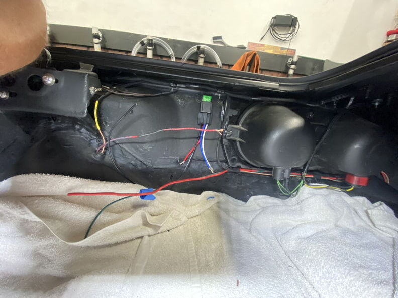

      Seriously, I forgot how nice these look.
      Plenty of room to seal off the cowl panel and install a set of shallow mount speakers.

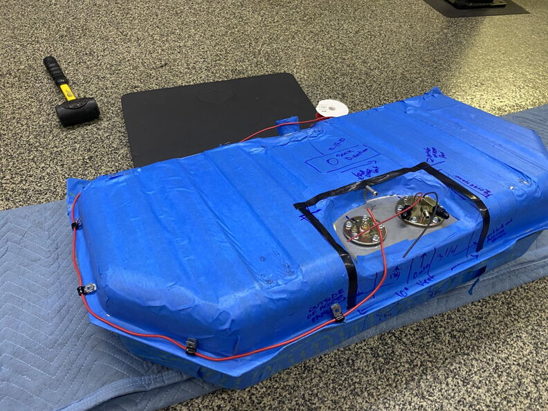

      I wanted to start with an easy task so I labeled a few more wires under the dash.

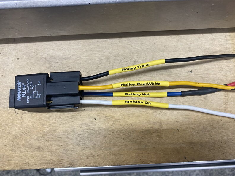

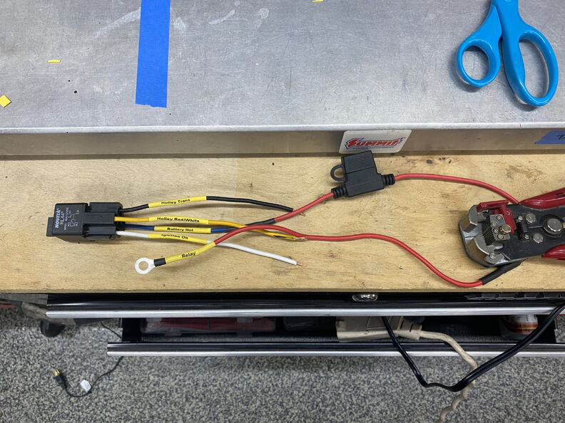

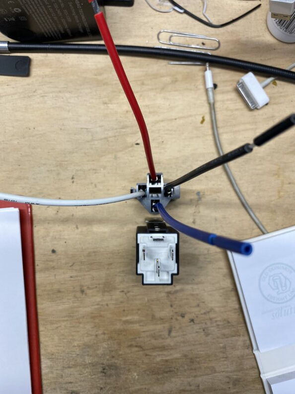

      Then I moved onto the Holley Trans relay wiring.

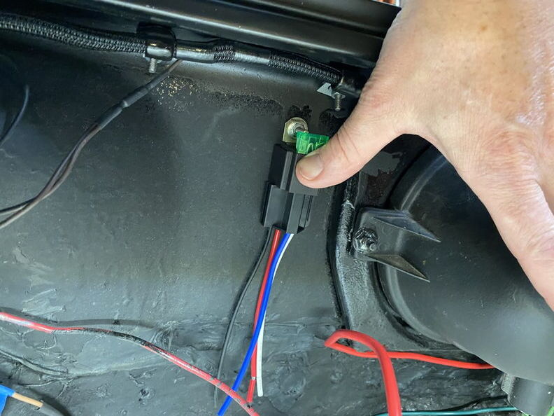

      This will end up getting it's power from the power lug in the passenger side cowl panel.

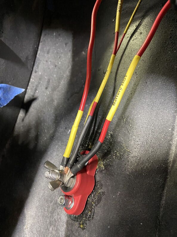

      Just a couple wires on the new power lug.

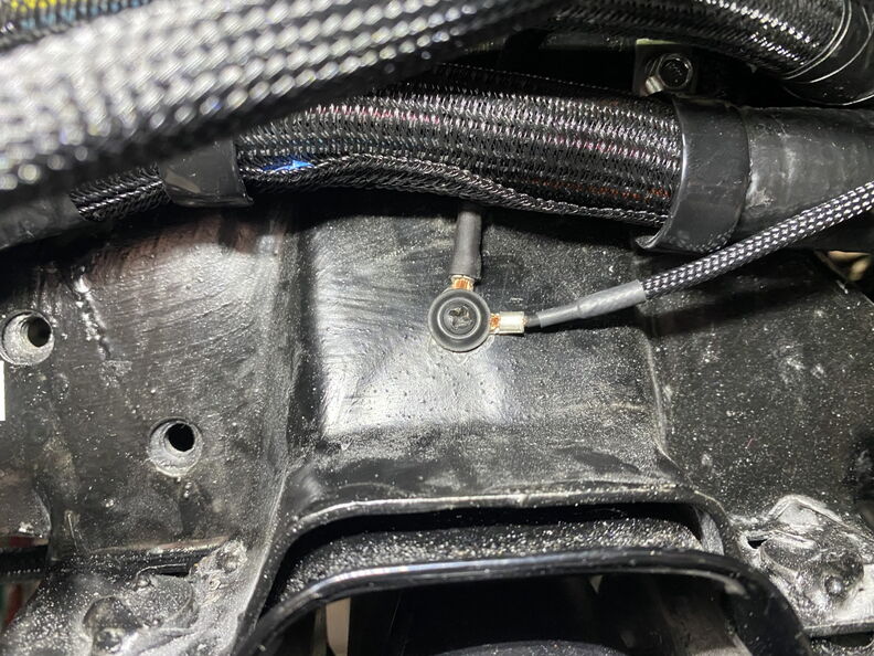

      I wanted to make sure all of my grounds had contact with bare metal.
      Now it does.

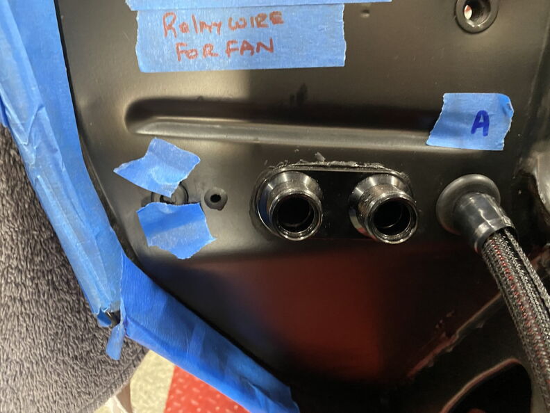

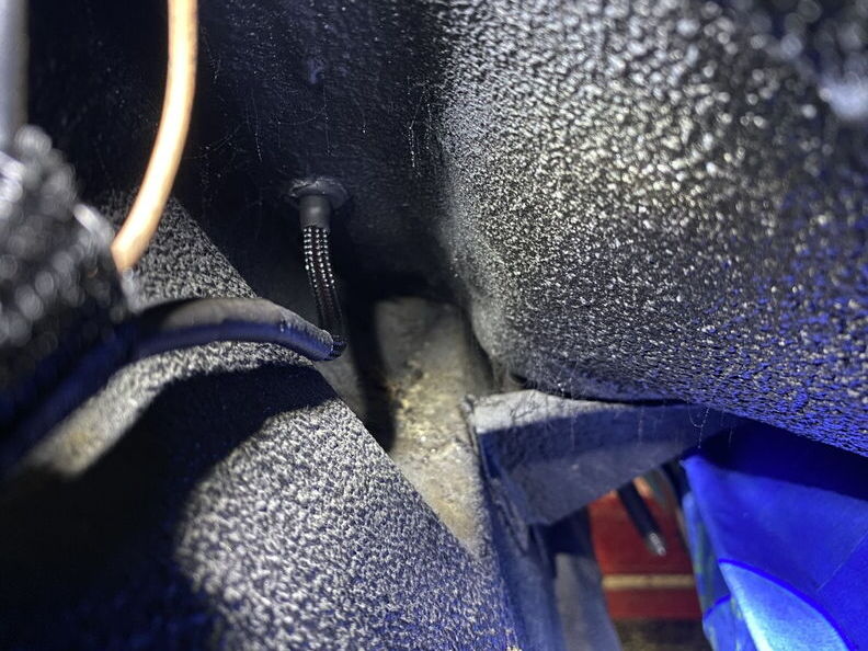

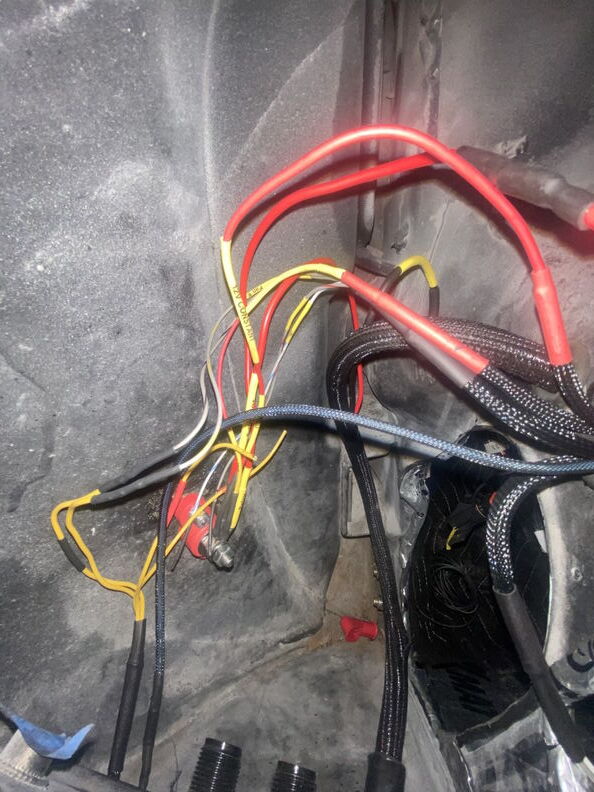

      Remember all those Yellow Wires ( 08-07-21 )

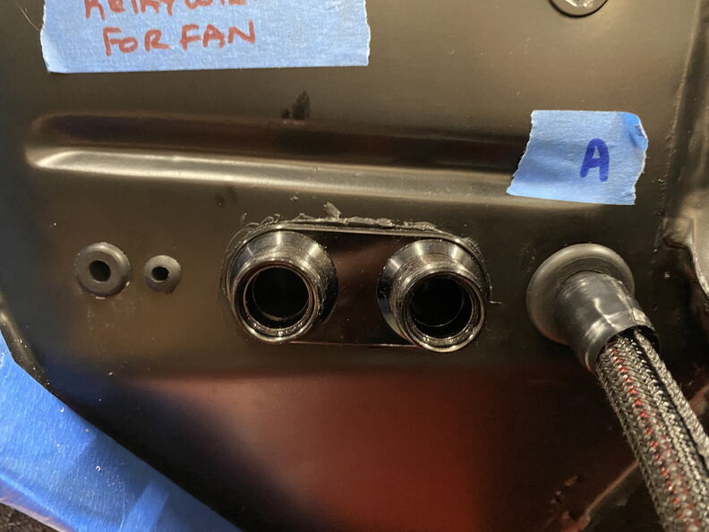

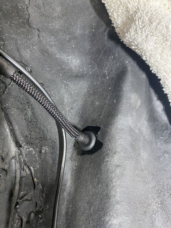

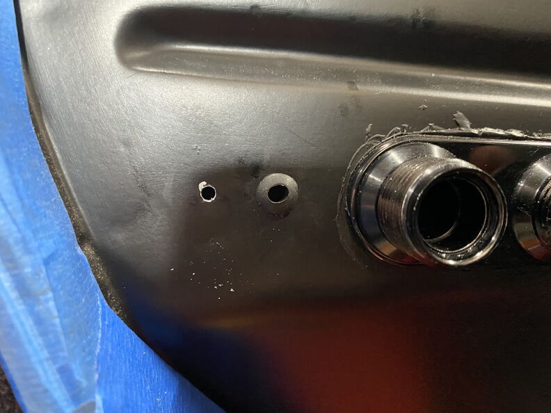

      So you remember all those yellow wires well they need to go somewhere.
      Which means I need to drill another hole in my freshly painted firewall.

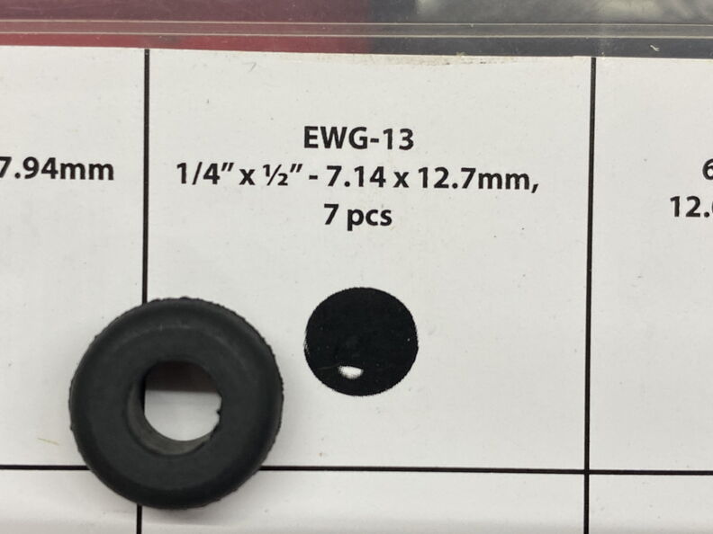

      Just in case you someone else needs to do the same here is the grommet I used..

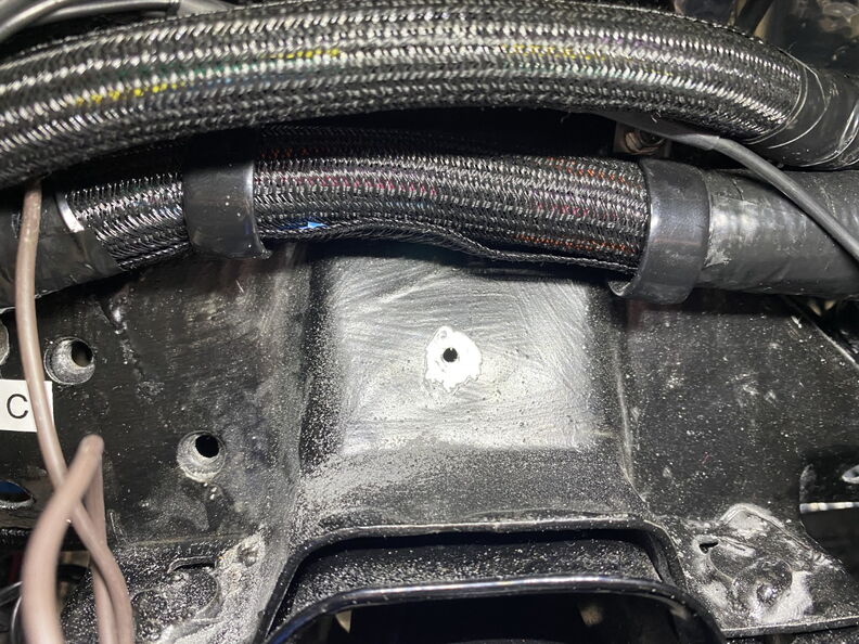

      If you have been following along I had a close call with the drill bit hitting the wire harness.
      So this time I removed the blue wire that is passing through the firewall.
      I connected two of the wires to the ECU as I will be using them to trigger the Fan and to turn off the A/C if it is running (still need help with this one).

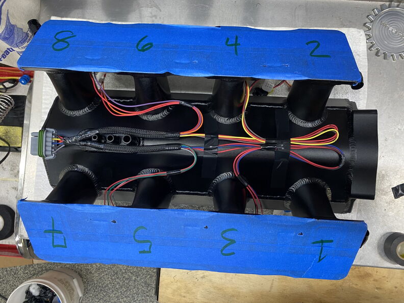

      I am starting to like the aesthetics of the wiring harness ( 08-12-21 )
      Admitting you have is the first step and I have realized that I have a problem with the wiring.
      Which means I am going to keep playing with it till I get it to look the way I want it.

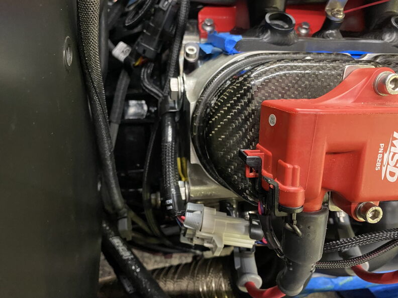

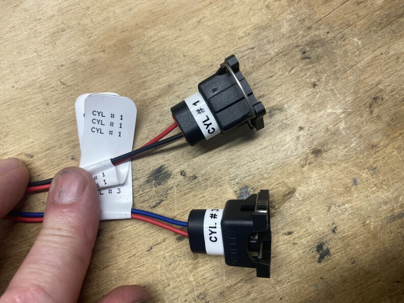

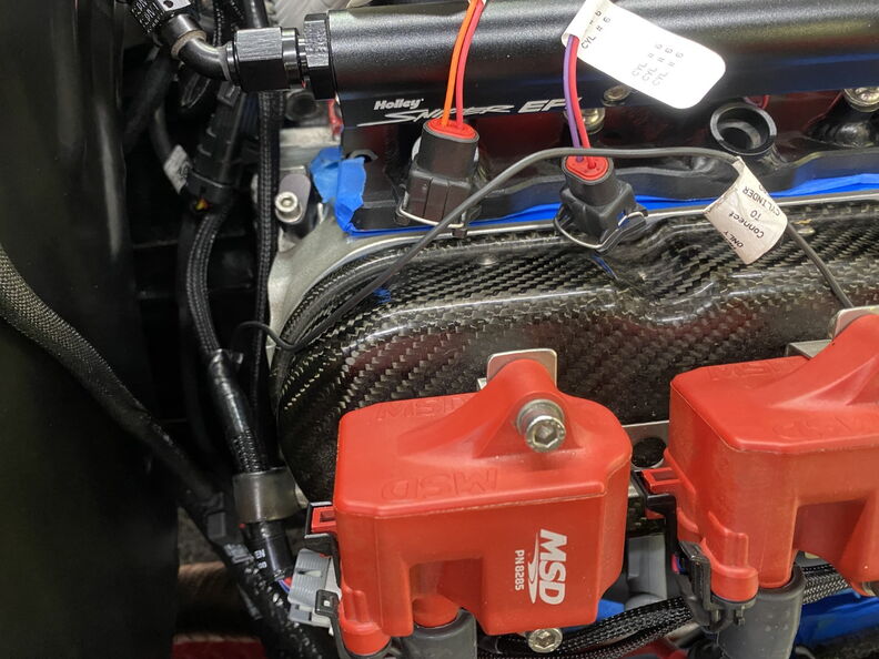

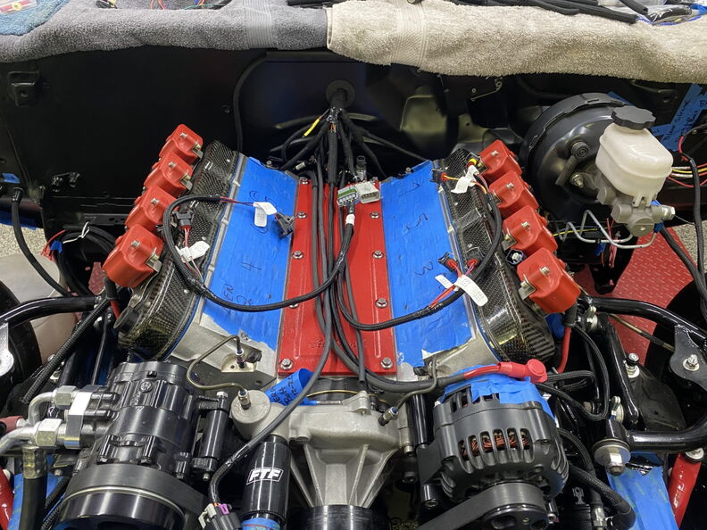

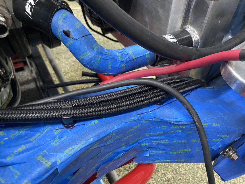

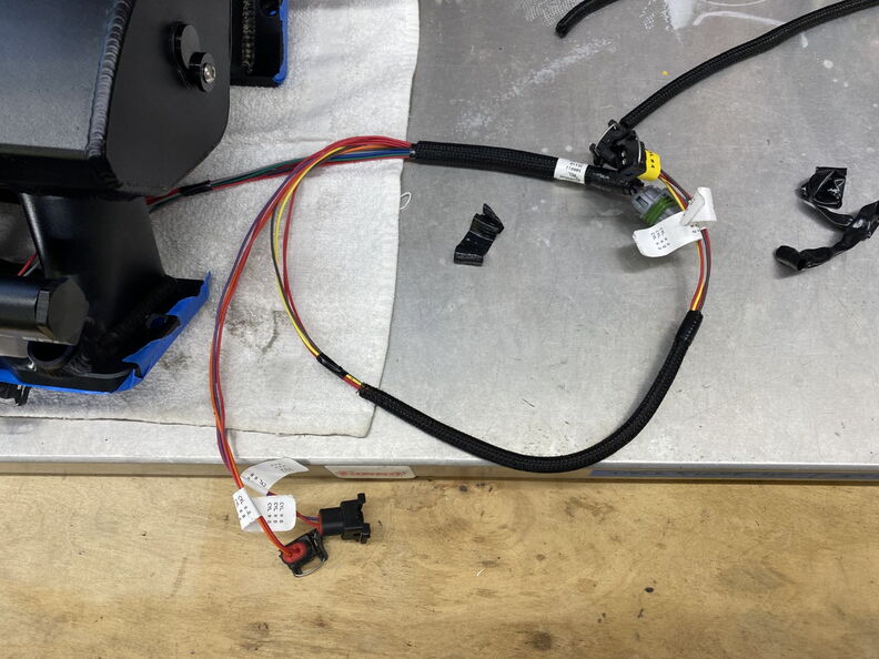

      Playing with the Injector Harness

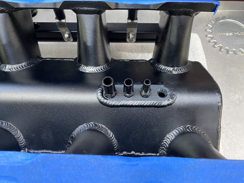

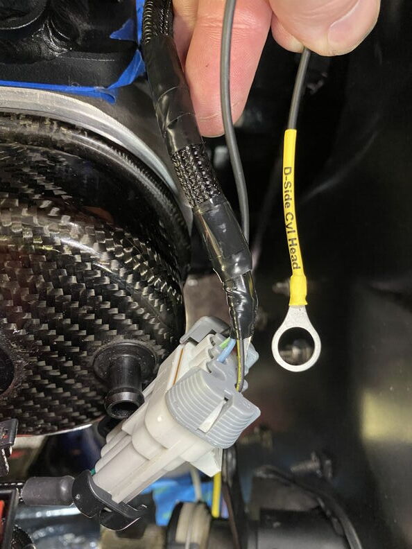

      So I have a question for Holley. Why on Gods Green Earth does the Cylinder head ground wire need to be 18" long when it is only 4" away from the dang bolt they want you to connect it to. Then why would they give a ring terminal that is way to freaking big for the wire.
      Second complaint. Seriously these fitting would be nice great if you could actually use them. If you actually tried to connect a hose to them it wouldn't allow you to bolt the intake manifold to the heads as it holds the intake up 1" because they hit the valley cover.

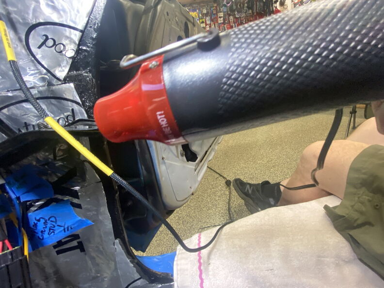

      I installed 1/4" Tech Flex wrap since the 1/8" Split Loom wrap isn't available right now. But heck by the time I finish this car they might offer 1/16" wrap.

      Holley Fuel Pump Relay ( 08-17-21 )

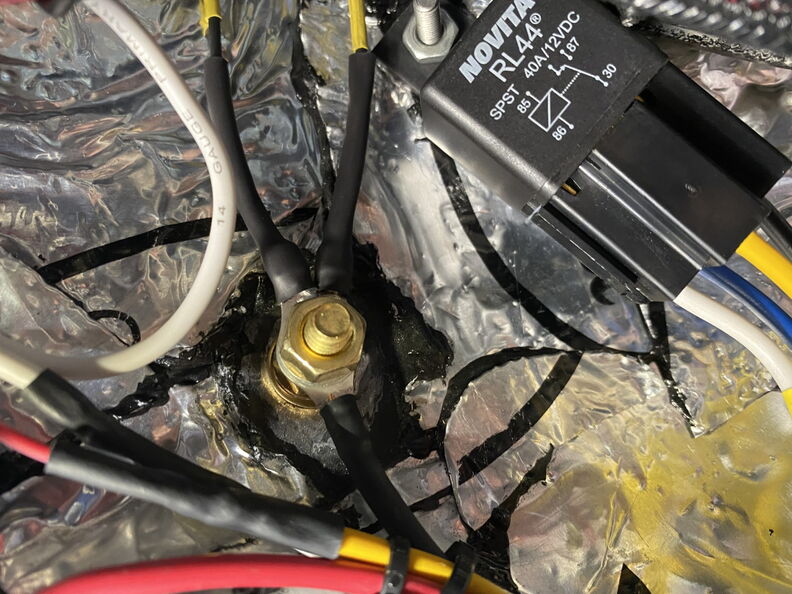

      I am installing a relay in the trunk for the Holley In-Tank pump. I decided to purchased
      an extra relay that I will keep in the car just have a back up for road trips.

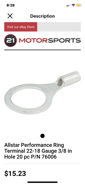

      Remember my complaint about needing a ring terminal for the Cylinder Head Ground wires. I finally
      found someone that had them in stock and it wasn't Amazon It was Ebay. I have extra's if anyone needs a set.

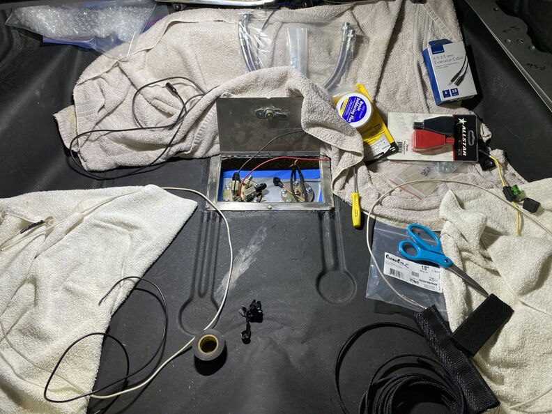

      Holley Fuel Pump Relay ( 09-05-21 )
      Took two weeks off from the car due to family life. But now I am back at it after work and riding.
      I have some company in the garage with me today. However who new it was nap time.
      Trying to fund a good location for the fuel pump relay.
      Since the car is already painted I once again used a Weld Stud.
      Yep, it's messy looking but one I spray in the bed liner coating you will never notice.
      More wiring.
      I had to extend the fuel sending unit wire.
      There is now way this was a good ground.
      More notes
      I will be back tomorrow one the Epoxy dries.

      Fuel Pump Relay Final Wiring ( 09-06-21 )
      Once again I labeled all of the wires.
      Sending unit wire

      I am struggling with running the wires on top of the tank. I just don't fell like it is safe as the floor pan has been Rhino-Lined and it just seems like the wire are being crushed.
      Time to come up with a new way to route the wires.

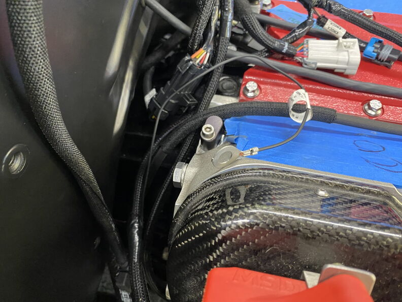

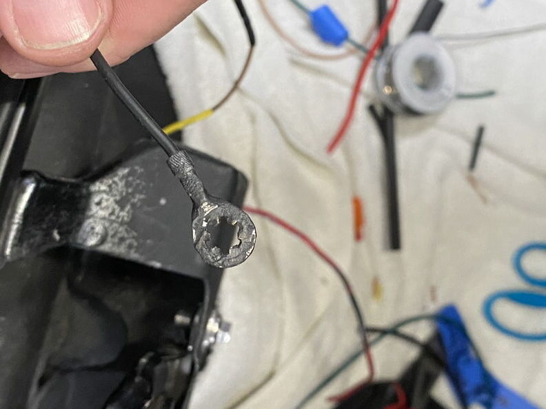

      Since Holley wants this wire grounded to the back of the cylinder head. Why would it be so freaking long when it literally is only inches away from the bolt that it needs to go to.
      Yep, I over stripped the wire.
      I did a better job stripping the wire on the passenger side.
      Well, Remy fell asleep as it was a beautiful day.
      Ran the last couple grounds to the brass bolt that is grounded directly to the battery.

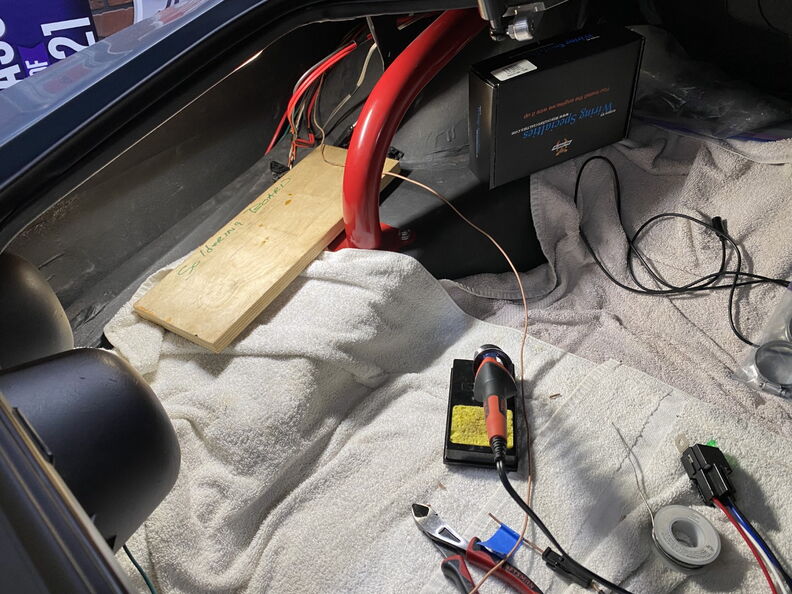

      Fuel Pump & Sending Unit Wiring ( 09-20-21 )
      So I went back out to the garage after talking with a few guys about how they wired there in-tank pump and I decided to try what they have done.
      I individually wrapped each wire in Tech Flex Sleeving to protect the wires from abrasion.
      It's definitely better so I am going to sleep on it and see how I feel in the morning.
      I also ran the sending unit wire next to the power & ground.
      marty-mj
    18. #798
      Chicago
      2,788

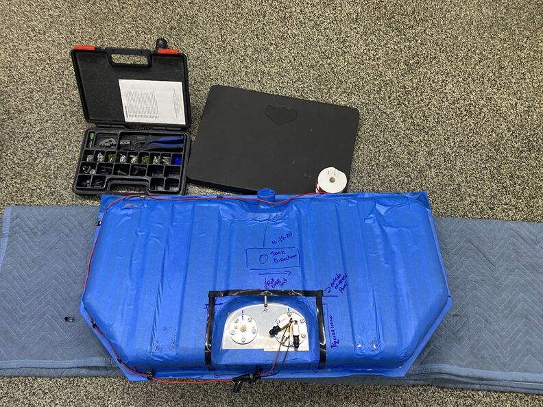

      Fuel Pump & Sending Unit Wiring Continued ( 09-21-21 )

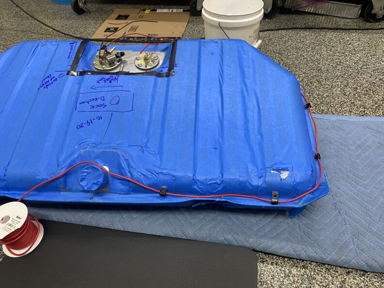

      Back to Plan "B" or is it Plan "C"
      I plan to run the wires around the tank and secure them with the "Weld Studs" in multiple locations.

    20. #800
      Oct 2011
      721
      Why don’t you run the wires through the groove in the tank?
