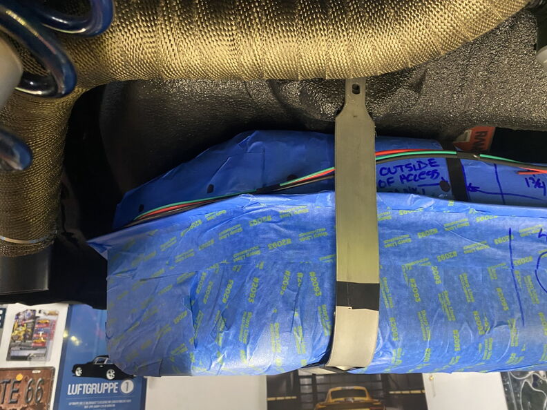

      Quote Originally Posted by joeko23 View Post

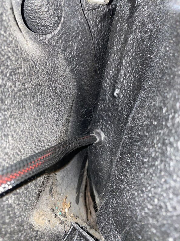

      Why don’t you run the wires through the groove in the tank?
      The tanks are designed for only one wire (sending unit). You will see when you install your tank you can’t even move that wire meaning it is trapped between the tank and floor. Then add in the fact that my floor pan is Rhino-Lined. It just makes it worse.
      marty-mj

      I ran all my wires through the grooves without any issues. I’m able to freely move them back and forth. Maybe because I have a ricks restomod tank, the grooves are slightly deeper than stock?
    3. #803
      The top of the holley tank is depressions that line up with the ridges in the trunk floor and there was one spot that looked like it was doable but that was also a no go. I really think the Rhino line is the issue.
      marty-mj

      5,560
      Can you sand down/smooth the roughness where the wires are going to run to keep them safe? Then tape them down with some kind of tape or even Eastwood mat you used. If your worried about the mat sticking to the wire you could leave the backing on in between to strips to stick it down.
      You could also space the tank down a quarter inch with something stuck to the tank right where the mounting straps go, it shouldn't make any difference in the mounting.

      2,788
      All good ideas but I’ve committed to wrapping the wires around the tank. Plus if there is ever an issue I won’t have to lower the tank down to remove the wires.

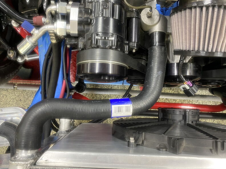

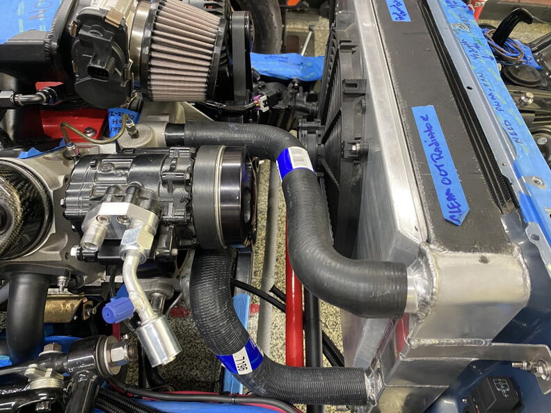

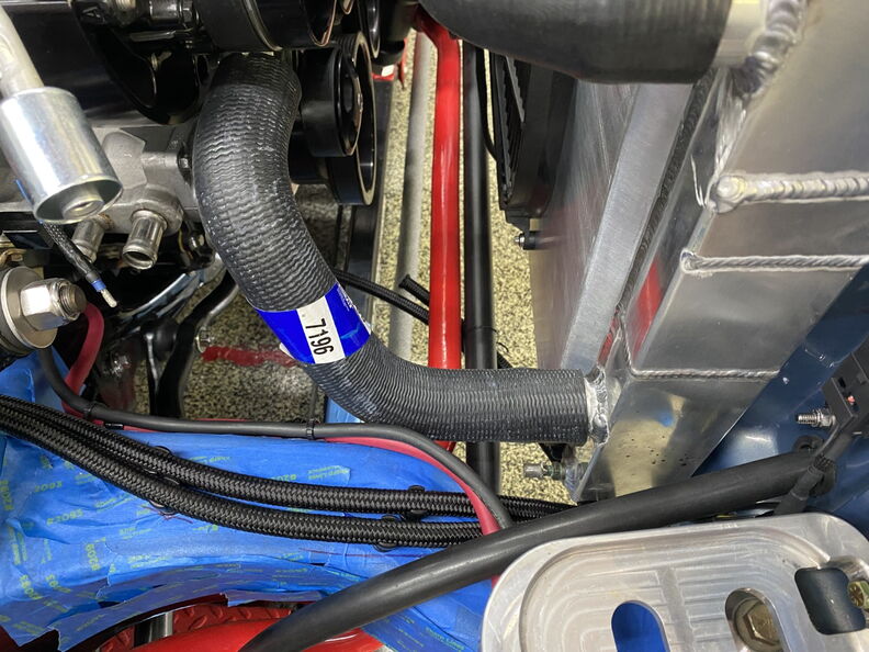

      While I was at Good-Guys Columbus I ran into a gentleman that found an over the counter radiator hoses solution that may work in my car. I ordered them up to see how close they would be on my car and they look pretty good.
      Attachment 194043
      Attachment 194044
      The lower looks good but it will need a swivel neck for it to work correctly.
      Attachment 194045
      Marty
      I think those radiator hoses do go pretty good. You got alot more clearance than I do. My ac compressor to fan shroud is only 2.75 and my water pump and other vicinity pulleys about 3.5. I'm running a c and r radiator, had the high profile fans but had to order mediums. I just test fit and it's tight but I'll have about an inch between fans and the tightest pulleys. I sety dingo sliders and Speedtech engine stands back as far as both would go. I should have re fabbed them like everything else but I'm tired of redo and hard charging forward.

    8. #808
      Chicago
      2,788
      Quote Originally Posted by TANKMASTERJ View Post
      Now that my engine is in and the ls Harness feeds it people can get a feel for my industrial look with harness and hoses.
      Your work even in wiring looks very classy and we'll planned out.
      Love your car it's bitchin
      Thank You Jason I appreciate the kind words.
      Marty
      Jason
      I ordered a swivel lower water pump neck and it looks like it will really help with the alignment of the lower hose. I am hoping to have the radiator back in this weekend and hoping it works as planned.

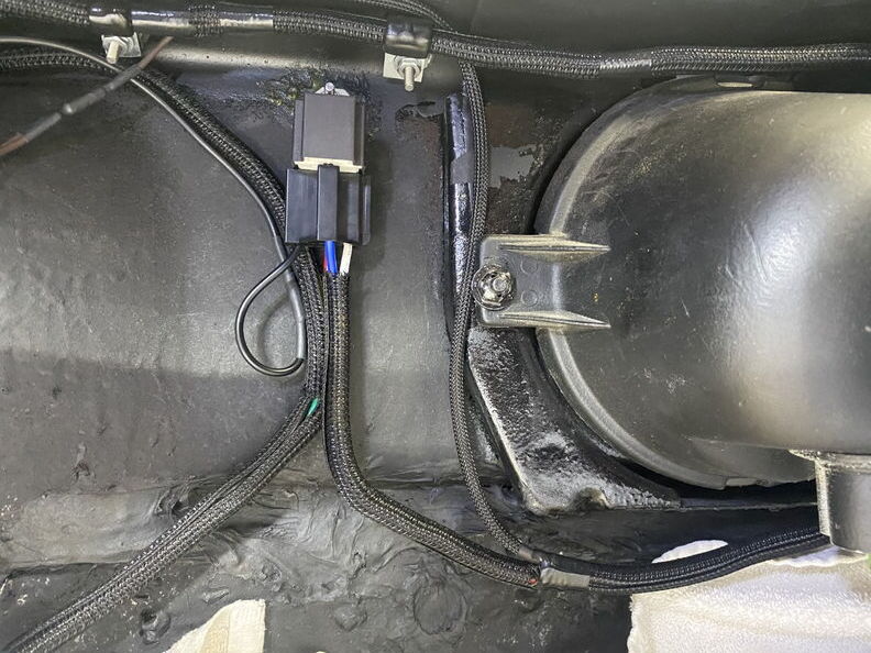

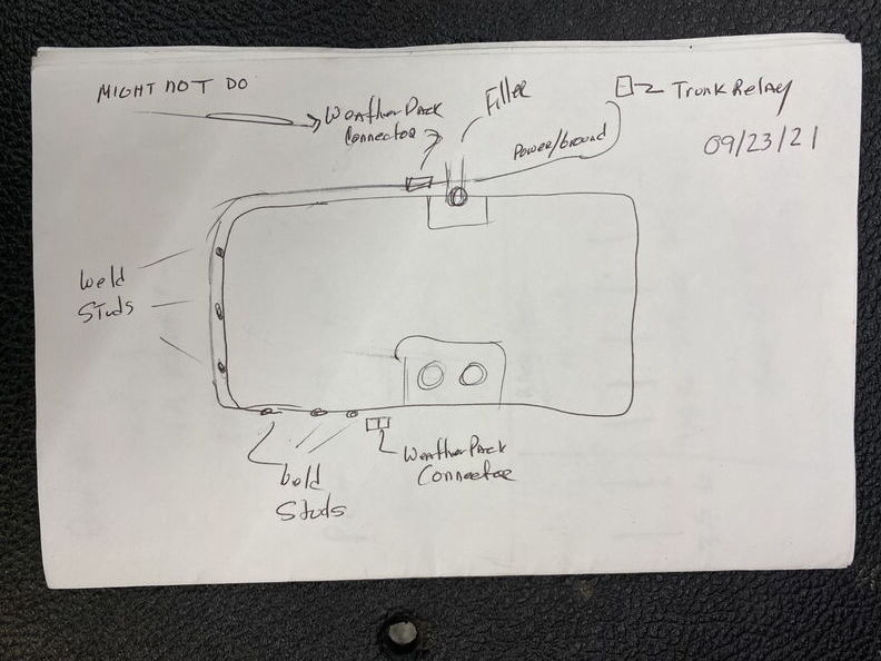

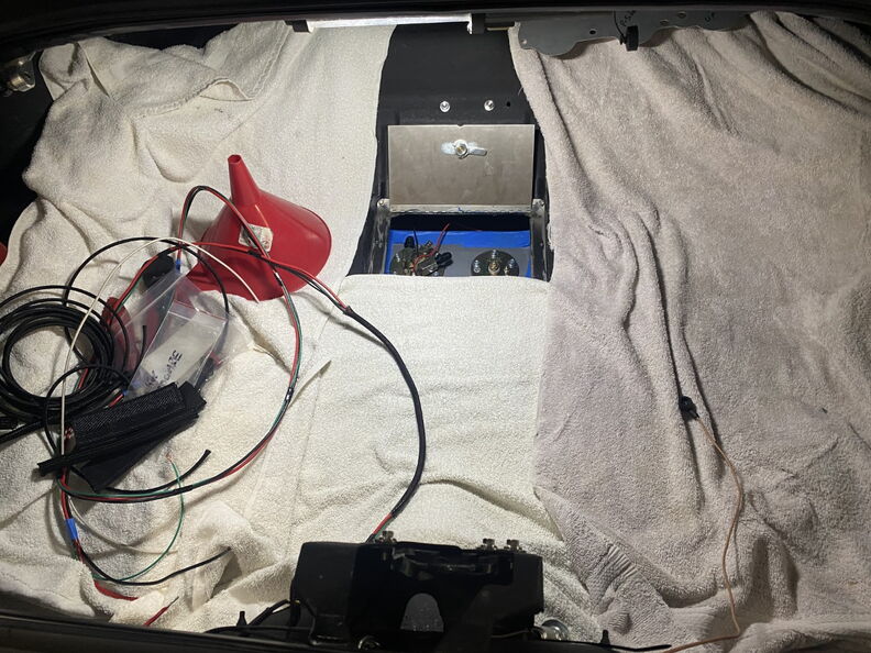

      Fuel Pump Wiring Concept ( 09-23-21 )
      Time to run some wires

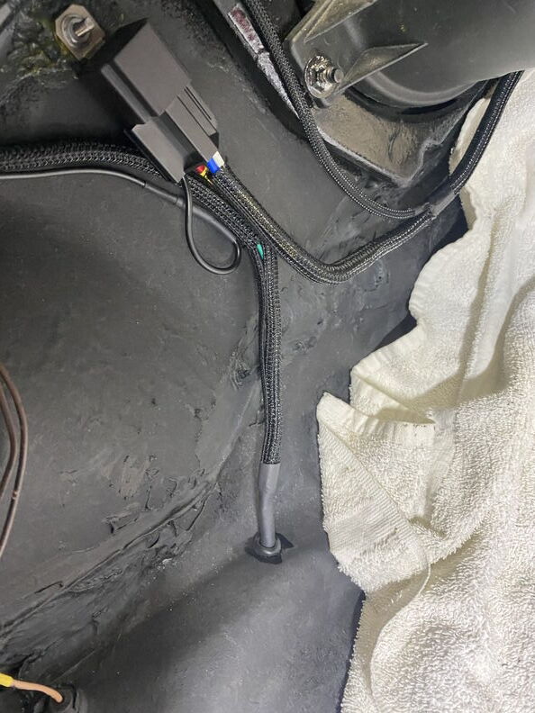

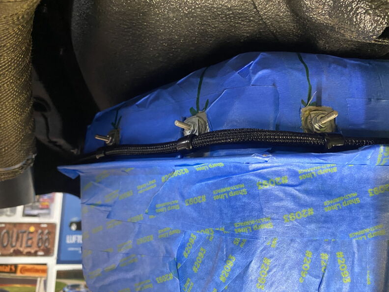

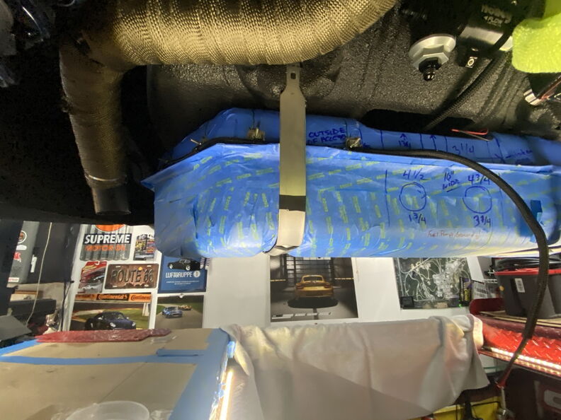

      I plan to install a weather pack connector in this location so if I have to remove the tank it will be easy to access.

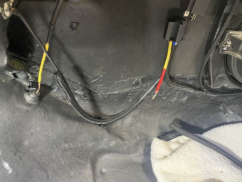

      Back in the trunk to make sure the wires coming out of the tank are long enough.

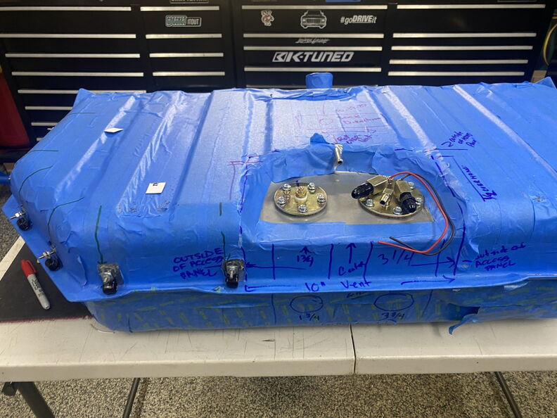

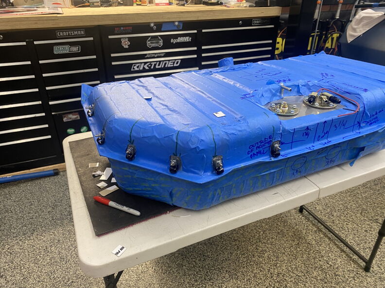

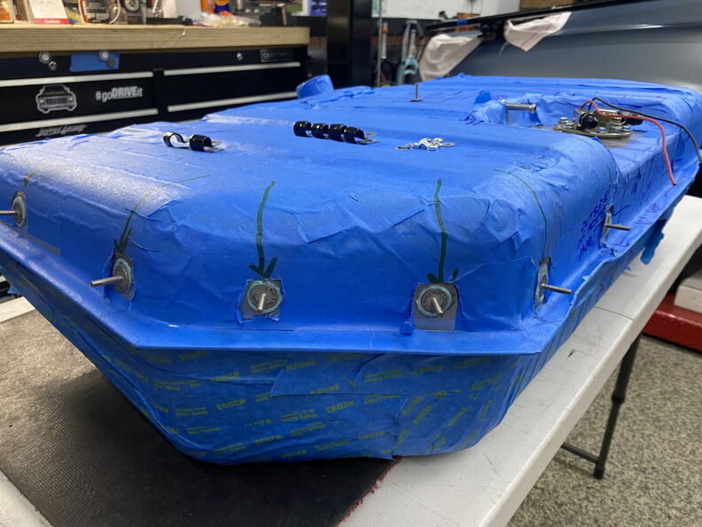

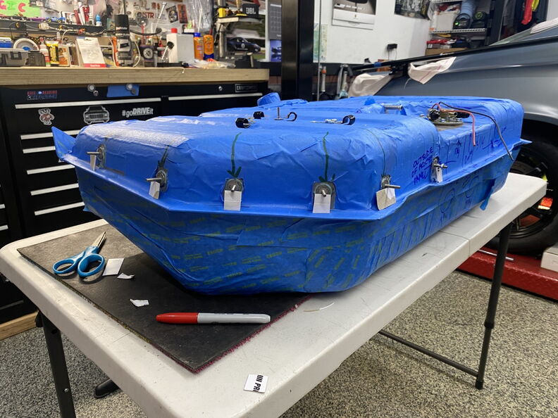

      Weld studs are installed I will clean up the excess once it dries or is it hardens.
      I had to make chipboard stands to keep the weld studs from sliding down. Most likely due to my generous amount of epoxy.

      Tank is going back in and I am going to finalize the wiring to the fuel pump and sending unit. ( 10-09-21 )

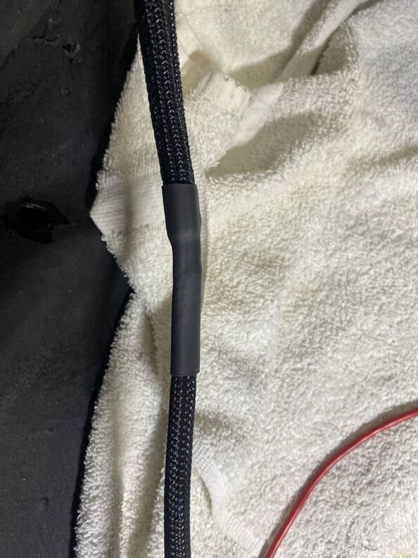

      I stepped the shrink wrap so the grommet would stay in place.

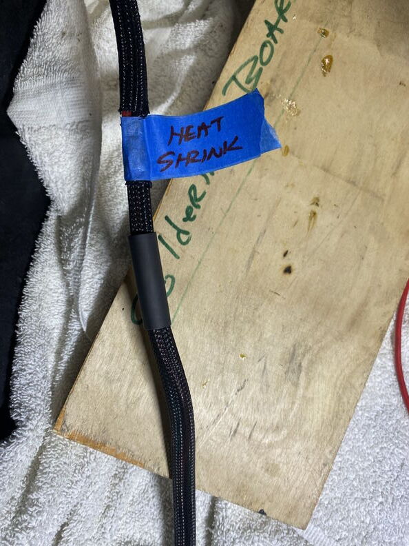

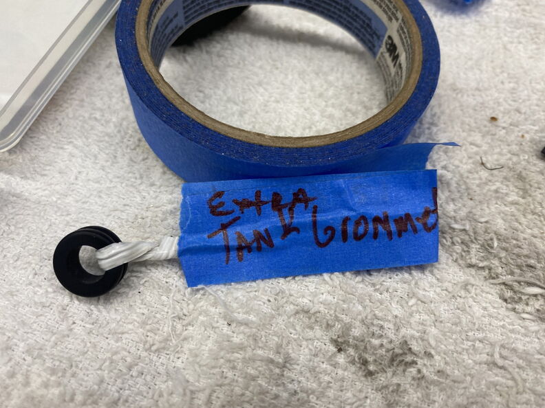

      I also saved and labeled an extra grommet just in case I needed one later. Yes, I am building a service kit for the car that I will stow in the trunk.

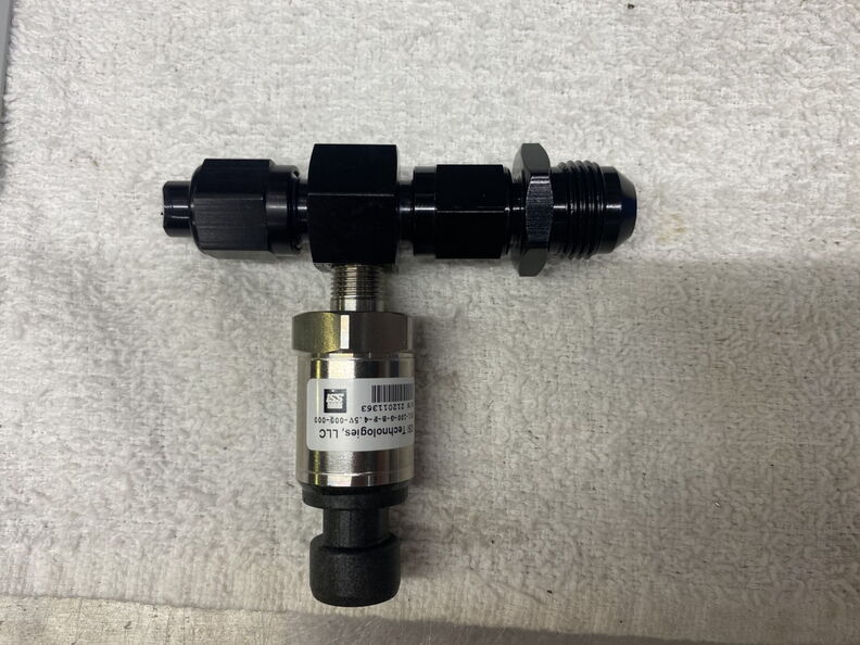

      I finally received the fitting I need to connect the Fuel Pressure Sensor to the Fuel Rail. I am sorry I don't really like it as it has to many points that could leak.

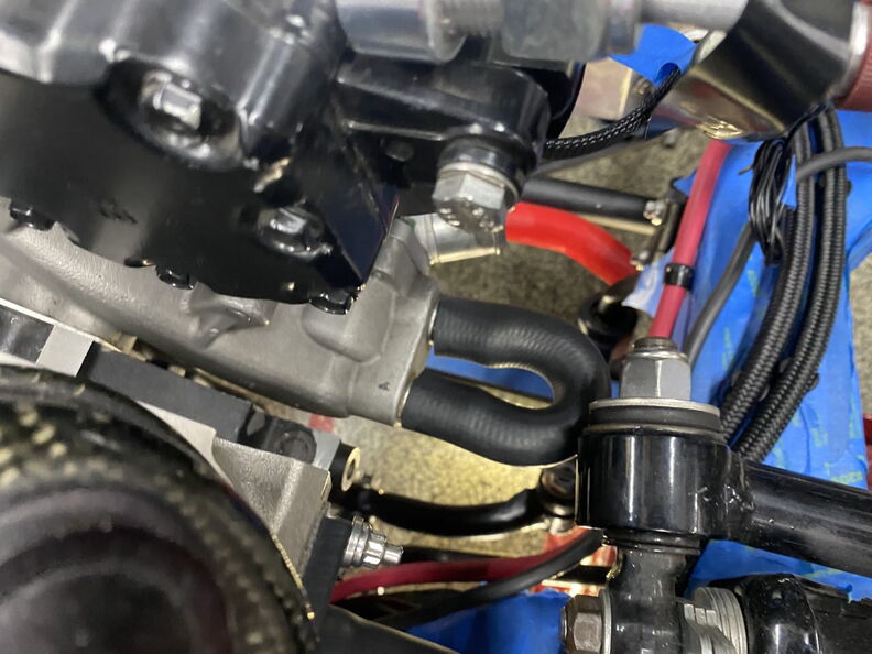

      2,391

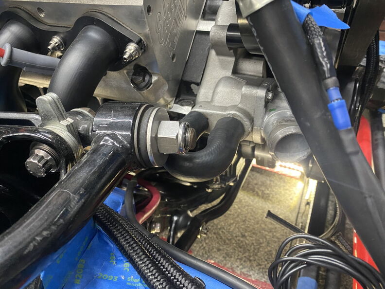

      Is the hose touching the UCA bushing washers? Would it if you add more shims?
    18. #818
      Chicago
      2,788
      Quote Originally Posted by NOT A TA View Post
      It’s just the picture angle. Thankfully there is plenty of clearance.
      Didn't think you'd let it rub, but due to the pic I figured I'd mention "just in case". Carry on!!! ahahaha A lot of us are watching even though we may not post in the thread often.
