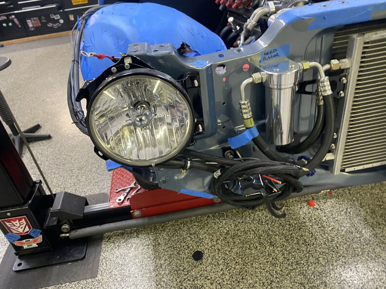

      I don't have long term review, just clicked about 5k miles after install, but is doing great. I've done some really sketchy driving and can't say anything bad, no difference in feel between it and steel line. Been checking line condition, joints for leaks, fluid level, etc. The lines are great so far.
      Running the lines/bending/flaring is a cake walk. It bends smooth and is soft enough to manipulate by hand if needed. If you do get it, run double flares as single doesn't want to seal well, tubing is thinner than steel.
      I was going to comment on your front tee fitting, I went with something a little more fun.
      https://hosting.photobucket.com/albu...unds&crop=fill

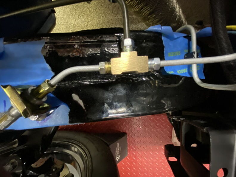

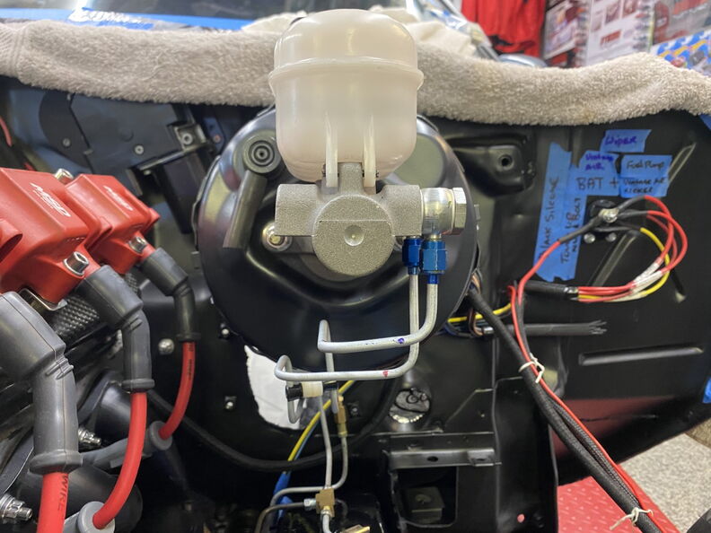

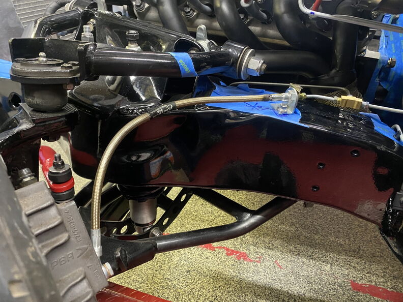

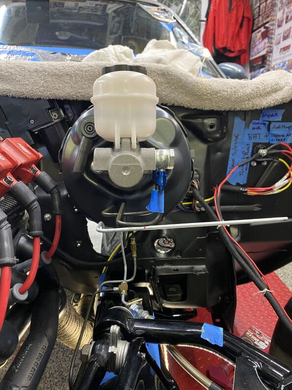

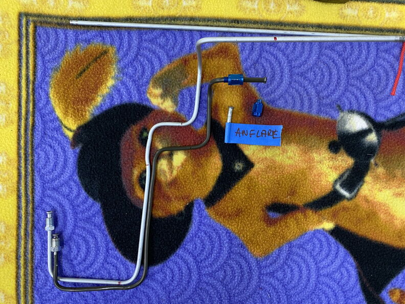

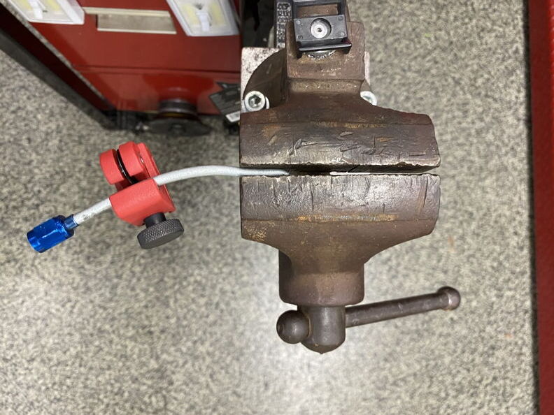

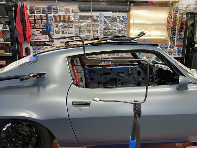

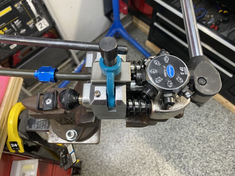

      Not Going to lie bending these lines scares me (( 11-27-20 ))
      As the title says I am a little bit nervous trying to remake these lines.
      My plan is to take the existing line and straighten then bend it like it needs to be since I moved things around a little bit.

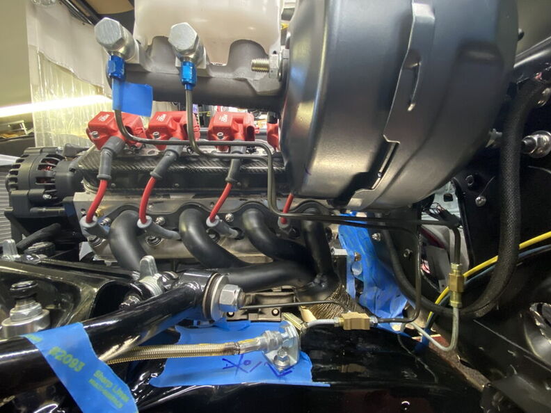

      Okay it worked

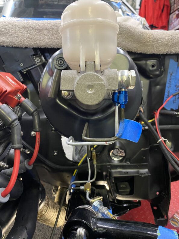

      Here we go
      I need this darn fitting !!

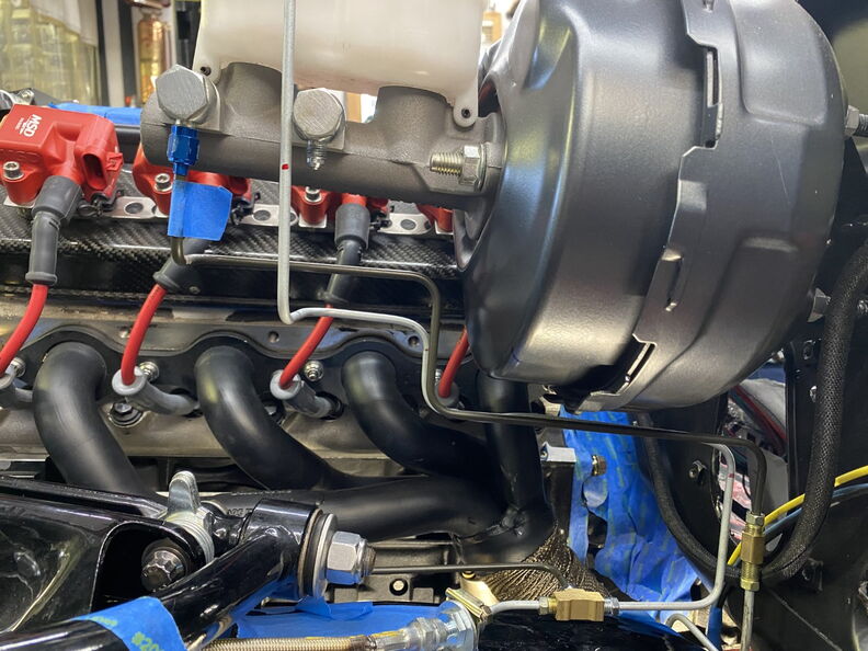

      I am very happy for the outcome of line # 1

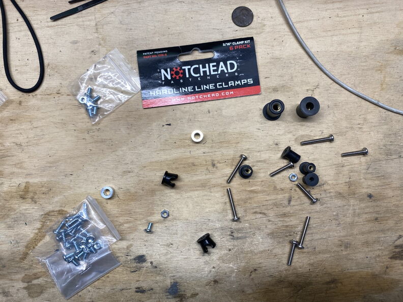

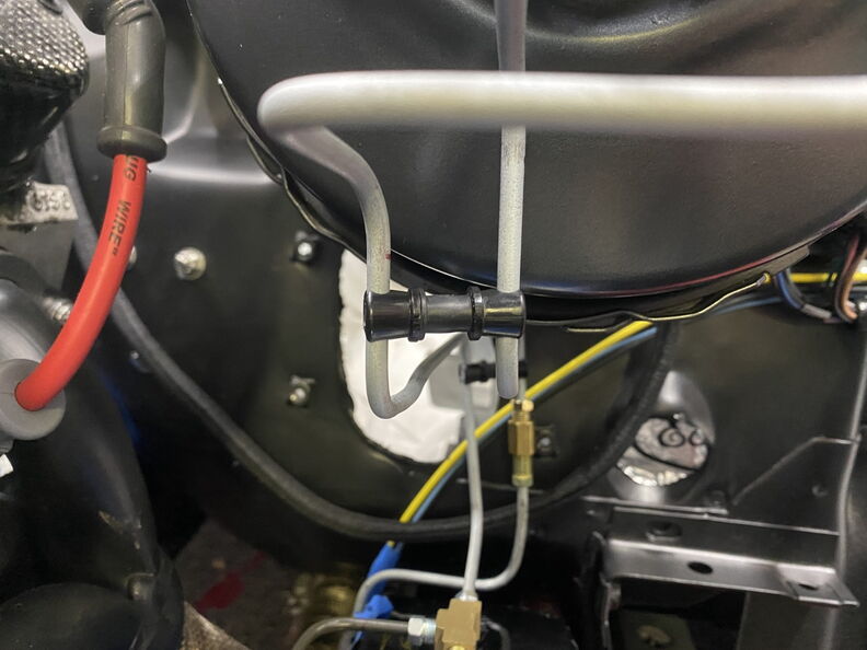

      To keep it clean I am going to use the Knotchead line clamps to secure the lines together.
      More to come later as I want to get home so I can work on the car tonight.
      marty-mj

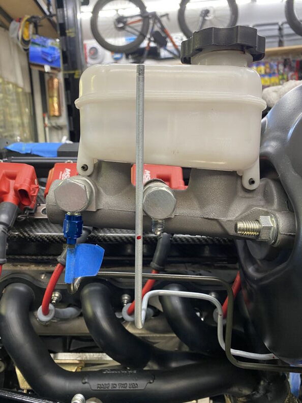

      Chicago
      2,788

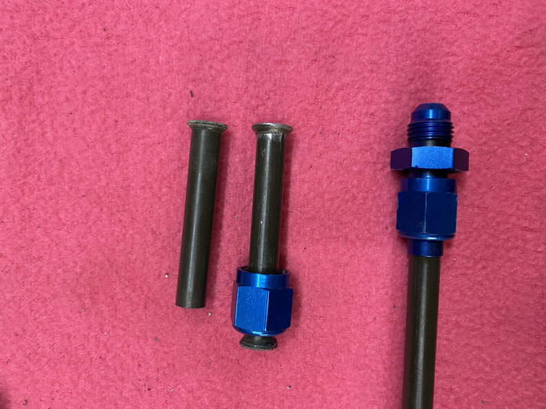

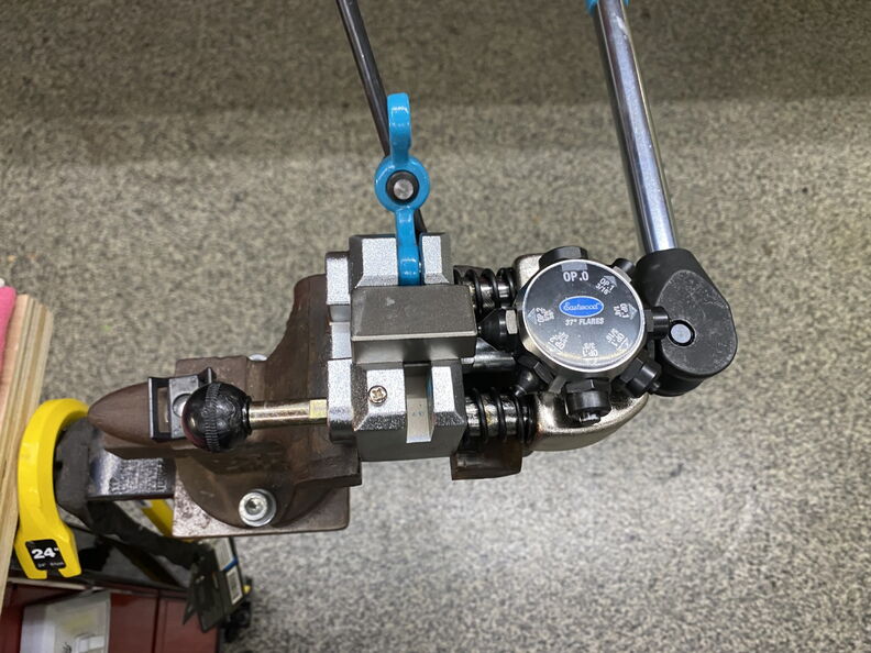

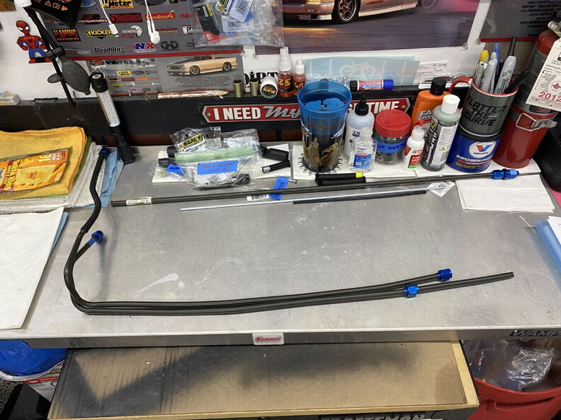

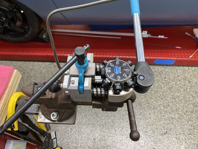

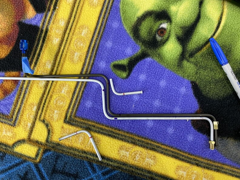

      Practicing flaring some 3/8" line with the new tool (( 11-27-20 ))
      Time to flare some 3/8 line

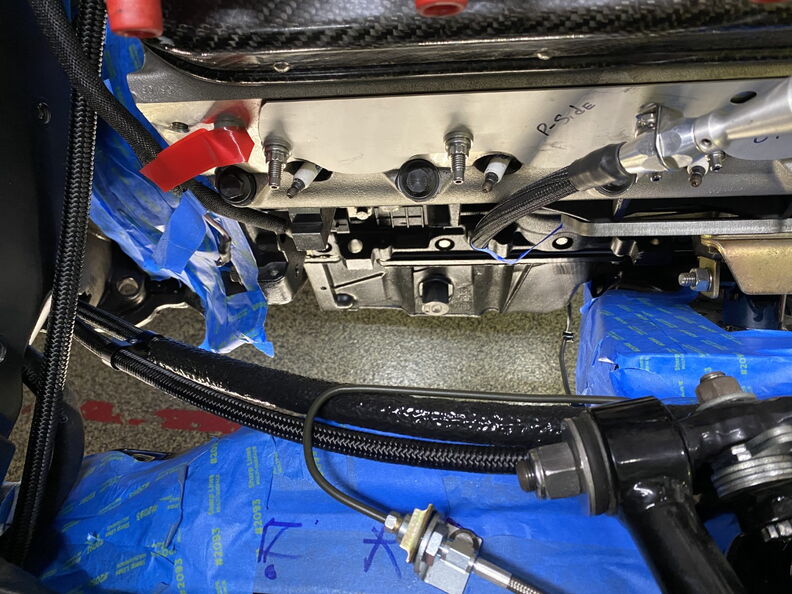

      Back to mocking up the trans lines.

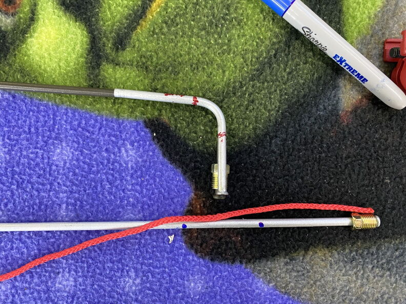

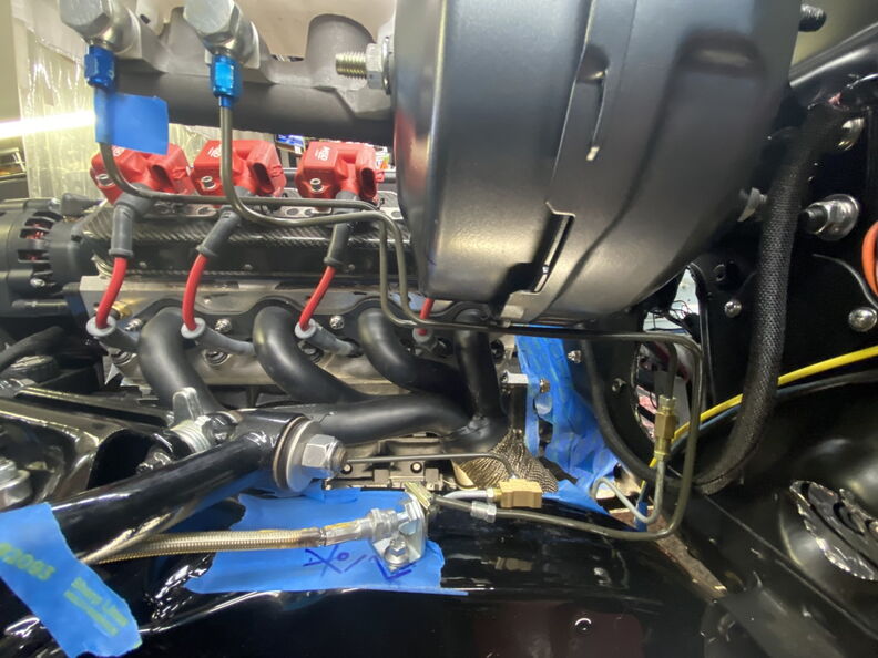

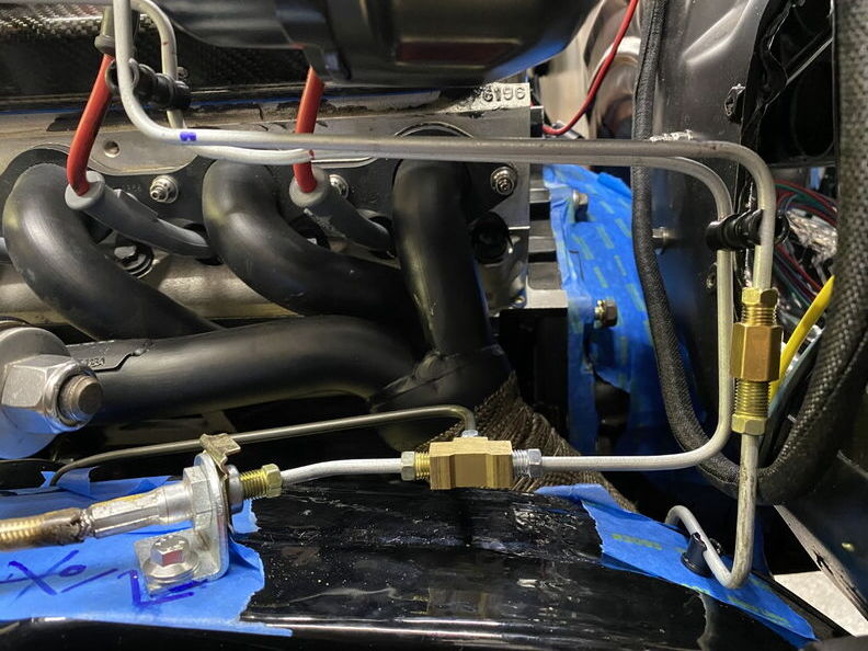

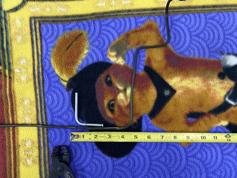

      Since the rear line didn't match I remade it so it would. (( 11-28-20 ))
      Using some the bend templates that I made helped to make this a much easier project.
      The good news is I did it in one shot with what I have learned so far.
      I wanted to link the lines together so I will be using the Knotchead line clamps. A quick trip to the local Ace Hardware to pick up
      some hardware and while I was there I scored a couple Hot Wheels Syclones. I also stopped a Dairy Queen for a Blizzard.

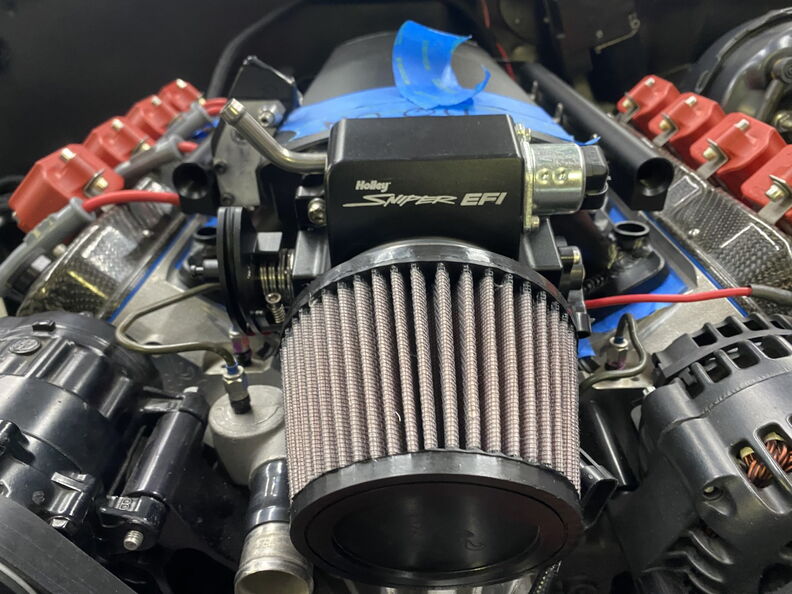

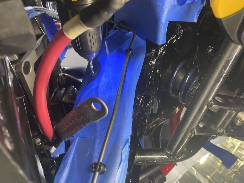

      Throttle Bracket - Still playing around a ((11-28-20))
      Trying to make this bracket a little leaner.
      I think if I trim it down to something like this and get it anodized black it will blend right in. Before I trim it down I need to get a new Lokar throttle cable.

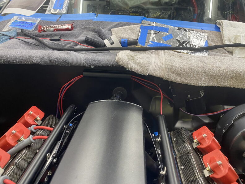

      Radiator ((11-29-20))

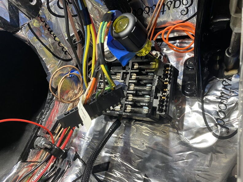

      I want to hide as many wires as possible so the horn wire will sneak behind the core support. I used a piece of door edge guard to protect the wires.
      little bit of an overkill to crimp and solder but what the heck why not.
      Moving on to the Kicker Bluetooth Stereo
      I tried to make the trunk a little more comfortable for me back.
      I need to run a 3.5mm extension up to the center console and the cable for the controller which will be mounted in the lower dash or center console. I won't decide that till I figure where the cup holders are going to go.

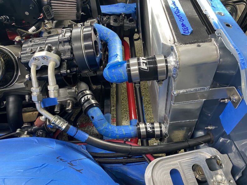

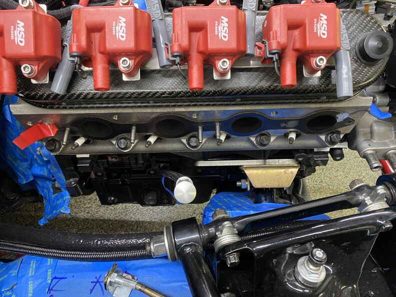

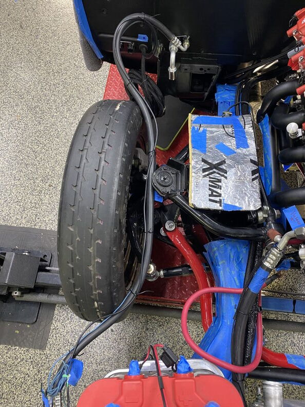

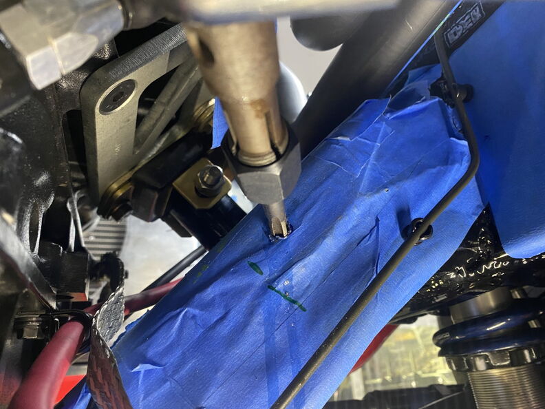

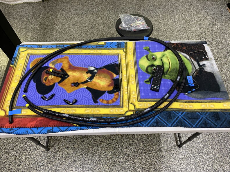

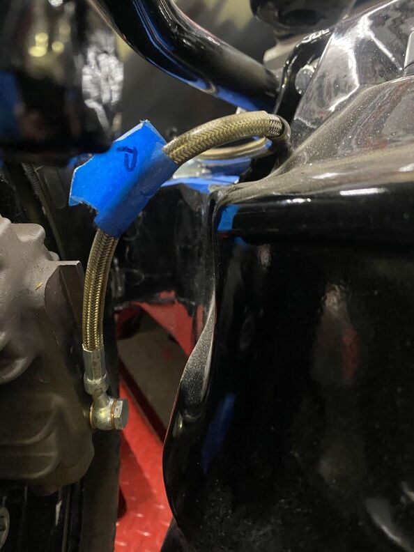

      Trans Coolant Lines & Finally some Holley Fittings
      Since Kenny did such a great job bending these line I am going to use them. ((11-29-20))

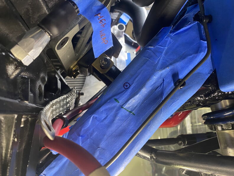

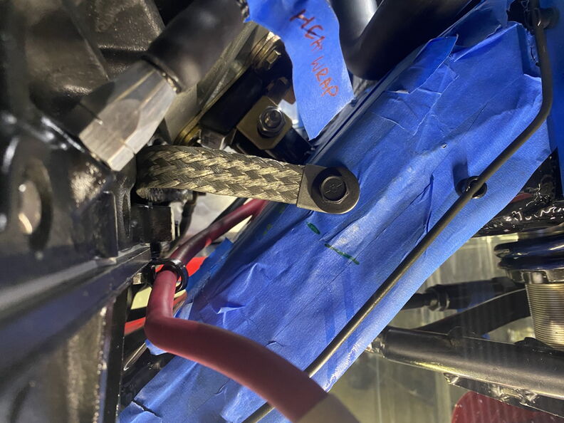

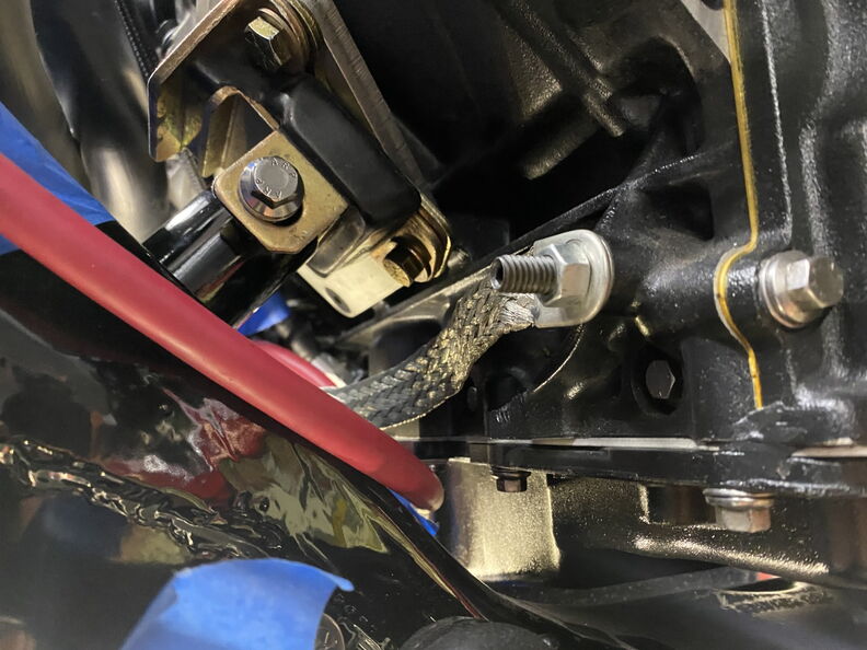

      Header is back out yet again.
      I ran the spindle through it's range of motion and it looks like all is good.

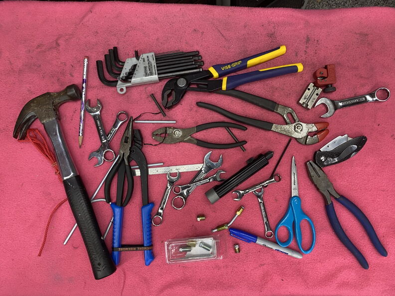

      It's hard to believe I used all of these tools.
      So eventually this brass fitting will be swapped out for a nice chrome fitting.
      and the lines will be painted black so they disappear into the frame.

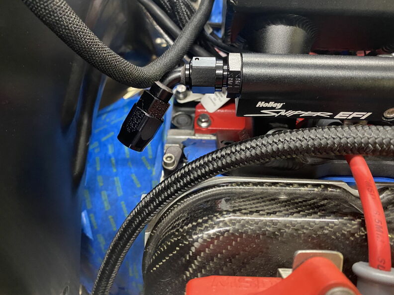

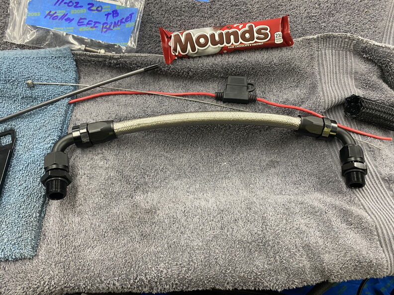

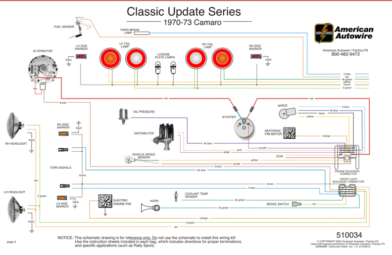

      Holley Sniper Fuel Line -6 (12-03-20)

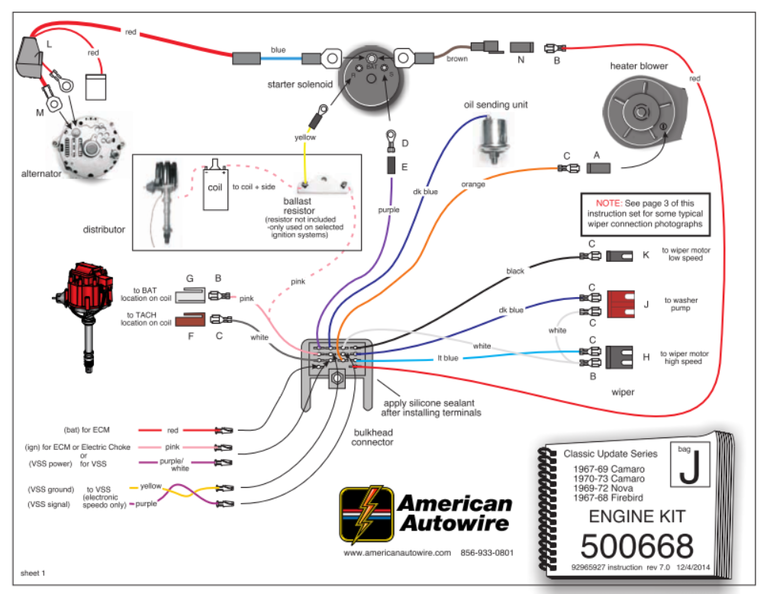

      As you all know I have some issue's and the line that came with the intake doesn't match the rest of the lines. I had considered just wrapping it with the Tech Flex wrap to make it look like the rest of the lines. However, if you run the line under the Throttle Body it is to short and it pulls on the fitting really hard and just doesn't make me feel good. So I am going to make a new line that looks like the rest of the fuel lines.
      When you bring this diagram back out you know it's not going to be fun.

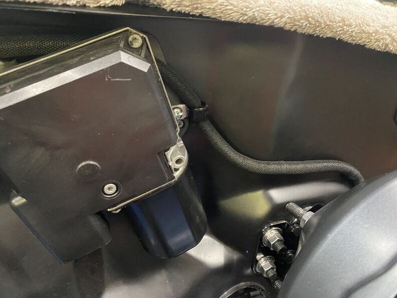

      My goal is to keep the car looking like an old car and not hiding all the wire. However the goal is to make the wiring look clean and like it belongs where it's at and look kinda cool while you are looking at it.

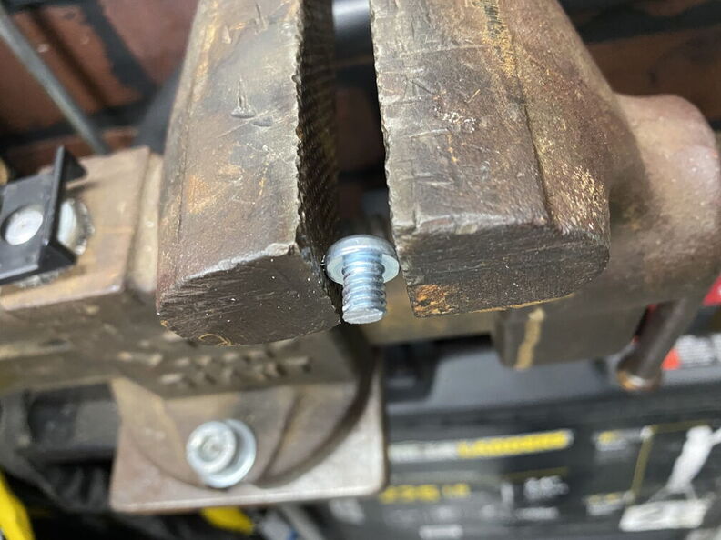

      Since I had no desire to run to the hardware store I cut one of the bolt so it would only go as deep as the DSE Wiper bracket. This was my grandfathers vise and I can't thank my buddy Ben enough for making the mobile cart and removable vise mount. I love seeing this vice every time I am working out in the garage. It brings back some great memories of working with my Grandpa and Uncle Tony in the garage when I was a kid.

      I also wanted to use the factory wire gutter.

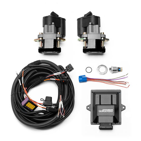

      Things I am considering Wilwood Electric E-Brake (12-19-20)
      So way back when there was a Sema Show I saw this really cool electric e-brake kit. I am going to have to talk with Tobin and see what he thinks and if he has a bracket as I have no interest in creating a bracket.

      Test fitting the coolant lines and AC lines so the inner fender had to go back on the car.

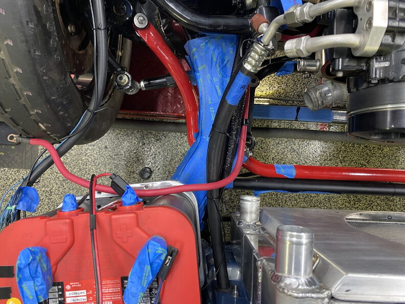

      I also re-ran the battery power but it will have to be shortened so I can add a cut off switch.

      Does anyone know if they make black headlight rings ?

      I found some black line clamps that I may consider using.

      I plan to powder coat my headlight rings black
    19. #719
      Chicago
      2,788
      Quote Originally Posted by joeko23 View Post
      Da !!! I have no clue why I never thought about that.
      Thank You

      Making Good Grounds - Hopefully ((12-20-21))
      So my goal is to have really good grounds throughout the chassis and the body. After spending sometime watch HP Performance wiring video's I am going to take what I have learned and apply it to the car.
      The Ground from the battery runs directly to the stud on the block and I have added a ground strap that goes from the stud to the subframe.
      Of course all the tools came out for this little project.

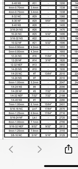

      It's nice having a cheat sheet.
      Not a lot of room to swing a hammer.
      Thankfully the drill fit in the gap perfectly.
      I used plenty of oil while I was tapping the hole as the last thing I want to do is figure out how to get out a broken tap.

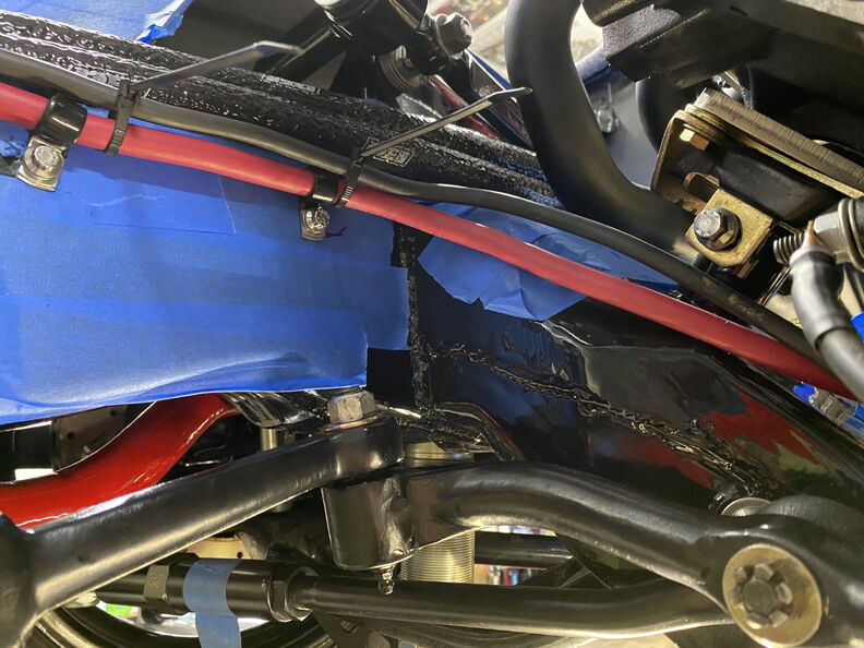

      Once all of the wiring is complete I will remove the tape and remove a little bit of the powder coating under the ground strap. I will also change the bolt that is holding the ground strap.
      Mocking up how the ground wire will run back to the battery.
