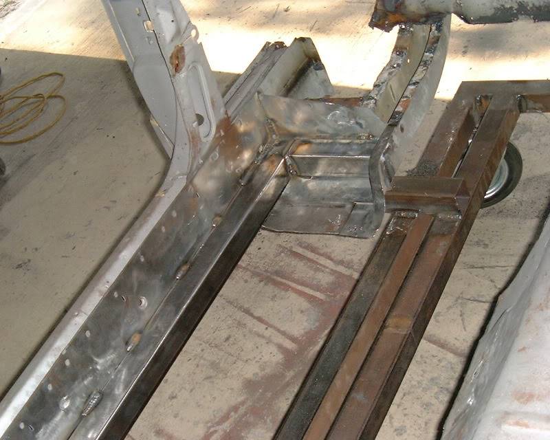

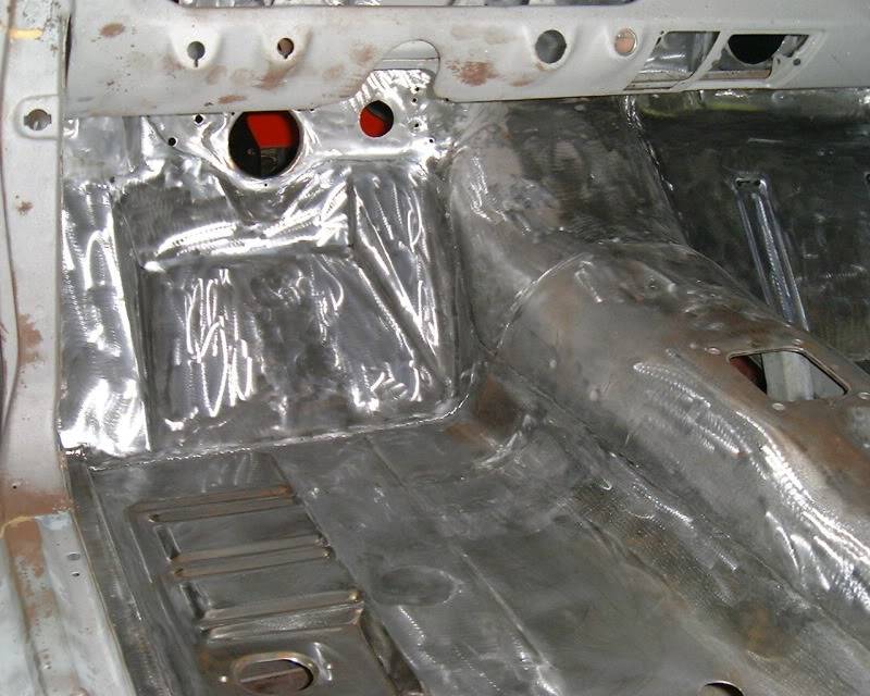

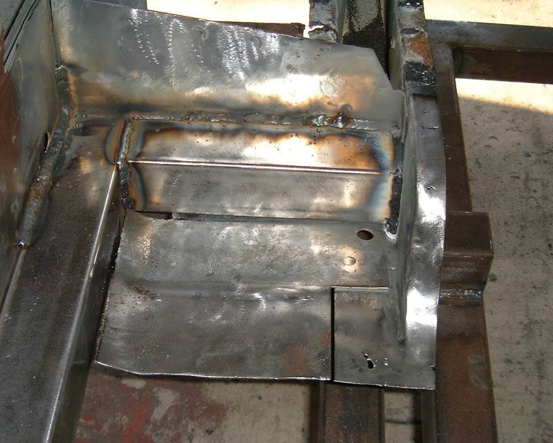

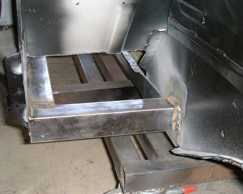

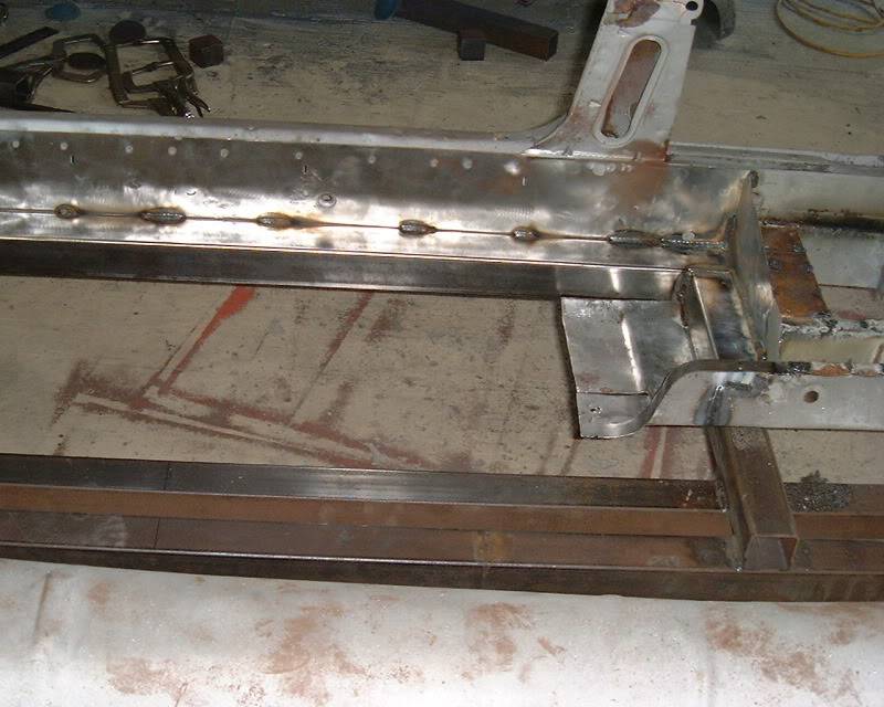

      This afternoon Brian starting making the right subframe connector. Since the early Mustang has no torque box in the front we are making one out of 2 x 2 and also welding it to the rocker and the rear torque box. He still has to finish welding to the rocker.

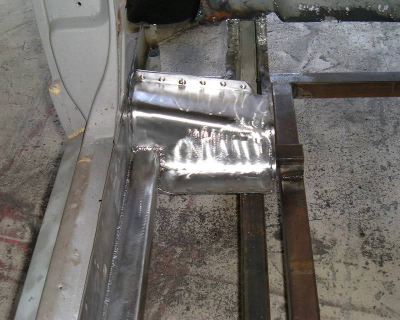

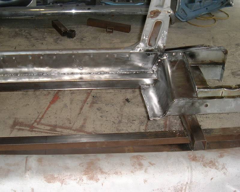

      Brian finished welding the rocker and added the top of the rear torque box

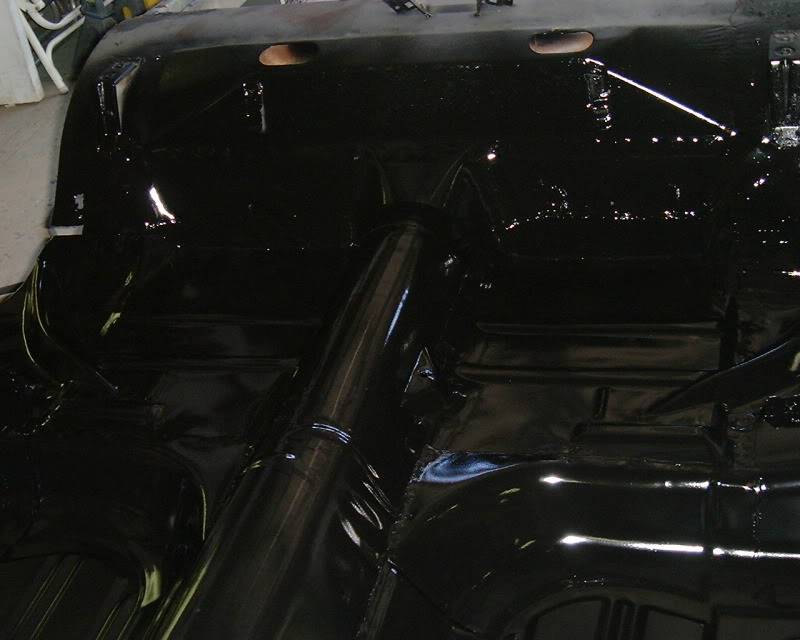

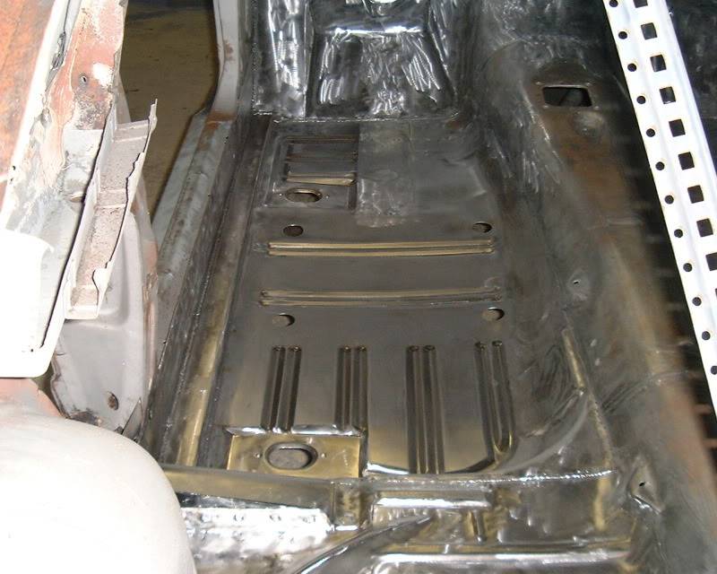

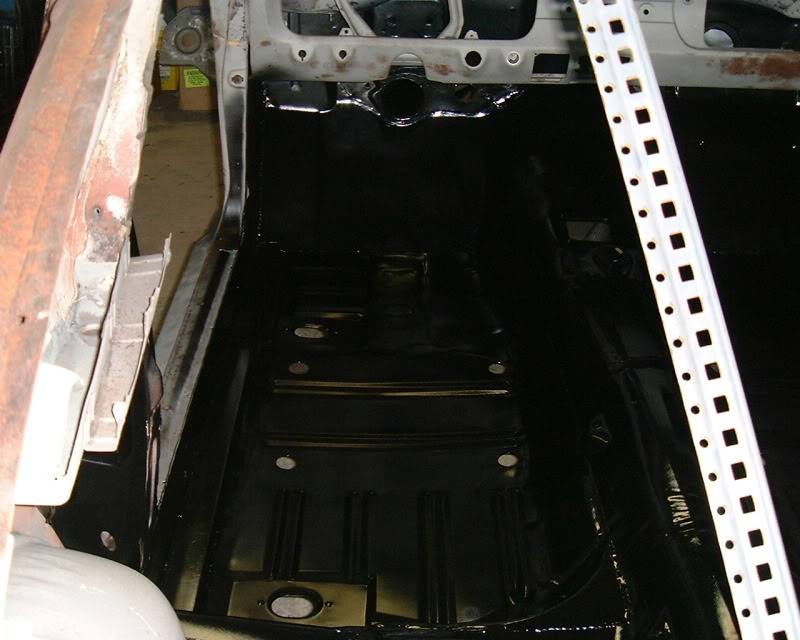

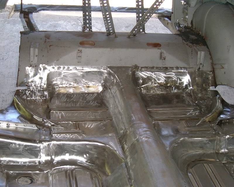

      The floor is finished and epoxy primed

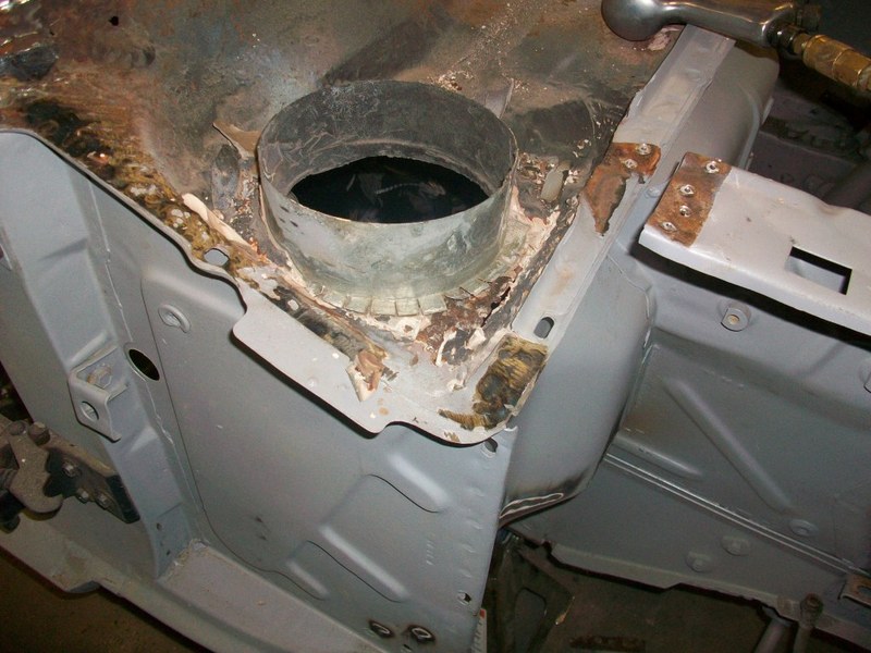

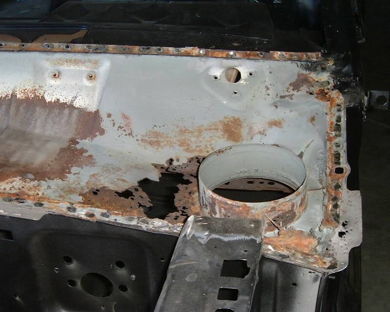

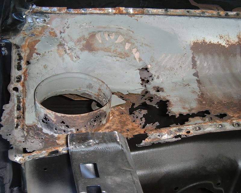

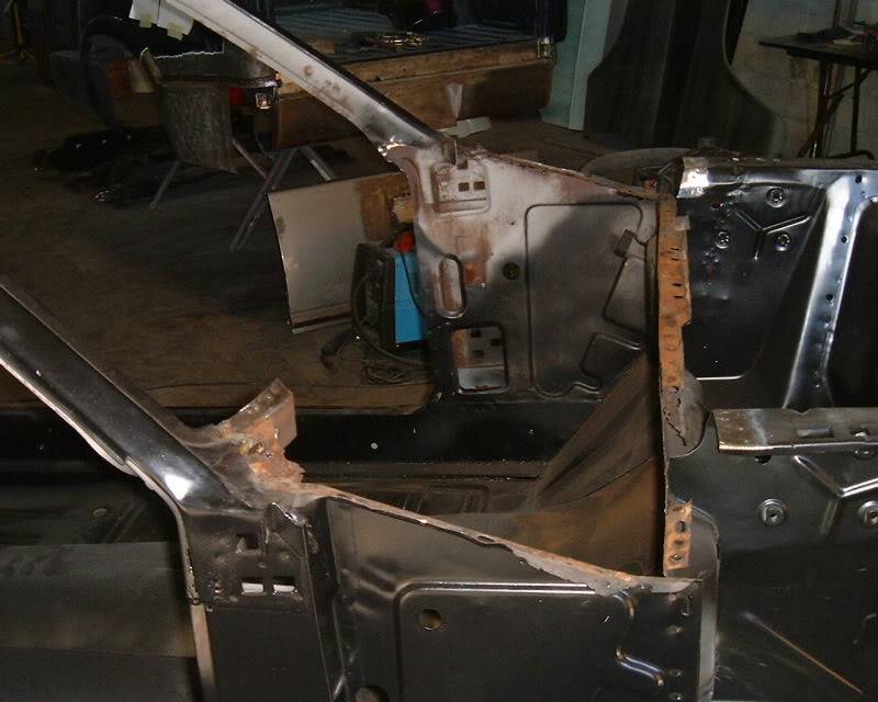

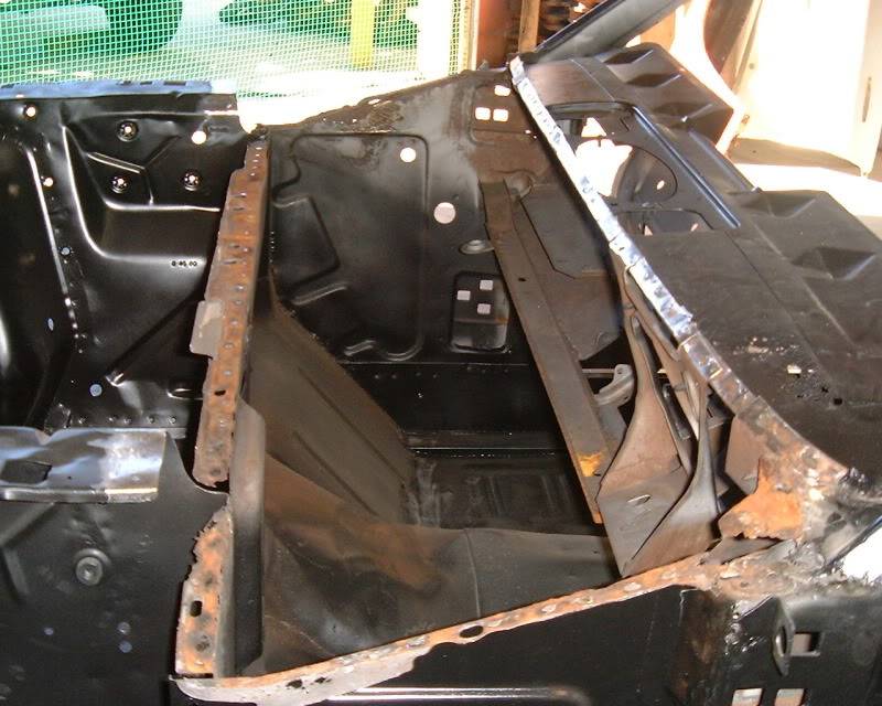

      It has been awhile since we have worked on this project we have been working on a couple of other projects but it is time to start working on the 65 Fastback.
      This is what we found under the cowl panel
      After the lower cowl panel is removed
      The dash also has rust and was removed

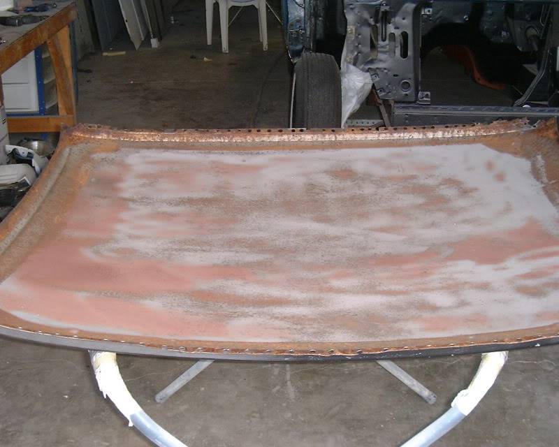

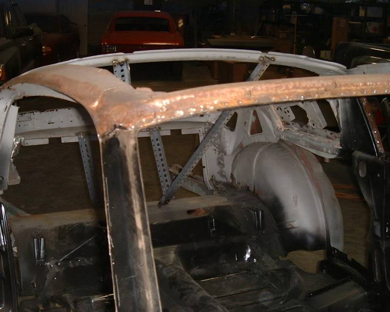

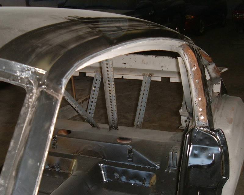

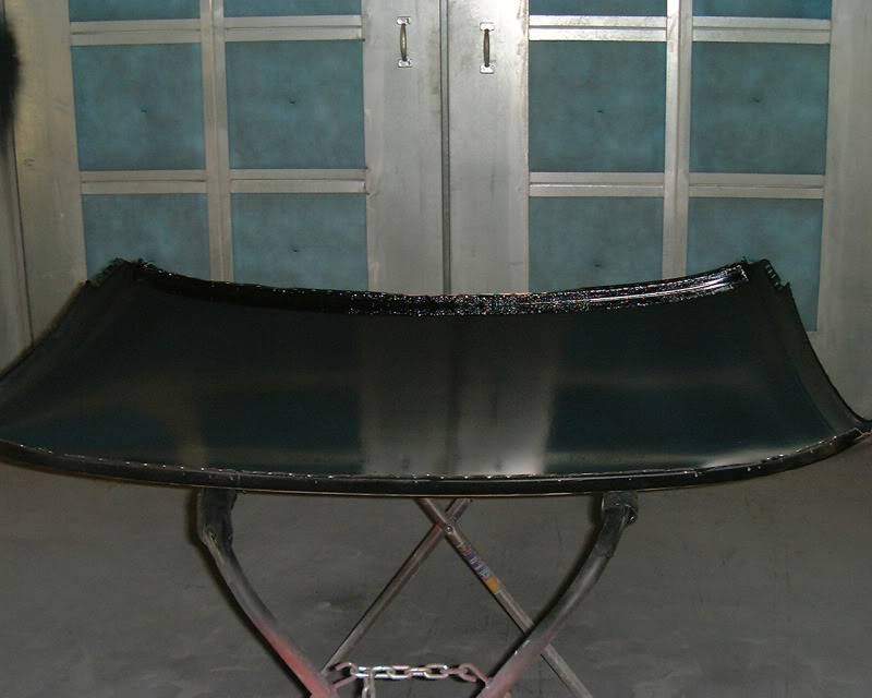

      Brian cut the drip rails off than drilled out the spot welds and removed the roof. Now he can repair the rust and epoxy prime the area that the factory left bare metal.
