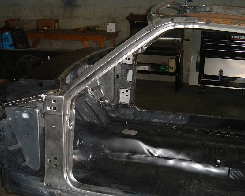

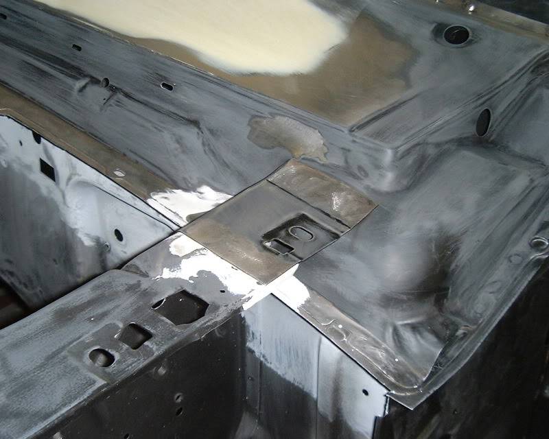

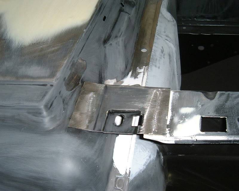

      Brian has the windshield posts and front door jamb finished. Today he sanded and epoxy primed the next step is to install the new dash.

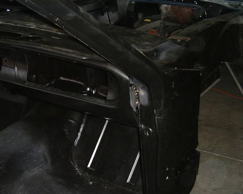

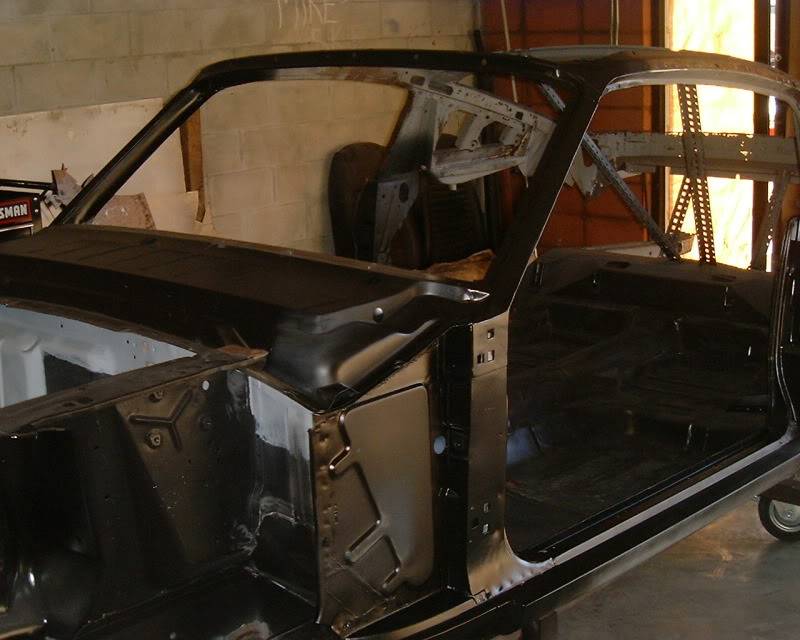

      The new dash was installed

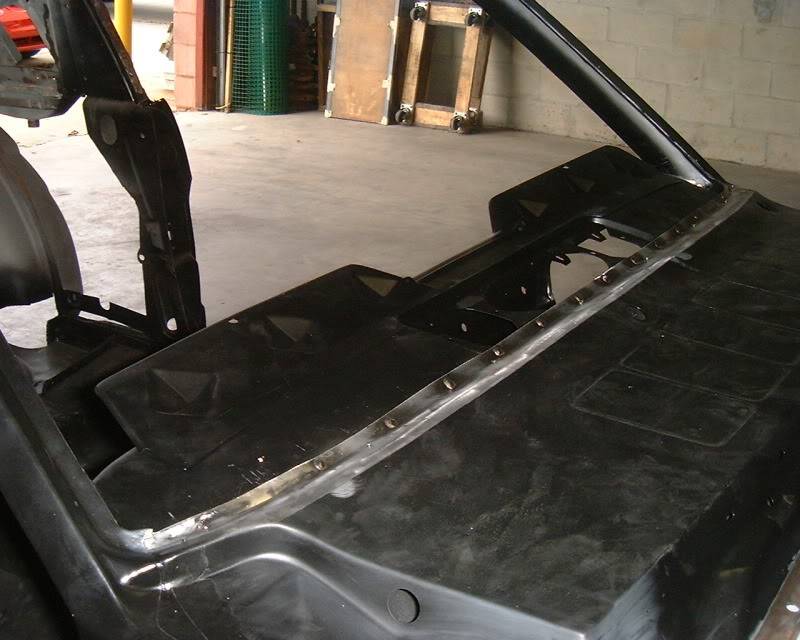

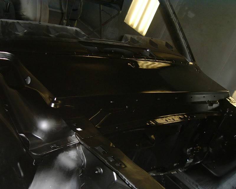

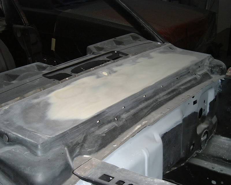

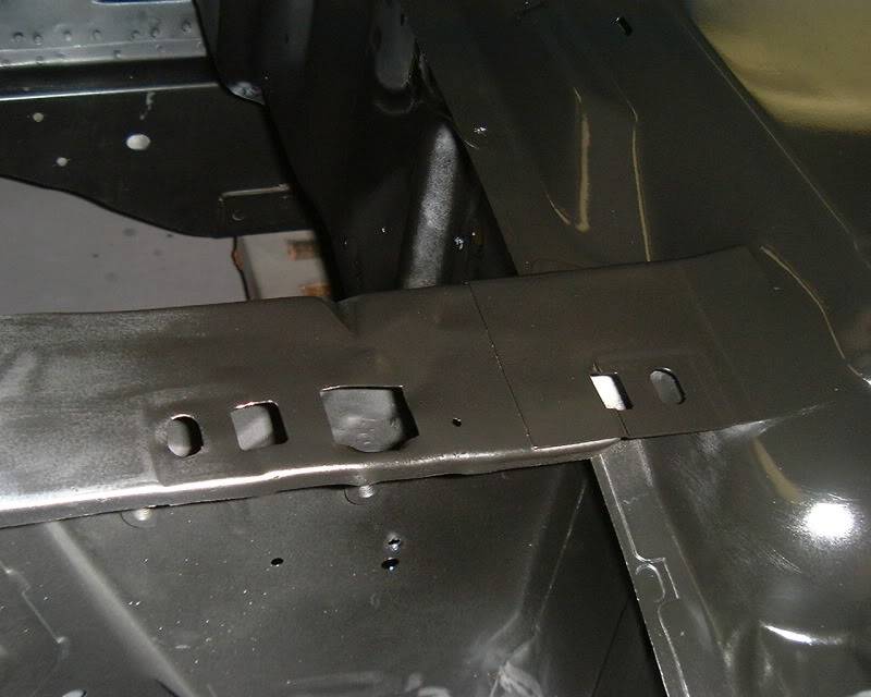

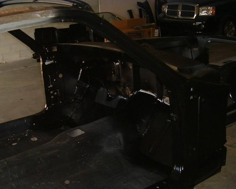

      The major bodywork is finished on the cowl. I just need to prime and block sand a couple of times. We are waiting for the apron to cowl extensions to come in than I will epoxy prime.

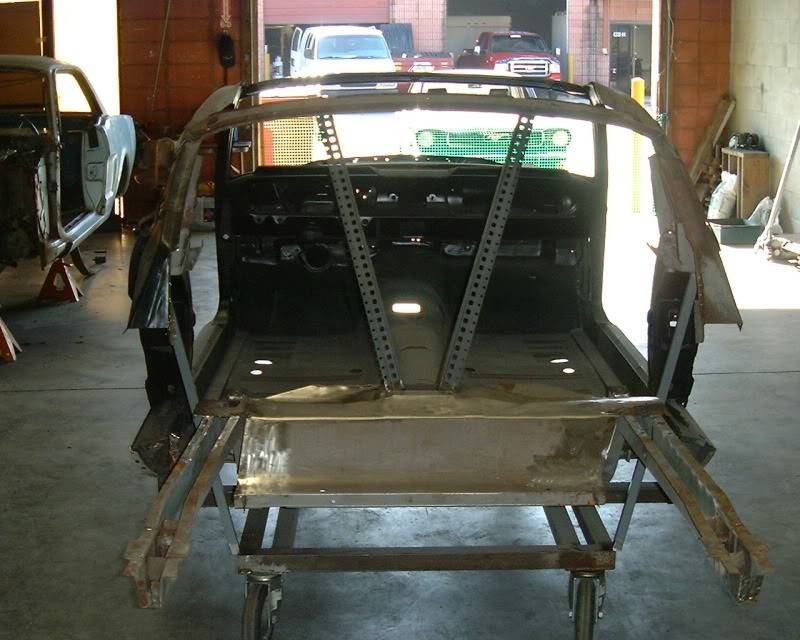

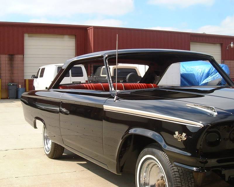

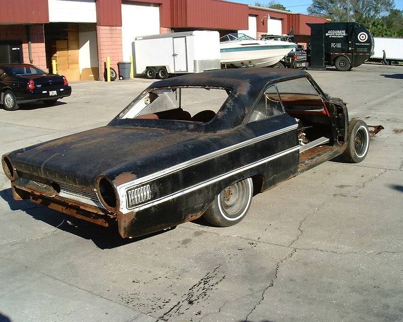

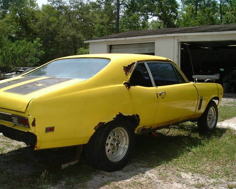

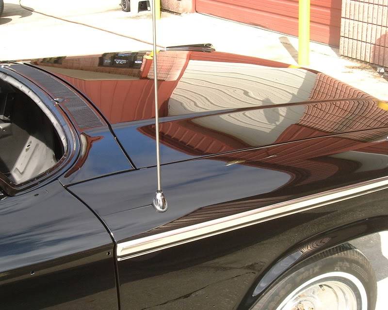

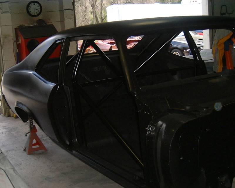

      We had stopped working on this for a little while because we had to work on a couple of other long term projects. Here are the before and after pictures of the other cars we were working on that needed a lot of rust repair.

      Wow that Galixe looks killer is it a real 427 car ?
      Yes it is an R code 427

      It may not look like it but Brian plug welded the fender apron extensions to the cowl and than I epoxy primed.

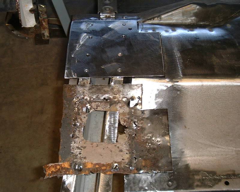

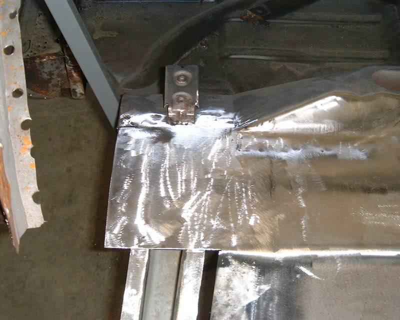

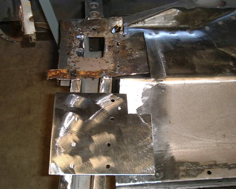

      We have a new rear panel so Brian removed the old one. This will save a lot of time.
      After the panel was removed he had to make a patch for the front trunk floor
      After Brian cleaned up the plug welds
