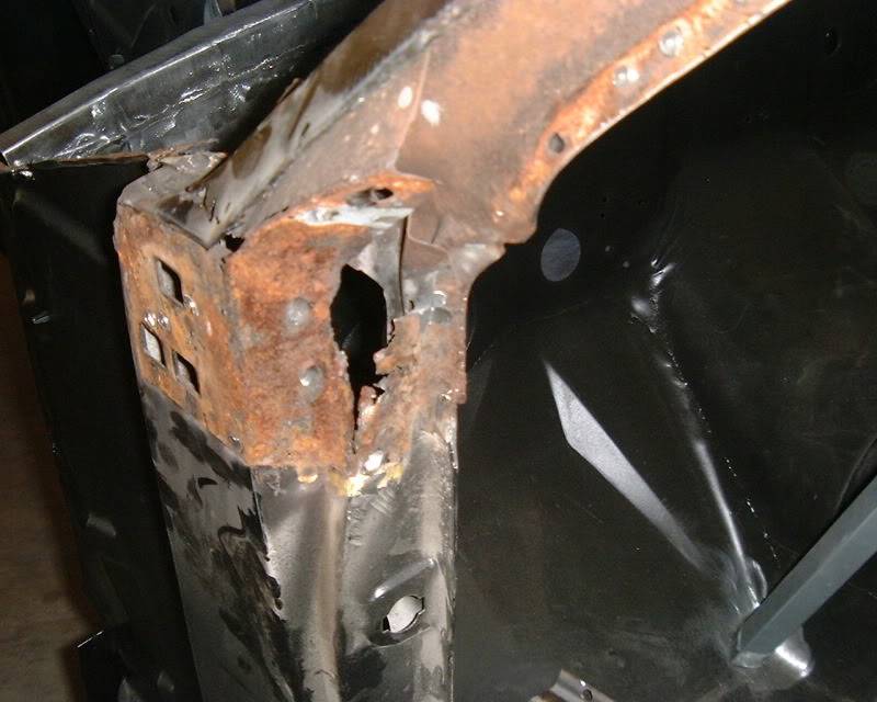

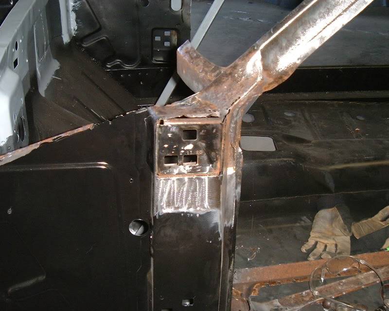

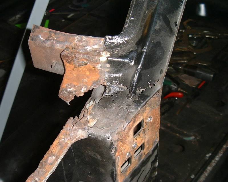

      Removed the top layer of the door jamb and this is how it looked
      Cut out the rust and started making a patch
      Rusty Gillis

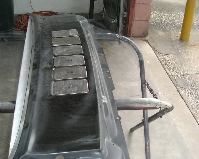

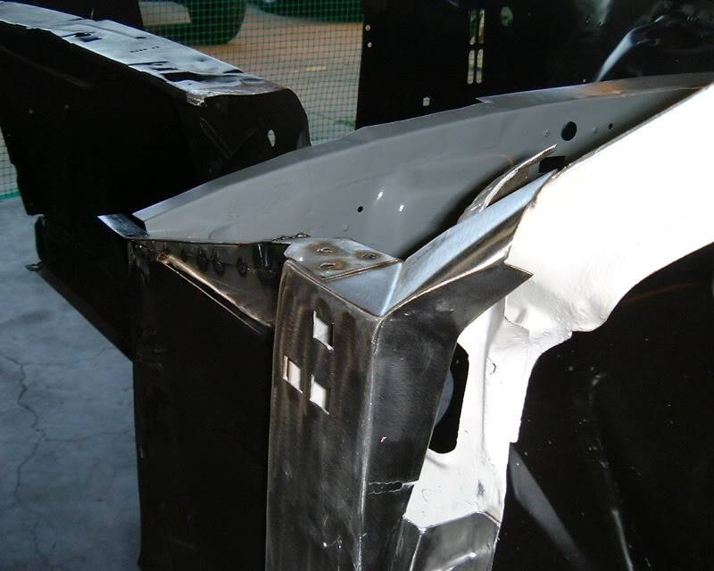

      Brian made a patch for the top of the side cowl panel.

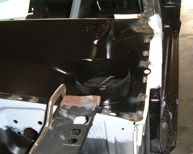

    6. #66
      Sep 2009
      Port Richey Fl
      775

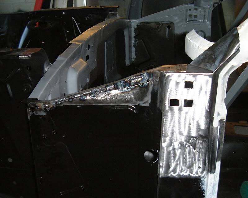

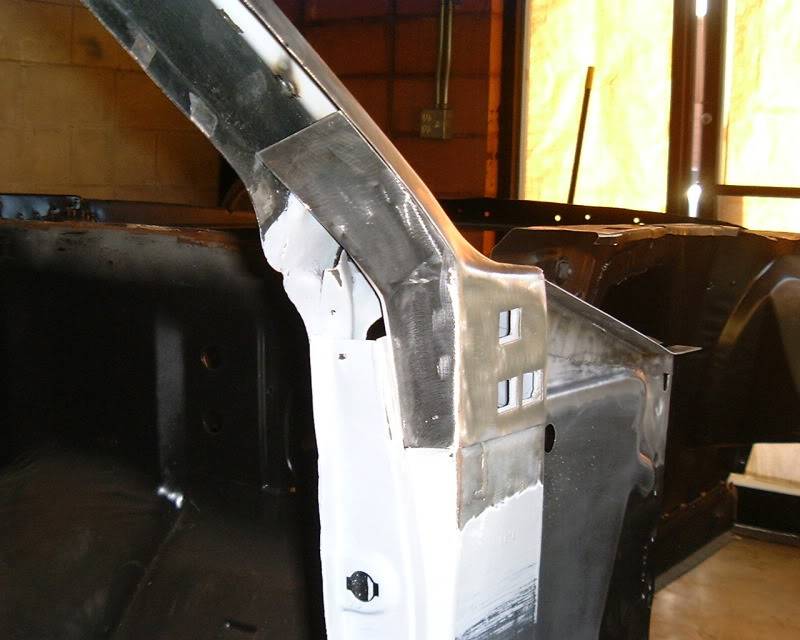

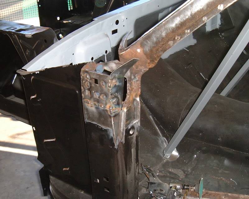

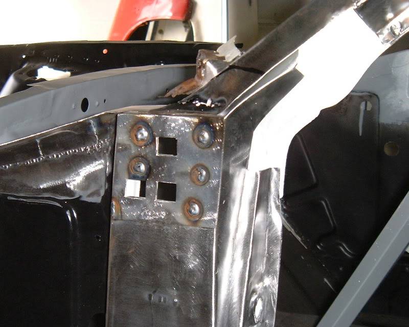

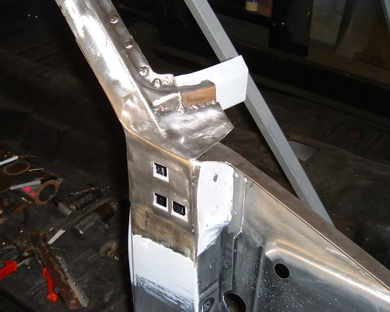

      Brian made a few more patches for the right front door jamb.
      Brian made patches for the cowl and than I used 3m panel adhesive to bond them
      Rusty Gillis
      Former SS/FA & SS/GA NHRA National Record Holder

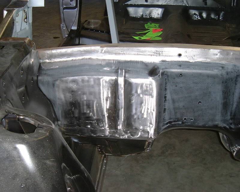

    7. #67
      Sep 2009
      Port Richey Fl
      775

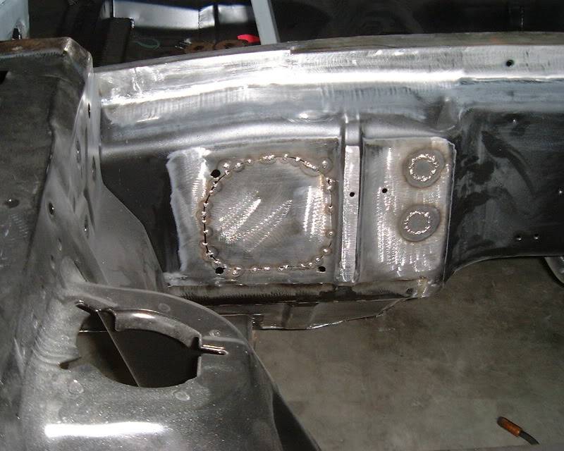

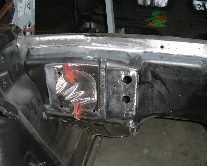

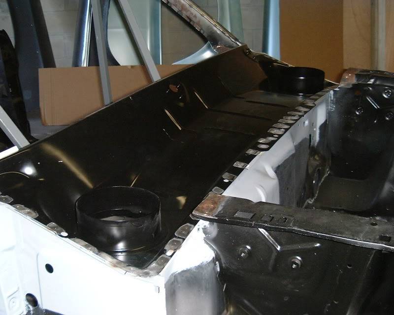

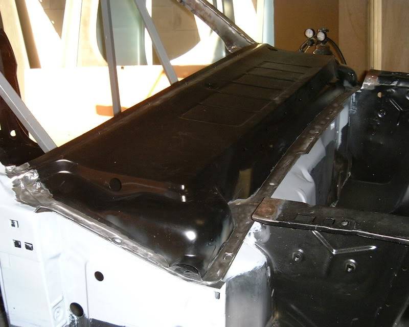

      Brian repaired the top of the firewall
      Rusty Gillis
    8. #68
      Sep 2009
      Port Richey Fl
      775

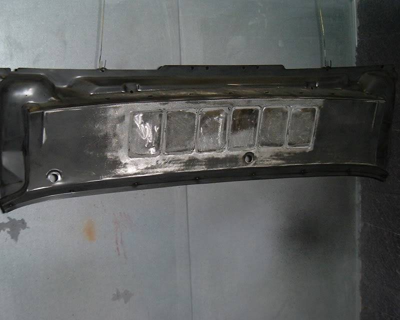

      The heater holes were filled in.
      Rusty Gillis

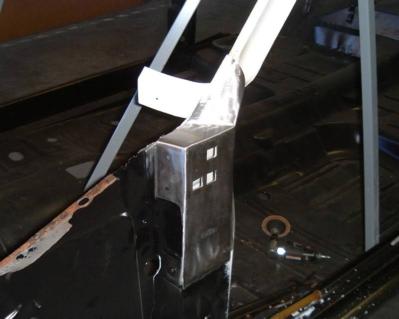

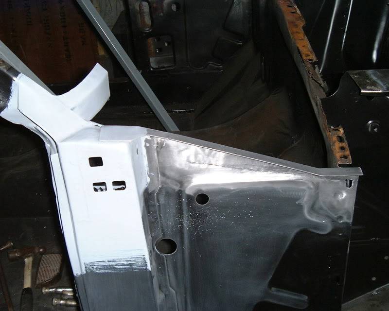

      Brian is starting on the left door jamb it has more rust than the right side
      Repair one section at a time

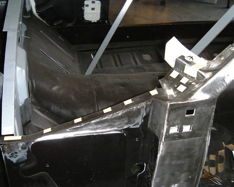

    12. #72
      Sep 2009
      Port Richey Fl
      775
      Progress on the left door jamb.
      Rusty Gillis
    13. #73
      Sep 2009
      Port Richey Fl
      775

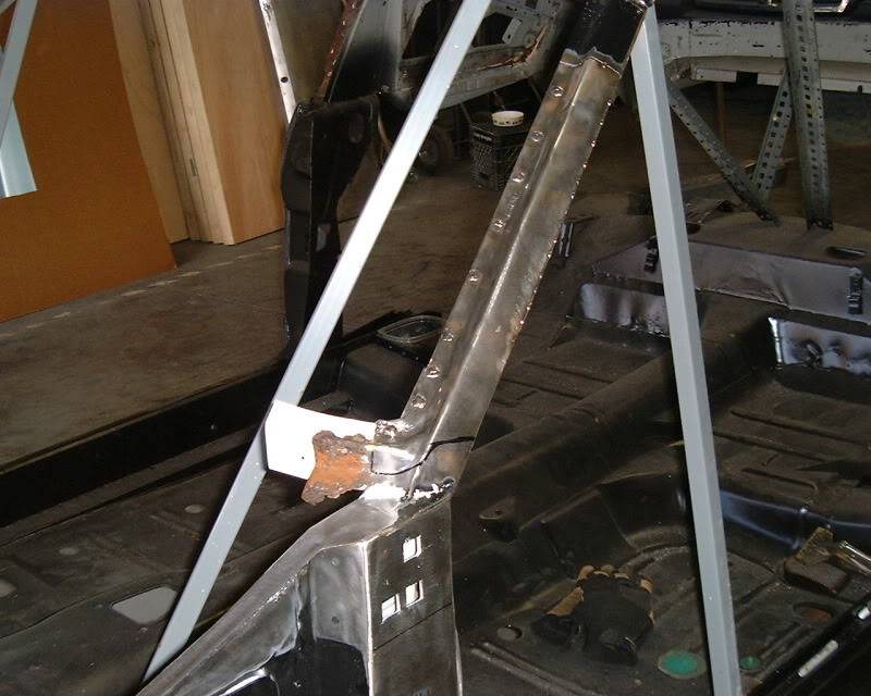

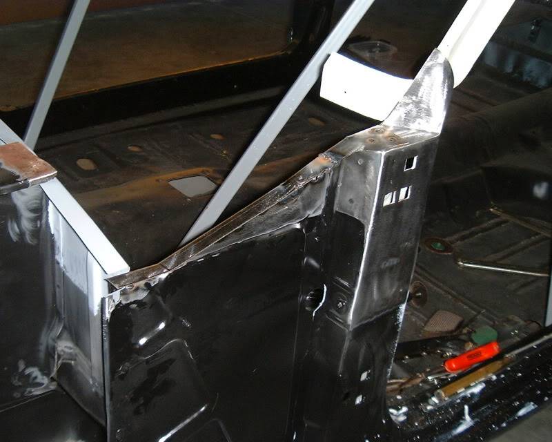

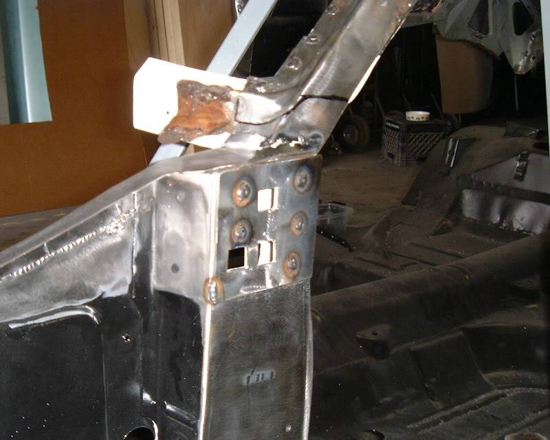

      The inner structure of the left door jamb is almost finished this afternoon Brian starting making the outer section.
      Rusty Gillis

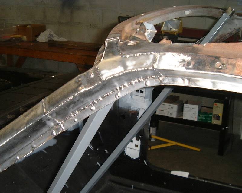

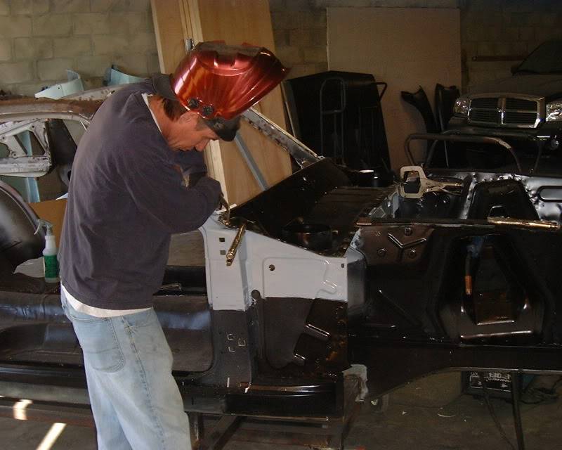

    14. #74
      Sep 2009
      Port Richey Fl
      775

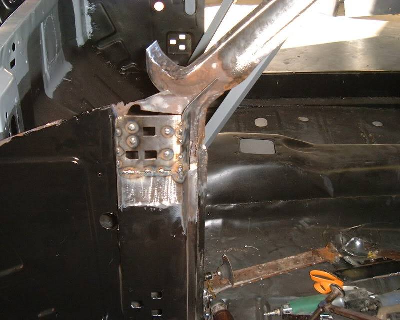

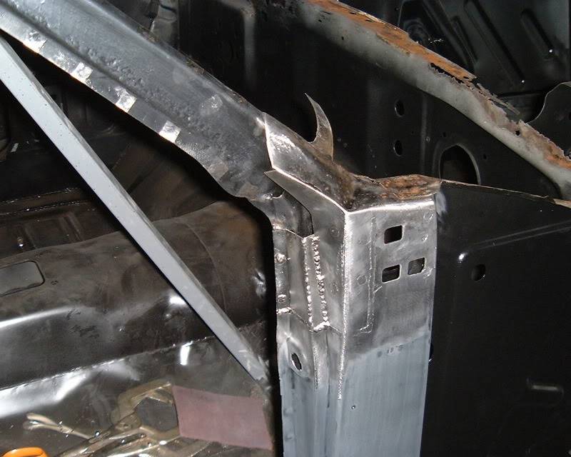

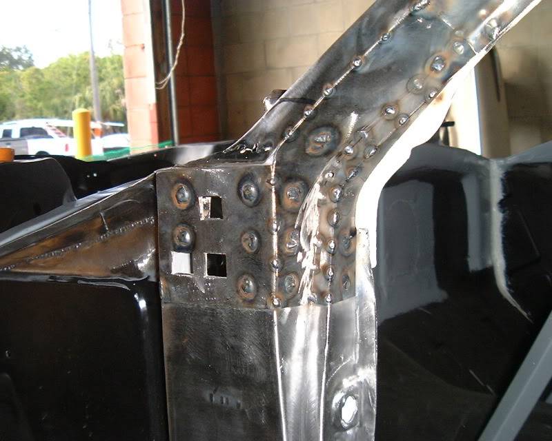

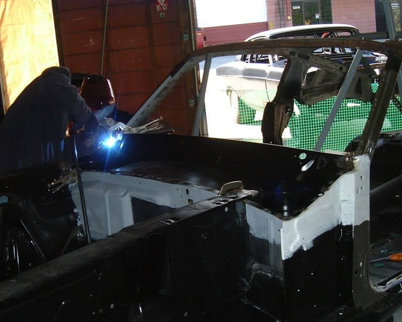

      Brian taped the area he will be plug welding before applying epoxy
      Fitting the inner cowl panel
      Welding the inner cowl panel
      Rusty Gillis

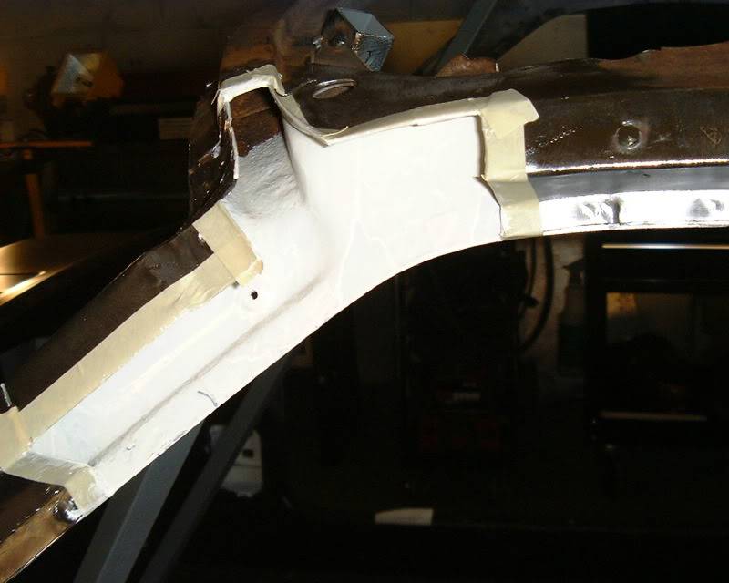

    16. #76
      Sep 2009
      Port Richey Fl
      775

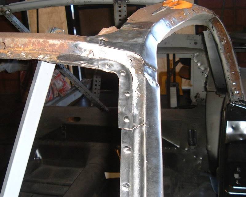

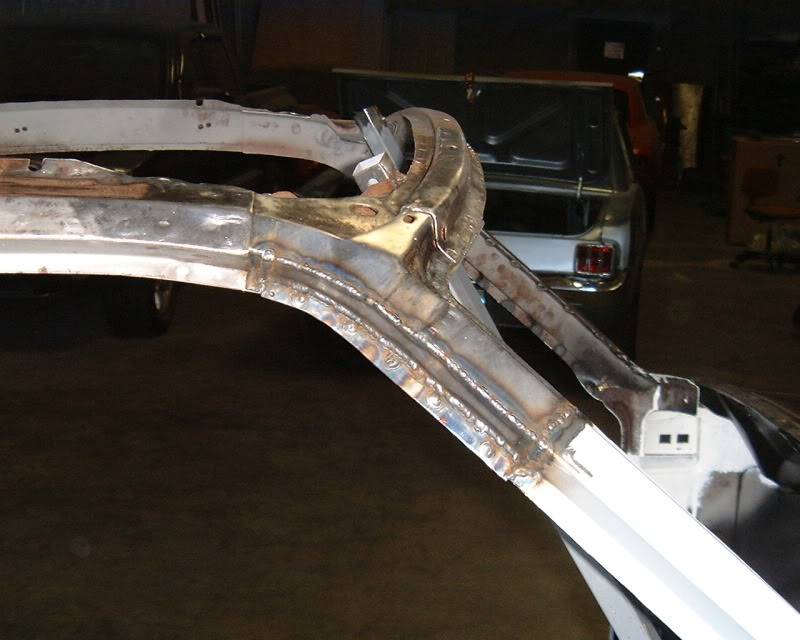

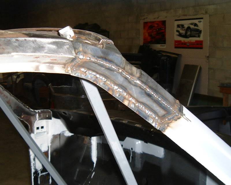

      Brian ground the welds and is now ready to install the top cowl panel
      Top cowl panel after welds are ground
      Rusty Gillis

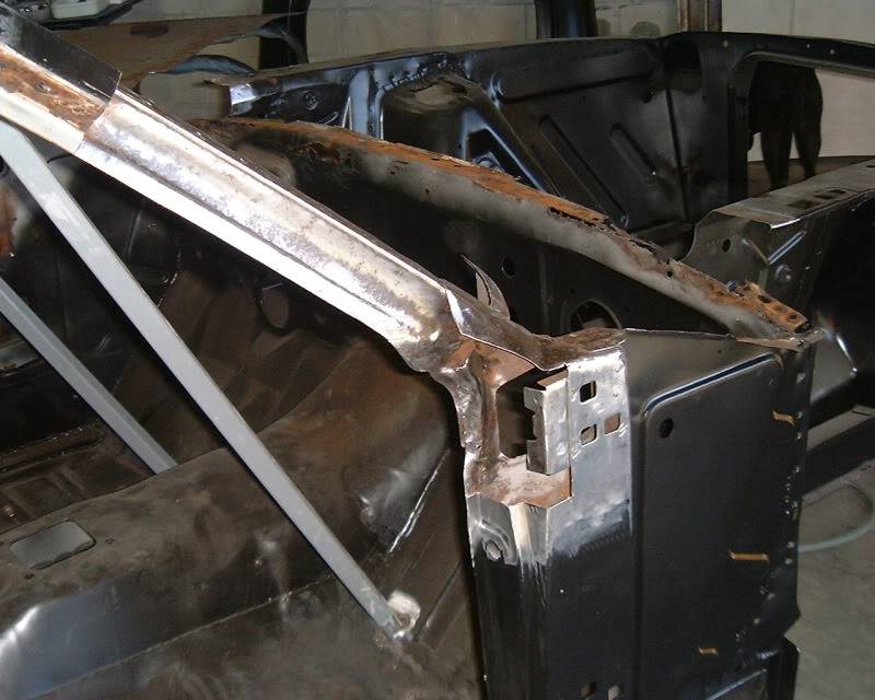

    18. #78
      Sep 2009
      Port Richey Fl
      775

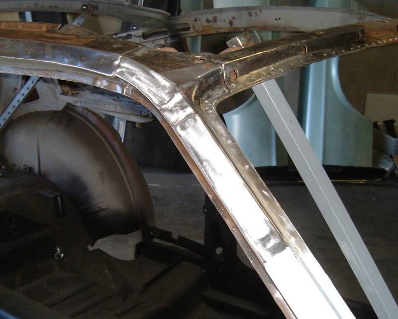

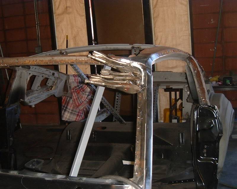

      Brian made the last patch on the right windshield post
      Rusty Gillis

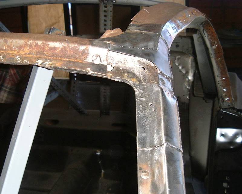

    19. #79
      Sep 2009
      Port Richey Fl
      775

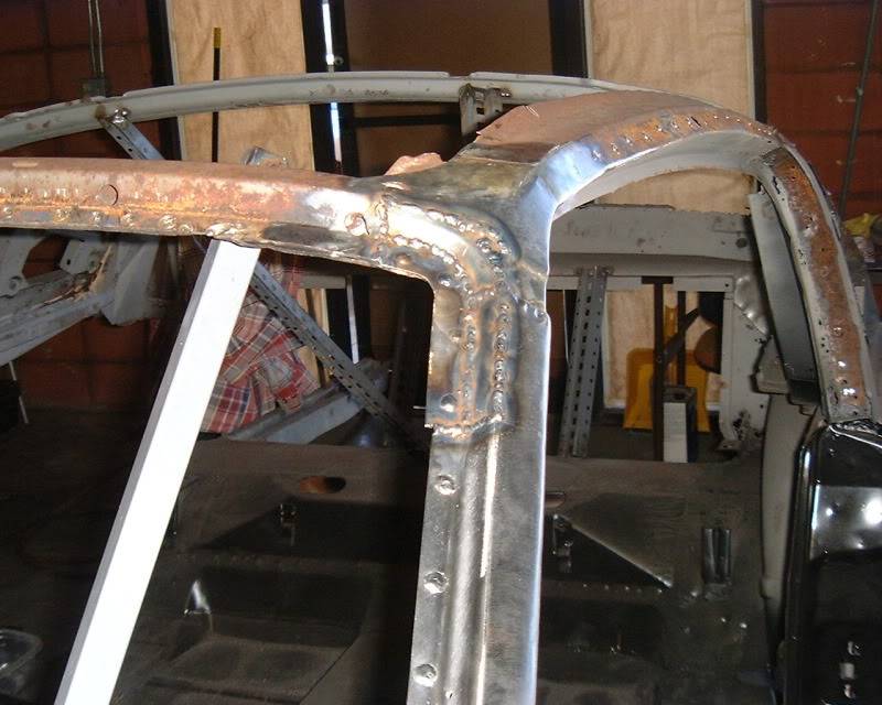

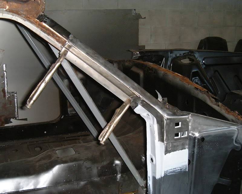

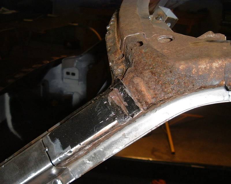

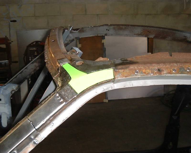

      Brian is starting to repair the top of the left windshield post
      Making a pattern out of poster board first
      Brush some SPI epoxy before the patches are welded
      Starting to make patches
      Rusty Gillis

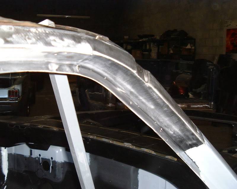

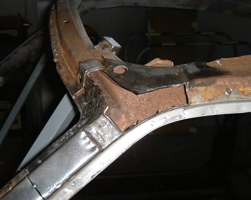

    20. #80
      Sep 2009
      Port Richey Fl
      775

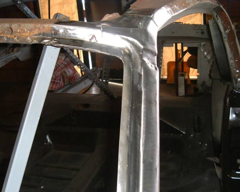

      Brian finished the top of the windshield post
      Rusty Gillis
