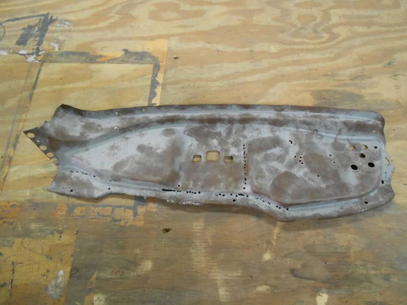

      Brian has to make or patch the inner structure since it is not available.
      Next epoxy before making another patch

      Since you cannot get this Brian had to patch the original

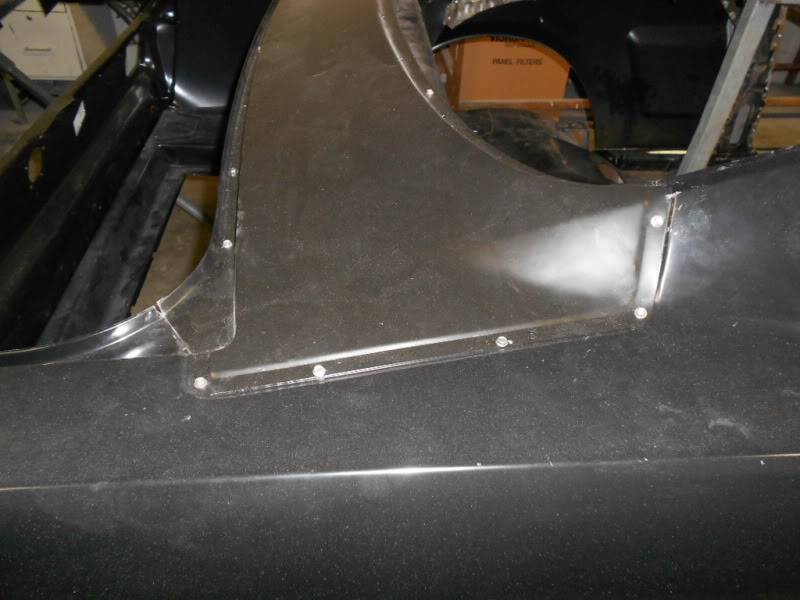

      More rust repair

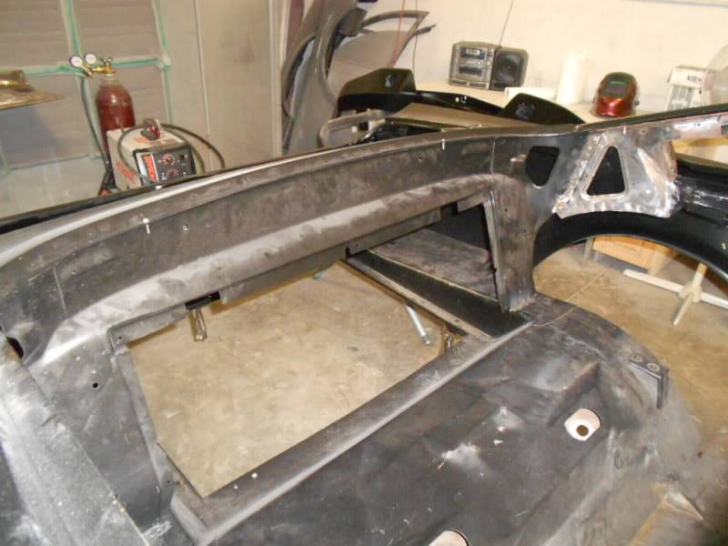

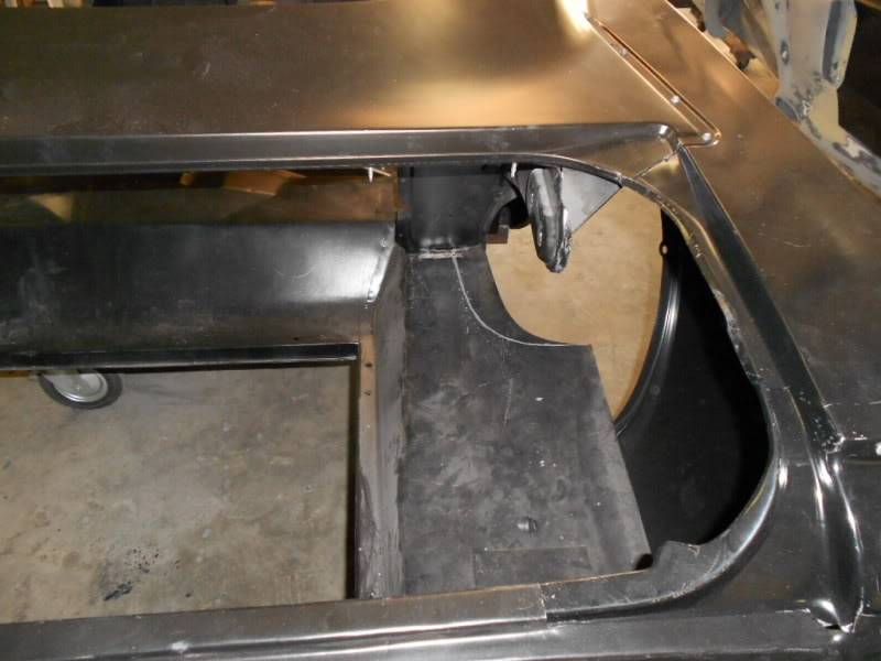

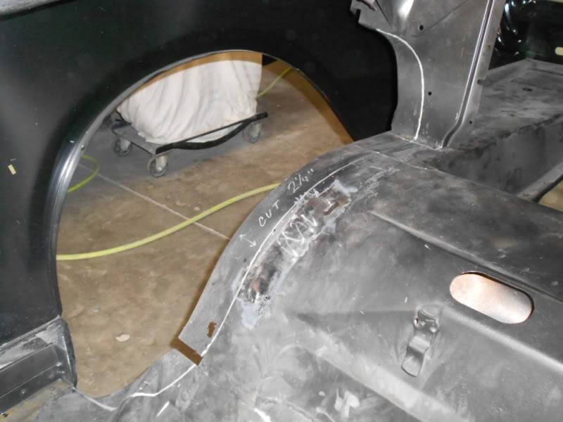

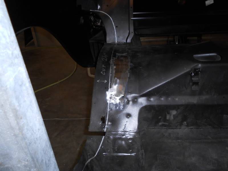

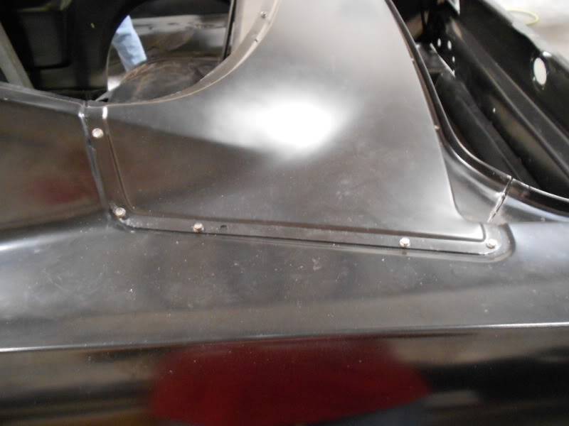

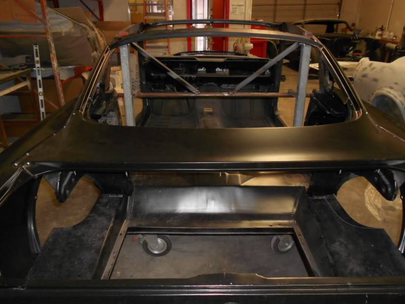

      Test fitting the sheetmetal before welding in the rear package tray panel
      Rear panel is welded
      Marking the area that needs to be cut out for the Graverobber wheel wells

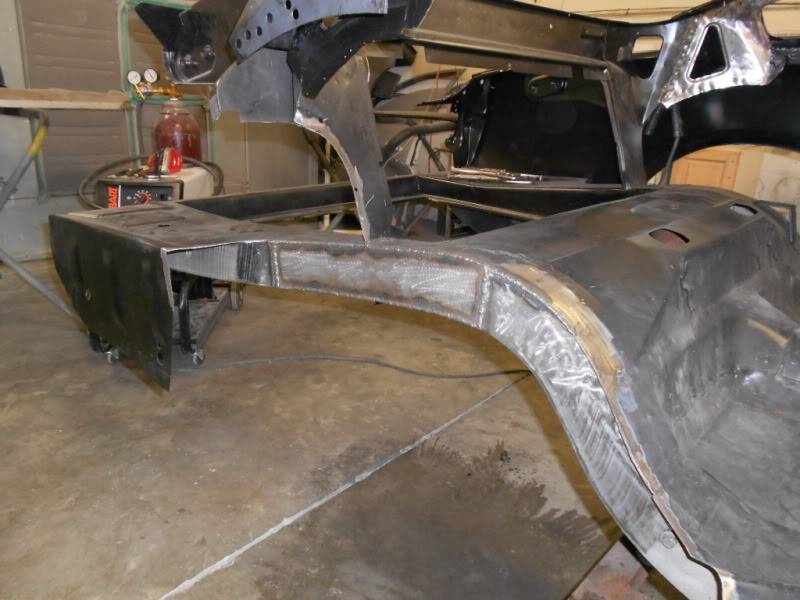

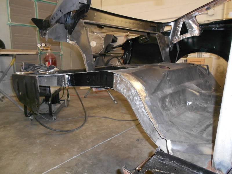

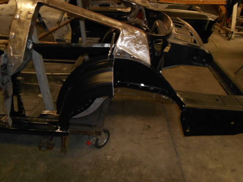

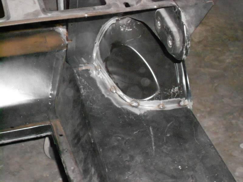

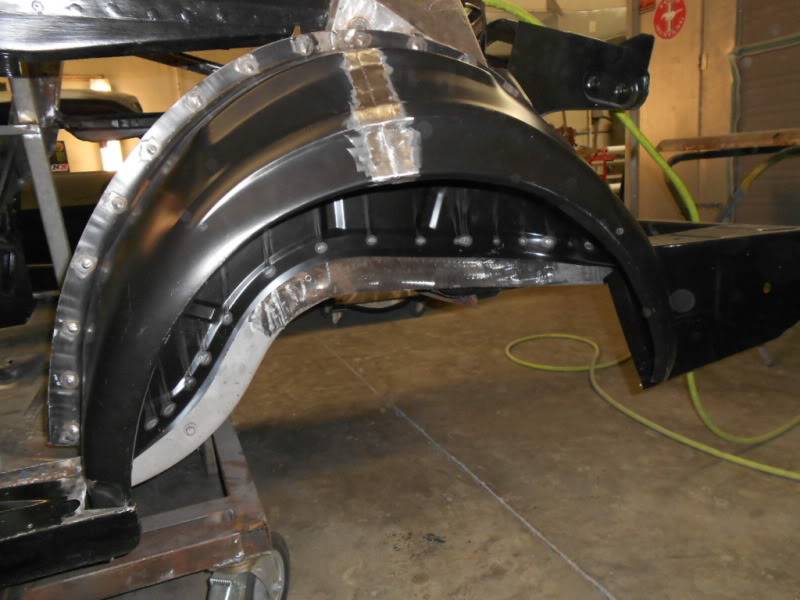

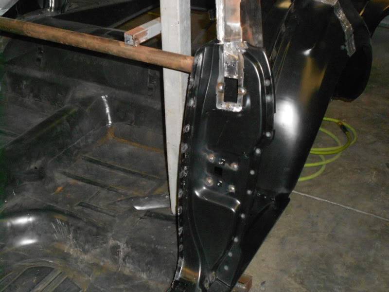

      The frame rail was notched and epoxy primed inside
      Patch welded in place
      Ready to install the right inner tub
      Tack welded in place

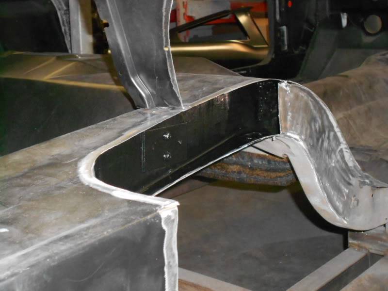

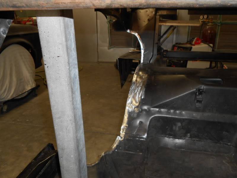

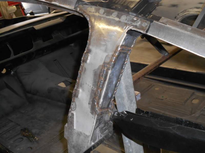

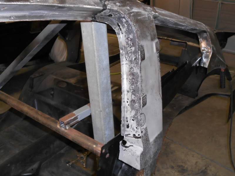

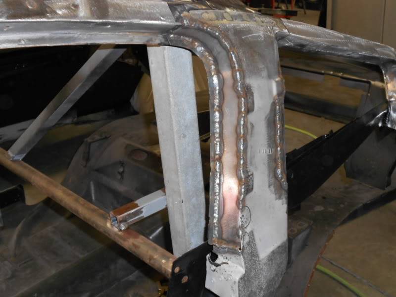

    20. #140
      Sep 2009
      Port Richey Fl
      775

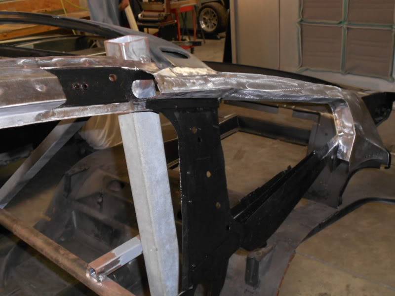

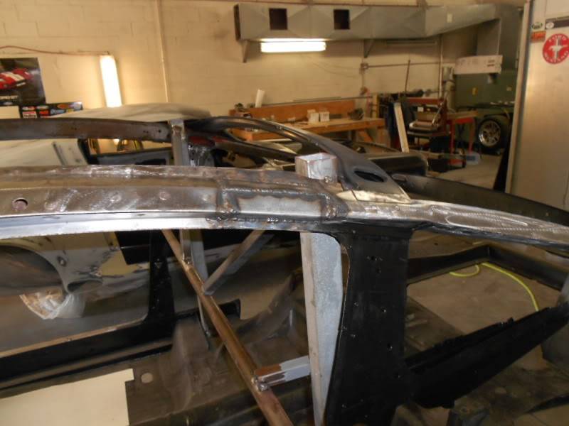

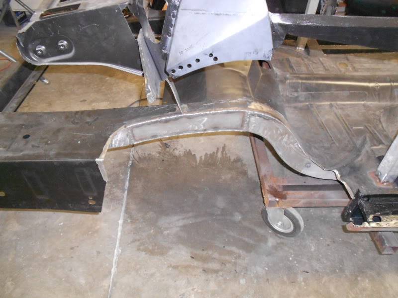

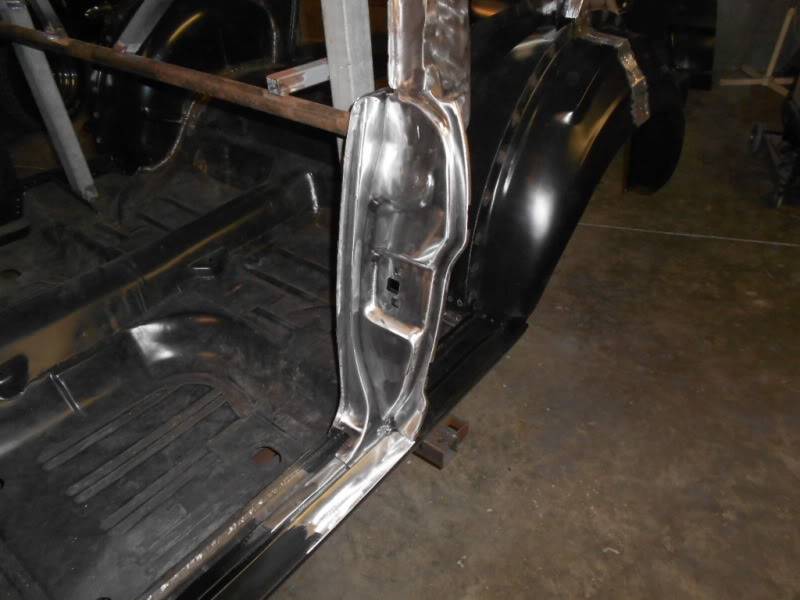

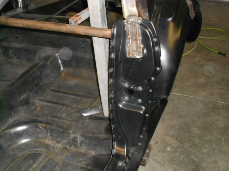

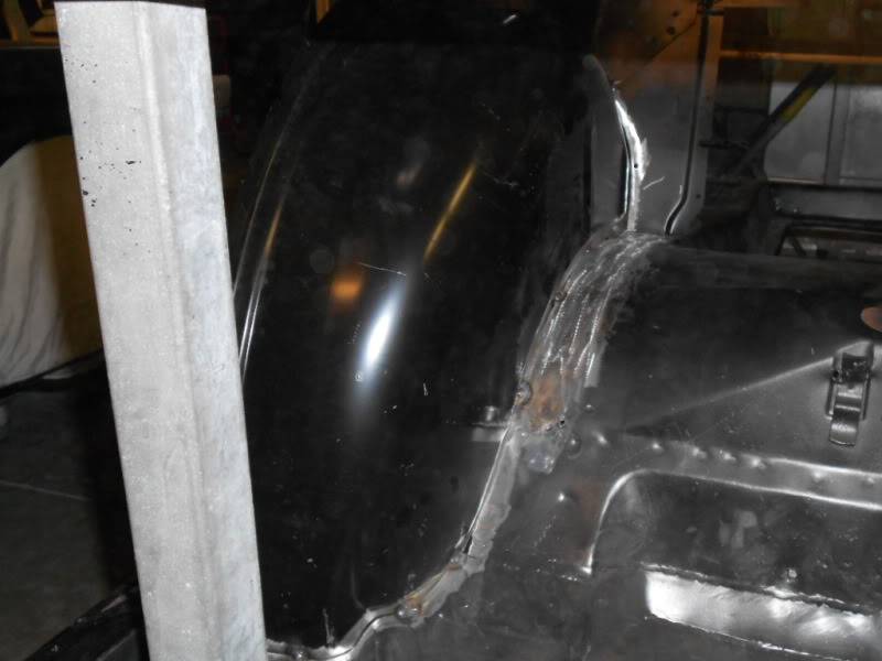

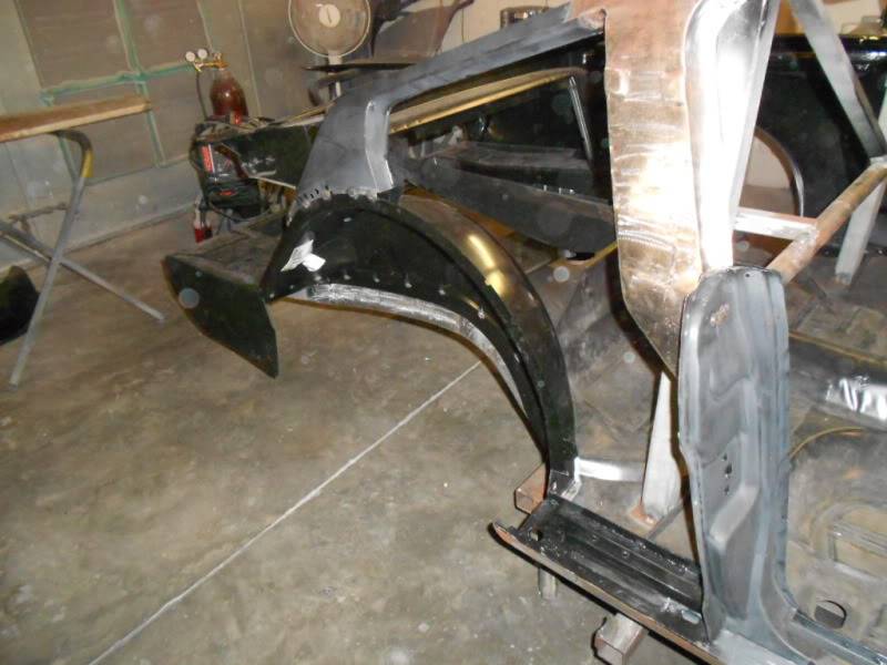

      The outer wheelhouse did not match the inner. We had this same problem on the 65 coupe and the outer wheelhouse was from a different vendor. Brian cut it in two than test fit the front
      He cut the rear section than welded it together

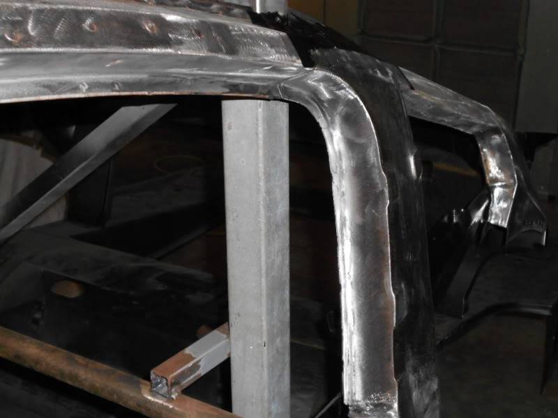

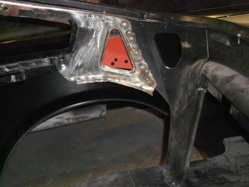

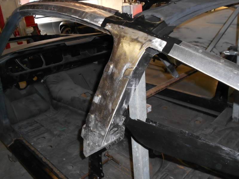

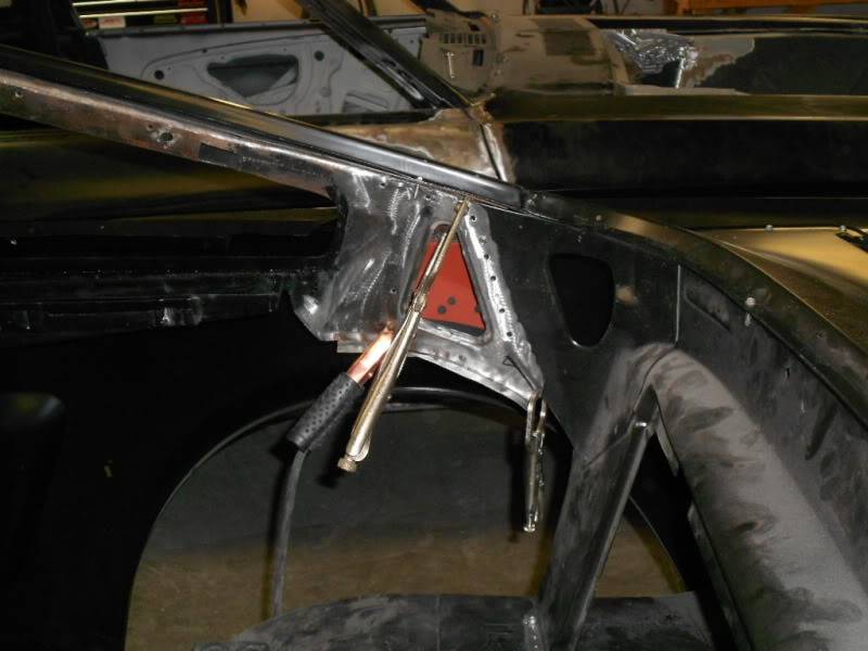

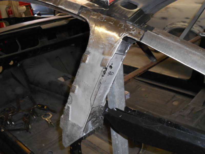

      After taking the B pillar apart we found it was beyond repair.
      They only make them for a coupe so he had to make a patch
      Rusty Gillis
      Former SS/FA & SS/GA NHRA National Record Holder
