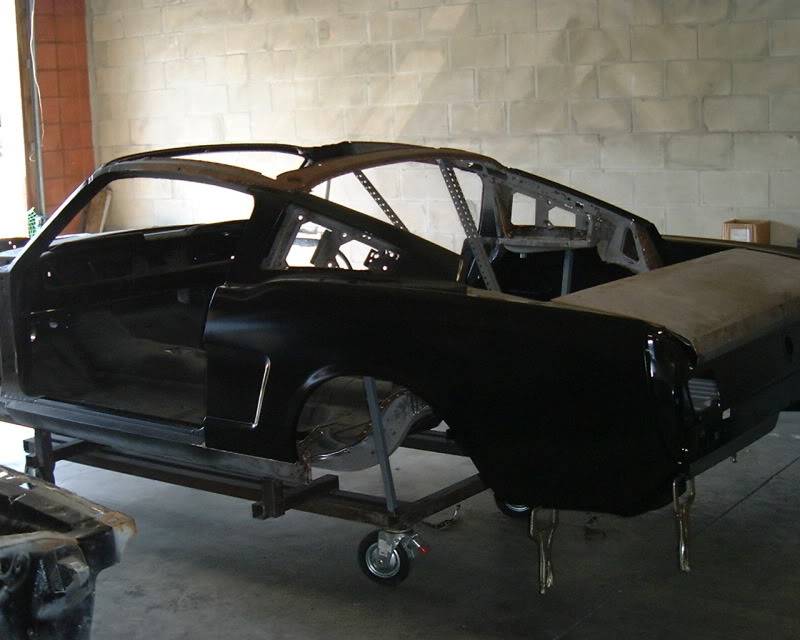

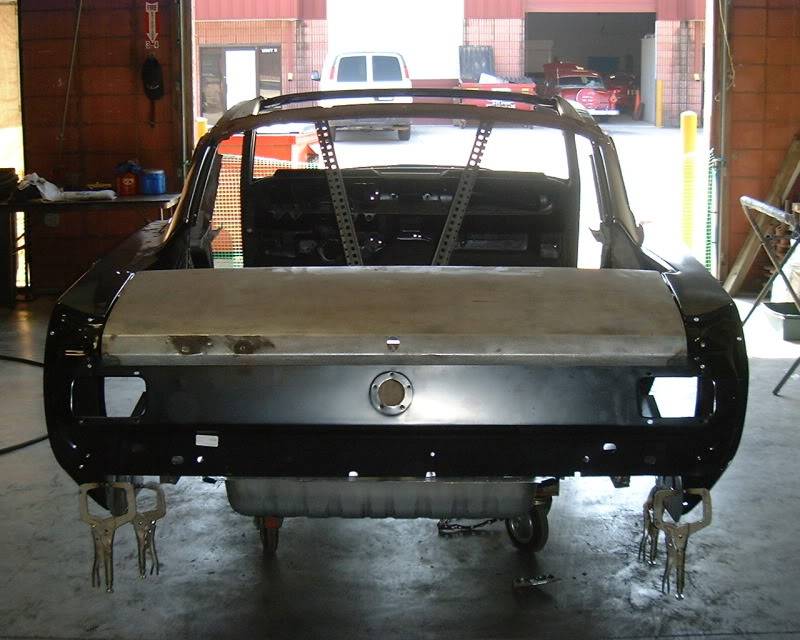

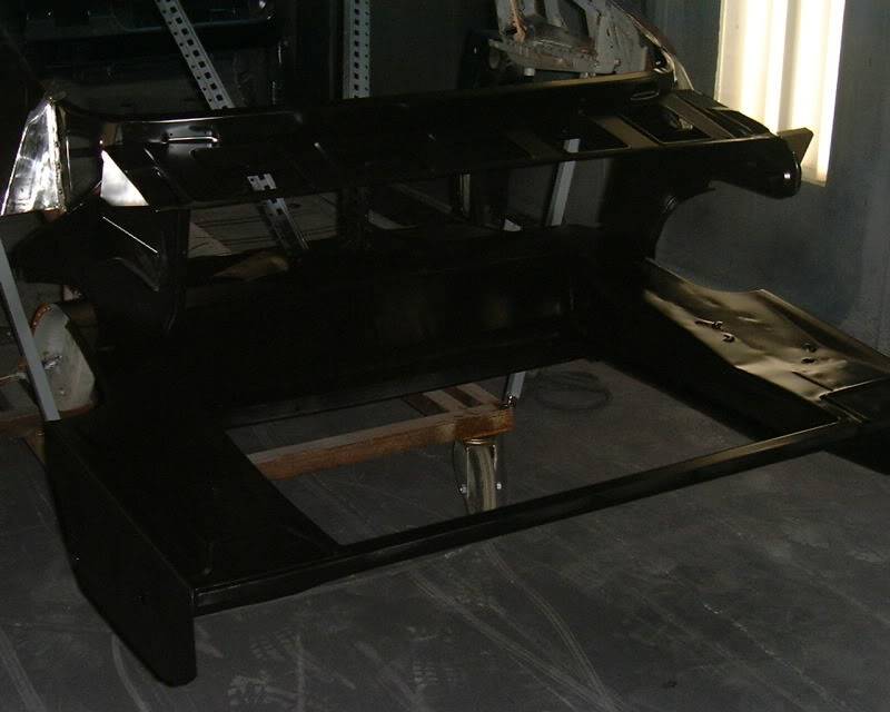

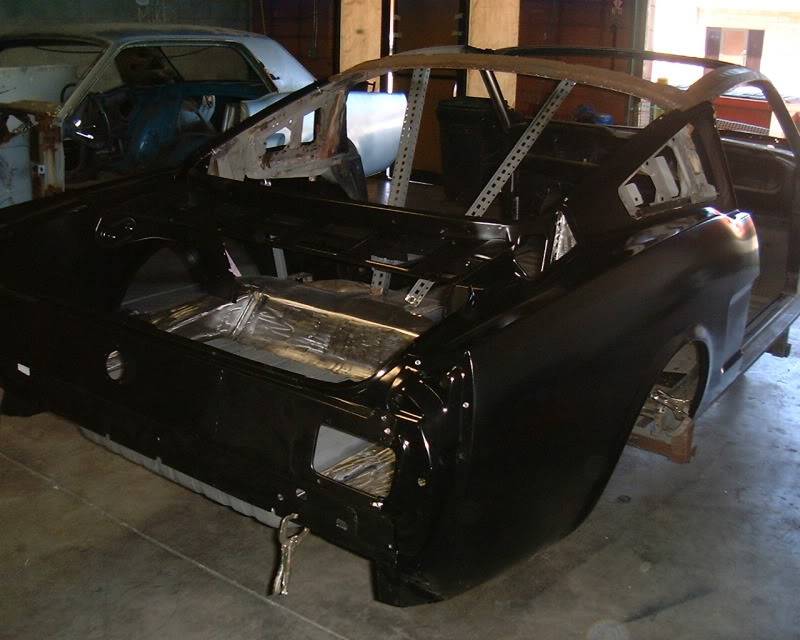

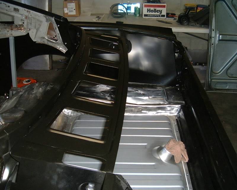

      Next step was to test fit the quarters, taillight panel and deck lid. Once everything is lined up the trunk floor will be drilled and plug welded.

      Looks good Rusty. Its not so naked!

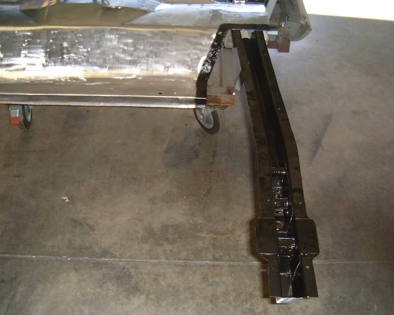

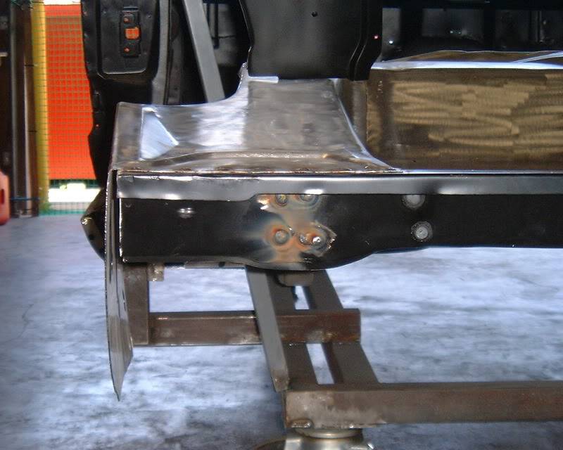

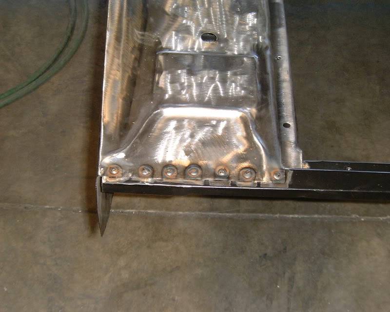

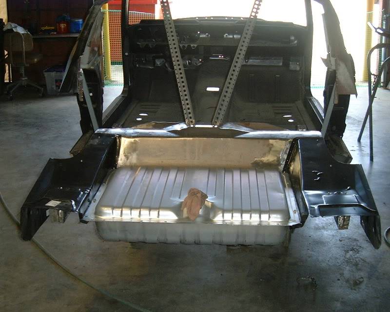

      Now that the rear panels fit it is time to prep the frame rails. As Brian was cleaning the front trunk floor he found a few rust pin holes. He cut out the bad area and made three patches one at a time to keep it from warping the edge that hangs down.
      Brian ground all the welds on the patch than brushed a heavy coat of epoxy in the frame rails
      Sorry Chris it is apart again!

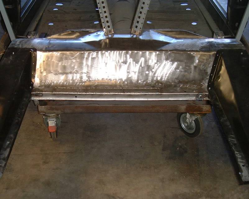

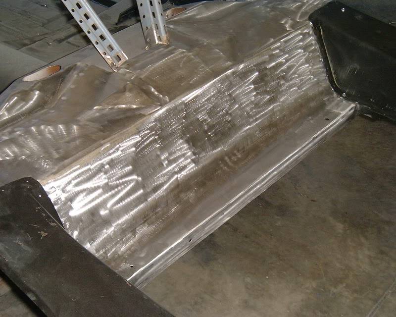

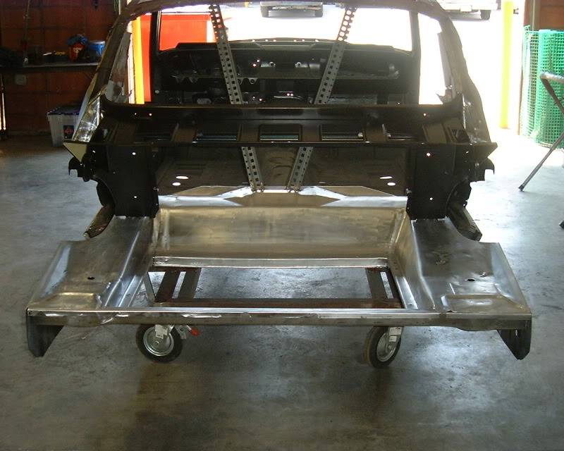

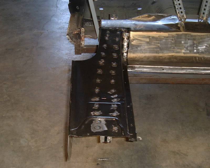

      Left side trunk floor welded to the rear frame rail

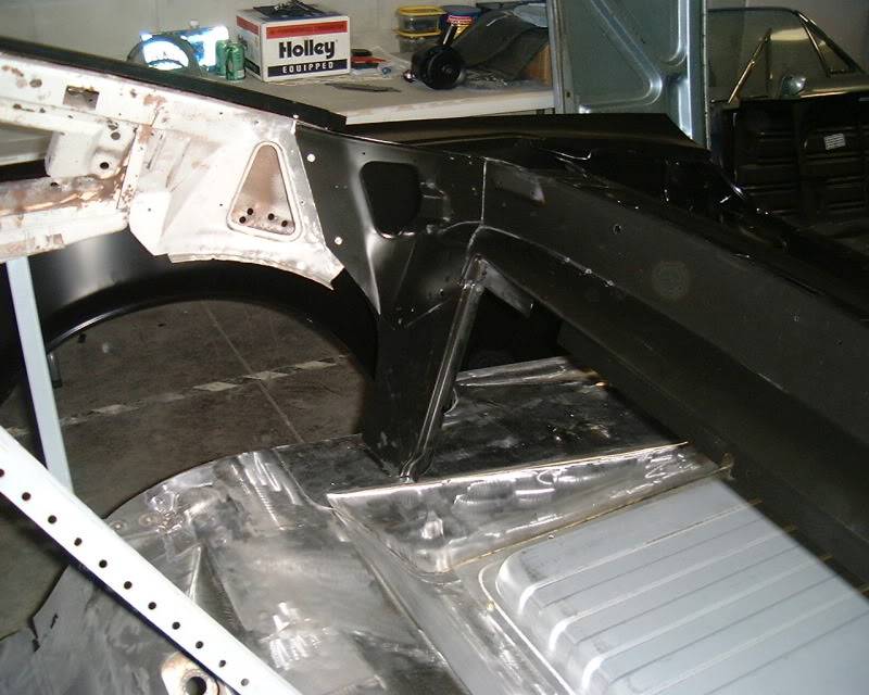

      New rear panel with package tray test fitted and also the quarters and taillight panel installed before the rear crossmember is welded. We wanted to make sure everything lines up in the rear before the rear crossmember is installed.
      Rear crossmember welded to the trunk floor and rear frame rail
      Rear trunk floor prepped for epoxy primer
      Epoxy primed
      Is the "package tray" sheetmetal new? I have been waiting for several years for Dynacorn to begin reproducing the stamped supports that connect the curved metal that is below the rear glass to the side supports inside of the sail panels... I would love to know where you found this metal if it is new...
      Thanks!

      Quote Originally Posted by SHOVOLVO View Post
      Thanks!
      It came from CJ Pony Parts

      cobragt: I will look into the trunk corner braces. Since the rear crossmember is welded in, I am not going to worry about it. I don't know if you saw the earlier pics, but there are some pretty stout subframe connectors installed. Additionally, the seams on the shock towers were welded up. We are also going to install a metal plate behind the rear seats for a some additional rigidity.
      The dynacorn piece saved me serious cash. It was about 300 from CJs.

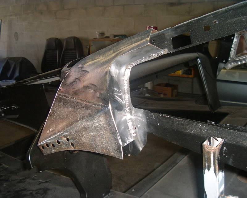

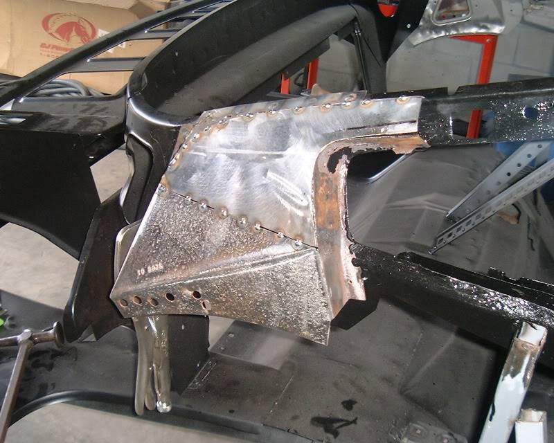

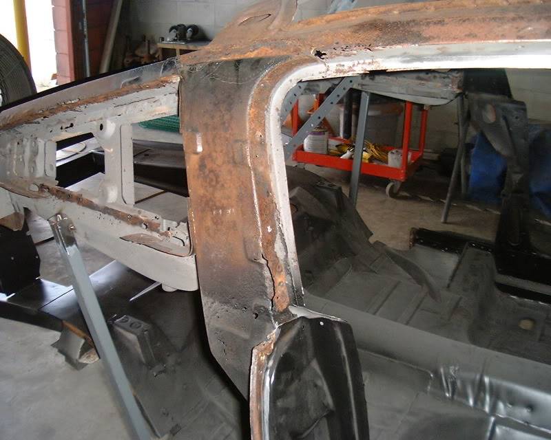

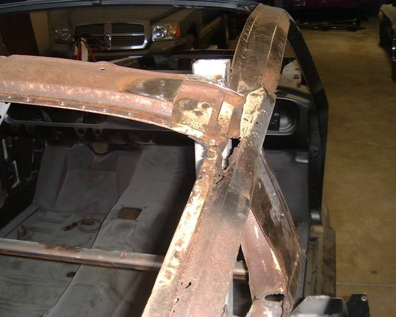

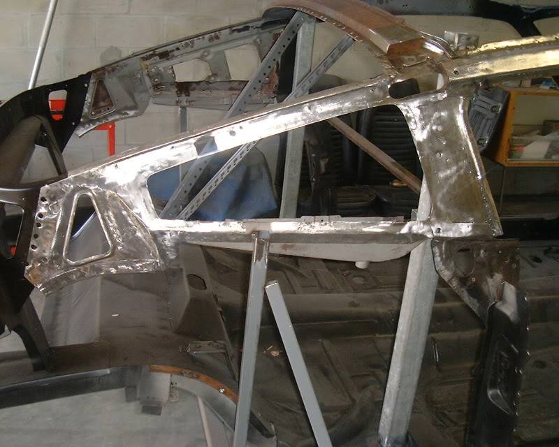

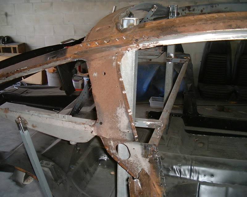

      Brian started patching the right quarter and roof inner structure
      The outer structure was removed so he can repair the rust under it.
      Brian made the first patch

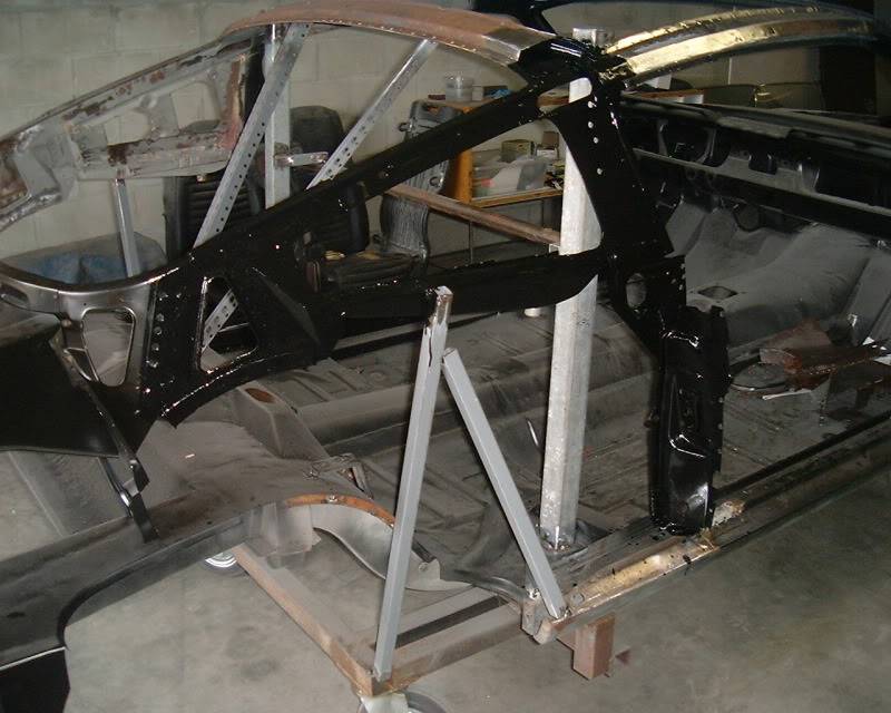

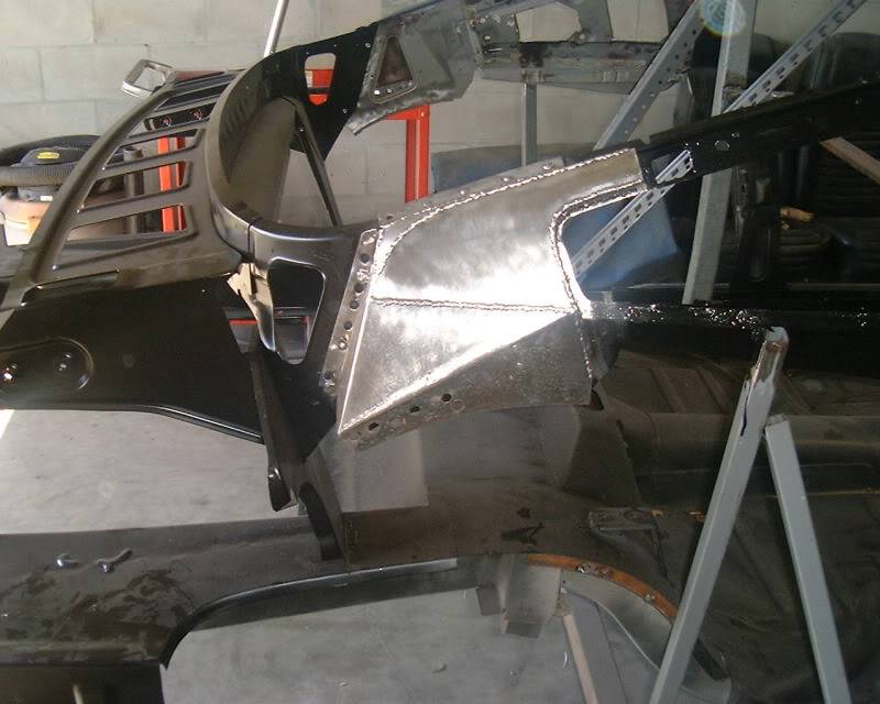

      Brian made a few patches than cleaned everything and epoxy primed
      Starting to put the puzzle back together

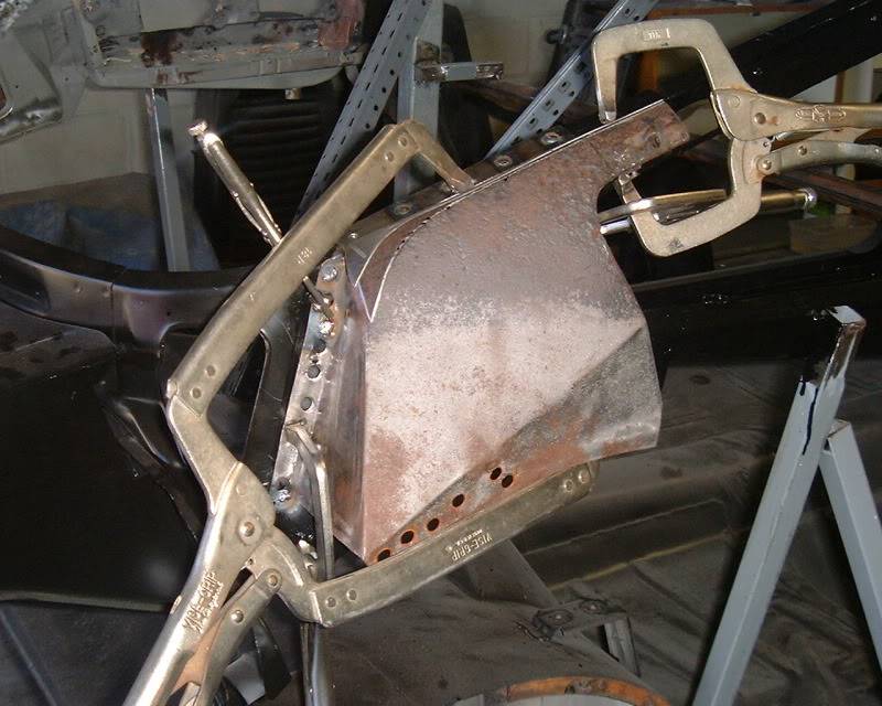

      More pieces of the puzzle added.
