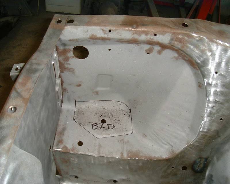

      Yeah guys....I was hoping she would come back from the blaster a little cleaner. OUCH.

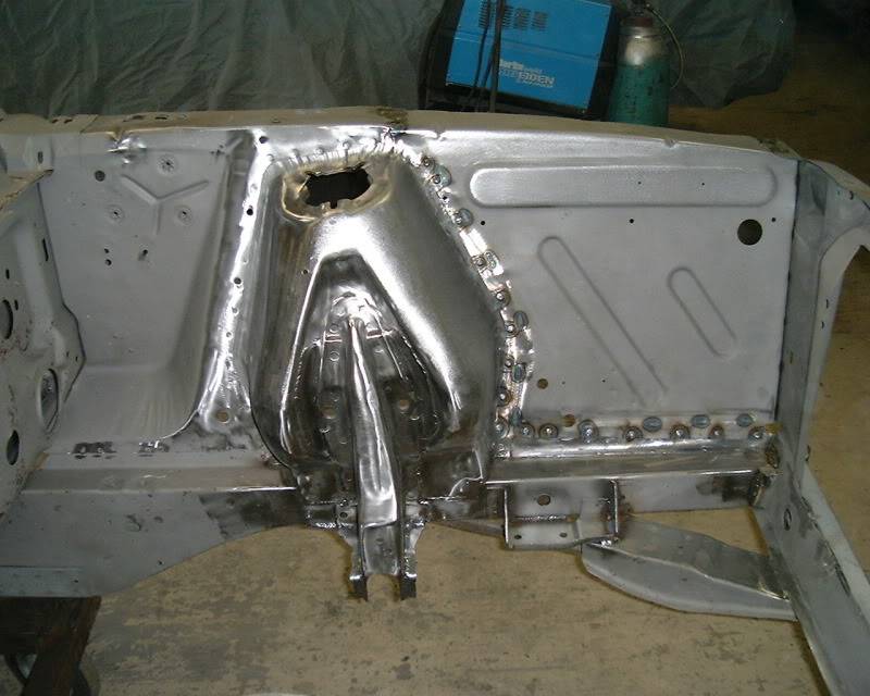

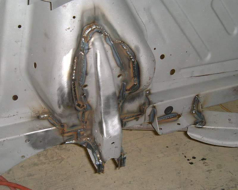

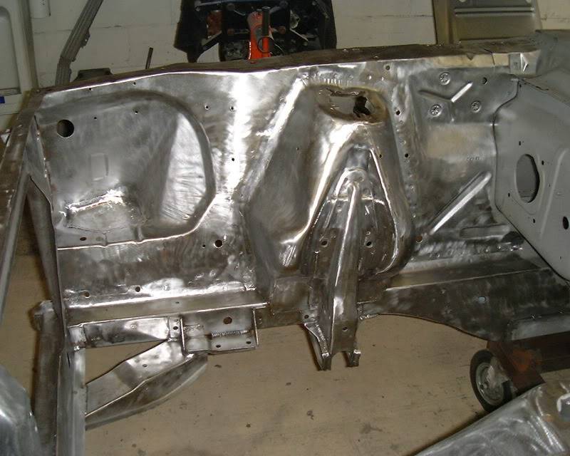

      I had Brian weld the shock towers since we are going to be using Opentracker front suspension

      What you did to the shock towers, is that what they call "stitch welding"? Sorry if thats a dumb question.
    8. #28
      Aug 2008
      41
      Stitch vs Seam
      runningriot,
      I think that is closer to seam welding than stitch welding, though local to an area, not the whole car.
      Some guys, especially rally car builders stitch weld the car, think on an inch, off an inch throughout the car and especially in the floorpan area to keep the car strong but also allowing a little give.
      I am not an expert, but this is what I have picked up. Any all knowing people, feel free to correct me.

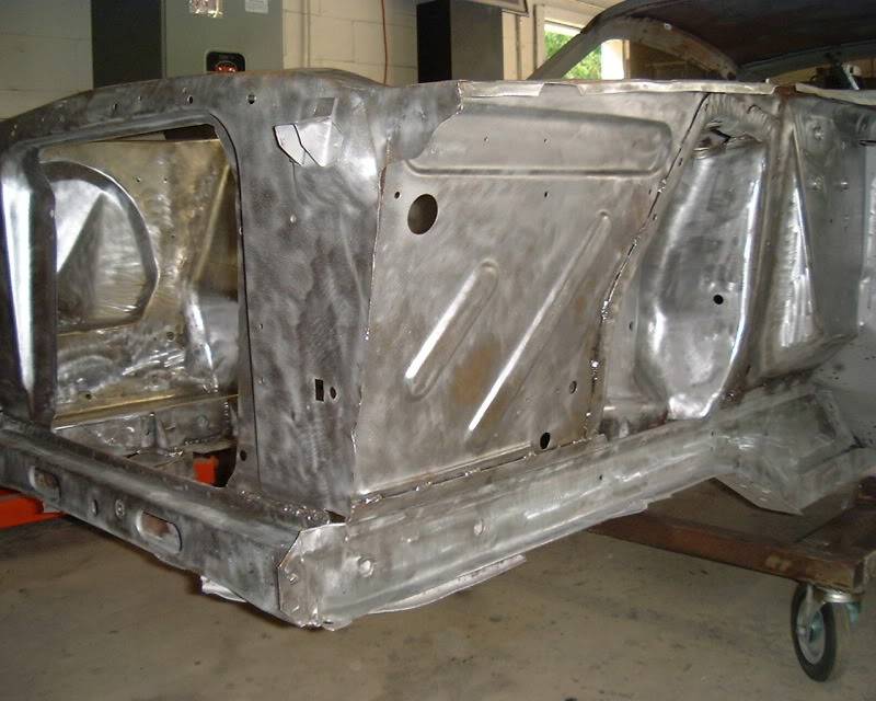

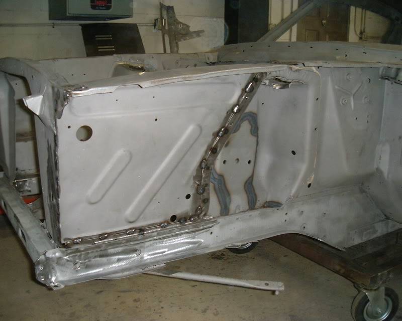

      The fender aprons had been replaced at one time but they had not cut out all of the old metal and were not welded in some places. Brian removed the fender apron cleaned it up and welded back in and repaired a little rust.

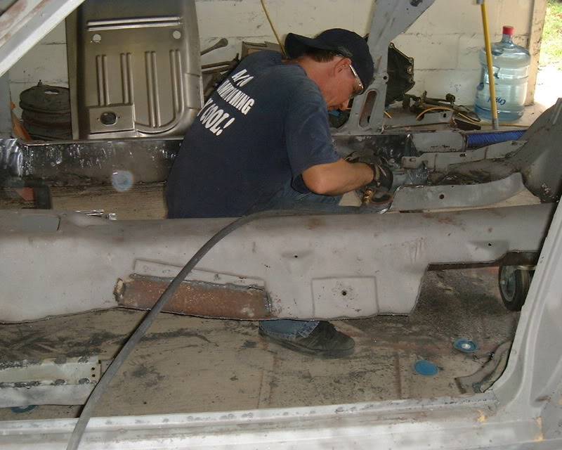

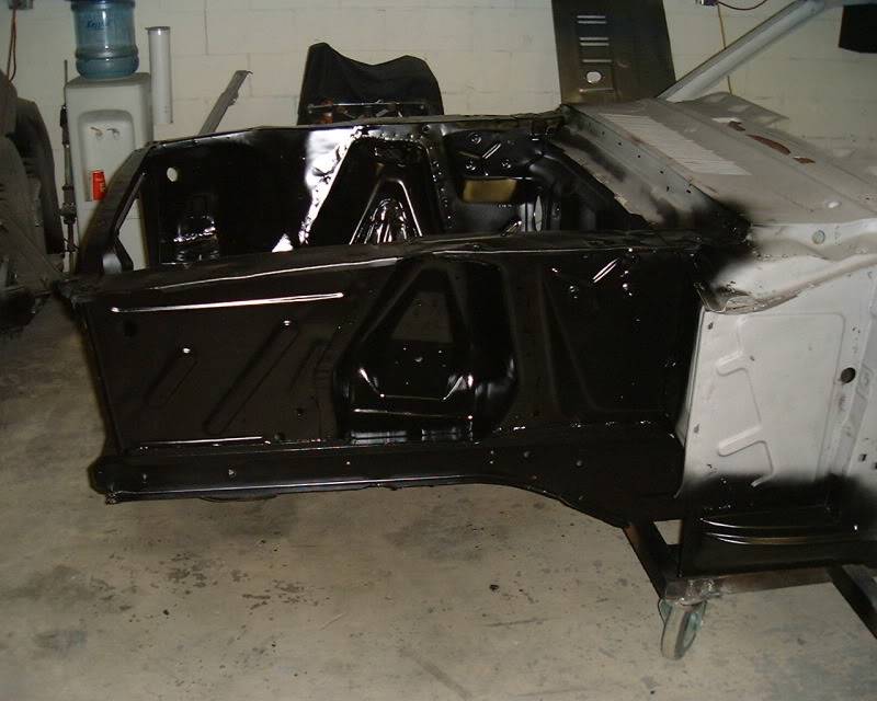

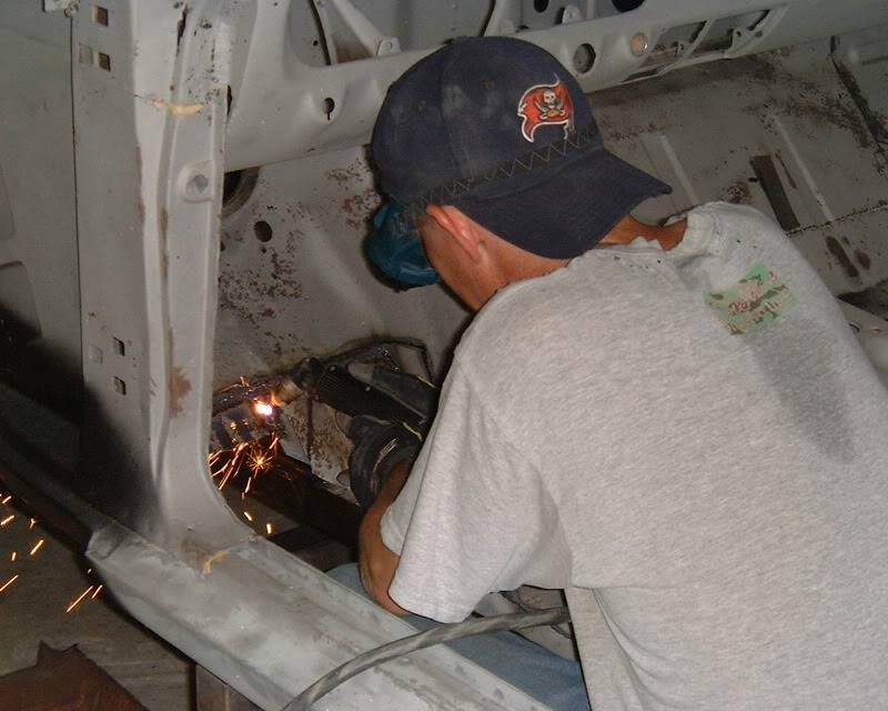

      Brian finished welding the engine compartment and epoxy primed it yesterday.

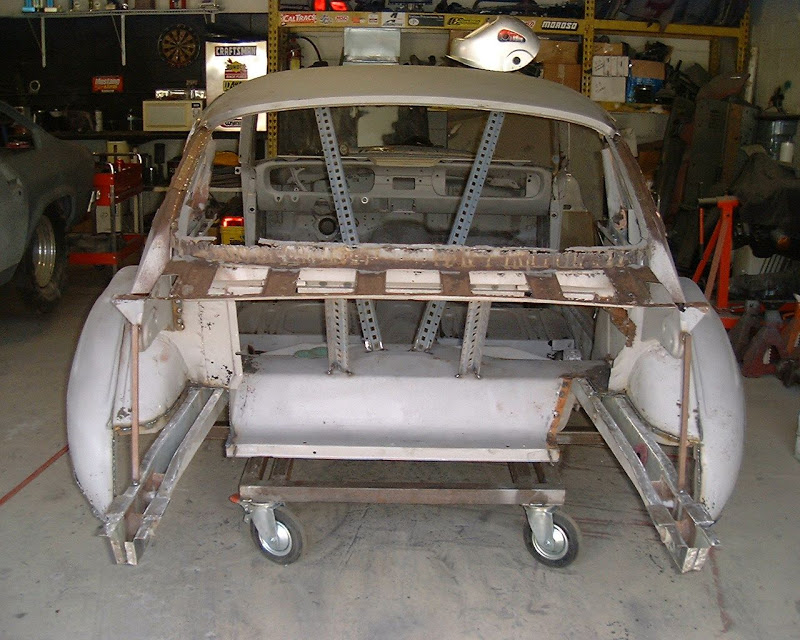

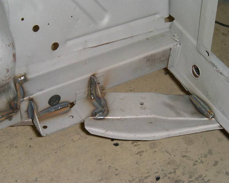

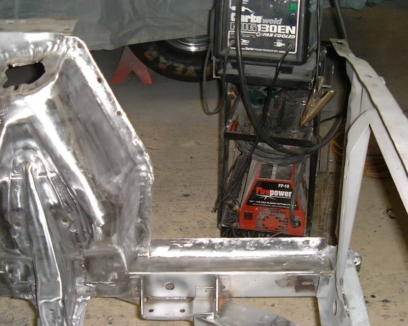

      Brian cut the floor out next step will be subframe connectors.
