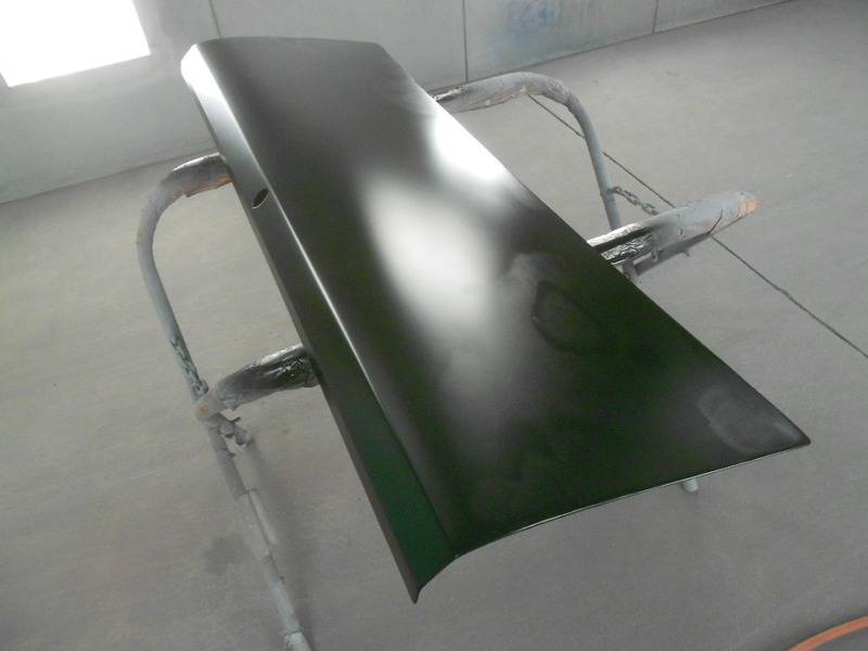

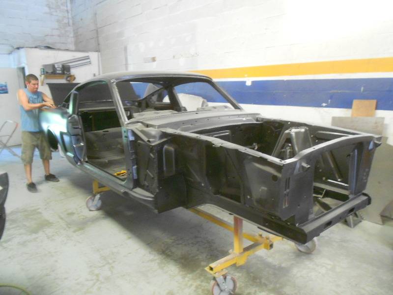

      This project has been on hold for awhile but it is time to finish it so we got it out of storage and into the fab shop. The first thing Brian did was line up the deck lid.

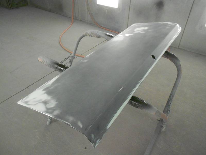

      He had to do a little cutting and welding on it and I did the bodywork and sprayed two coats of SPI epoxy.
      Block sanded and sprayed SPI Turbo primer.

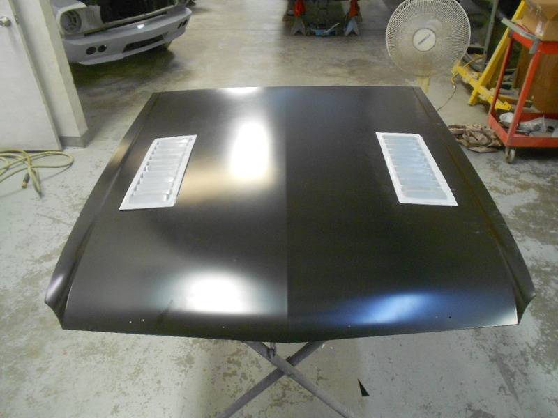

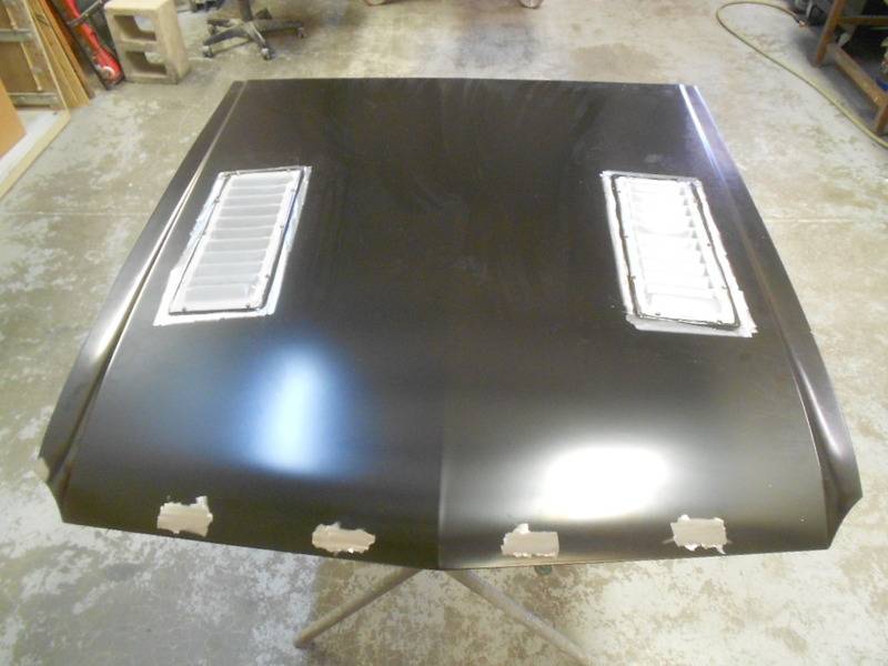

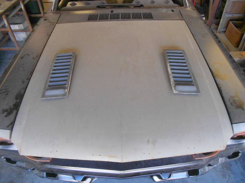

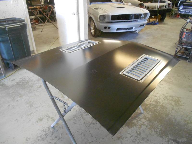

      The customer wanted vents in the hood and I found these. This is not his car.

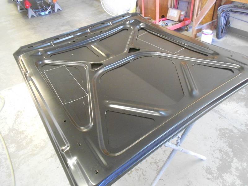

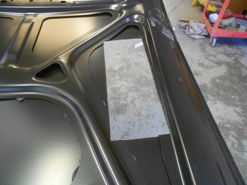

      After Brian did a lot of measuring he found out they would fit without modifying the brace.
      He just had to trim a little of the flat part of the brace

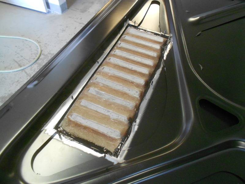

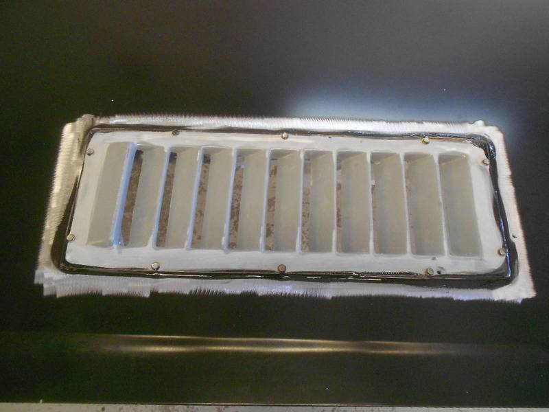

      Brian used 3m8115 panel bond.
