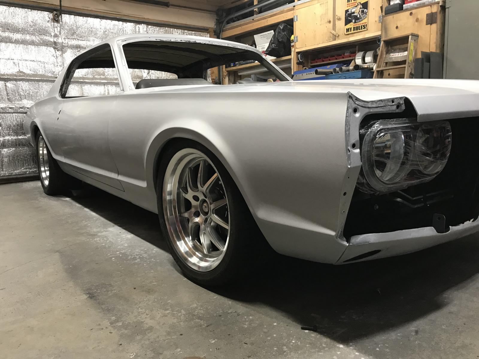

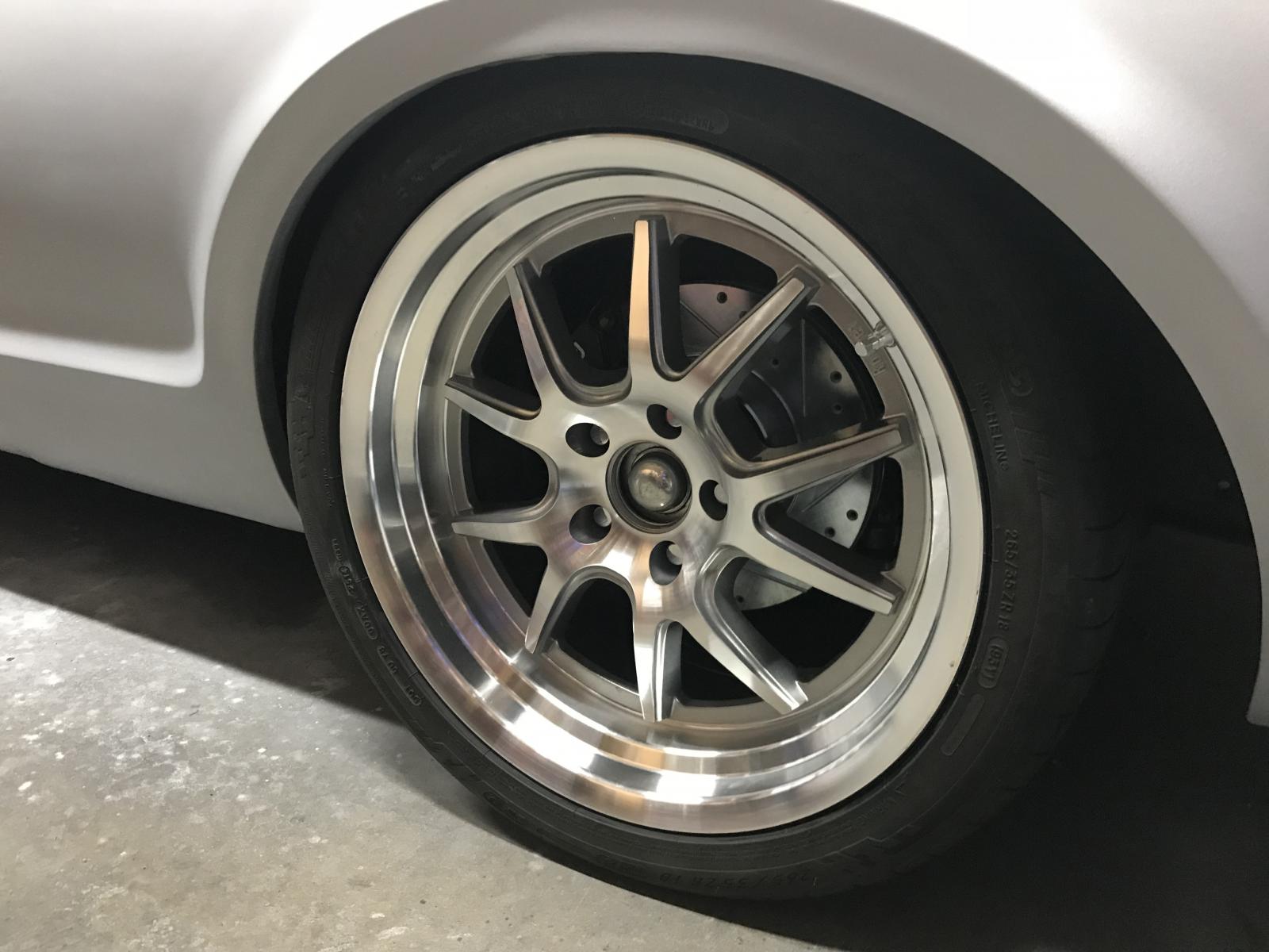

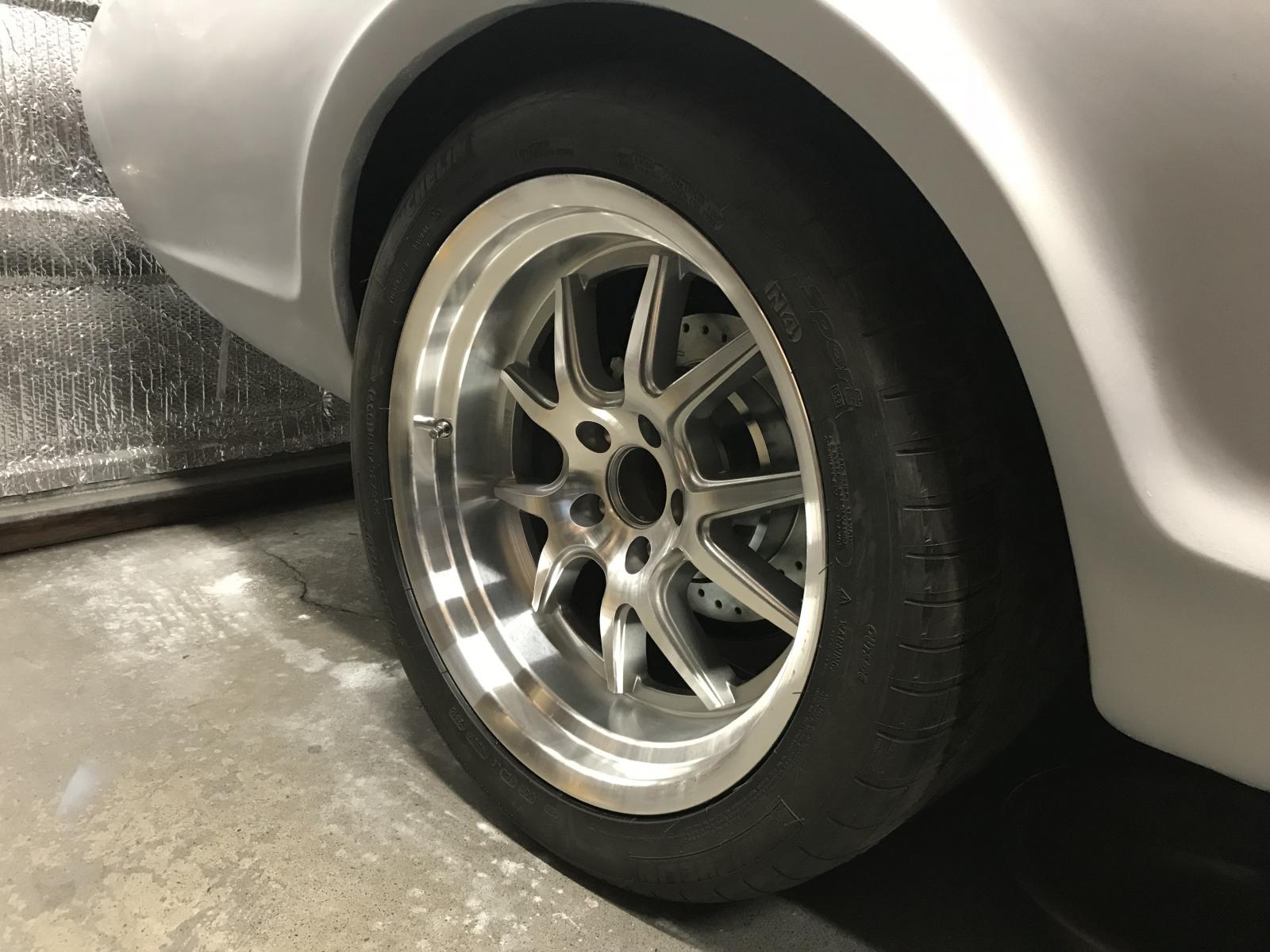

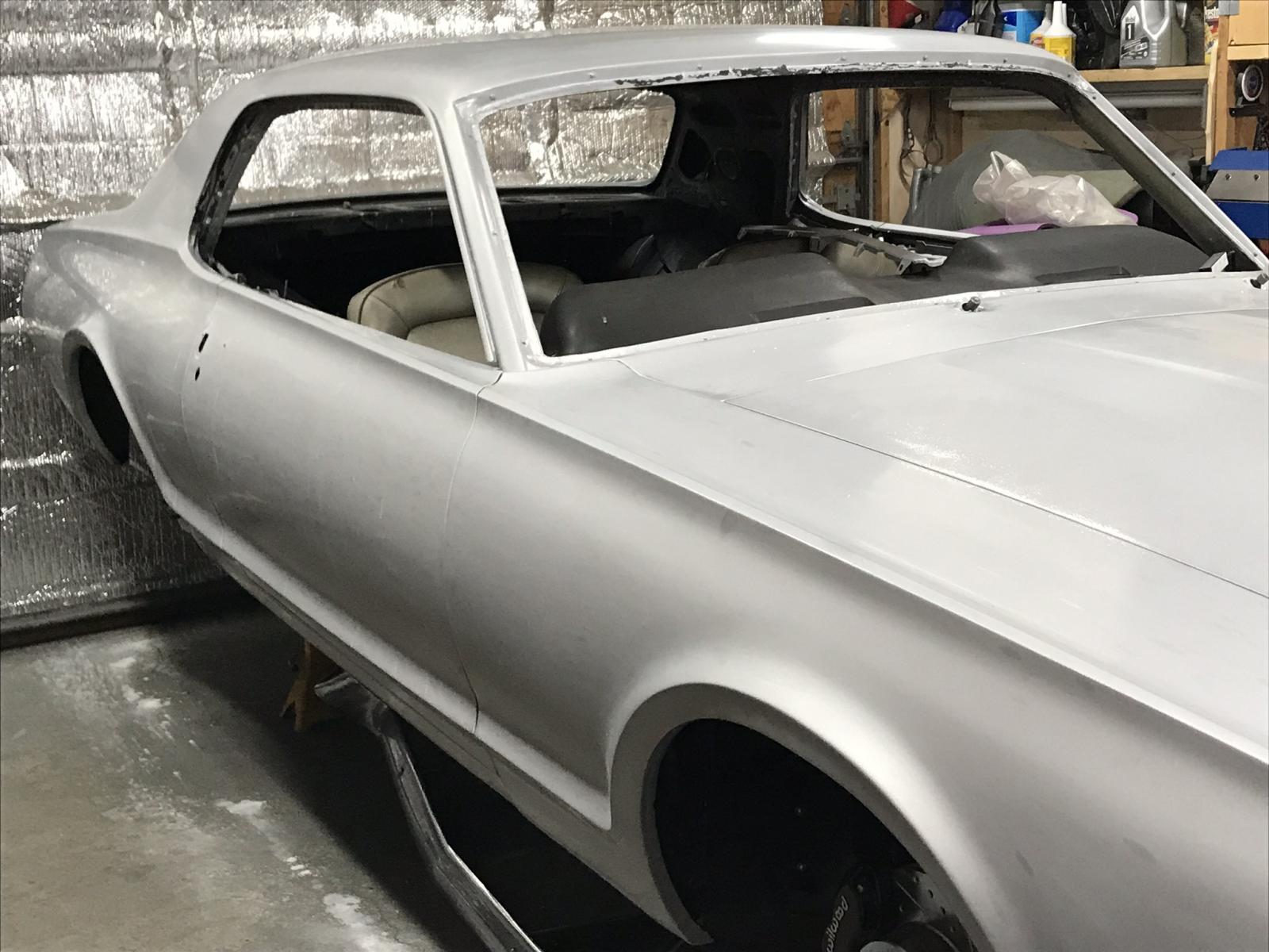

      I've been working on this project for some time now . This project started when my brother in-law gave me this Cougar that he'd owned since 1969 . He took it off the road approx. 20 years ago when it started running rough and he couldn't seem to figure out why . The guy I sold the pure stock 289 to for $200 informed me that there was a hole in one of the piston tops . I've torn it down to a bare shell and have been repairing any rust damage that I have found , which has been found in the rear quarters and front torque boxes. I have replaced the complete stock front suspension with A TCI front suspension kit including cross-member , tubular upper and lower control arms , ridetech coil-overs , power rack and pinion , sway bar , 2" lowering spindles , and Wilwood disc brakes . I've installed a Detroit Speed mini tub kit , sub-frame connectors , and rear torque boxes . I plan to install the Detroit Speed Quadra-Link rear suspension when I have the $$$$ . As for the power plant I have installed a GM 6.0 LQ9 LS motor and a 4L65E transmission . I've set the motor back as far as I could without getting silly , that being said I've modified the firewall and have fabricated a whole new trans-tunnel . I've had to do some minor body work . My recent project has been replacing the rear tail-light section sheet metal and welding in a 68 Shelby Mustang tail-light panel. I've always thought that the Cougar tail-light looked really heavy on the eye. Pictures to follow .
