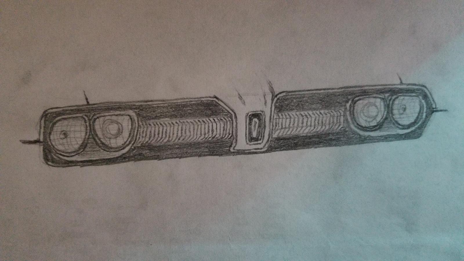

      I love the Challenger headlights and agree that they'll be better without the grilles covering them. However, I also don't think the stock radiator grilles will look right without the side pieces. So, I took the liberty of doing a quick pencil styling study. I've basically created some mini waterfall grillebars to tie it all together. Name:  20180809_211552.jpg
      That's awesome Mr. Peanut ! Thanks .
      The area between the headlights and center grille piece will be quite a bit smaller than your drawing . My plan is to build a grille piece similar to the stock grille . Thanks again for your efforts .

      Yeah, I figured I was gonna get my proportions wrong if I didn't pay attention! I actually did that sketch while I was running lights for a local theatrical production of Tuesdays With Morrie!
