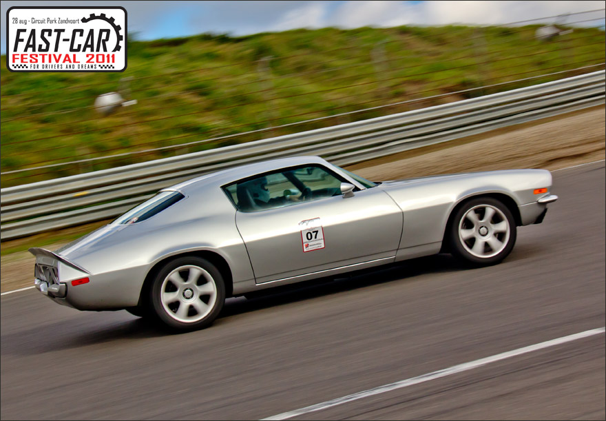

      I have 275/40/17 (25.66") in the rear with a little spare room for wider and 255/40/17 (25.03") in front both on 8,5" wheels and this is how it is with Hotchkis rear leafs and QA1 coilovers in front:
      I think the 27" rear will fill the wheel wells better and the higher wheels will give more ground clearance while looking lower because of the more filled wheel wells.

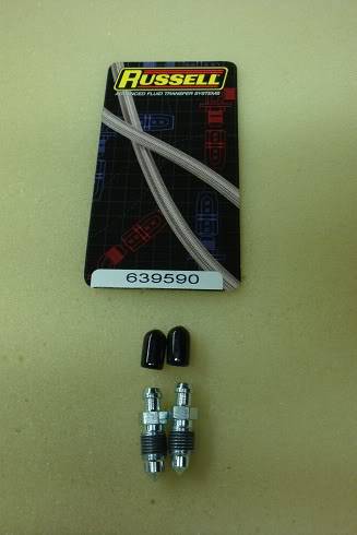

      Just finished putting in the Russell speed bleeders and bleeding the brakes.
      WOW!!!! Are they easy to use. This is the first time I have used them. I think it took me about 15minutes to bleed all four corners.
      I'm sold.

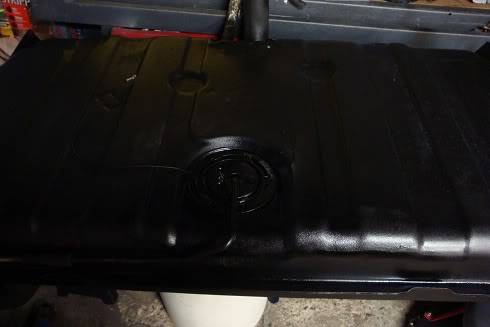

      Scubbed down the gas tank today and will hit it with a coat of bed liner tommorrow.
      Inside of the tank looks like it was just put in last week.
      Pretty amazing for a 40 year old tank.
      I was going to coat the inside of the tank until I saw what great condition it was in.
      Orderd a new pickup and anti-squeak pads.
      I have read alot of stuff about differant vent systems but I think I will just keep the original.
      Just going to replace the charcoal canister with a filter hidden in the front fender.

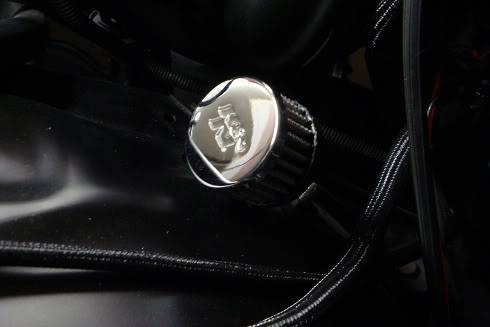

      Coated the gas tank with bed liner, installed the new gas tank sending unit today.
      Also got the K&N filter in for the gas tank vent tube.
      Read alot of the posts out there about vent systems and the common thread through all of them is that the stock ones work really well.
      So I just descarded the original charcoal canister and replaced it with a small K&N filter hidden in the front fender.

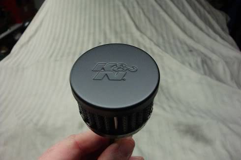

      Ok, I know it's a small thing but, I love the small details.
      The K&N filter just didn't fit with the anti-chrome look I'm going for.
      So, I painted it satin black.
      I know it will be hidden in the fender but I couldn't help myself.
      I would know it's there.
      Again, I love the small details.

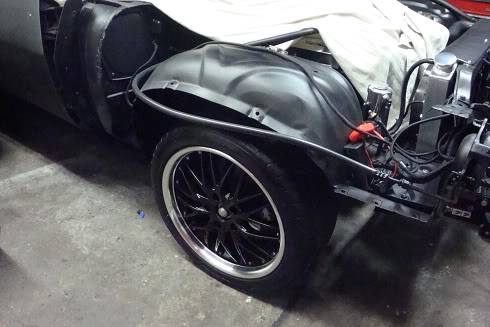

      Picked up 4 MRR Gt-1 18" wheels mounted with Nitto's today for very cheap.
      Even if I don't use them, their good for mock ups for future projects.

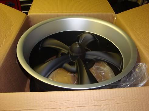

      Decided to go in a differant direction with the wheels.
      Found these 18" wheels with the perfect backspacing and the satin black with the brushed machined look to the outer rim of the wheel.
      Matches the engine compartment perfectly. Plus I want to brush the bumpers too.
