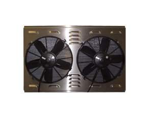

      Have settled on this setup.
      Dual Spal fans with aluminum shroud.
      Total cfm 3260. Ordered it today.
      Also ordered the programmable wiring kit.
      Includes all the relays, wiring, fuses, fan pigtails and sensors
      for the dual fan setup.

      Just got the new dual Spal fan setup in.
      Hope to be in the garage tomorrow to test fit it.
      Should cool nicely.

      Finally, here are the fans and rad put together.
      I had the cut the corners of the fan shroud and bend the sides out a little so there would be no gaps between the shroud and the radiator.
      Worth the effort, no gaps.
      Now I just have to sand and polish out a few scratches that are on the rad.
      Then time for final install. No more trial fits.

      Which radiator did you end up going with? I have used Spal fans on all my projects and they work good. They seem to move more air than similar other brand setups.
    11. #31
      Feb 2009
      N.J.
      690
      I had bought a Champion rad several years ago when I started the project, just to start collecting parts.
      I was under more of a budget then, than I am now so I hope it works out ok. I have read many good thing and a few bad things so we'll see.
      I really like the finish though and the shoud is very nice too.
      The Spal fans have a good rep so I'm sure they will work great.
