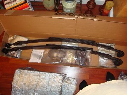

      I came home today and Santa had come(that's what I like to call the UPS guy).
      Hotchkis leaf springs. Made my day.

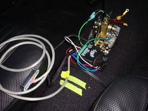

      So then, got the drive shaft in and started to wire the shifter up.
      This shifter has more wiring than any shifter I have ever seen.
      Not sure about how to wire in the nuetral safety switch relay, so I will call Lokar on tue to finish it up.

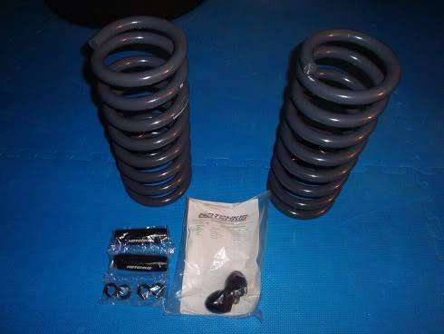

      690
      I get such a thrill at seeing the UPS or Fed-Ex truck pull up to the house.
      Today I got more goodies from Hotchkis.
      Front springs and tie rods sleeves.

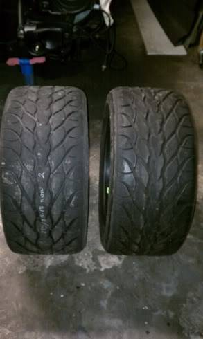

      Got my mockup tires in.
      Big thanks to Bret & Greg over at ridetech for putting up all their old testing tires for sale.
      Picked them up for $20 a piece. Wasn't sure what size I wanted to go with but now I know.
      These are BFG KDW 275/35/18's and I think I will go with 285/40/18 for the rear and 245/40/18 for the front.
      Now I just have to find a set of wheels that I like.

      Quote Originally Posted by aps63 View Post
      a 285/40 will be a tall tire. 27" tall in fact, and about 1.25" taller than the fronts. This will add approximately .625" to the final rear height of the car. To keep the car somewhat level in stance, you'll have to compensate for that. I think I remember reading you ordered a 2" drop in the front and 1.5" drop in the rear. Jeg's carries a wide range of lowering blocks you can use to dial in the final stance. I'd consider running a 35 series side wall or shorter to keep the overall wheel height down in the rear. This will not only help out with final stance, but a shorter wheel improves overall gearing too.
      Last thing to consider is rim width for that 285. You might not find a rim you like available in a 9.5" wide rim. You might have to jump up to a 10" wide rim. Now rim backspacing becomes critical and a mini-tub might be needed depending on how low you want the rear to sit.
      - David

      What i've found out with mine is that the front is in fact 3/4" higher by nature and the 27" in the rear would work perfect.
      Quote Originally Posted by MyFriendScott View Post
