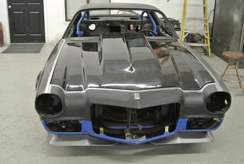

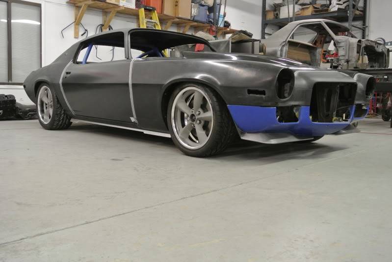

      If there is enough interest I will look into getting molds made of the Front Spoiler so Troy can sell them.

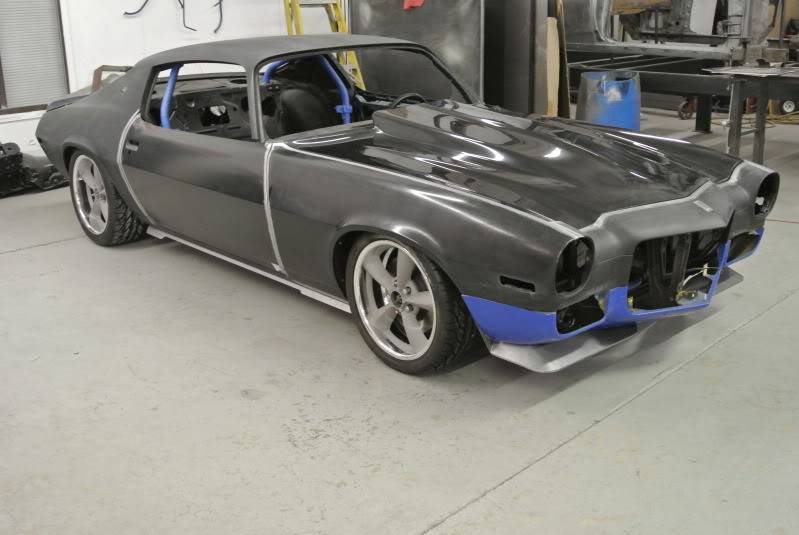

      I saw the car in person on Saturday and the front end looks great. When it comes home in two week I will taking the spoiler to the Fiberglass shop to have molds made.
      At this point it looks like we will be making at least 5 sets

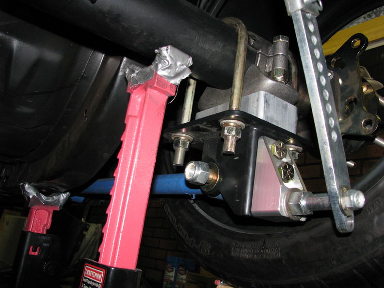

      2nd Chance Camaro - Ride Tech Coil Over Rear Suspension Part I
      2012 04-15 Update - Ride Tech Coil Over Rear Suspension Part I
      www.2ndchancecamaro.com

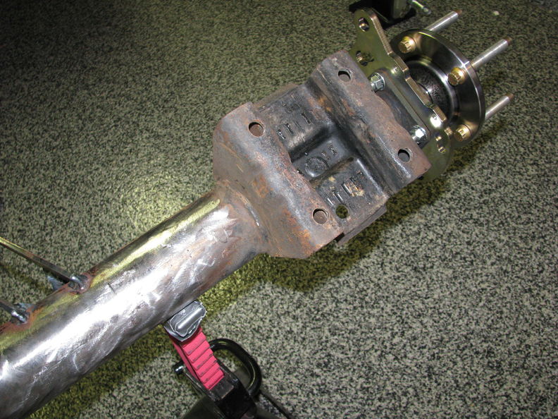

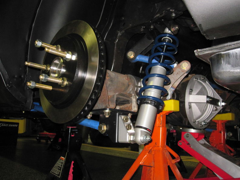

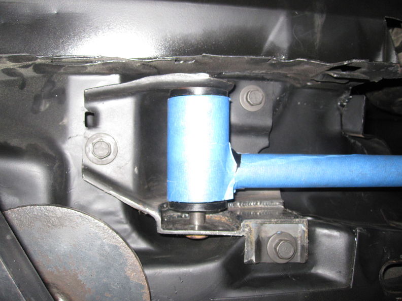

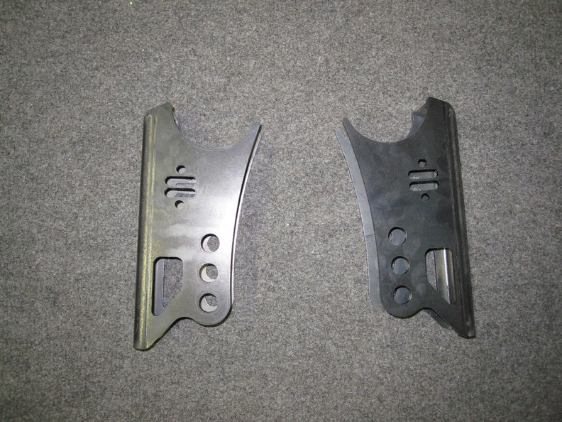

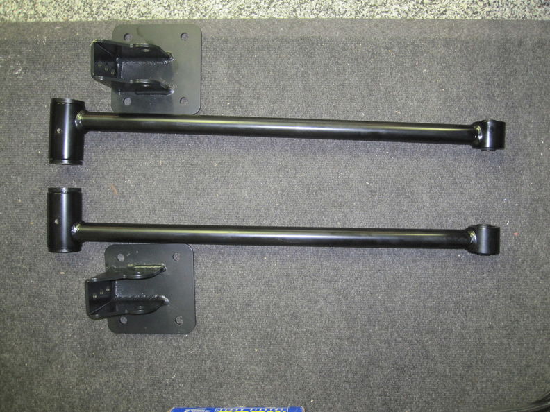

      Good Morning all,

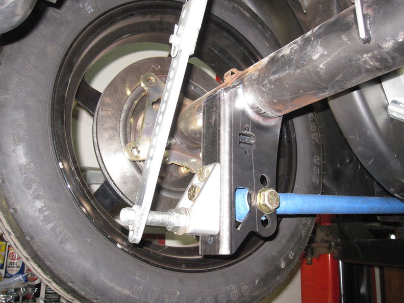

      For the rear suspension I upgraded to the Ride-Tech Coil Over set up. However we've added a few new
      parts that Ride-Tech offers. First is there offset lower link bar and offset spring mount which gives you an
      extra 3/4" of tire room. There will be plenty of room to fit the BFG 295 (12.5" wide) and most 315's.

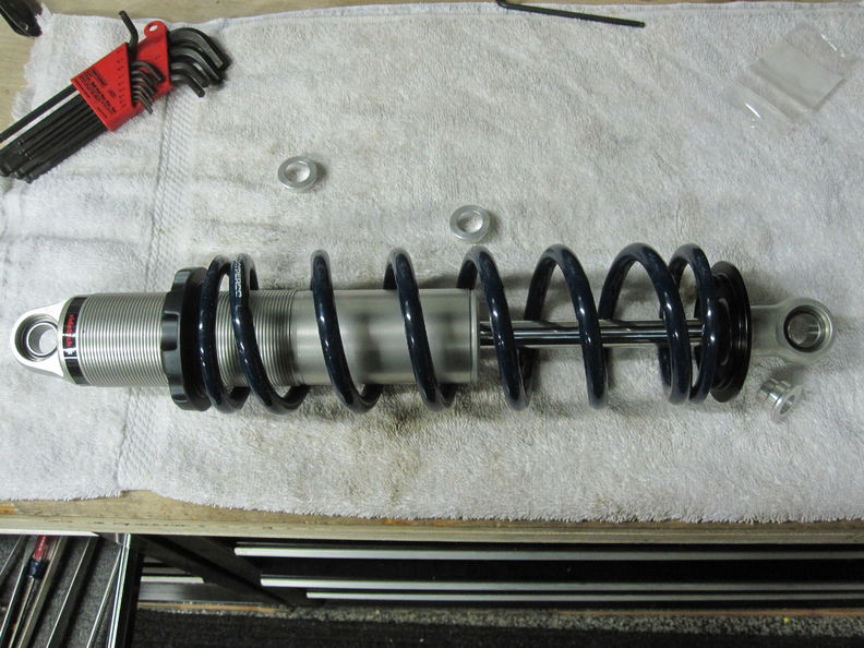

      There new Coil overs - what else do I need to say.
      Very Simple Install.

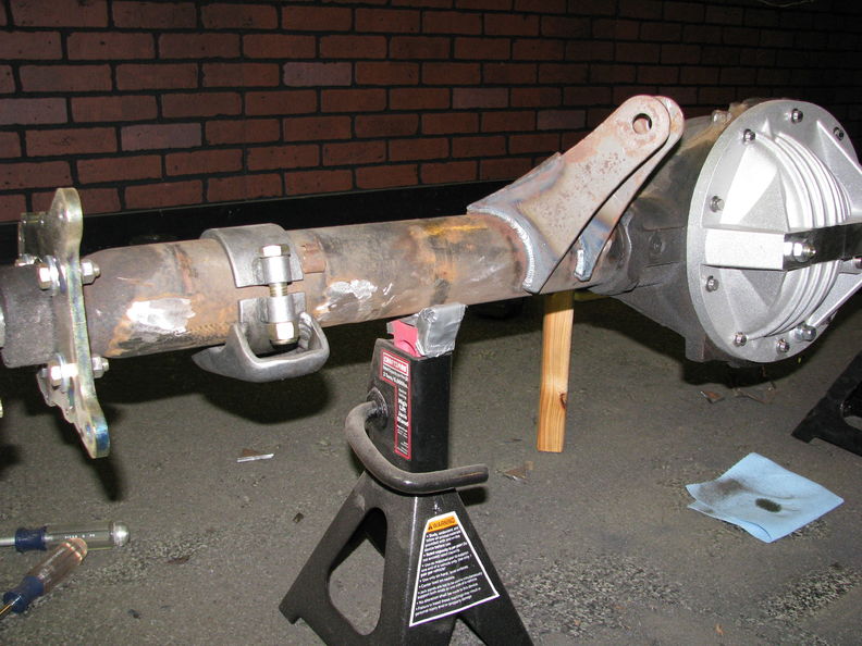

      Okay Plan B
      Yes I am changing things just a little. I am going to remove the factory spring perch and install Ride Tech's
      new weld on lower bracket. I think they are going to clean up the area. The plan is to move the arm over
      another 1/2 which will allow me to fit the BFG 335. It will also allow me to fit the Michelin 345 which is an 1"
      narrower then the BFG 335.

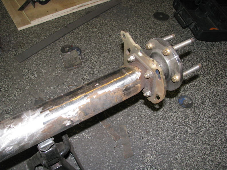

      Before I bring the car to High Speed Welding I am going to cut off the spring perch's off the axle.
      In order to get it back to High Speed Welding I used some of my extra parts. This cool little part came from
      DSE. Originally I was going to keep the leaf springs but since they wouldn't sell me the front spring pocket
      parts I needed that idea was soon scrapped. I made a quick call to Ride-Tech and purchased there
      complete rear kit. So if anyone needs these brackets there just sitting on a shelf at my shop.
      Priced to sell cheap !!!
      Ready for Transport
      Here are the new brackets from Ride Tech. They are really going to clean up the area.
      Pictures hosted by www.garagescene.net
      marty-mj

      I like those lower brackets. I am going to be picking up a new rear with a posi, so I may get those brackets and weld them up before powder coat. I wasn't aware they existed.

      They are really nice. I will try my best to post up another update today to show you how much better they look.

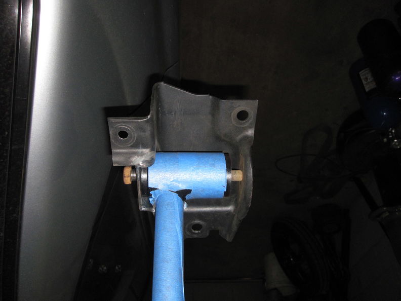

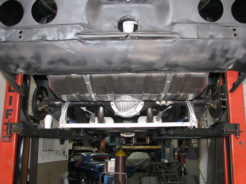

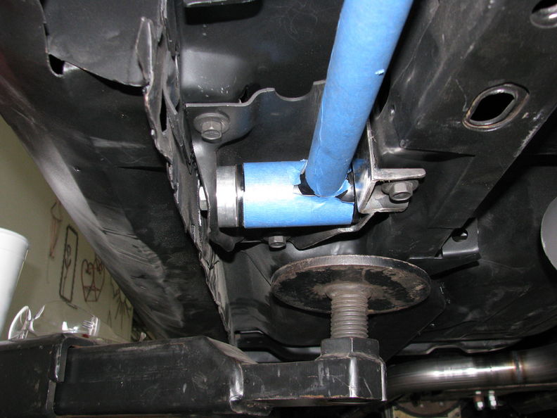

      2nd Chance Camaro - Ride Tech Coil Over Rear Suspension Part II
      2012 04-16 Update - Ride Tech Coil Over Rear Suspension Part II

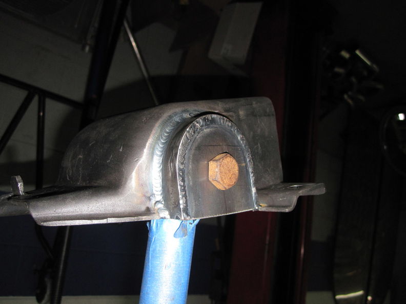

      Here is what the bracket looks like when it is removed.
      I need to thank a couple people here.

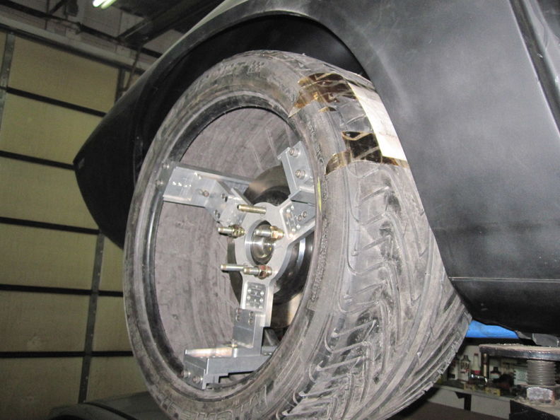

      Mario from US Collision for letting me borrow his 345 Michelin tire and Chris at JCG Customs www.jcgcustoms.com for letting me borrow his 3 finger wheel tool. The 345 fit perfectly after this very simple modification.
      The new Ride Tech lower bracket installed. Much cleaner look and no more ugly u-bolts.

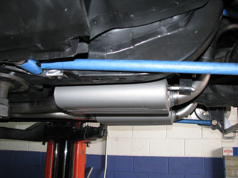

      Joe has also been working on the Edelbrock modified exhaust. He made a couple modifications to the floor pan to get the exhaust above the site line under the car. I am very happy with the progress of the exhaust so far.
      All done and ready to roll.
      pictures hosted by www.garagescene.net

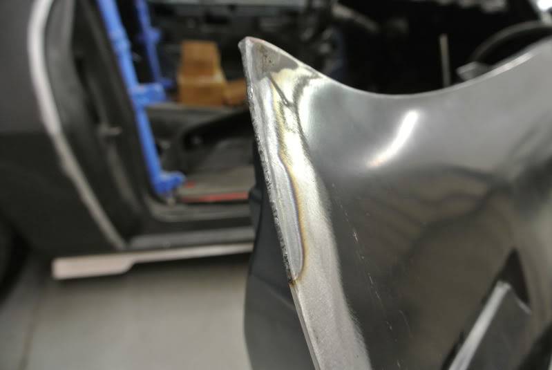

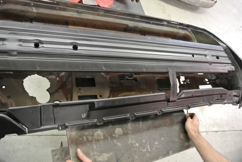

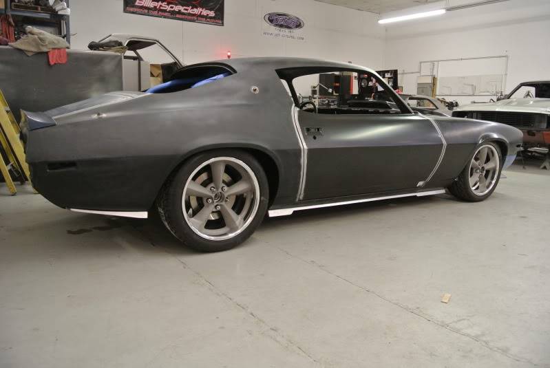

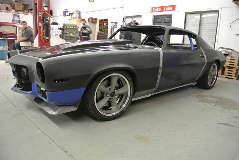

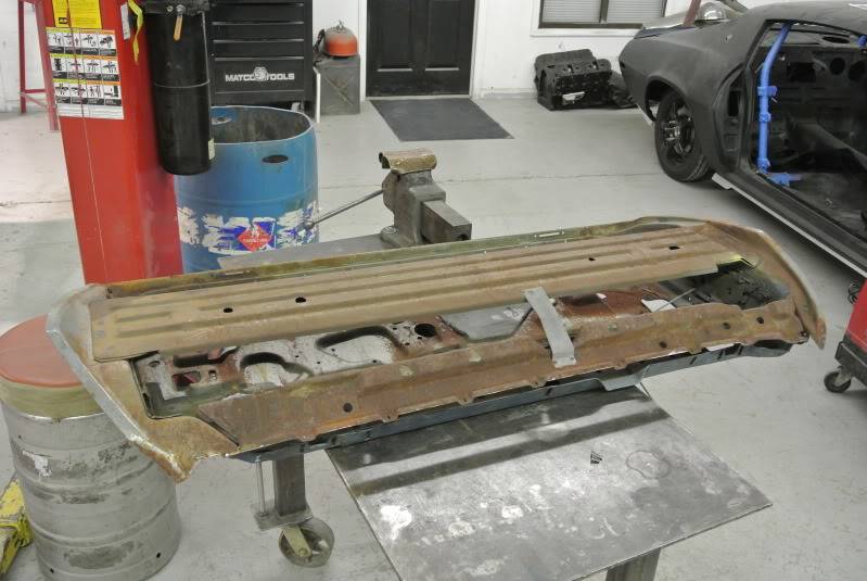

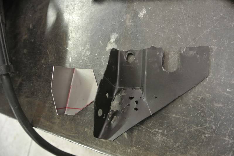

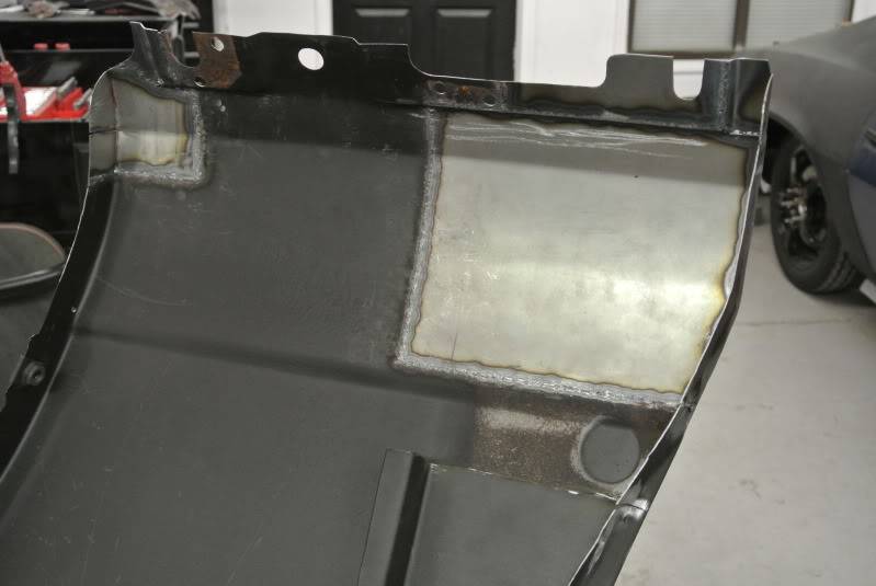

      2nd Chance Camaro - BBT Fab Sheet Metal Repair
      2012 04-17 Update - BBT Fab Sheet Metal Repair

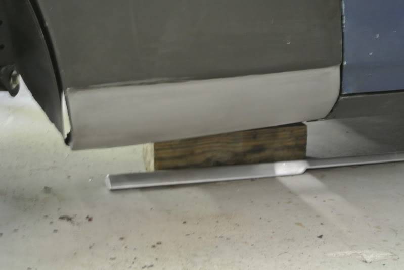

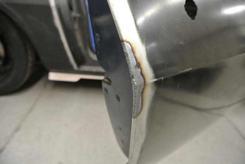

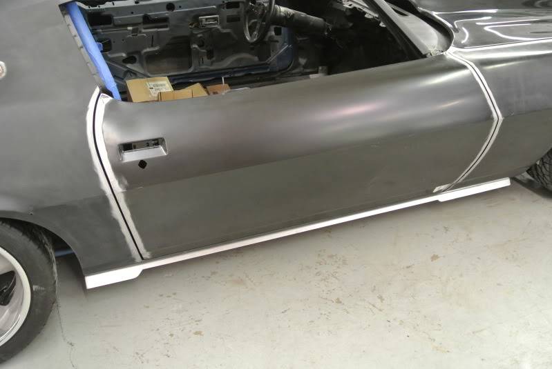

      Troy from BBT fab posted an update on the Camaro today. He is donig a great job on the car.
      Finished up all the gapping and some rust repair on Martys camaro.
      Troy
      marty-mj

      875
      Nice door lines!! It's almost as if troy knows what he's doing!!

      97
      Great project looks like its coming together nicely, you are doing an amazing job man! The stance with wheel/tire combo looks just right!

      10
      Looks fantastic. Gaps are looking really good. Like the skirts and spoiler. Love the stance!
