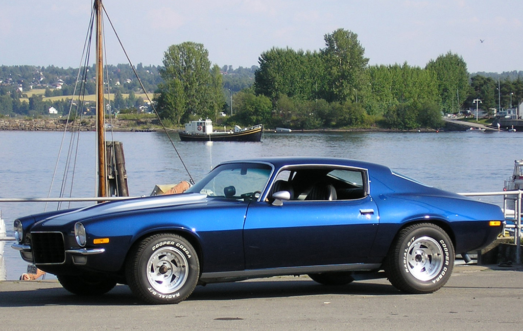

      Nice Project I have a -71 Camaro that I'm working on... Had it for 12 years now
      Imported the car From Sweden to Norway in January 2000.
