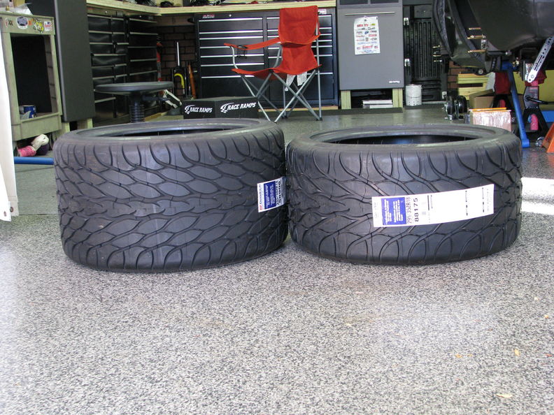

      So here are the two tires side by side. 335 on the left and 295 on the right.
      Since the goal it actually drive this car I am pretty sure I am going to be using the one on the right. However I will still make sure the bigger 335 fits under the car.

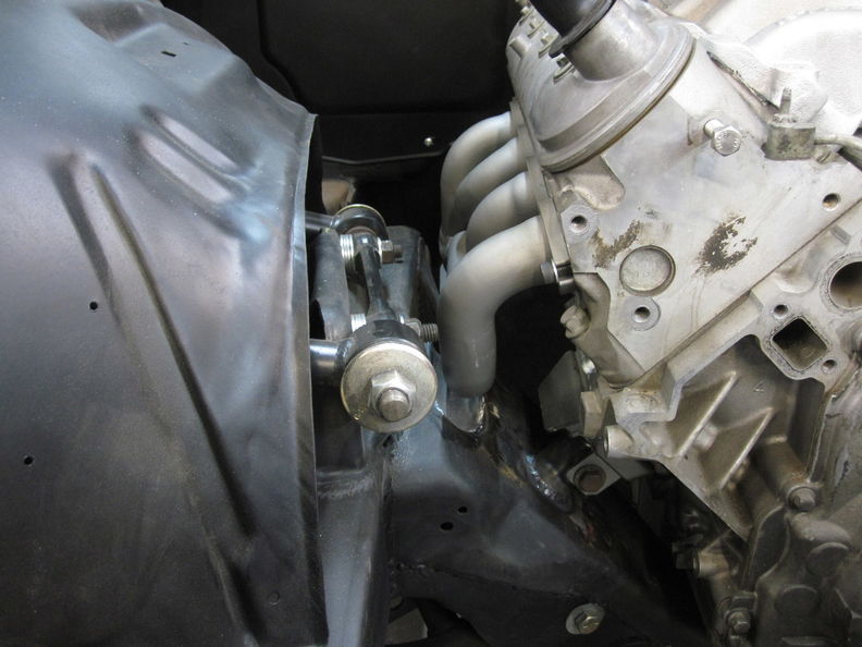

      Evening All,

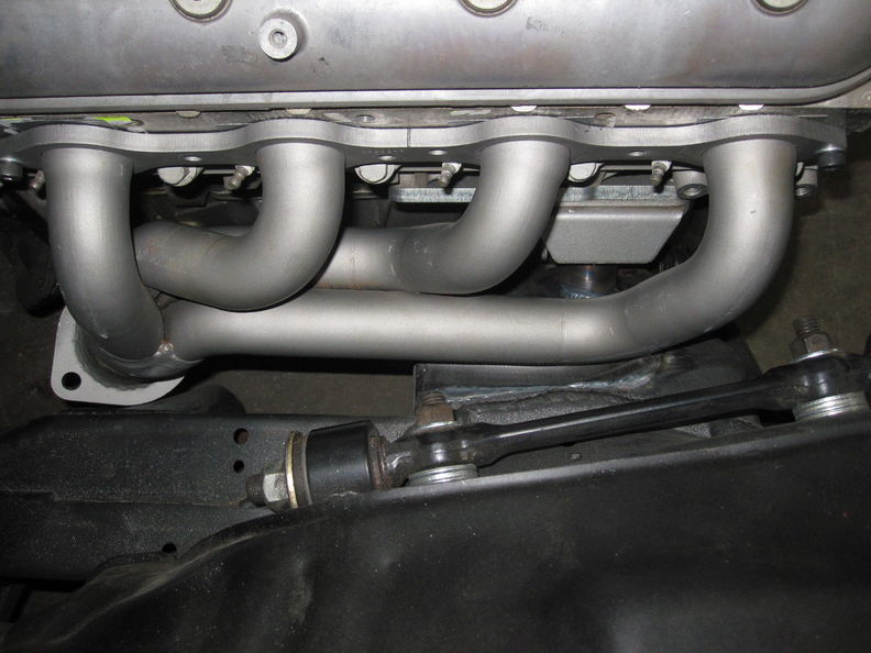

      To keep things simple I wanted off the shelf headers so I ordered up a set of Edlebrock shorty headers for a 2010 Camaro. Very nice
      piece I may order a set for my 2010 Bumble Bee.
      We needed to add a little extra clearance so the guys at High Speed Welding notched the frame to clear one of the tubes on the passenger
      side.The good news is the drivers side fit perfectly.

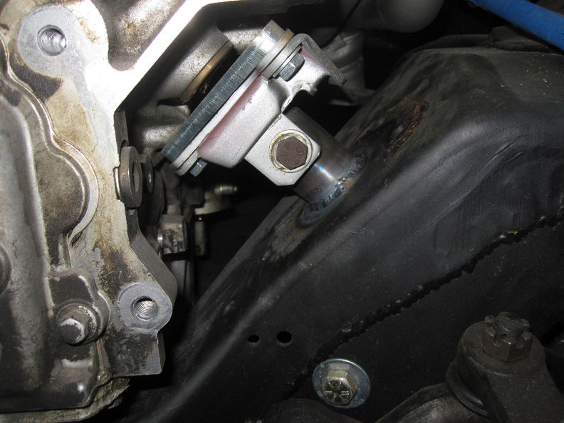

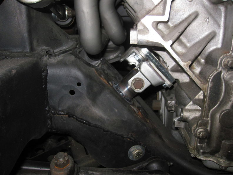

      A close up of the motor mount stands welded to the stock subframe. I also used the Edelbrock set back plates so I could use the stock style
      motor mounts.

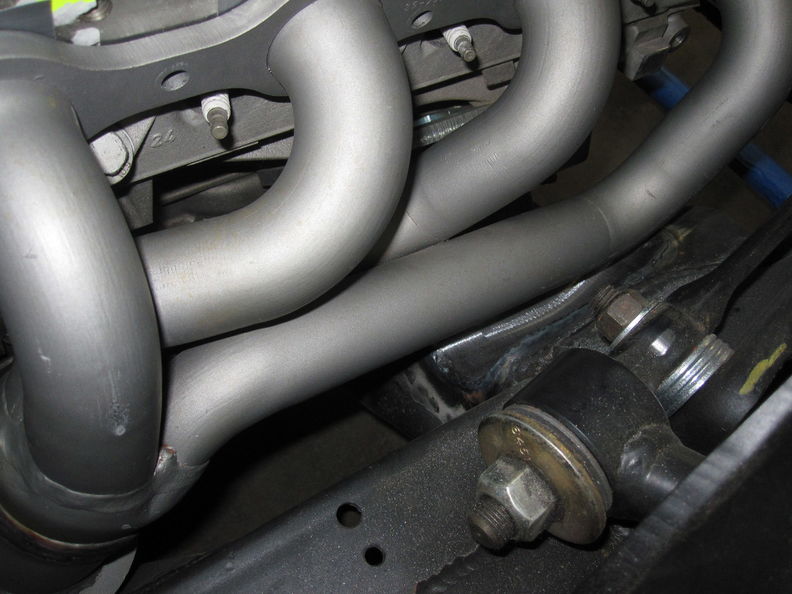

      Looking down you see that the collector hits the subframe so a little more work is needed on the passenger side to make the header
      work.
      One of the reason for the shorty headers is ground clearance. Since the car will be sitting 6" off the ground the exhaust needs to tuck
      up tight to the floor. There is only 4" of space between the floor and the bottom of the subframe thus there is no true way to hide
      the exhaust unless you run a down-pipe style exhaust.

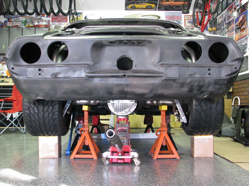

      2nd Chance Camaro - High Speed Welding Edelbrock Exhaust Mod Post 1
      2012 10-22 Update - High Speed Welding Edelbrock Exhaust Mod Post 1
      www.2ndchancecamaro.com
      Afternoon All,
      The guys at High Speed Welding are finishing up the exhaust and it should be done by the end of the week.
      The goal is to tuck the exhaust up tight to the stock floor pan.
      Close up of the new downpipes on the shorty headers
      You can see that nothing is hanging below the Stock Sub-Frame as the car will be 5 1/2" off the ground.
      In order to tuck the muffler tight to the floor they had to raise a section of the stock floor pan.
      It was very important to keep the factory rear seat for my girls to ride in.
      Finished front half of the exhaust.
      The G-Force cross member made tucking the exhaust up easy. This is a great piece !
      Up and over the axle is going to be exciting as the car has been lowered 3" in the rear so it's going to be a tight squeeze.
      I love how pictures make things look closer then they actually are.
      More to come this week.
      Pictures hosted by www.garagescene.net
