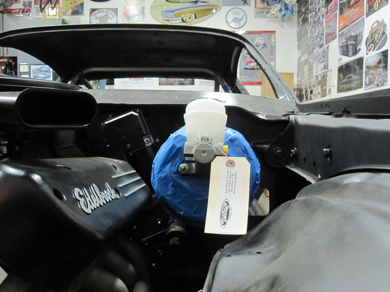

      2nd Chance Camaro - DSE Brake Booster Install
      2012 07-02 Update - DSE Brake Booster Install
      www.2ndchancecamaro.com

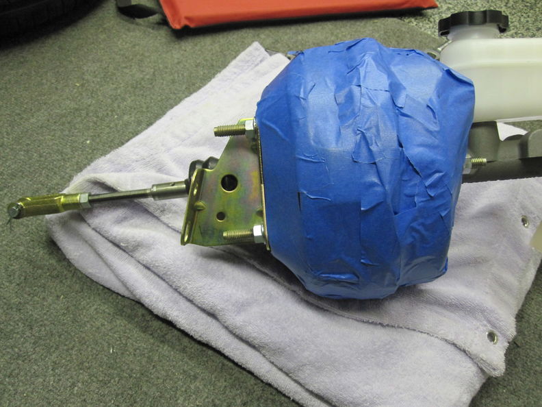

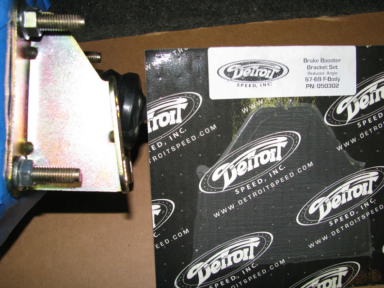

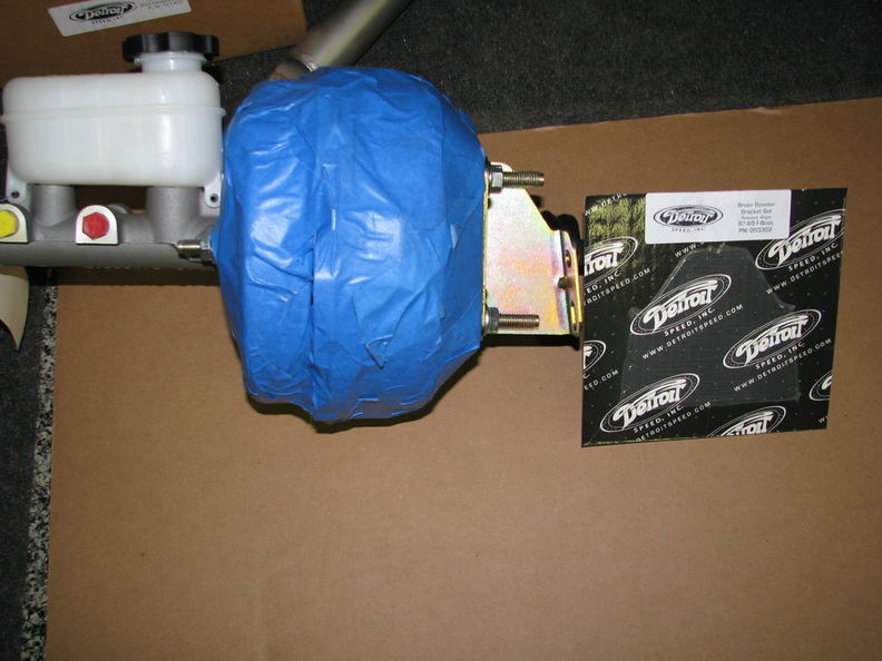

      Good Evening All,
      It's very important to mock everything up before paint and final assembly. The perfect example is what happened when I installed
      the Brake Booster. The angle is off even though this is the correct DSE part number for a 70 Camaro.
      You can see that the hood won't close with the supplied bracket. So back on the phone with DSE to talk with Tech Support,
      send some pictures and wait for a response & solution.
      A few weeks later DSE has a solution and it's simple bracket swap. I like simple, especially when your trying to build a bolt-on
      Camaro.
      The new bracket part # 050302 if you need one.
      Problem Solved - Thank you DSE

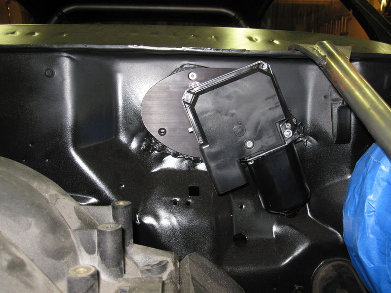

      Good Morning All,
      First up order the DSE closeout panel.

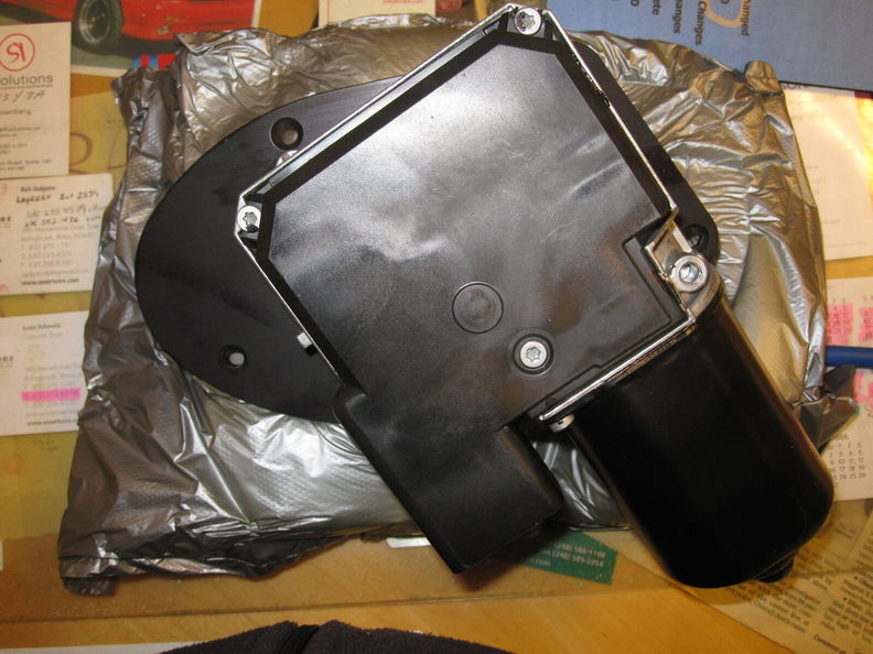

      Since the plan is to actually drive this car I am certain it will be caught in the rain more then once. Quick call to the guys
      at DSE and a Wiper motor is on the way.
      I remember back in the day when Mark Steilow was building the Mule and he did this modification. I knew that I would be
      ordering one of these for future projects.

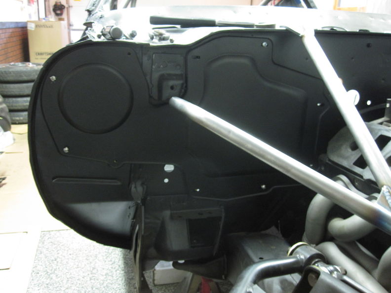

      Troy & the guys at BBT Fab started working their magic on the firewall. The goal is to have a very clean look once it's complete.
      Pictures hosted by www.garagescene.net

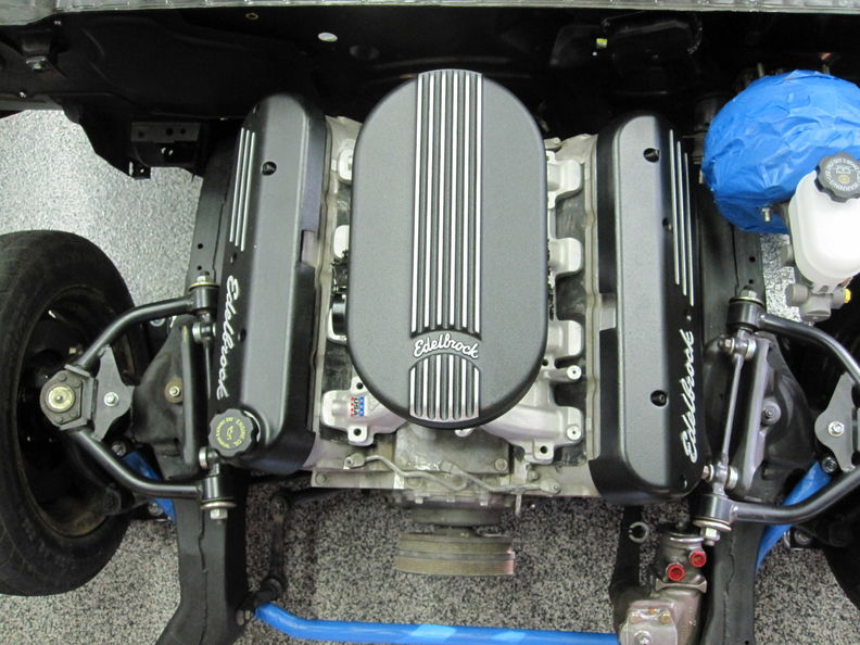

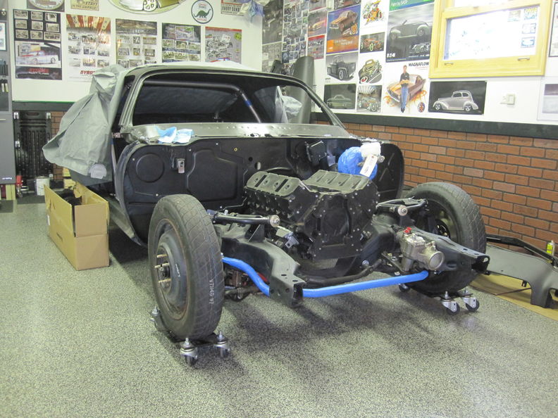

      2nd Chance Camaro - Fitting the LS1
      2012 07-04 Update - Fitting the LS1

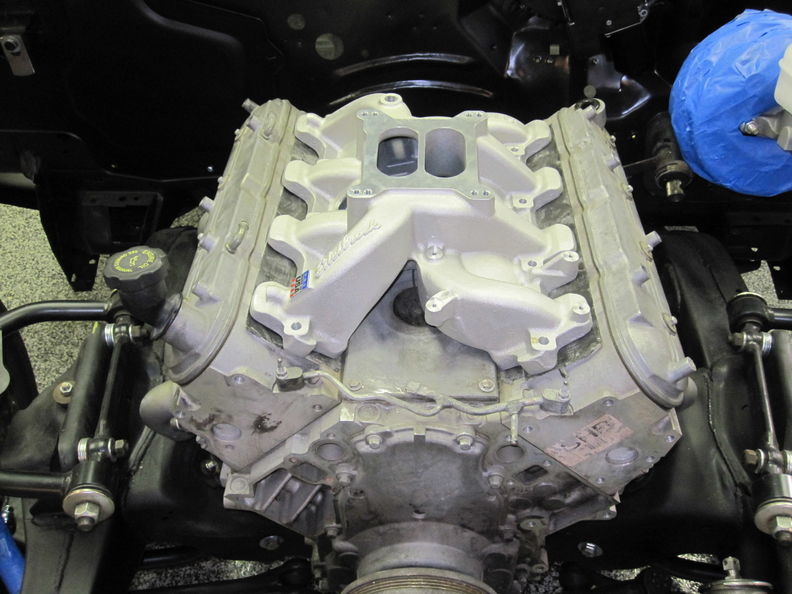

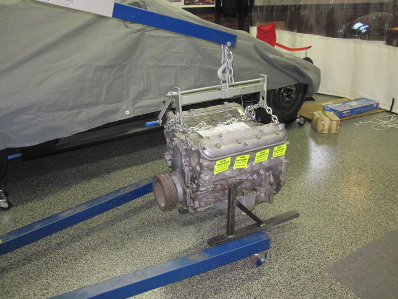

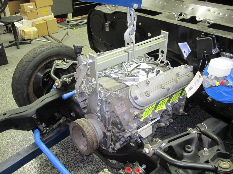

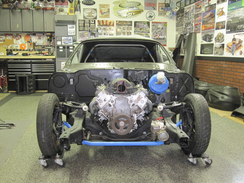

      Morning All,

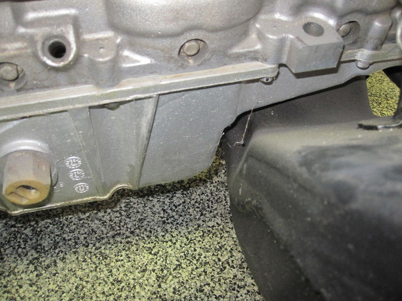

      It's time to put the actually motor in the car so the guys at High Speed Welding can finish up the edelbrock exhaust.
      The plastic blocks are sure awesome it's to bad I am not strong enough to lift the real motor.
      I purchased the LS1 from Travis at Kenny Davis Hot Rods it came out of a 98 Camaro.
      I used Edelbrock adaptors to mount the motor and you can see the F-Body oil pan clears the subframe perfectly.
      Motor is in and there is plenty of hood clearance with the stock intake manifold.

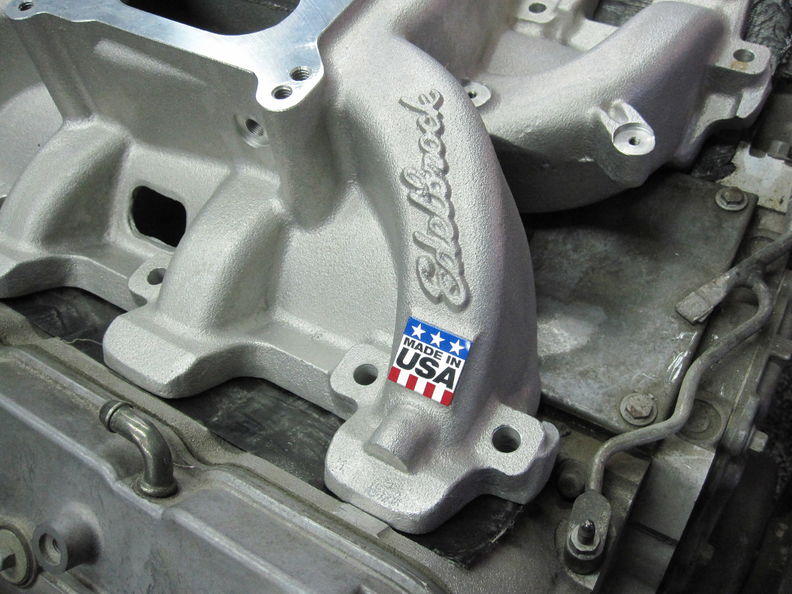

      But of course I have no intention of using the stock manifold as this motor is going to have a Carb.
      Did I mention it's made in America.
      Once again you can see I am using as many Edlebrock products as possible. Nothing say vintage race car and Americana
      then Edelbrock !!!

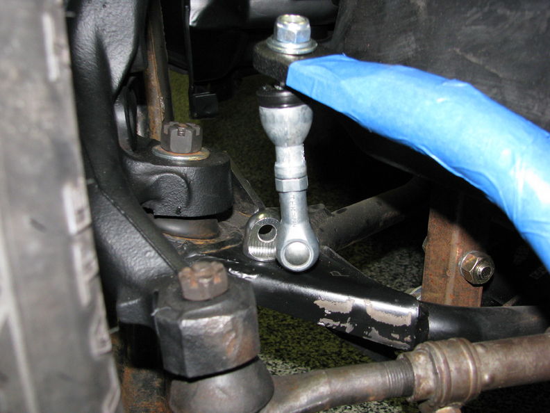

      Afternoon All,

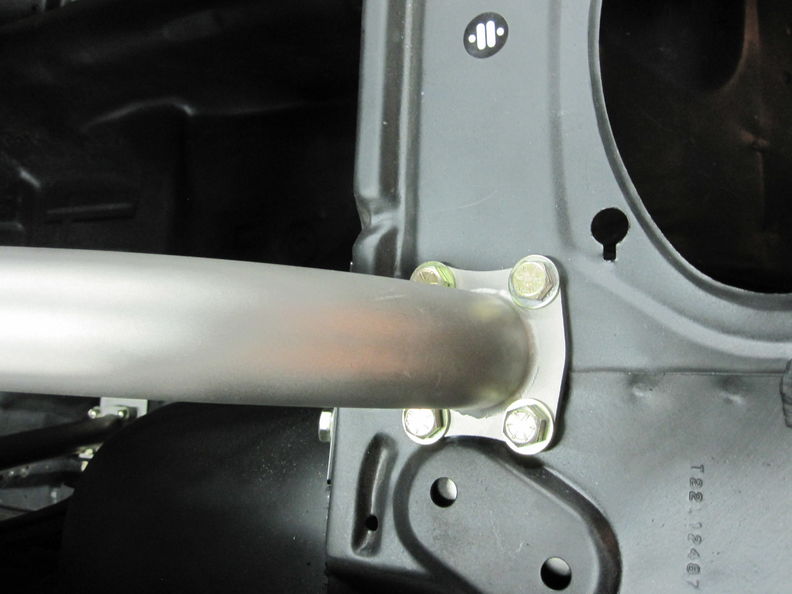

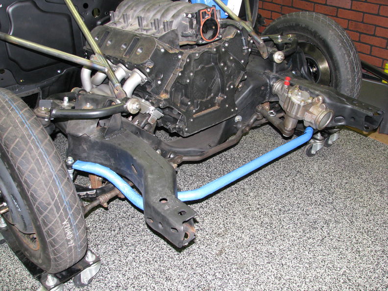

      People tend to think that they can handle a complete subframe swap. Then in the middle of the project they realize they have
      either run out of money, time or skill to finish the project. As said in previous post the build of this car needs to be simple and
      something that anyone can do. That is why Ride Tech is my first choice and always will be. Their product is proven and if you
      can do simple remove and replace you are going to be unbelievable happy with all of the products offered by them.
      Time to install the Ride Tech Muscle bar.
      30 minutes later the bar is installed.
      If your goal is to build you car in your garage or your driveway and not make it yard art then step up to Ride-Tech !!!!

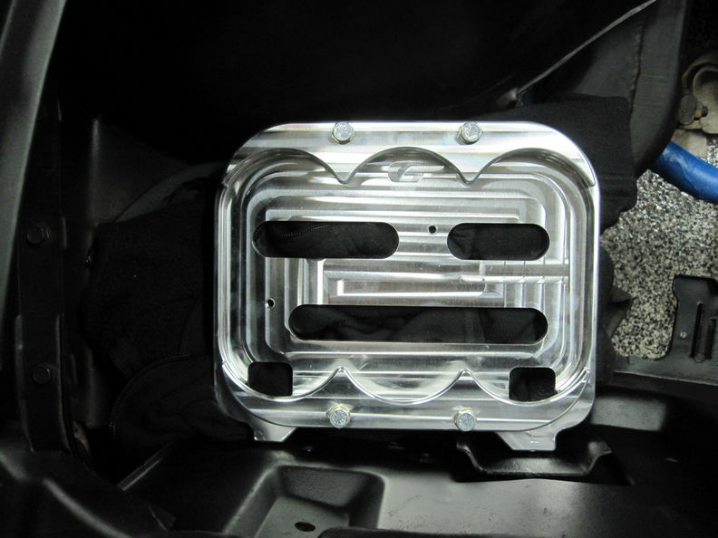

      Afternoon All,

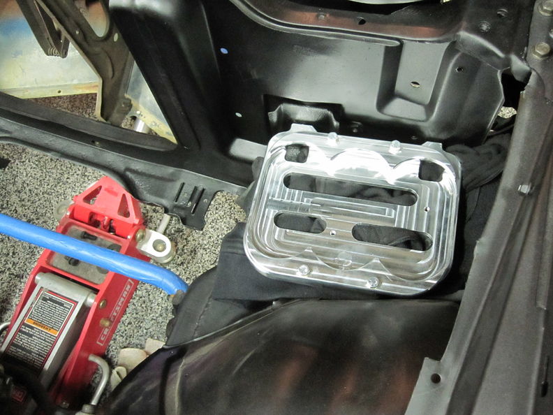

      The goal with this project is to keep it simple which means keeping the battery in the stock location. So I worked
      with Ron Wilson at Wilson Muscle Cars to design a stock location Billet Battery Tray that would hold an Optima
      red top Battery.

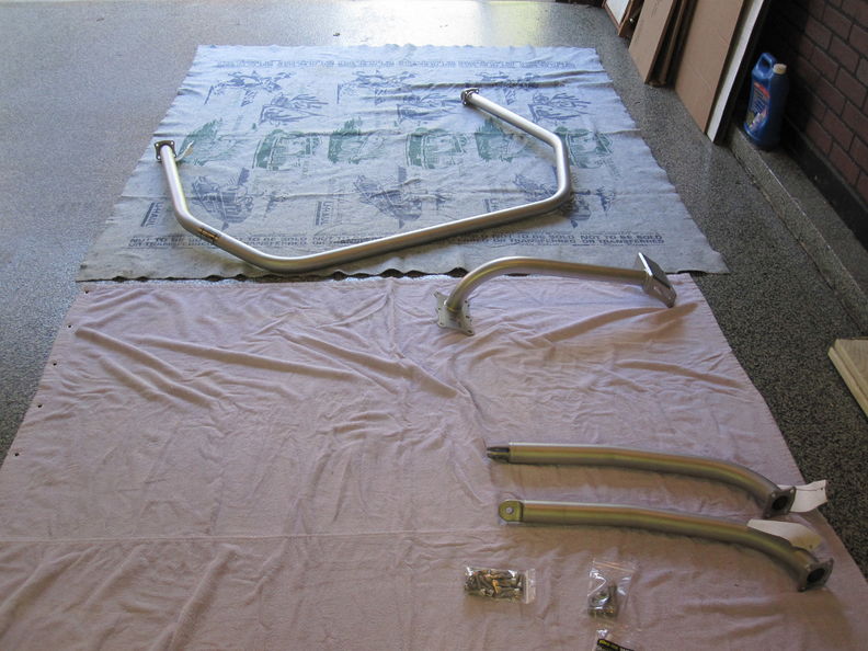

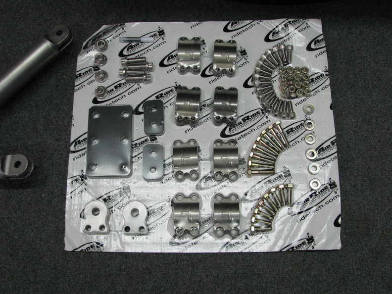

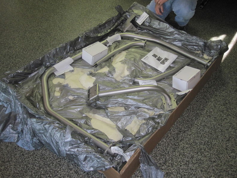

      More boxes from Ride-Tech
      Good thing Scott was over he was able to open the box while I took pictures. It's to bad he's a cuB faN the good news is but he's
      still a good guy.
      It's going to look really nice once I get it installed.

      Cage looks good. Are you going to weld it or bolt it in?

      I like the Tiger Cage! Are you going to install the road race bars also? Please post more photos and information during the install.

      Yep, we are doing the complete cage.

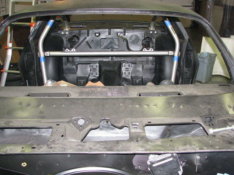

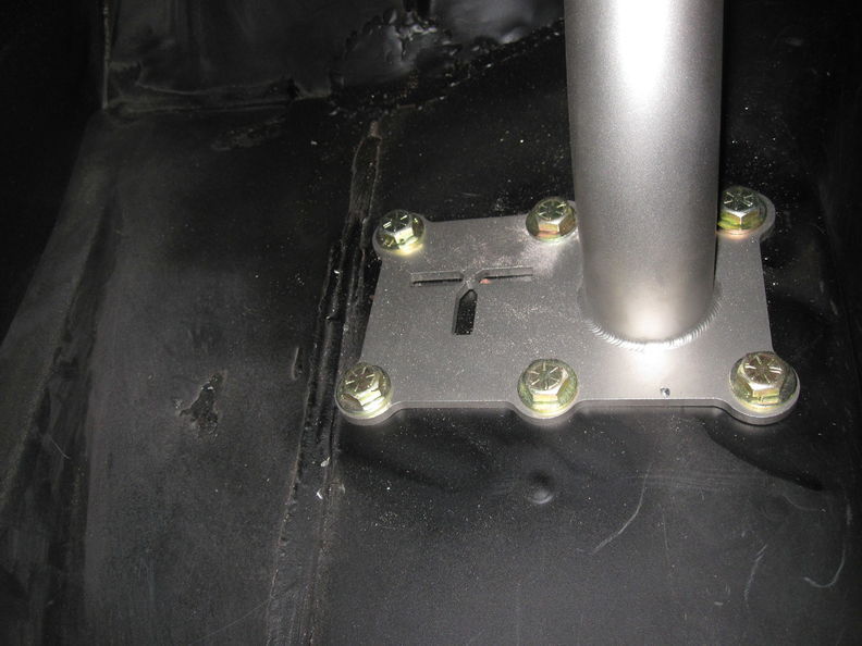

      2nd Chance Camaro - Tiger Cage Install Part 2
      2012 08-09 Update - 2nd Chance Camaro - Tiger Cage Install Part 2

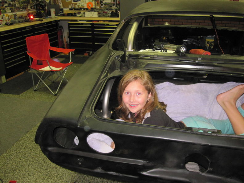

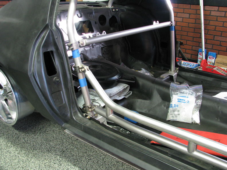

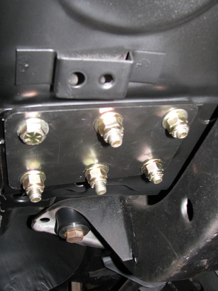

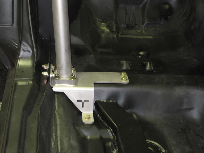

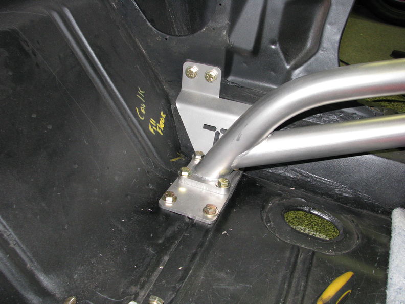

      Good Evening all,

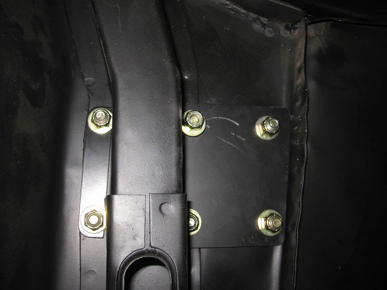

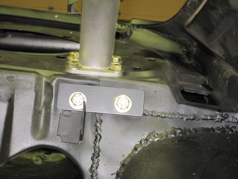

      Installing the Tiger cage is fairly easy. I was able to install the complete cage in about 4 hours. However, I did
      need a helper to finish tightening some of the supplied hardware

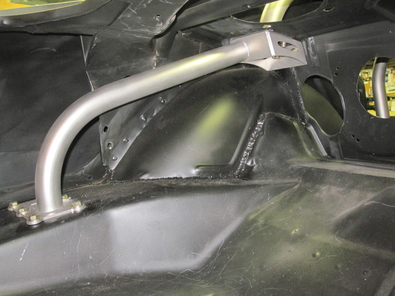

      The hoop mounts into the floor brackets which self align for easy drilling.
      The down bars attach through the package tray.
      Quick look at the finish of the down bar.

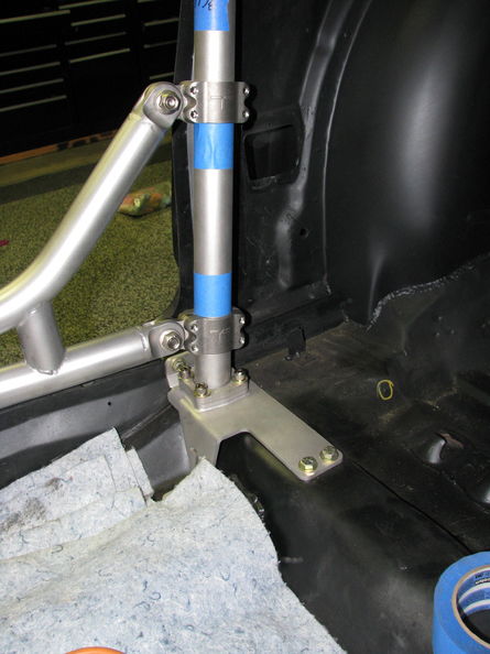

      The down bars attach to the trunk floor. I used the frame rail spot welds as a guide to line up the bolt holes.
      Make sure you line this up perfectly so it hits the flat part of the frame rails. I used a right angle drill with a
      1/8 drill to make sure I hit the frame rail perfectly.
      You can see that the bolts hit there mark perfectly. I also had to get tweak the floor just a little bit.
      Finishing off the cage I once again enlisted the help of one of my daughters. I also found the perfect use for an
      old cotton shower curtain. It makes a perfect blanket for my daughter to lay on.

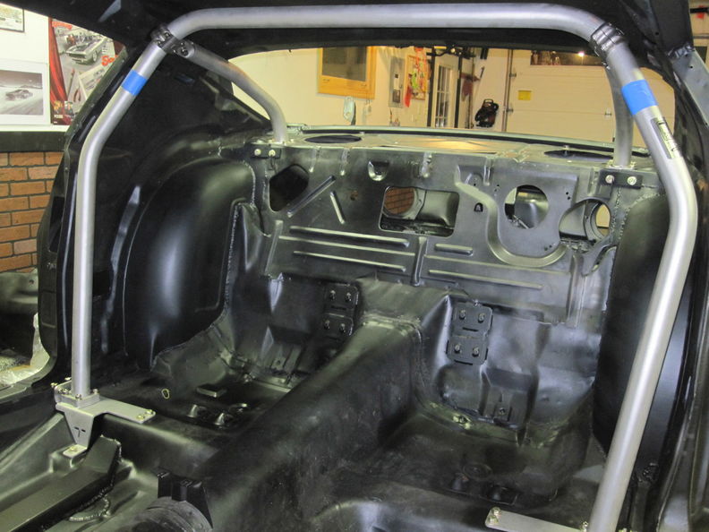

      You can see Ride-Tech did a perfect job when designing the Tiger cage. The main hoop is in perfect alignment
      with the "B" pillar.
      Harness bar installed.
      marty-mj

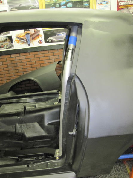

      2nd Chance Camaro - Tiger Cage Install Part 3
      2012 08-12 Update - 2nd Chance Camaro - Tiger Cage Install Part 3

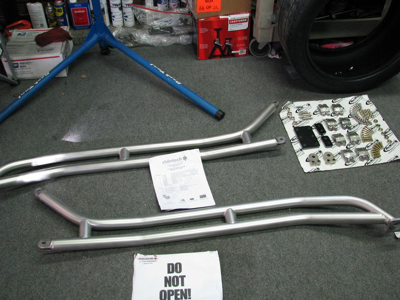

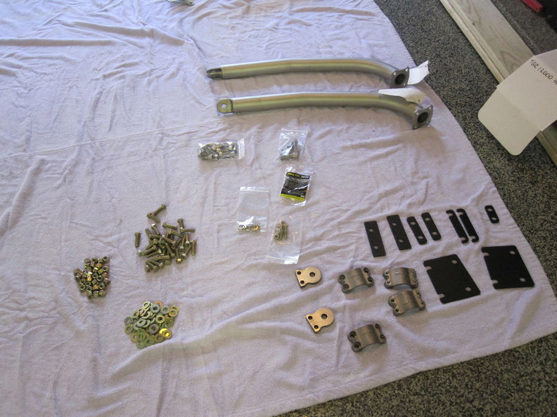

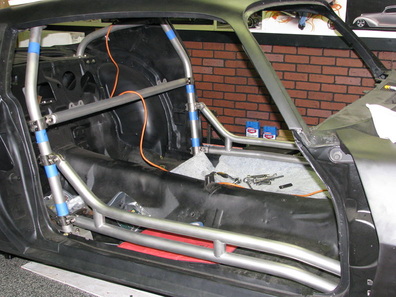

      Good Afternoon all,
      Even my girls are excited when boxes come from Ride Tech.
      The most important thing is "Do Not Open" the Envelope from Ride Tech. You may order more stuff !!!!!
      Now this is how parts are suppose to be shipped.

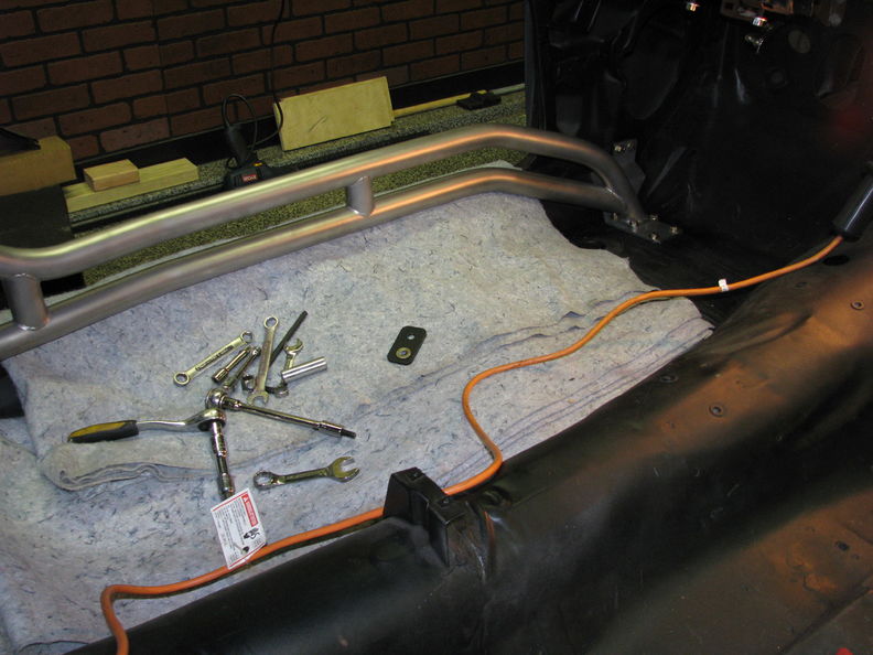

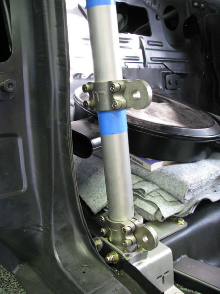

      Mounting the side bars is very simple. Locate the brackets on the main hoop and tighten once all hardware is loosely fastened.
      Still trying to decide if we are going to hide this bracket under the carpet. It's almost to nice to hide.
      On forward door bar one of the bolts must come up from the underside of the car.
      These are the only tools that you need to install a Tiger Cage after you drill the holes in the floor pan.
      Cage fully installed.
      pictures hosted by www.garagescene.net
      marty-mj

      Do I spy wheels in the pics? Mock up? Tiger Cages looks like it fits like a glove.
