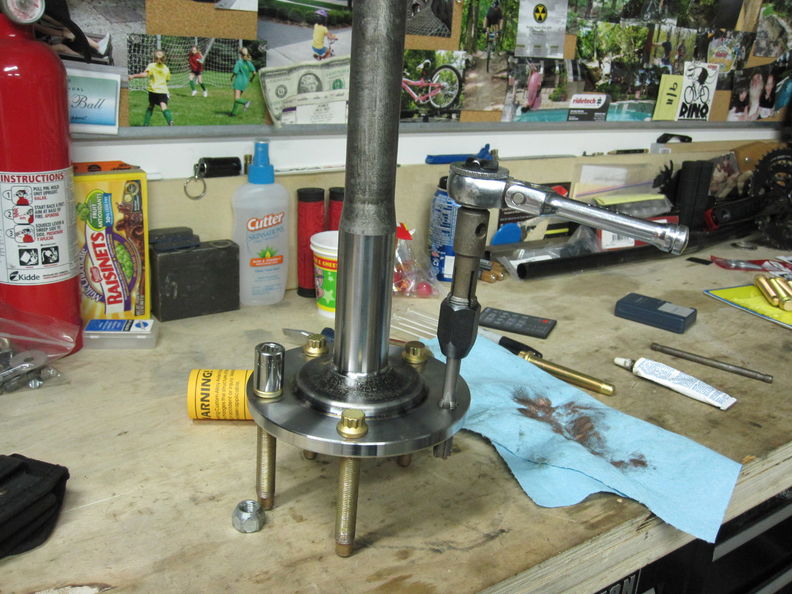

      2nd Chance Camaro - Kore 3 Rear Brakes & Moser Axles's
      2012 05-29 Update - Kore 3 Rear Brakes & Moser Axles's www.kore3.com
      www.2ndchancecamaro.com
      Okay I am way behind at posting updates.

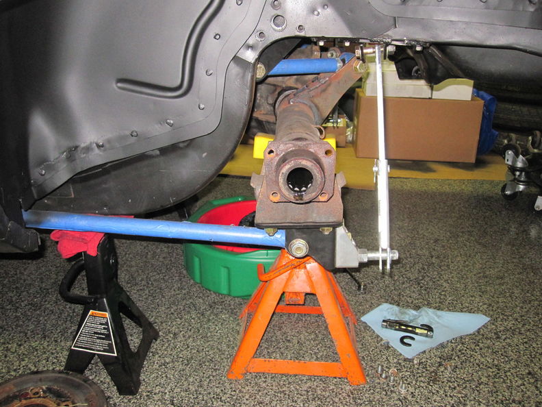

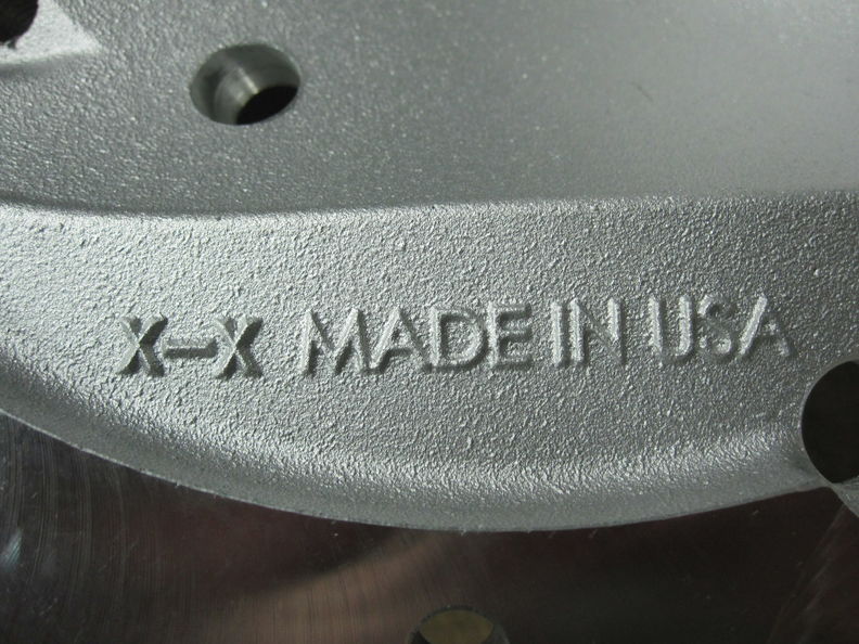

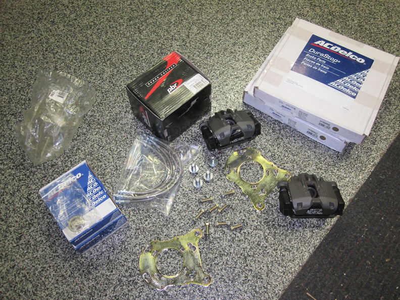

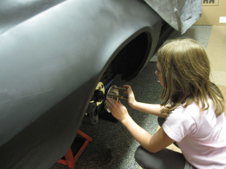

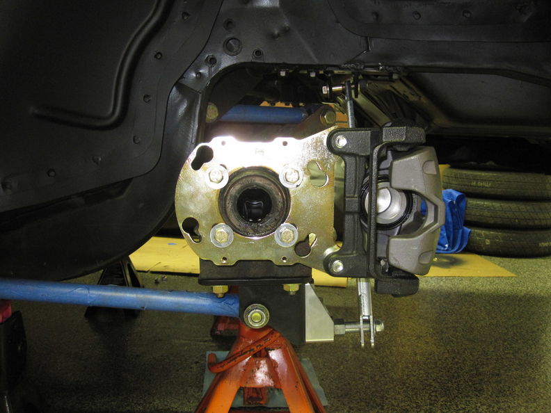

      Installing the Kore3 brakes is so easy install even my 11 year old daughter can do it. First we remove the stock axles and original drum brakes.
      Here is the complete Kore3 rear brake kit.
      We installed the supplied bracket and did a quick test fit of the caliper.

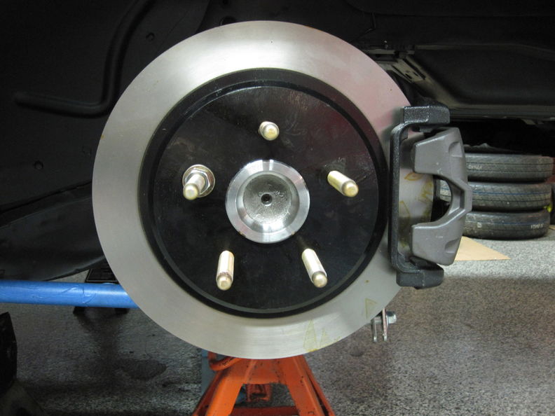

      In order for the GM Rotors to fit on the axles you need to machine down the axle flange. Instead of machining down the 40 year old axle I called Moser and had the build a set of HD Axles with the proper flange diameter. My daughter ran the tap down thru the bolt holes to ease the install of the ARP wheels studs.
      Like I said so simple a 11 year old could do it.
      Final Install Picture and yes my daughter installed the entire kit with only a little help.

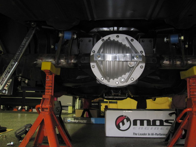

      Since the rear cover was off it was the perfect time to install the Aluminum Differential cover from Summit Racing.
      Did I mention it's "Made in America"
      pictures hosted by www.garagescene.net

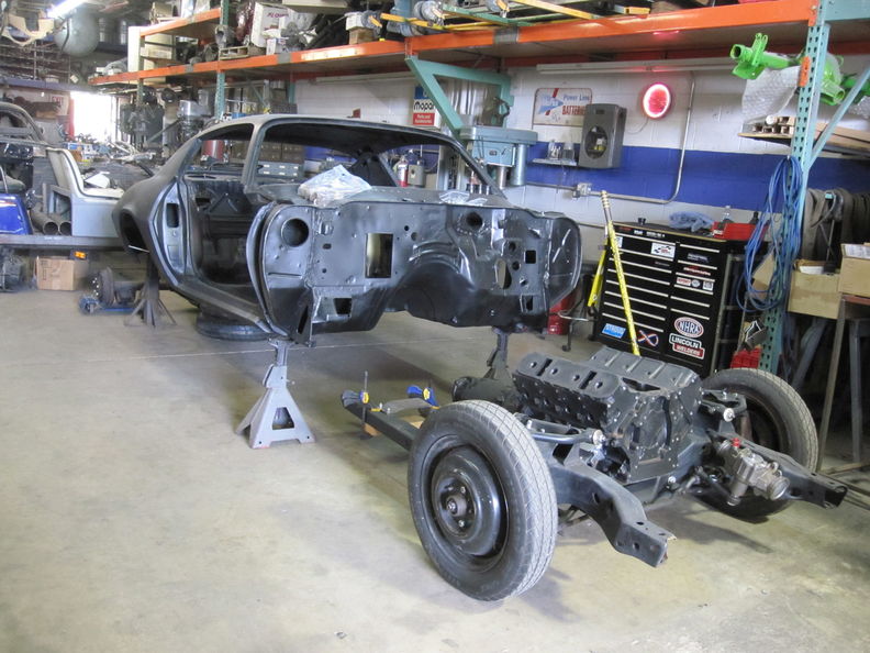

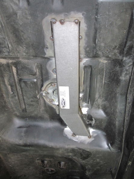

      2nd Chance Camaro - Rear Seat Restraints
      2012 06-25 Update - Rear Seat Restraints

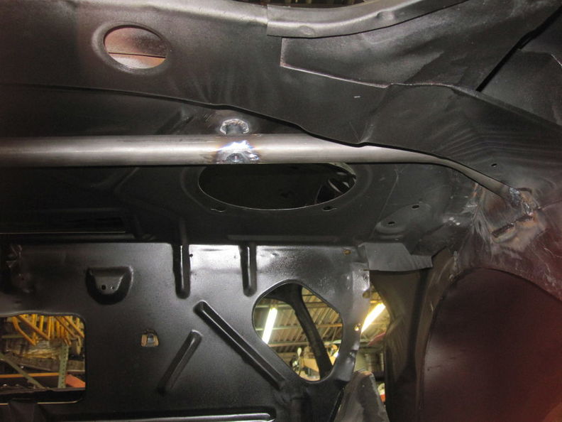

      Evening all,

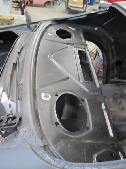

      Since this car is being built to haul the family it's important to have restraints for all passengers. I had
      the guys at High Speed Welding in Westmont, IL install a mounting point for the 4 Point restraints for
      the kids. www.highspeedwelding.com
      Couple Quick Pics
      Sorry about the picture quality however you can see where the mounts are located.
      Once the car is back together the plan is get a hold of the guys at Seat Belt planet to make some custom
      seat belts for the kids.

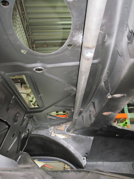

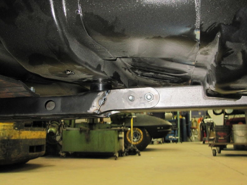

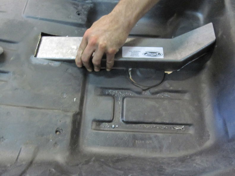

      2nd Chance Camaro - DSE Subframe Connectors
      2012 06-26 Update - DSE Subframe Connectors

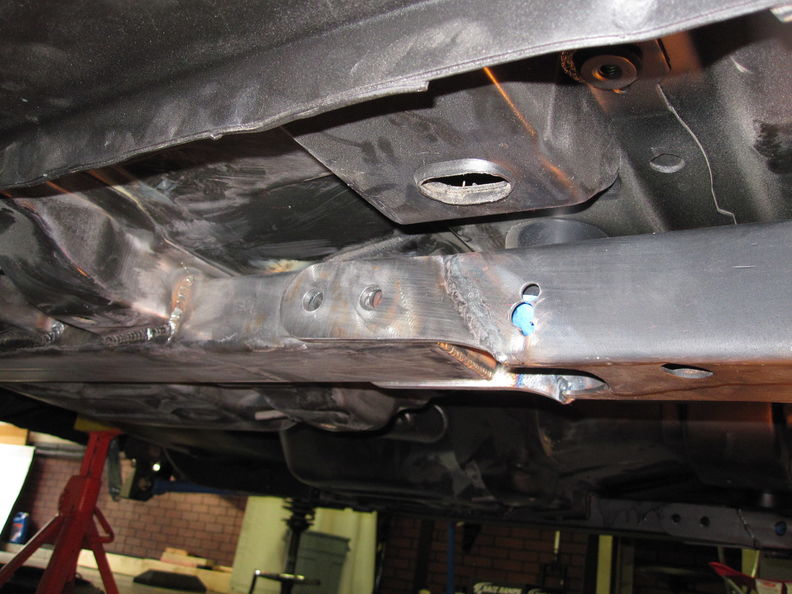

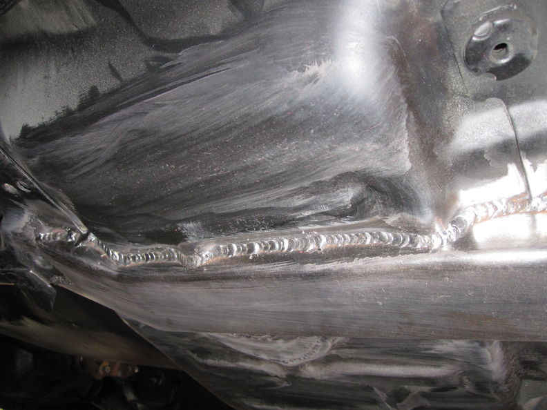

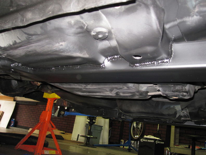

      Evening all,

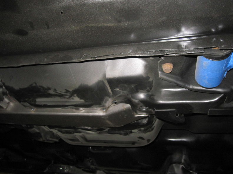

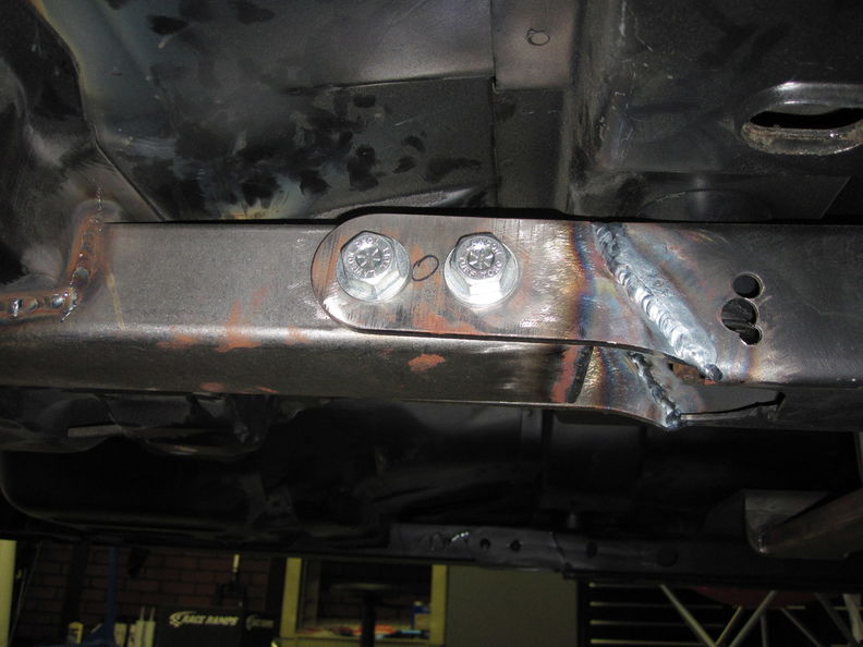

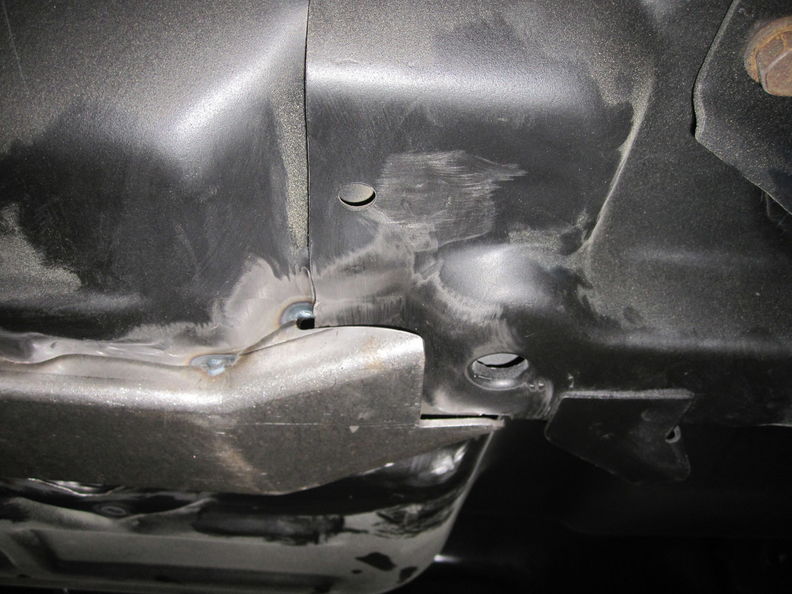

      Since the body and the subframe need to get put back together we figured now is a good time to install
      the Sub-Frame connectors from DSE.
      Once again the guys at High Speed welding handled the work. www.highspeedwelding.com
      What I like the most about there connectors is how close they fit to the body.
      marty-mj

      2nd Chance Camaro - Cleaning Up the DSE Subframe Connectors
      2012 06-27 Update - Cleaning Up the DSE Subframe Connectors
      Evening All,

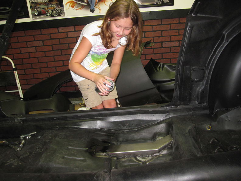

      Okay since I am home for at least one more week and I am not allowed to drive it's time to play catch up.
      I enlisted the help of my oldest to help clean up the sub-fame connectors. It's amazing how fast they
      flashed over with rust. Out came the wire wheel and some serious elbow grease.
      Getting closer
      Time to get out the cheap labor. Did I mention she works for Taco's
      Looks much better.
      Pictures hosted by www.garagescene.net

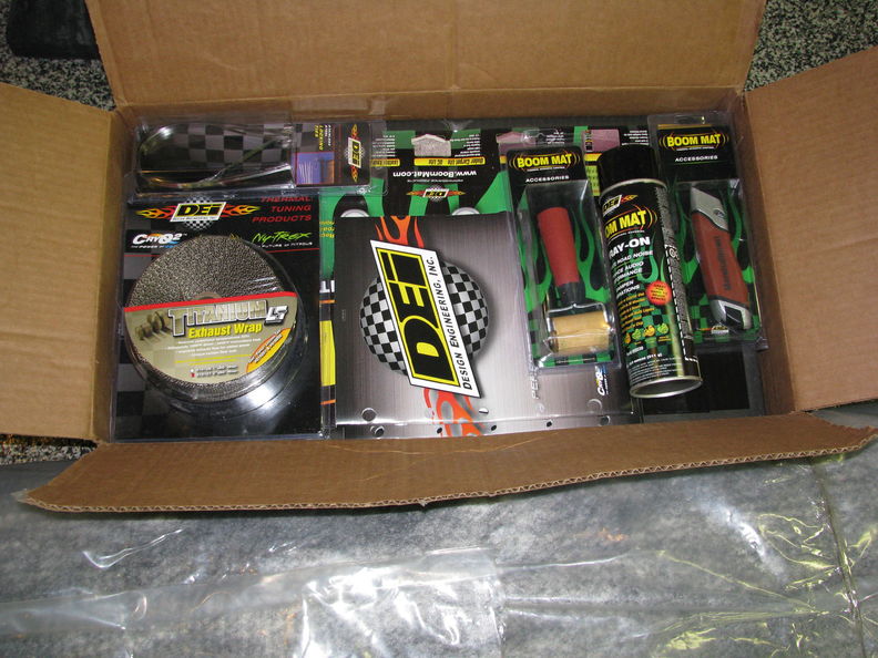

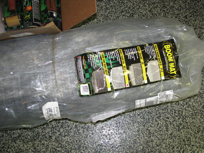

      2nd Chance Camaro - DEI Boom Mat
      2012 06-29 Update - DEI Boom Mat
      Morning All,
      I love Christmas in June even if it's Hot as Hell out. www.boommat.com
      We used DEI products on Syborg www.syborgtwinturbo.com to keep the heat down under the hood
      and now they offer a full product line to keep you cool on the inside.
      Don't forget to check out the full product line. http://www.designengineering.com/
      marty-mj

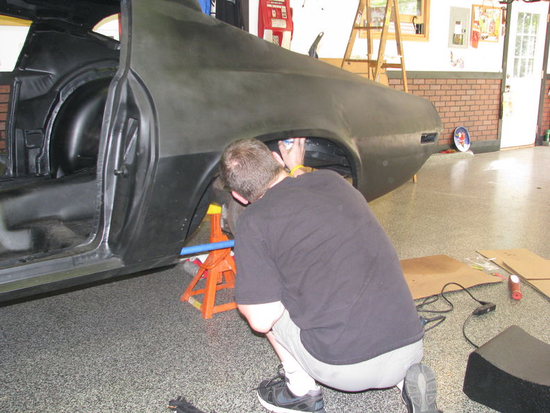

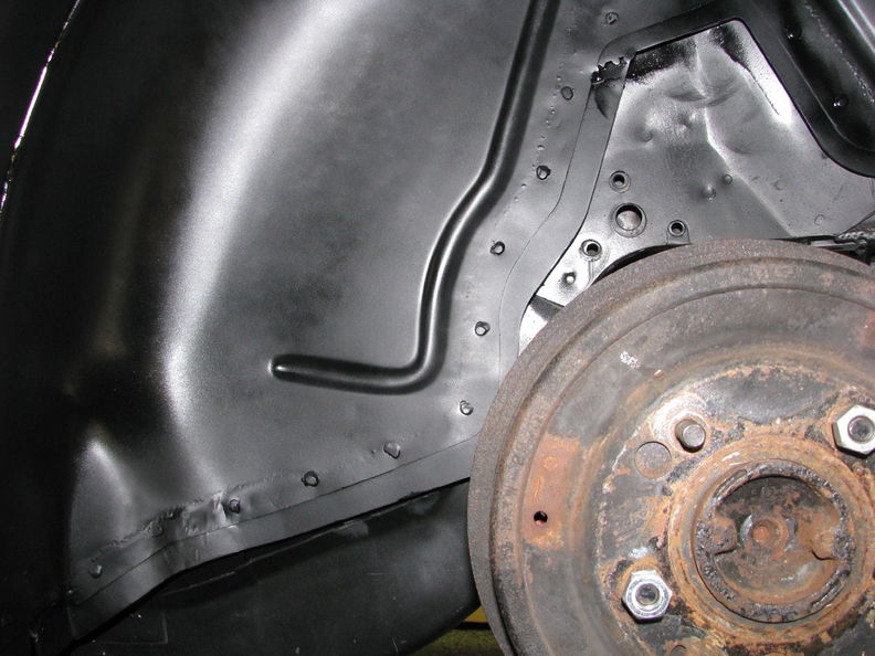

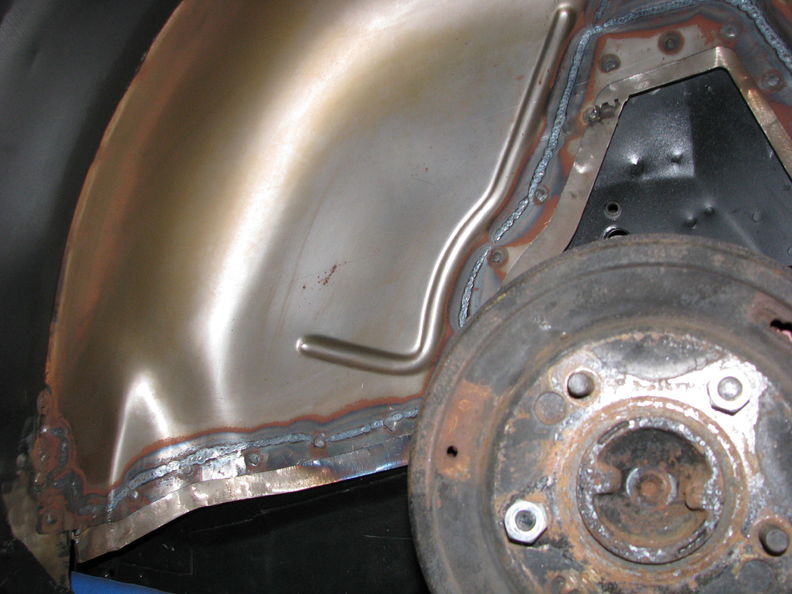

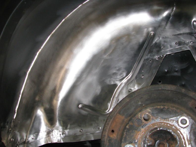

      2nd Chance Camaro - A Little Primer on the DSE Tubs
      2012 06-29 Update - A Little Primer on the DSE Tubs
      Morning All,
      My buddy rick came over to help me clean up the mini-tubs. Seem he was the supervisor.
      marty-mj
