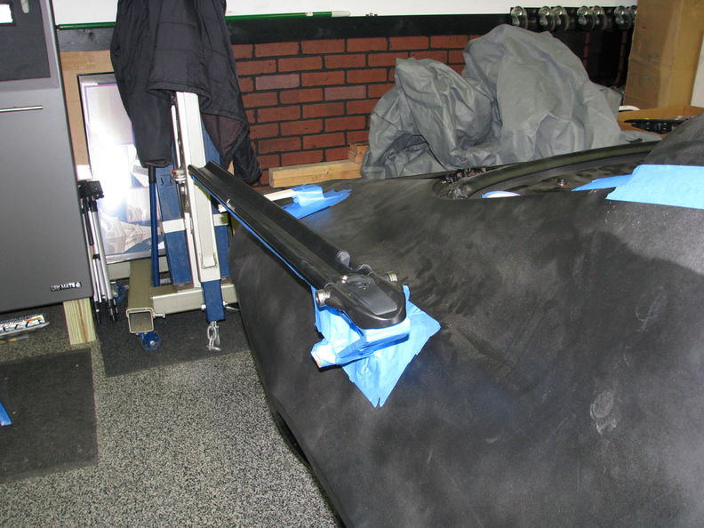

      2nd Chance Camaro - Rocky Mounts
      2012 04-30 Update - Rocky Mounts www.rockymounts.com
      www.2ndchancecamaro.com
      This post is all about my first love (other then my family of course). I am a die-hard mountain biker it is very hard for
      me to miss a ride in the summer due to a show schedule. The only way to solve this was either to buy a Lotus and
      order a rack from Unique Racks http://uniquerack.com so I could have a cool car with a bike rack on it. But it didn't
      solve the problem. I wouldn't be able to do any of the Good-Guys shows (www.good-guys.com ) since the Lotus would
      be was newer then 1972.
      Warning: the following pictures may not be suitable for immature audiences. author: David Chooey

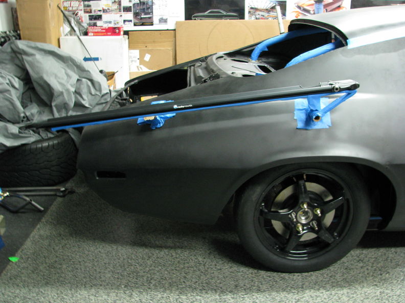

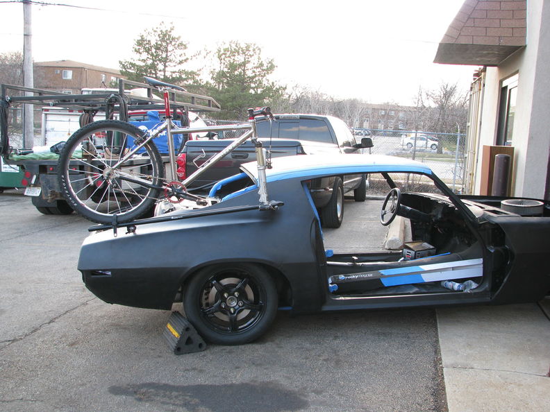

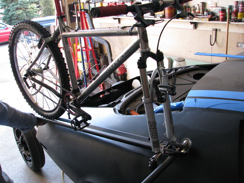

      So here is my dream bike and I am trying to figure out a way to mount the bike on the side of the car and wondering how it would
      look. I know most people would put it on the back but that is way to boring for me.

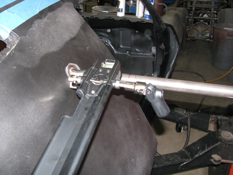

      Now that I determined the location all I have to do is find the best looking tray on the market. When I was in Colorado at
      Cankworx ( www.crankworx.com ) I walked by the Rocky Mounts Display ( www.rockymounts.com ) and saw the perfect
      tray. I wanted to buy one at the show but I figured Southwest wouldn't let me carry it on the plane home.

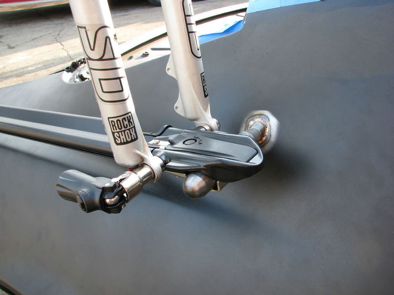

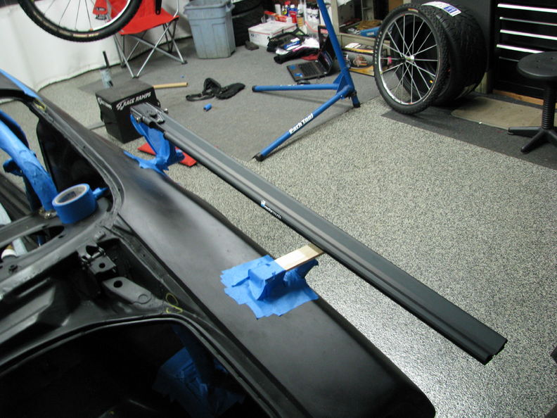

      I ordered up the tray the day I got home and started mocking it up on the car.
      You can see that the tray's has a very thin profile and looks very clean on the side of the car. I can't wait to order a set
      for my daily driver.
      Warning: the following pictures may be offensive and not suitable for automotive purists. author: David Chooey

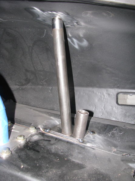

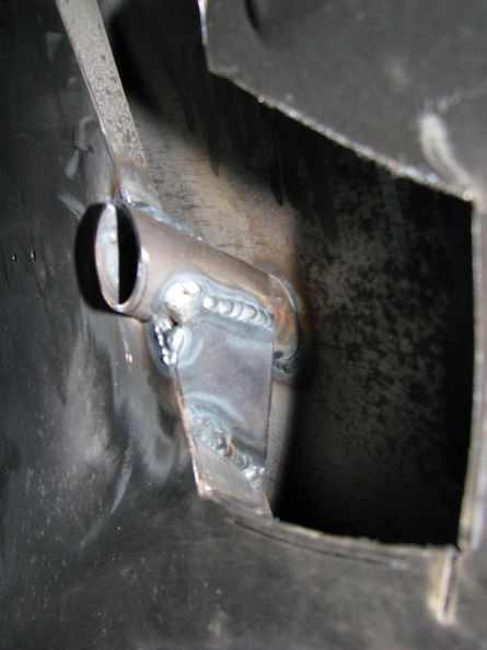

      I hauled the car back to High Speed Welding ( www.highspeedwelding.com ) and showed Dennis and Joe my idea.
      Good thing for me both of them thought it was a cool idea.
      We have two goals make it removable so I can run the car through a car wash and to try not to disturb the original lines
      of the car.

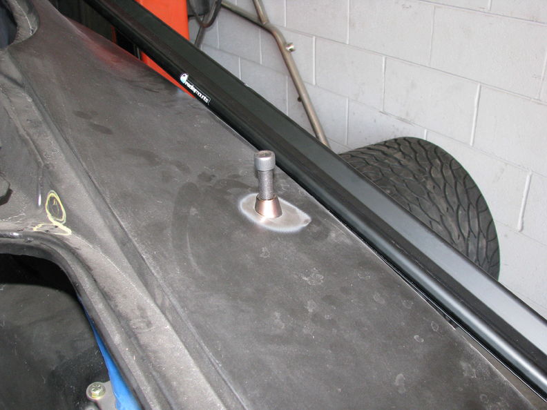

      When the tray is removed all that will be left is two stainless steel bungs on the quarter. Kenny will be making a cap to
      cover them up when the Rocky Mount tray is removed.
      Since this hole was already on the side of the car we choose to use it for the rear mount.
      Here is the finished product.

      You can use the mount up on the sail panel as a camera mount for autocross events. That will settle some people down around here.
      Stephen
    5. #145
      Chicago
      2,788
      Yep we have a go pro mount ready to go
      marty-mj

      Very cool, are there supports on the other side of the sheetmetal?
      Yep. The front bar is supported in 3 places

      Tray is removable right? so the rear mount looks like that where some people place their auto antenna's, but what's the front mount look like? is it just that nub or is the body smooth with a female like receiver? Definately one of a kind, unusual, but trick and purpose built! I think we should show up at a mountain bike competition with two nasty 2nd gens....If your ever out this way, there are some sick trails out here...Mike
    11. #151
      Chicago
      2,788
      Morning Mike,
      Yep the tray is removable and all that is left is a Stainless Steel Bung. You are correct that there was an antenna in the rear and that is why we used that location.

      Cool mod....I was wondering if you supported those mounts under the skin...otherwise the body would look decidedly average after a long drive..theres not much support for the skin on that sail panel area.
      Hey, when the car's finished...colour match your bike to the same paint scheme.
      Trust me if it can hold Kenny it's all good.
      Actually the bike is going to be Viper Red to match the car.

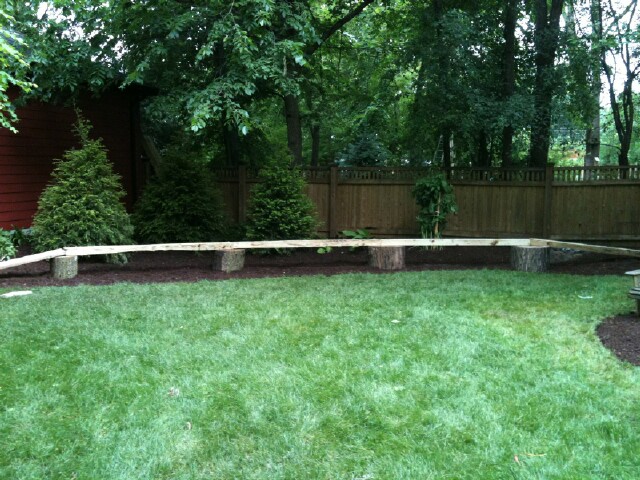

      Here is the skinny in my back yard it's part of a course I built so I could just get up in the morning and screw around in the back yard
