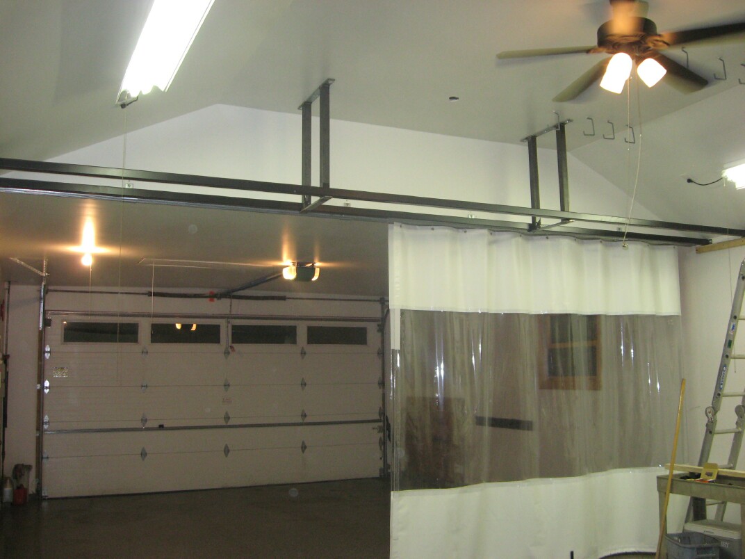

      any build tips or pics of that wheel rack?
      It was a pretty easy idea. I don't care for things on the floor so I wanted a shelf and a tire rack. I will dig up the link to the build of the garage and post it tomorrow.
      Here is a pretty good picture of the rack.
      The center is for tires and the sides are shelve's
      marty-mj
