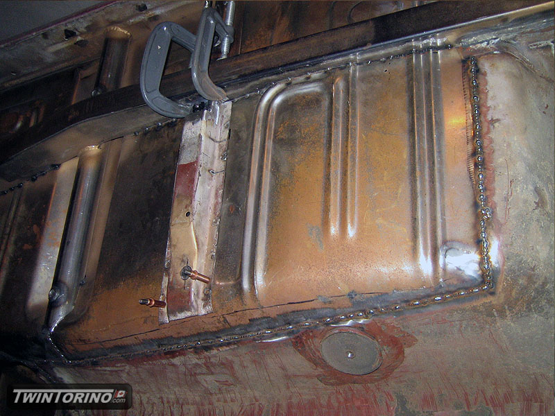

      Been working a lot on the car lately.. mostly in the form of welding, so there is not as much to see as of late. Finished the balance of the welding on the subframe connectors in the rear and moved onto the rear suspension and wheel tubs. Should have that done in the next couple of weeks.

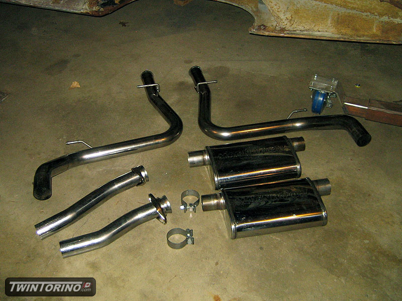

      Finally gave the exhaust some attention. Decided to just run an "off the shelf" 2003/2004 Cobra system, and will add length where necessary, and modify the outlets so you can't see them. Found a used 2004 Cobra cat-back stainless Magnaflow system with only 1600 miles on it for only $200 shipped, and it even came with an extra set of flowmasters. Not sure why it was so cheap, but I didn't ask questions there. Have the forwards x-pipe section on it's way, so we may have an exhaust system in the car soon enough.

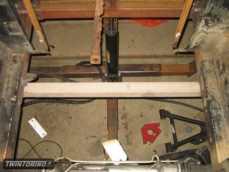

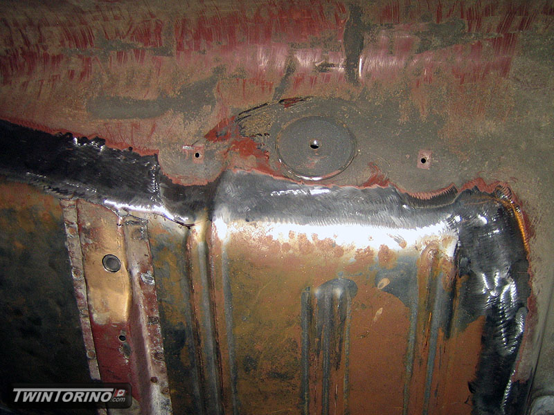

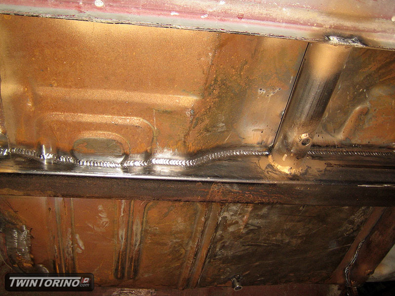

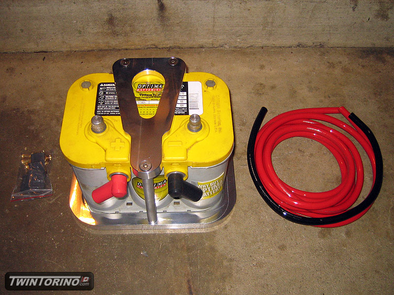

      Since we plan on having the car up and running in the next month.. time to take care of the smaller things. Worked on getting the parts together for the remote battery setup. We were going to make our own battery mount, but for the time it takes, we decided to just go with a DSE mount for a 34/78 optima. To connect the dots, we are using 2 gauge Quickcar cable and side mount location on the battery.
      Driver's side floors have been welded and smoothed out. Pass side is close behind and just need to be ground down smooth. Sure is nice to be able to do this with the car sideways on the rotisserie. Nearly done everything under the car now. Also in the process of of putting the rear seat support back in. It is hard to see in the picture, but we added a recessed area in the seat supports right beside the frame connectors where the brake/fuel lines will clip into on each side.

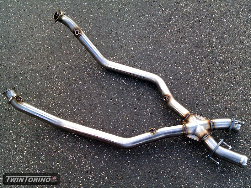

      Moving right along, got the Magnaflow offroad X-pipe yesterday. Looks great and saves a ton of time trying to piece together straight sections and bends. As soon as the car comes off the rotisserie, the powertrain will go back in and exhaust will go on. Also got some straight 2.5" SS pipe to make the Magnaflow system work since the Torino is longer than a Mustang.

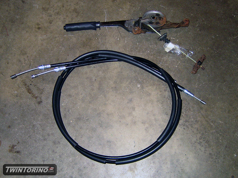

      Moved onto the e-brake system. Went back and forth on whether to go on the floor in the pedal area, or in the console area. Since the car is clearly not going the stock route, function wins. Since we are not running consoles in the cars, and want a nice area for the dead pedal to go, it makes the most sense beside the driver. Besides, it makes e-brake drifting much easier . Cables are aftermarket pieces for a 2004 Mustang with IRS.

      Sorry - forgot to mention that. It is from a 2001 Mustang GT. I am hoping all we have to do it lengthen the single cable coming off the handle to adapt to the Torino. The two cables that go to the brake calipers connect directly to the end of the single cable which makes things nice and simple.

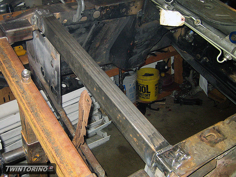

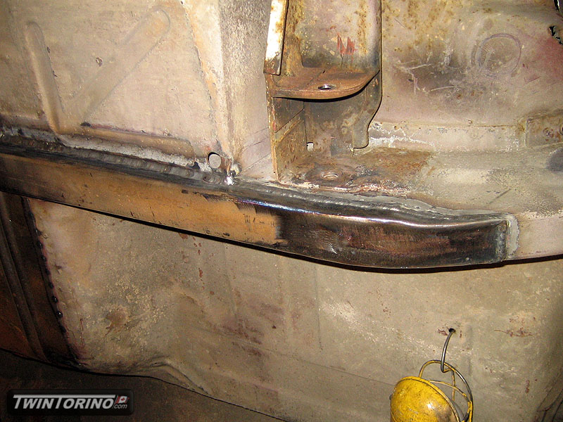

      Have most of the underbody final welded (pass side shown from underneath car). Was a bunch of rust on the front crossmember under the rad - so we just cut it out. Will replace with 3"x2" steel section which will fit perfectly - the nice thing is it only needs to be cut to length and can be welded in. No sense in spending lots of time on spot repair since the suspension points that use the underside of this are long gone anyway.

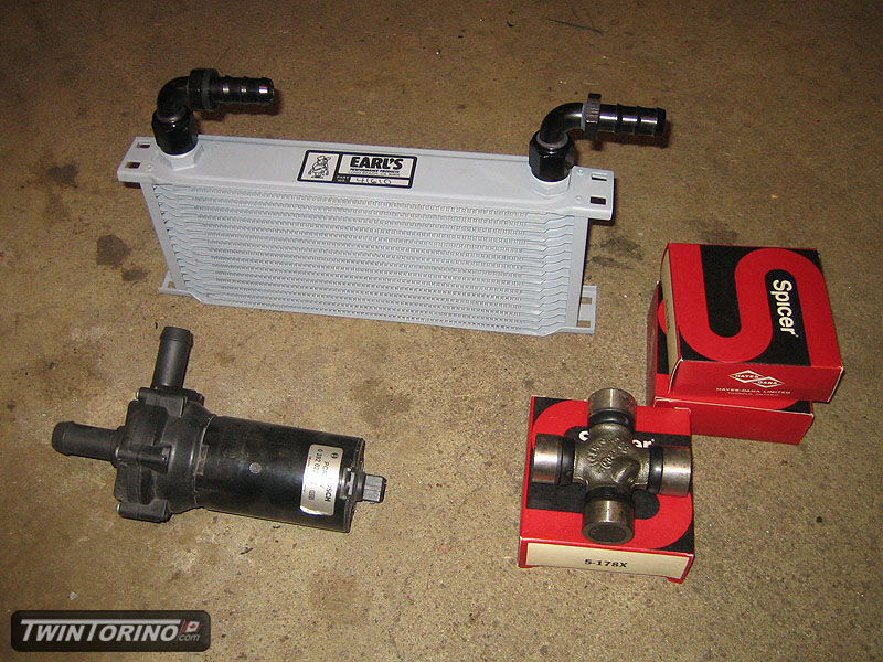

      Also found an Earls oil cooler, Bosch intercooler pump and Spicer 1350 series u-joints on Ebay in the last few weeks. Just need to get a Speedway 36" 1.25" OD splined sway bar for the front and the major purchases for this car will be close to complete.

      It is simply used to pump coolant (seperate intercooler circuit) through the intercooler inside the intake manifold down a smaller radiator located in front of the main radiator. Intercooler pump itself has been used on every Ford supercharged/intercooled application as of late except for the Ford GT (Shelby, Lightning, Terminator, etc).

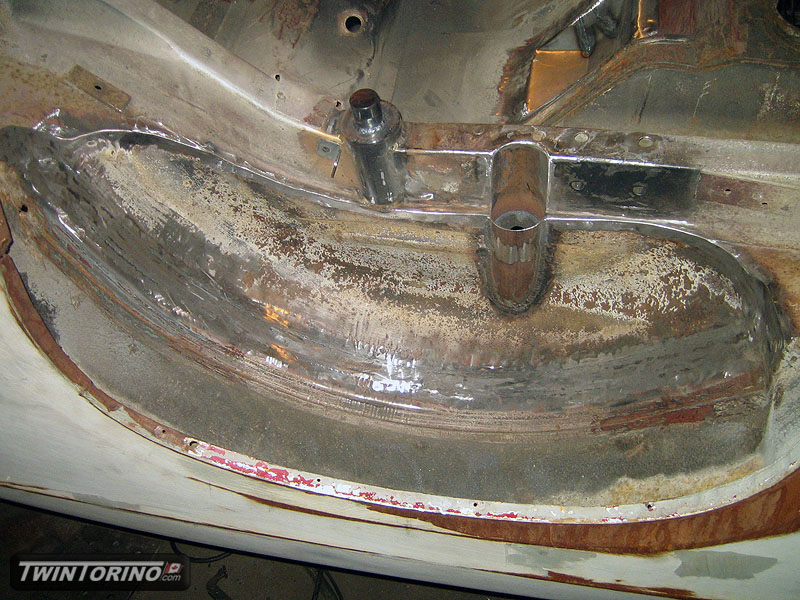

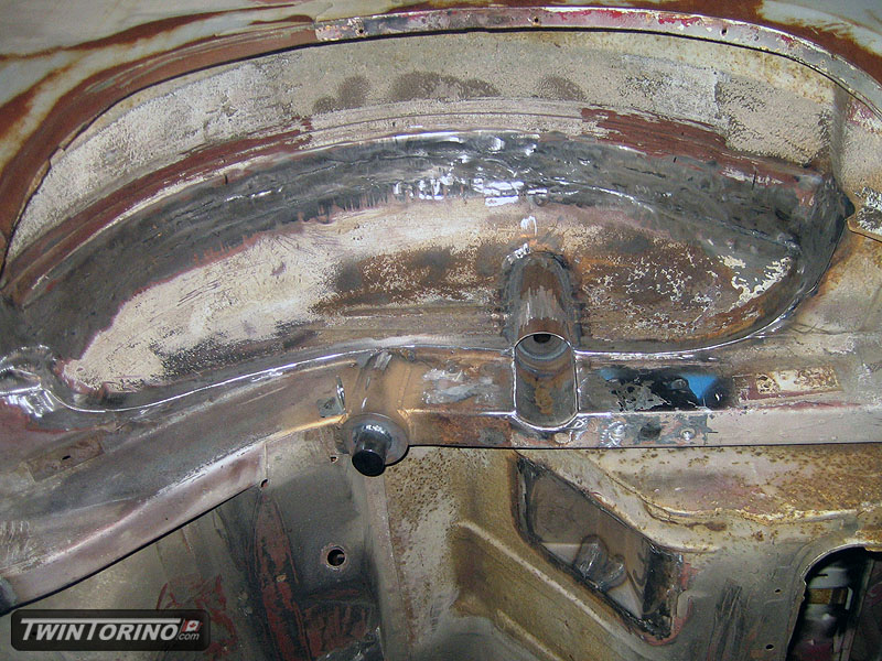

      Have the rear wheel wells, shock mounts and spring mounts completed. Pictures shown is with the car upside down. Not much else to do in this area until final paint goes on. Moving onto the front of the car, the new radiator crossmember is welded in for good, and more or less complete (and also shown upside down. Just need to make up a mount to pick up the hood latch support. Only thing left to do under the car now is bend up the 2 rear brake lines and a fuel line.

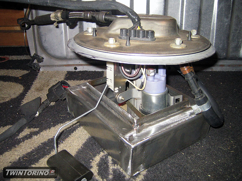

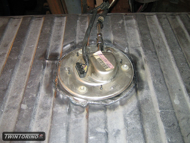

      Figured since the car will hopefully be up and running soon, it was time to finish up the fuel system. We made a fuel sump up out of stainless using a 2003/2004 Cobra tank as reference. We still need to add the supply tube and air vent, otherwise it is ready to go in the tank.

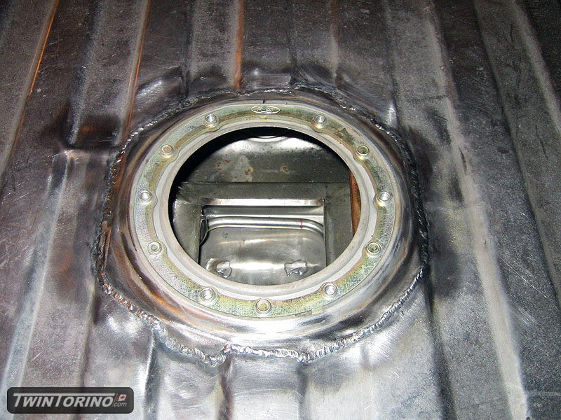

      Have not posted in a while.. likely because we have been too busy working on the car. We have the fuel tank almost ready to bolt in, just need to weld on a modern filler neck/cap. The pump reservoir has been welded to the standard Torino gas tank to mimic the setup on a 2004 Mustang Cobra.

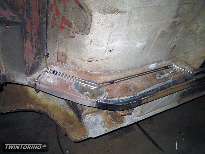

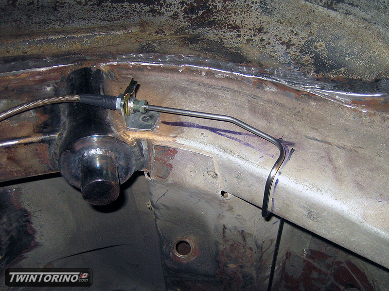

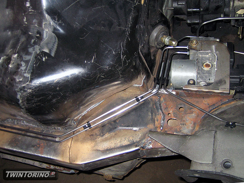

      Brake system is for the most part complete, as all the necessary lines are bent up and attached to the car. Since we are running a 4-channel ABS system, we had to run two separate line to the rear. Once the car is back on the ground, only thing to do now is bleed them.

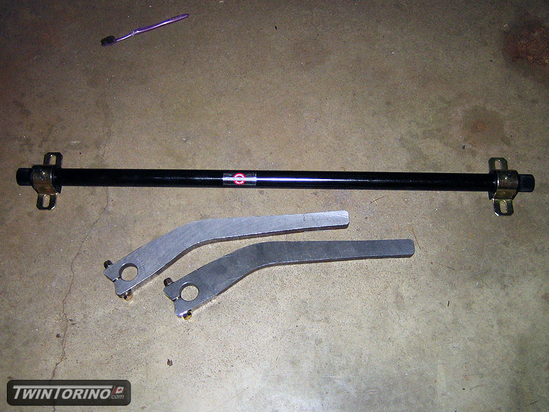

      Splined swaybars arrived this week from Speedway - very nice parts. Looks like we are very close to having all the parts we need to complete 1 car - finally.
