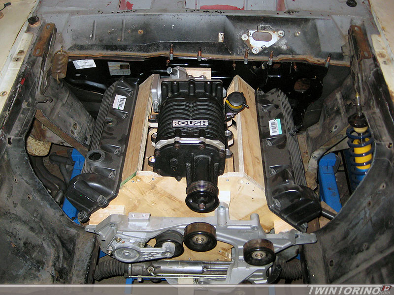

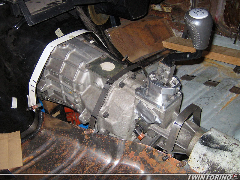

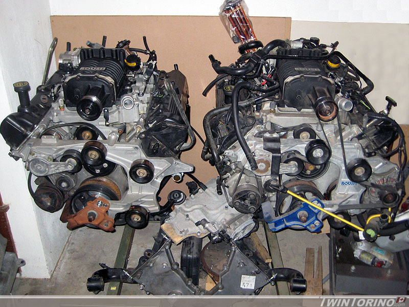

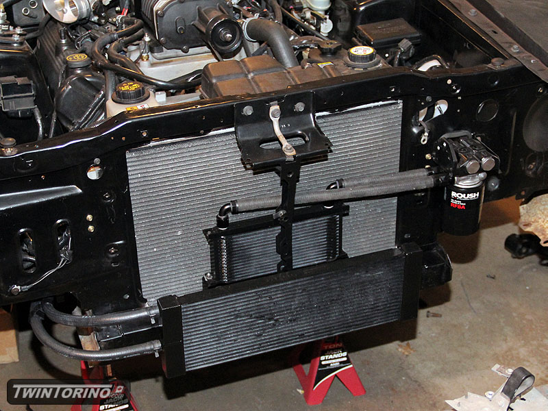

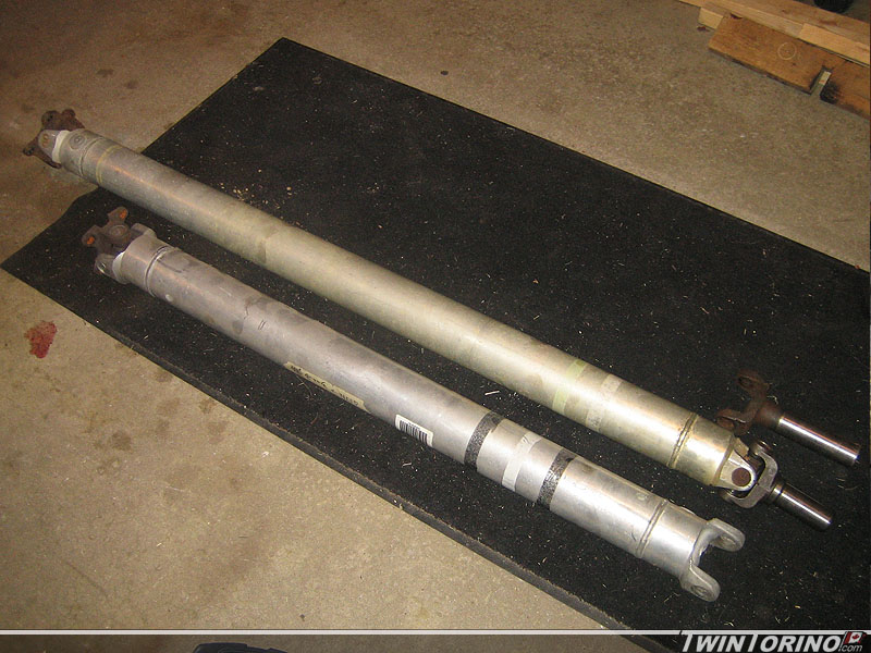

      The engines are 4.6L DOHC ones from a 2004 Mach 1 and the transmissions are T56 6-speed from a 2004 Cobra. We went with a Mach 1 as the engine is all aluminum, and are a lot cheaper than the Cobra supercharged motors. The supercharged motors use iron blocks. The rear ends are 2004 Cobra 8.8 (31 spline inner/outer) as part of the IRS assembly. Cooling comes from 2004 Cobra aluminum radiators (36mm core) and Mustang 2-speed cooling fans. Exhaust will use Bassani stainless steel headers, and a complete 2004 Cobra Bassani stainless steel system to start (modified to fit of course).

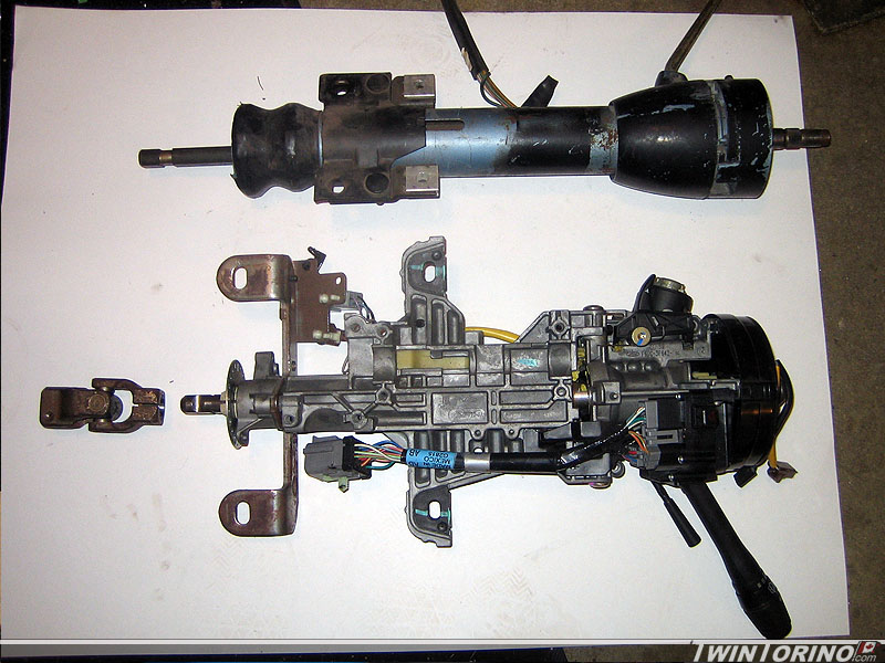

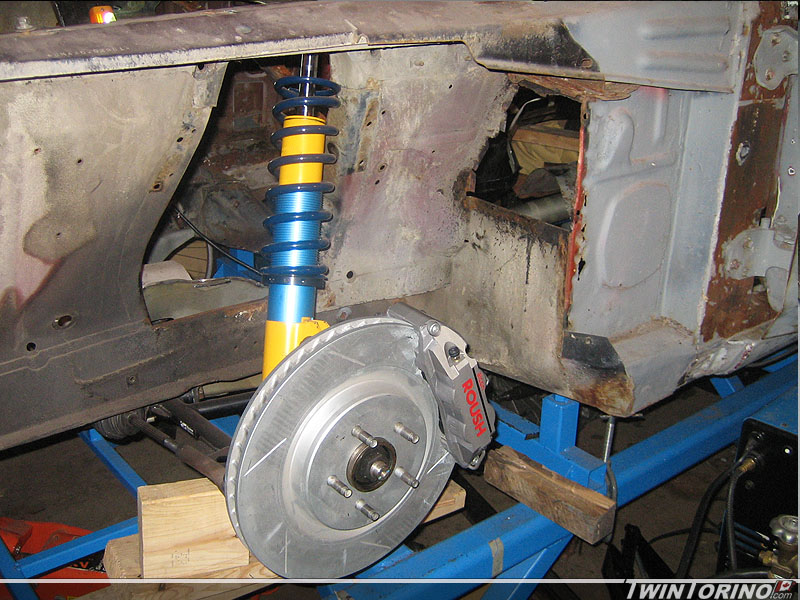

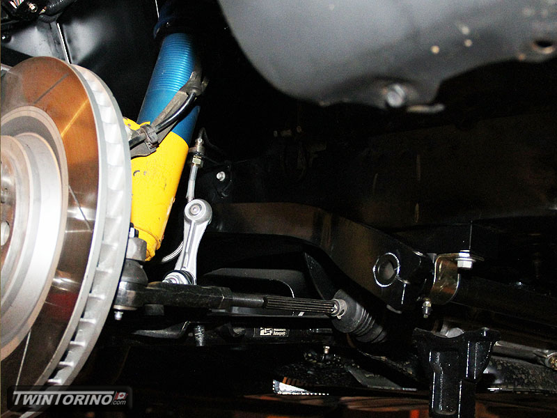

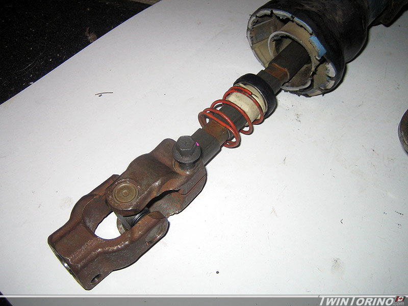

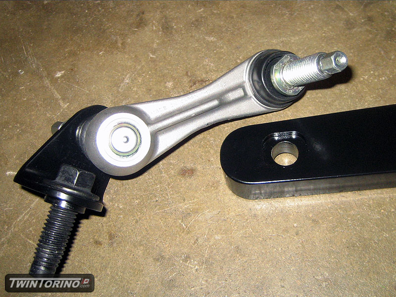

      The front suspension is a modified 2004 Cobra McPherson strut setup. The rear suspension is a modified 2004 Cobra IRS. The steering rack comes from a 2004 Cobra. Front sway bar is a 35 mm Roush bar, and the rear is 26mm stock unit from the IRS. Koni DA's will be used at all 4 corners.
      Front brakes are 2004 Cobra PBR front calipers with 13" Brembo rotors, and will have Carbotech AX6 street/track pads. Rear brakes are 11.65" disk from a 2004 Cobra. Brakes will be powered by a Cobra hydroboost unit. 2004 Mustang pedals are used under the dash.

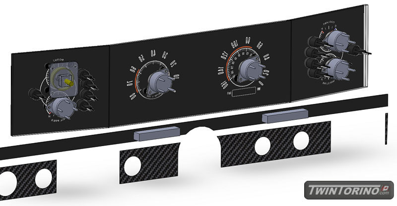

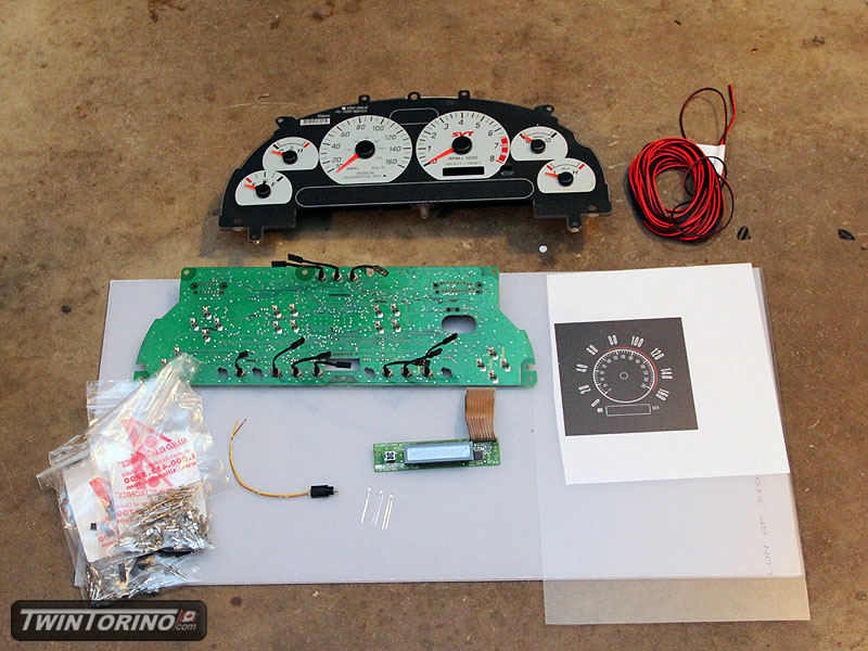

      Seating will be modified 1969 Torino buckets for daily driving, and Sparco Torino's for track days (although they will likely stay in all the time). Interior will appear mostly stock looking. The gauges will be custom (using a Mustang gauge clsuter to start) with silkscreened faces to mimic the original ones. A/C and heating system will be based on a modified 2004 Mustang system.

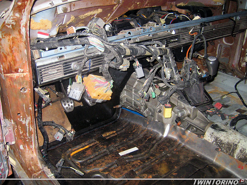

      Wiring will be modified 2004 Mach 1 harnesses. It is much cheaper that way in comparison to aftermarket setups. Also more complicated this way though .
      Cars will retain the Cobra ABS brakes, traction control, PATS theft system (with key in the dash), keyless entry, and basically any other major electrical function a 2004 Cobra would have. We are getting rid of things like air bags, power mirrors and lots of other things that are not needed.

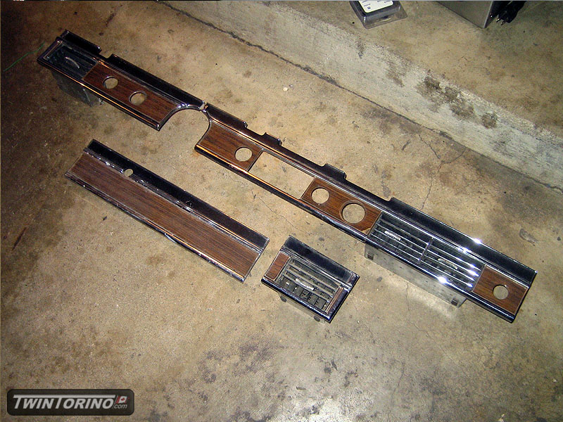

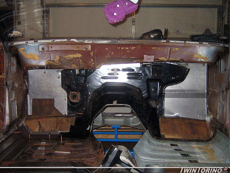

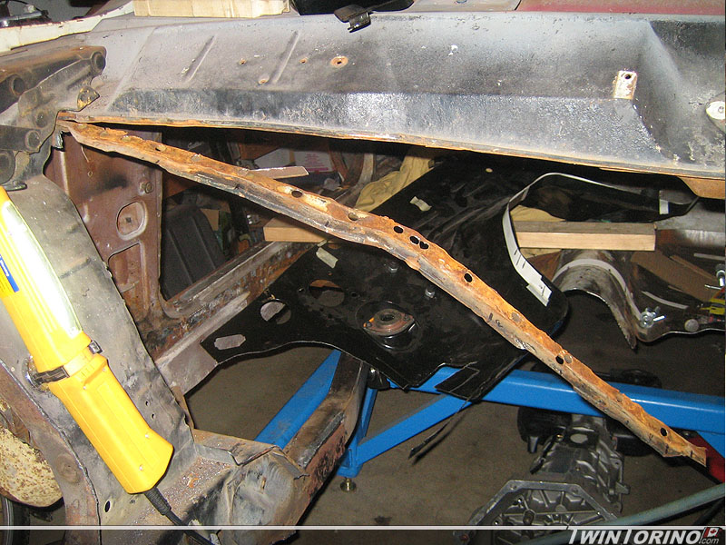

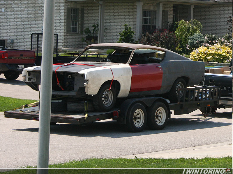

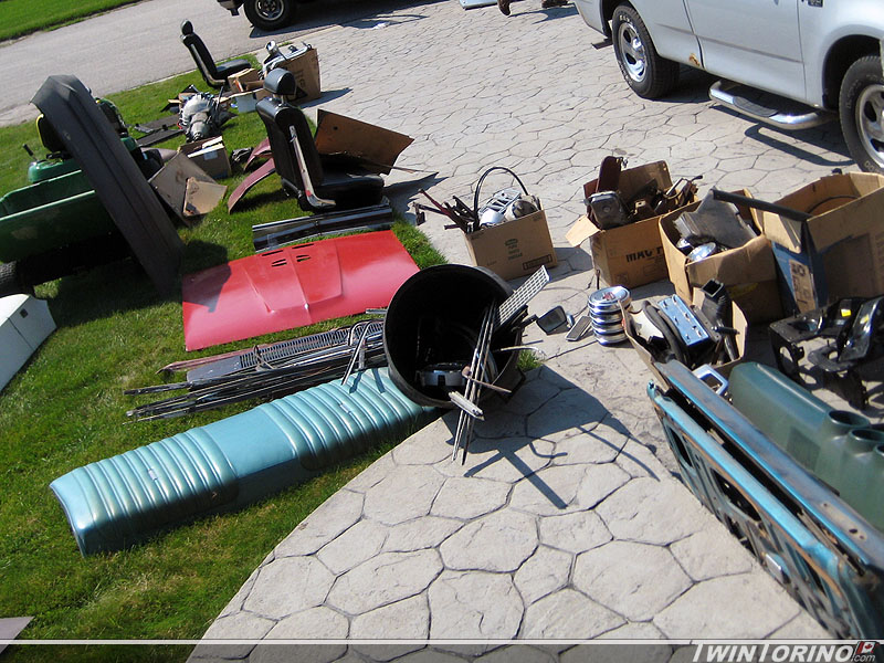

      Day 1 for both cars:
      Powertrain:
      Suspension/Brakes/Steering
      Front donor suspension structure:

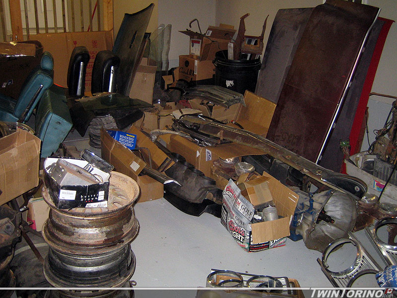

      Seats:
