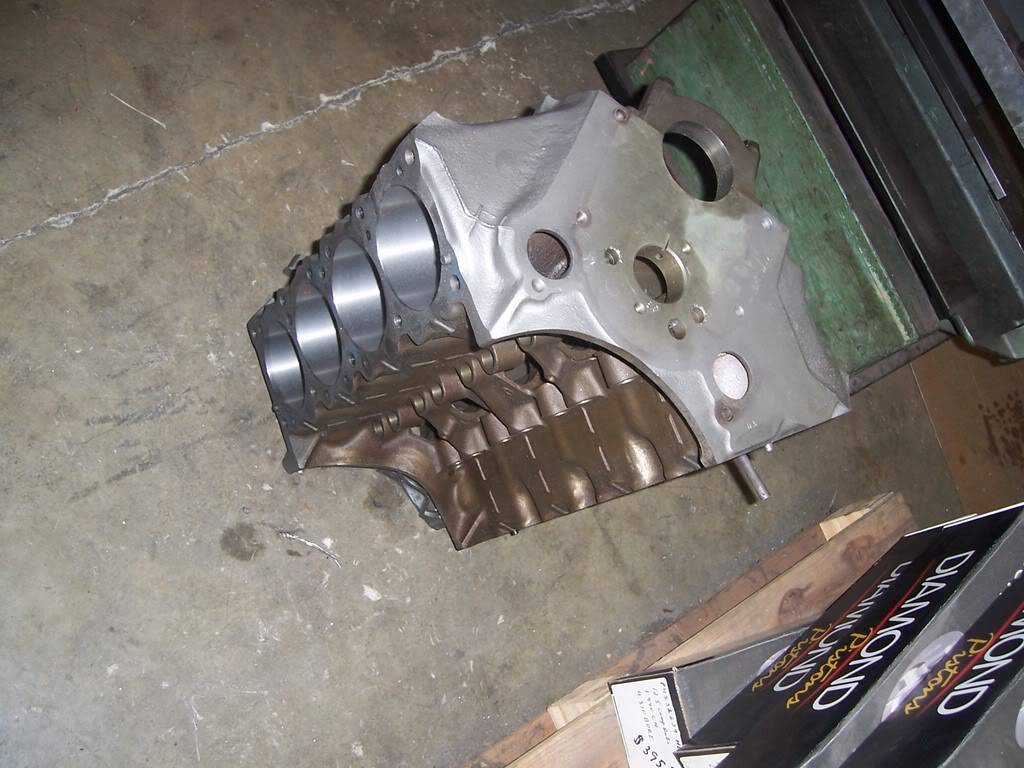

      stopped by the shop today to get some pics of the motor
      over all they said it was in good shape and had rebuilt before
      bearing were in good shape and they said the cylinders were in good shape so they may just hone them
      the cam however has been wiped but i got a new cam to go in it anyways
      tomorrow the block gets hot tanked

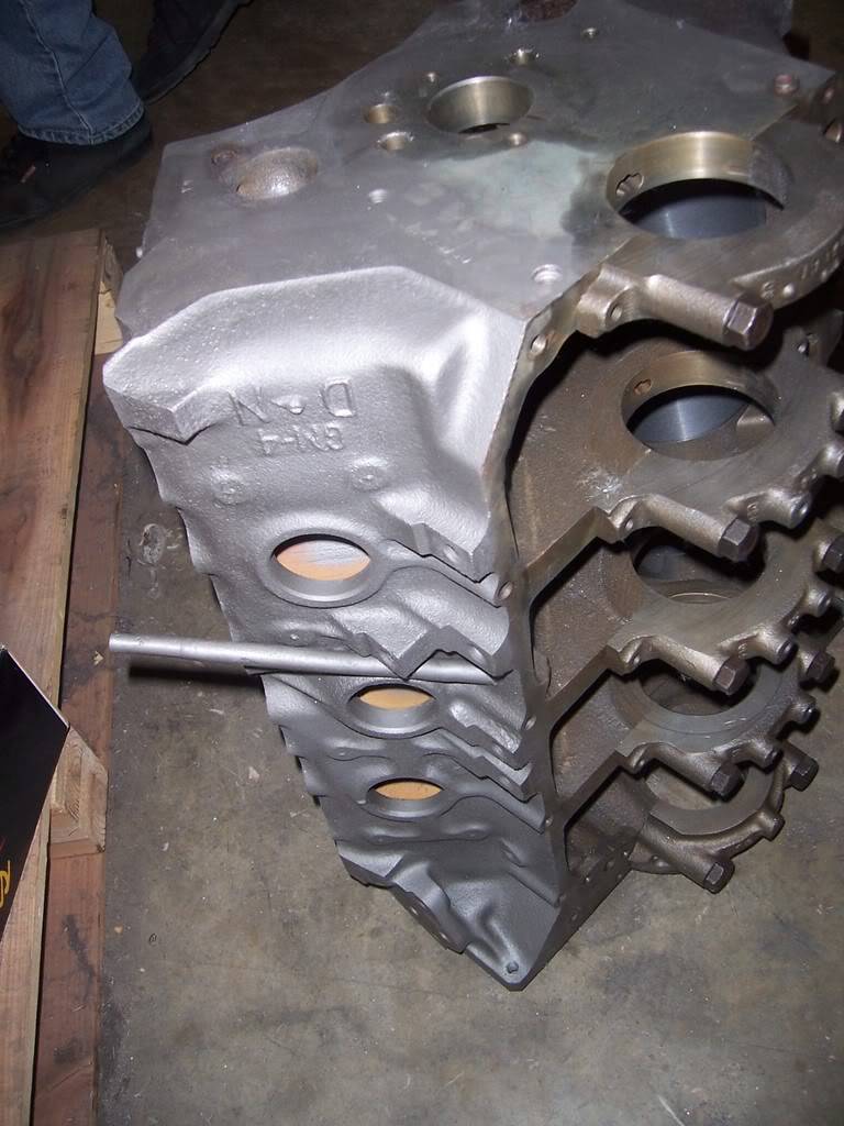

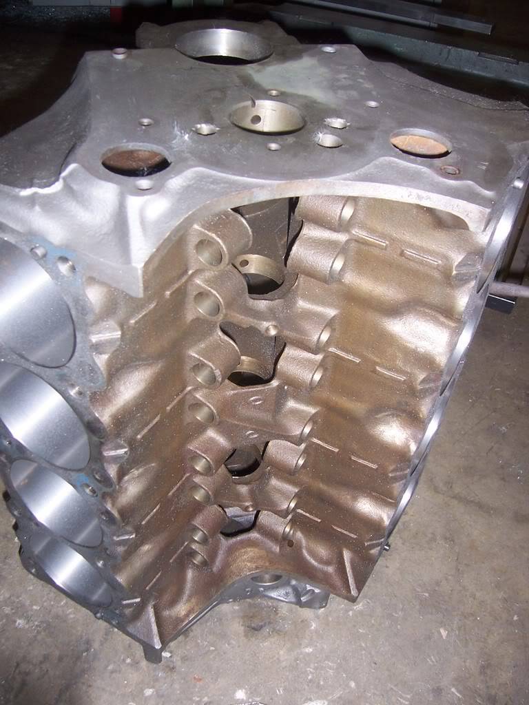

      checked on the motor today
      well they tried honing it but had issues so they decided to bore it out more
      it was 40 over now its 60 over
      the block is in the cast gray color right now but will be painted pontiac metallic blue
      need to order my headers and I also ordered new valve covers for the motor

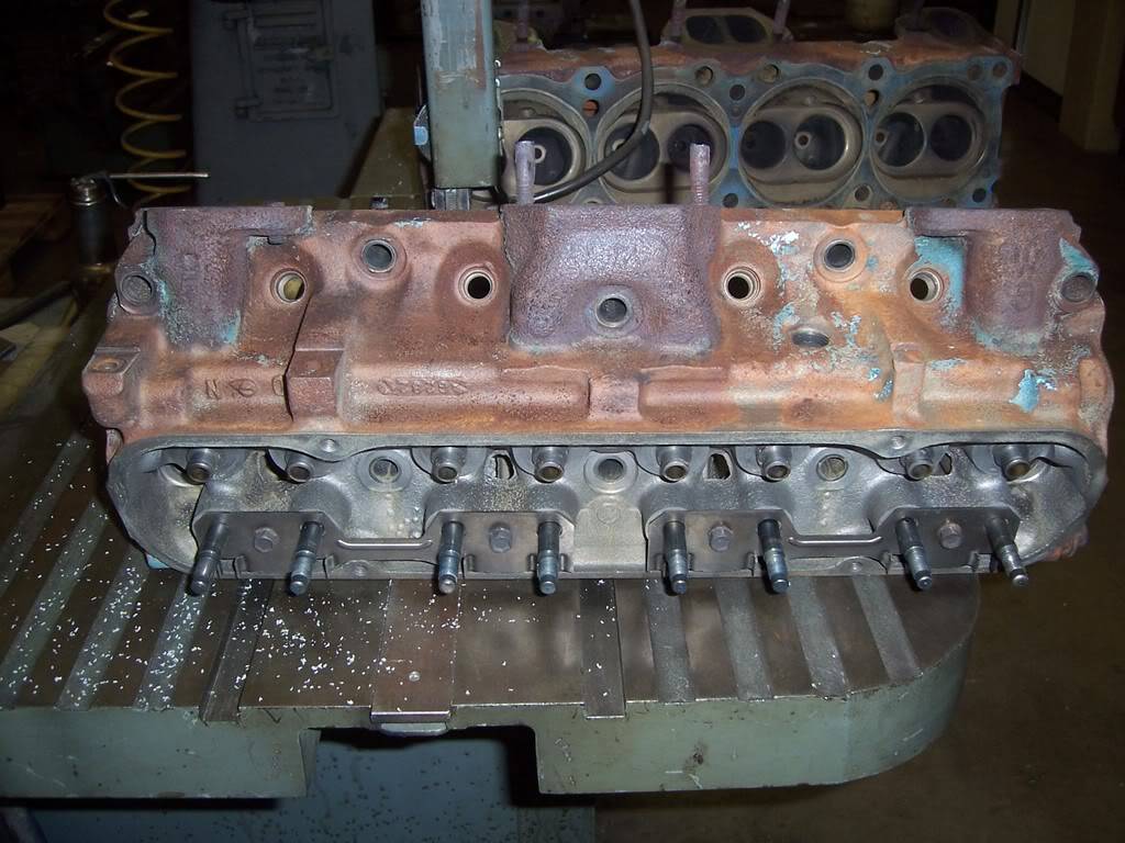

      well some slight bad news
      I got a call saturday morning from a buddy who visits the shop frequently and they found a crack on one of the heads after cleaning them up. Crack is on the exterior but the thermostat hole I havent seen it yet but my brother and dad went to check it out. might be fixable but might be looking for another set of heads.
      If I buy heads i'm not going real pricey i wouldn't mind finding just a nice decent set to get me buy for a couple years till I decide to go for some nicer heads $1,500-$2,000 is not in my budget for heads

      Head Pics my brother took these and sent them to me
      they look pretty good except for the crack
      You can see the crack in these pics

      well my brother talked to a friend of his who's family is in the race shop business and said head is toast I'm going to stop by the shop where the engine is at to talk to them about options

      that's too bad. but core cast iron heads shouldn't be too expensive.
      unless these are some rare casting?
