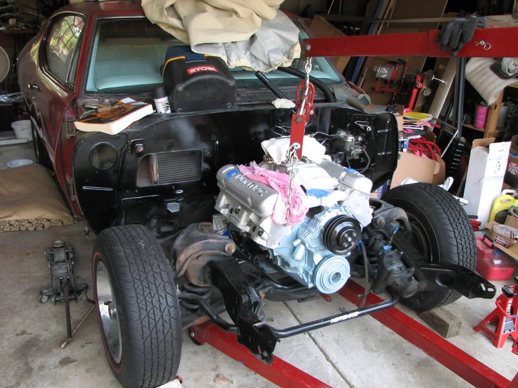

      getting ready to put the engine in tomorrow

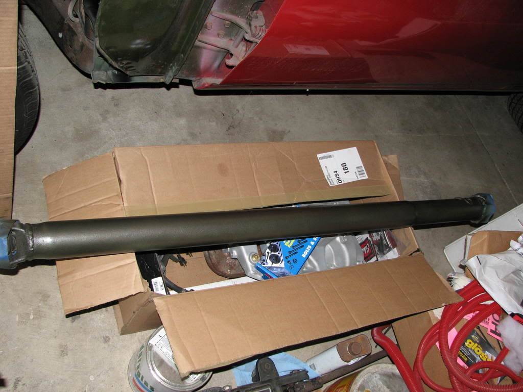

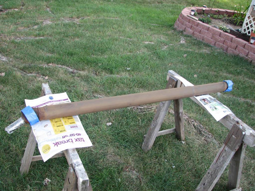

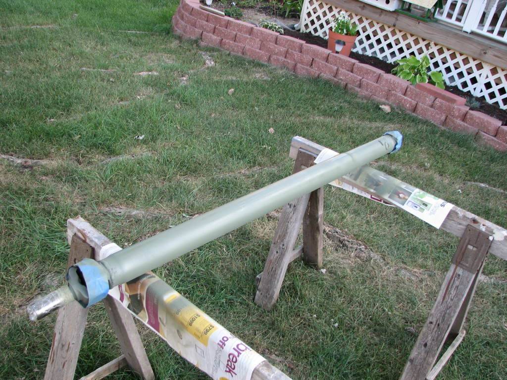

      sanded and painted the drive shaft

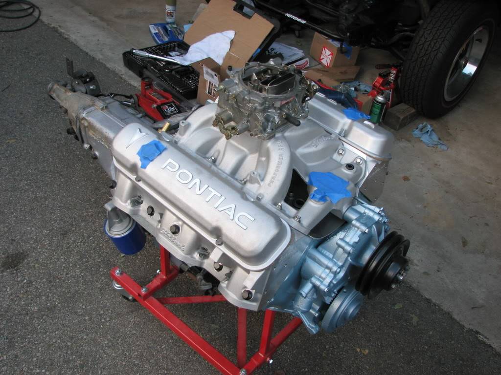

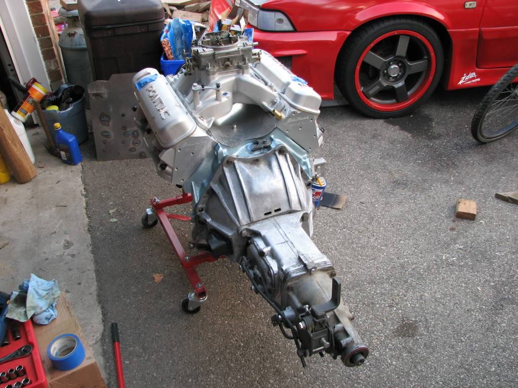

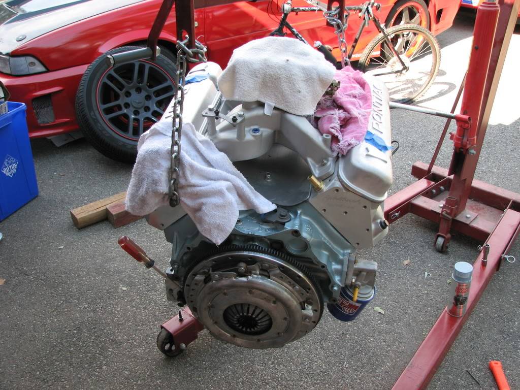

      drivetrain goes in tomorrow picked up a new Hayes Billet steel flywheel last weekend while at the summit truckfest

      You might want to clean up that trans, and spray some aluminum engine paint on it. Get some high temp primer and paint it, should look great! For 10 bucks, you cant go wrong.

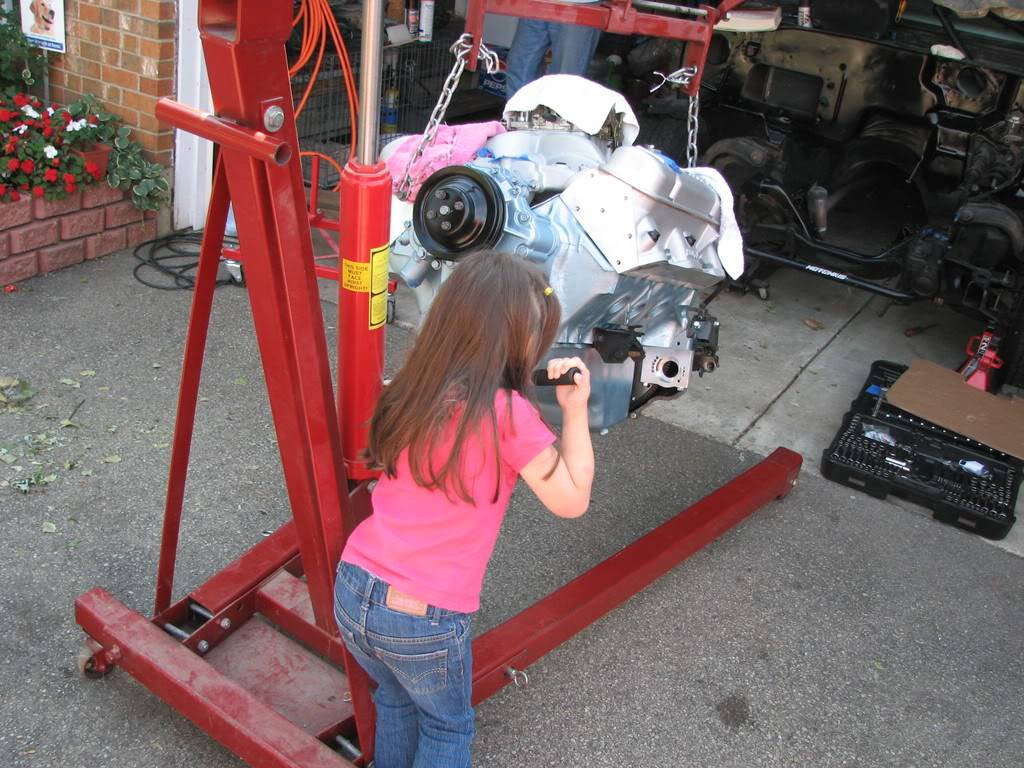

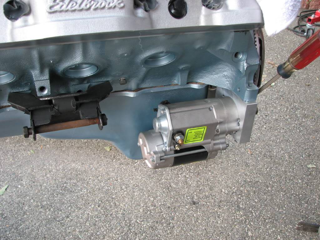

      got my jegs starter that weve had for years finally mounted and lined up right.

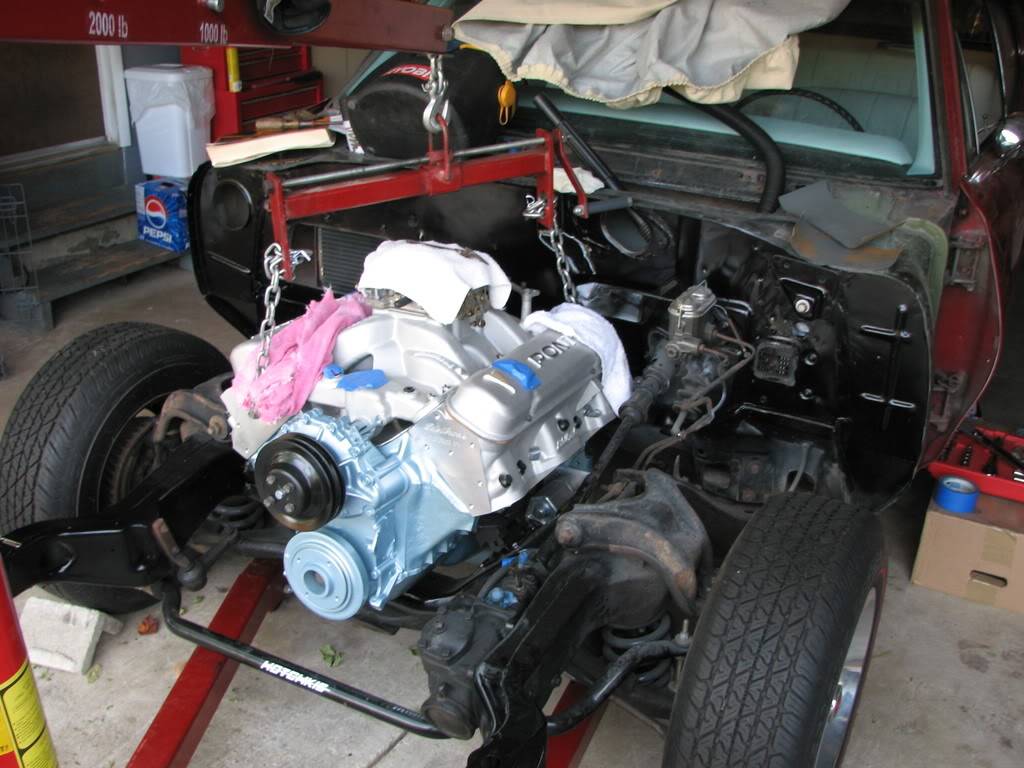

      did a test fit of the engine first without the trans to check for clearance of the starter so I didn't have to put it on from under the car.
      tried to put the engine and trans in the car and then remembered the headers lol well ran into a bit of a snag but will probably wait till next weekend to finish up getting everything lined up and headers put in.

      Teaser with just the engine no trans and no headers in in the car.

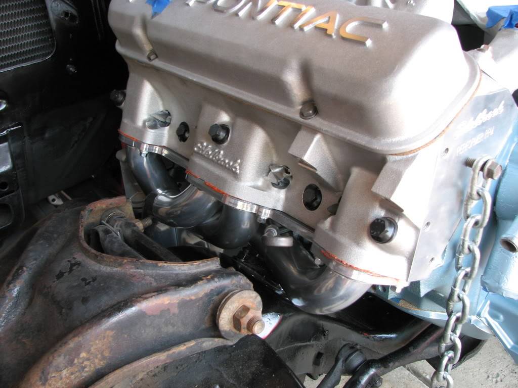

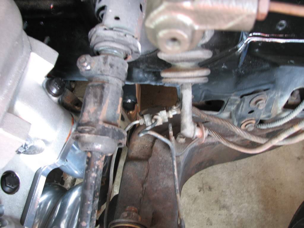

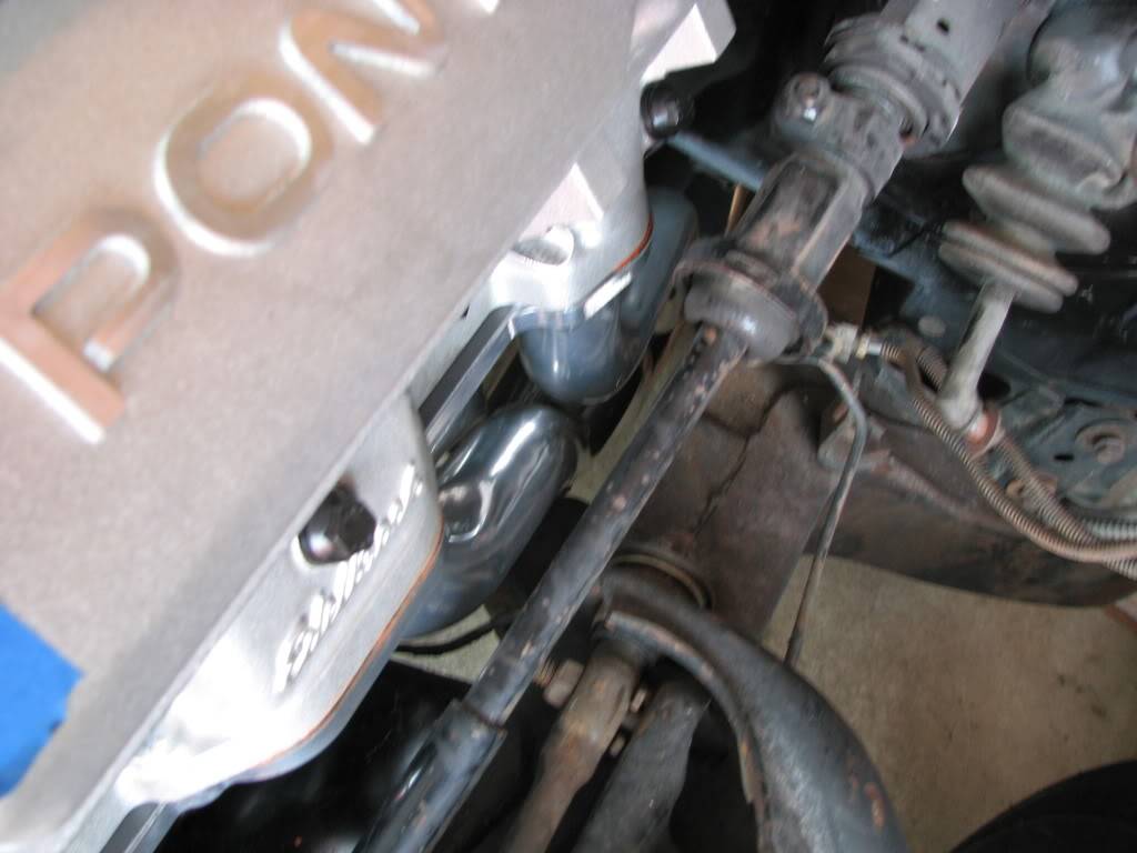

      I talked to the guys at the engine shop today about my headers hitting my porportioning valave and they said yup every pontiac does that and it has to be moved up lol

      Quote Originally Posted by Code Red
      thank ya
      My prop valve was floating above the frame to clear my headers when I got the car. I fabbed up a bracket to mount it to the frame behind the inner fender, using two existing holes.
      I think if I have to do it again I will put it under the toe-board.

      Yup, had the same problem. If you 'leave it as is' movement of the motor will cause the header to rub against the valve and you will work a hole into the side of your headers. Not to mention the heat sink it creates for your valve being so close (the stock exhaust I believe tucks in a bit tighter to the trans).
      I had to move my p-valve to another location (I swapped out a Bird front-disc/rear-drum p-valve and mounted it under my Master-Cyl).

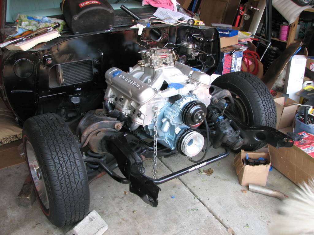

      finally bolted the headers and motor woo hoo
      now I just need to start assembling the clutch parts, all the dam accessories, plugs, wires, distributor, and a bunch of other things before I get the body panels back on and then I can take it up to the shop for its first startup
      should I wait to fit up the exhaust and do the first startup on open headers? lol
      yes exhaust will be getting replaced eventually with bigger tubbing
      Damn brake proportioning valve was in the way of the driver side header so just moved it up and out of the way for now I'll figure out later how I mount to mount it
