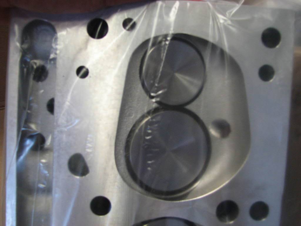

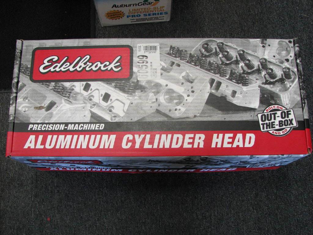

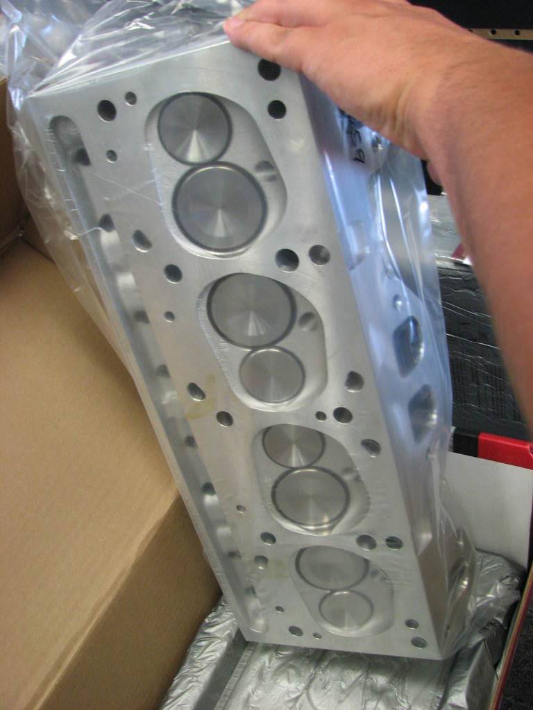

      well my mom and I went up to the shop and after some discussion decided to bite the bullet and go with the edlebrock rpm 72cc heads man my wallet is going to feel so empty after all of this

      Stopped by the shop and there was a mess up with the order they only got one in but the other will be in monday

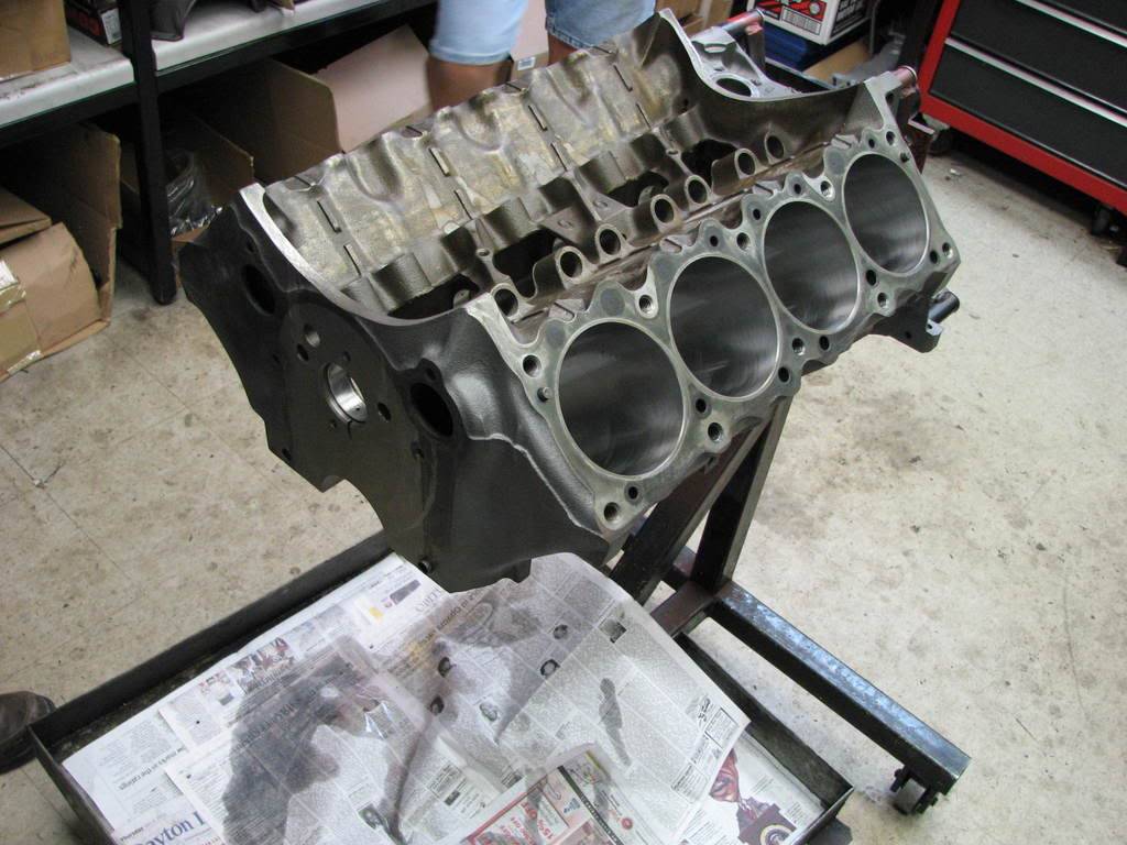

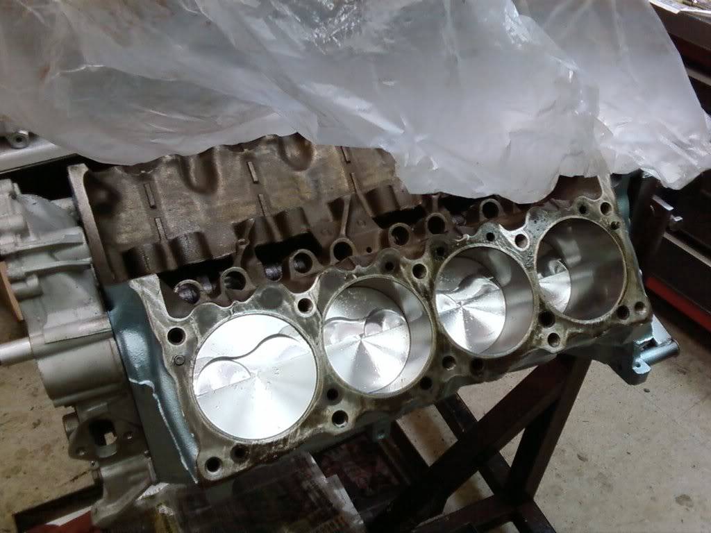

      They rolled the block into their assembly room today
      block should be painted by saturday and assembly should start on monday, so if all goes well engine should be home next weekend

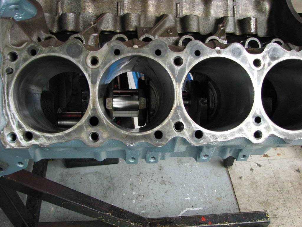

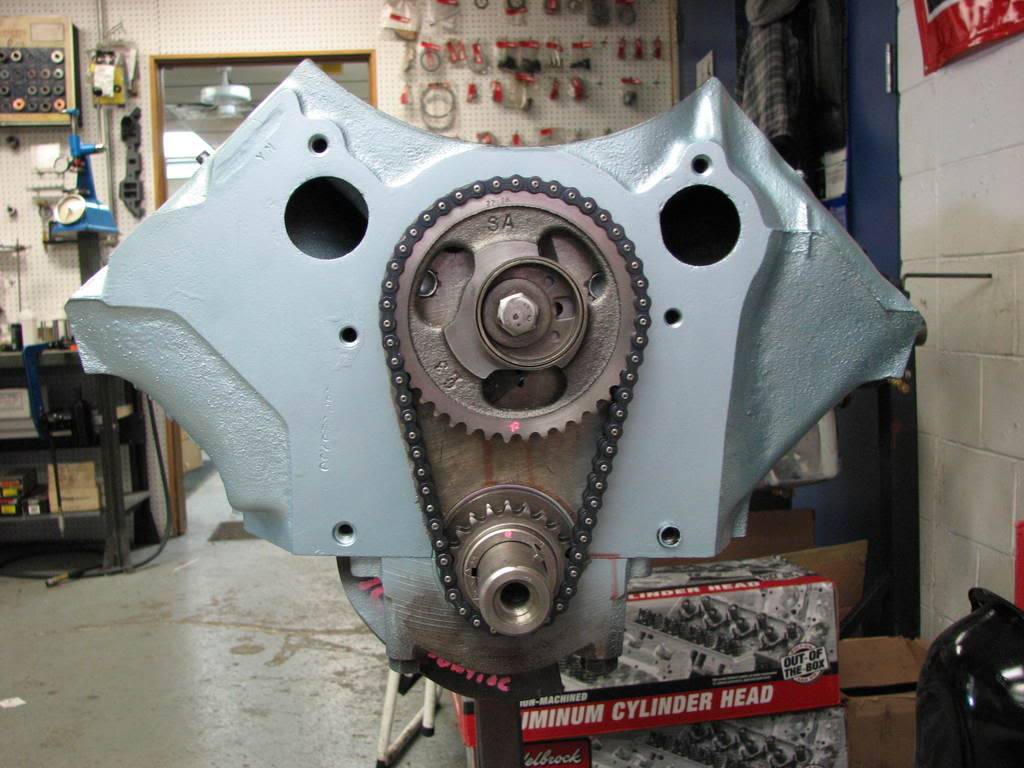

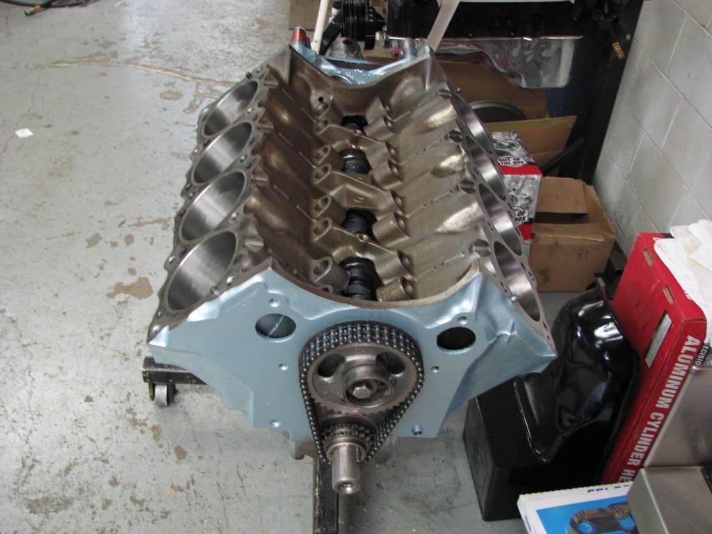

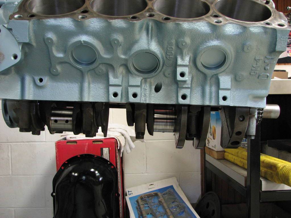

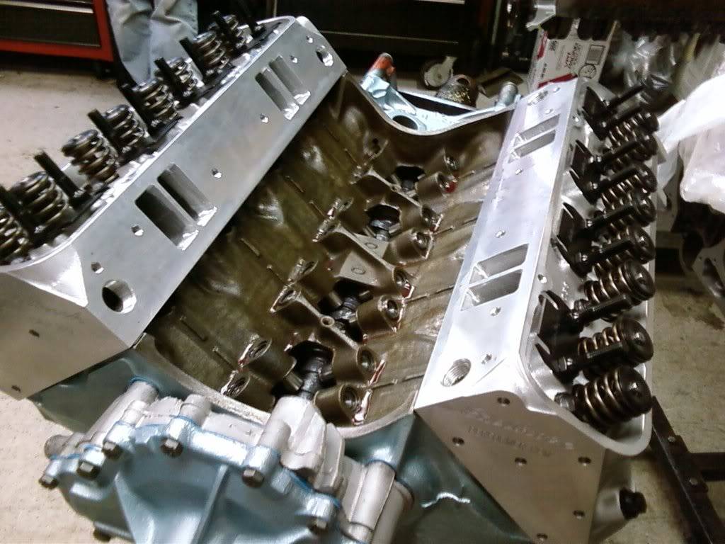

      well its blue and starting to get assembled

      That engine is going to look really nice! Pontiac blue on the bottom and all aluminum on top. In addition you are going to loose about a 100 pounds off the front end, give or take a few pounds.
      What compression are you running?
      Great progress on the firewall! That will set off the engine compartment with it all smooth. Are you going to paint it the same color as the body?

      think the engine shop said 10:1 on the compression due to the heads
      well we are thinking gloss black for now may change once we actually paint the car but we will see

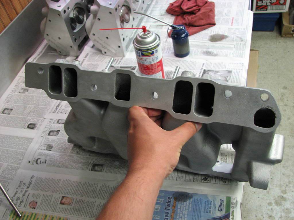

      Major Update
      well some bad news
      1. Crack pulley is cracked and has to be replaced (there is supposed to be a ring in which the bolts are tighten down on but it was missing so the previous person did in on the pulley and cracked it) upgrading to billet
      2. Valley Pan rusted up a bit and has holes will be ordering a new one
      http://www.jbp-pontiac.com/images/MISC/valleyPan.JPG
      3. Flywheel has cracks might be ok to use for now but will start a search
      4. My old Edlebrock PB4 intake WILL NOT FIT the new Edlebrock Performer RPM heads grr so ordered a new Preformer RPM Intake
