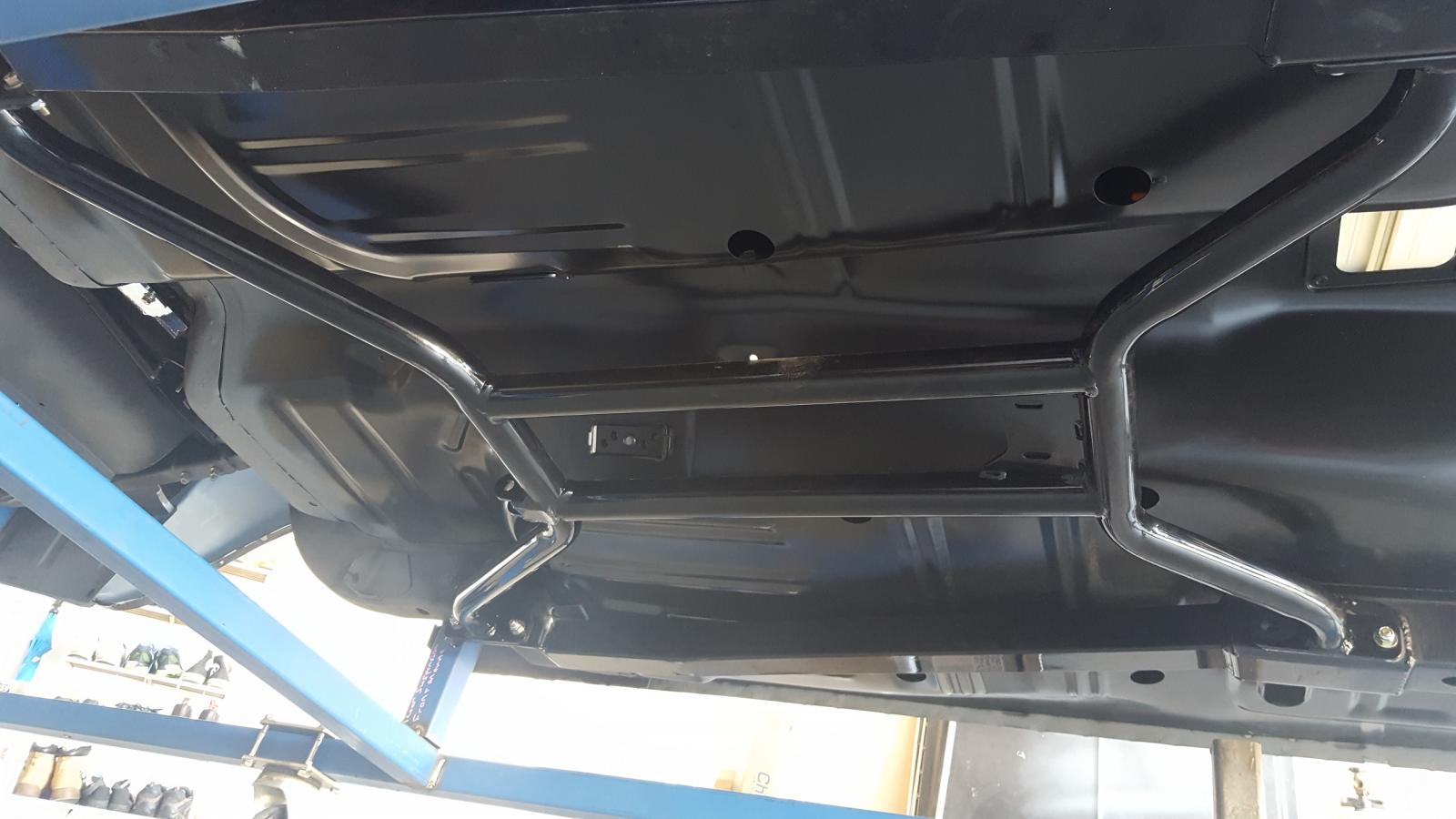

      Hi All. Just a quick update as we are still awaiting my wheels to arrive so i can get my axle sized up.
      The rear suspension arrived and the quality from chassis works is as good as the sway bar that arrived earlier. We have fitted the suspension cradle, chassis rail connectors and the cross support. It looks great and looks like it will be as stiff as a board.
      We have started to tackle the dreaded front fenders and are making great progress. We released the fender supports and adjusted the position of the top of the fender and how it sits. After a day of adjustment and fender on , fender off, cutting, welding and adjustment i am beginning to believe we are making great progress. We have cut the bottom of the fender completely off for now just below the rocker panel line with a view to a possible customization which could involve lengthening the rocker panel to the wheel arch.
      We have seen this done on a Ring Brothers car and its one of those mods that has people scratching their heads wondering what looks different about the car but can't put a finger on it. Ring Brothers did a great job on theirs but they are also very skilled and have a multitude of tools and trades at their disposal. We are but two people with a passion and a spare garage.
      If we could pull this off it will solve the problem of unusable aftermarket fenders that are literally too short. We also have the option of welding and extension piece in but the former option is rather exciting.

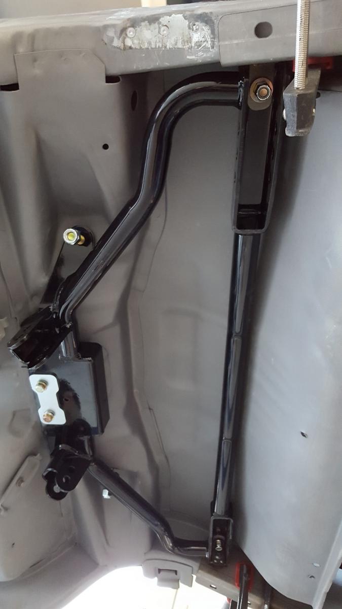

      Rear suspension cradle from Chassisworks.Name:  20160702_153825.jpg

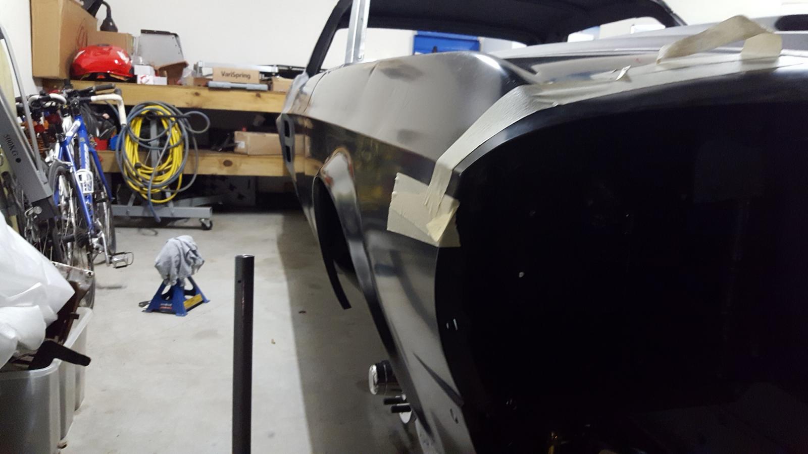

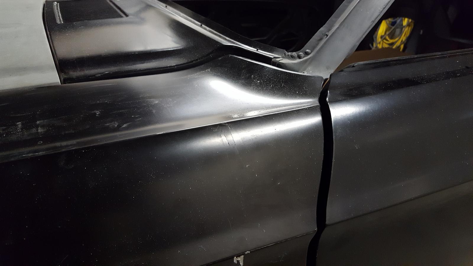

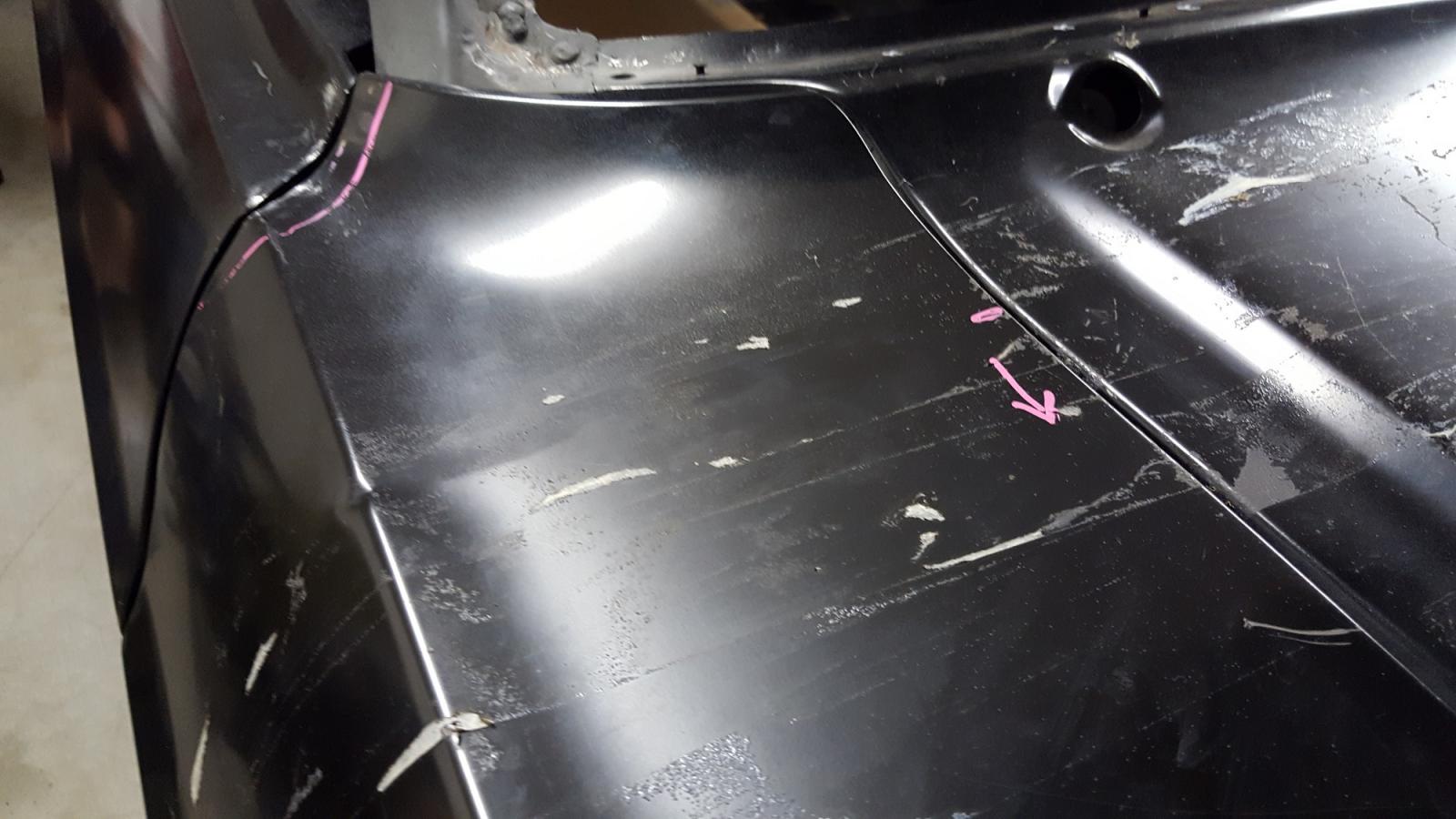

      This is a before shot of the fender.Name:  20160723_184210.jpg

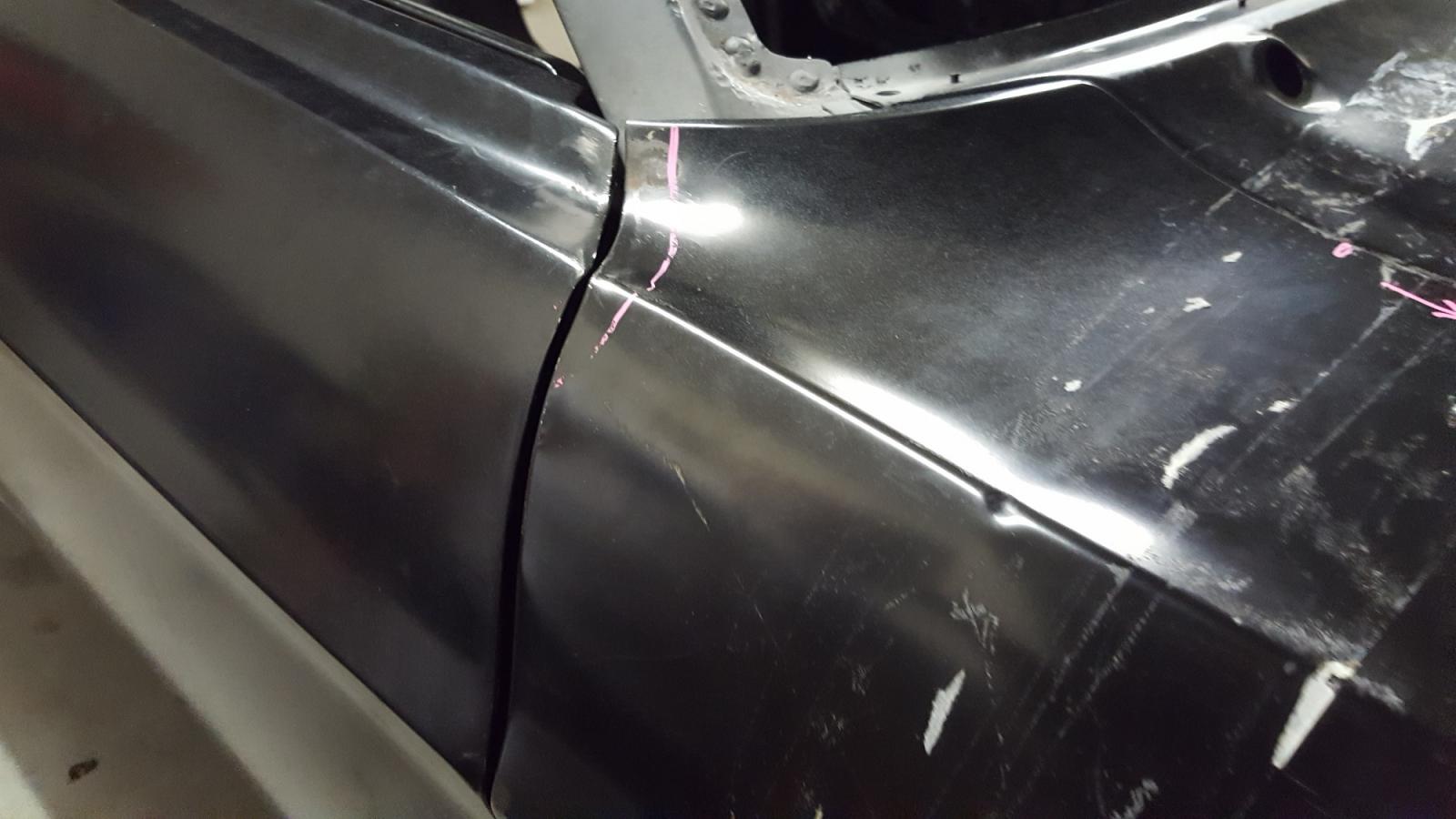

    8. #88
      Jan 2015
      Australia
      285
      Country Flag: Australia

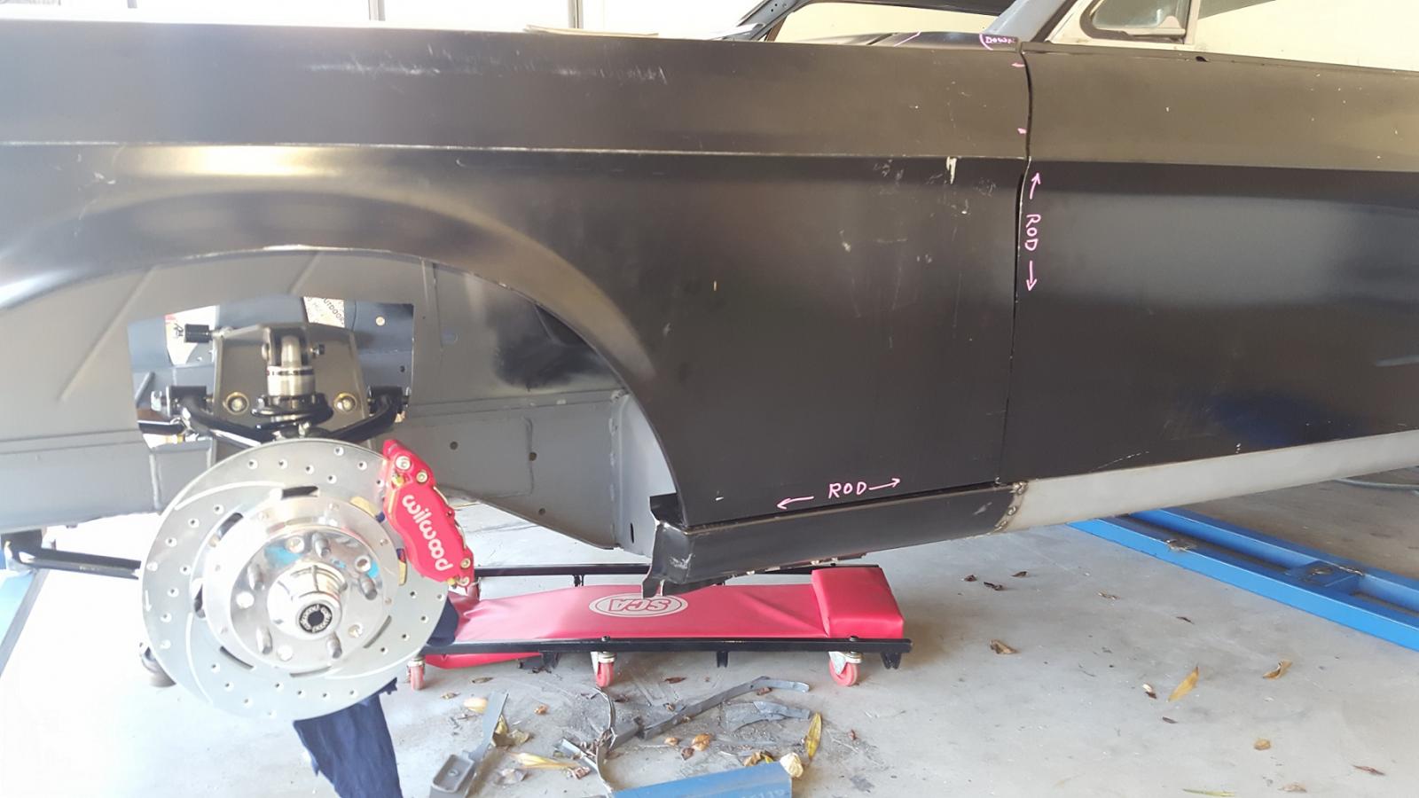

      This is after many adjustments. Nearly there but not quite!!Name:  20160723_183959.jpg
    9. #89
      Jan 2015
      Australia
      285
      AnothName:  20160723_183952.jpg
Size:  134.9 KBName:  20160723_184057.jpg
Size:  110.8 KBer shot.

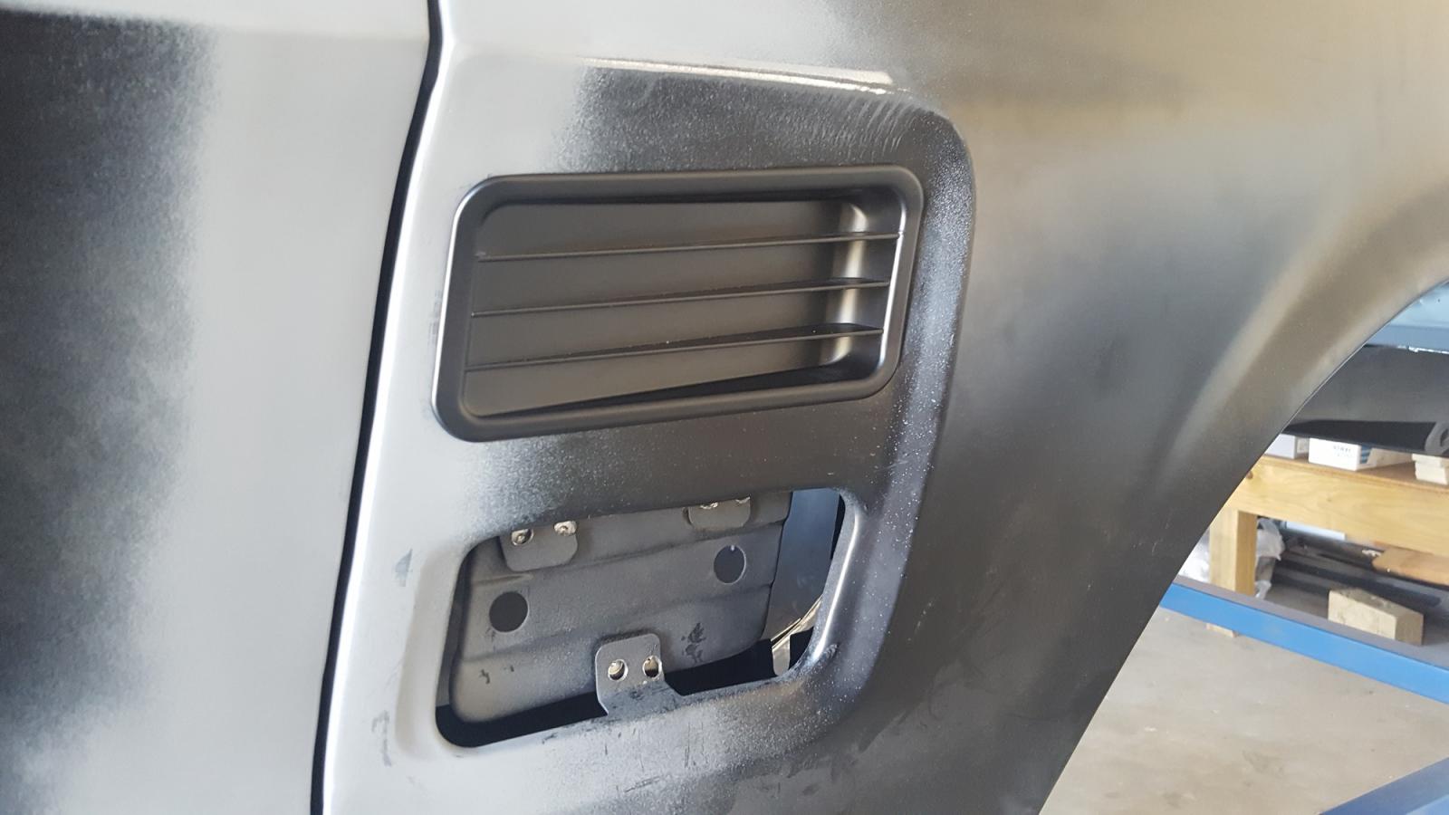

      Did I mention how bad aftermarket panels are, even the qtr panel ornament brackets are welded in the wrong position. We have had to release the welds and move the mounting bracket accordingly followed by the required amount of panel beating to get them to sit any where near acceptable.Name:  20160723_184225.jpg

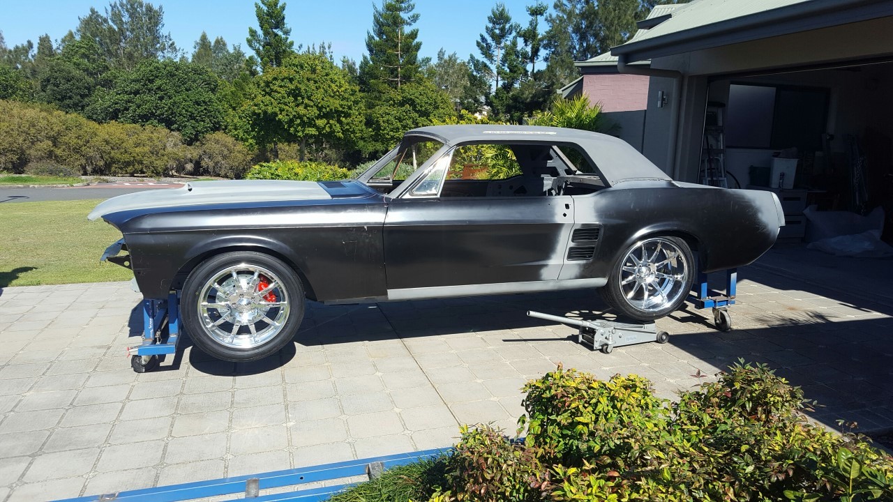

      Wheels have arrived from Boze and look great. The service i got from Zak at Boze was outstanding even though i am all the way down here in Australia. A big thanks and a recommendation to any one looking for a quality product with good service.
      I have married the wheels with some 305 Nitto Invo tyres on the rear and the result is looking good.
      I'll post some better pictures over the weekend.Name:  IMG_20160804_202526_resized.jpg

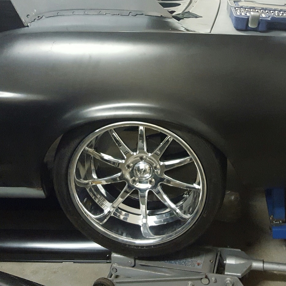

      Hi all, here's a better of the look I am trying to achieve. The wheels an a real good fit under the original guards with no flaring. The rear di require a little trimming of the boot floor but no rail modification has been required. I will now measure the correct distance required for my axle length.

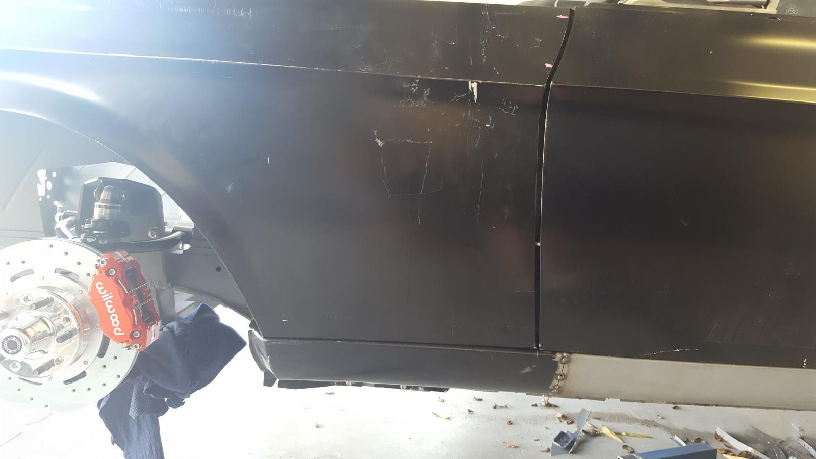

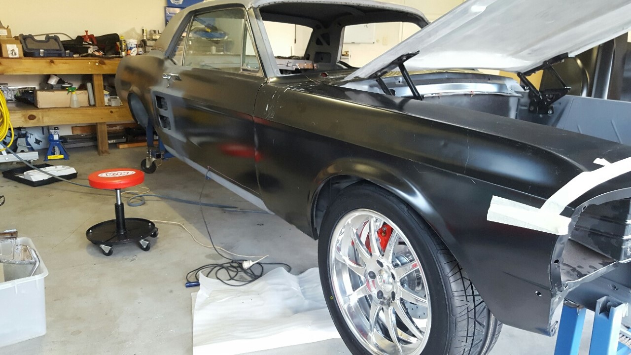

      We are making progress with the badly fitting aftermarket fenders as well. Taking inspiration from Ring Brothers Split R build, we are going to extend the rocker panel to the bottom edge of the wheel arch and cut the fender short. Tis will give the look of the lower door edge gap going all the way to the wheel arch and the fender sitting on top of it. I am aiming for a mod that is subtle and will take people a while to realize whats been done. It's early days but it looks promising. Not sure how we are going to get a nis neat bend in the lower edge of the fender yet but i'm sure we will work it out.

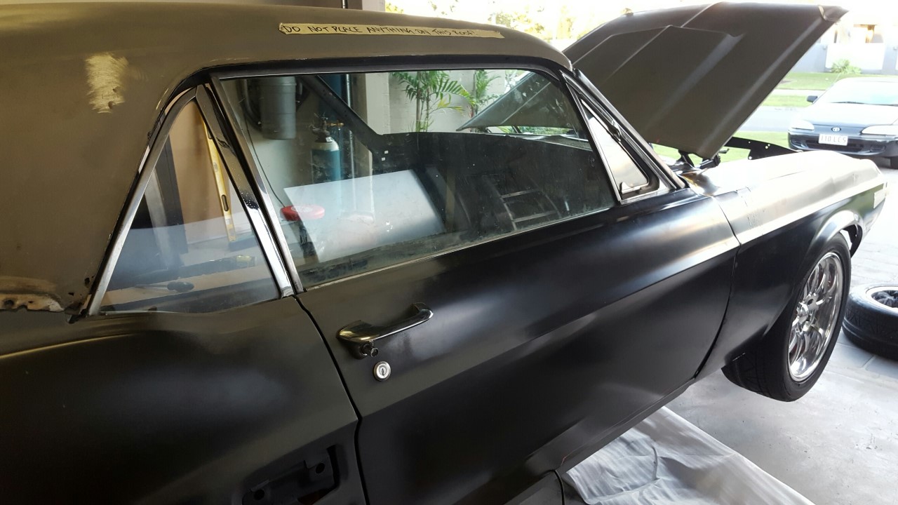

      Also started to test fit the glass into the new door shells to see how they fit. As I suspected they will need some adjustment to get them right but i would rather do this now prior to paint!!!

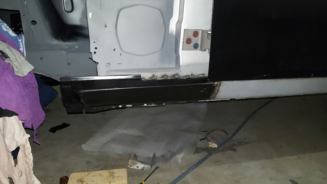

      The front fenders and rocker panels are coming along. Just fix up the gap and align it with the door gap and it will start to look nice.
Size:  112.7 KBName:  20160903_123759.jpg
      Once we close off the end it will look a lot more like a factory finish
