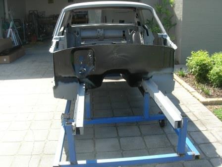

      Here is a quick shot of how things are starting to come along.
      Took this last night to see if my levels were ok and I must admit I was pretty impressed with myself.
      I will measure a few more times before finally welding the firewall and cowls in fully but not bad so far.
