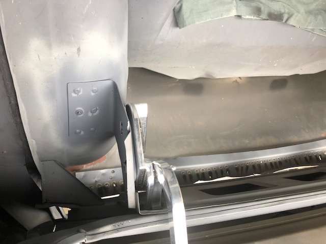

      Fabricated some trunk hinge bracket supports and fitted the ring Brothers hinges.
      Just cleared the Detroit speed rear tubs....Lucky!
      Love the hinges and starting to gap up nice.

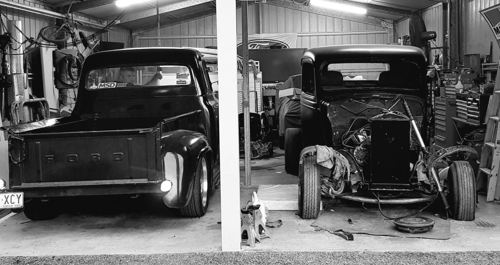

      Last post just for fun.
      This is a friend of mine in his shed.
      Love the Picture.

      That picture of your mates shed is awesome!

      My friends garage is impressive. That was just a quick snap on afternoon. Just taken at the right time.

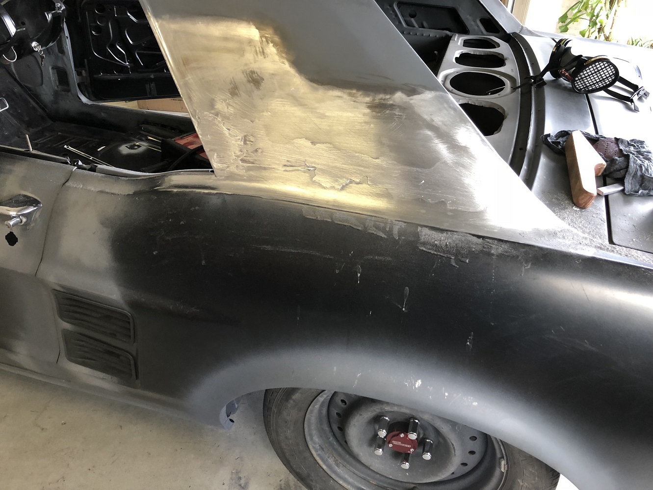

      Had to decide what to do about the sail panel /roof joints and after much talk we finally decided to use the old school lead for no other reason the we had never done it before and the origional lead was in the joint for 51 years with no issues or any signs of a problem underneath when we removed it.
      Can't be that hard!!!!
      I must admit after much swearing and tamtrums i think we finally worked it out and the left side will be a lot easier.
      I think it will turn out good when we do our final finish and a lot more filing

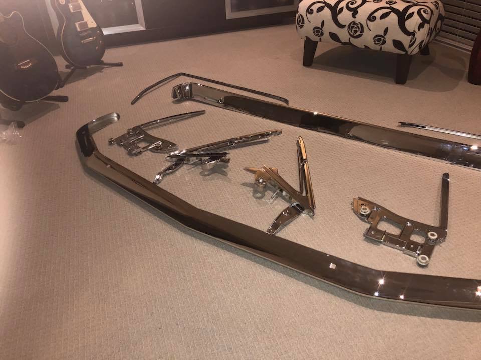

Size:  137.9 KBHad the original chrome and stainless republished and chromed and the results are brilliant.
      Old steel certainly better and thicker than new.

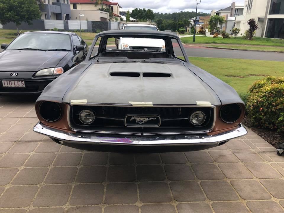

Size:  79.1 KBIt’s time to start thinking about colour and I really can’t decide but I did see a House of Koloa Apple red.
      Has anyone seen or know any one who’s used it.
      This is a Camaro that was done over in the States

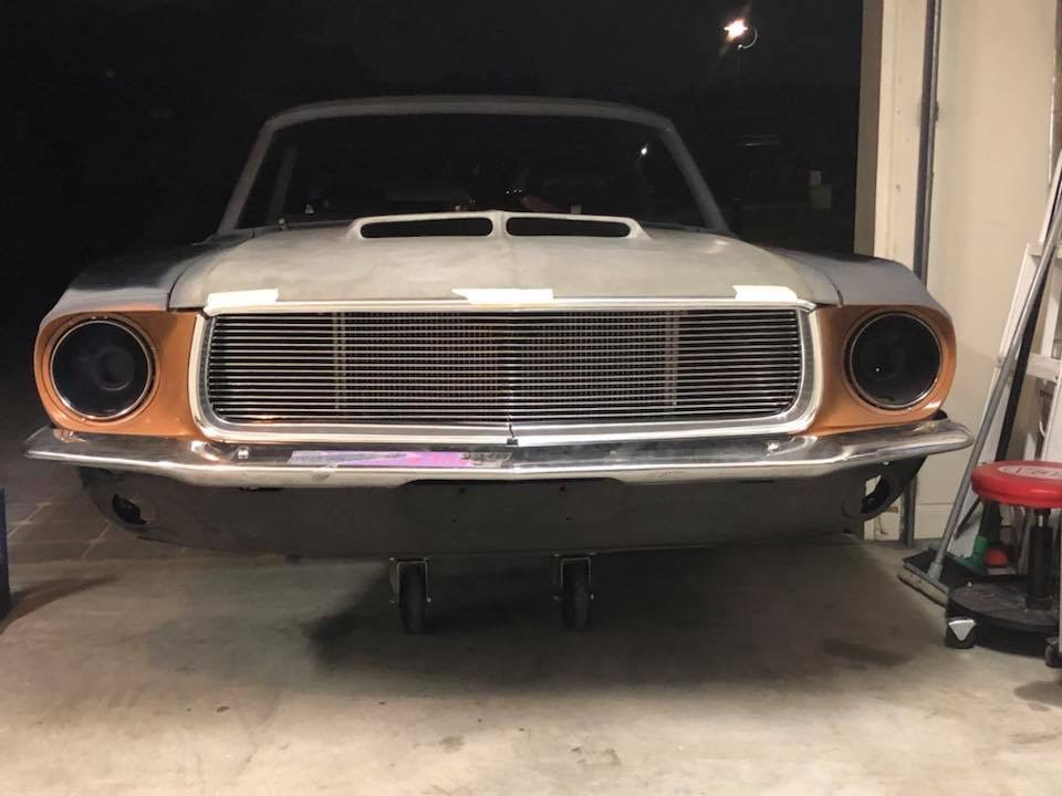

      Ok , question of the day
      With or without?

      With, of course. With that candy apple red, it would be sweeeeeeeet.
      House of Kolor or Koala? I can see where you might slip when typing. lol
      Gorgeous color. Car's coming along great!

      Optical illusion, or is the crossbar not parallel with the grille bars?

      Light bars are not level they are just loosely fitted. Just trying to decide light bar or not

      I actually like it better without the light bar, nice clean look.
      Thought you had decided on a color waaay back when you painted the panel prior to installation? I really liked that color.

      As far as the leading, Gene Winfeild did a video, for Eastwood I think, good watch to catch some tips. By the time you finish you'll wonder why more people don't do it, pretty easy once you get the swing of it.
