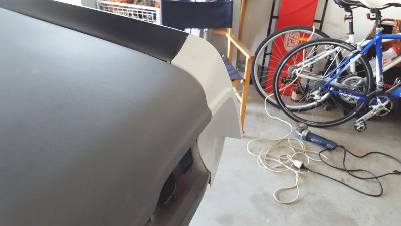

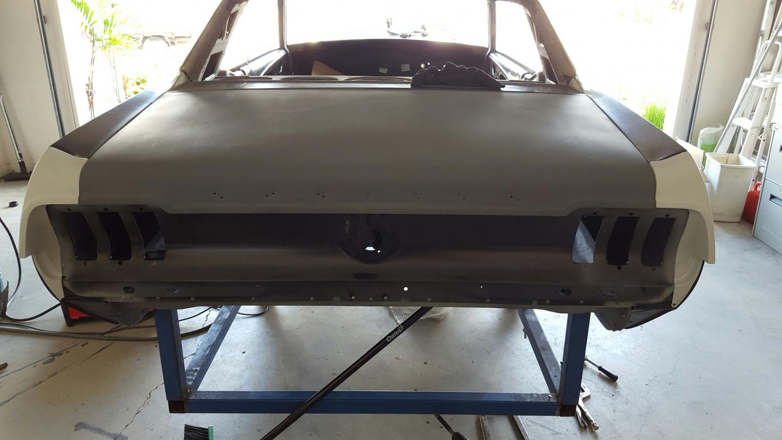

      Rear Quarter Before and after shots.
      O.K.
      Managed to get some time in the garage this weekend and we plan on starting to finish and gap from the rear end forward. We had tacked the qtrs in place and decided to get the qtr extensions and boot lid in place and correctly gapped. The original extensions had been hit and were pretty bashed up so a new set of Dynacorn parts got purchased. The overall finish on the parts is really good but the shape of the rear qtrs was something to be desired. After a good day of reshaping and beating we have finally got them looking really close and final file should see a good result. As i said previously, anyone starting a build like this in the future needs to use as much original steel as possible!!!Name:  20160417_103818.jpg

      The rear end is really coming along now and after my previous rant about after market parts i am actually quite pleased with the results.
      I still believe that if it can be saved then save it but with a lot of time and patience then a reasonable result can be achieved.
      Still a little undecided about the final look of the back but i am leaning towards the tightened up bumper look that has become popular with a lot of restomods. here is a quick picture of where we left it today. A little more filing and tapping then we should achieve a nice result with minimal bog and filler.Name:  20160417_123044_resized.jpg

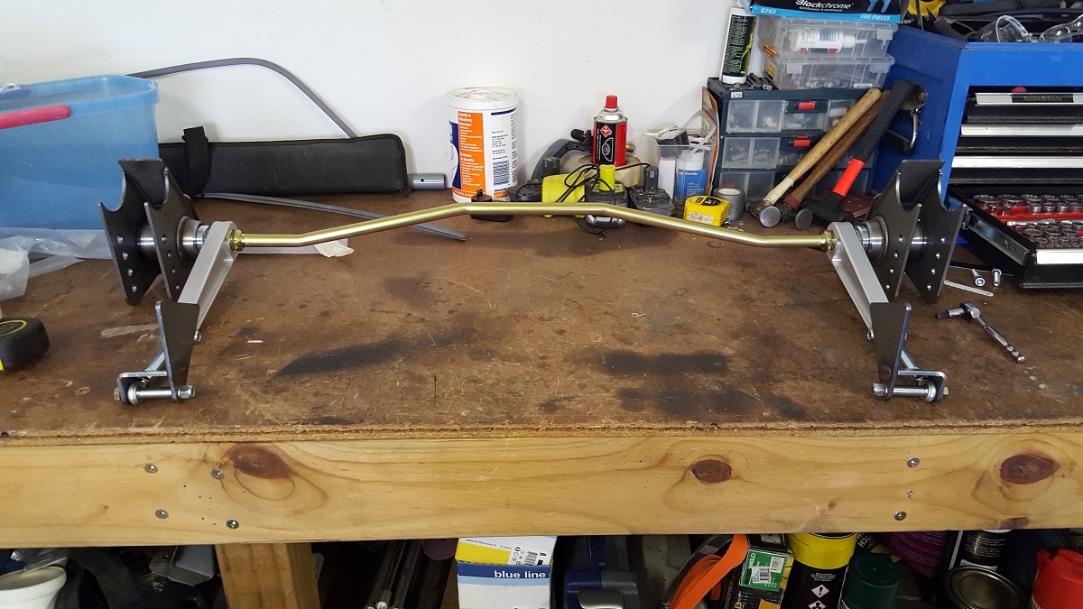

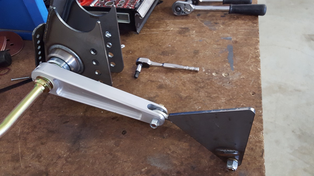

      I have finally ordered the rear suspension and decided to go with the Chassisworks G-Link rear. The splined sway bar arrived during the week and the quality of the product is exceptional. I hope the rest of the rear end is the same.Name:  20160604_151222.jpg

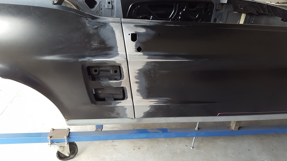

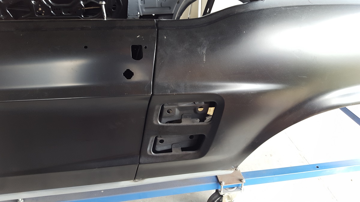

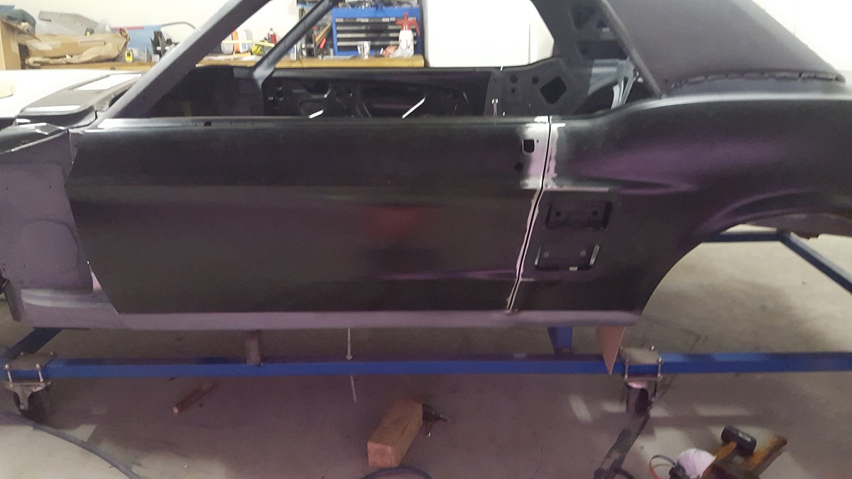

      Here are some progress photos of the door gaps coming along.Name:  20160604_170549.jpg

      We are working our way from the rear to the front because the front fenders are such a bad fit I really am not sure what to do with them. We are considering carrying the lower rocker panel all the way along and chopping the fender off at the bottom. Ring Brothers did a great example of this in one of their builds but i am not sure if it will fix my bad fit problem due to cheap reproduction parts.

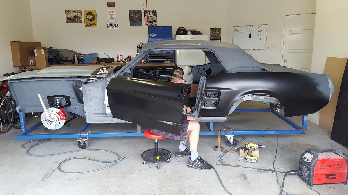

      Woody working away. I'm sure we should be in the pub by now!!!Name:  20160604_132228.jpg
