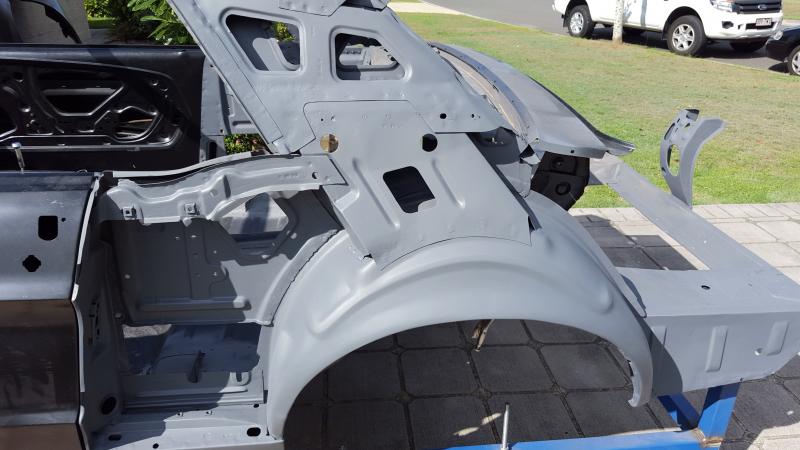

      285
      Country Flag: Australia
      The roof skin itself is also in good condition and will only require a buzz down with a DA the priming. In the lower section of the sail panel we will cut out the corrosion and replace with new steel similar to what we will do with the frame.

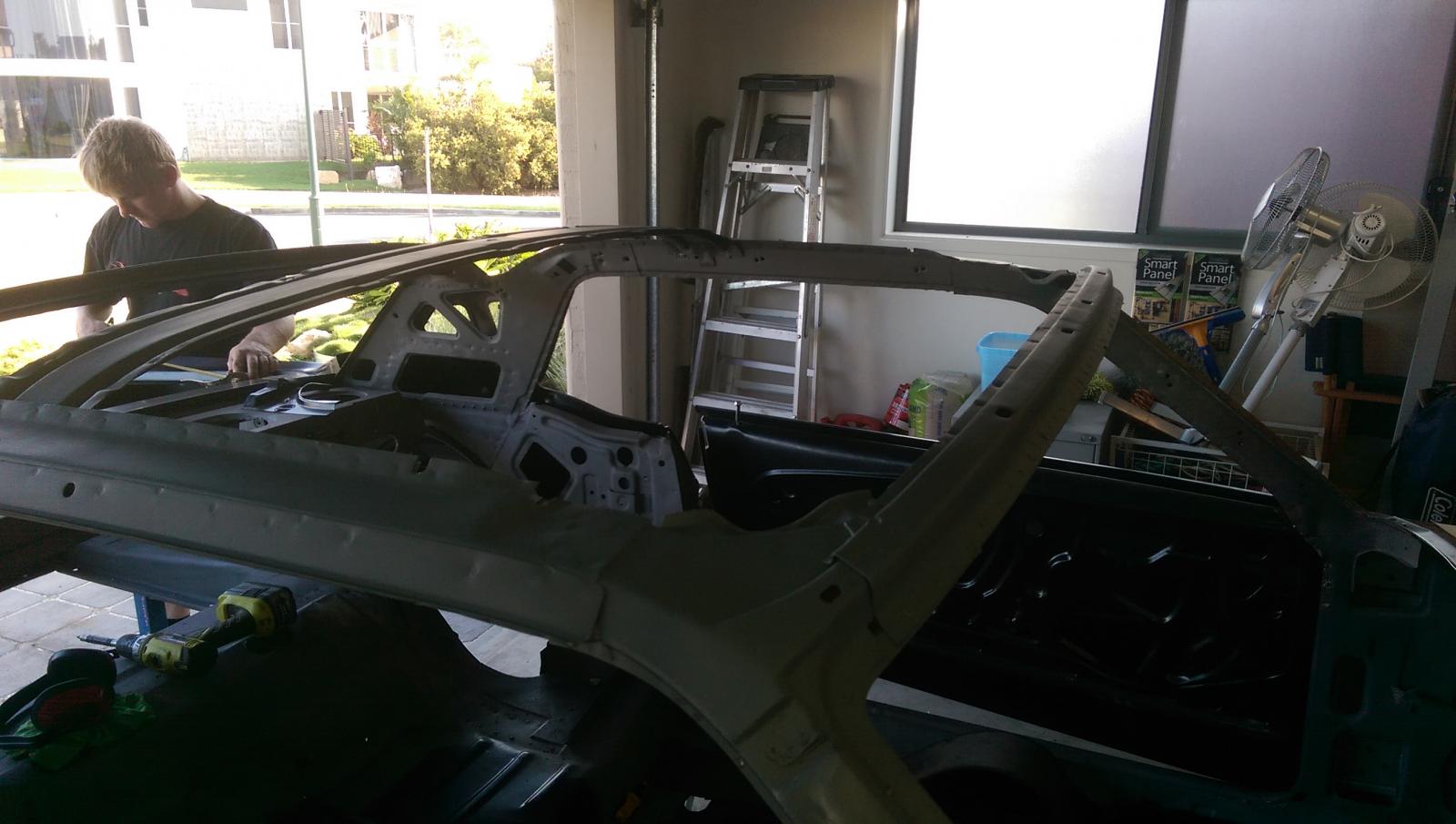

    3. #43
      Jan 2015
      Australia
      285
      Roof frame primed
      A quick view of the roof frame in proimer

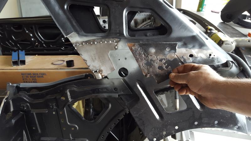

      Before, During and after shots of the sail panel repairs.

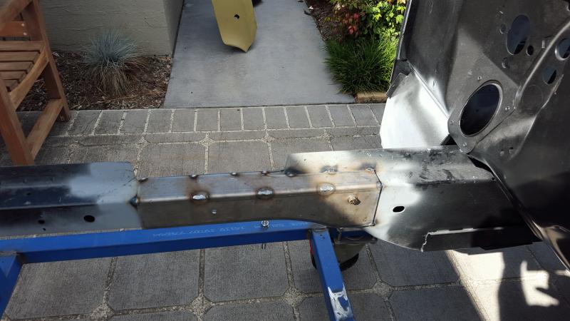

    8. #48
      Jan 2015
      Australia
      285

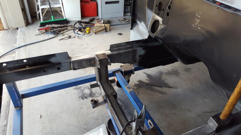

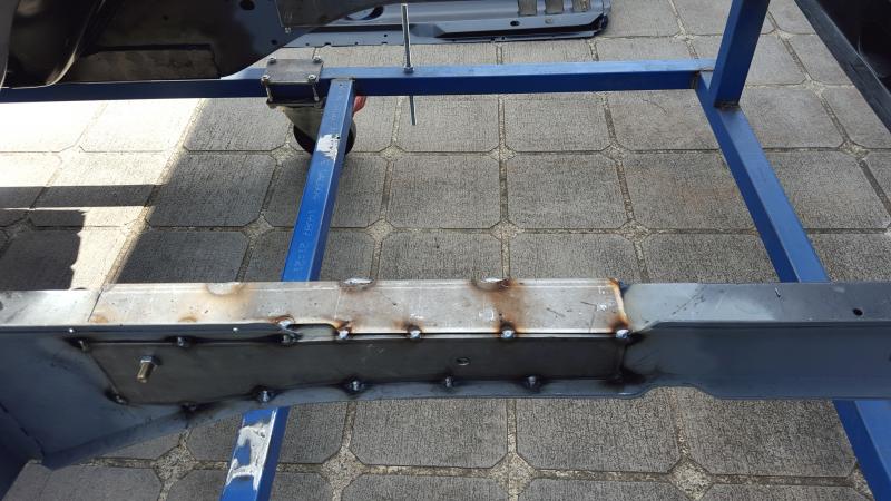

      This is a shot of the rails getting beefed up with steel from the Total Cost Involved IFSName:  20160131_153006.jpg
Size:  57.0 KBName:  20160131_153014.jpg
      - - - Updated - - -

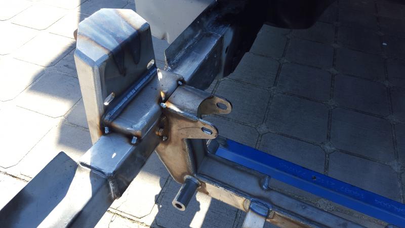

      We then measured up the cradle ready to weld in followed by the Shock mounts.

    10. #50
      Jan 2015
      Australia
      285

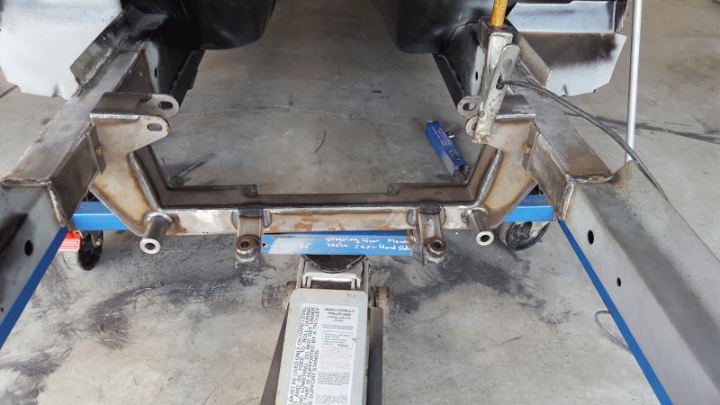

      The cradle took some time to get into the correct position with metal needing to be removed from either side to ensure a good tight fit that was square and central.
      Once that was in place we tacked the shock mounts in and proceed to test fit the control arms prior to final weld up.

      Cradle welded in
    12. #52
      Jan 2015
      Australia
      285
      Shock Mounts Tacked in.
Size:  48.9 KBName:  20160214_155052.jpg

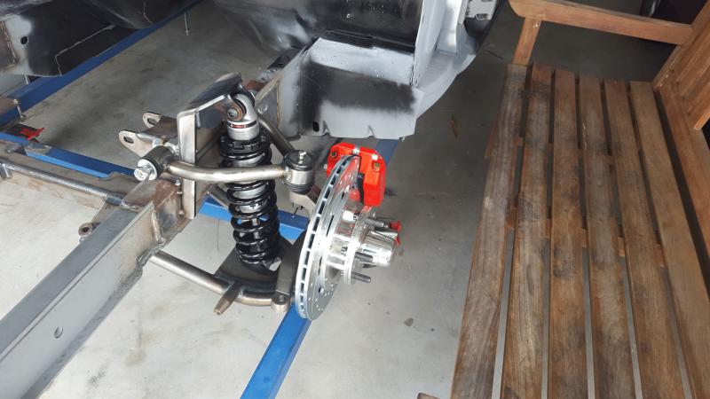

      Control arms and Wheel hub Test fit.

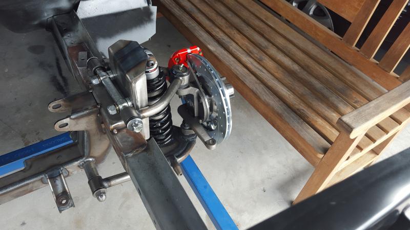

      Test Fit
    15. #55
      Jan 2015
      Australia
      285
      Nice

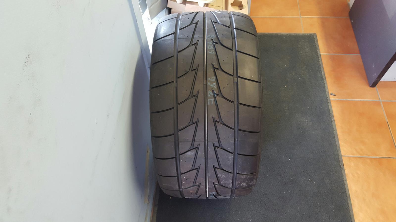

      Hi Everyone just a quick update of where we are at.
      We have got the rear end tacked on and are going to pack the trailer and take the car into work to do as many spot welds in a weekend that we can. We'll spend a day marking all the welds we have left from the beginning of the build with a paint pen to check we don't miss any. I have decided on a Chassis works rear end suspension with a fabricated third member housing from a local company down here called Race Products. I found them completely by accident locally here in Brisbane and the work these guys do is amazing. (www.raceproducts.net)
      With the axle decided on we needed to get the wheel and tire sizes to get the correct axle length manufactured. I saw a 66 Coupe on this site by with 315-35-17 rears on and set about seeing if i could get that size tucked underneath the rear end without cutting the frame rails as its a big no, no down here if you ever want to get your car road registered.
      I looked a the Autoworks minitubs which i think will suit me just fine. They only require the flange of the rail edge cutting and straighten up the inner wheel arch which should give me enough room.
      I'll post a couple of quick pictures to give an idea.

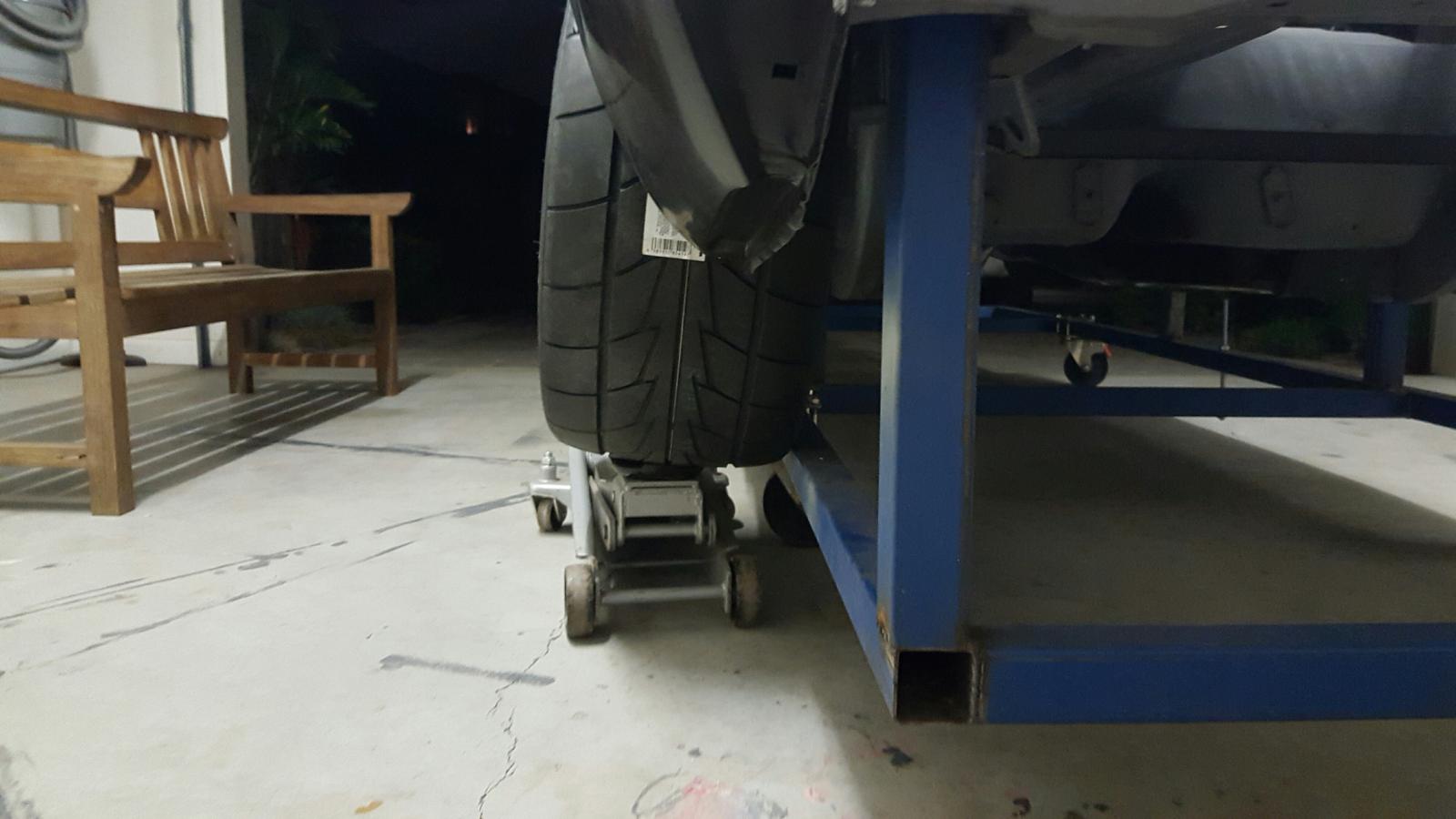

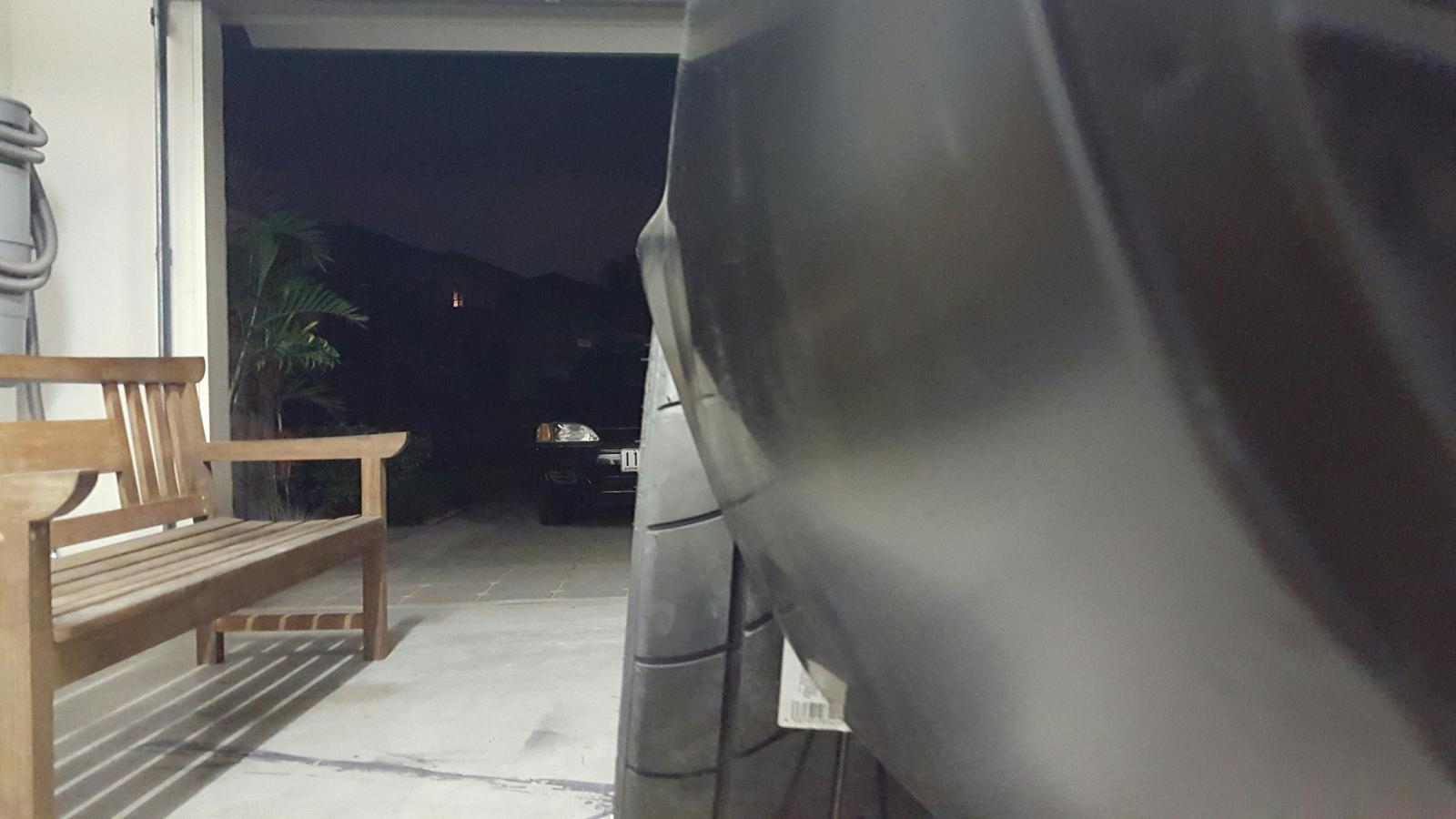

      Rear Wheel and tire size.
Size:  113.2 KBName:  20160404_191450_resized.jpg
Size:  100.4 KBName:  20160404_191504_resized.jpg
Size:  135.1 KBName:  20160404_191512_resized.jpg
Size:  107.0 KBName:  20160404_152348_resized.jpg
      Love the look of 17" rims on an older car but tire choices are getting harder to find over here.
      You can just see in the third photo the amount of boot floor that is able to be trimmed up to the rail to give enough room for the tire. I will move the bump stop to the inside of the rail along with the leaf spring mount.
      I think it was a user by the name of, I Got Oil, who has inspired this tire size choice. Check his build out it looks great.
