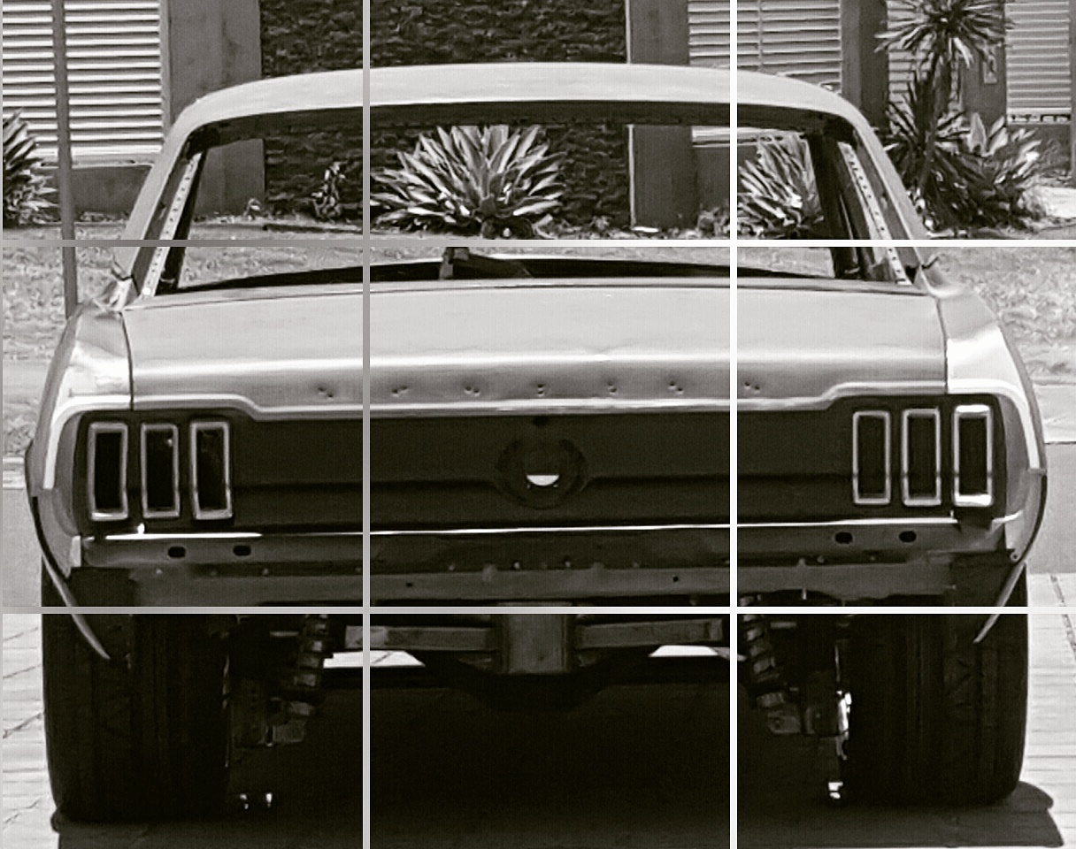

      Great job! and the rear stance is awesome!

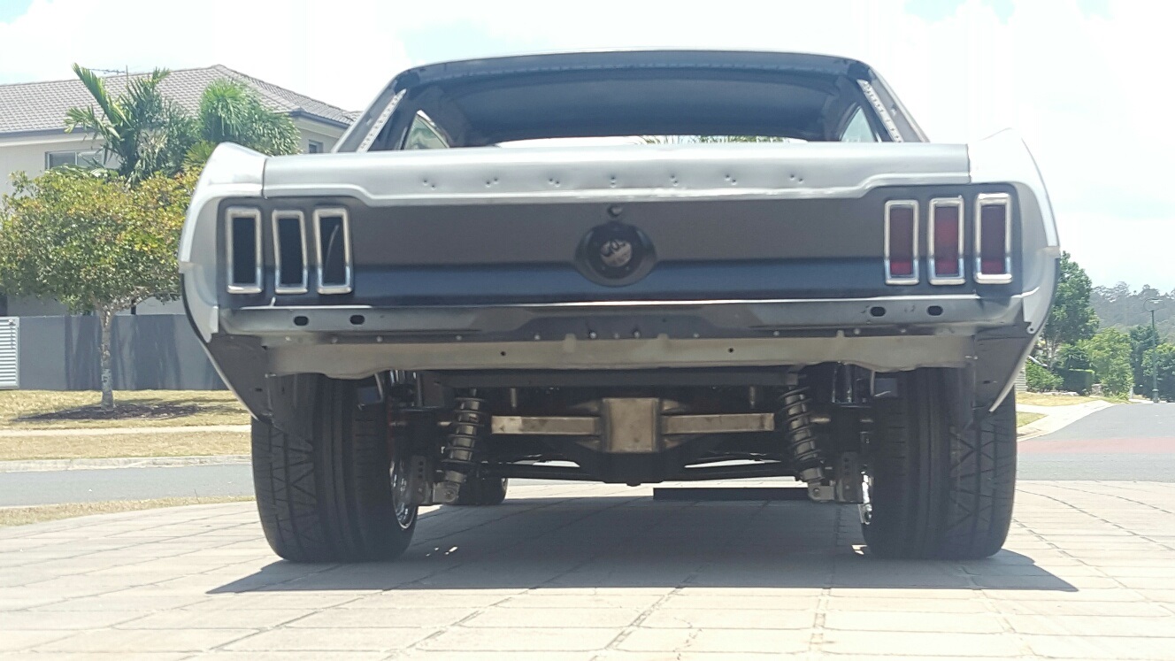

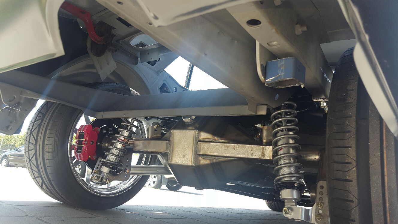

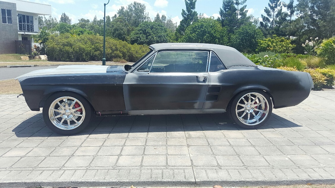

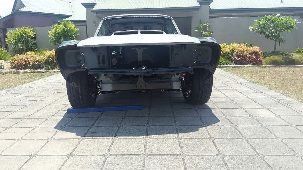

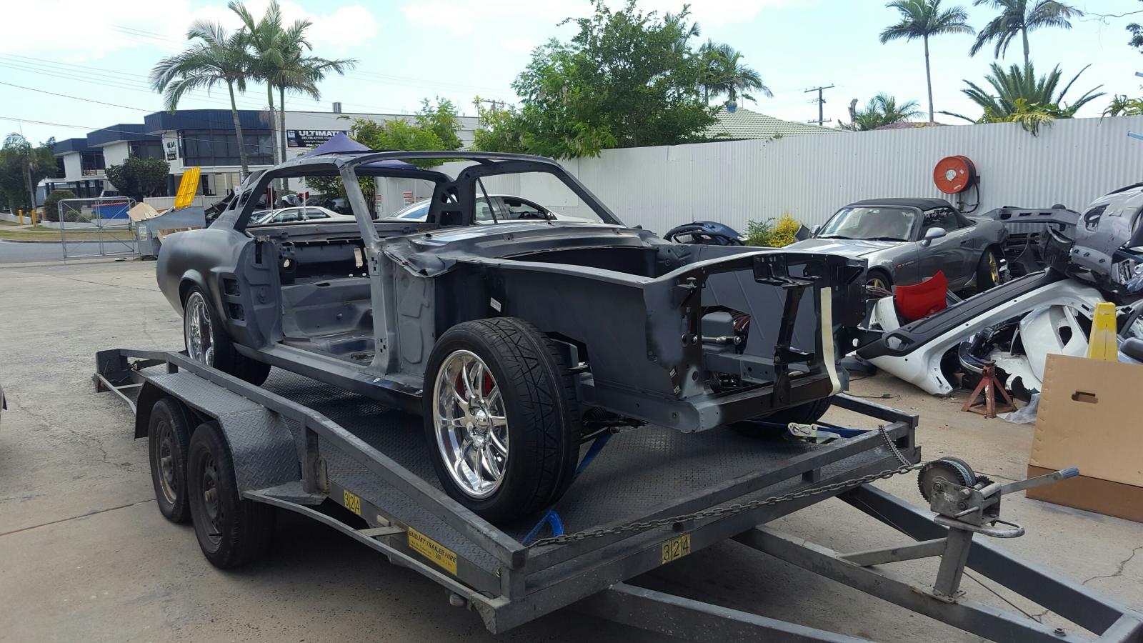

      Ok, Didn't do much today but we did reach a mile stone.
      The car is back on all four wheels. (for a short while anyway!!) Here are a few shots of the first impressions.

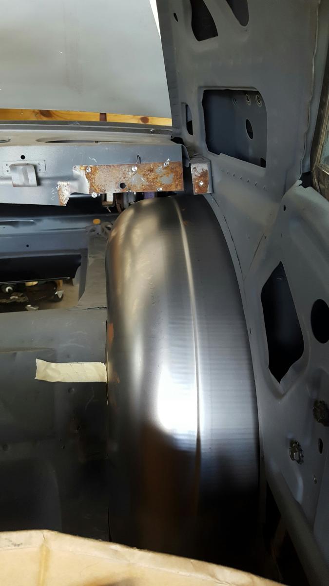

      Rear end shaping up nicely.
      Hoe you have a great Thanksgiving over the last few days and are enjoying my build.

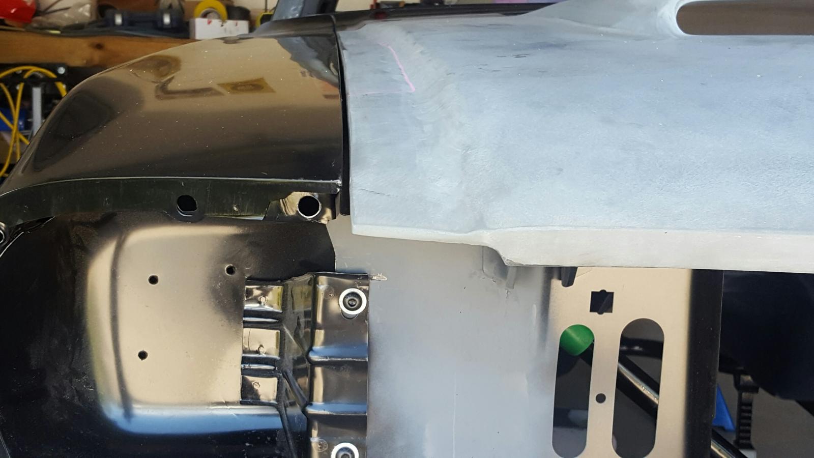

      We are up to getting the bonnet gaps and light buckets to fit. What a joke. I'll show you in pictures.

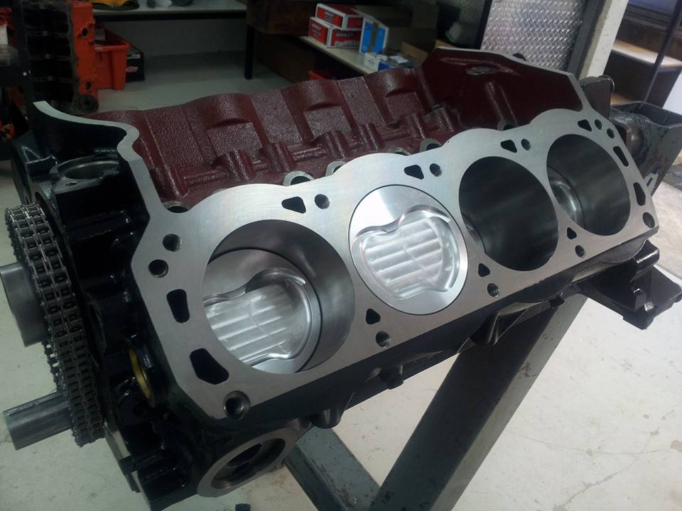

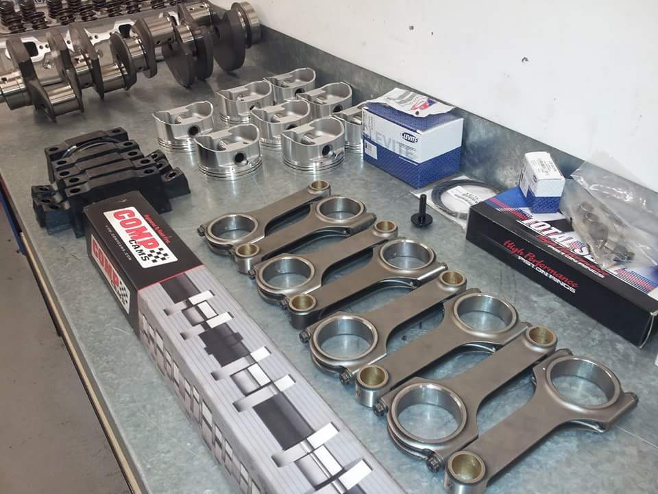

      Engine Build
      For the engine i have gone for a good street build consisting of 351 Dart block stroked to a 427, Internally balanced, 4 bolt mains and H beam rods. Don't know any numbers yet but hoping for a 500 plus hp with as much torque as i can get with nice and mild manners.

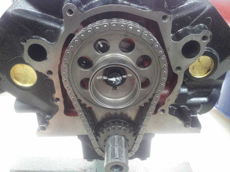

      Engine Build
      Finished putting the Engine together today

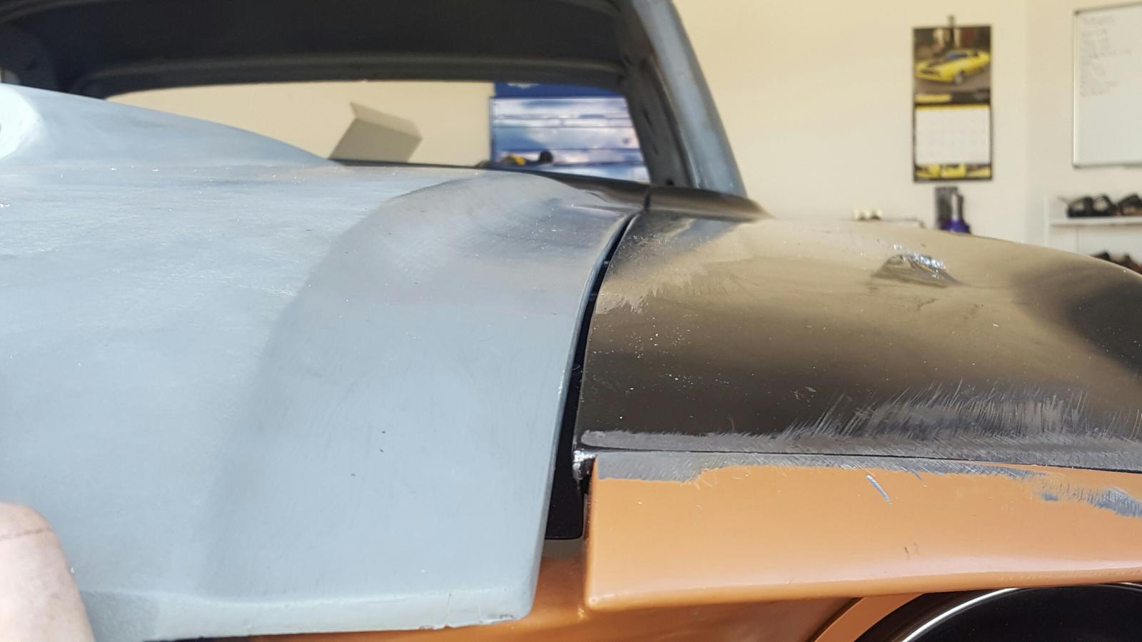

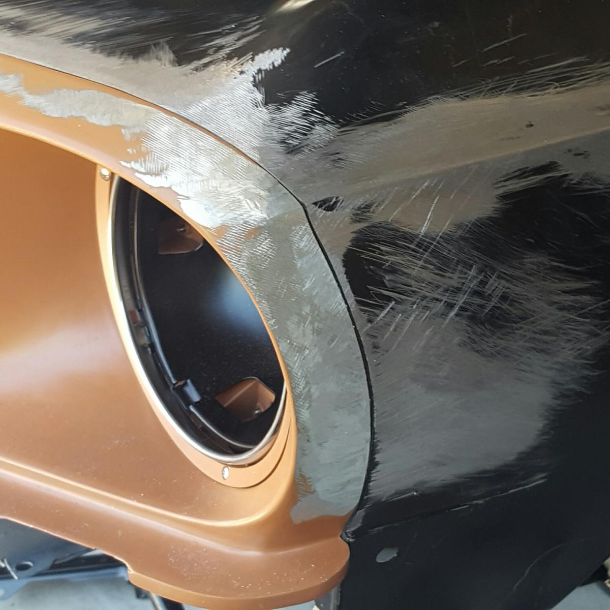

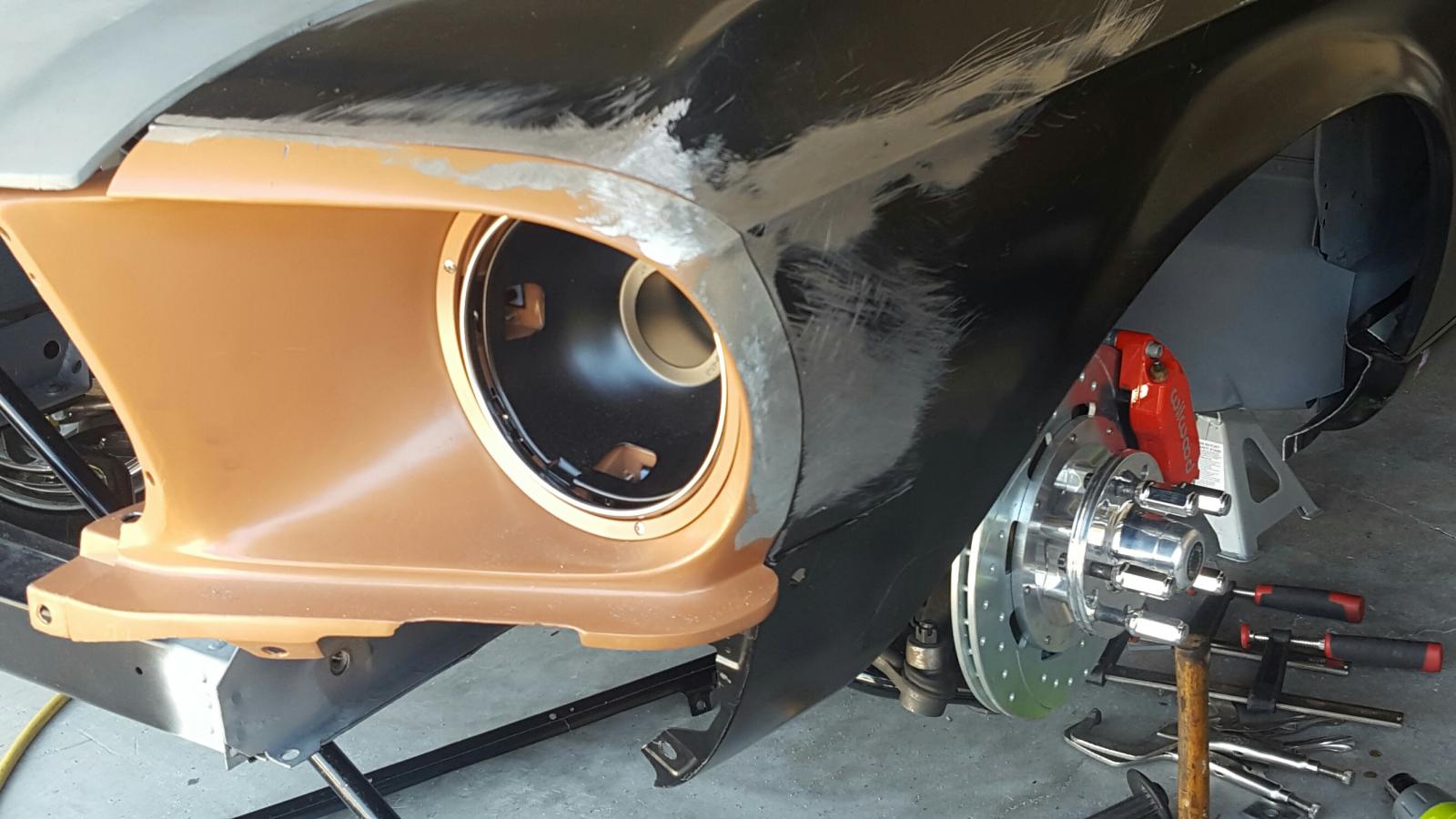

      Back to what i was saying about aftermarket parts. We spent the weekend fitting up the guards and light buckets but as usual they needed lots of TLC. The shape of the guards along with cast shape of the buckets has led to more filing than i can remember along with the need to aluminium weld a piece of the old light bucket onto the new at the bonnet lip to achieve good gaps.
Size:  141.2 KBName:  IMG_20170218_131736_893_resized.jpg
    9. #129
      Jan 2015
      Australia
      285
      Country Flag: Australia
      This is a picture of the amount of material that was short on the new light bucket.
      We have cut a section off the old bucket and shaped it to fit and will then weld it into place. This will give a nice finish without the risk of cracking through the paint.
      The consolation prize is that after all this extra work the gaps are looking really good. The glass bonnet has taken good shape after some heat manipulation and seems to be staying in position even after sitting it in the 40 degrees Queensland sun.

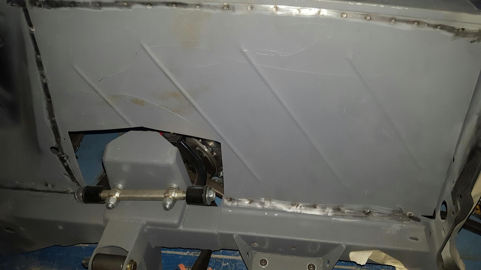

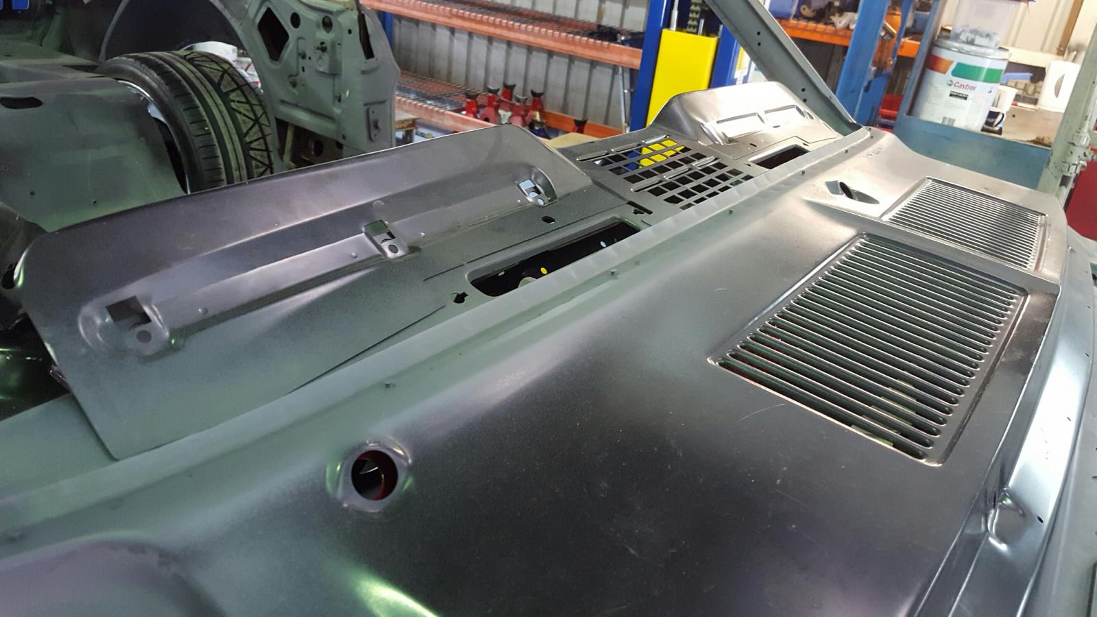

      Took the car into work for the first time last week to finally get rid of the tack welds and screws holding it together.
      Couldn't believe how much different the car felt after getting the panels fully spot welded together.Name:  20170225_105303_resized.jpg

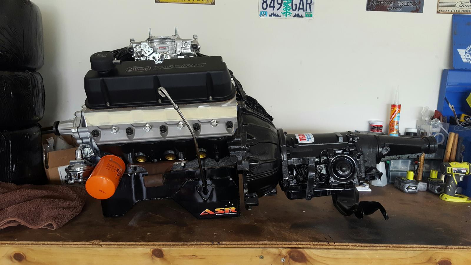

      Engine and Transmission come together.
      Just a quick shot of my engine and transmission back together for a short while.
      C4 with a stage 2 shift kit, hardened shafts, Kevlar bands from Northside Transmissions mated to my 427 Windsor from Fataz Competition Engines

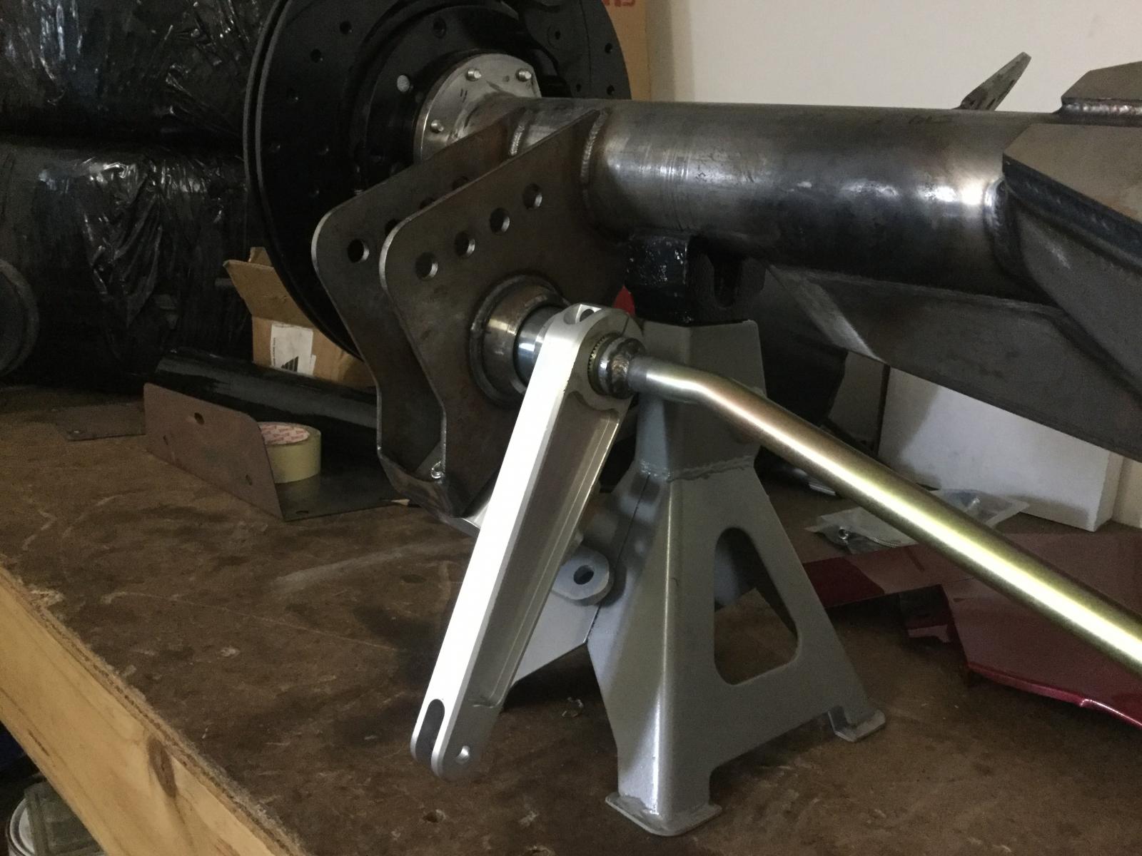

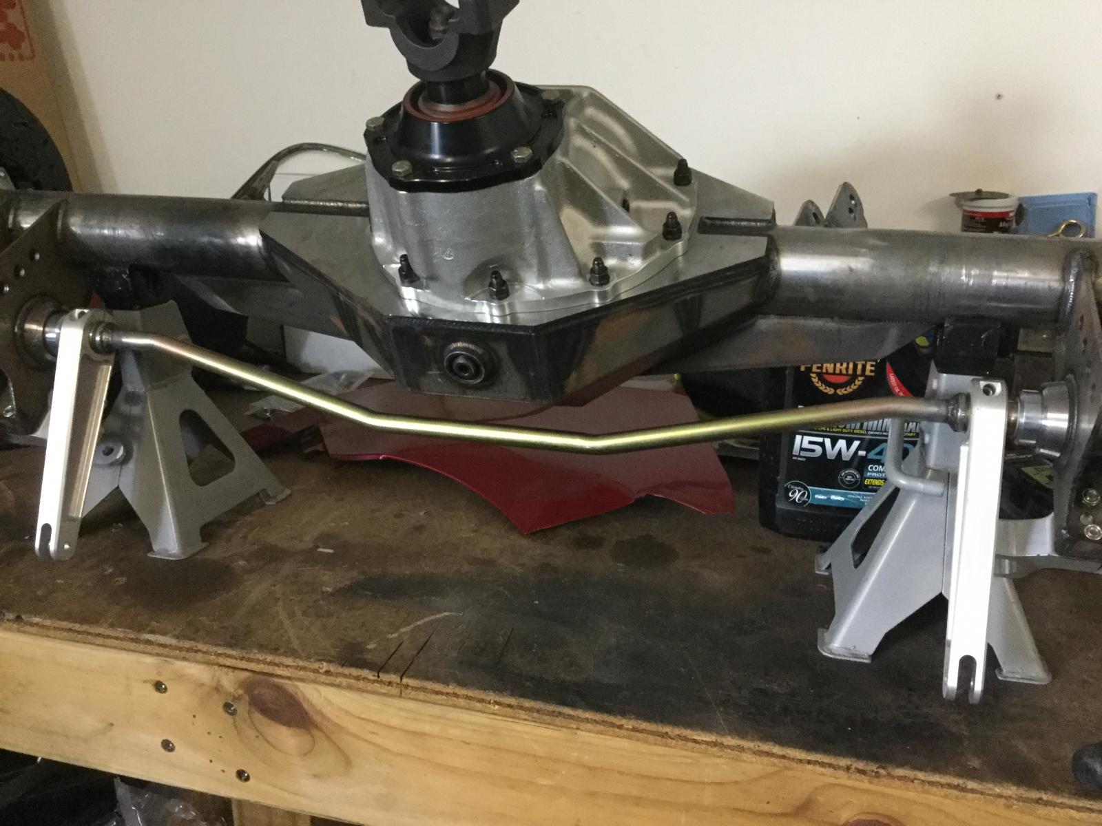

Size:  178.2 KBHad to shorten the Sway bar after my measuring mistake of the shock mounts.
      I didn't take into account the correct backspace on my wheels when I went up to 10 inch rims so the mount had to come in 1.5 inch each side. But after shortening the sway bar we are back on track
