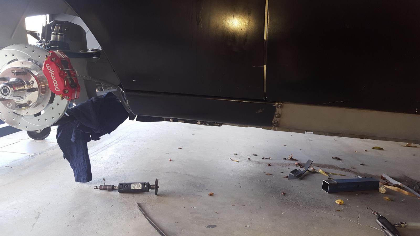

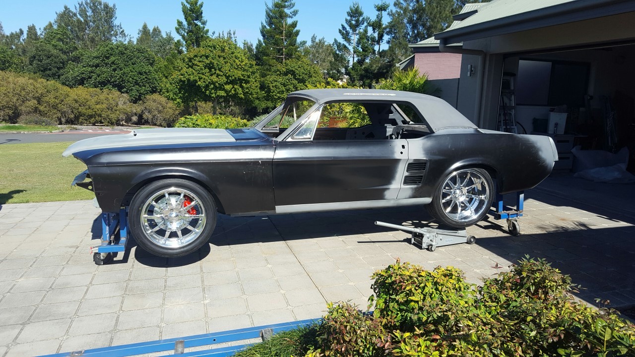

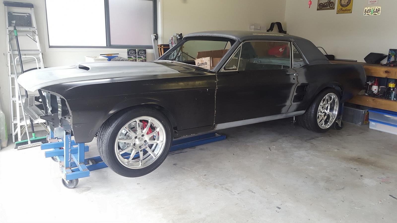

      We've had a busy weekend and made a little progress. Woody wasn't happy with how the bottom of the Fender finished up last weekend so he decided to re bend it to tighten up the bottom gap and add some stick welding rod to the front and rear of the doors to enable him to file a nice finished gap.
      So far it seems to be doing the trick.
      The lines are coming together and our gaps are looking a lot neater. Considering where we started with the aftermarket panel sizes and shape we are really pleased with how it shaping up.

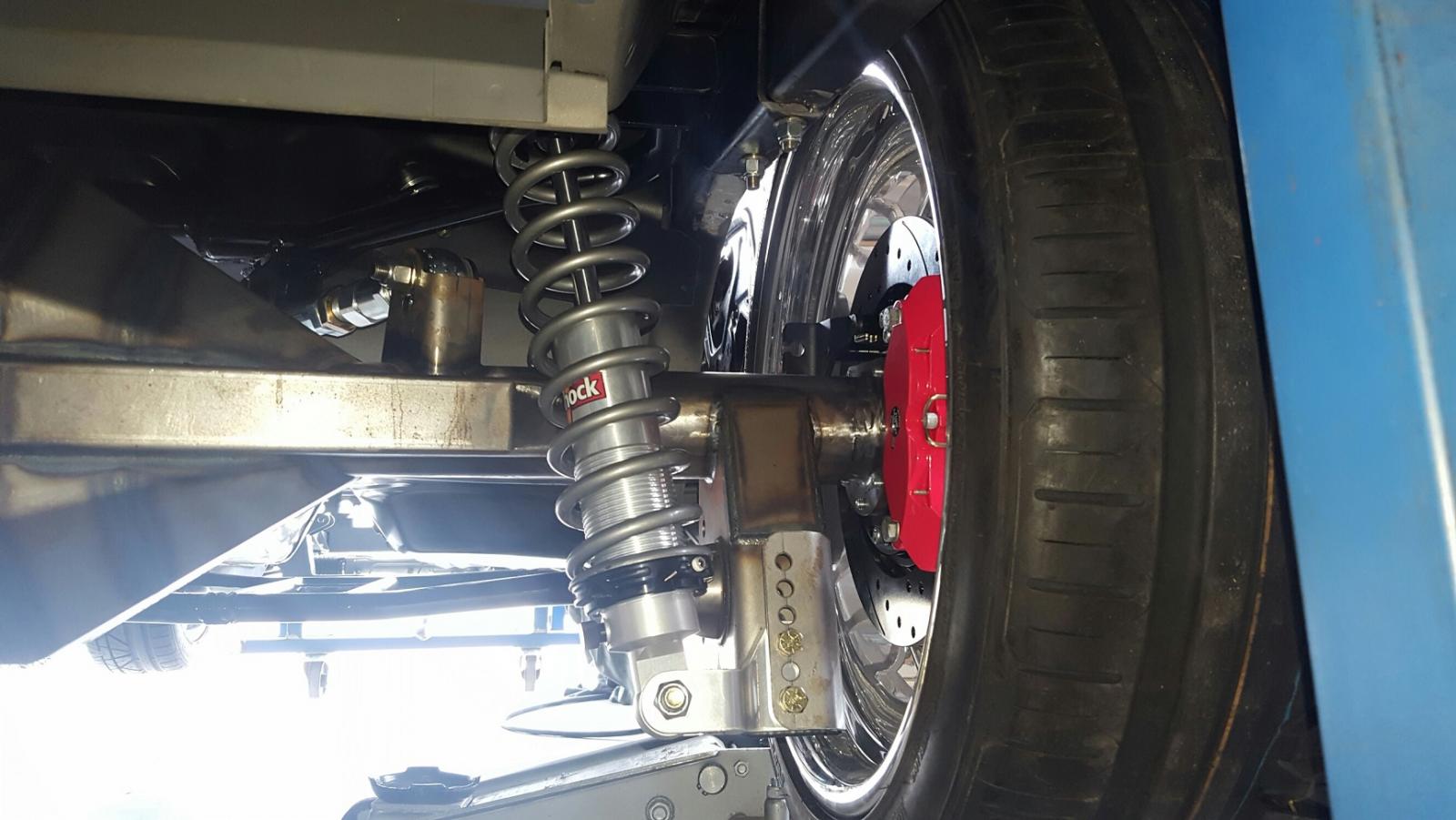

      The rear axle housing turned up during the week so that gave me a job to do while Woody was plying his trade to the bodywork.

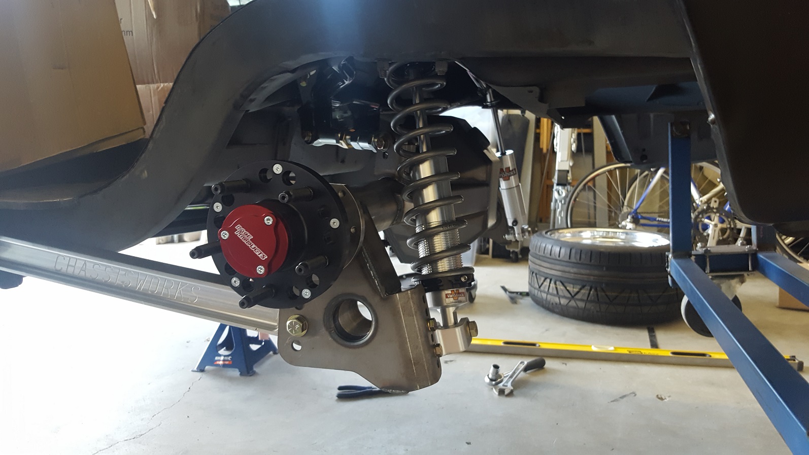

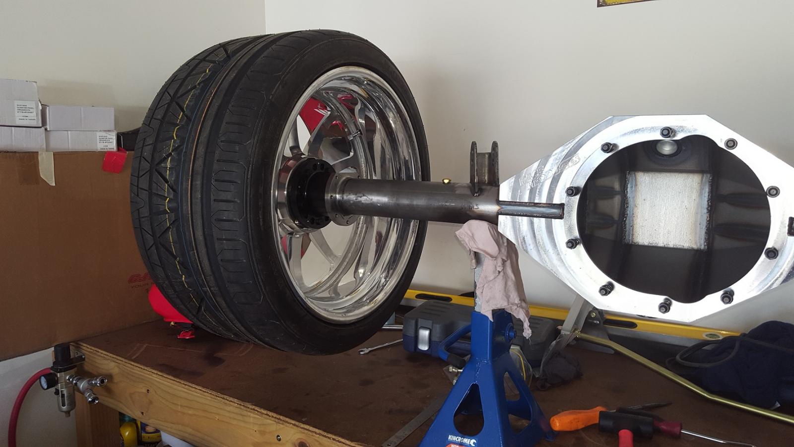

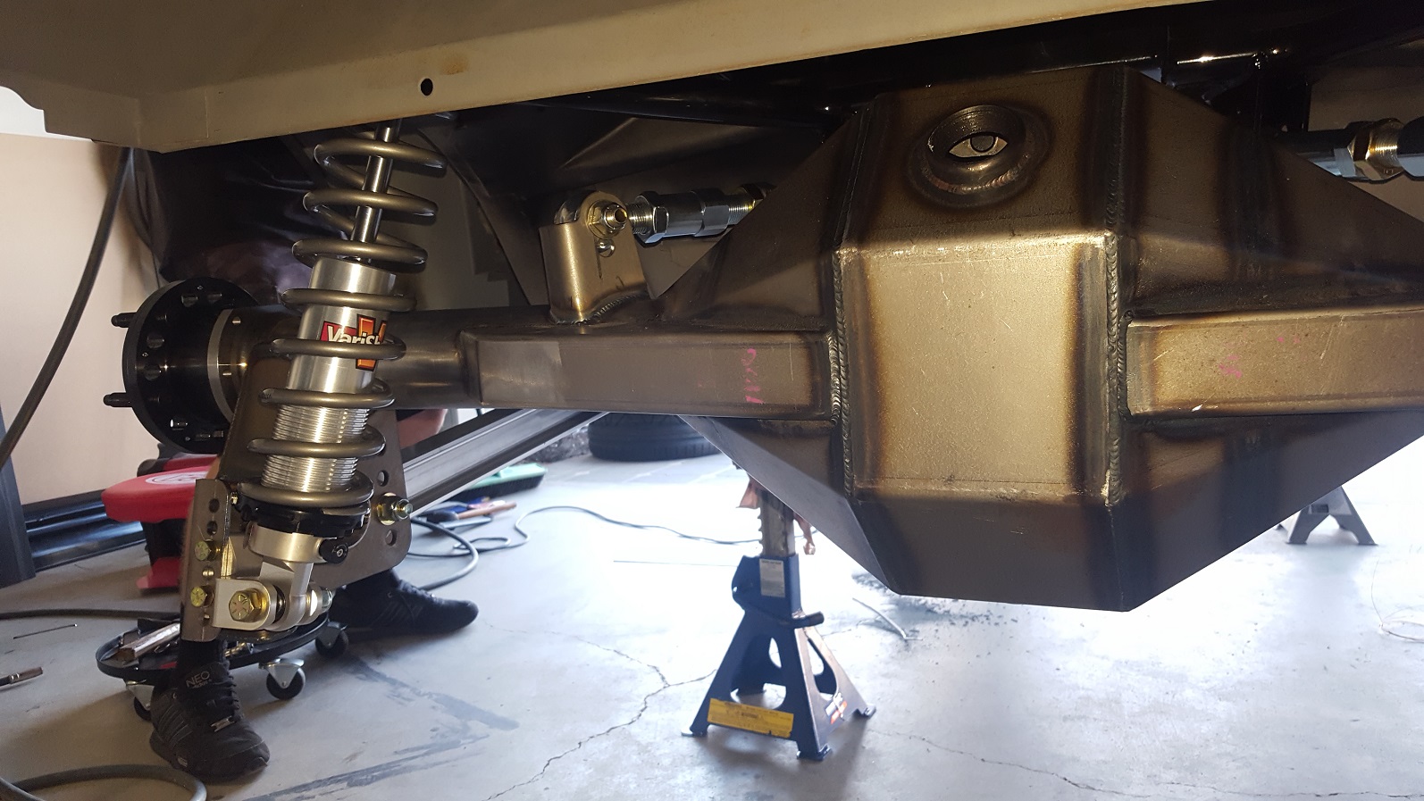

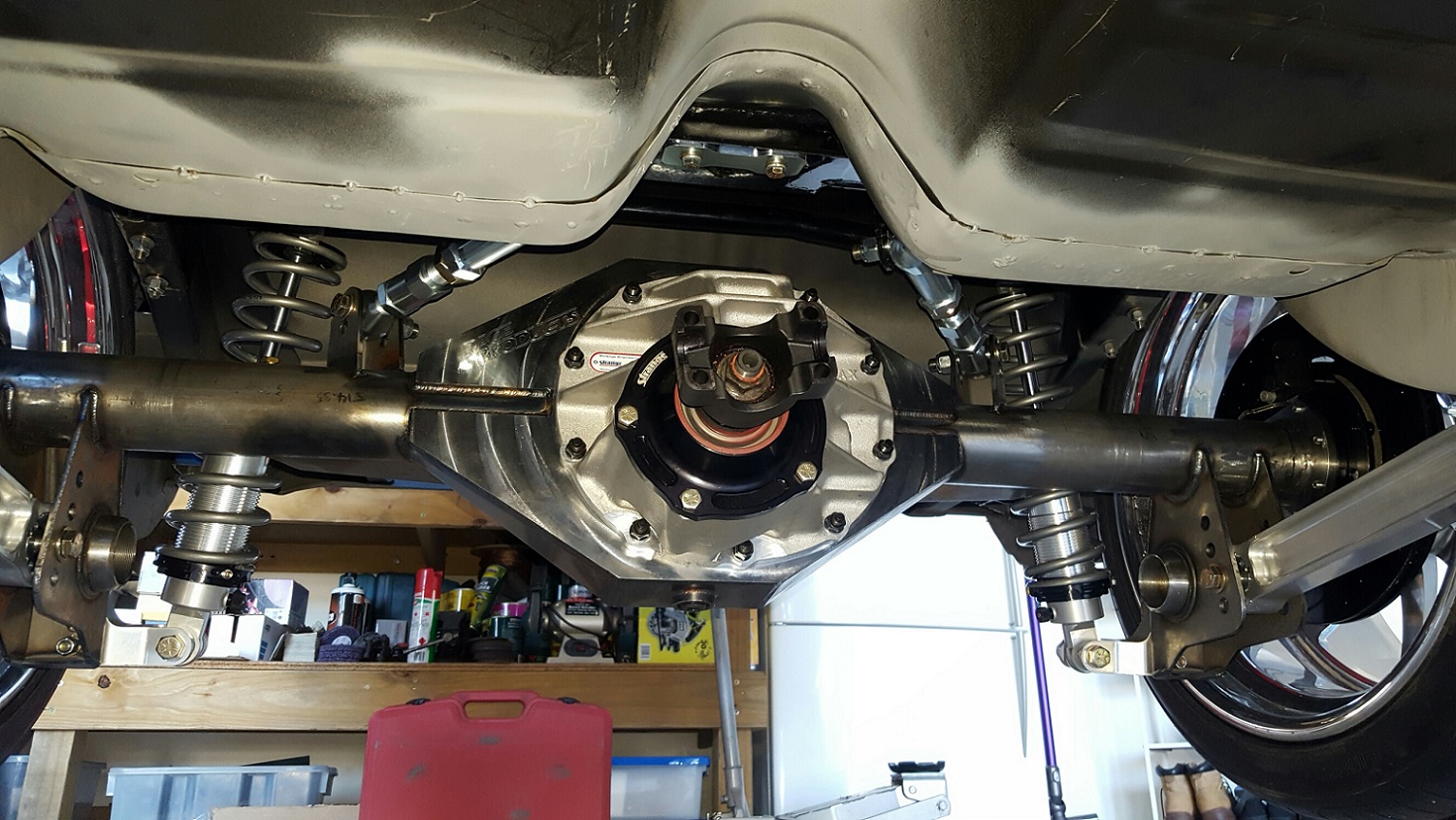

      I planned on fitting up the rear axle to check all the clearances and get the car sat on the ground to look at the ride height and stance. (without engine.)
      All went well until i fitted the wheels onto the back. The lower control arm rubs the 305 size tire. Looks like i miscalculated the wheel back space or the axle length by about 7/16 inch.
      Total control Products do do an off set pivot to give a little more tire clearance but i'm not sure it will be enough. I may have to get the mounting brackets removed from the axle and re welded further in. If the brackets don't come off then i'll have to get some new ones from Total Control. Expensive rookie mistake!!!!
      Lower fender gap coming along

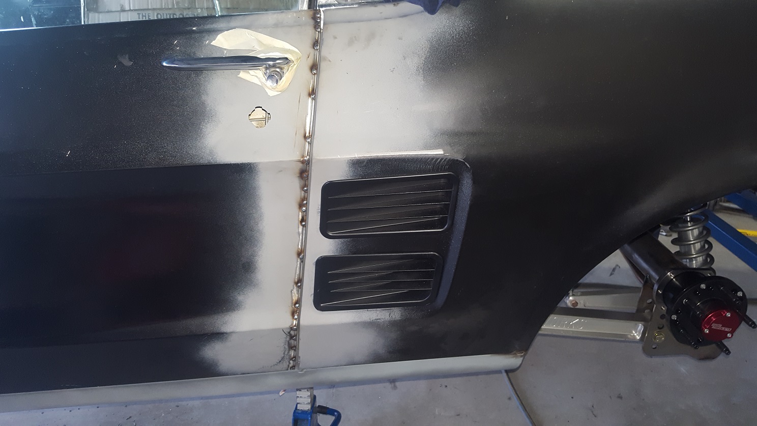

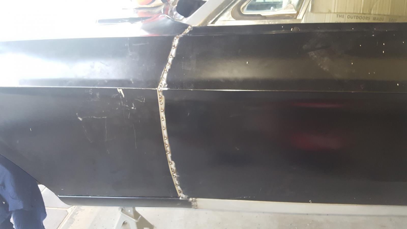

      Skick Rod welded to the door edges to enable a nicely file gap.

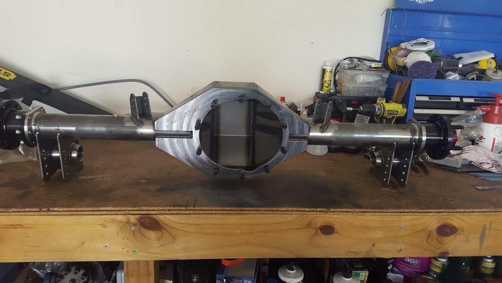

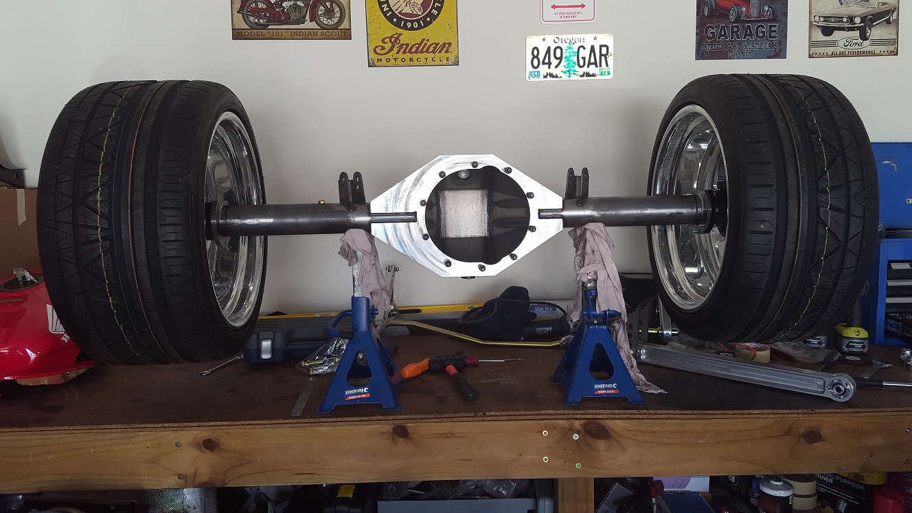

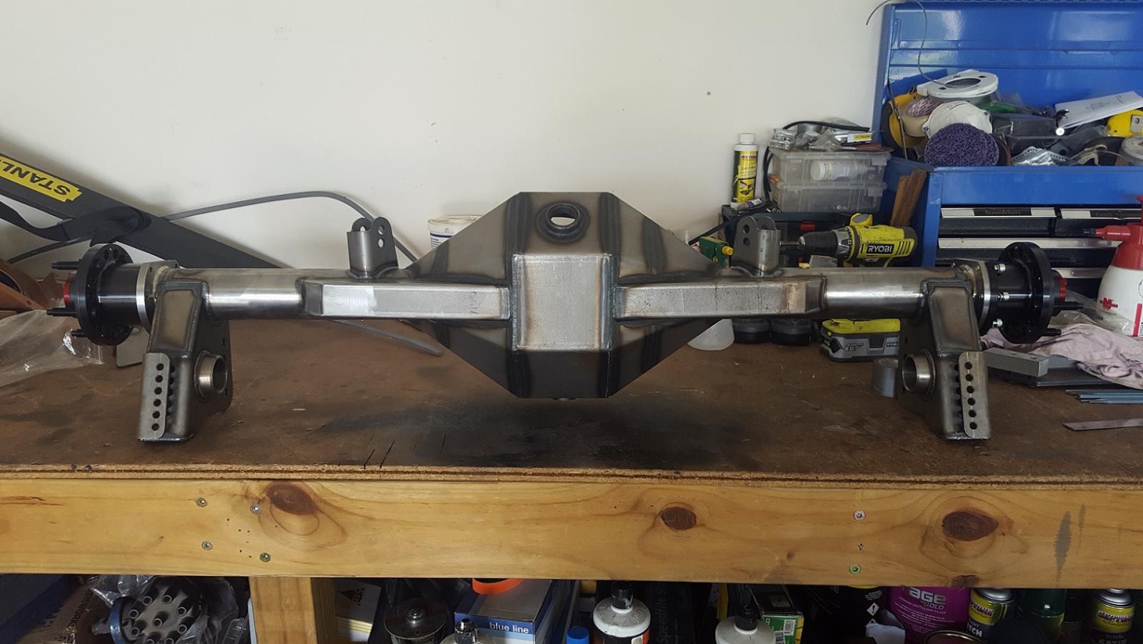

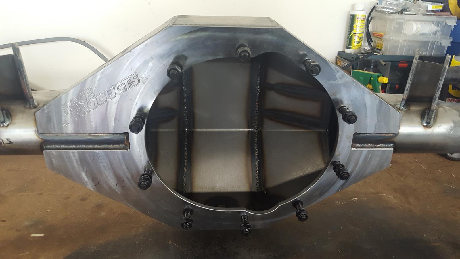

      Fully floating Axle and Diff housing from Race Products in Brisbane.

      Suspension in place. Pity about the tire rub but i'll sort it out soon.

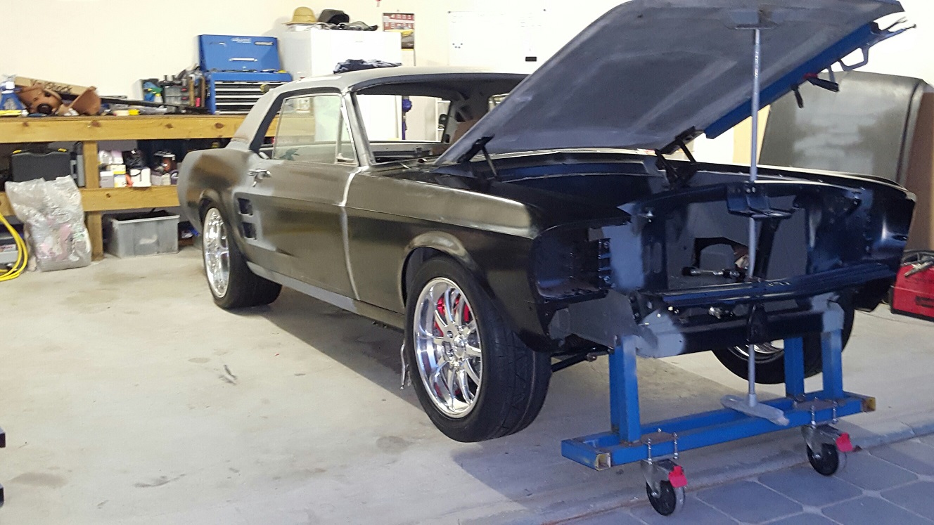

      Looking good.

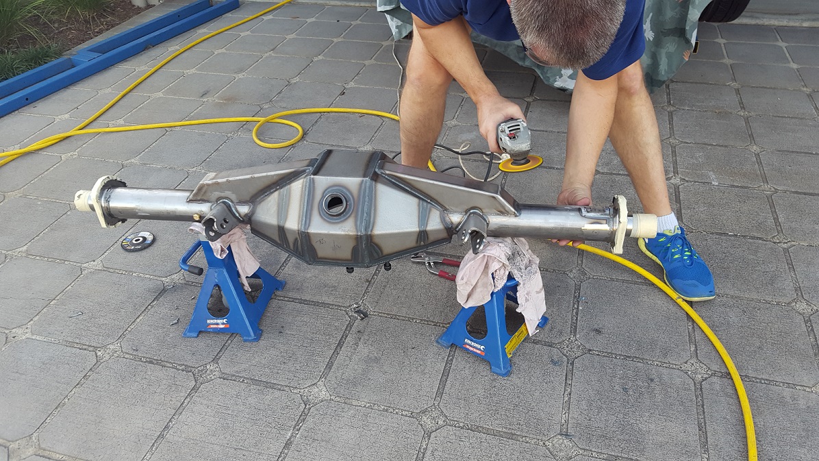

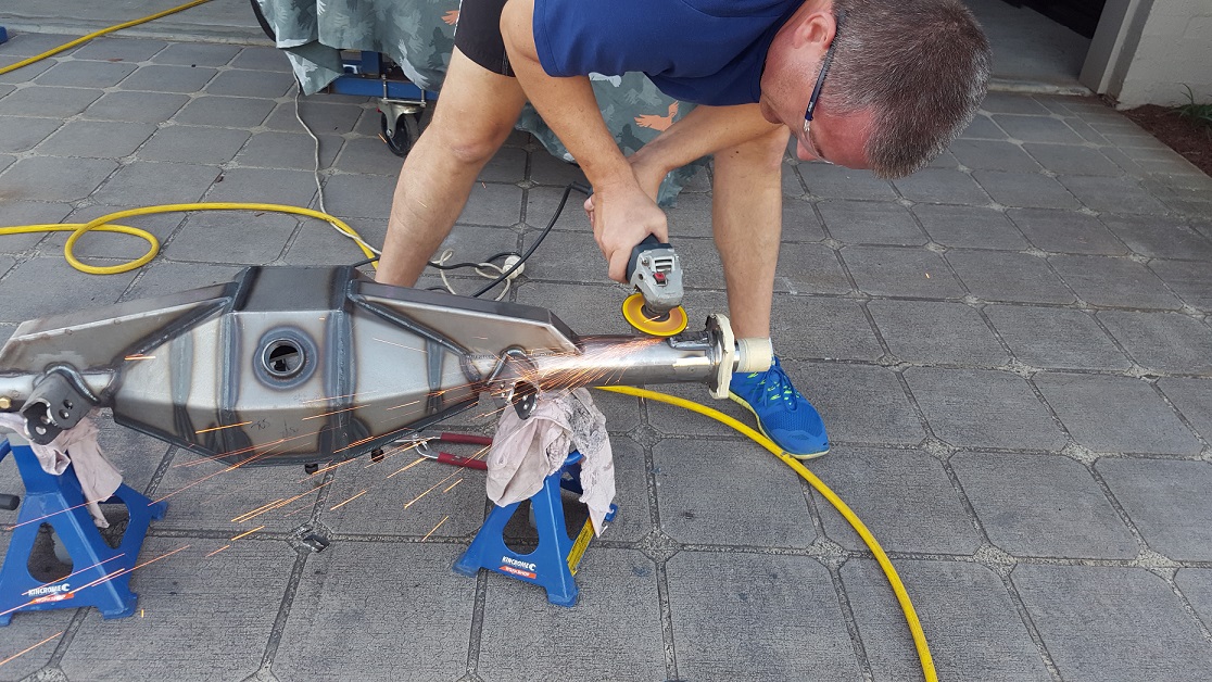

      This weekend saw the rear axle housing removed from the car to fix the mistake of the incorrect position of the lower control arm and shock mounts. The mistake was purely mine and i have no one else to blame, but i did try!!!.
      I changed my mind on the wheel width from 9' to 10' but forgot to alter the backspacing accordingly. The only real way to fix it was to order new brackets and cut the old ones off.
      Licve and learn with a $600 Aussie dollar mistake.

      Managed to get the new lower control arm brackets from Chassis worksName:  20161119_090920_resized.jpg
Size:  344.5 KBName:  20161119_090927_resized.jpg
Size:  350.6 KBName:  20161119_115413_resized.jpg
Size:  321.2 KBName:  20161119_115426_resized.jpg
Size:  134.1 KBName:  20161119_165200_resized.jpg

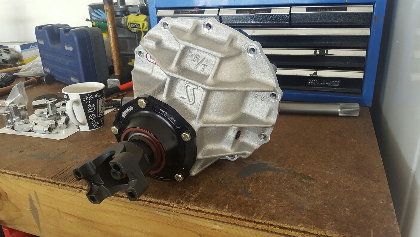

Size:  387.6 KB and had them re-welded into the correct position. The diff center and rear brakes also arrived and the whole package was assembled and put into it's rightful place. The rear of the car has been removed from the wheel dolly for the first time in nearly two years to see how she will sit.

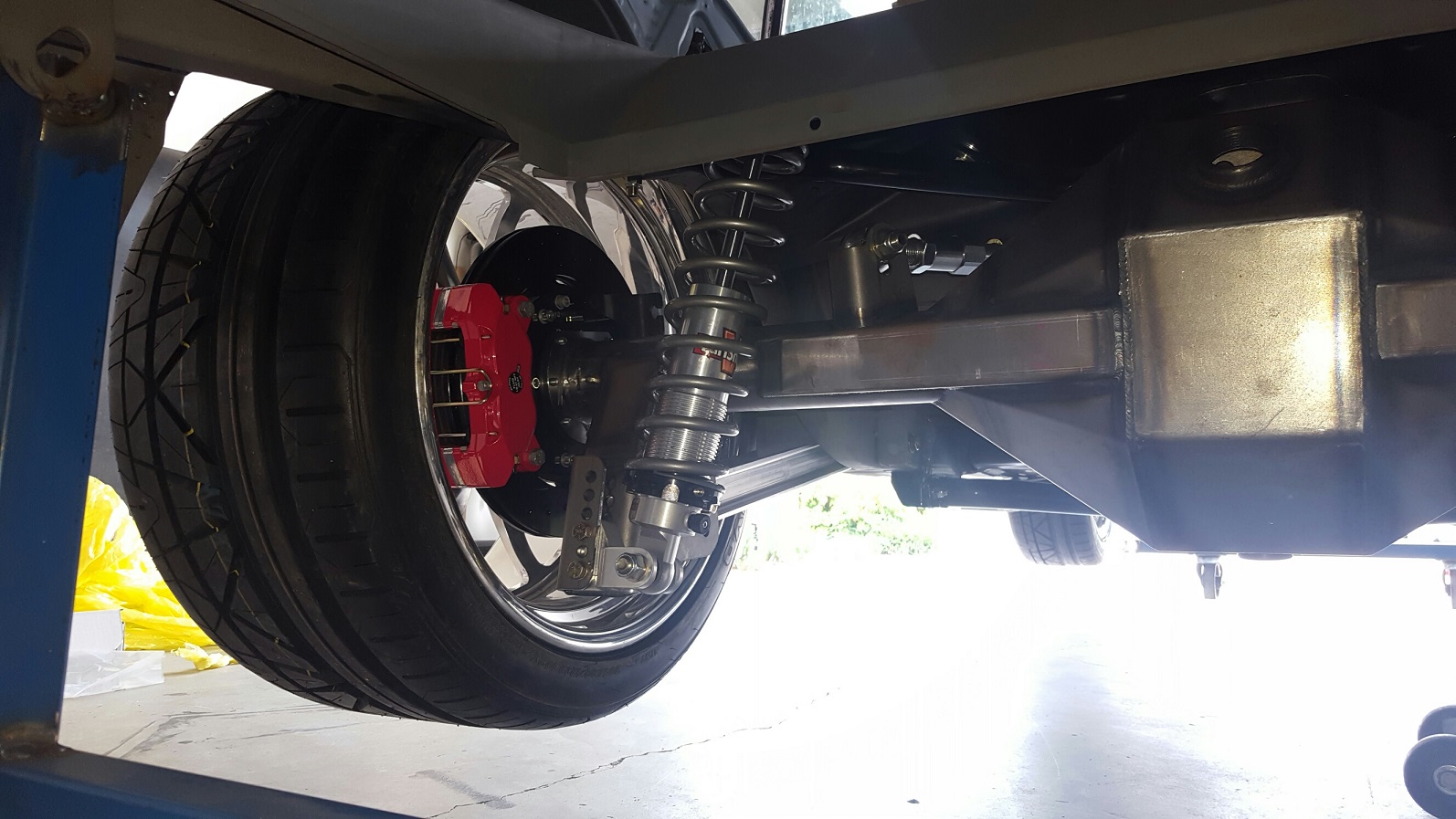

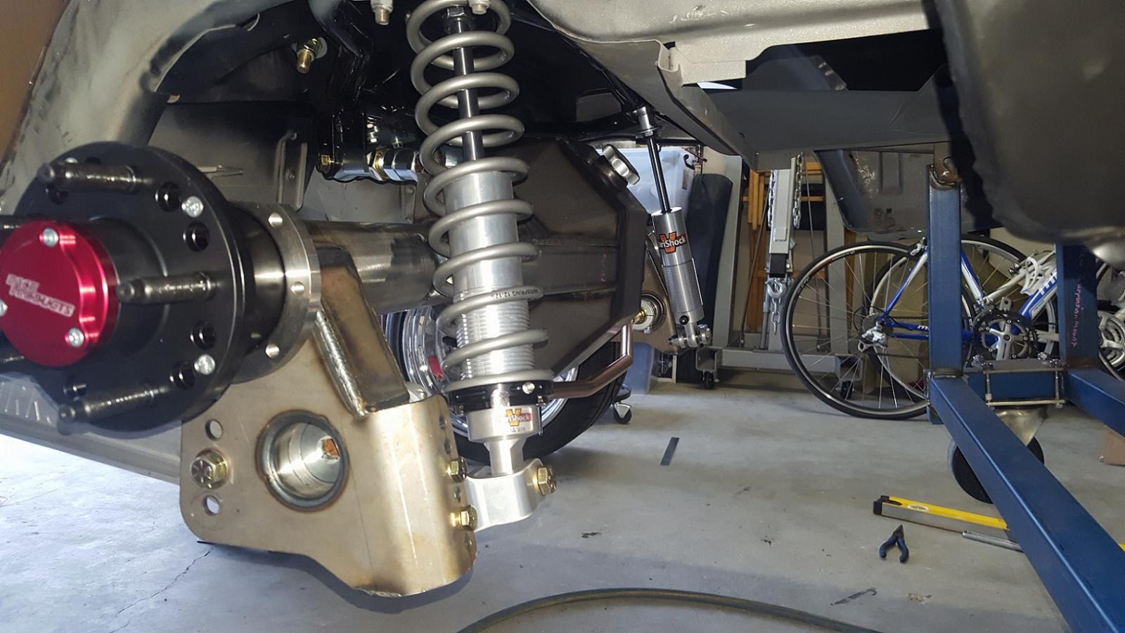

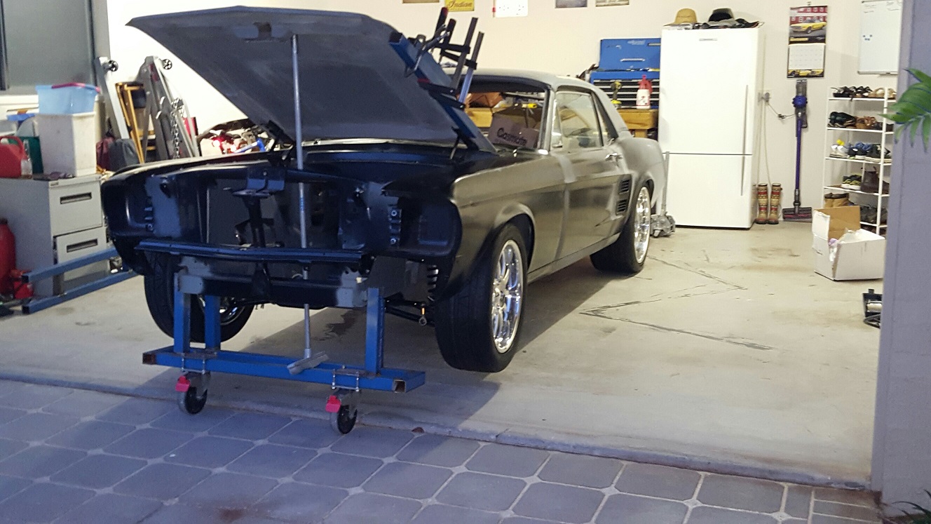

      Sitting on the floor for the first time in years
Size:  367.2 KBName:  20161119_124631_resized.jpg
      Really like the way the car sits at the rear. Once we have finished my aim is to set and align the car to run at this height or as near as depending on how it handles.
      The guys at ChassisWorks supply a top quality product and are super helpful in the time of rookie mistakes. Thanks heaps guys.

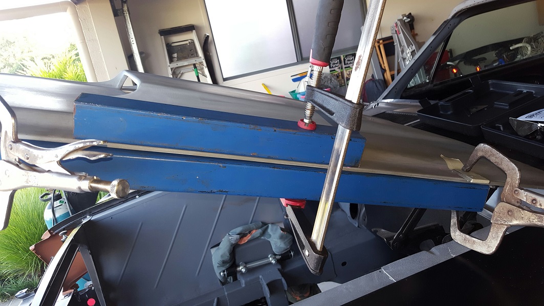

      We have also spent time with the body work and its coming along nicely. The front fenders are now aligned and will only require minor beating prior to the car being epoxy primed.

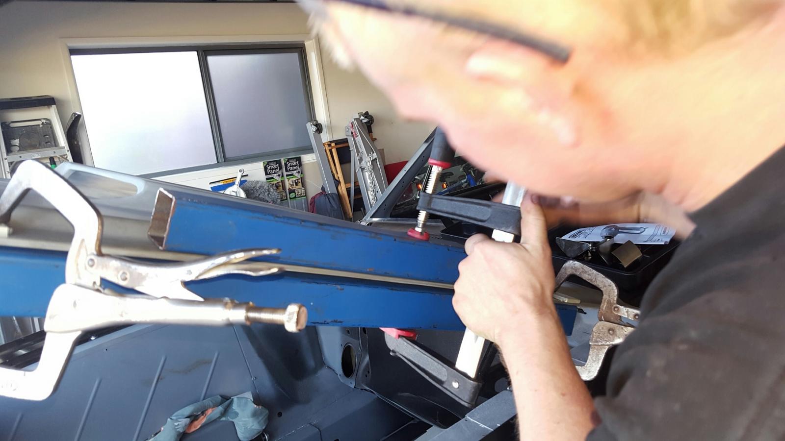

      The glass bonnet / hood was in a terrible mess and i must admit for the price of this product i am more than a little disappointed in the quality and final shape. I know some of you out there will say all glass parts are like that but at the price point it was at i expected better.\
      We did a little research and tried out a few thing and it is starting to come together. Applying heat and flexing the glass gently we seem to be able to get the glass to become playable enabling us to reshape it enough to start getting lines and gaps. With a few more hours work and blocking i think it will work out.
      At the start of the weekend i was all for ditching the glass hood and getting a steel one but i was persuaded to give it another go.

      Hot Sandwich Press Theory
