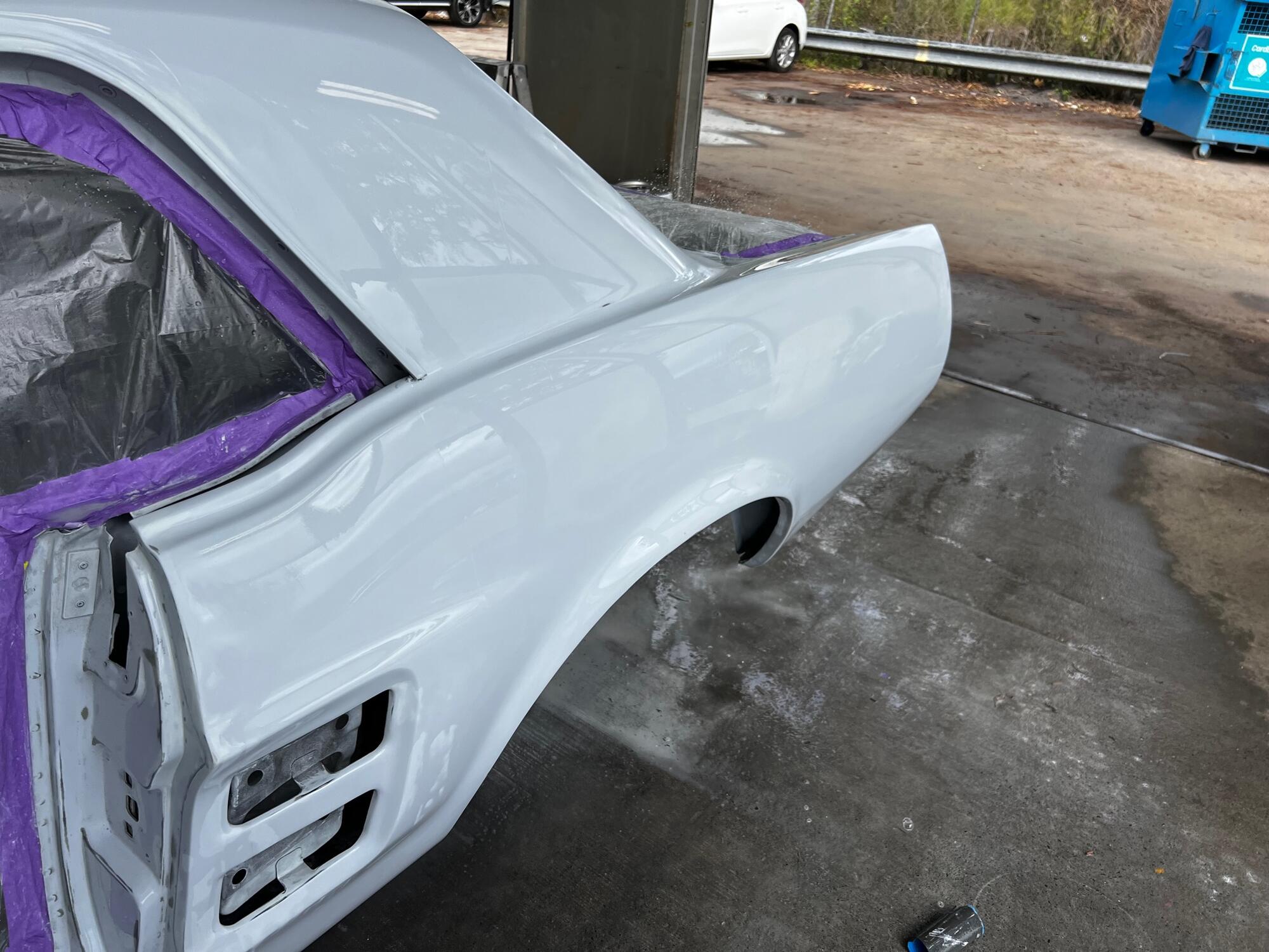

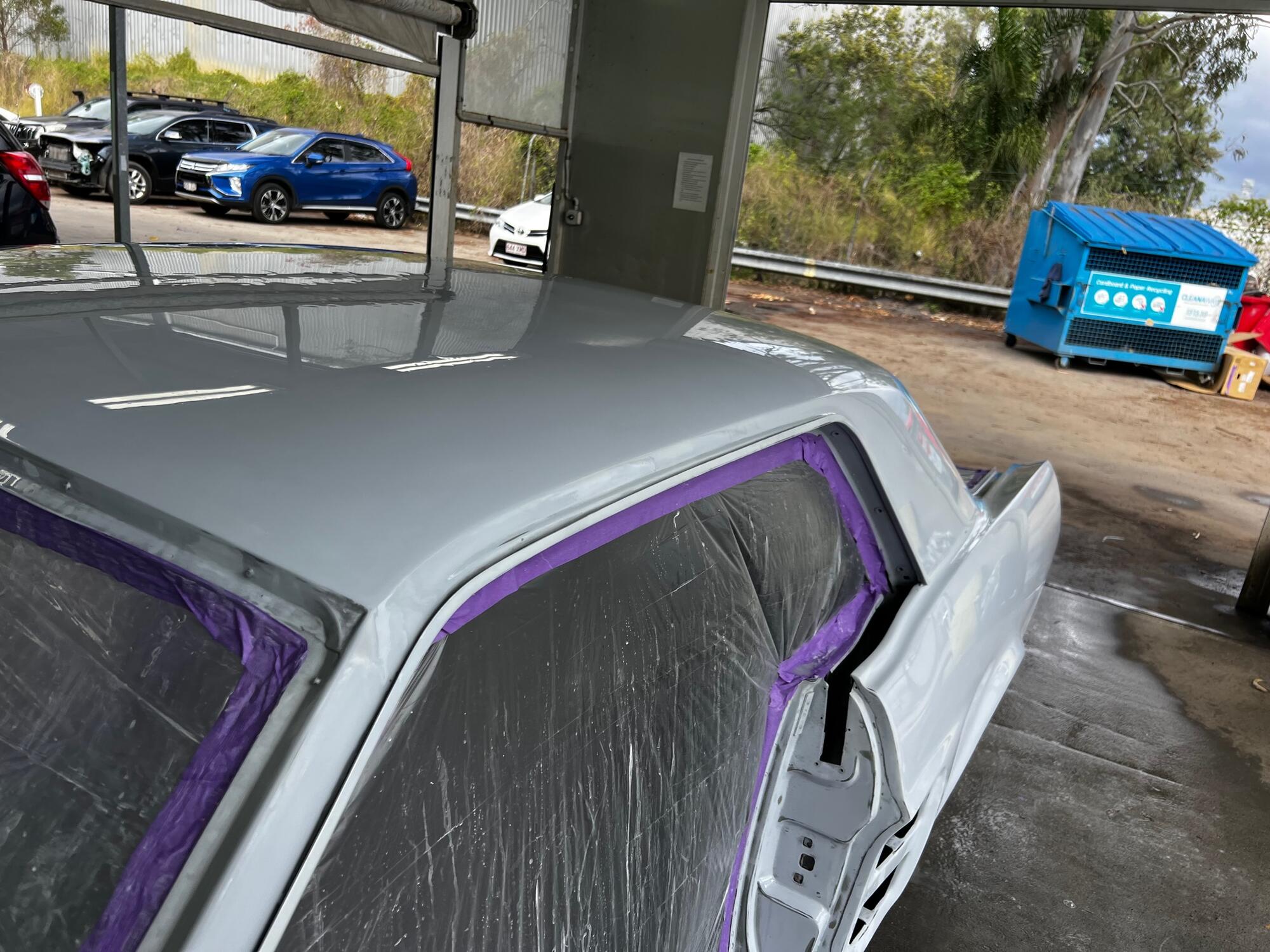

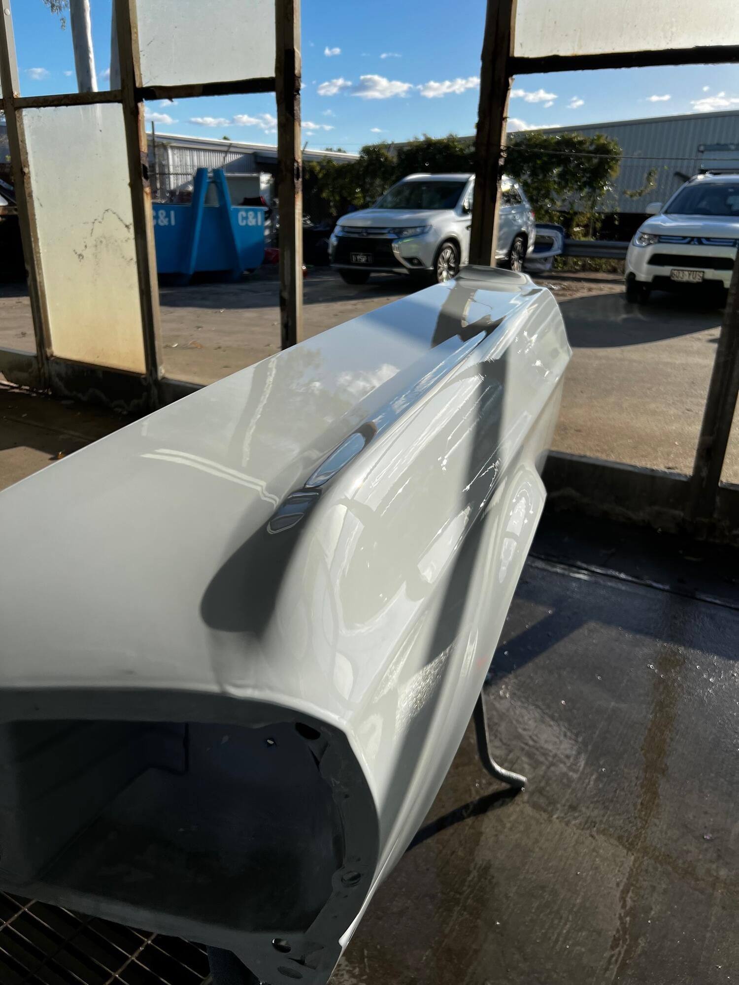

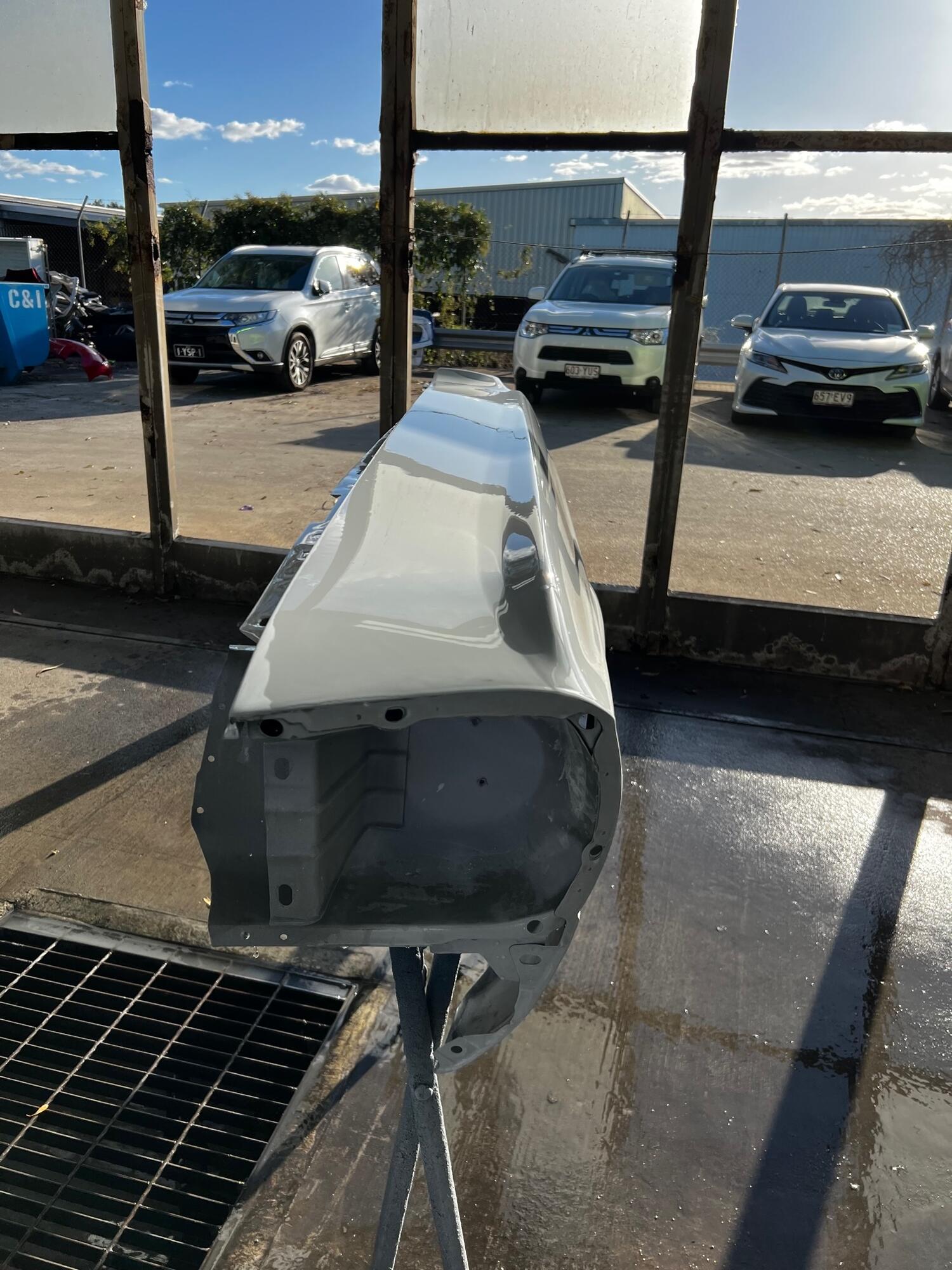

      Day 8 of blocking
      Unbelievable difference between 500g dry and 800g wet rub
      Paint 6 days and counting

      Day 12 of blocking and finally ready for paint. Looking excellent after a final wet rub with 800g wet and dry

      Look good, can't wait to see it painted.
      Blocking is not the funniest part on a project, you've done all of it by hand?
    4. #284
      Jan 2015
      Australia
      285
      Country Flag: Australia
      All done by hand. 240g, 320g, 500g followed by an 800g wet rub.
      love the feel of it after. Minimal cut through but my arms and body was sore.
      start painting Saturday🥳

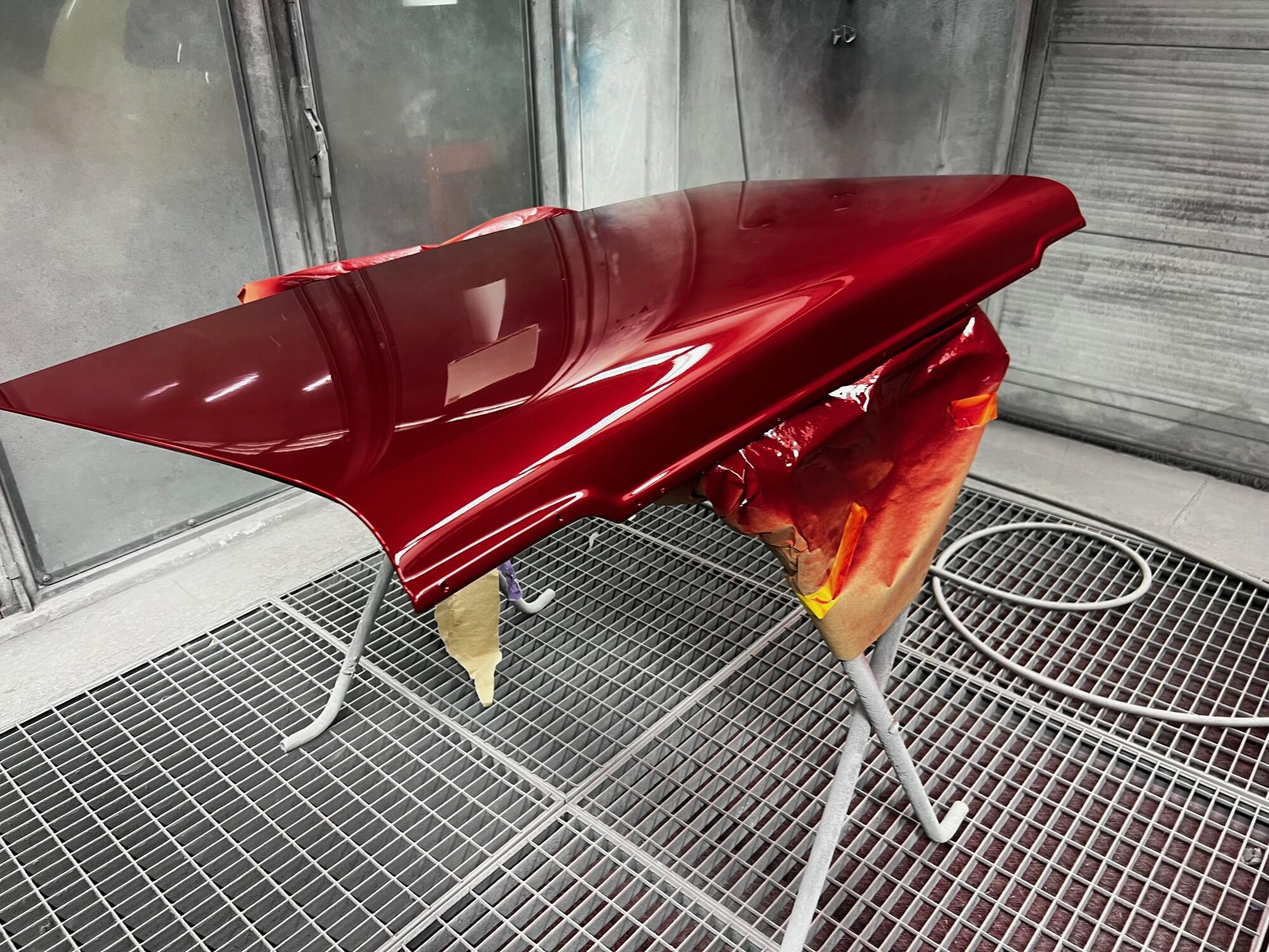

    5. #285
      Jan 2015
      Australia
      285
Size:  161.4 KBName:  IMG_2314.jpeg
Size:  182.5 KBName:  IMG_2313.jpeg
Size:  185.6 KBName:  IMG_2322.jpeg

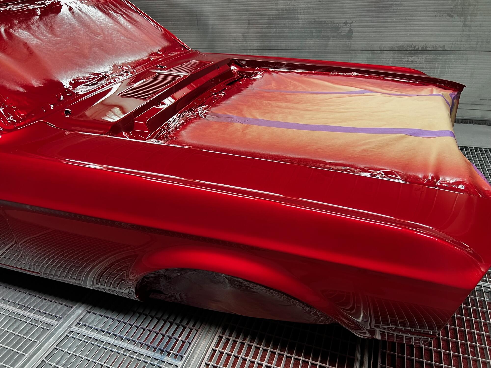

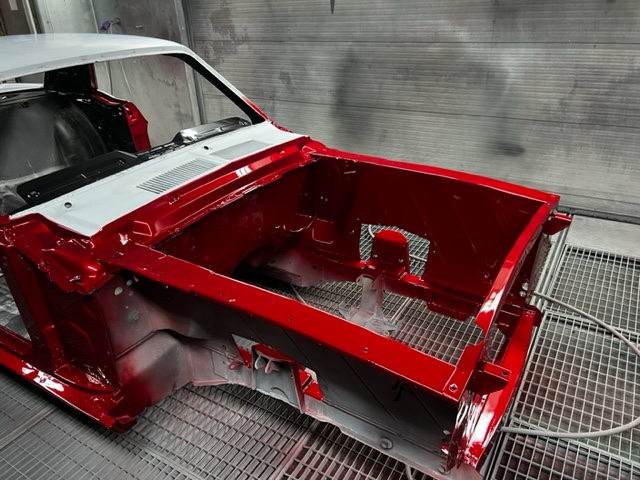

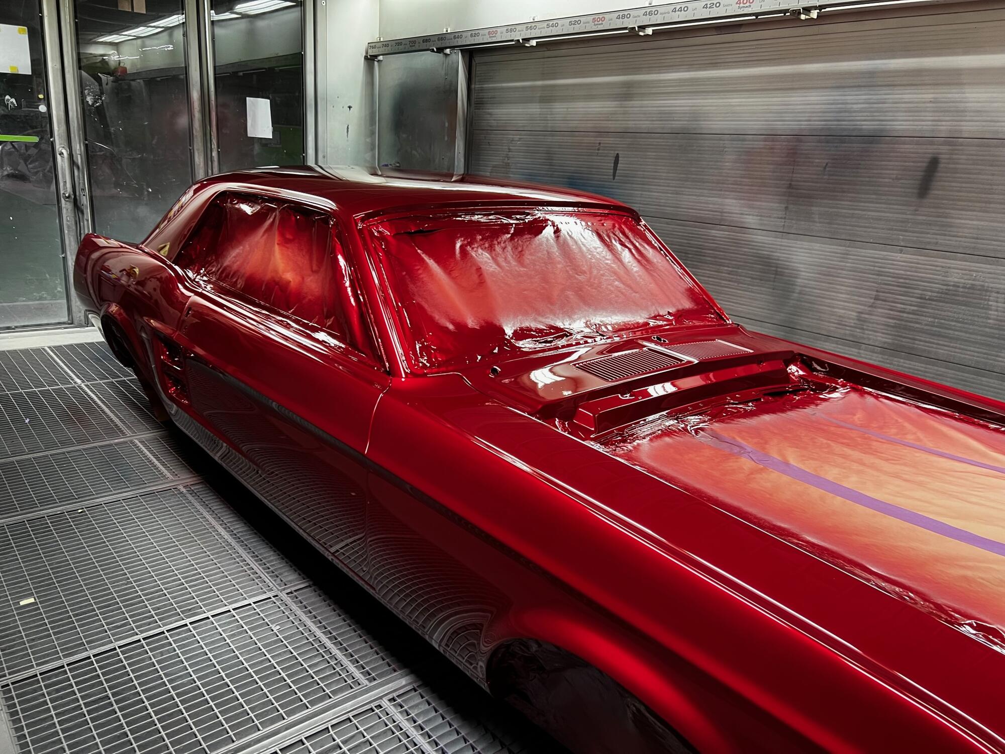

      Candy going on
    6. #286
      Nov 2009
      the dirty mitten
      1,217
      Color looks really nice!! How many coats is that and what is the name of the paint?
      Steve
    7. #287
      Jan 2015
      Australia
      285

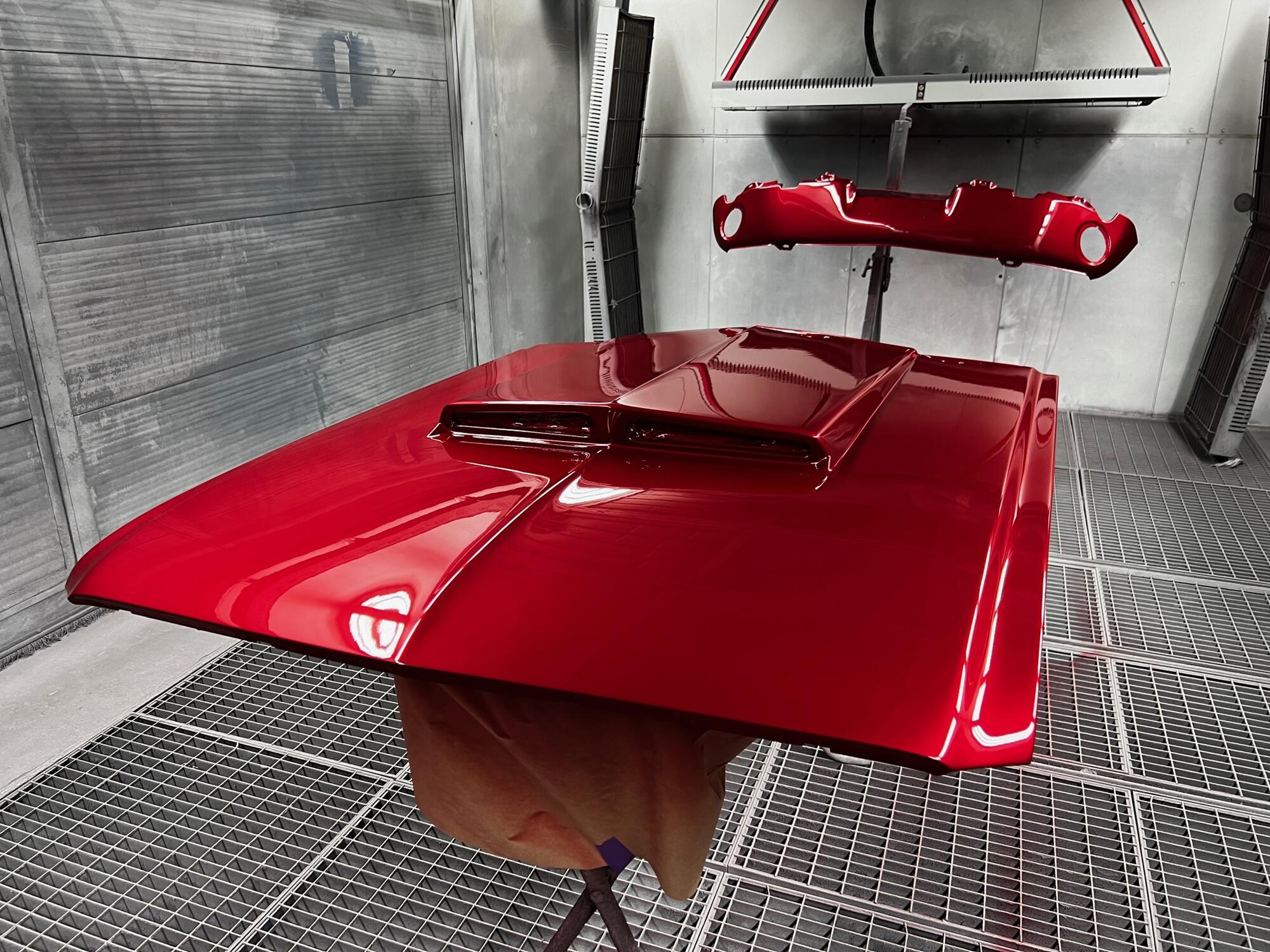

      Hi.
      Thats 3 coats. The doors, guards, bonnet and boot will go on then it will get painted all over. It’s going to sit for a week or two after that to dry out. Then it will be flattened of with 1200”1500 grit and flow coated.
      The colour is Lucid Red Pearl. Paint is Glassurite 90 line

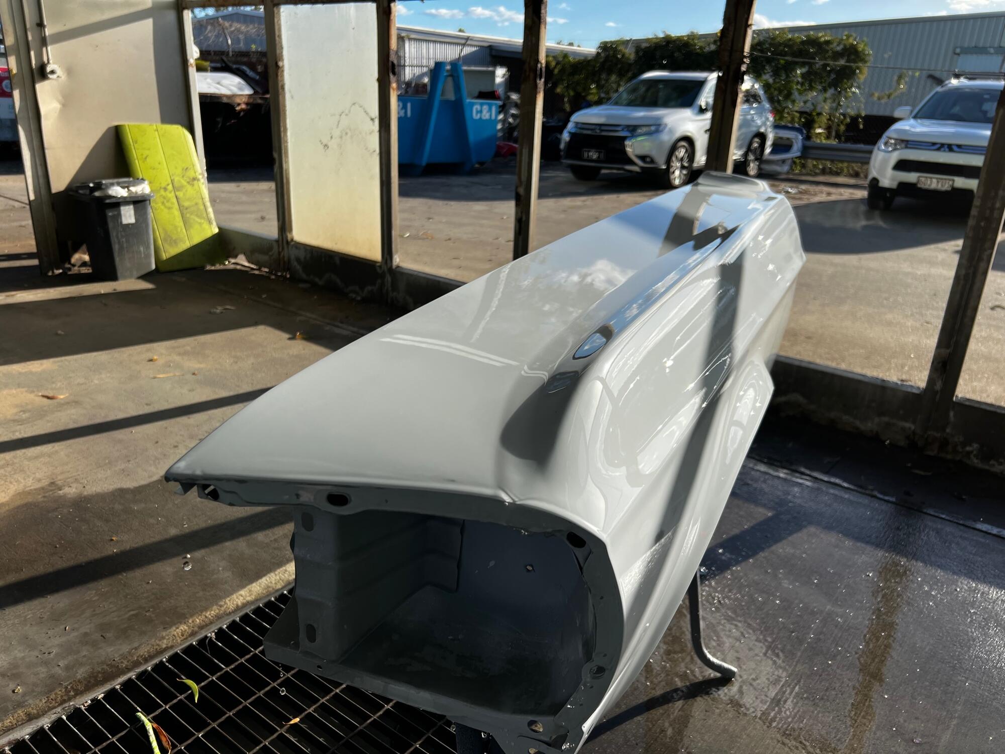

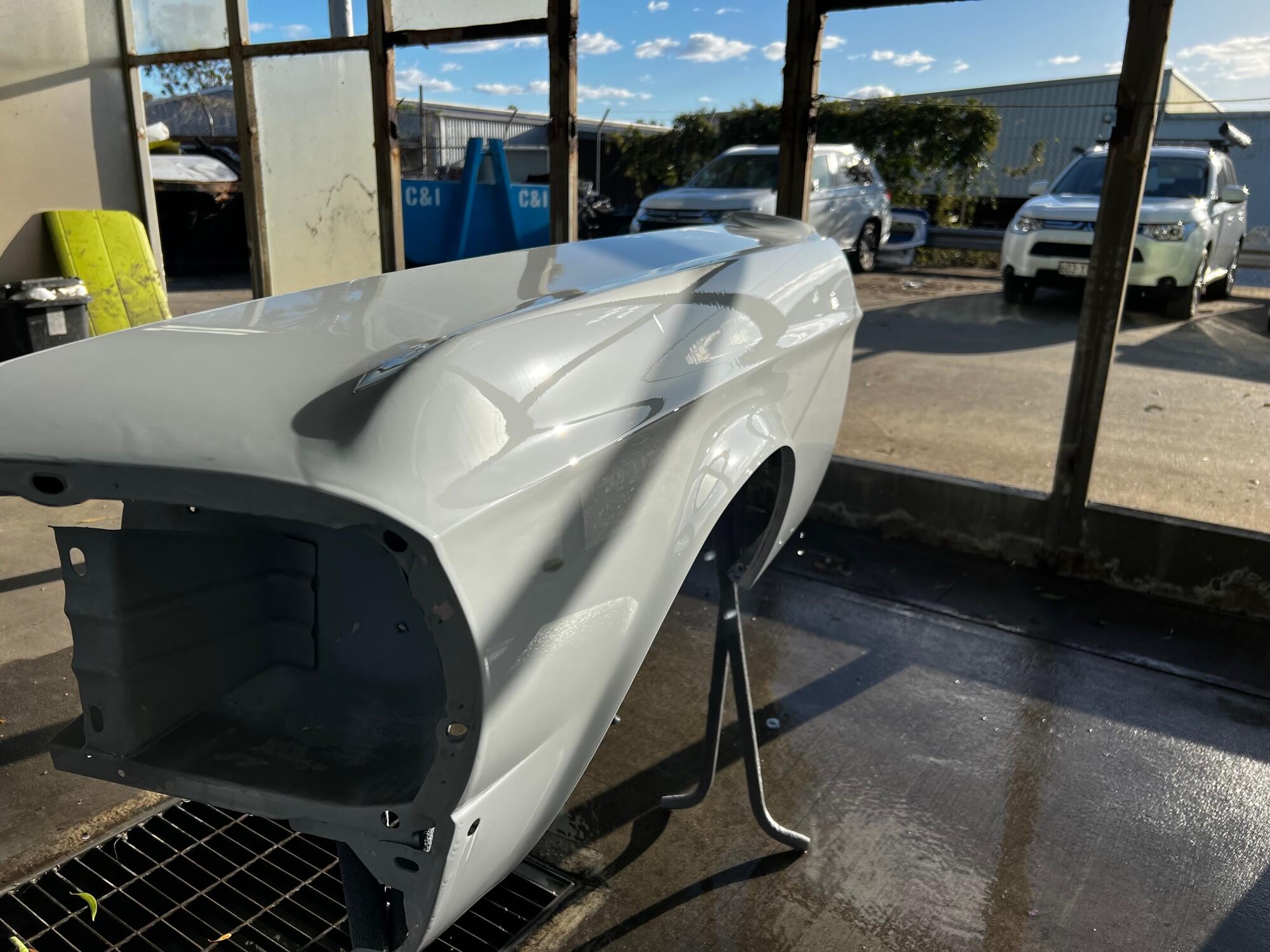

    10. #290
      Jan 2015
      Australia
      285

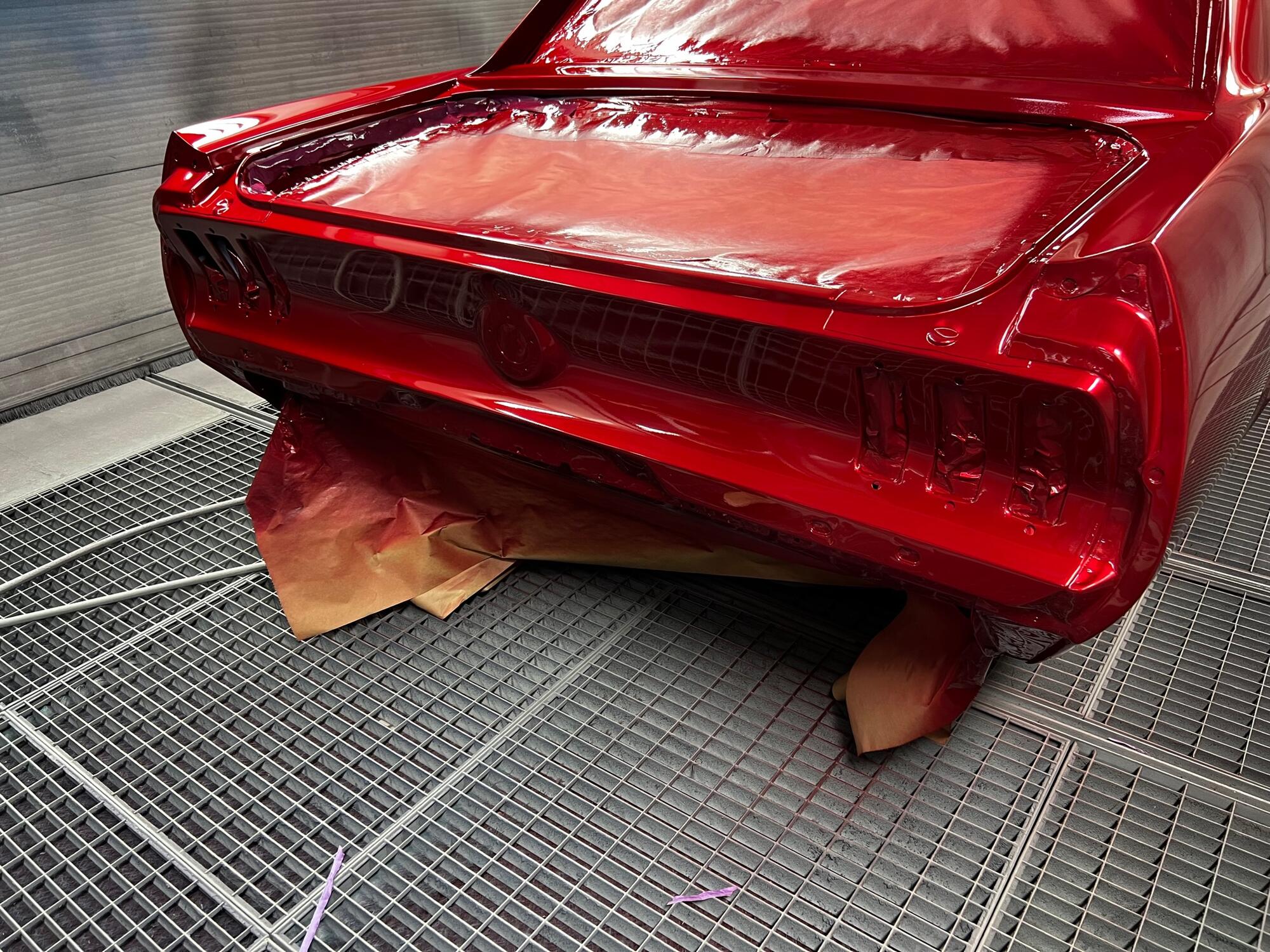

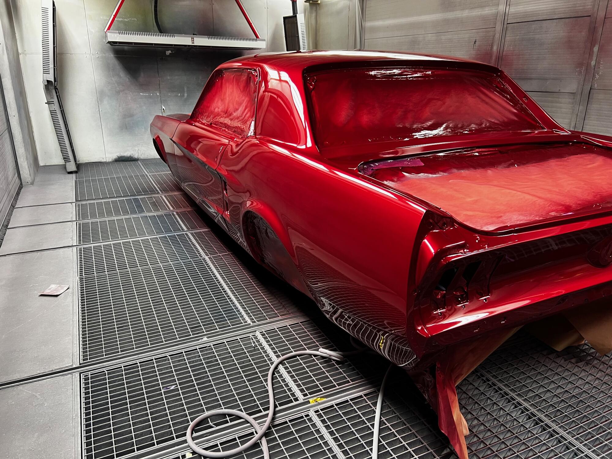

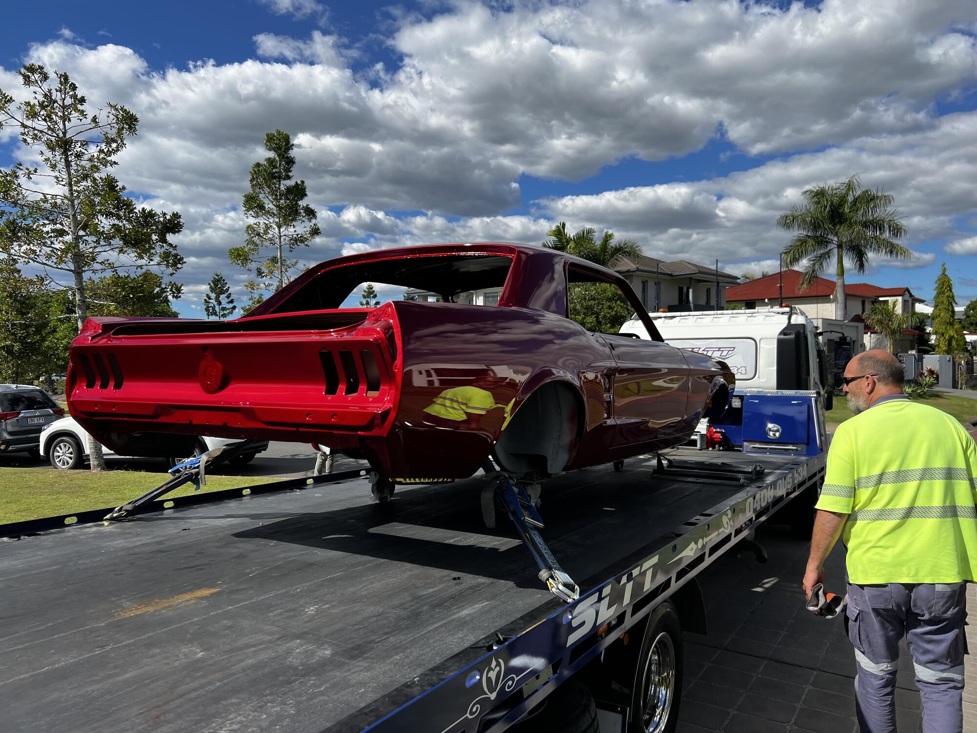

      Finally painted
Size:  498.0 KBName:  IMG_2370.jpg
Size:  484.8 KBName:  IMG_2369.jpg
Size:  574.8 KBName:  IMG_2368.jpg

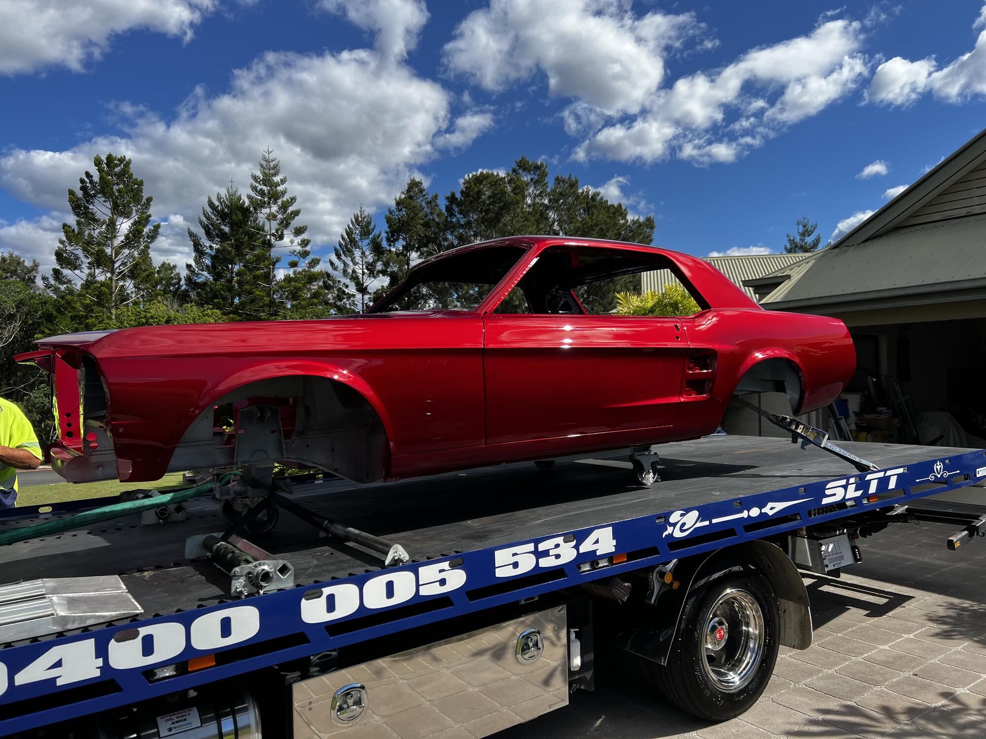

      And this happened today

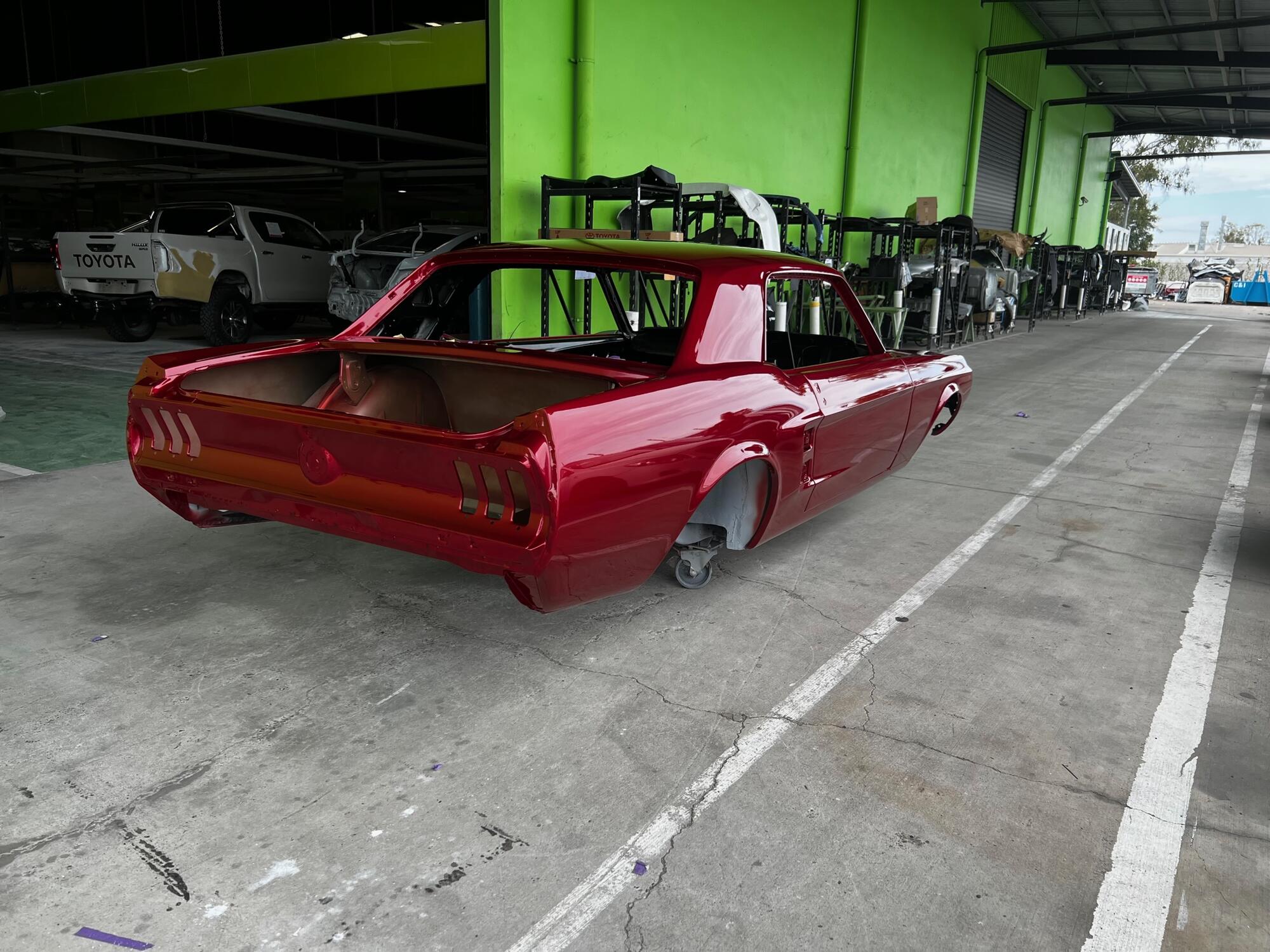

    12. #292
      Jan 2015
      Australia
      285
      Finally painted
Size:  580.4 KBName:  IMG_2367.jpg
Size:  502.1 KBName:  IMG_2359.jpg
Size:  401.4 KBName:  IMG_2361.jpg
      - - - Updated - - -
      Time for the rebuild

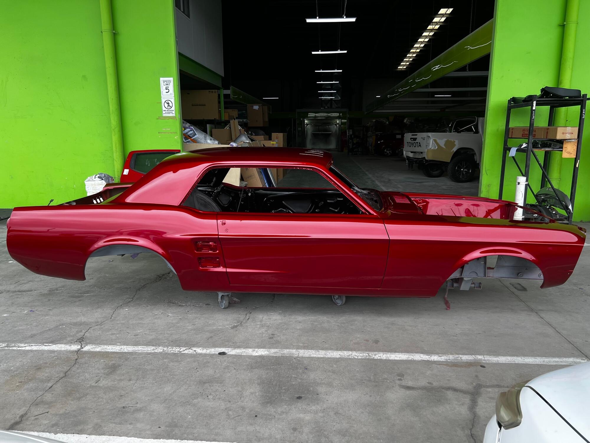

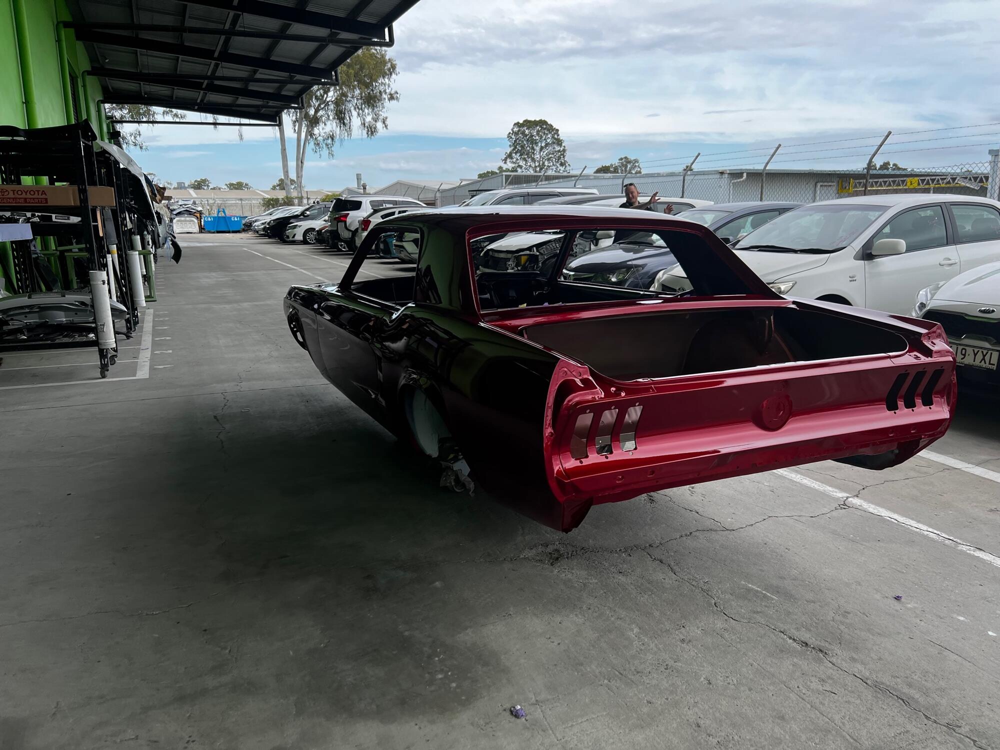

      Pain in the natural light. Looks darker in pictures but once the sunlight hits it the change is awesome

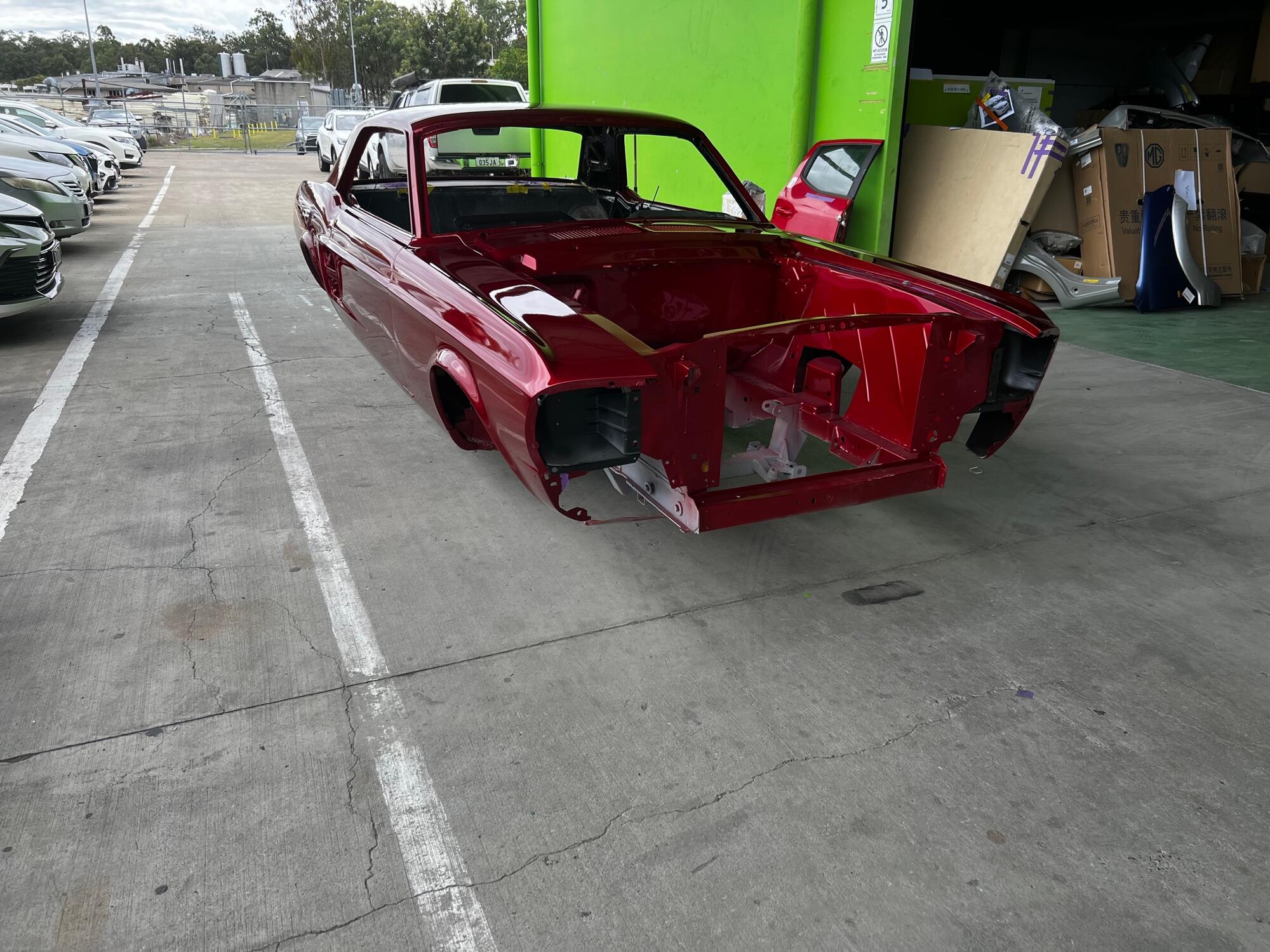

      This colour really pops in the Sun
      Lucid Red Pearl

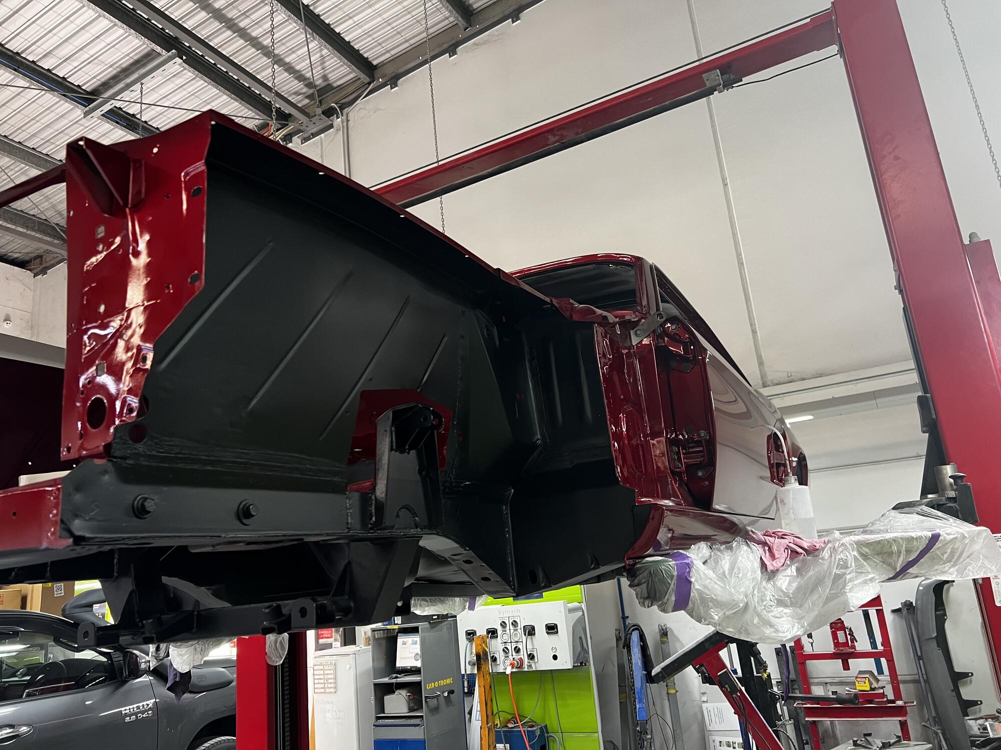

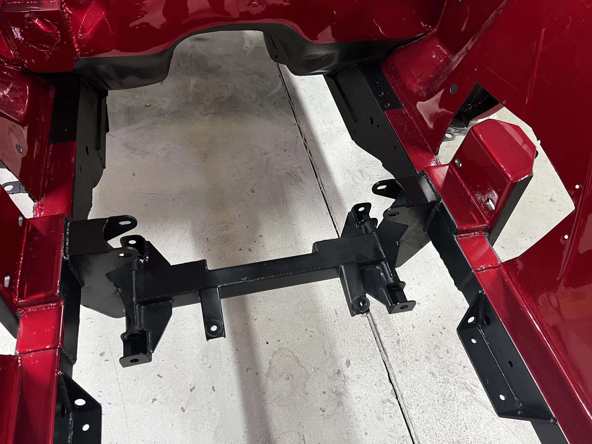

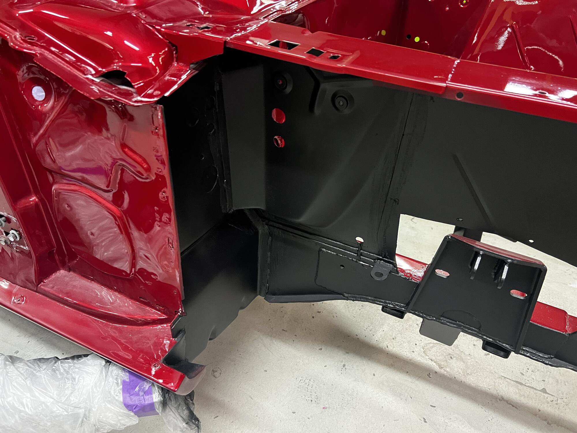

    20. #300
      Jan 2015
      Australia
      285
Size:  331.6 KBName:  IMG_2421.jpg
Size:  282.1 KBName:  IMG_2420.jpg
Size:  360.7 KBName:  IMG_2422.jpg
      Rapter coated the underside, wheel arches, inner guards and cross member.
      Thinned it down with 10-15% reducer to give it a better look than bed liner
