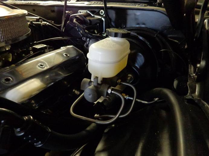

      Been awhile since I've posted or been able to get to the garage.

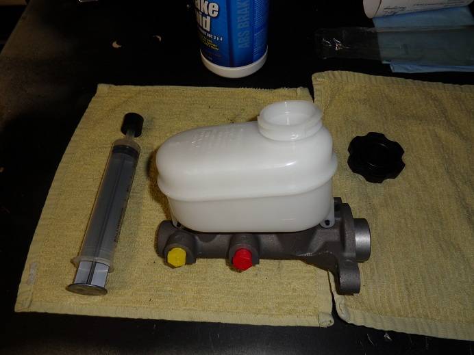

      Got the m/c bench bleed and the front lines bent and flared.
      Bought stainless steel straight tubing, spring wrap, and s/s nuts from Inline Tubing and made the lines for the m/c and prop valve.
      Now I just have to bleed the brakes and I'm done.
      Then on to the exhaust.

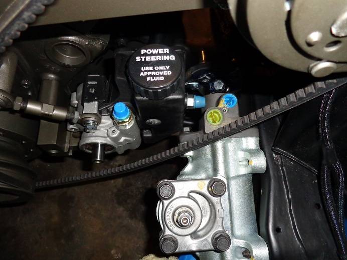

      Looking to replace the stock steering box with the Delphi 600 from Hotchkis.
      Now just have to mate a new style power steering pump to it.
      Looking at this aluminum GM high flow unit right now.

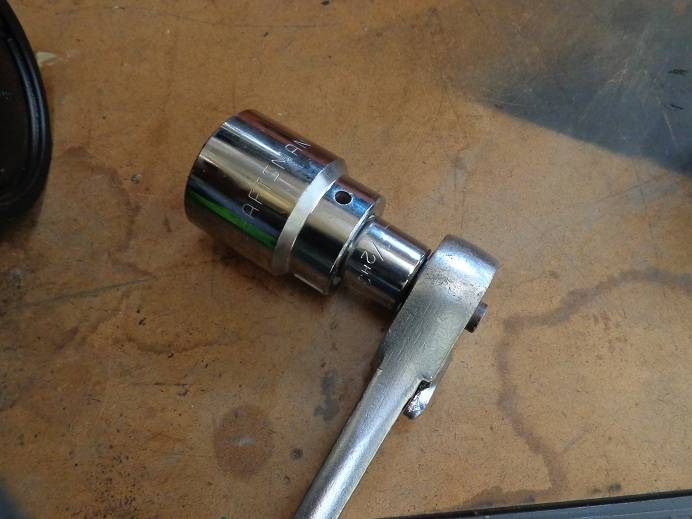

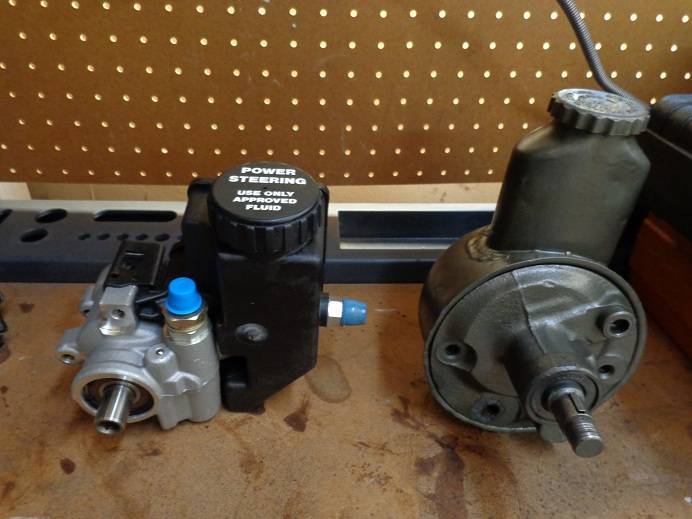

      I Haven't been in the garage or posted in awhile, but we had a big storm out here this weekend so I was house bound for a couple of days.
      So I got a chance to get out to the Camaro for a couple of hours.

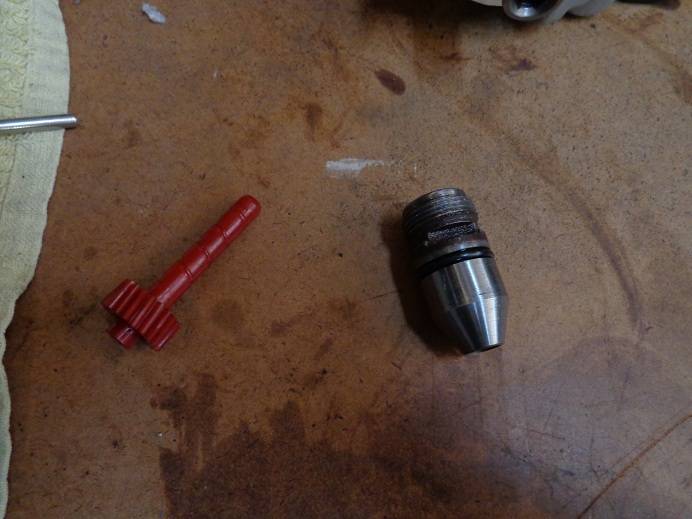

      Had a leak in the trans speedo cable so replaced the speedo bullit and gear.
      Been waiting for the Hotchkis steering box for about a month (they were on backorder from their supplier).
      Should be here monday so out with the old 70's steering box & pump.
      The only times I have ever used this socket is to take the nut on & off the steering box.
      Old steering pump, New steering pump. Slight differance.
      Hope to get it all mocked up this week so I can order the braided lines & brackets.

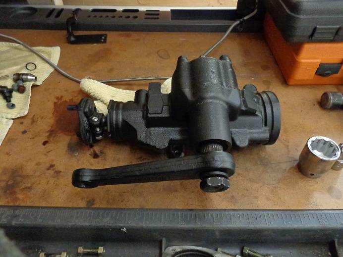

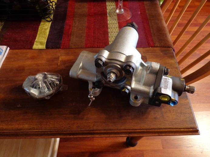

      Got my new Delphi 600 steering box from Hotchkis today.
      Paint it then install it.
      Now I have to order the pulley and the hose kit from Detroit Speed, ss bolts from ARP for the GM Pump and I'm set.
      Hopefully everything will be in by this weekend and another upgrade checked off.

      Got the box & pump mocked up today and they are very close.
      Not much room to plumb the lines. Should be able to redrill the mounting holes on the bracket to move the pump over almost an inch.
      That should do it. Just waiting for the DSE pulley and line kit to get here so I can make sure.

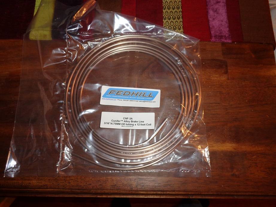

      I redid all my brake lines in stainless steel several months ago.
      Bought a kit from Inline Tube, very nice.
      Once I started to change out the mc and put in the Kore3 brakes I had to shorten or change up the lines.
      So, I bought a Mastercool Flaring kit, also a great tool.
      I have had sooooooo much trouble flaring the ss. I just have not been able to get them to seal correctly.
      I have redone them several times, I have loosened then tightened them several times. Nothing seems to work.
      I surrender and I'm going over to the other side.

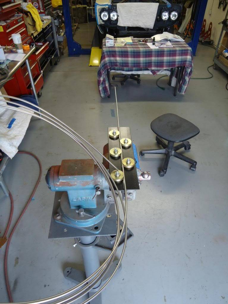

      I ordered a roll of Cunifer alloy brake tubing from Fedhill.
      Everybody I have talked to really likes this stuff.
      All of the advantages of ss and none of the disadvantages.
      Now I just need a way to straighten it.
      Looked online to find a tube straightener, WOW!!! Most were about $350.
      Does not seem like a complicated tool.
      Found a guy on a tool website who made his own for $30.
      Went to Lowes today and bought all the parts I need as per his list and tommorrow I will build my tube straightener.
