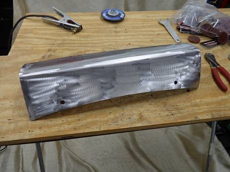

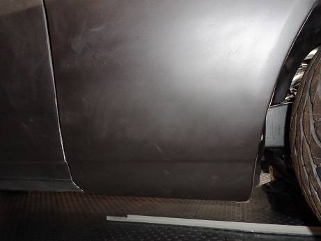

      Finished up the fender this last weekend. I don't think it came out too bad for my first body repair.

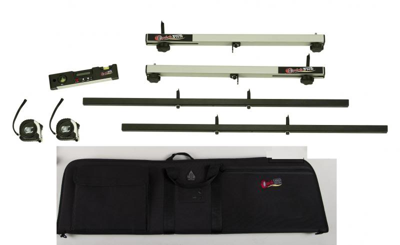

      I'm hoping to get it off the cradles this weekend and go for a shakedown ride. I need to align the front end so with that thought in mind I was going to but a DIY alignment kit like this one.
      I just can't shell out the $400 bucks for it when I can build one myself, but more on that later.

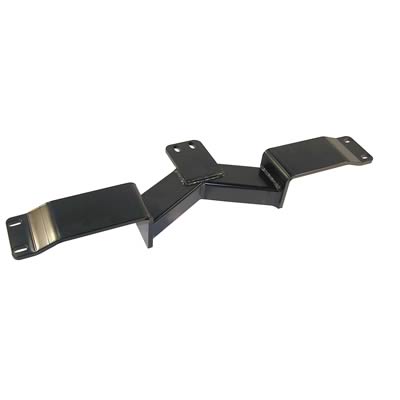

      I think I got a little carried away with tucking up the exhaust under the car. At idle the exhaust taps the trans crossmember.
      I think it's one of the last original piece's left on the car. I don't know why I didn't change it when I did the exhaust. Temporary insanity I guess.
      Anyway's I ordered a new crosmember from Summit. Should be here tomorrow.

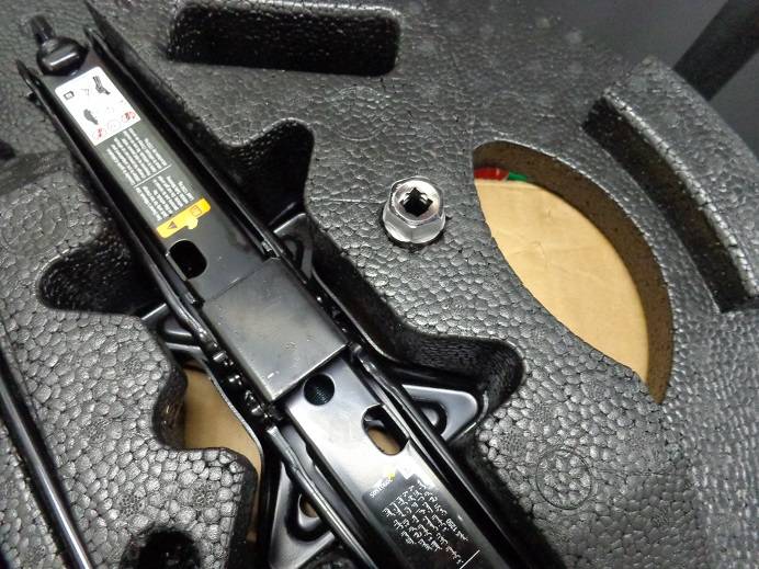

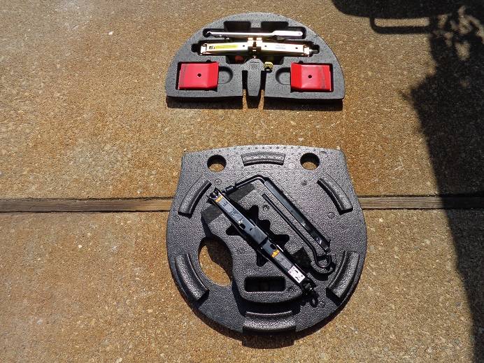

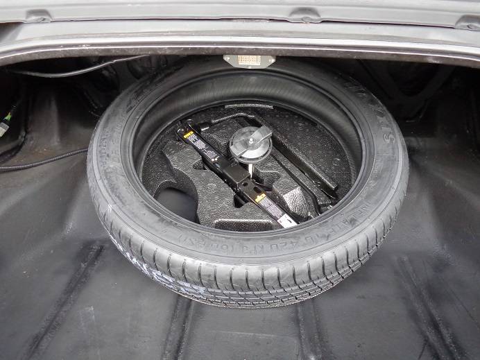

      I started with 2 differant spare kits. The top one is from an 04-06 GTO. I liked it because it has the wheel chokes built in.
      The bottom is from a cadillac. I got it online from GM. I like it because it fits perfect with the tire and wheel as it should because they come as a kit.
      I started today by placing the kit in the car to see how I would attach it. It fits good on an angle pushed up against the front of the trunk.

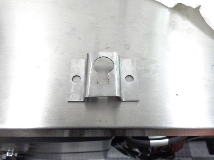

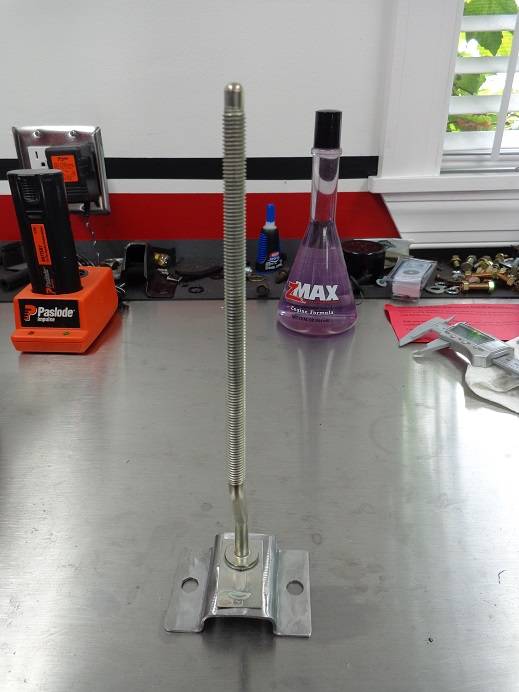

      The kit came with the rod that clips into the trunk floor of the caddy, but not the clip. So I made my own.

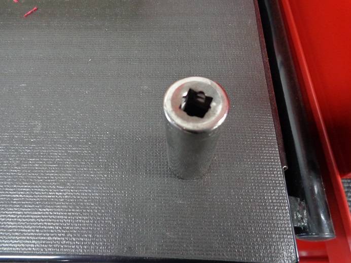

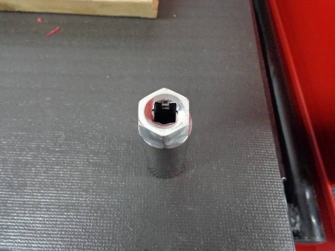

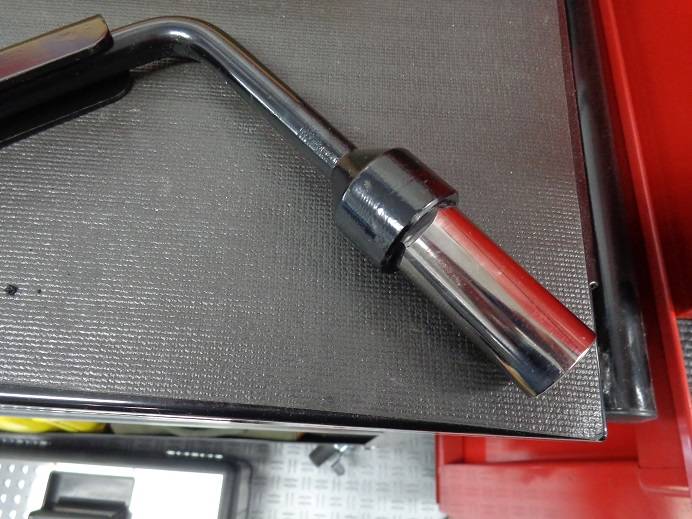

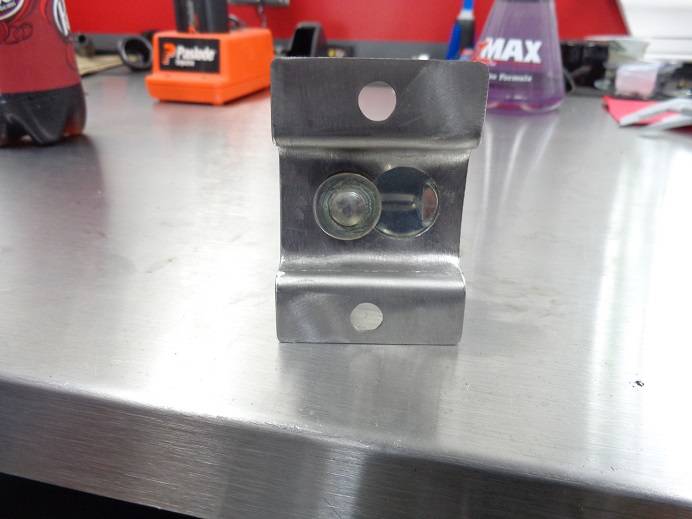

      I wanted to use the lug wrench that came in the kit but it didn't fit the lugs or the wheels. So I took the 3/4" deep socket I use for the lugs and modified it to fit inside the wrench.
      So now I just have to have the center of the wheel enlarged to fit over the hub and mount the tire.
      Then I can build in the tire and cover the spare and the rest of the trunk. Hopefully next weekend.

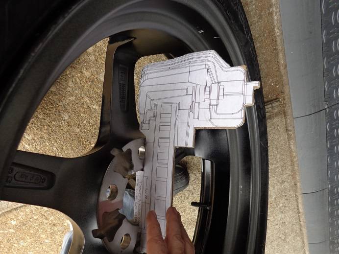

      I have a template for the Z06 brakes from Tobin at Kore-3's website.
      I will check it tomorrow.
      Here is the original picture I found of the wheel. So, I'm assuming if it fits over the Brembo's it probably will fit the Z06's.

      According to the template the Z06 brakes fit with plenty of room to spare.(sorry, I couldn't resist.)

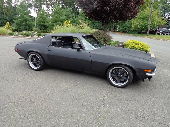

      I haven't posted in a while because I've been out enjoying the car. Except for adjusting the suspension a little I've done nothing to the car except drive it.
      It's been a blast. Have run into one small problem thought, front tires rubbing on the inner fender when I hit any big dip in the road. I have looked into getting wheels with more of a backspace but I really like the way the car sits and looks right now. So I have decided to modify the fender lip and inner fender to make more room. The design of the fender allows for the inner lip to be modified from a horizontal position to an almost vertical position thus opening up almost an inch of extra room. Tomorrow I'm going to take the fenders off and start cutting and welding. I will take pictures and post them.

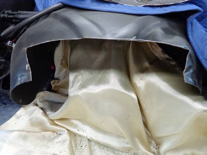

      Started the fender & inner fender today. Did not get as much done as I had hoped but most of the cutting is done.
      Started with the fenders first. There is about an inch wide lip in the wheel well that needed to be bend back.
      A few cuts and it folded up pretty easy. Just have to weld up the cut lines and good as new.
      I left about a 1/4" on the fender so I have picked up 3/4" already. Then I went onto the inner fender and cut out the piece I want to raise up.
      I actually cut out one more inch up into the inner fender after I took this photo. This will be the section that I square off to get 2 additional inches of vertical wheel travel.
      Should end up with plenty of wheel room. More to come.
