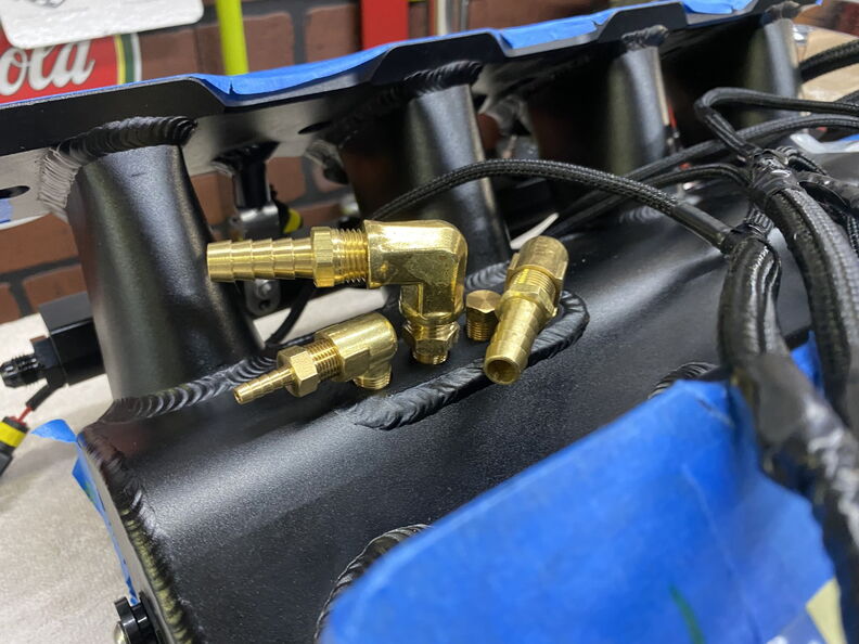

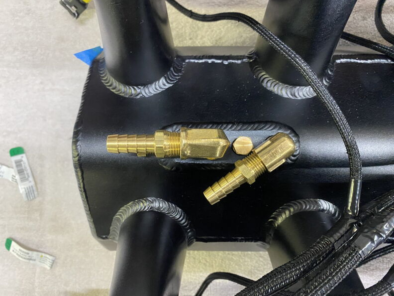

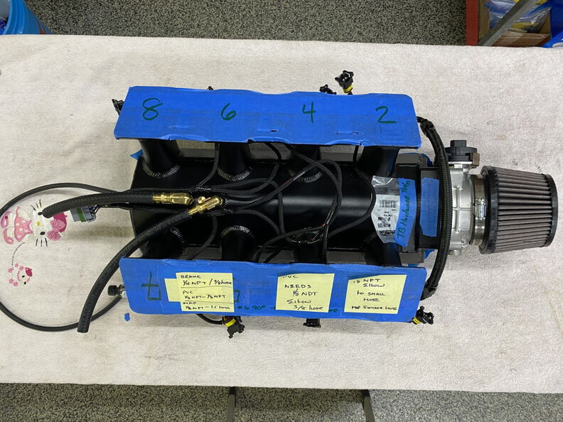

      Intake Manifold Fittings ( 10-30-21 )

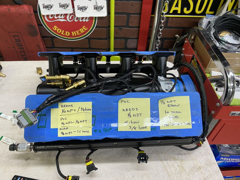

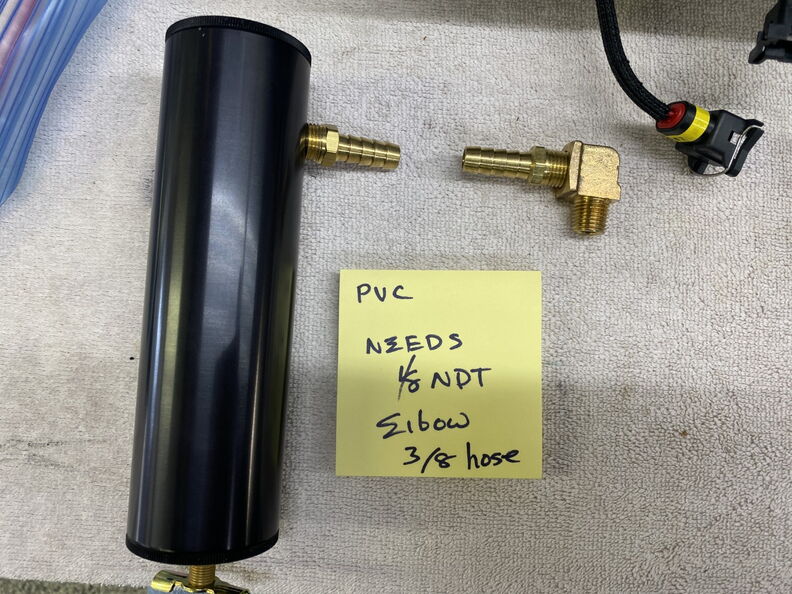

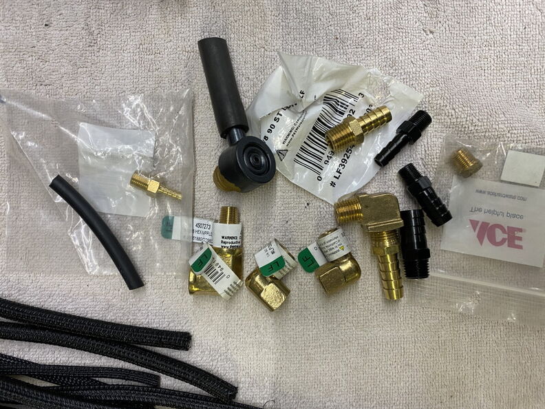

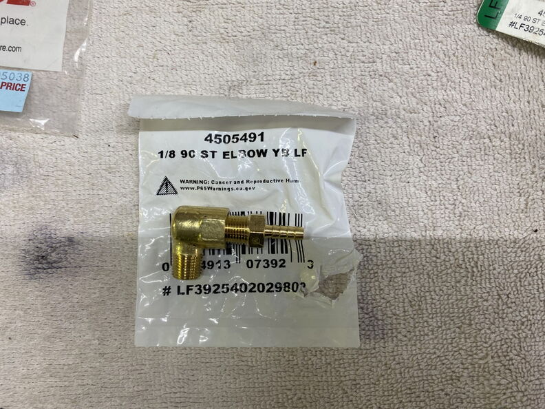

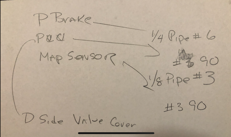

      Planning ahead before I run over to Ace Hardware for some fittings as the one's that are supplied are useless.

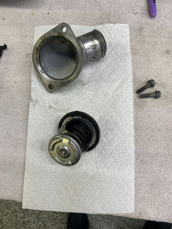

      So the Earl fitting that I happened to have looked like it was going to work. However, It did not as it hit the valley cover.

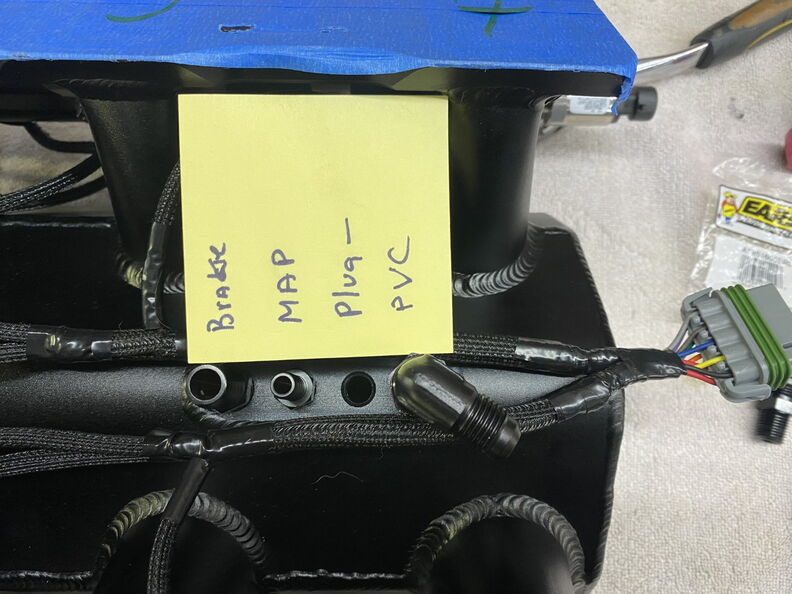

      So I found my Mike Norris Catch can and I used these fitting to start mocking up the fittings I needed.
      After a quick trip to Ace I think I have the fittings I need.
      Only at Ace can you find a 1/8" Hose Barb (trust me I looked everyone else)
      First Mock Up

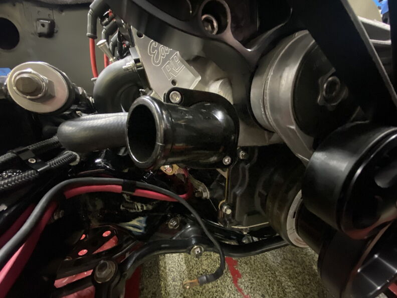

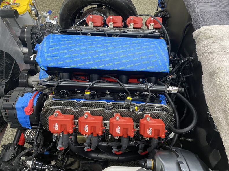

      Water Neck and Intake Manifold Plumbing ( 10-31-21 )

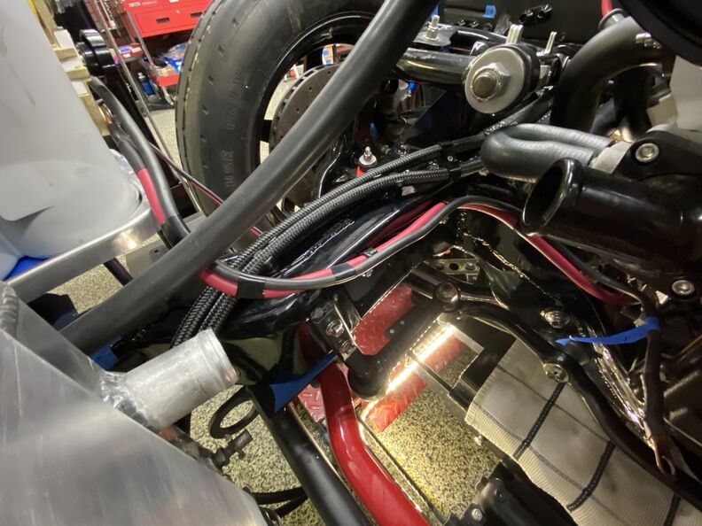

      I had time to do a couple simple projects so out to the garage I went.

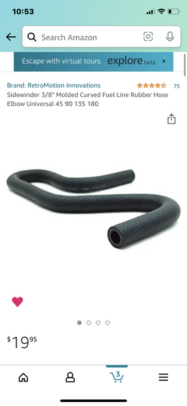

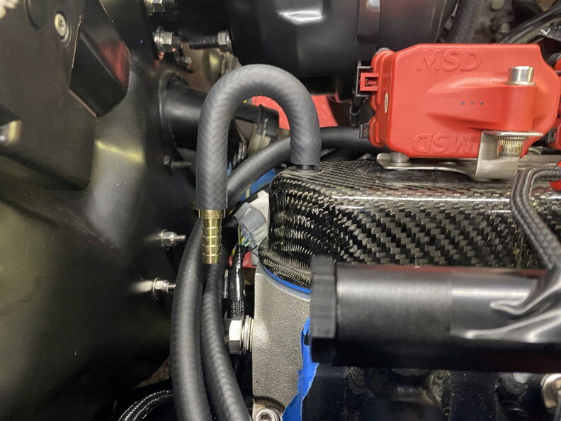

      I decided to mock up some of the hoses.
      Thankfully the auto parts store is close
      Nope, I don't like the way this hose looks.

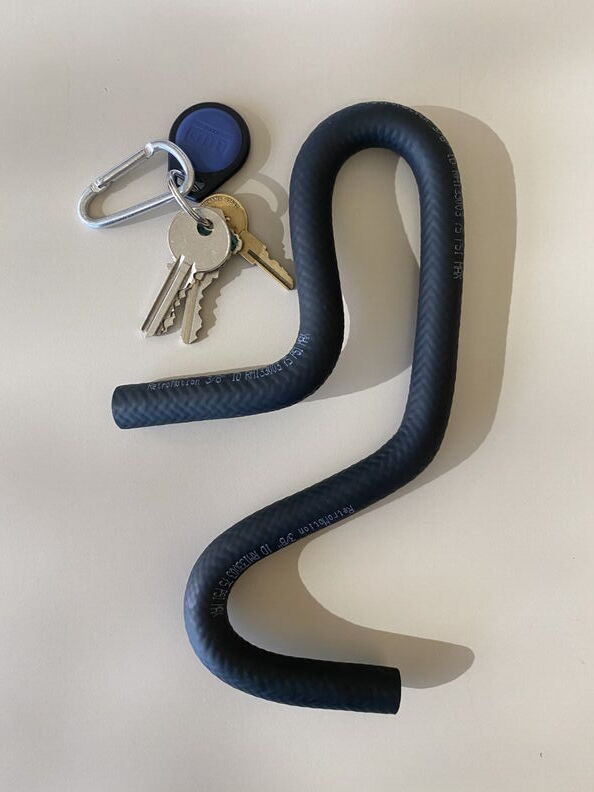

      I ordered this custom hose with all kinds of crazy bends in it.

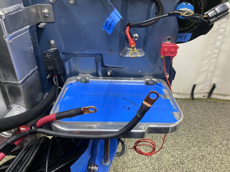

    3. #843
      Chicago
      2,788

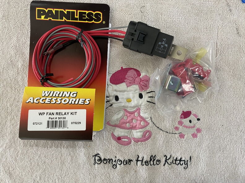

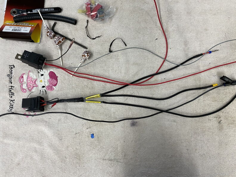

      Last one for the night Upgrading to a Waterproof Relay ( 10-31-22 )

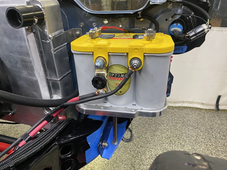

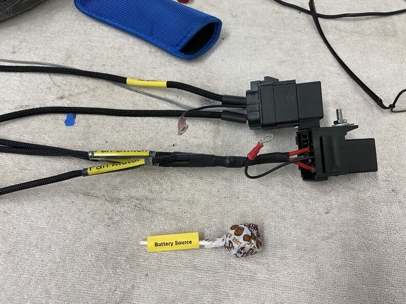

      Way back somewhere in this thread I installed Painless fan relay and I screwed up and didn't order a standard fan relay. So I ordered a new Water Proof Fan Relay kit.
      Since it is in between the battery and the radiator the batter once again needs to come out.
      Thankfully I used a weather pack connector as I was able to just remove the ground from the plug.

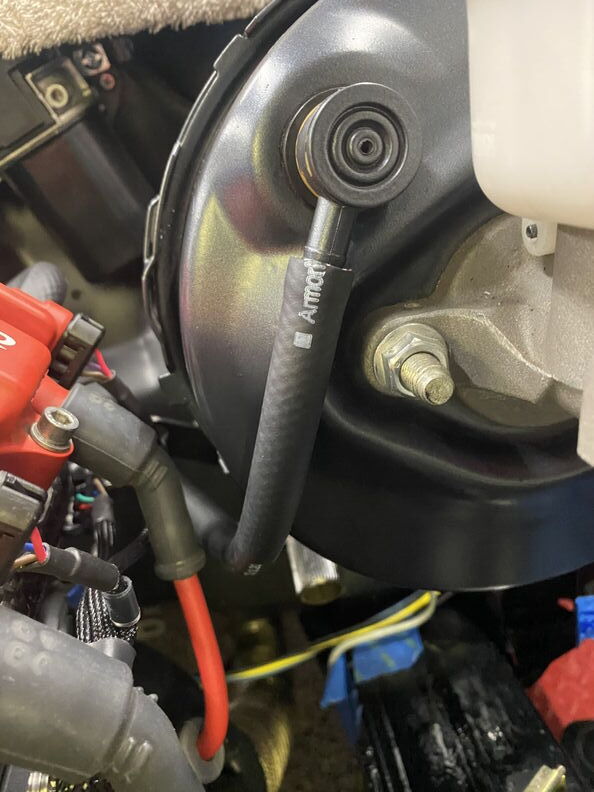

    4. #844
      Chicago
      2,788

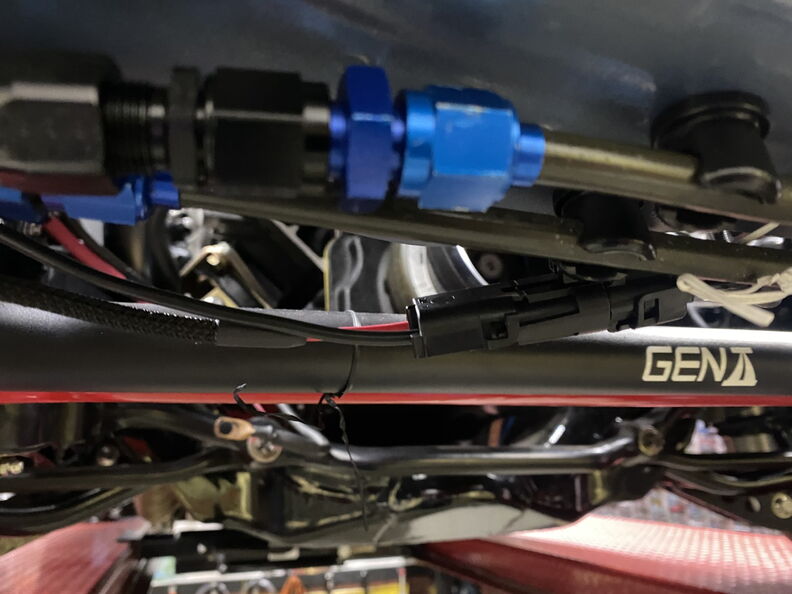

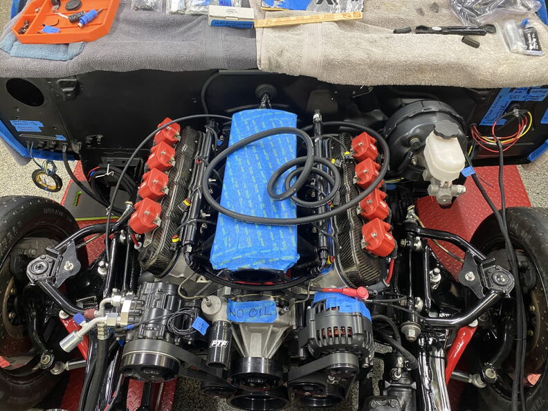

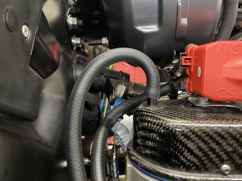

      Vacuum Hose Installed ( 11-09-21 )
      My molded hose arrived

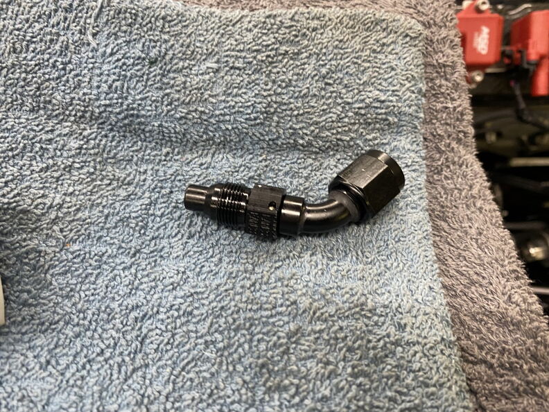

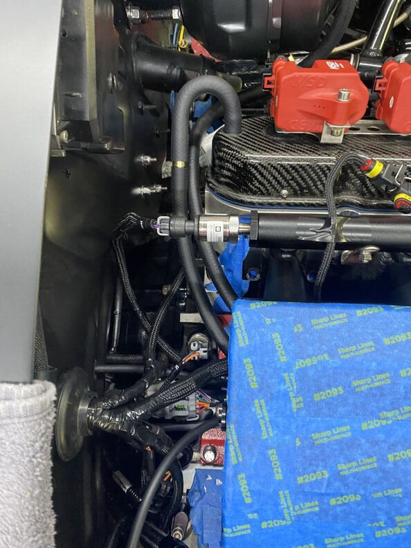

      I also received another fitting for the Fuel Pressure Sensor
      Looks like I need a longer hose.
      Found an all in one fitting that will be replacing two of the fittings.

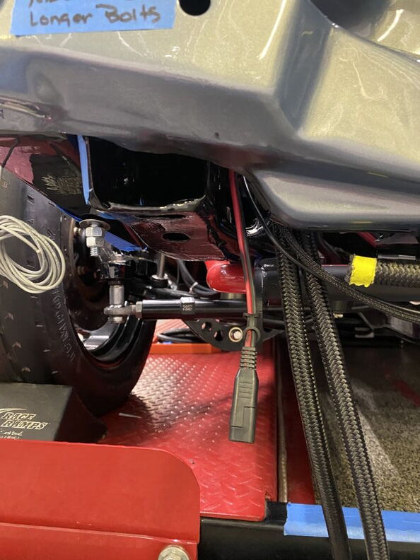

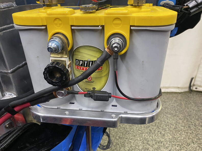

      Optima Batter Charger Plug ( 11-09-21 )
      Since I keep the car on the optima charger when it is parked in the garage I decided to mock up the wire and see if I could hide it when it's not in use.
      I can easily tuck it in the frame rail when not in use.

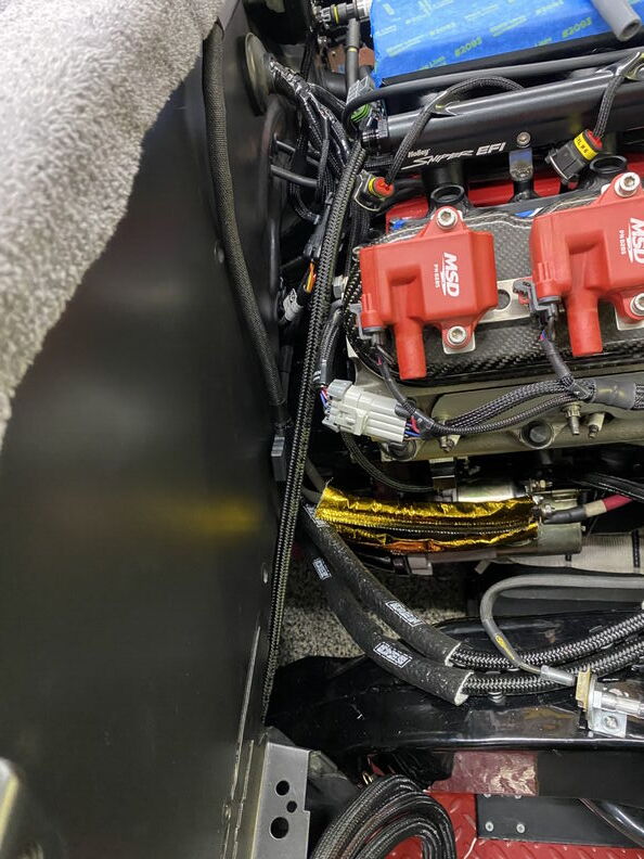

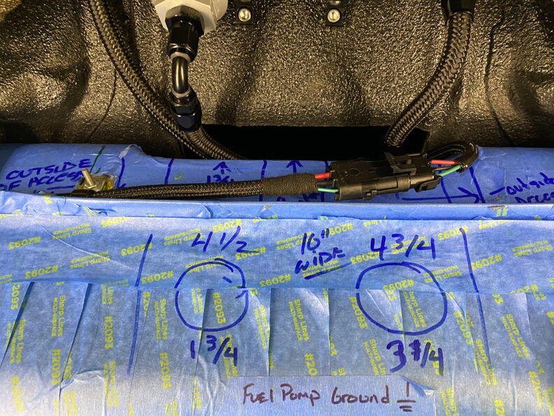

      Today I will be working on all of the various ground wires.
      My goal is to make then looks nice and I even have some company in the garage today.

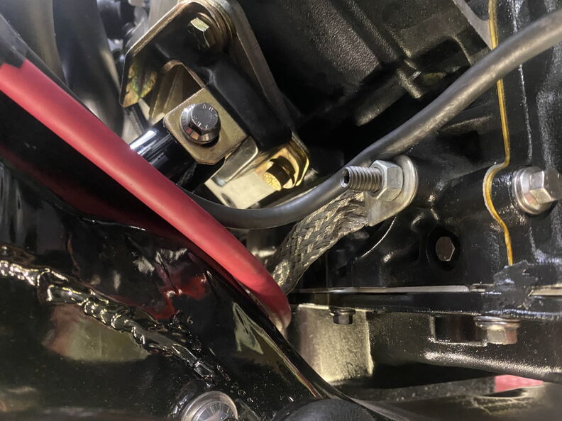

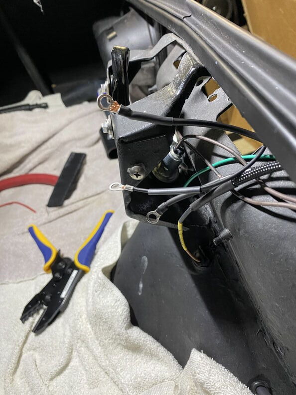

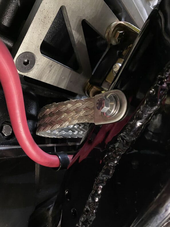

      Ground wire from the block to the frame
      Wires running back to the battery ( I think I have a cool idea and I hope to share it soon )
      Securing the ground wire to the motor mount bolt.

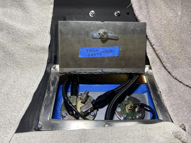

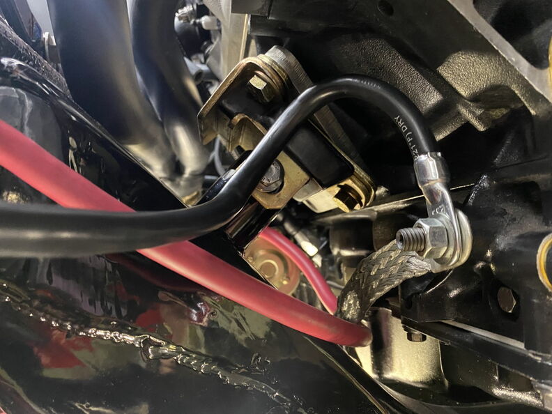

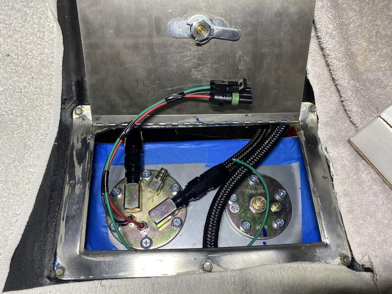

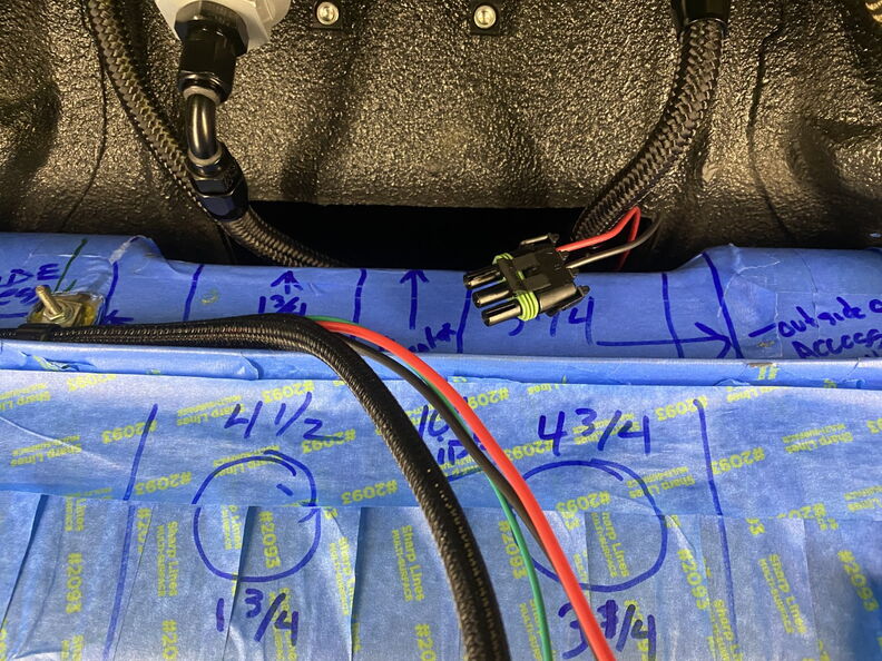

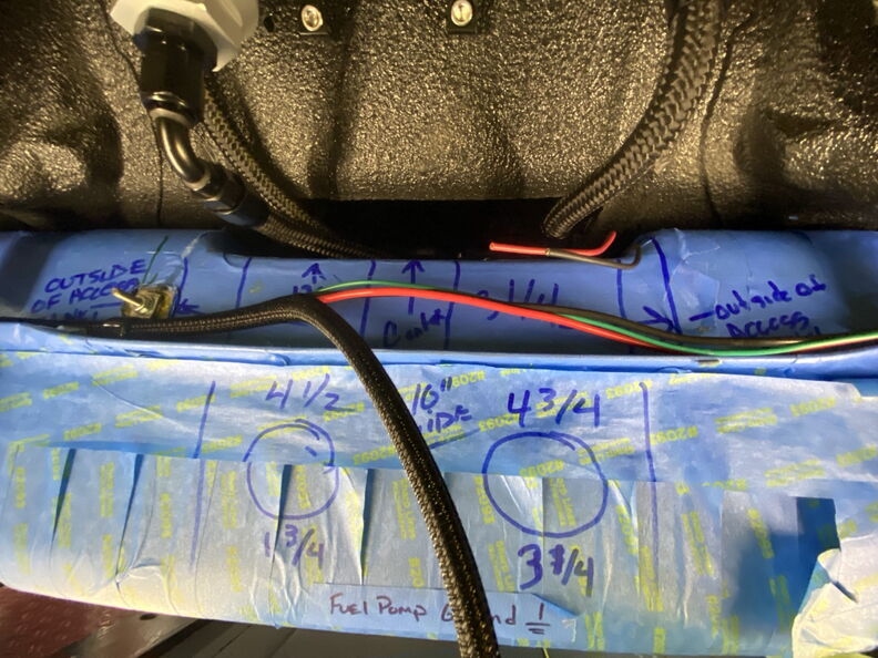

      I am finally connecting the wires from the relay to my gas tank.

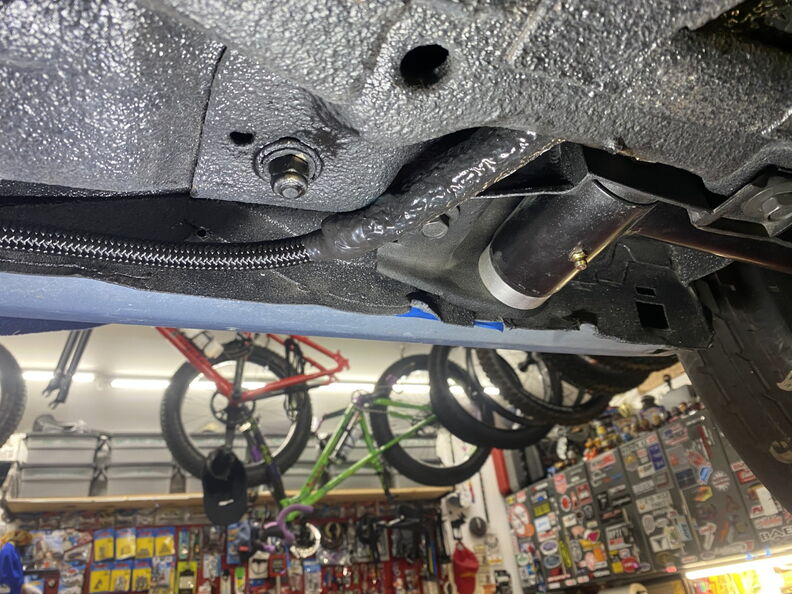

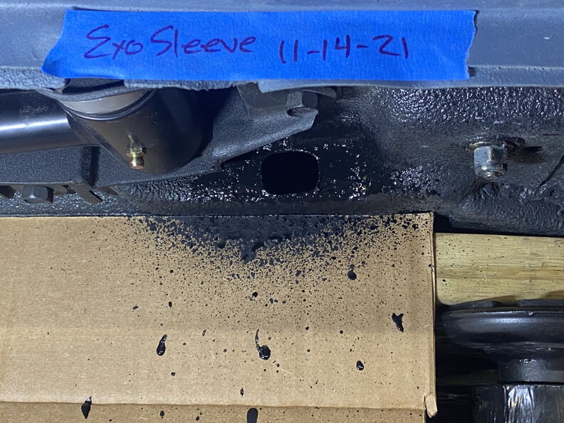

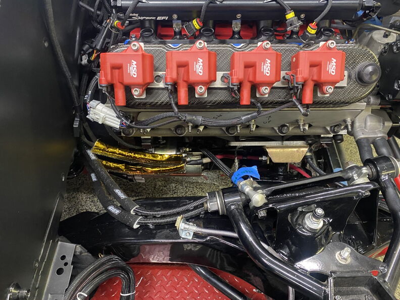

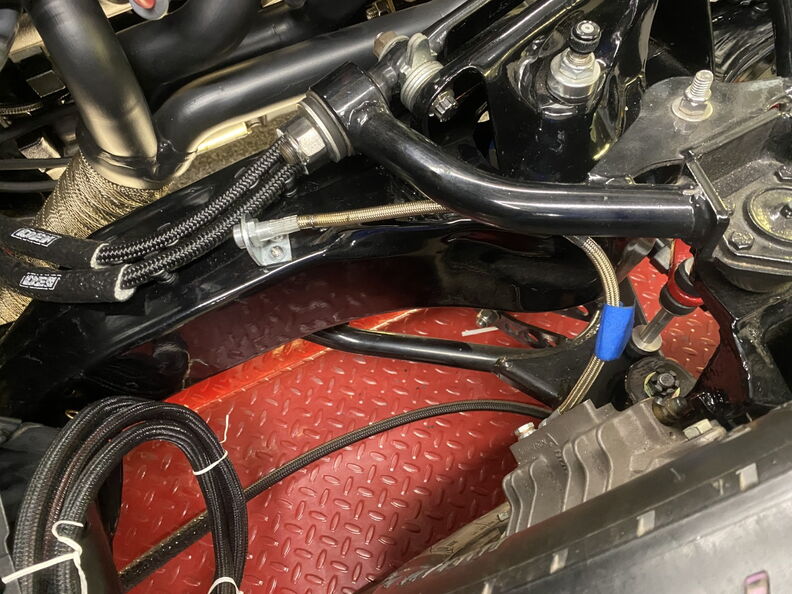

      Fuel Line Routing ( 11-14-21 )

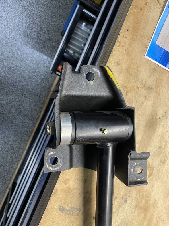

      Another reminder while I am here to powder coat the spring pocket and the lower arms.

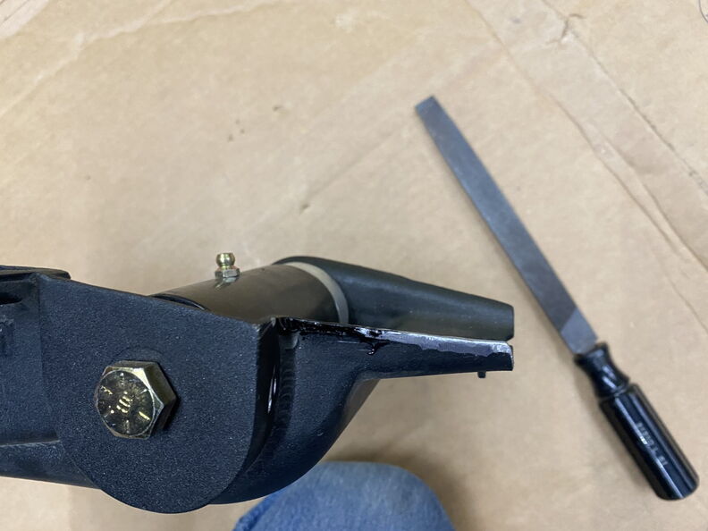

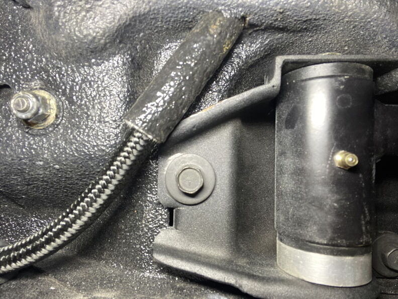

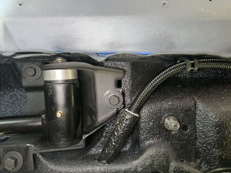

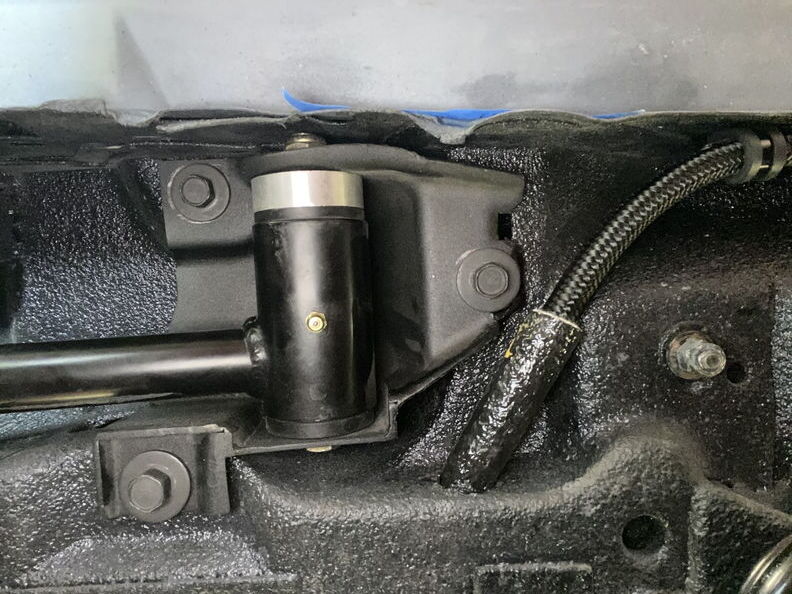

      The fuel lines runs right over the spring pocket and I am going to trim a little bit of it off to protect the fuel line.
      I started slowly removing just a little bit.

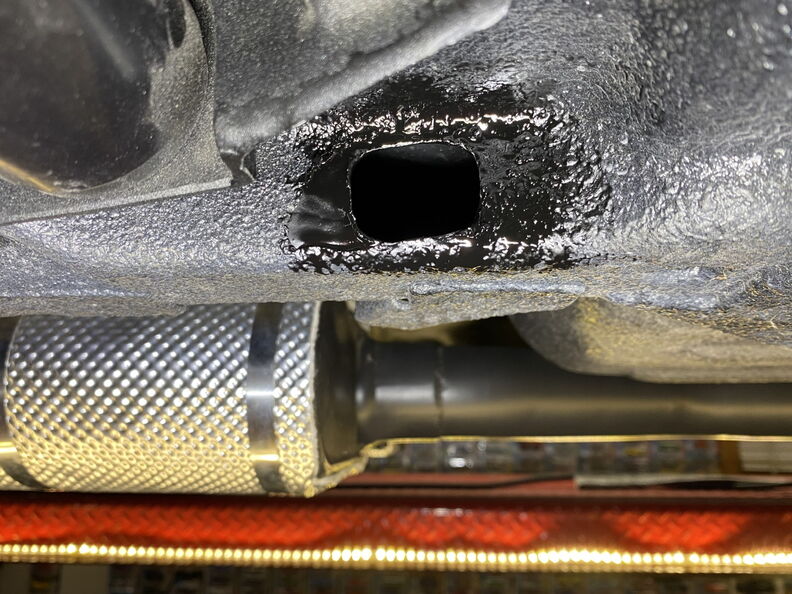

      Then I took just a little more off.
      Out comes them death wheel.
      A little clean up.

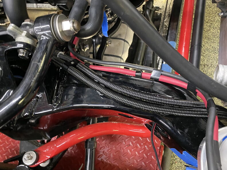

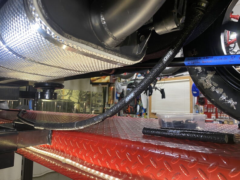

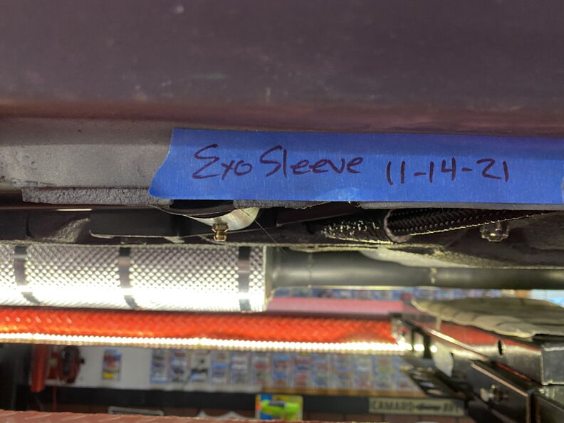

      All better now and I am still going to run the line through DEI ExoSleeve.

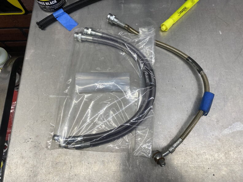

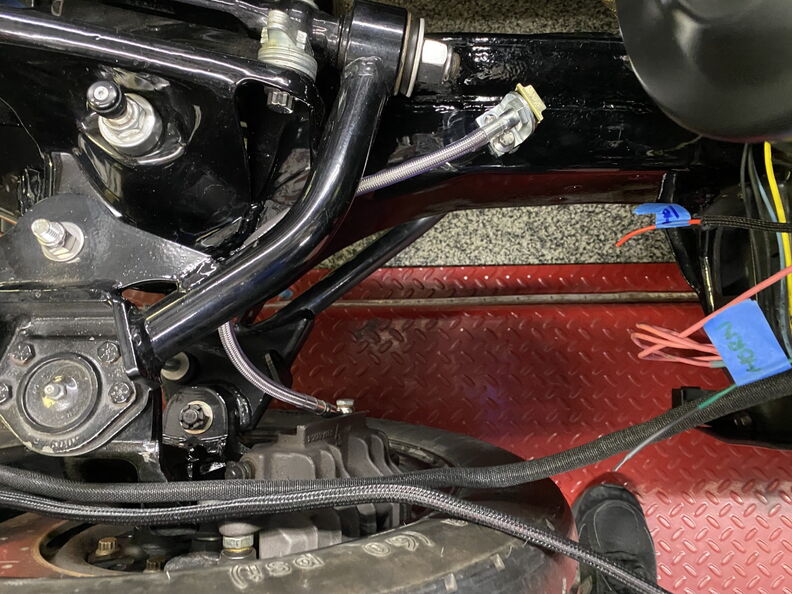

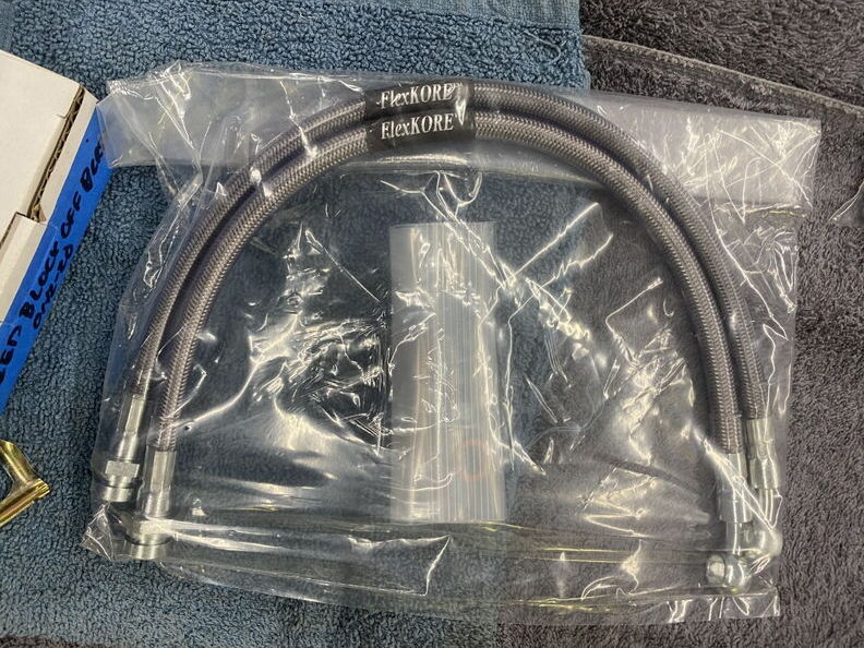

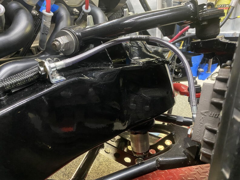

      Kore3 FlexKORE Brake Line ( 11-14-21 )

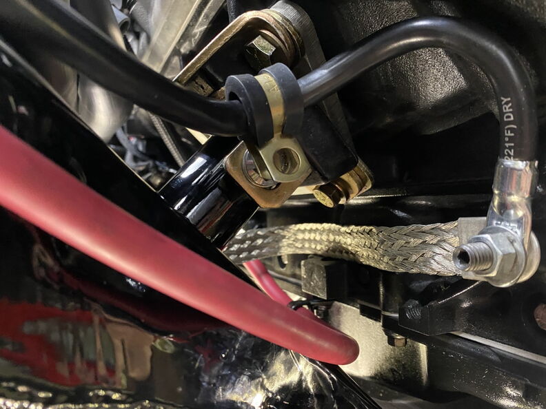

      I am finally installing the FlexKore brake lines.
      Old lines are coming out.

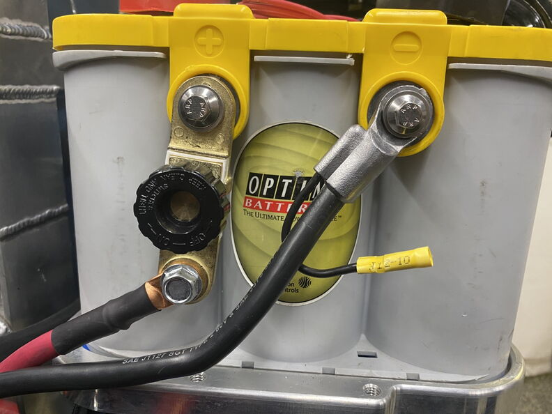

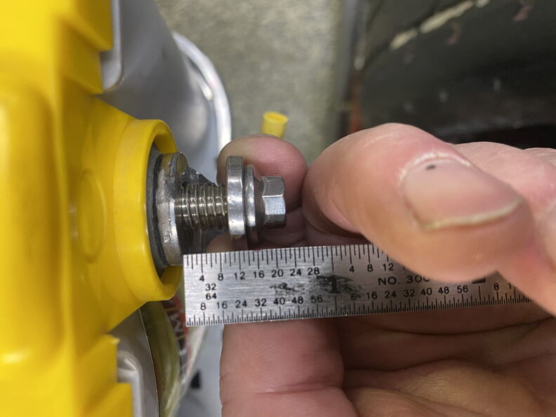

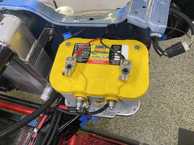

      On the battery switch, only one is necessary but if you wanted two it wouldn't hurt anything. It would save having to re-run the positive wire since it looks like it would no longer reach the battery without the switch. But, I would run one on the negative side because ECMs are far more sensitive to having the plus side opened than anything else on the car would be.
      Thank you for the quick reply as I am not sure I have it in me to redo the battery wire again. However, I might have to redo the ground wire as it may be to long now.

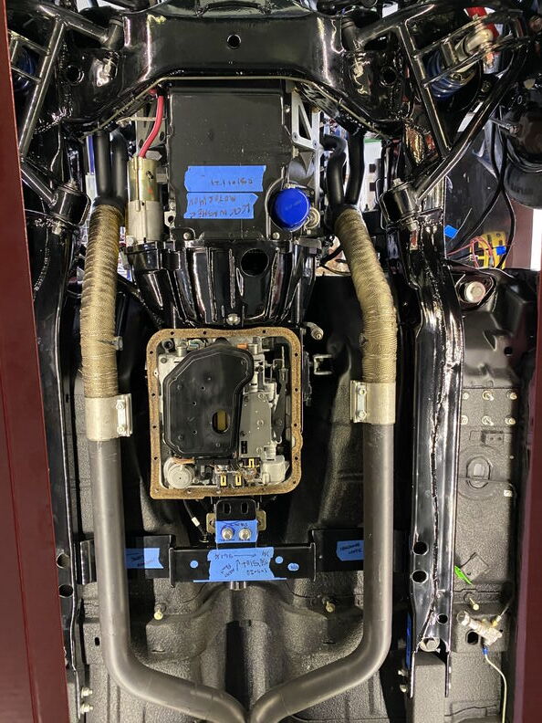

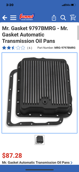

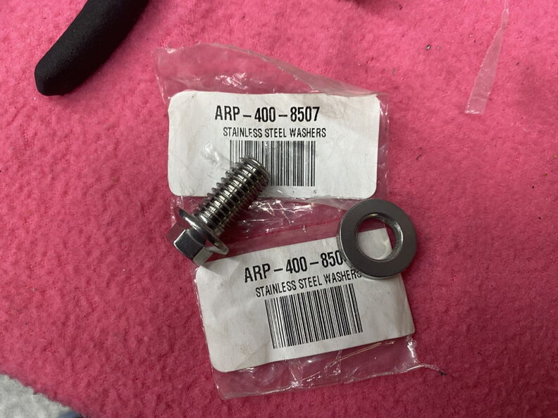

      Since the current pan on the new transmission from Atomic was a standard depth I ordered a stock depth pan
      as I didn't want the pan to hang down and lower then it was. Well this one didn't works so I guess at some point
      I will order another one.

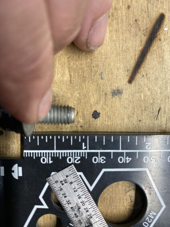

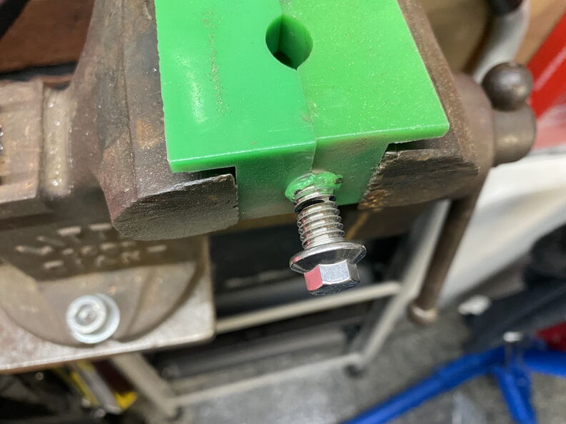

      Just in case anyone needs to know what size the bolt is.

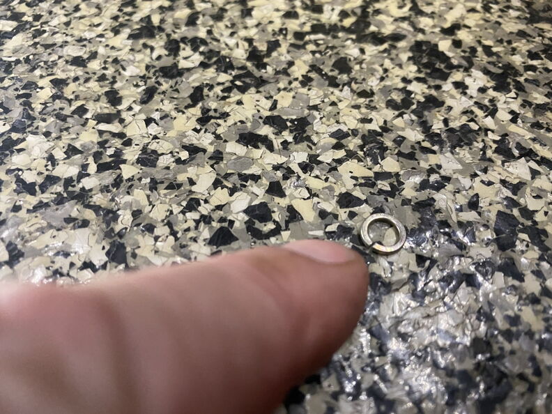

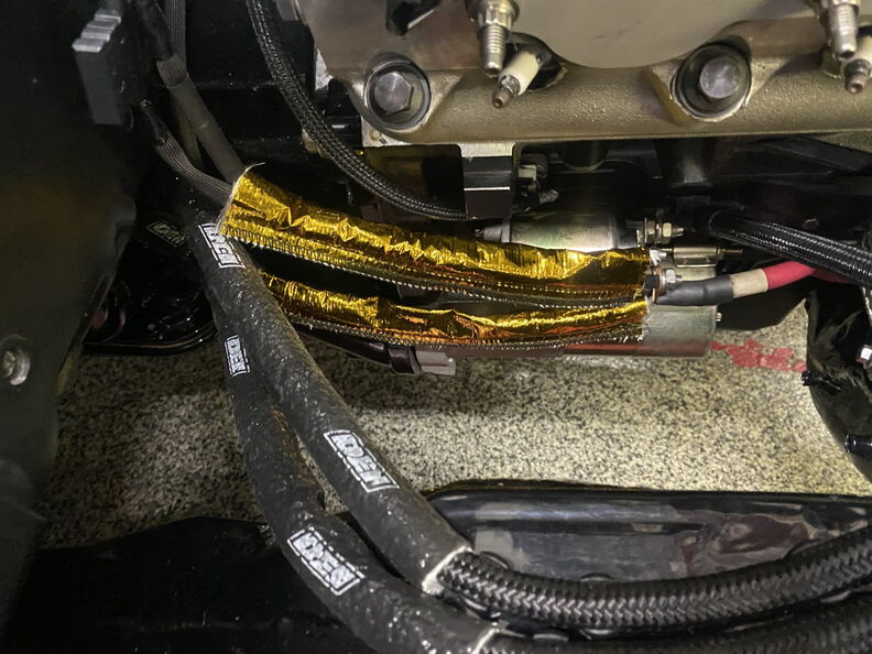

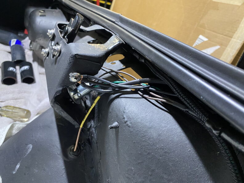

      Once again I am taking the passenger side header off so I can get to the wiring at the starter.
      So I dropped the lock washer of course my floor is speckled gray so it blended right in.

      Eventually I laid on the ground with the flashlight so I could find the freaking thing.

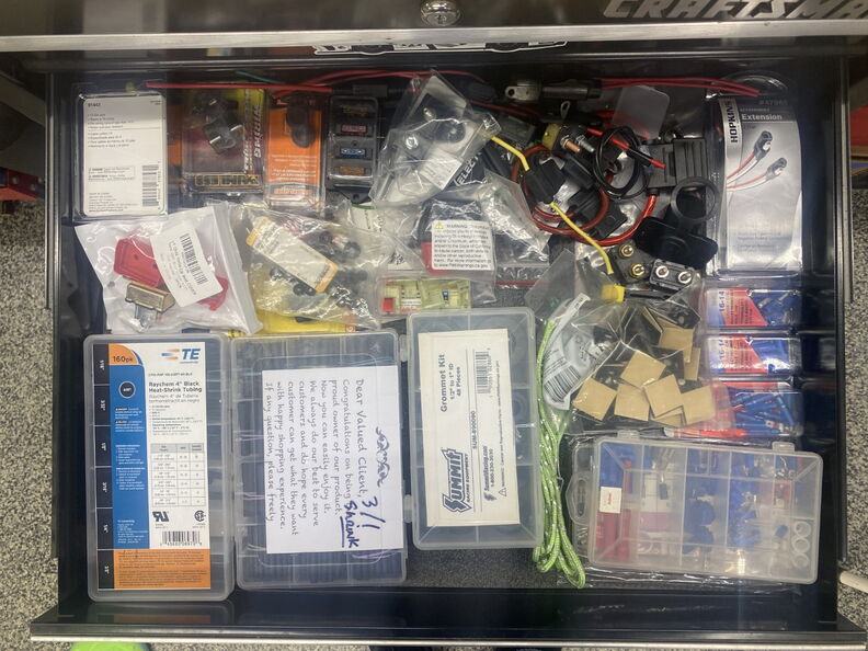

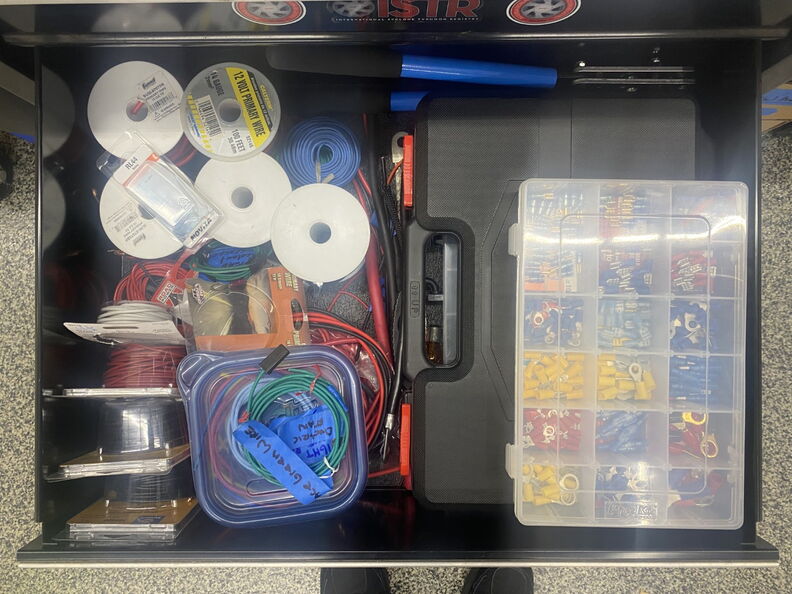

      Wiring toolbox ( 11-14-21 )
      So the other day I was looking at all of the tools I have collected for wiring this car and I thought I would share pictures of my tool box that is completed dedicated to wiring. So when the car is done it will be going back to my warehouse.

      Fuel Line Routing & DEI Heat Protection ( 11-20-21 )
      I need to widen this rectangular hole so the fuel line can pass through this opening safely.
      I installed the DEI Heat shield and EXO-Sleeve.
      I am still trying to figure out if I am going to secure the line to the firewall or just let it hang from the fuel rail. Which doesn't sound good as I type this.
      This is the final AN fitting that I need to finish the fuel line.

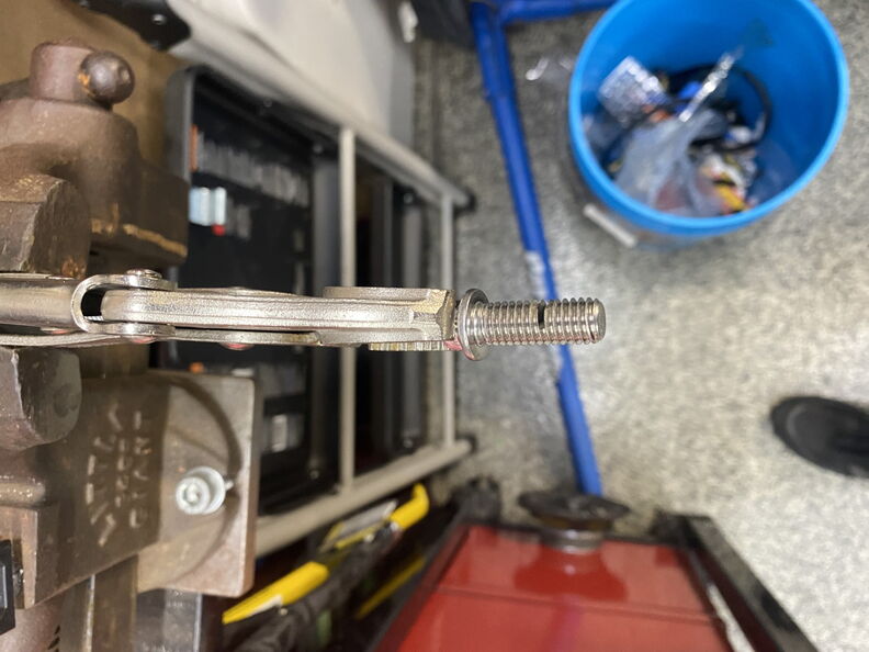

      ARP Battery Bolts ( 11-25-21 )
      I am not a fan of battery bolts and I really like ARP bolts. Since Rad Rides uses them on their builds I might as well use them on my car.
      Apparently the bolt got a little warm.
      I ran the bolt all the way in to make sure it wasn't to long. Eventually I will order the correct bolt.
      marty-mj
