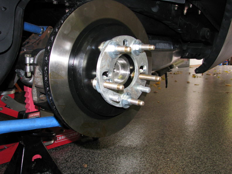

      Yep - it's a stock rear end with upgraded Moser Axles, Eaton Center section & Kore3 Brakes (BTW-Tobin is the man)

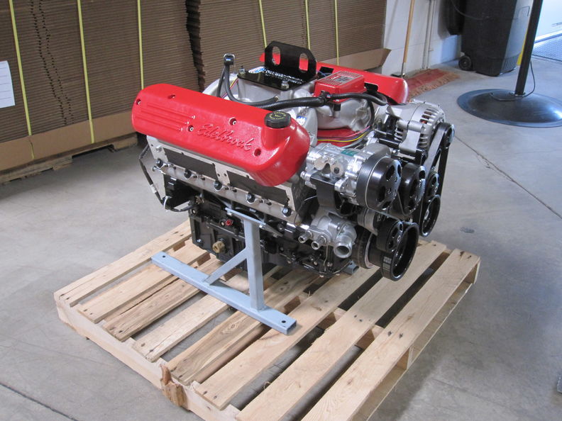

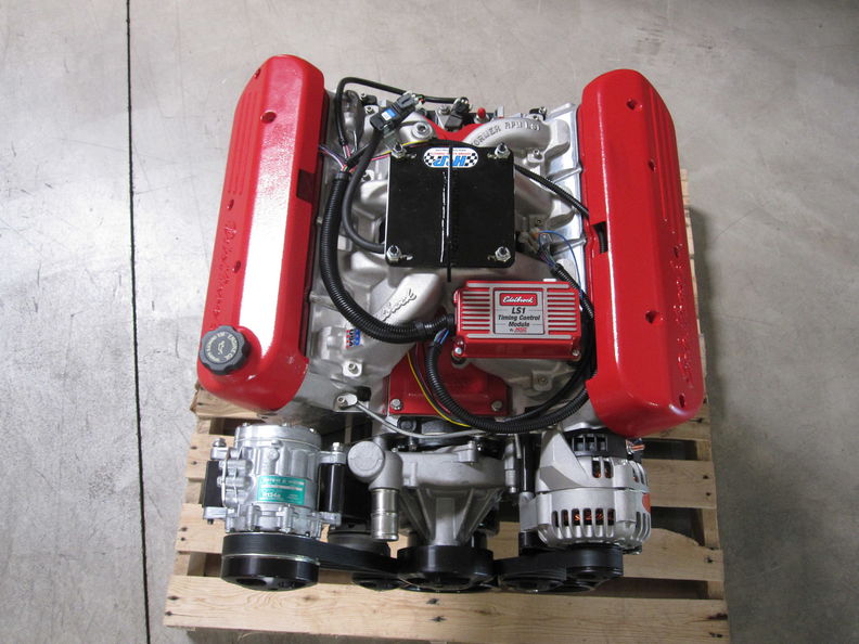

      2nd Chance Camaro - Wegner Automotive LS1 is Complete
      2013 01-06 Update - Wegner Automotive LS1 is Complete
      www.2ndchancecamaro.com

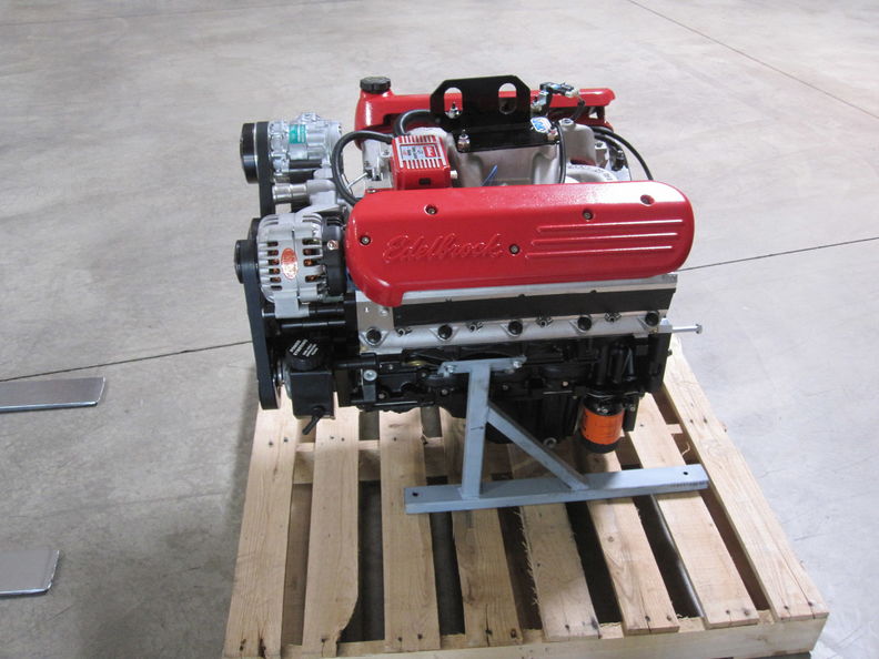

      Good Evening All,
      The motor is back from Wegner Automotive. While it was there I had them completely tear it down
      and check everything and install all of the new Parts. I think my favorite part is their new front drive
      it's super clean and fights tight to the block
      I couldn't be happier with the way the motor turned out. The motor dyno'd 468hp with a new Holley Carb
      which should be more then enough to haul that mountain bike on the side of the car.
      Kenny is going to have the "Edelbrock" and the horizontal lines on the Coil Covers painted White. I can't wait
      to see them painted.
      Trying to keep it simple all of the MSD wires will be wrapped in black nomex wrap from Tech Flex. We're not
      trying to hide anything on this project.
      [IMGhttp://garagescene.net/_data/i/upload/2015/12/20/20151220211031-6ed7a635-me.jpg[/IMG]
      I had the guys at Wegner replace all of the GM hardware with ARP hardware.
      pictures hosted by www.garagescene.net
      marty-mj

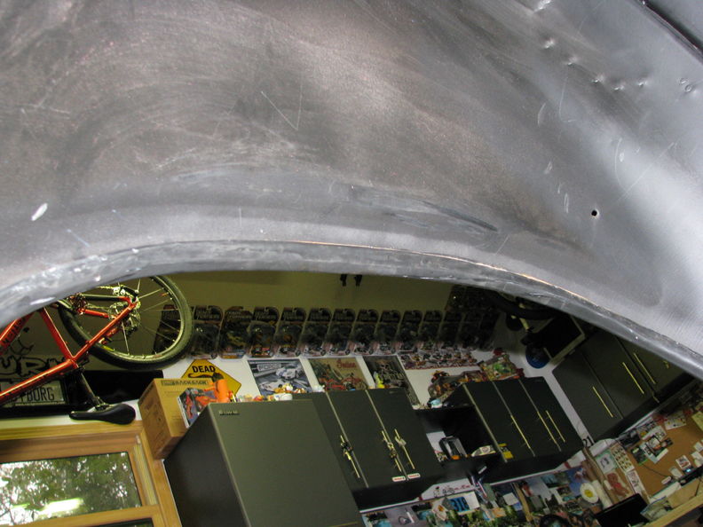

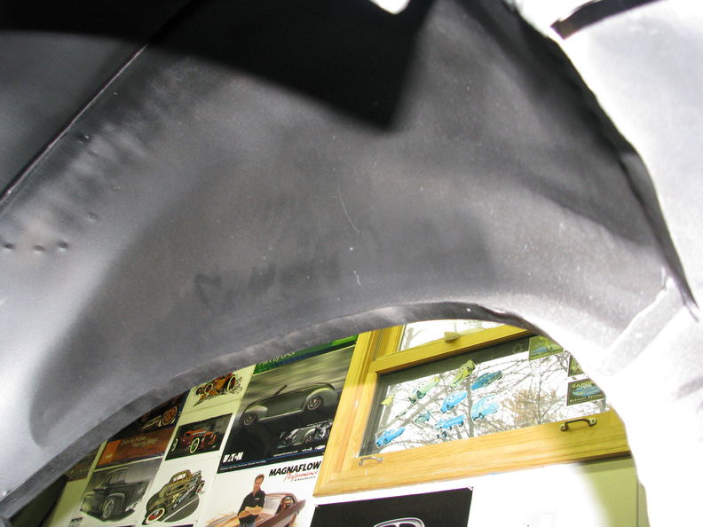

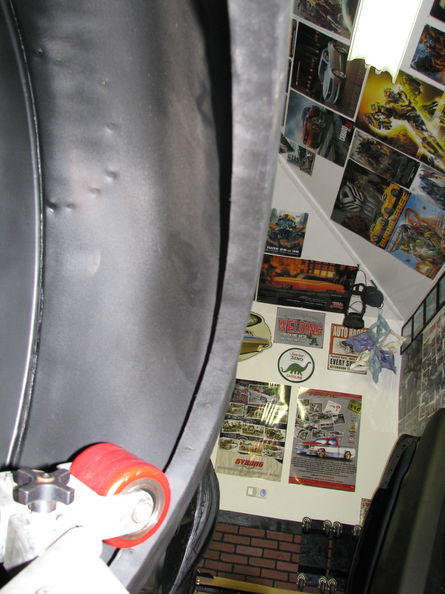

      2nd Chance Camaro - Rolling the Inner Fender Lip
      2013 01-29 Update - Rolling the Inner Fender Lip

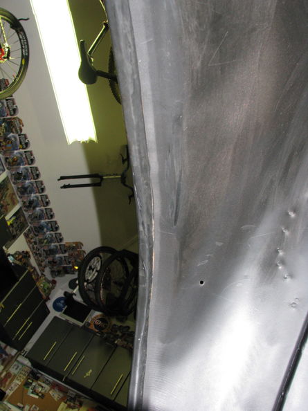

      Good Evening All,
      Last step is to roll the fender lip to gain a little tire clearance.
      You can see how wide the fender lip.
      Fender roller mounted and the fun begins
      Finished - I've gained about 1/2" of extra room.
      marty-mj

      That looks nice. How did you like the tool? Eastwood?
      Stephen
    12. #272
      Chicago
      2,788
      Quote Originally Posted by srh3trinity View Post
      Actually I bought it from Tire Rack back in the day when i was building Syborg. At some point they sould it to Eastwood so it's the same thing.
      It took about 20 minutes on each side. Well worth the time and money savings. If you have a painted surface it is good to use a heat gun to prevent the paint from cracking
      marty-mj

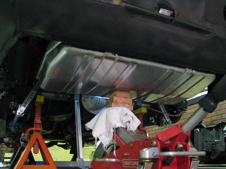

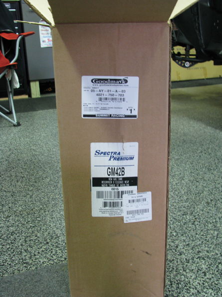

      2nd Chance Camaro - Goodmark Fuel Tank
      2013 03-13 Update -Goodmark Fuel Tank
      Good Morning All,
      Okay, as most of you already have guessed I am way behind on posting updates. Let's just say the last 9 months
      have been really fun (sarcasm). Chemotherapy is finally over and it's time to bring you guys up-to-date on the
      car. As for my health everything looks good and so far all of my test have come back perfect. Good news!
      Now back to our regular scheduled Updates.
      Since we are running a Carburetor on the car I ordered up a Goodmark Industries stock replacement tank from Summit
      Racing. I also ordered all new hardware to install the Tank. Summit Racing has sure received a bunch of my money in
      the last year. You can't beat there service and pricing.
      I really like seeing Made in the USA & Made In Canada.
      Kenny will make the necessary modifications on the front of the tank for the fuel line and the Edelbrock electric fuel pump. The Fuel Pump
      will be mounted on the tank directly behind the differential. Moving the lines to the front of the tank is much safer then having them coming
      out of the back of the tank and being exposed.
      On the power Tour several years ago a car with a low hanging fuel tank & rear exiting fuel lines caught on fire after it gently rear ended at
      a stop light. Moving to lines to the top or front of the tank is much safer location.

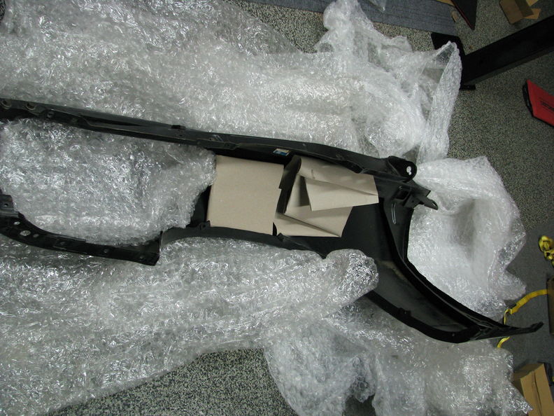

      2nd Chance Camaro - A Few NOS Parts
      2013 03-13 Update - A Few NOS Parts
      Good Morning All,

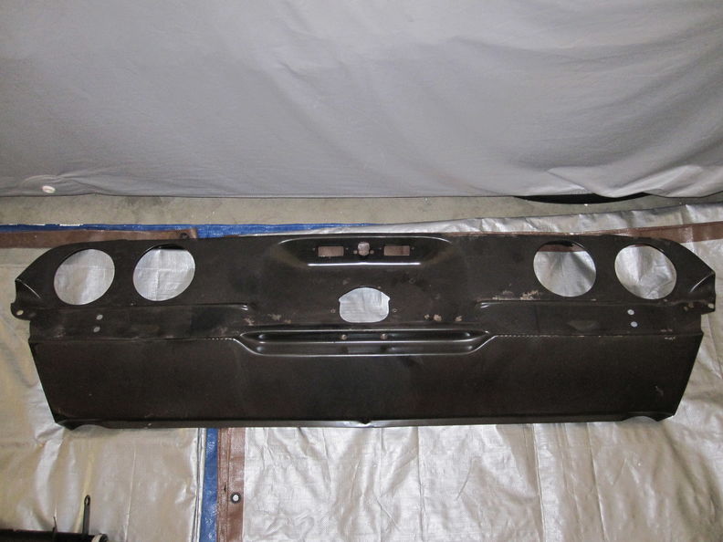

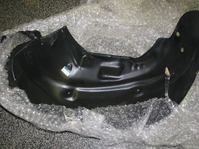

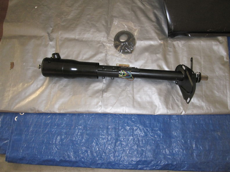

      Trying to keep up with the Made in America theme I searched the internet and found all of the NOS parts I needed. Tom at
      Courtyard Camaro was a great help. If it's for a 2nd gen Camaro he has it our can point you in the right direction.
      marty-mj
